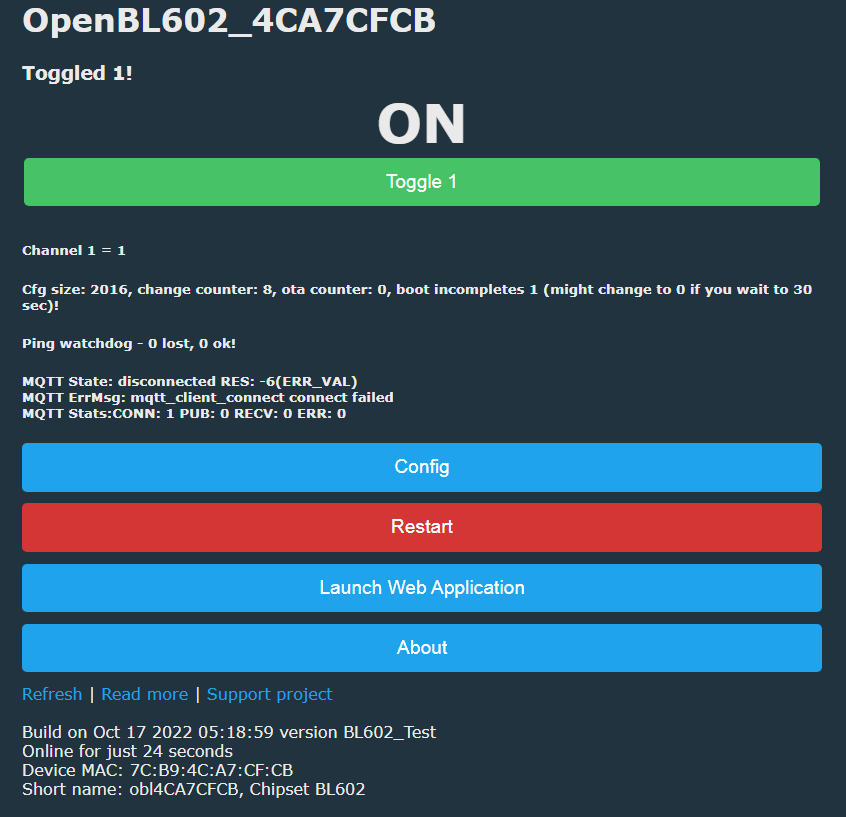

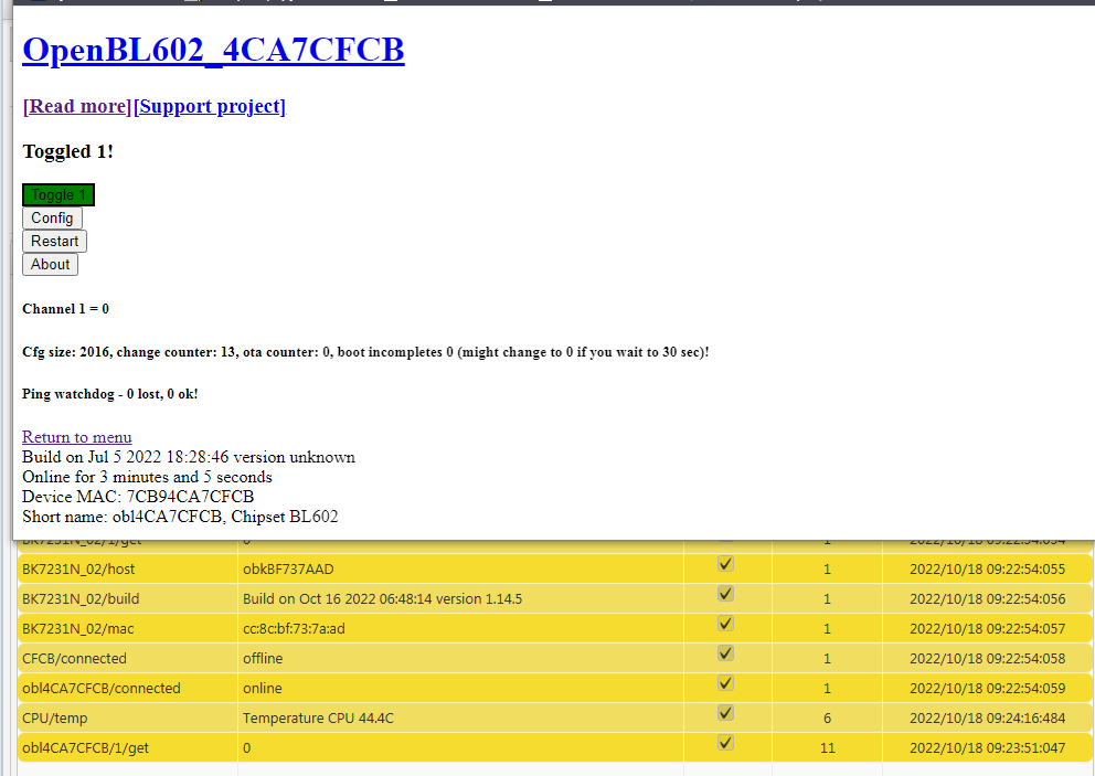

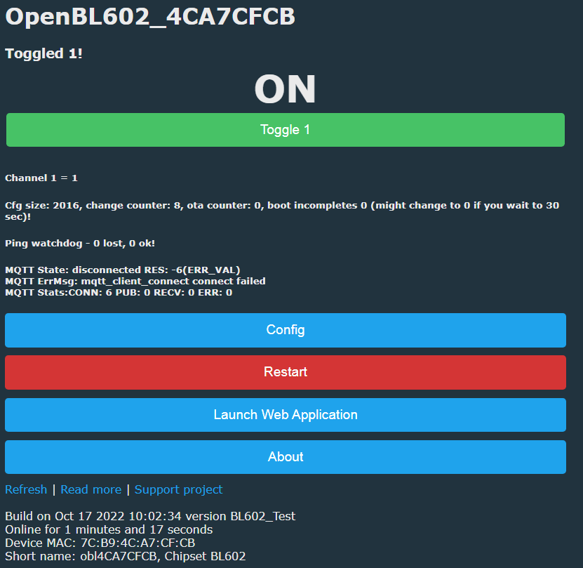

    bxwen19
    Posts: 9
    OK, manage to flash using Rx0 and Tx0 instead.
    Cell phone can see a wifi access point openbl602_...., if click, it says sign into network,showed tasmota interface, but then disconnect
    Teraterm shown random symbols. There is no baud rate 2000000 to choose
    Finally, wifi is connected. Is it time to remove the wires and solder everything back? Is the OTA working? How to toggle the relay and how to read the power?
    The middle pin doesn't seem to go anywhere.

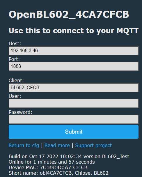

    I have a Problem with the Home Assistant Template
    The Code, generated with the Web GUI works, but i got 3 Sliders for each Color one.
    The Code posted in this Thread to fix this, dont work for me.
    Home Assistant starts after in Safe Mode. I putted the Code in the configuration.yaml as described, but no Success.
    Can someone explain me what to do?
    Iv got 2 Tasmota Devices within the System. That collides with this Yaml Configuration i think.
    EDIT: I have it: There is a new Format in Configuration.yaml since my used Version.
    This is how it works now: i Must more RTFM!

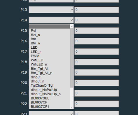

    bryanmandville
    Level 4  
    @p. kaczmarek2 thanks so much for all your hard work, this firmware is awesome! I was able to get a Smart Life door/window sensor (BL602) working in Home Assistant. It's great. However, the one issue I have, with this being a battery powered sensor, is that it seems to drain the battery very fast. The sensor when used with Tuya lasted for months and now I only get about 48hrs...
    Any tips on configurations changes to help improve battery life?
    Right now I just have the configuration set up as a binary sensor with a DigitalInput_NoPullUp on pin 8.
    Will definitely be supporting this awesome project moving forward!!

    Thanks for the dev cube 1.4.8 file!!!
    Flashed, configured WiFi, enabled the necessary pins, configured flags, 7 and 10 (Flags (Current value=1152)), connection to the broker.
    MQTT does not work...
    Tasmota replacement for BL602, programming, pairing with Home Assistant, now with OTA working!
    Version 1.5.8 working
    Version 1.14.18 working !!!
    P.S. Figured it out. If you leave the mqtt login and password fields empty, we get an error. You need to insert something, even if authorization is not required.
    For BK7231, this was irrelevant.
