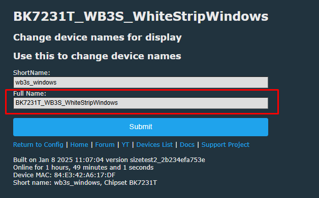

    I think we can easily fix it, we could even allow ourselves to just call obk config API to get device name... full name, that one here:
    Screenshot of device name change form with the full name BK7231T_WB3S_WhiteStripWindows highlighted.
    Just call CFG_GetDeviceName() there, we don't support non-BK APPs anyway, and even if so, we could do a #define check. What do you think, @max4elektroda ?

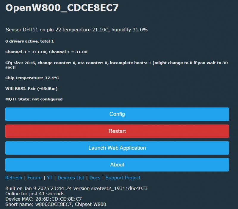

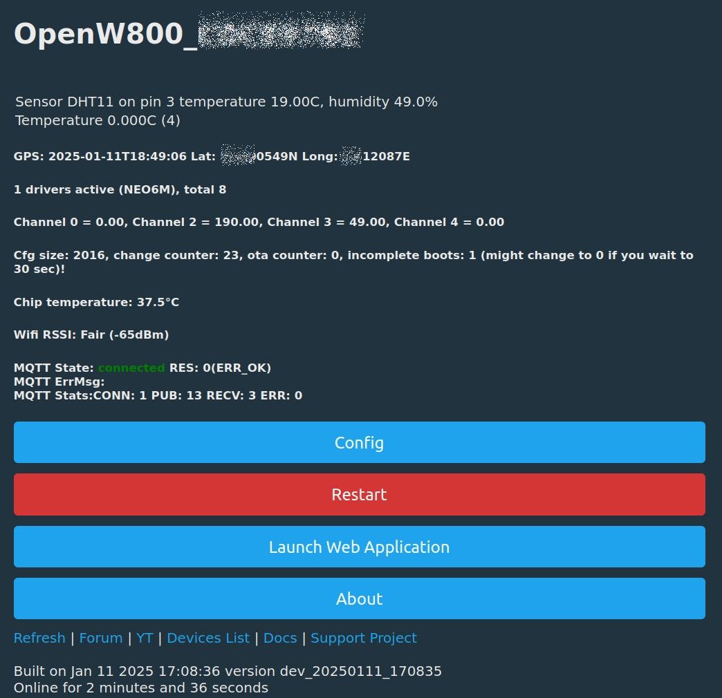

    DHT11 works:
    OpenW800 device web interface displaying DHT11 sensor data.

    Shure, fixing the name should be easily possible in this case.
    I always looked for the strange name when I forgot the DHCP address, but never thought of fixing it...

    apologies, I thought it weird I couldn't find in code search. I was transforming hyphen to underscore in my head. :/

    max4elektroda wrote:
    I'll put it on my to-do list for the weekend
    So it's done - see https://github.com/openshwprojects/OpenBK7231T_App/pull/1508
    I didn't set the hostname in sdk code, but in hal_wifi.
    Reason: in lwip code the config seems not yet read (at least CFG_GetDeviceName() will always return NULL).
    So I went the easy way and (re-)defined the hostname just before connecting in "connect_wifi_demo()".

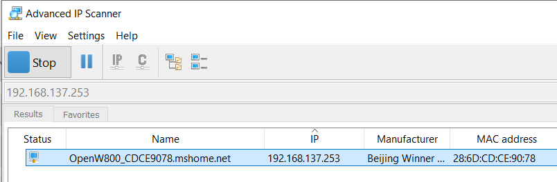

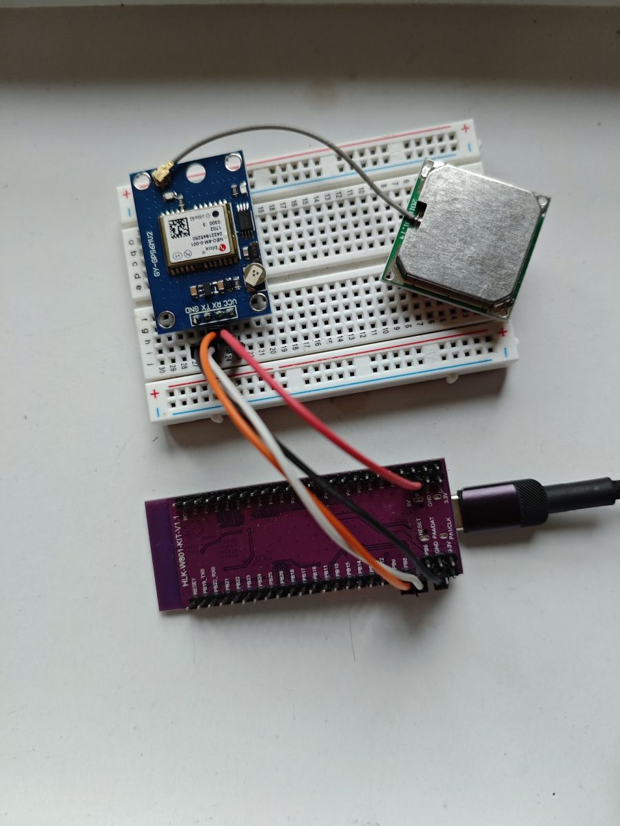

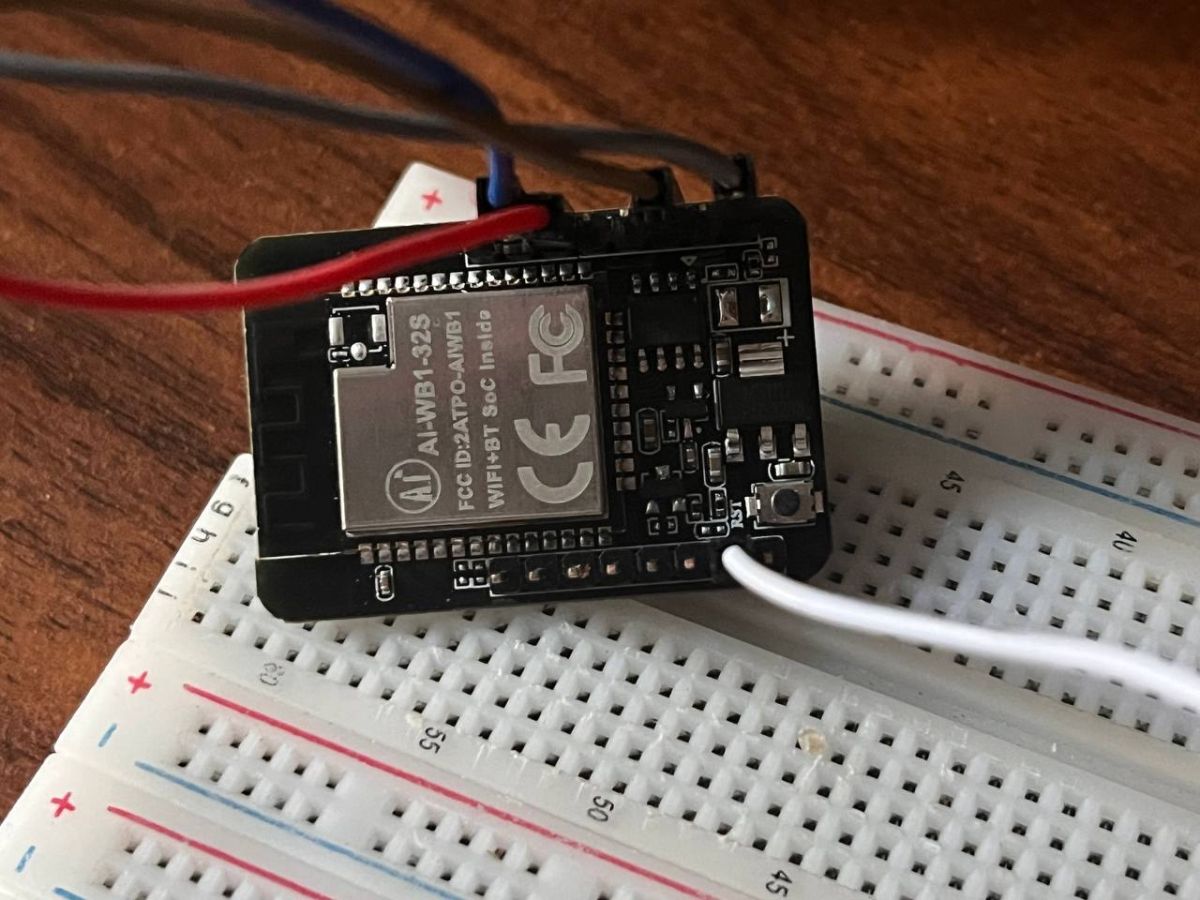

    One additional information / finding:
    Old host name as expected:
    max@max-PC:~$ nmap -sP 192.168.0.0/24 | grep uart
    Nmap scan report for uart-wifi.fritz.box (192.168.0.37)
    max@max-PC:~$
    New firmware:
    max@max-PC:~$ nmap -sP 192.168.0.0/24 | grep 0.37
    Nmap scan report for OpenW800-XXXXXXXX.fritz.box (192.168.0.37)
    max@max-PC:~$
    Please note: The underscore has been changed to a hyphen?!?
    Added after 10 [minutes]:

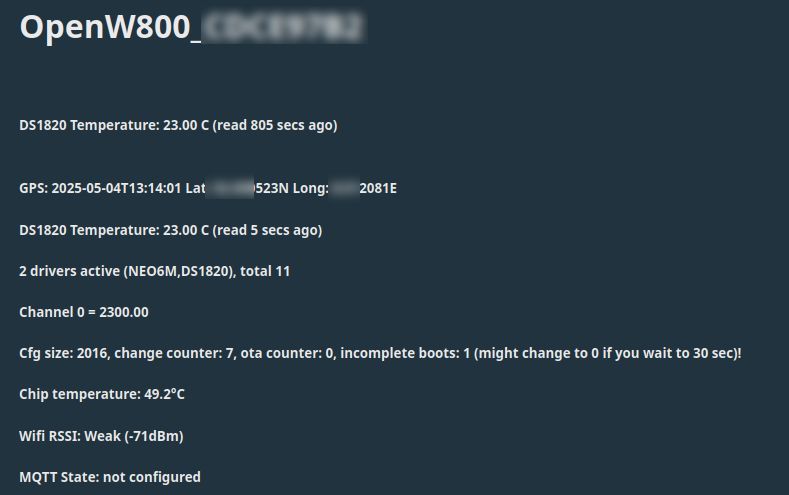

    Maybe @divadiow you finally want to make use of the additional item sent with the W801?
    https://github.com/MaxineMuster/OpenBK7231T_App/tree/W800_NEO-6M
    NEO-6M has to be connected to UART1 (PB7 is W800s RX and PB6 is TX)
    OpenW800 device user interface displaying sensor data and configuration options

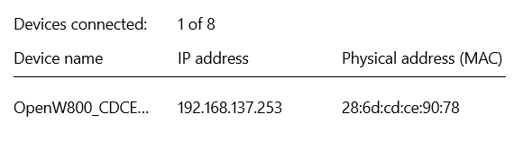

    Information about a device connected to the network.
    Interface of Advanced IP Scanner showing a detected network device.
    sure.

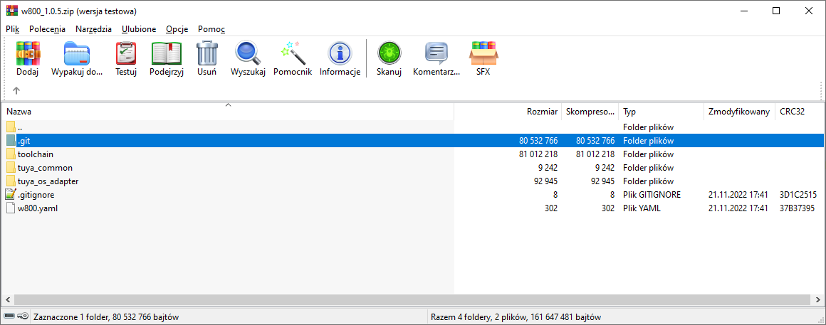

    W800 Tuya kits
  • #42 21527547
    Posts: 14612
    Help: 655
    Rate: 12630

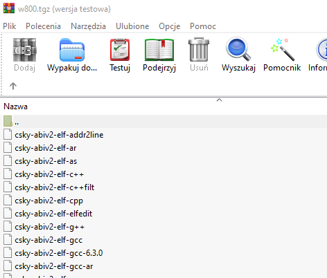

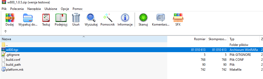

    It's funny that they even included their GIT repository in the zip:
    Screenshot of the 7-Zip program with the w800_1.0.5.zip archive open and a list of files and folders visible.
    Toolchain is a separate archive (csky-abiv2-elf):
    Screenshot of WinRAR with the w800_1.0.5.zip archive open, showing files inside the archive.
    A file decompression program window showing the contents of an archive named w800.tgz.
    And there is only Tuya adapter, I can't see any W800 source code?

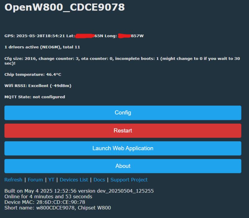

    The RSSI shown looks better, but trying OTA always fails for me (after (long) restart, old version is present...)
    Version is attached, just in case you want to try ...

    GPS module and prototyping board connected to a purple microcontroller board with wires.

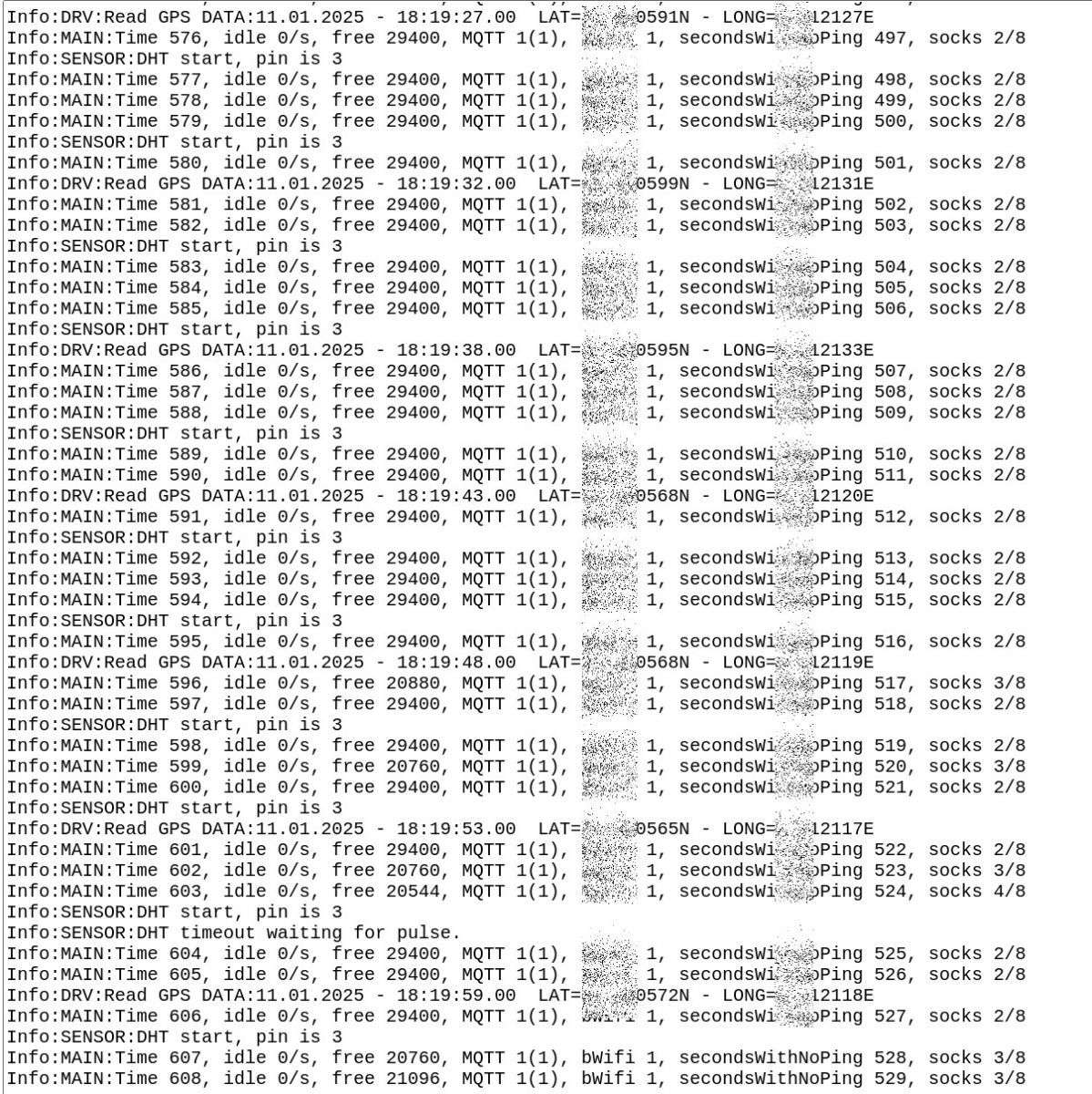

    divadiow wrote:
    Info:DRV:Read GPS DATA:28.05.2025 - 18:51:22.00 (epoch=1748458282) LAT=41.902893N - LONG=12.454444E
    Greetings to the Pope ;-)

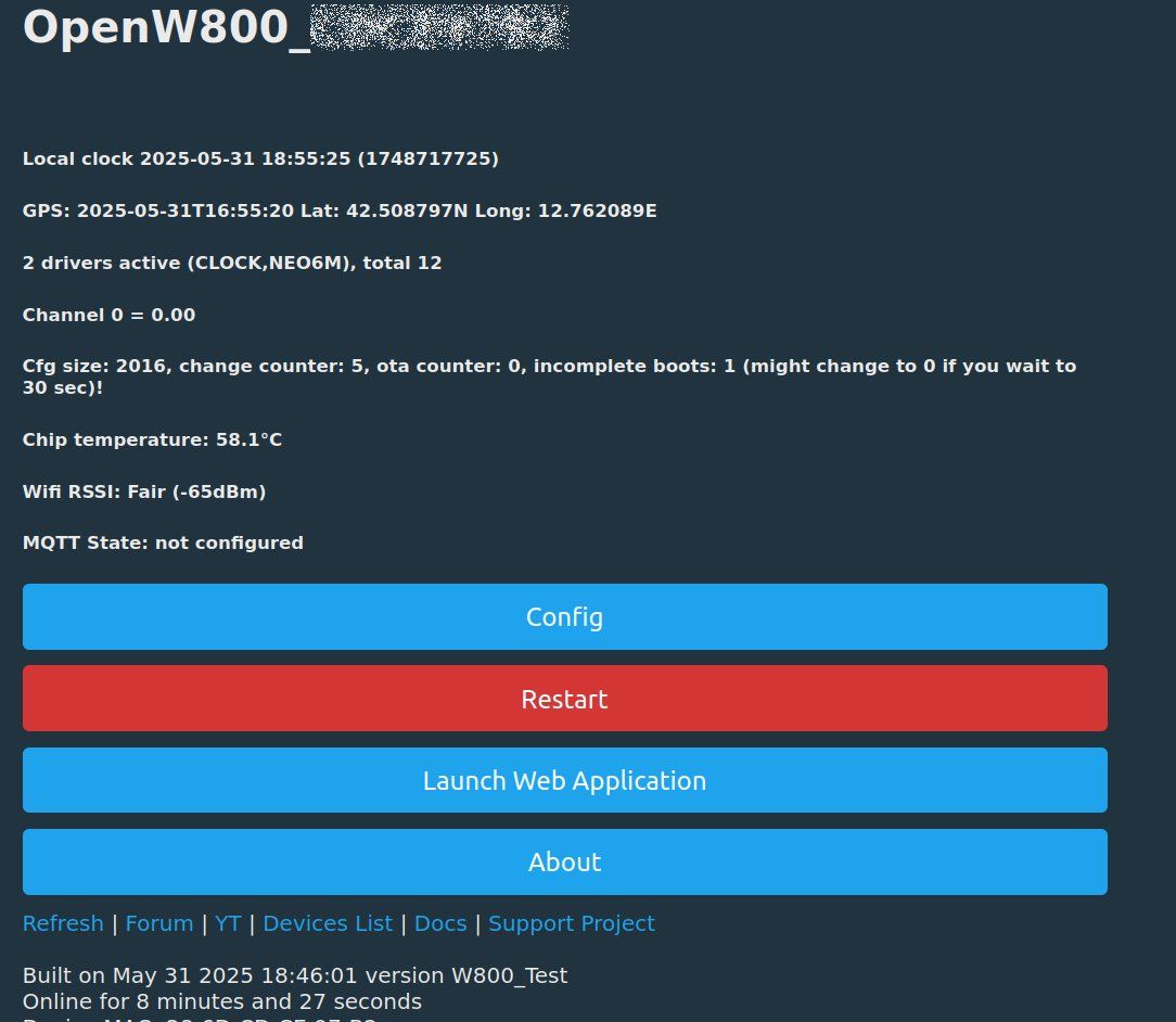

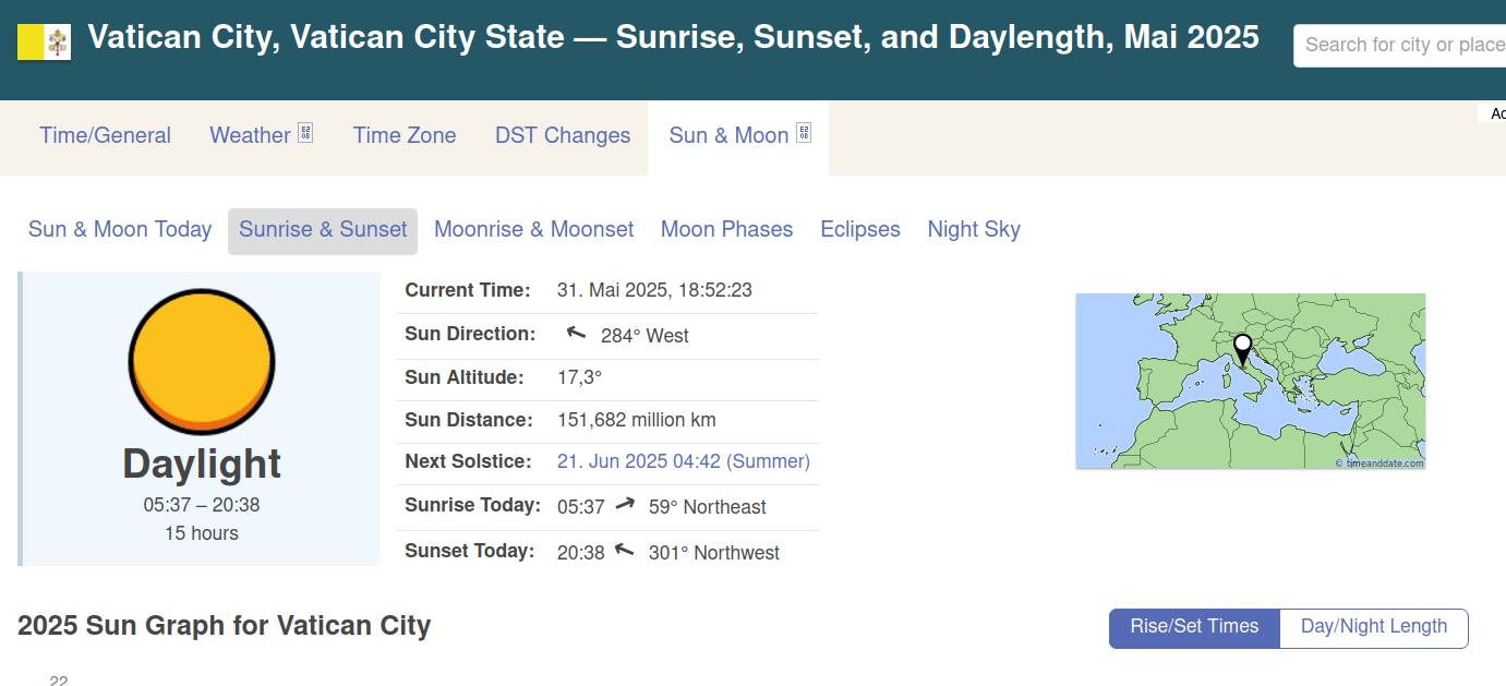

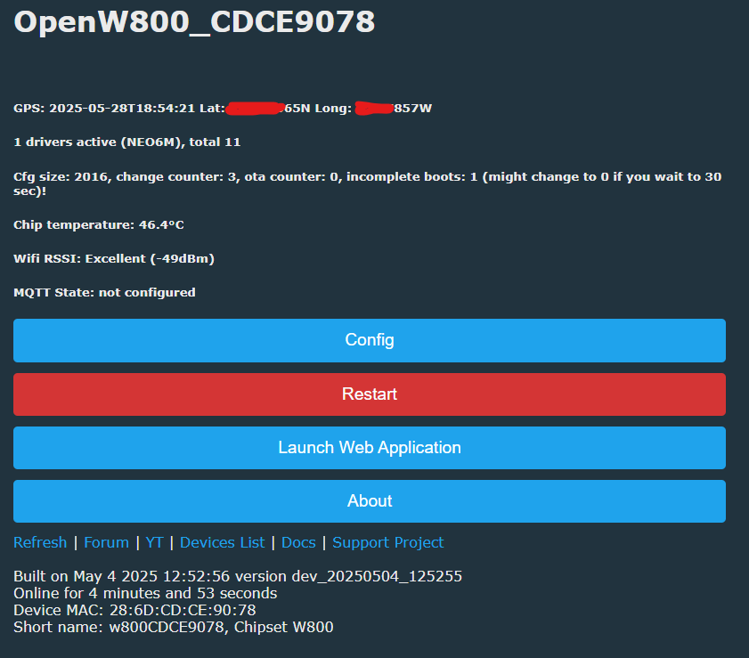

    As long as I use Chrome OTA usually works, so I included the "local clock" and NEO6M driver to @insmod _w800 branch so you might actually use the GPS data:
    The W800 image is build with (aditionally):
    #define ENABLE_CLOCK_DST                  1
    #define ENABLE_CALENDAR_EVENTS            1
    #define ENABLE_CLOCK_SUNRISE_SUNSET       1
    #define ENABLE_DRIVER_NEO6M               1
    If you start the driver with "setclock" and/or "setlatlong" it will set the values accordingly if GPS is locked. For me in Germany it's (with some slight hiding of my home ;-))
    backlog startDriver NEO6M setclock setlatlong fakelat=4190.5  fakelong=01245 ; CLOCK_setDST 0 3 1 2 60 0 10 1 3 0; clock_setTZ 1
    I recently reworked DST settings, so this version will use two "statements" with "CLOCK_setDST" for the two switching times. You can start with begin or end of DST, since the statement will include "how much DST offset after this point".
    Every entry is "nth week" "month" "weekday" "time" "minutes to add"
    In my case it can be "pseudo" read as
    "on/after last (0) Marchs (3) Sunday (1) at 2:00 (2) add 1h / 60 minutes (60 ) and on/after last (0) Octobers (10) Sunday (1) at 3:00 (3) add 0 (= set DST to 0)"
    OpenW800 control panel showing local time, GPS data, active drivers, chip temperature, and WiFi status.
    After this you can use the clock as usual without NTP or any other clock source:
    In summer time - next DST switch at 1761447600 (2025-10-26 03:00:00)
    Info:DRV:Read GPS DATA:31.05.2025 - 16:51:22.00 (epoch=1748710282) LAT=42.508869N - LONG=12.762115E  (clock and lat/long set to GPS data)
    Info:DRV:Read GPS DATA:31.05.2025 - 16:51:27.00 (epoch=1748710287) LAT=42.508862N - LONG=12.762107E  (clock and lat/long set to GPS data)
    Info:DRV:Read GPS DATA:31.05.2025 - 16:51:32.00 (epoch=1748710292) LAT=42.508854N - LONG=12.762103E  (clock and lat/long set to GPS data)
    Info:DRV:Read GPS DATA:31.05.2025 - 16:51:38.00 (epoch=1748710298) LAT=42.508877N - LONG=12.762115E  (clock and lat/long set to GPS data)
    Info:NTP:CLOCK sunrise is at 05:33
    Info:NTP:CLOCK sunset is at 20:38
    Info:CMD:19980 74280
    Info:CMD:[WebApp Cmd 'echo $sunrise $sunset' Result] OK
    Info:DRV:Read GPS DATA:31.05.2025 - 16:51:43.00 (epoch=1748710303) LAT=42.508911N - LONG=12.762124E  (clock and lat/long set to GPS data)
    Seems o.k ;-)

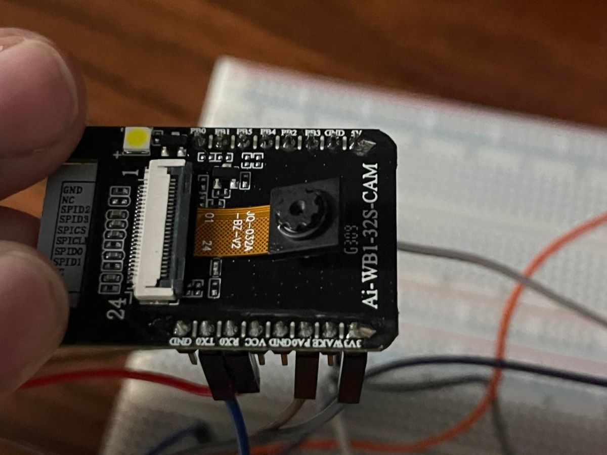

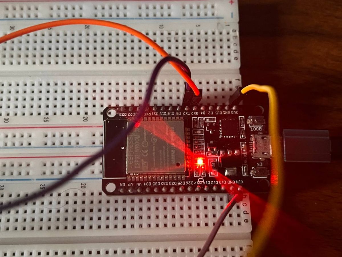

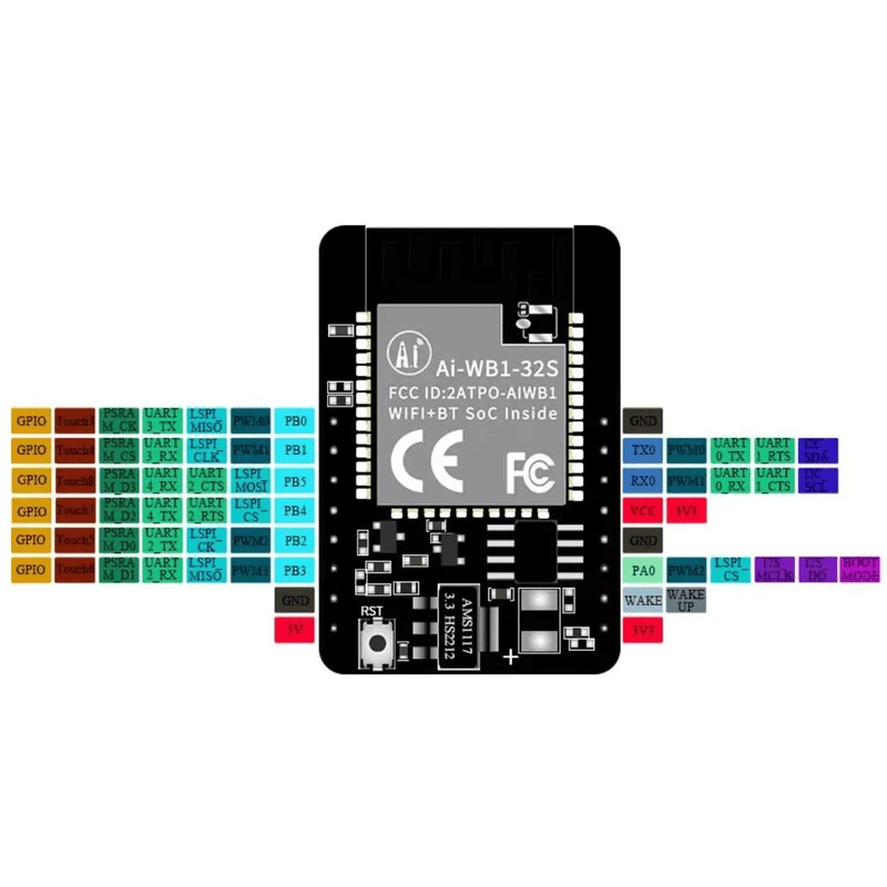

    shehab2003magdy
    Hi I am trying to setup a chip that also works on W800 which is Ai-WB1-32S, (it's very similar to ESP32-CAM) but unfortunately the setup is nightmare. I followed multiple Chinese tutorials and installed multiple IDEs, But i always get stuck in the same error:
    C:\Users\sheha\Downloads\wm_sdk_w800-main\wm_sdk_w800-main\tools\w800>wm_tool.exe -c COM3 -dl C:\Users\sheha\Downloads\wm_sdk_w800-main\wm_sdk_w800-main\bin\w800\w800.fls
    connecting serial...
    serial connected.
    wait serial sync.........
    please manually reset the device.
    serial sync timeout.
    I tried Everything, I tried pressing and releasing the RST button
    I tried setting the PA0 (BOOT pin) into ground and pressing the RST and then disconnect the PA0 from GND
    Connections:
    3.3V (ESP32) → 3.3V (Ai-WB1-32S)
    GND (ESP32) → GND (Ai-WB1-32S)
    TX2 (ESP32) → RX0 (Ai-WB1-32S)
    RX2 (ESP32) → TX0 (Ai-WB1-32S)
    GND (Ai-WB1-32S) → AP0 (Ai-WB1-32S)
    I am using ESP32 DivKit as USB-to-serial passthrough programmer,

    max4elektroda
    Posts: 754
    Help: 48
    Rate: 187
    Are you sure your "ESP-UART" works as expected?
    If you're following the guide I read, they used the UART on dev board directly by setting EN on this board to GND:
    https://esphome.io/guides/devboard_as_flasher/
    Then you need to connect the pins 1:1, RX to RX and TX to TX. (At least I couldn't see the EN set to GND on the image, so you might have another setup, but might try it in this case).
  • #56 21700246
    shehab2003magdy
    >>21699877
    I tried your method 1:1 connection and EN to GND, but i had the same problem in making the chip enter the flashing mode.
    I also tried this: "Now you have to reboot the device - either via the RESET signal or by cutting and connecting the power supply."
    by pressing the RST button once and by removing jumpers connecting 3v3 and by removing PA0 (Boot pin) from GND
    Error:
    serial connected.
    I can't find any tutorial on this exact chip (Ai-WB1-32S)
