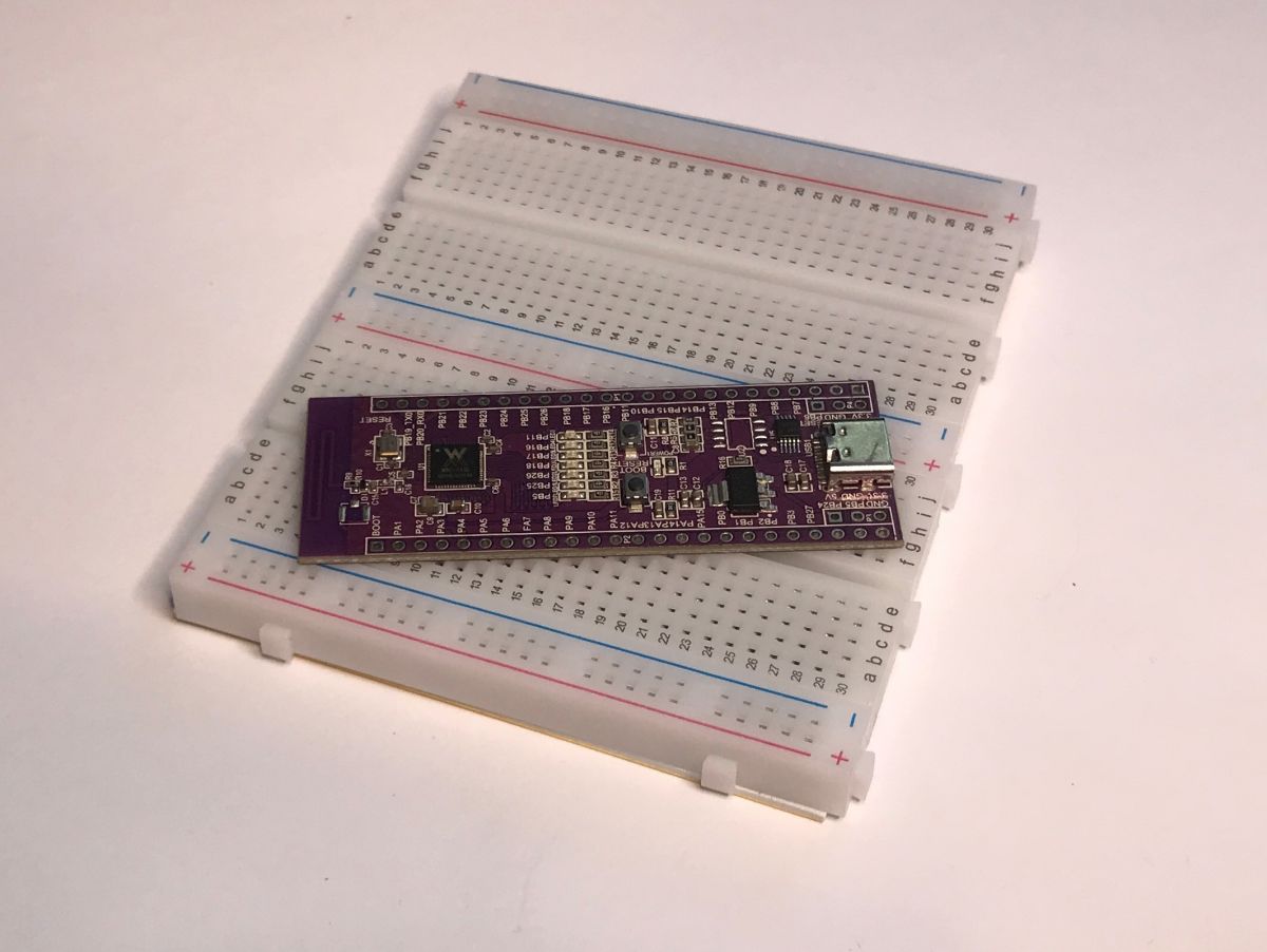

  • HLK-W801-KIT-V1.1 development board on a breadboard with two sensors.

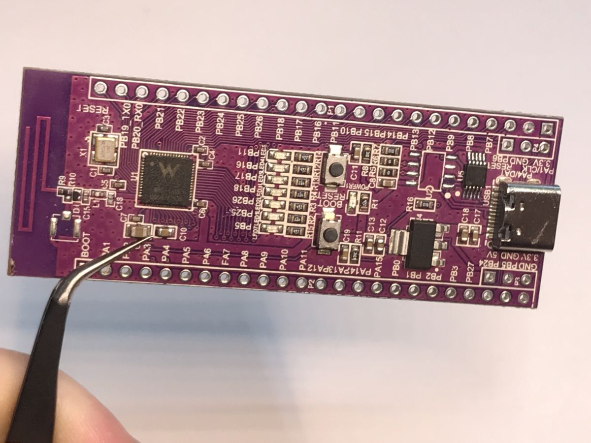

    The HLK-W801-KIT-V1.1 is a development board powered by the 32-bit, 240MHz WinnerMicro W801-C400 SoC. It includes 2MB of on-board Flash and 288KB of RAM, making it ideal for various IoT applications. The board can easily integrate with Home Assistant using the provided firmware.
    In this guide, I’ll introduce two tools for flashing firmware onto these boards and demonstrate how to use W800/W801 with various sensors supported by my project. This process is also applicable for flashing IoT devices with W800/W801 chips, but if you’re interested in the development board, it’s available for as little as $2:
    W801 development board with dimensions 70mm x 26mm, priced at $1.65 with a 25% discount.
    HLK-W801-KIT-V1.1 development board on a breadboard.
    HLK-W801-KIT-V1.1 development board held by a person using tweezers.
    Close-up of the HLK-W801-KIT-V1.1 development board with a WinnerMicro W801 chip.

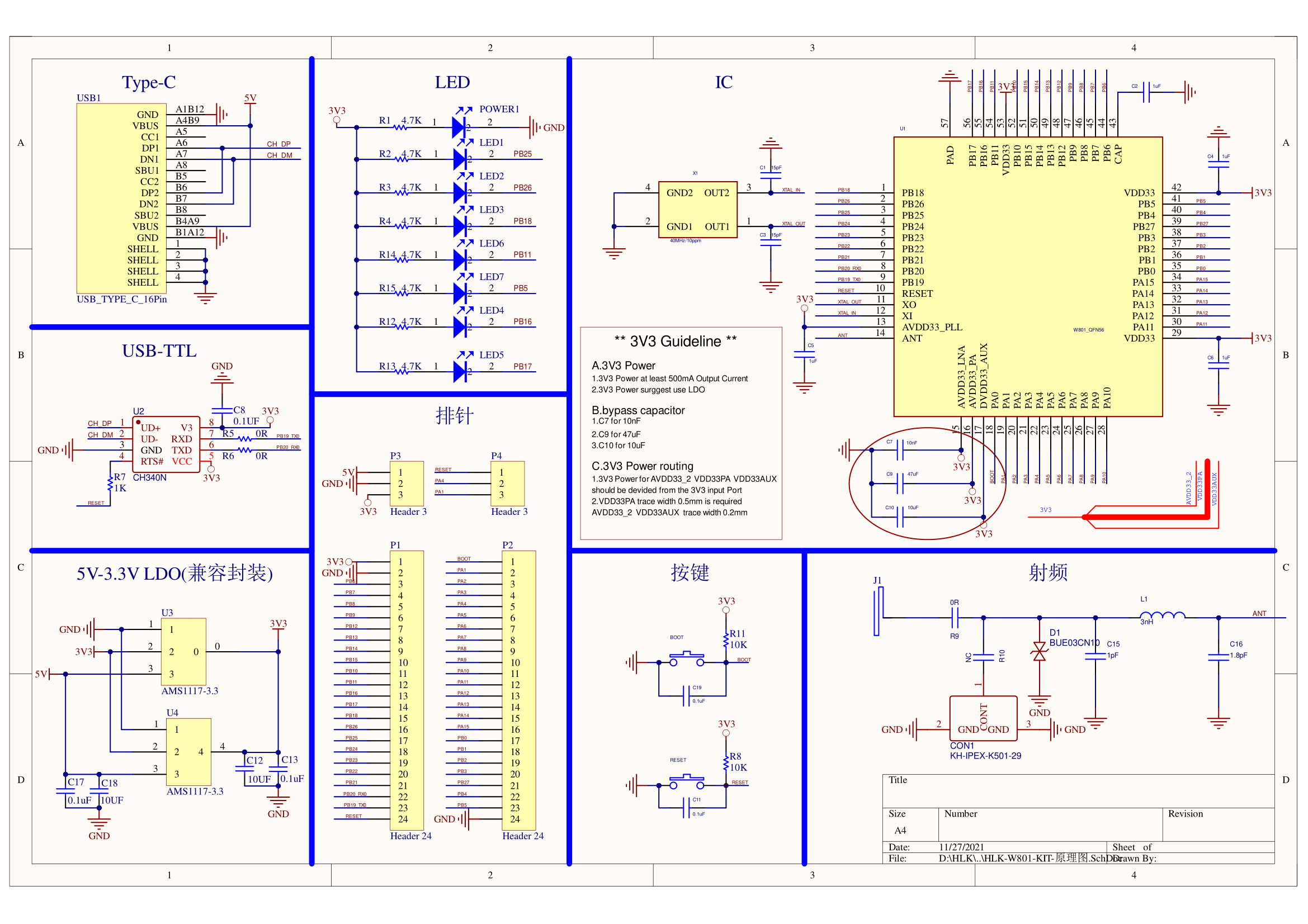

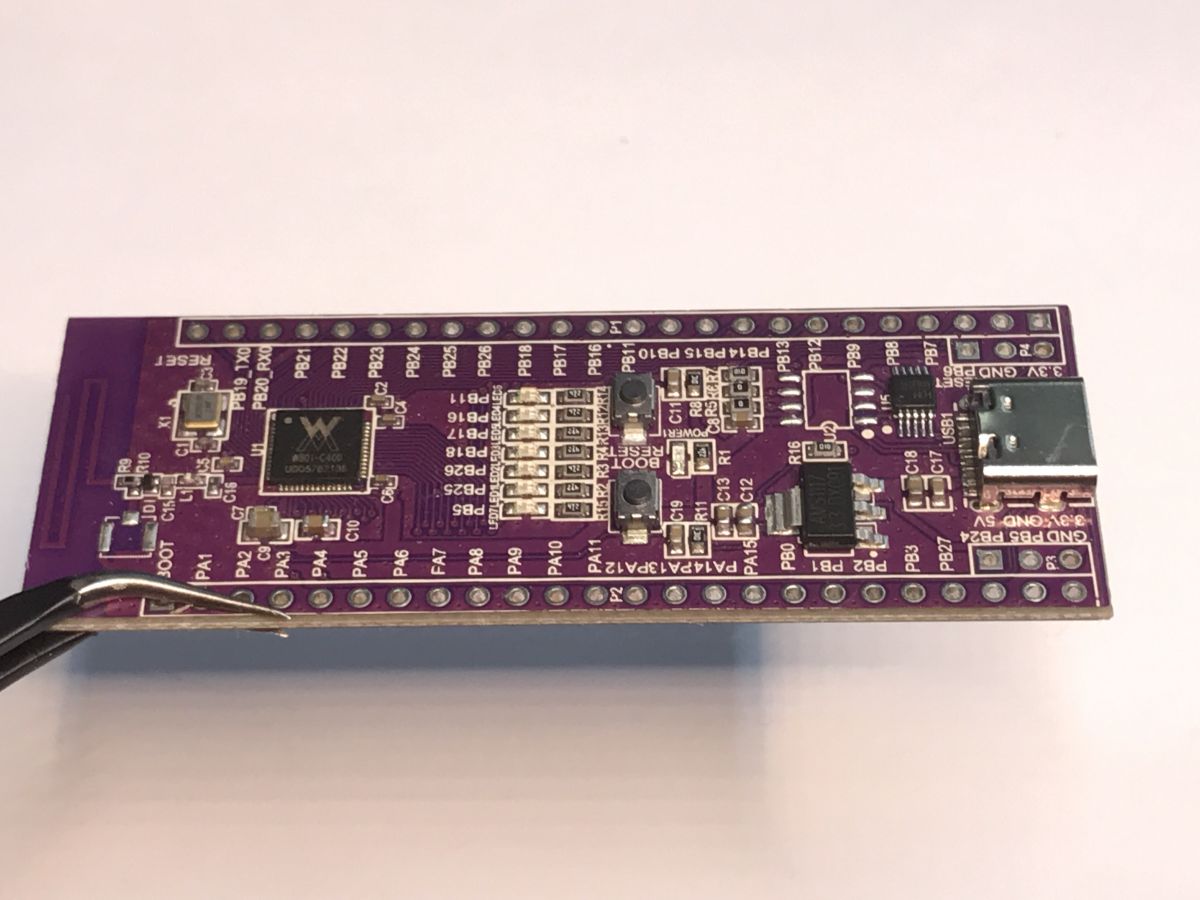

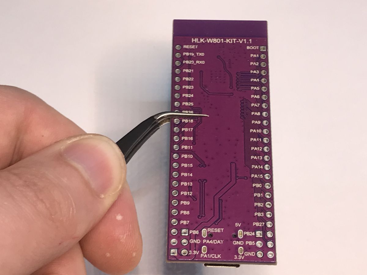

    Understanding HLK-W801-KIT-V1.1 board
    Let's consider HLK-W801-KIT-V1 board schematic:
    Circuit diagram of the HLK-W801-KIT-V1.1 development board featuring the W801-C400 chip.

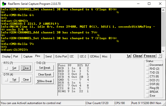

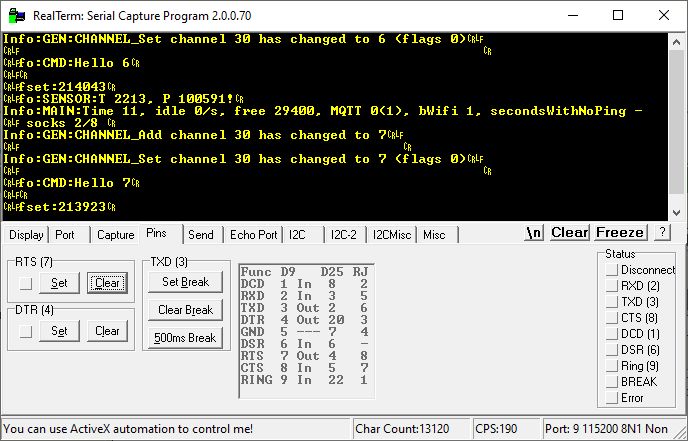

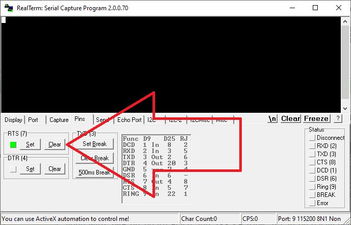

    HLK-W801-KIT-V1.1 features CH340N USB to UART controller which is used for both UART communication and board resetting - communication is done through UART 1 port, PB19 TXD and PB20 RXD, and reset is done via CH340N RTS pin, which can be easily controlled from many applications, for example from Realterm:
    Screenshot of RealTerm program showing RTS and DTR settings.
    This can be used to reset board for flashing without having to physically press the button, but it can be also misleading, because your firmware will not boot as long RST is set. It has to be cleared for firmware to boot:
    Screenshot of RealTerm program with an open serial port logging window.

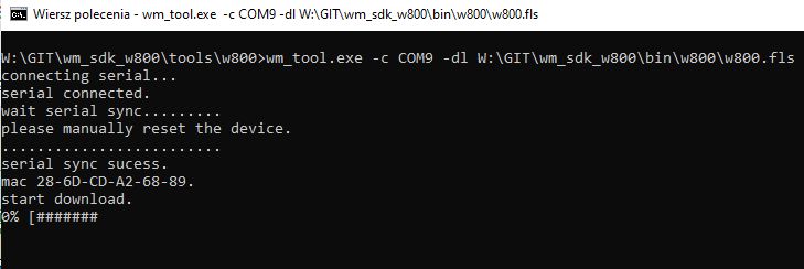

    Flashing with wm_tool.exe
    First tool, the command line-only utility, was already presented here.

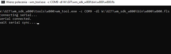

    Uploading firmware via wm_tool.exe is very simple, you just need to specify the COM port, source file, and reset while needed:
     wm_tool.exe -c COM9 -dl W:\GIT\wm_sdk_w800\bin\w800\w800.fls
    So we execute this command and get:
    Command prompt showing the process of loading a file using wm_tool.exe.
    Now you have to reboot the device - either via the RESET button or RTS UART signal on HLK-W801-KIT-V1.1.
    Command line screenshot showing the firmware upload process for the W800-C400 microcontroller.
    There is no need to worry about the 0% progress visible for the entire programming time, the program just does not refresh this counter.
    Once flashed, do reset again so firmware can start.

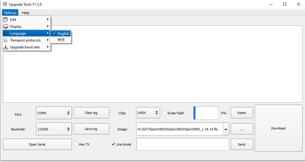

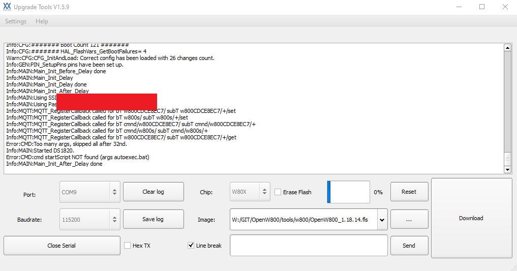

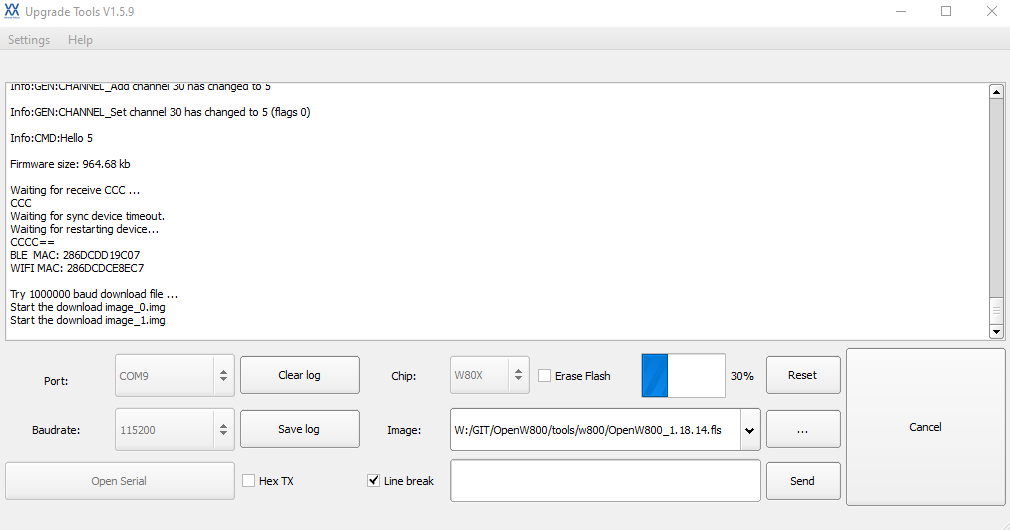

    Flashing with UpgradeTools
    Second method is the GUI approach. The tool is in Chinese by default, but it can be changed to English:
    Screenshot of Upgrade Tools application version 1.5.9, set to English language.
    Then you need to select the source firmware file (FLS file), target UART port, chip type (W80X or W60X), and click "Open Serial Port". Then press "Download". This is how it looks like during flashing:
    Upgrade Tools V1.5.9 interface with open firmware flashing log on a W80X board.
    Once it flashes, you should see your firmware UART output in the same log window as the flashing log:
    Screenshot of the Upgrade Tools V1.5.9 interface showing a firmware flashing log.
    You can use "RESET" button to reboot your board remotely, but flashing procedure should do this automatically.
    Get UpgradeTools here: https://github.com/openshwprojects/FlashTools/tree/main/WinnerMicro

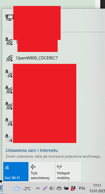

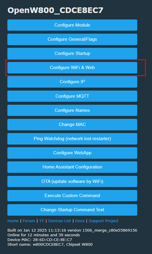

    You can also flash W800/W801 with OpenBeken firmware, get FLS file here:

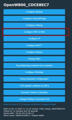

    Download it from Releases tab. Once you flash it and reset, the open access point should appear:
    List of available Wi-Fi networks on a computer with the selected network OpenW800_CDCE8EC7
    Connect to it and navigate to page 192.168.4.1, then open Config, and Configure WiFi:
    User interface of OpenW800 with WiFi and Web configuration option highlighted.

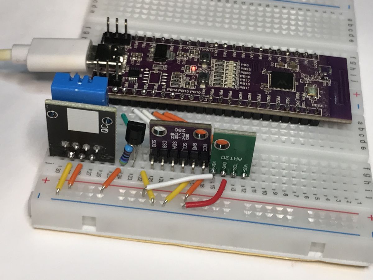

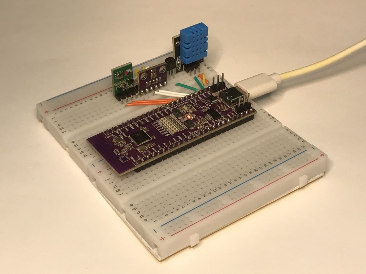

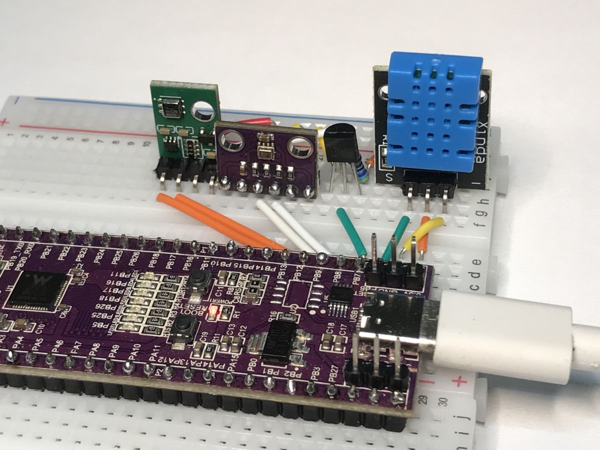

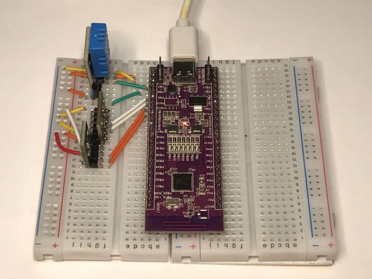

    I've prepared a simple OpenBeken demo featuring multiple sensors and drivers on the HLK-W801-KIT-V1.1 board. My setup features:
    - DHT11 for temperature and humidity measurements,
    - AHT20 for enhanced temperature and humidity readings,
    - BMP280 for barometric pressure and temperature,
    - DS18B20 for precise one-wire temperature monitoring,
    - and last but not least, OpenWeatherMap integration for real-time weather information fetched from the web.
    This setup showcases the flexibility of OpenBeken, supporting various sensors simultaneously and allowing seamless integration of OBK scripting engine and Home Assistant Discovery.

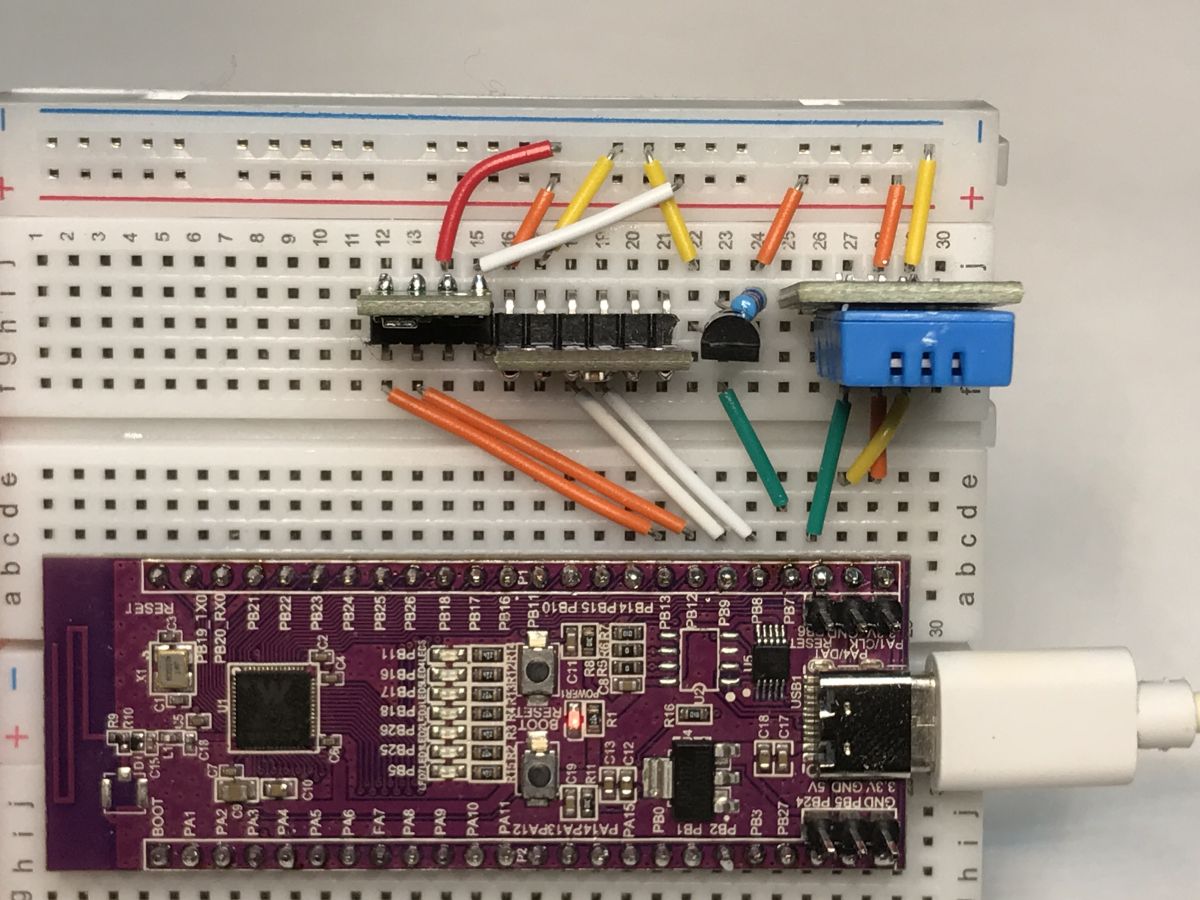

    The hardware setup is fairly simple, the only thing worth noting is the presence of 4.7k pull up resistor next to DS18B20:
    HLK-W801-KIT-V1.1 development board with connected sensors on a breadboard.
    HLK-W801-KIT-V1.1 development board with sensors connected on a breadboard.
    HLK-W801-KIT-V1.1 development board with sensors on a prototyping board

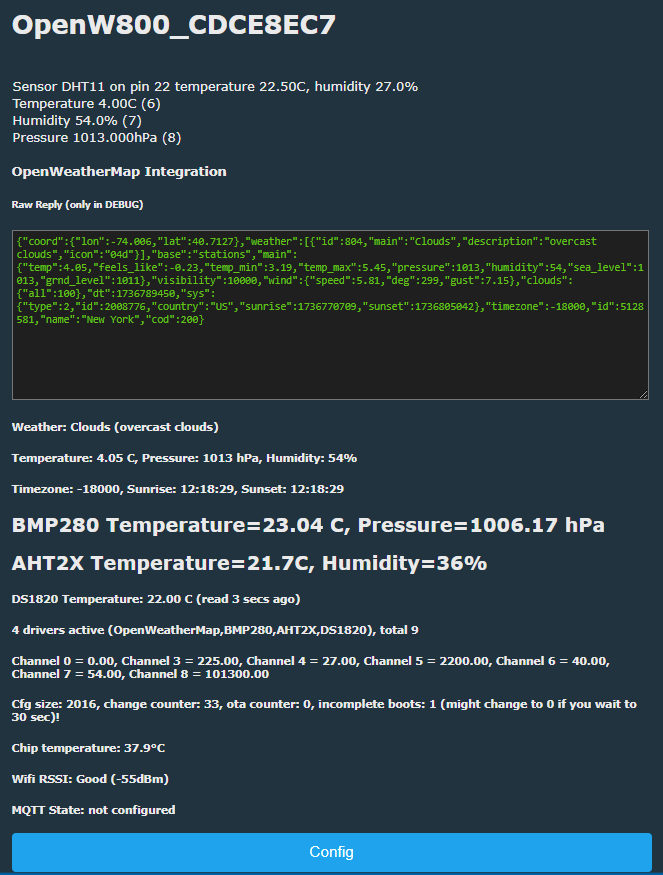

    All revelant information is shown on main OBK page:
    OpenW800 interface displaying sensor data and weather integration.

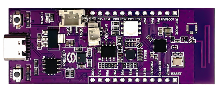

  • HLK-W800-KIT image and CHT8305C pin mapping
    #3 21919043
    Posts: 5195
    Help: 446
    Rate: 913
    I couldn't see an HLK-W800-KIT image on Elektroda for use in device template. So here's one
    Purple PCB with USB‑C port, buttons, labeled pins, and SPK and MIC connectors
    I'd forgotten this version comes with a CHT8305C Sensylink temperature/humidity sensor

How do I use UpgradeTools in English to flash a W801 FLS file and monitor the UART log afterward?
Switch UpgradeTools to English, select the .fls file and UART target, then start the serial port and download. 1. Change the interface language from Chinese to English. 2. Choose the firmware file, the correct COM port, and the chip family, such as W80X. 3. Click Open Serial Port, then Download. After flashing, the same log window shows normal UART output from the firmware. The thread notes flashing should reset the board automatically, though a manual RESET button is also available. [#21391305]
Why does wm_tool.exe show 0% progress during programming even though the W801 flash process is still running?
It shows 0% because the utility does not refresh that counter during programming. The thread states there is no need to worry if 0% remains visible for the entire flash session. That is a display limitation, not a write failure. You should judge completion by the tool’s behavior and by resetting the board afterward to confirm the firmware starts. This is a known cosmetic issue in the described workflow. [#21391305]
How do I connect to the OpenBeken access point on a newly flashed W801 board and configure Wi-Fi at 192.168.4.1?
After flashing and resetting, join the board’s open access point and configure Wi-Fi at 192.168.4.1. OpenBeken/OpenW800 starts an AP immediately after first boot in the shown setup. Connect to that AP from a phone or PC, browse to 192.168.4.1, open Config, and use Configure WiFi. Once the board joins your network, it can expose sensors and Discovery data to Home Assistant. That is the first-run onboarding path shown in the guide. [#21391305]
What sensors from the demo setup are supported on the HLK-W801-KIT-V1.1, and how are DHT11, AHT20, BMP280, and DS18B20 assigned to pins or channels?
The demo supports DHT11, AHT20, BMP280, DS18B20, and OpenWeatherMap data on one HLK-W801-KIT-V1.1 board. The script starts DS1820 on a pin defined in Configure Module. It starts BMP280 on PB9 and PB8, storing data in channels 9, 10, and 11, with I2C address 236. It starts AHT2X on PB12 and PB13, using channels 11 and 12. The DS18B20 hardware also needs a 4.7k pull-up resistor. DHT11 appears in the hardware list, but the shown script excerpt does not assign its pin. [#21391305]
