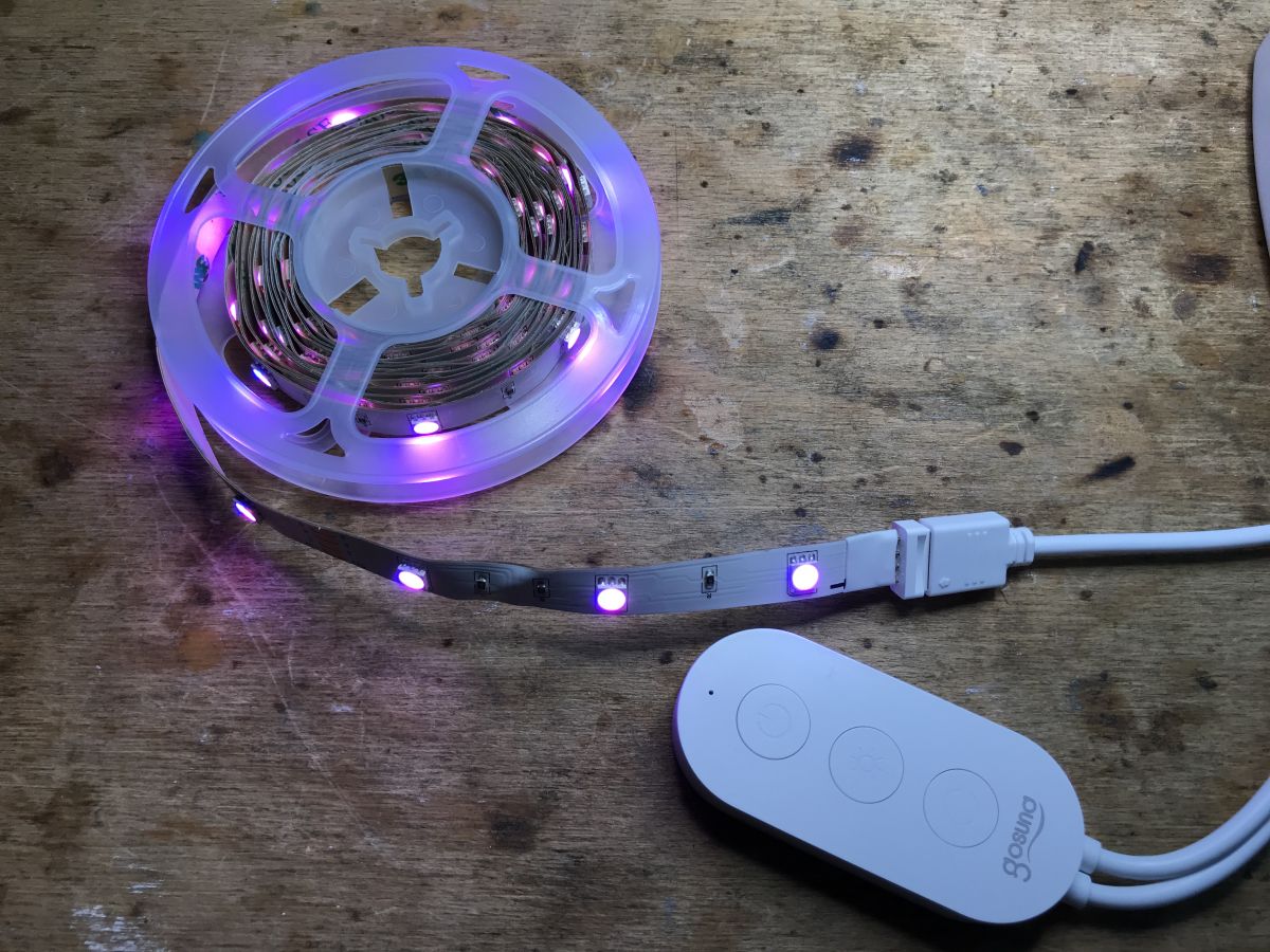

    Today I'm going to show here another colour LED strip that works with the Tuya app. This LED strip stands out because it has up to three buttons on the controller housing. This allows us to change its colours, brightness and animation without reaching for the phone. This is a big plus! Some of the LED strip controllers I reviewed did not have buttons on the casing at all, which condemned us to the phone. Such a thing, on the other hand, I found inconvenient. But perhaps I have too much of an 'old school' attitude.
    This strip comes under the model name Gosund SL1-B and is powered by USB. This is also a plus. It can be plugged into, for example, a USB socket from the TV, as long as it has sufficient current capacity. Previously reviewed strips were powered from 12V.

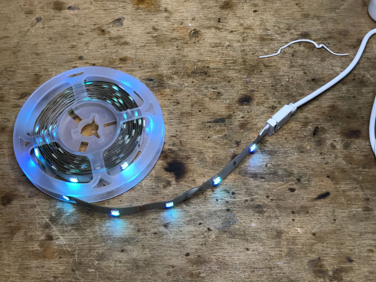

    Belt can only light one colour at a time!
    The strip is characterised as such under the TV:

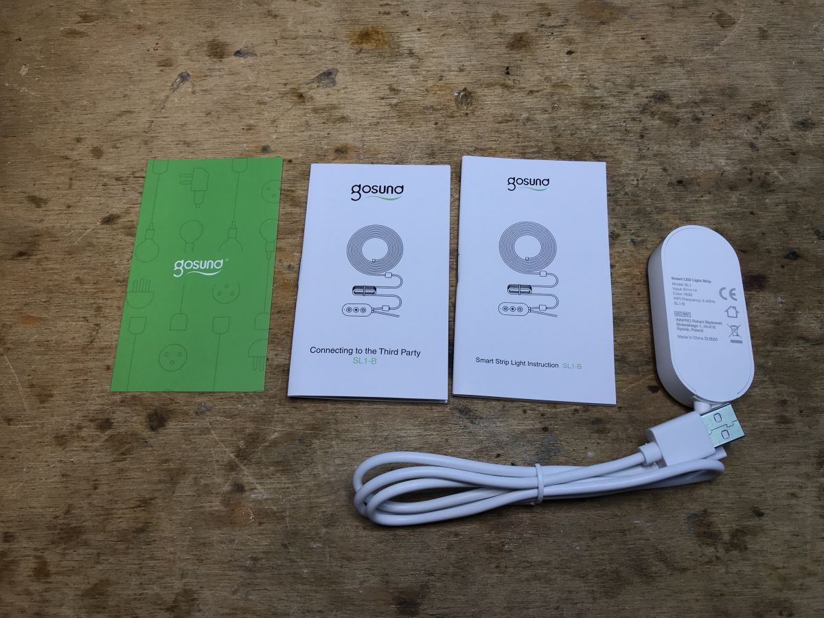

    Kit contents:
    Gosund Smart Led Strip - RGB - 5V LED strip with three buttons .
    Strap, instructions:
    Gosund Smart Led Strip - RGB - 5V LED strip with three buttons Gosund Smart Led Strip - RGB - 5V LED strip with three buttons Gosund Smart Led Strip - RGB - 5V LED strip with three buttons .
    Instructions. To enable pairing, hold power 8 seconds.
    Gosund Smart Led Strip - RGB - 5V LED strip with three buttons Gosund Smart Led Strip - RGB - 5V LED strip with three buttons Gosund Smart Led Strip - RGB - 5V LED strip with three buttons Gosund Smart Led Strip - RGB - 5V LED strip with three buttons Gosund Smart Led Strip - RGB - 5V LED strip with three buttons .
    Effect:

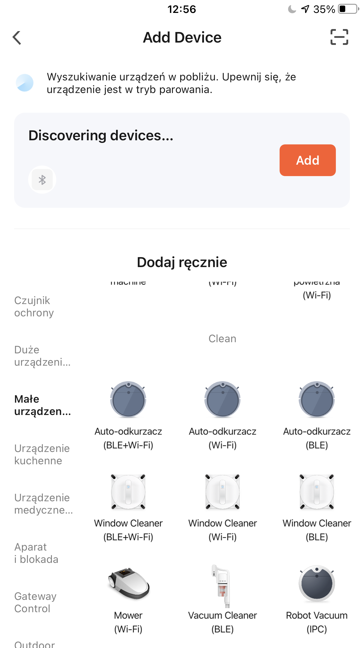

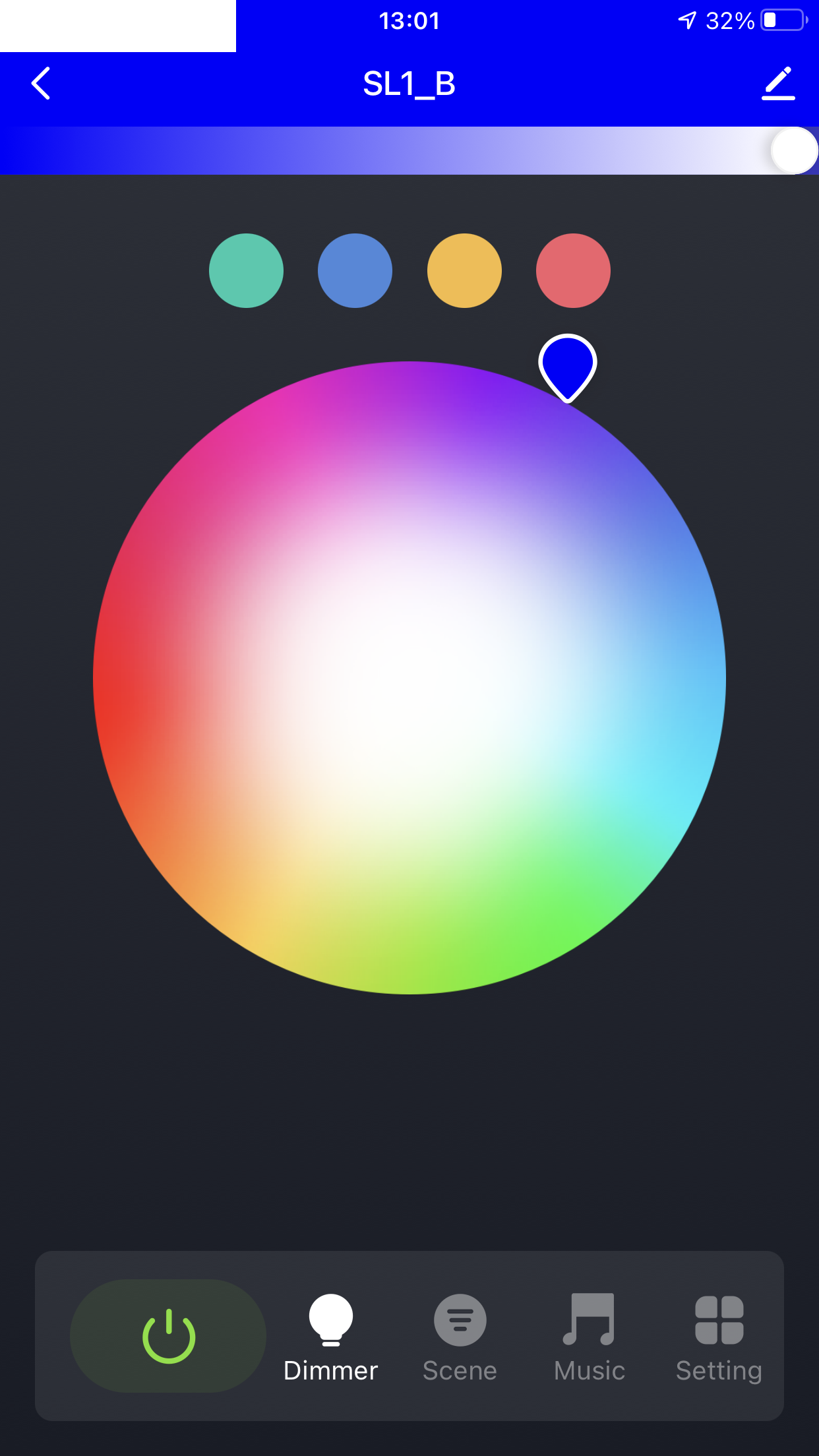

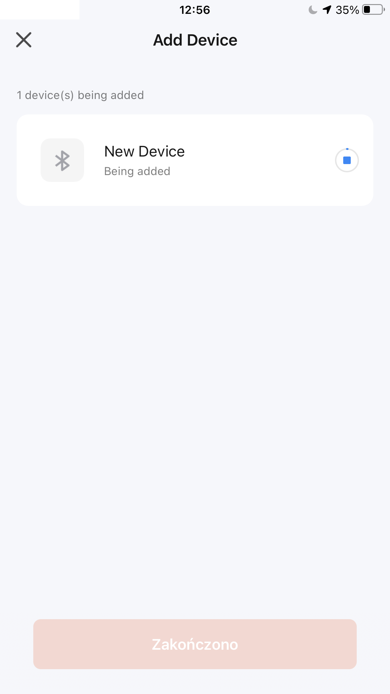

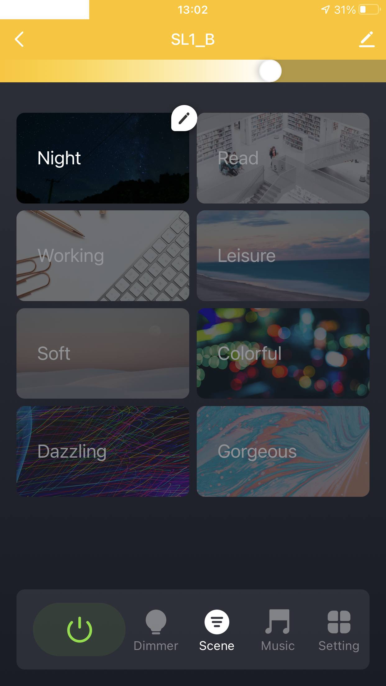

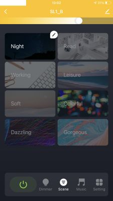

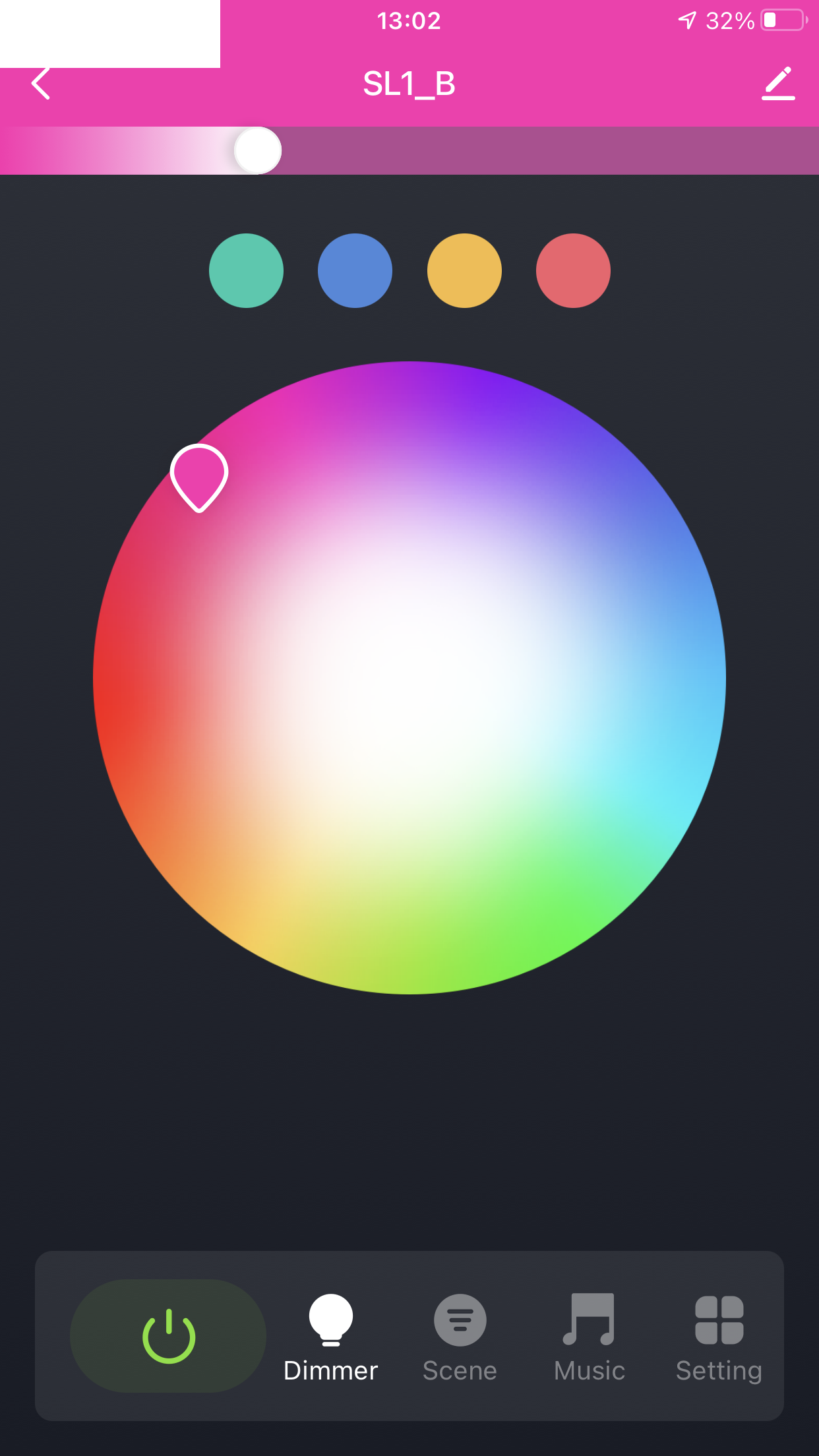

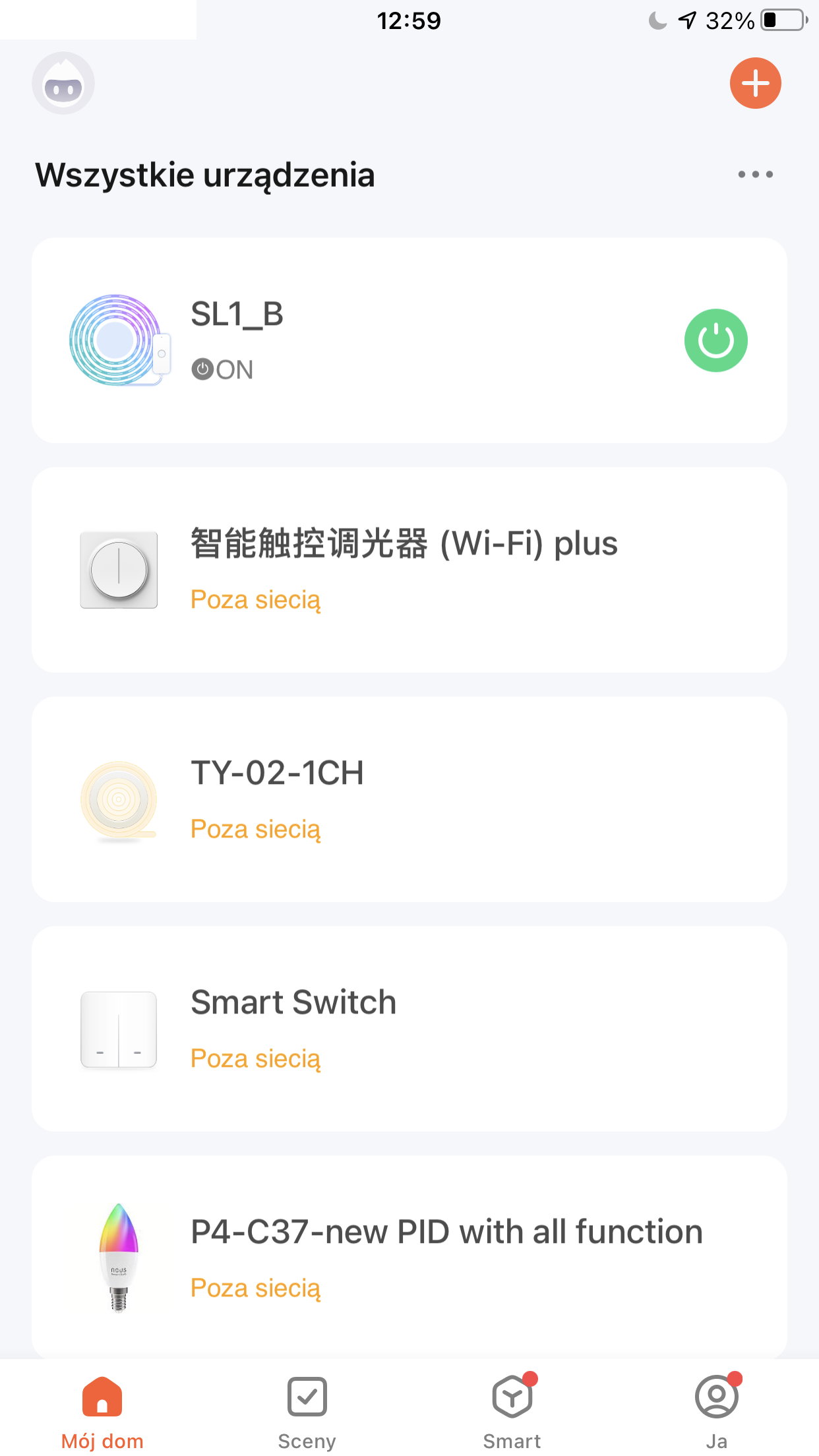

    Test with Tuya app .
    As usual - just a short test. The belt brand is Gosund, but you can pair it with Tuya. Zero problems.

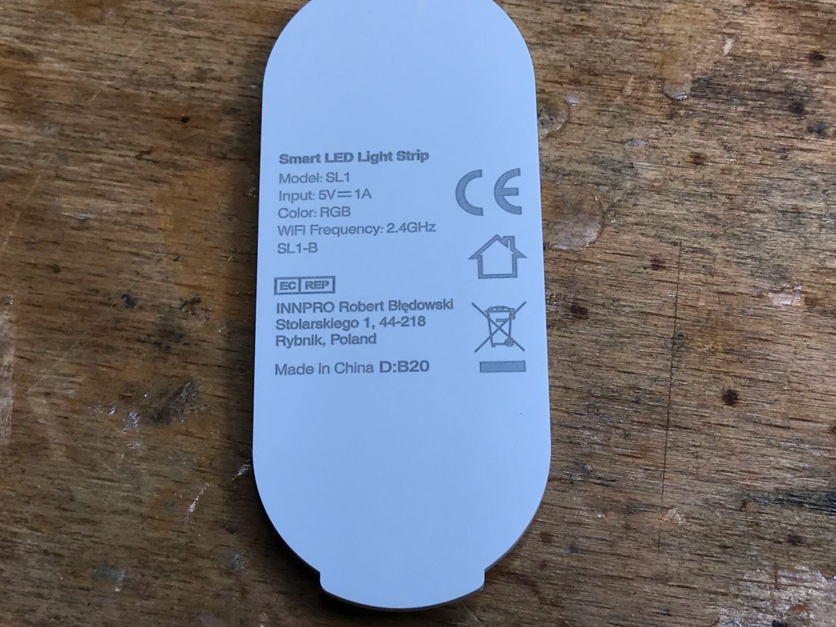

    Bar marking on the housing:

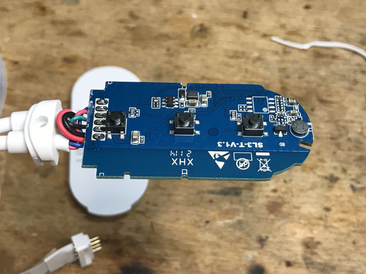

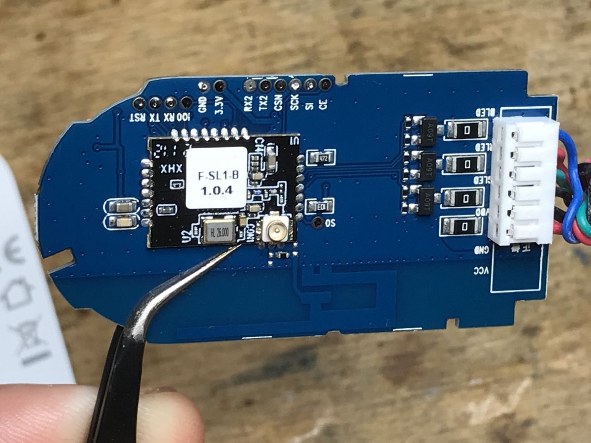

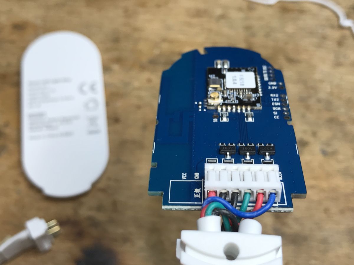

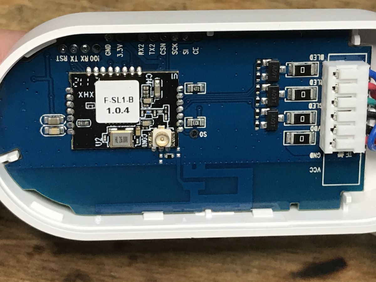

    Interior of controller .
    The housing simply needs to be levered up. Zero screws.

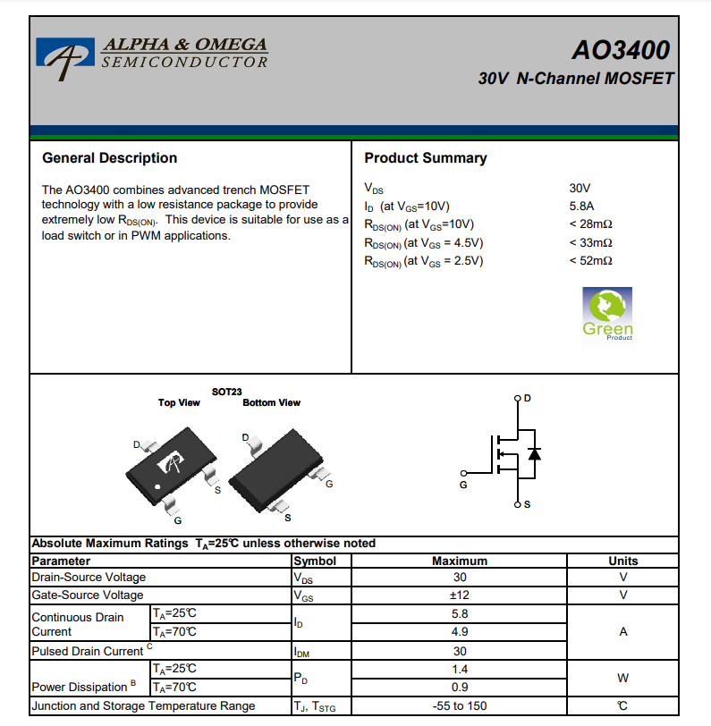

    What is the WiFi module? We'll see in a moment. There are also three A09T transistors, one per channel.
    A09T is an AO3400. N Channel MOSFET:

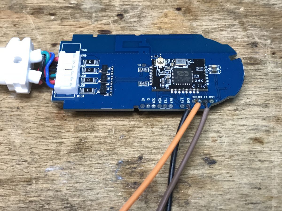

    Apparently IO0 is the pin for ESP, but TX2 and RX2 suggest Beken (BK7231 has separately UART 1 for programming and UART 2 with log output - printf).

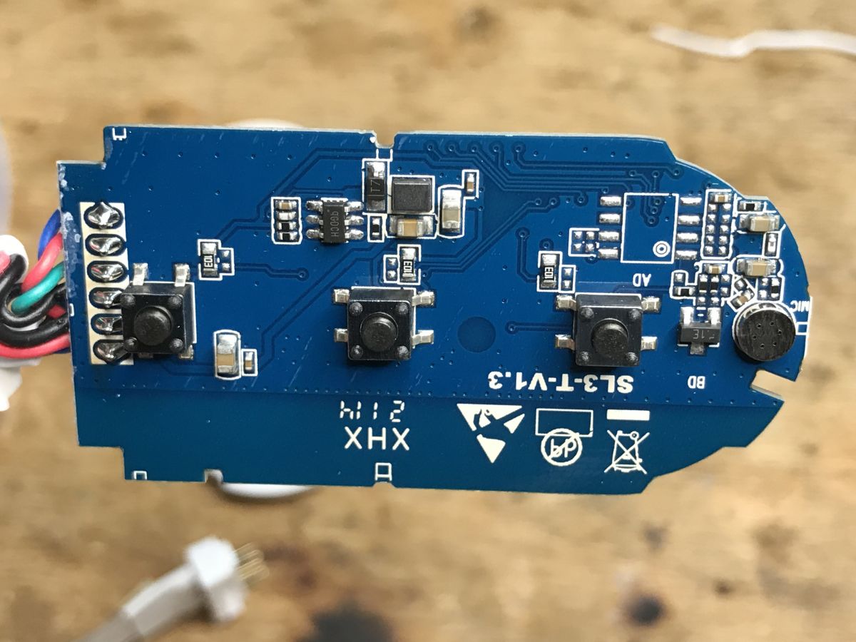

    On the bottom is a step down inverter giving 3.3V, a qGDCH (unless it's an LDO? Seemingly at 5V it would make sense... at 12V less so), and a microphone along with a small transistor, probably some amplification. There's also room for a chip in SOIC8 - could it be that another version of this strip supports RF?

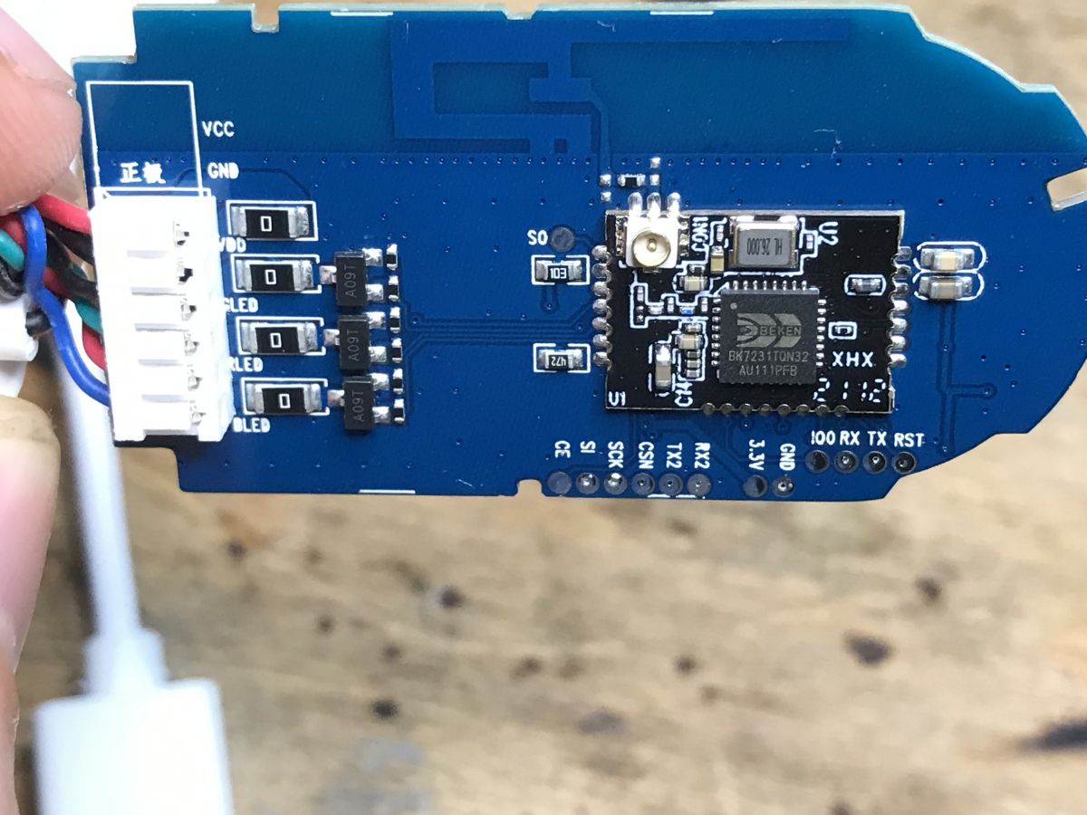

    Removing the sticker:
    BK7231T! OpenBeken can be uploaded.
    Change batch Change batch.

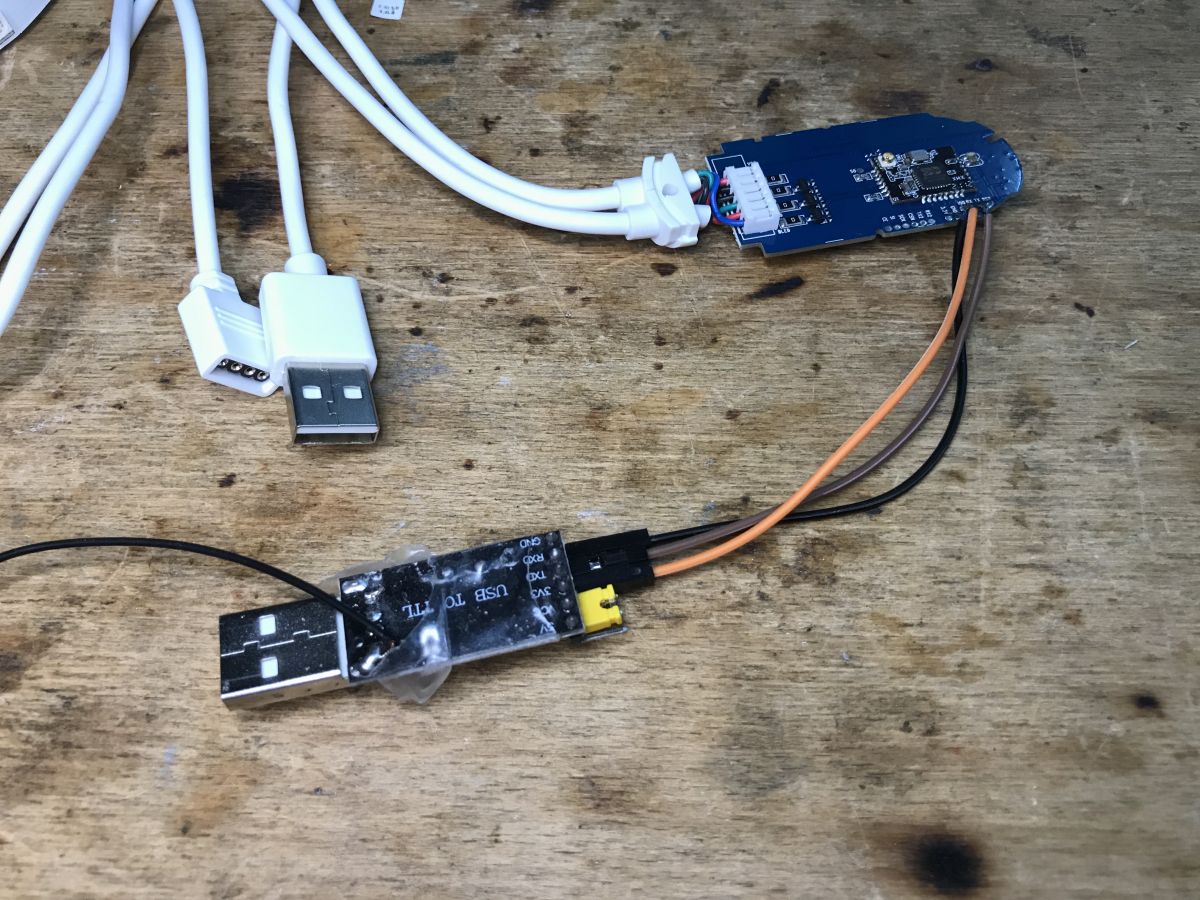

    Standard - we only solder RX and TX and ground. We don't even need the power supply, as we can use the USB connector. Then a USB to UART converter in 3.3V mode. Then bkWriter 1.60 and there we upload the batch, doing a RESET by cutting the power (i.e. removing the USB plug from the socket), of course the USB to UART converter must be connected all the time.
    Interesting fact: In the pictures you can also see the pads from SPI, i.e. those SO, SI, CLK.... because the BK7231 can also be programmed in SPI mode. I have a program on Github for this:
    https://github.com/openshwprojects/BK7231_SPI_Flasher
    I tested the program with this very bar - it works. You can even change the BK batch after losing the bootloader, just in this SPI mode.

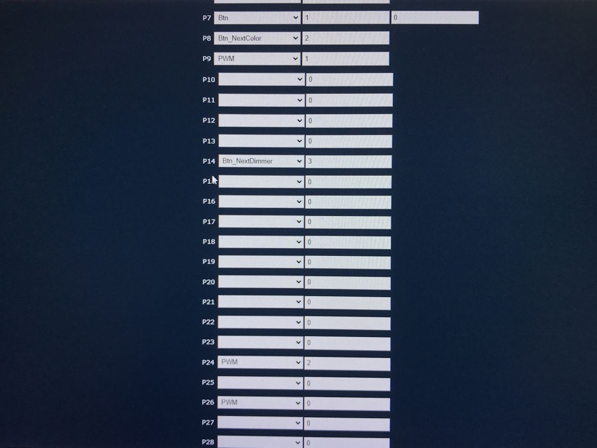

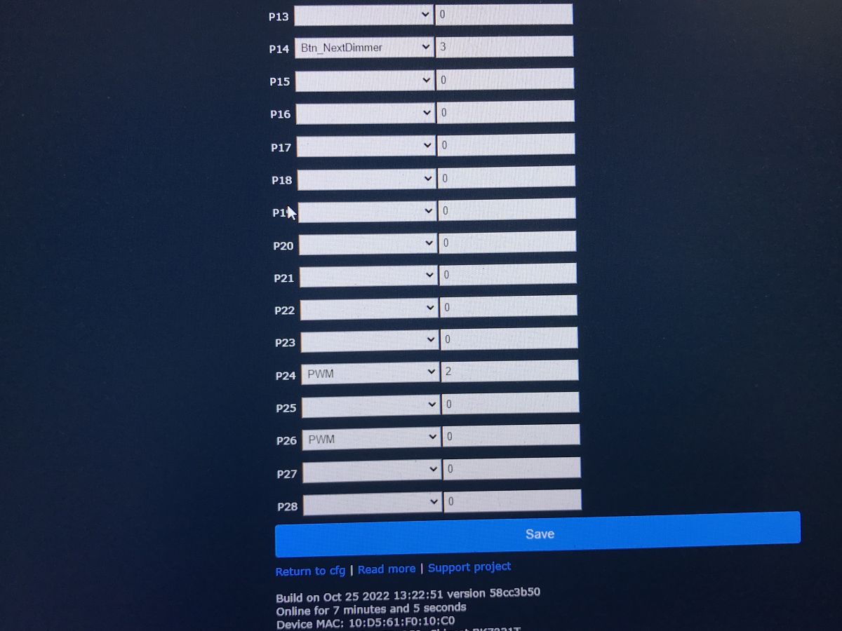

    OpenBeken configuration .

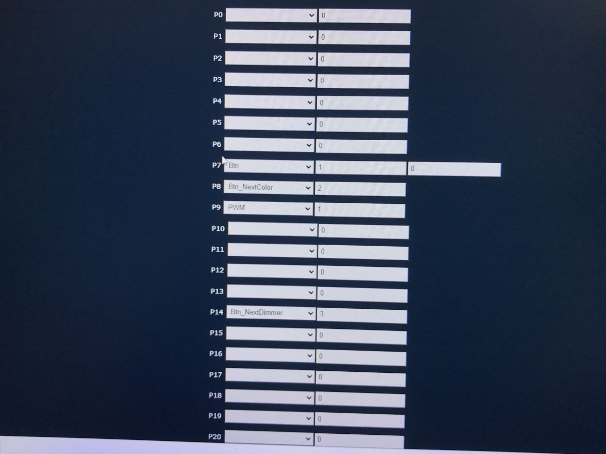

    The OpenBeken configuration boils down to setting three PWM pins (because we have three colours) and three pins with Button roles, or more precisely with special Button roles for that.
    We will use here:
    - Button - a normal button (turns the bar on/off)
    - Button_NextColor - a special button that sets the next colour
    - Button_NextDimmer - a special button that changes the brightness of the bar when held down
    Here is my configuration:
    That's it. Zero additional scripting.
    Configuration of Home Assistant is done as usual - either via Yaml generation or via Discovery.
