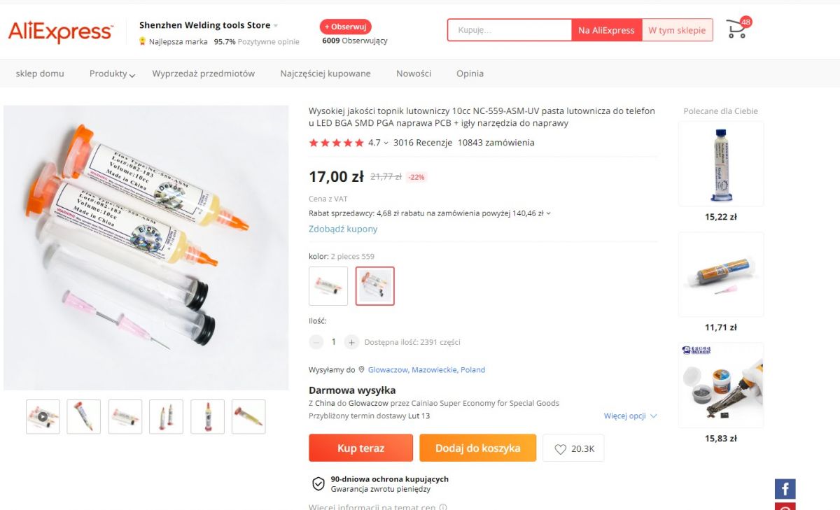

    Interesting way of desoldering. I usually sucked as much binder as possible from the pads with a braid and then removed the chip after heating it with hot-air. Of course, this method is not always possible. When desoldering from a system in which you do not know the BOM or the schematic, it is good to glue the surrounding small elements with kapton, because it may happen that when the board is accidentally moved, small elements may change their place and this may cause problems.
    A preheater is useful if the board allows its use.
    An interesting fun was once when desoldering a module in the form of a PCB soldered on another PCB - it had to be done in such a way as not to damage either the board or the module. The problem was that the module had pads (I don't know what it's called exactly, it's figuratively a semicircle - as if a metallized THT pad was cut in half) on both sides, and I don't know if there were even any on the third edge.
    The three of us desoldered it - one of us heated a copper wire of about 1mm soldered on one side of the pads with one soldering iron, I heated the other side in the same way and had tweezers at the ready, the third of us heated the whole thing with hot air. In addition, the whole thing on the heater ?
    The whole thing was finally completed successfully.
    The key to success is the flux. Practice shows that flux or even an ordinary, not very advanced solder paste perfectly retains heat and allows you to solder SMD components with a simple soldering iron.

    I do not use any special binder, the most ordinary Sn60Pb40 sold often in small violets with a characteristic blue plug, although I bought a spool of it some time ago because it is so convenient. And the pasta...
