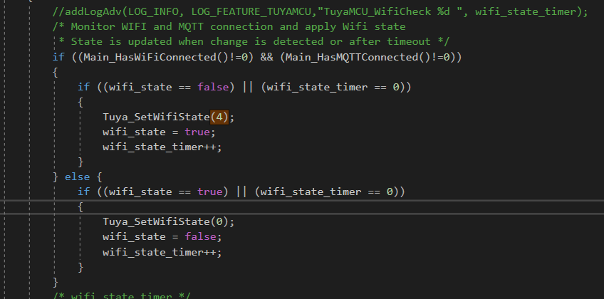

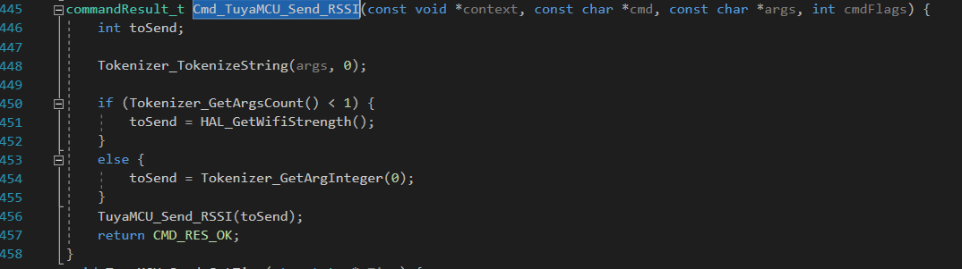

    Hi
    I tested "tuyaMcu_sendRSSI -80" and it works perfectly.
    I checked again and it's definitely "uartSendHex 55AA000300010407" the 03 is correct.
    Sending the "Tuya_SetWifiState" manually I get the following
    Error:CMD:cmd Tuya_SetWifiState NOT found (args 1)
  • Possible protocol bug in Tuya_SetWifiState handling
    #32 20332688
    Posts: 14791
    Rate: 12937
    Thanks,
    but to be clear:
    tomanyusers wrote:
    I checked again and its definitely "uartSendHex 55AA000300010407" the 03 is correct.
    I meant that current code should itself send that packet if MQTT and WiFi are connected. Do you have them both connected?
    Home Assistant Integration: Reflashing BK7231N in Tuya Smart DIN-rail Energy Meter TAC2121C
    It should not be needed to send "55AA000300010407" manually.
    Unless there is some kind of bug... maybe protocol difference....
  • #33 20332702
    tomanyusers
    Posts: 34
    Yes, the meter is connected to the WiFi and is publishing to my MQTT Broker.
    But still needed to manually send the command.
  • #34 20332951
    Posts: 14791
    Rate: 12937
    No idea what's wrong, we have to debug.

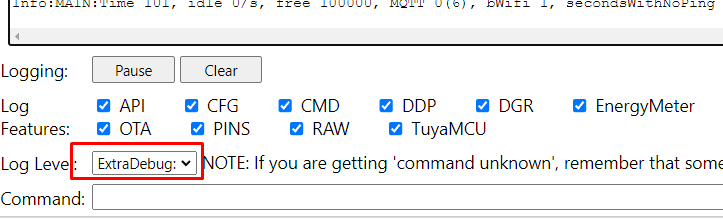

    Update to latest build, add an extra line "loglevel 6" to your autoexec, also change runtime log level to ExtraDebug:
    and reboot, what does it shows for you? Paste full log.
    You can disable non-TuyaMCU options in logging.

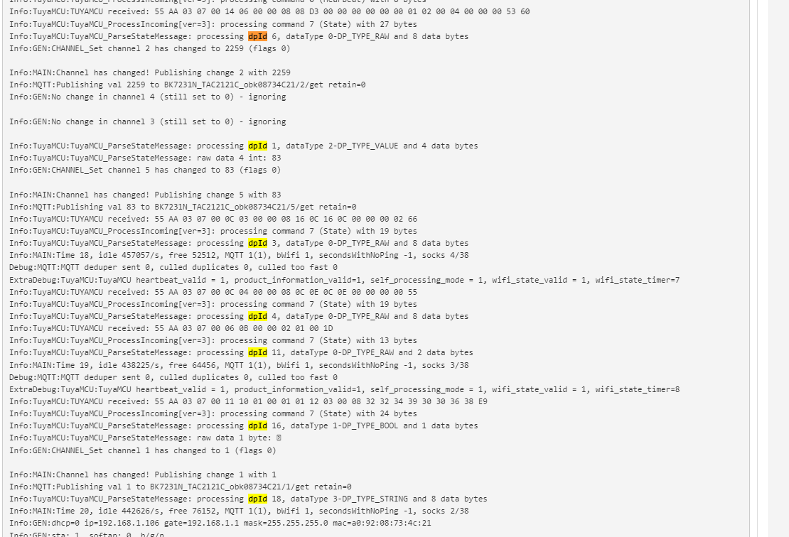

  • TuyaMCU logs show heartbeat and MCU config parsing issue
    #35 20332980
    tomanyusers
    Posts: 34
    Hi
    Will this do?
    Info:NTP:Seconds since Jan 1 1900 = 3879930027
    Info:NTP:Unix time  : 1670941227
    Info:NTP:Local Time : 2022/12/13 14:20:27
    Info:TuyaMCU:TUYAMCU received: 55 AA 03 02 00 00 04
    Info:TuyaMCU:TuyaMCU_ProcessIncoming[ver=3]: processing command 2 (MCUconf) with 7 bytes
    Info:TuyaMCU:TuyaMCU_ProcessIncoming: TUYA_CMD_MCU_CONF had wrong data lenght?
    ExtraDebug:TuyaMCU:Will send TUYA_CMD_QUERY_STATE (state_updated==false).
    Info:MAIN:Time 4, idle 466643/s, free 81416, MQTT 0(0), bWifi 0, secondsWithNoPing -1, socks 2/38
    Debug:MQTT:MQTT deduper sent 0, culled duplicates 0, culled too fast 0
    ExtraDebug:TuyaMCU:TuyaMCU heartbeat_valid = 1, product_information_valid=1, self_processing_mode = 1, wifi_state_valid = 0, wifi_state_timer=0
    Info:MAIN:Time 5, idle 468467/s, free 81416, MQTT 0(0), bWifi 0, secondsWithNoPing -1, socks 2/38
    Info:MAIN:ssid:NewNet key:XXXXX
    Debug:MAIN:Registered for wifi changes
    Info:TuyaMCU:TUYAMCU received: 55 AA 03 00 00 01 01 04
    Info:TuyaMCU:TuyaMCU_ProcessIncoming[ver=3]: processing command 0 (Hearbeat) with 8 bytes
    Info:MAIN:Time 6, idle 459076/s, free 75824, MQTT 0(0), bWifi 0, secondsWithNoPing -1, socks 2/38
    Info:MAIN:Time 7, idle 461054/s, free 75824, MQTT 0(0), bWifi 0, secondsWithNoPing -1, socks 2/38
    Info:MAIN:Time 8, idle 278206/s, free 76032, MQTT 0(0), bWifi 0, secondsWithNoPing -1, socks 2/38
    Info:MAIN:Time 9, idle 0/s, free 76032, MQTT 0(0), bWifi 0, secondsWithNoPing -1, socks 2/38
    Info:MAIN:Time 10, idle 0/s, free 76032, MQTT 0(0), bWifi 0, secondsWithNoPing -1, socks 2/38
    Info:GEN:dhcp=0 ip=0.0.0.0 gate=0.0.0.0 mask=0.0.0.0 mac=a0:92:08:73:4c:21
    Info:GEN:sta: 0, softap: 0, b/g/n
    Info:MAIN:wl_status 3
    Info:MAIN:Main_OnWiFiStatusChange - WIFI_STA_CONNECTING
    Info:MAIN:wl_status 10
    Info:MAIN:Main_OnWiFiStatusChange - WIFI_STA_CONNECTED
    Info:MAIN:wl_status 11
    Info:MAIN:Time 11, idle 139474/s, free 76272, MQTT 0(0), bWifi 1, secondsWithNoPing -1, socks 2/38
    Info:MAIN:Time 12, idle 460918/s, free 76312, MQTT 0(0), bWifi 1, secondsWithNoPing -1, socks 2/38
    Info:MQTT:mqtt_userName homeassistant
    mqtt_pass qqqqqqqqqq
    mqtt_clientID BK7231N_TAC2121C_obk08734C21
    mqtt_host mqtt.home:1883
    Info:MAIN:Time 13, idle 458260/s, free 76224, MQTT 0(1), bWifi 1, secondsWithNoPing -1, socks 2/38
    Info:MQTT:mqtt_subscribed to BK7231N_TAC2121C_obk08734C21/+/set
    Info:MQTT:mqtt_subscribed to cmnd/BK7231N_TAC2121C_obk08734C21/+
    Info:MQTT:MQTT client "BK7231N_TAC2121C_obk08734C21" request cb: err 0
    Debug:API:POST to api/cmnd
    Debug:CMD:cmd [logfeature 8 1]
    Debug:CMD:logfeature set 0x01FFFDFF
    Info:MAIN:Time 14, idle 445322/s, free 76224, MQTT 1(1), bWifi 1, secondsWithNoPing -1, socks 2/38
    Debug:CMD:cmd [logfeature 8 0]
    Debug:CMD:logfeature set 0x01FFFCFF
    Info:MAIN:Time 15, idle 444805/s, free 76224, MQTT 1(1), bWifi 1, secondsWithNoPing -1, socks 2/38
    Info:MAIN:Time 16, idle 460904/s, free 64096, MQTT 1(1), bWifi 1, secondsWithNoPing -1, socks 4/38
    Info:NTP:Seconds since Jan 1 1900 = 3879930045
    Info:NTP:Unix time  : 1670941245
    Info:NTP:Local Time : 2022/12/13 14:20:45
    Info:MAIN:Time 17, idle 455424/s, free 76224, MQTT 1(1), bWifi 1, secondsWithNoPing -1, socks 2/38
    Info:MAIN:Time 18, idle 458336/s, free 76008, MQTT 1(1), bWifi 1, secondsWithNoPing -1, socks 3/38
    Info:MAIN:Time 19, idle 448381/s, free 76224, MQTT 1(1), bWifi 1, secondsWithNoPing -1, socks 2/38
    Info:MAIN:Time 20, idle 458007/s, free 64528, MQTT 1(1), bWifi 1, secondsWithNoPing -1, socks 3/38
    Info:GEN:dhcp=0 ip=192.168.1.106 gate=192.168.1.1 mask=255.255.255.0 mac=a0:92:08:73:4c:21
    Info:GEN:sta:rssi=-60,ssid=NewNet,bssid=4c:5e:0c:a2:23:b7 ,channel=5,cipher_type:CCMP
    Info:MAIN:Time 21, idle 456973/s, free 76224, MQTT 1(1), bWifi 1, secondsWithNoPing -1, socks 2/38
    Info:MAIN:Time 22, idle 459214/s, free 64528, MQTT 1(1), bWifi 1, secondsWithNoPing -1, socks 3/38
    Info:MAIN:Time 23, idle 449104/s, free 76224, MQTT 1(1), bWifi 1, secondsWithNoPing -1, socks 2/38

  • #36 20333072
    Posts: 14791
    Rate: 12937
    It seems like the device doesnt' answer the TUYA_CMD_QUERY_STATE until a TUYA_CMD_WIFI_STATE is set. I've added a crude mechanism to send TUYA_CMD_WIFI_STATE is device didn't answer to QUERY, can you check now? The final solution is still TODO
  • Logs show unsupported command mappings in autoexec.bat

  • #38 20333333
    Posts: 14791
    Rate: 12937
    Please include ExtraDebug messages
  • MQTT and TuyaMCU logs after latest update

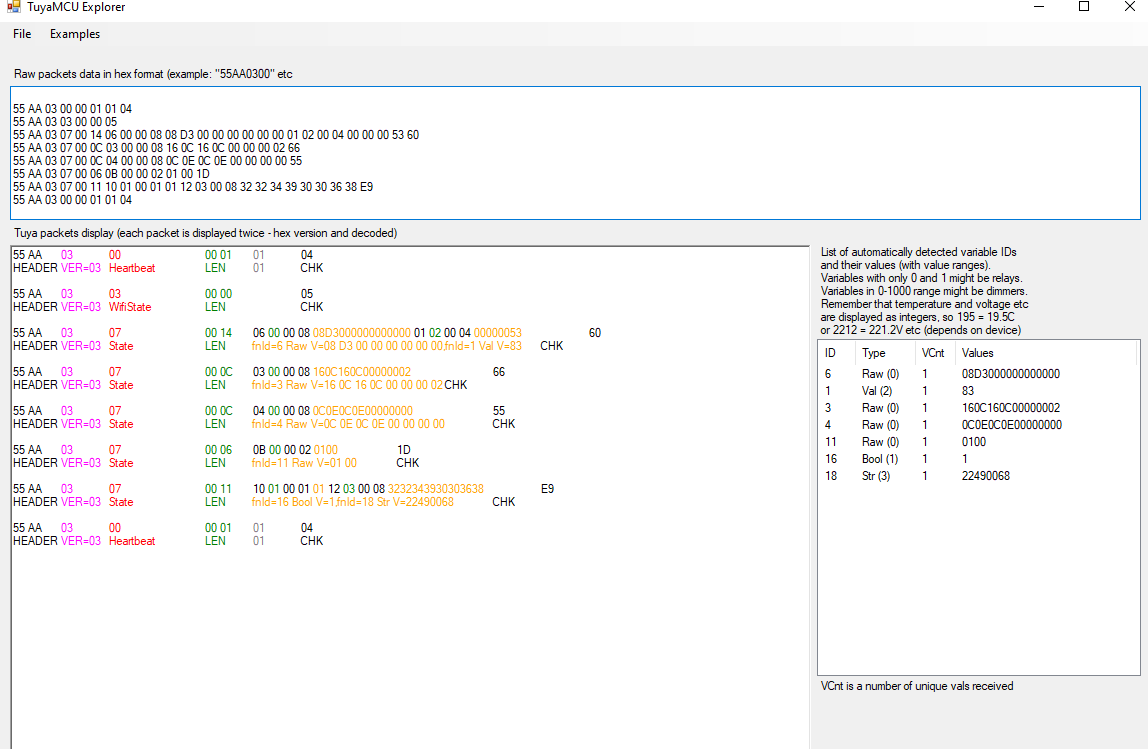

    #39 20333899
    tomanyusers
    Posts: 34
    I just updated to the newest version again. Here are the logs.
    Info:MAIN:Time 13, idle 457419/s, free 75816, MQTT 0(1), bWifi 1, secondsWithNoPing -1, socks 2/38
    ExtraDebug:TuyaMCU:TuyaMCU heartbeat_valid = 1, product_information_valid=1, self_processing_mode = 1, wifi_state_valid = 1, wifi_state_timer=4
    ExtraDebug:TuyaMCU:Will send TUYA_CMD_QUERY_STATE (state_updated==false, try 7).
    Info:MAIN:Time 14, idle 441774/s, free 64456, MQTT 1(1), bWifi 1, secondsWithNoPing -1, socks 3/38
    ExtraDebug:TuyaMCU:Will send SetWiFiState 4.
    Info:MAIN:Time 15, idle 444942/s, free 52760, MQTT 1(1), bWifi 1, secondsWithNoPing -1, socks 4/38
    ExtraDebug:TuyaMCU:TuyaMCU heartbeat_valid = 1, product_information_valid=1, self_processing_mode = 1, wifi_state_valid = 1, wifi_state_timer=6
    Info:TuyaMCU:TUYAMCU received: 55 AA 03 03 00 00 05
    Info:TuyaMCU:TuyaMCU_ProcessIncoming[ver=3]: processing command 3 (WiFiState) with 7 bytes
    ExtraDebug:TuyaMCU:Will send TUYA_CMD_QUERY_STATE (state_updated==false, try 9).
    Info:MAIN:Time 16, idle 449845/s, free 52328, MQTT 1(1), bWifi 1, secondsWithNoPing -1, socks 5/38
    Info:NTP:Seconds since Jan 1 1900 = 3879987487
    Info:NTP:Unix time  : 1670998687
    Info:NTP:Local Time : 2022/12/14 06:18:07
    Info:MAIN:Time 17, idle 453826/s, free 52760, MQTT 1(1), bWifi 1, secondsWithNoPing -1, socks 4/38
    Info:TuyaMCU:TUYAMCU received: 55 AA 03 07 00 14 06 00 00 08 08 D3 00 00 00 00 00 00 01 02 00 04 00 00 00 53 60
    Info:TuyaMCU:TuyaMCU_ProcessIncoming[ver=3]: processing command 7 (State) with 27 bytes
    Info:TuyaMCU:TuyaMCU_ParseStateMessage: processing dpId 6, dataType 0-DP_TYPE_RAW and 8 data bytes
    Info:GEN:CHANNEL_Set channel 2 has changed to 2259 (flags 0)
    Info:MAIN:Channel has changed! Publishing change 2 with 2259
    Info:MQTT:Publishing val 2259 to BK7231N_TAC2121C_obk08734C21/2/get retain=0
    Info:GEN:No change in channel 4 (still set to 0) - ignoring
    Info:GEN:No change in channel 3 (still set to 0) - ignoring
    Info:TuyaMCU:TuyaMCU_ParseStateMessage: processing dpId 1, dataType 2-DP_TYPE_VALUE and 4 data bytes
    Info:TuyaMCU:TuyaMCU_ParseStateMessage: raw data 4 int: 83
    Info:GEN:CHANNEL_Set channel 5 has changed to 83 (flags 0)
    Info:MAIN:Channel has changed! Publishing change 5 with 83
    Info:MQTT:Publishing val 83 to BK7231N_TAC2121C_obk08734C21/5/get retain=0
    Info:TuyaMCU:TUYAMCU received: 55 AA 03 07 00 0C 03 00 00 08 16 0C 16 0C 00 00 00 02 66
    Info:TuyaMCU:TuyaMCU_ProcessIncoming[ver=3]: processing command 7 (State) with 19 bytes
    Info:TuyaMCU:TuyaMCU_ParseStateMessage: processing dpId 3, dataType 0-DP_TYPE_RAW and 8 data bytes
    Info:MAIN:Time 18, idle 457057/s, free 52512, MQTT 1(1), bWifi 1, secondsWithNoPing -1, socks 4/38
    ExtraDebug:TuyaMCU:TuyaMCU heartbeat_valid = 1, product_information_valid=1, self_processing_mode = 1, wifi_state_valid = 1, wifi_state_timer=7
    Info:TuyaMCU:TUYAMCU received: 55 AA 03 07 00 0C 04 00 00 08 0C 0E 0C 0E 00 00 00 00 55
    Info:TuyaMCU:TuyaMCU_ParseStateMessage: processing dpId 4, dataType 0-DP_TYPE_RAW and 8 data bytes
    Info:TuyaMCU:TUYAMCU received: 55 AA 03 07 00 06 0B 00 00 02 01 00 1D
    Info:TuyaMCU:TuyaMCU_ProcessIncoming[ver=3]: processing command 7 (State) with 13 bytes
    Info:TuyaMCU:TuyaMCU_ParseStateMessage: processing dpId 11, dataType 0-DP_TYPE_RAW and 2 data bytes
    Info:MAIN:Time 19, idle 438225/s, free 64456, MQTT 1(1), bWifi 1, secondsWithNoPing -1, socks 3/38
    ExtraDebug:TuyaMCU:TuyaMCU heartbeat_valid = 1, product_information_valid=1, self_processing_mode = 1, wifi_state_valid = 1, wifi_state_timer=8
    Info:TuyaMCU:TUYAMCU received: 55 AA 03 07 00 11 10 01 00 01 01 12 03 00 08 32 32 34 39 30 30 36 38 E9
    Info:TuyaMCU:TuyaMCU_ProcessIncoming[ver=3]: processing command 7 (State) with 24 bytes
    Info:TuyaMCU:TuyaMCU_ParseStateMessage: processing dpId 16, dataType 1-DP_TYPE_BOOL and 1 data bytes
    Info:TuyaMCU:TuyaMCU_ParseStateMessage: raw data 1 byte:
    Info:GEN:CHANNEL_Set channel 1 has changed to 1 (flags 0)
    Info:MAIN:Channel has changed! Publishing change 1 with 1
    Info:MQTT:Publishing val 1 to BK7231N_TAC2121C_obk08734C21/1/get retain=0
    Info:TuyaMCU:TuyaMCU_ParseStateMessage: processing dpId 18, dataType 3-DP_TYPE_STRING and 8 data bytes
    Info:MAIN:Time 20, idle 442626/s, free 76152, MQTT 1(1), bWifi 1, secondsWithNoPing -1, socks 2/38
    Info:GEN:sta:rssi=-61,ssid=NewNet,bssid=4c:5e:0c:a2:23:b7 ,channel=5,cipher_type:CCMP
    ExtraDebug:TuyaMCU:TuyaMCU heartbeat_valid = 1, product_information_valid=1, self_processing_mode = 1, wifi_state_valid = 1, wifi_state_timer=9
    Info:MAIN:Time 21, idle 441706/s, free 76152, MQTT 1(1), bWifi 1, secondsWithNoPing -1, socks 2/38
    Info:MAIN:Time 22, idle 453325/s, free 76152, MQTT 1(1), bWifi 1, secondsWithNoPing -1, socks 2/38
    ExtraDebug:TuyaMCU:TuyaMCU heartbeat_valid = 1, product_information_valid=1, self_processing_mode = 1, wifi_state_valid = 1, wifi_state_timer=10
    Info:MAIN:Time 23, idle 448789/s, free 76152, MQTT 1(1), bWifi 1, secondsWithNoPing -1, socks 2/38
    ExtraDebug:TuyaMCU:TuyaMCU heartbeat_valid = 1, product_information_valid=1, self_processing_mode = 1, wifi_state_valid = 1, wifi_state_timer=11
    Info:MAIN:Time 24, idle 439836/s, free 76152, MQTT 1(1), bWifi 1, secondsWithNoPing -1, socks 2/38
    ExtraDebug:TuyaMCU:TuyaMCU heartbeat_valid = 1, product_information_valid=1, self_processing_mode = 1, wifi_state_valid = 1, wifi_state_timer=12
    Info:MAIN:Time 25, idle 446626/s, free 76152, MQTT 1(1), bWifi 1, secondsWithNoPing -1, socks 2/38
    Info:MAIN:Time 26, idle 456696/s, free 76152, MQTT 1(1), bWifi 1, secondsWithNoPing -1, socks 2/38
    ExtraDebug:TuyaMCU:TuyaMCU heartbeat_valid = 1, product_information_valid=1, self_processing_mode = 1, wifi_state_valid = 1, wifi_state_timer=13
    Info:MAIN:Time 27, idle 448265/s, free 76152, MQTT 1(1), bWifi 1, secondsWithNoPing -1, socks 2/38
    ExtraDebug:TuyaMCU:TuyaMCU heartbeat_valid = 1, product_information_valid=1, self_processing_mode = 1, wifi_state_valid = 1, wifi_state_timer=14
    Info:MAIN:Time 28, idle 440439/s, free 76152, MQTT 1(1), bWifi 1, secondsWithNoPing -1, socks 2/38
    ExtraDebug:TuyaMCU:TuyaMCU heartbeat_valid = 1, product_information_valid=1, self_processing_mode = 1, wifi_state_valid = 1, wifi_state_timer=15
    Info:MAIN:Time 29, idle 449660/s, free 76152, MQTT 1(1), bWifi 1, secondsWithNoPing -1, socks 2/38
    Info:MAIN:Time 30, idle 450210/s, free 76152, MQTT 1(1), bWifi 1, secondsWithNoPing -1, socks 2/38
    ExtraDebug:TuyaMCU:TuyaMCU heartbeat_valid = 1, product_information_valid=1, self_processing_mode = 1, wifi_state_valid = 1, wifi_state_timer=16
    Info:MAIN:Time 31, idle 449819/s, free 76152, MQTT 1(1), bWifi 1, secondsWithNoPing -1, socks 2/38
    Info:MAIN:Boot complete time reached (30 seconds)
    Debug:CFG:new offset 7876, boot_count 64, success count 64
    Debug:CFG:new offset after read 7876, boot_count 64, success count 64
    Debug:CFG:re-read - offset 7876, boot count 64, boot success 64, bootfailures 0
    ExtraDebug:TuyaMCU:TuyaMCU heartbeat_valid = 1, product_information_valid=1, self_processing_mode = 1, wifi_state_valid = 1, wifi_state_timer=17
    Info:MAIN:Time 32, idle 435063/s, free 76152, MQTT 1(1), bWifi 1, secondsWithNoPing -1, socks 2/38
    ExtraDebug:TuyaMCU:TuyaMCU heartbeat_valid = 1, product_information_valid=1, self_processing_mode = 1, wifi_state_valid = 1, wifi_state_timer=18
    Info:MAIN:Time 33, idle 449166/s, free 76152, MQTT 1(1), bWifi 1, secondsWithNoPing -1, socks 2/38
    Info:MAIN:Time 34, idle 450591/s, free 76152, MQTT 1(1), bWifi 1, secondsWithNoPing -1, socks 2/38
    ExtraDebug:TuyaMCU:TuyaMCU heartbeat_valid = 1, product_information_valid=1, self_processing_mode = 1, wifi_state_valid = 1, wifi_state_timer=19
    Info:MAIN:Time 35, idle 449292/s, free 76152, MQTT 1(1), bWifi 1, secondsWithNoPing -1, socks 2/38
    ExtraDebug:TuyaMCU:TuyaMCU heartbeat_valid = 1, product_information_valid=1, self_processing_mode = 1, wifi_state_valid = 1, wifi_state_timer=20
    Info:MAIN:Time 36, idle 439591/s, free 76152, MQTT 1(1), bWifi 1, secondsWithNoPing -1, socks 2/38
    Looks like the TUYA_CMD_WIFI_STATE worked.
  • #40 20352744
    tomanyusers
    Posts: 34
    Hi
    Whats the next steps from here?
  • Requesting dpID meanings and GUI mapping status
    #41 20352750
    Posts: 14791
    Rate: 12937
    Hello, it's been 14 days, I must read back whole topic again to see how much progress we had, but in general, do we already have a known list of dpIDs for this device with their meanings?
    What is your current autoexec.bat?
    Do we know the meaning of those dpIDs?

    From what I see, you had received those packets...
    We might need to guess what are the binary values here, especially in RAW packets:
    55 AA	03	07		00 14	06 00 00 08 08D3000000000000 01 02 00 04 00000053 		60
    HEADER	VER=03	State		LEN	fnId=6 Raw V=08 D3 00 00 00 00 00 00,fnId=1 Val V=83	CHK
    55 AA	03	07		00 0C	03 00 00 08 160C160C00000002 		66
    HEADER	VER=03	State		LEN	fnId=3 Raw V=16 0C 16 0C 00 00 00 02	CHK
    55 AA	03	07		00 0C	04 00 00 08 0C0E0C0E00000000 		55
    HEADER	VER=03	State		LEN	fnId=4 Raw V=0C 0E 0C 0E 00 00 00 00	CHK
    55 AA	03	07		00 06	0B 00 00 02 0100 		1D
    HEADER	VER=03	State		LEN	fnId=11 Raw V=01 00	CHK
    55 AA	03	07		00 11	10 01 00 01 01 12 03 00 08 3232343930303638 		E9
    HEADER	VER=03	State		LEN	fnId=16 Bool V=1,fnId=18 Str V=22490068	CHK
    EDIT: From what I've seen, I've already described them 2 weeks ago here:
    https://www.elektroda.com/rtvforum/topic3936455.html#20310817
    So basically now we just need to them on GUI?
    It seems that most of the work is already done, what is remaining now, or are you asking how to get results to Home Assistant?
  • Autoexec mapping for TAC2121C channels and formatting

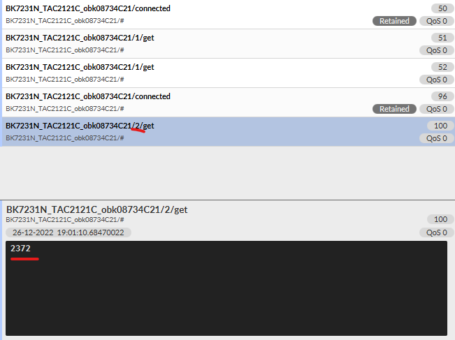

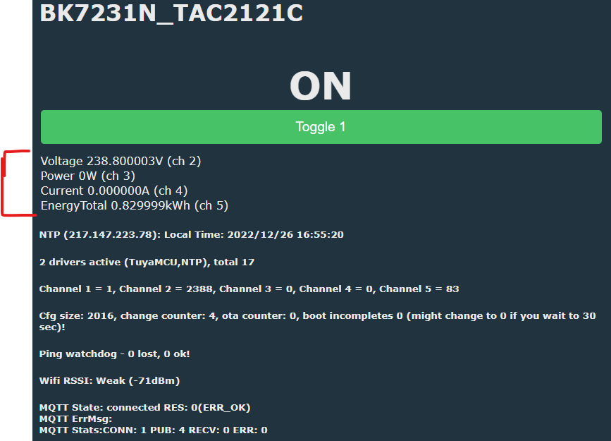

    Yes, it has been a while.
    In my mind the last few bits are:
    1. Getting the RSSI to display on the LCD Screen.
    2. Updating the channel names in the MQTT messages to reflect the actual names and not just numbers and formatting the numbers.
    3. Format the values correctly on the GUI, at the moment there are 6 decimal places, I assume the plan is to round these to 2.
    Not sure if there is anything else.

  • Hardcoded GUI values to two decimal places
    #45 20352962
    Posts: 14791
    Rate: 12937
    Well, I think we should send it at the correct moment, I heard rare reports that some devices do not like transferring data at the unexpected times.
    But if you want to use more risky approach (which might work ok), maybe you can do in autoexec "addRepeatingEvent 30 -1 tuyaMcu_sendRSSI"? Every 30 second send that command (-1 means infinite repeats). I am curious if it would work for you.
    tomanyusers wrote:
    3. Format the values correctly on the GUI, at the moment there are 6 decimal places, I assume the plan it to round these to 2.
    Should be done, I hardcoded it to 2 decimal places right now:
  • #46 20353000
    tomanyusers
    Posts: 34
    The 2 decimal points seems to be working except for the energy. It rounded 0.8299999... to 0.82 but the value should be 0.83. Seems to truncate and not round.
    Adding the "tuyaMcu_sendRSSI" to the autoexec does not seem to work as it is expecting the RSSI as a parameter.
    Debug:CMD:cmd [tuyaMcu_sendRSSI]
    Info:TuyaMCU:Requires 1 argument
  • RSSI command to use current signal when omitted
    #47 20353016
    Posts: 14791
    Rate: 12937
    That's not good, but it seems that our lightweight sprintf just works that way. I might need to figure out a better way for conversion. At least, this is purely cosmetical, the values in channels are not rounded.
    Ah I see, I forget about that. I will modify this command to send the current RSSI if an argument is not present.

    Posts: 14791
    Rate: 12937
    Hey @tomanyusers , if I remember correctly, I added the default RSSI value sending many days ago:

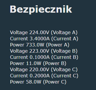

  • RAW_TAC2121C_VCP appears to merge all phase readings
    #52 21325110
    tarkowskimicha
    Hi,
    Sorry for digging inside an old topic but I have a question about the usage of RAW_TAC2121C_VCP command in a 3-phase metering tuya device, using autoexec provided in this thread and dpIDs I was able to convert a SMTONOFF breaker from tuya proprietary firmware to OpenBK one although there is a small bug with publishing voltage current and power values in situation when three phases use different dpID's. In my case Phase A is published on dpID 6, Phase B on dpID 7 and Phase C on dpID 8.
    When using:
    "linkTuyaMCUOutputToChannel 6 RAW_TAC2121C_VCP
    setChannelType 5 Voltage_div10
    setChannelLabel 5 "Voltage A"
    setChannelType 6 Power
    setChannelLabel 6 "Power A"
    setChannelType 7 Current_div1000
    setChannelLabel 7 "Current A""
    instruction all data from Phase A is published correctly but when added another dpID's:
    linkTuyaMCUOutputToChannel 7 RAW_TAC2121C_VCP
    setChannelType 20 Voltage_div10
    setChannelLabel 20 "Voltage B"
    setChannelType 21 Power
    setChannelLabel 21 "Power B"
    setChannelType 22 Current_div1000
    setChannelLabel 22 "Current B"
    linkTuyaMCUOutputToChannel 8 RAW_TAC2121C_VCP
    setChannelType 23 Voltage_div10
    setChannelLabel 23 "Voltage C"
    setChannelType 24 Power
    setChannelLabel 24 "Power C"
    setChannelType 25 Current_div1000
    setChannelLabel 25 "Current C"
    it combines all 3 phase metering values and publishes them on channels 5, 6 and 7. Am I missing something in the configuration or is it expected behaviour? If I use the command from the first example but exchange listening dpID to 7 or 8 alone it works as expected but publishes only one phase metrics.

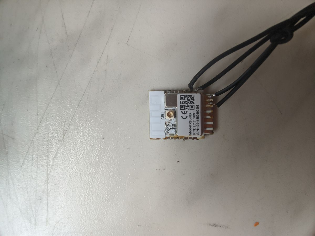

  • UART pins exposed under front label on older breaker revision
    #56 21326279
    tarkowskimicha
    >>21325645 Yes I do, here is a dump, dpID's and MCU output. I have two breakers as one was bricked by vendor with Tuya MCU update (8H3K64S2 flash was corrupted and cannot be dumped from other working breaker, Chinese seller couldn't provide me with working dump but sent me a new breaker for replacement). Newer one is a bit different revision and cannot be reflashed with openBK without opening (although it is simple, just 4 screws at the back of device). In older one, the front label can be removed and UART pins are exposed next to the display (MCU does not interfere with CBU unit when no voltage is applied to breaker inputs and can be reflashed without removal of CBU) PCB with a digital display and buttons. Printed circuit board with integrated circuits and connectors on a white background. Electronic module with four wires on a light background.
    And the rest of files:
    • readResult_BK7231N_QIO_breaker_2024-30-11-11-46-57.bin (2 MB) You must be logged in to download this attachment.

  • RAW_TAC2121C_VCP needs voltage channel first
    #57 21337927
    Posts: 14791
    Rate: 12937
    Thank you in advance for your support.
    @tarkowskimicha Here is related update. You still can use RAW_TAC2121C_VCP, but you need to specify first channel, which is used for voltage. Next is current, then is power.
    See related commit:
    https://github.com/openshwprojects/OpenBK7231...mmit/6e176a39112e34691808efa22cb3245bd5682b43
    Self test:
    Code: C / C++
  • #58 21345230
