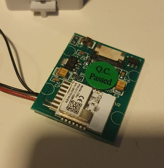

    Ok here is what I have.
    Tuya Single Phase Energy Meter 6 In 1: CBU Chip Flashing & ESPHome Integration Issues Tuya Single Phase Energy Meter 6 In 1: CBU Chip Flashing & ESPHome Integration Issues

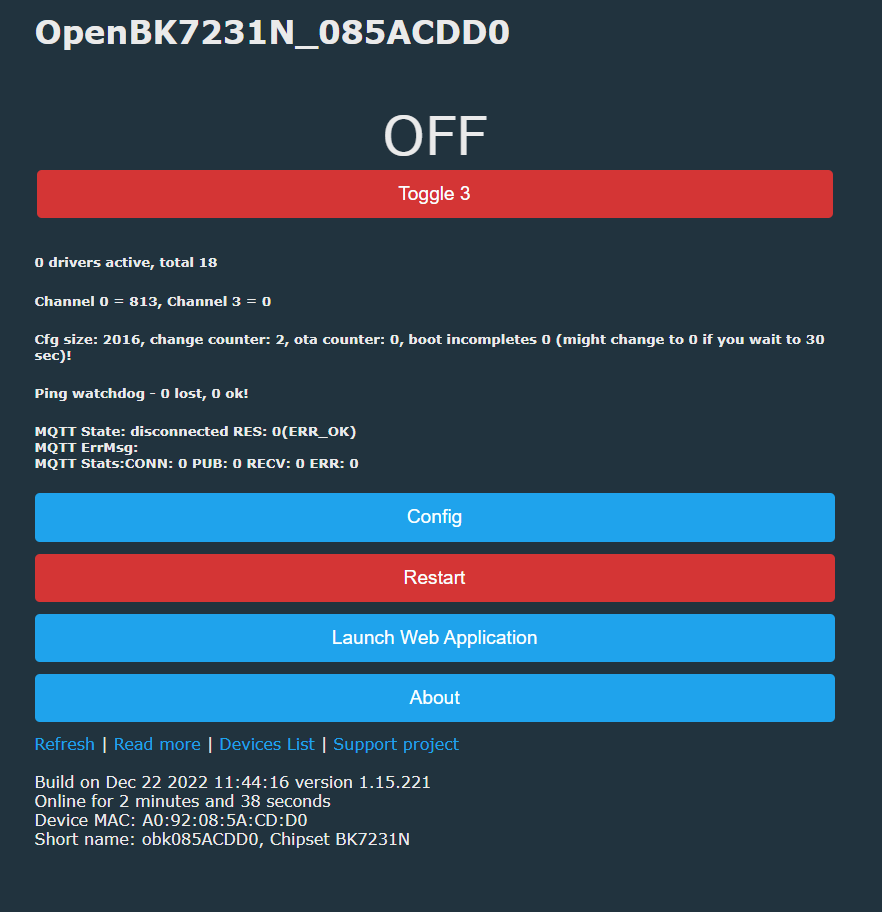

    Ok here's an update.
    I have connected the device to wifi and have also connected it to homeassistant via MQTT.
    The only issue is it only has one entity showing, which is a switch.
    There is no entity displaying the current output.

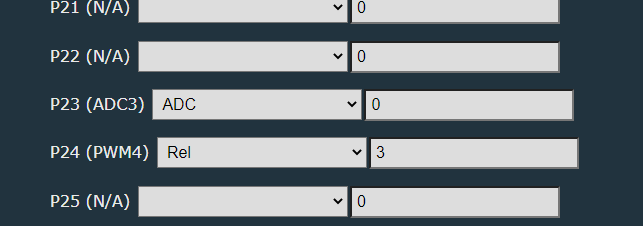

    Does the 813 channel0 value changes with the current? We don't have a driver for ADC-based current sensor yet, would you be able to help with testing new one? I must check how other firmwares handle that. Still, it looks relatively simple. We could write one (or port) for you. Most like it will need a user calibration, just like in Tasmota, with an external meter:

    Ok, now, does that ADC reading changes with the current? Are we sure that this ADC port is used here?

    Also, I can confirm the value is changing when power is passing through.

    Ok, slight problem. Tried doing the test you asked for but the value does not seem to change.
    I thought it was fine as I tested it before, but it's really not changing, it kind of just fluctuates between 810 and 840.
    Any ideas?

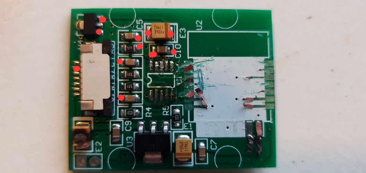

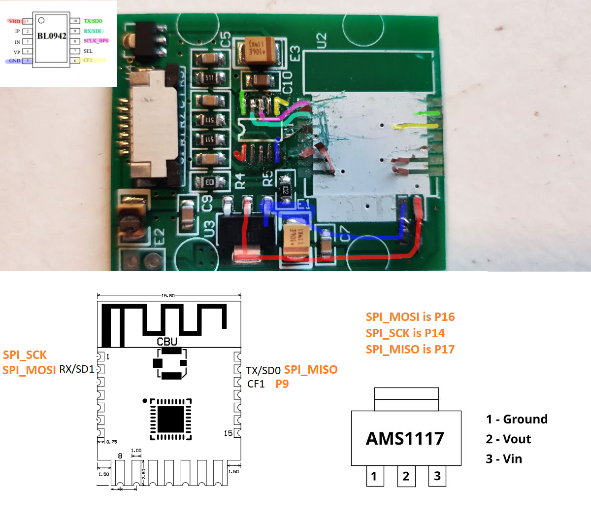

  • Request to reverse engineer PCB pin roles and connections
    #41 20355639
    Posts: 14754
    Rate: 12876

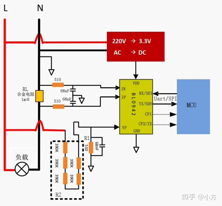

    We need more information. We need to reverse engineer this device. I did such things in the past, for example for QTouch no-neutral switch in this topic (sorry, Polish language!):
    https://www.elektroda.pl/rtvforum/topic3793509.html
    I drawn this schematic:
    You don't need to draw whole schematic, but we really need to know this device does (check in Tuya App?) and what are pin roles, where which signal from CBU goes.
    I can write a driver specifically for you, per your request, but I don't know what's going on that PCB. It would be really helpful to sketch the connections, where are the resistor connected, where the measurement coil (I+ and I- goes), etc.
    The second option is to find the Tasmota template for this device, and if it matches, we can use knowledge from there.
    I will also double-check ADC handling for N and T.

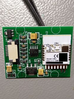

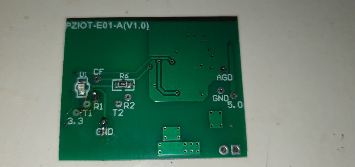

  • #43 20356800
    Posts: 14754
    Rate: 12876

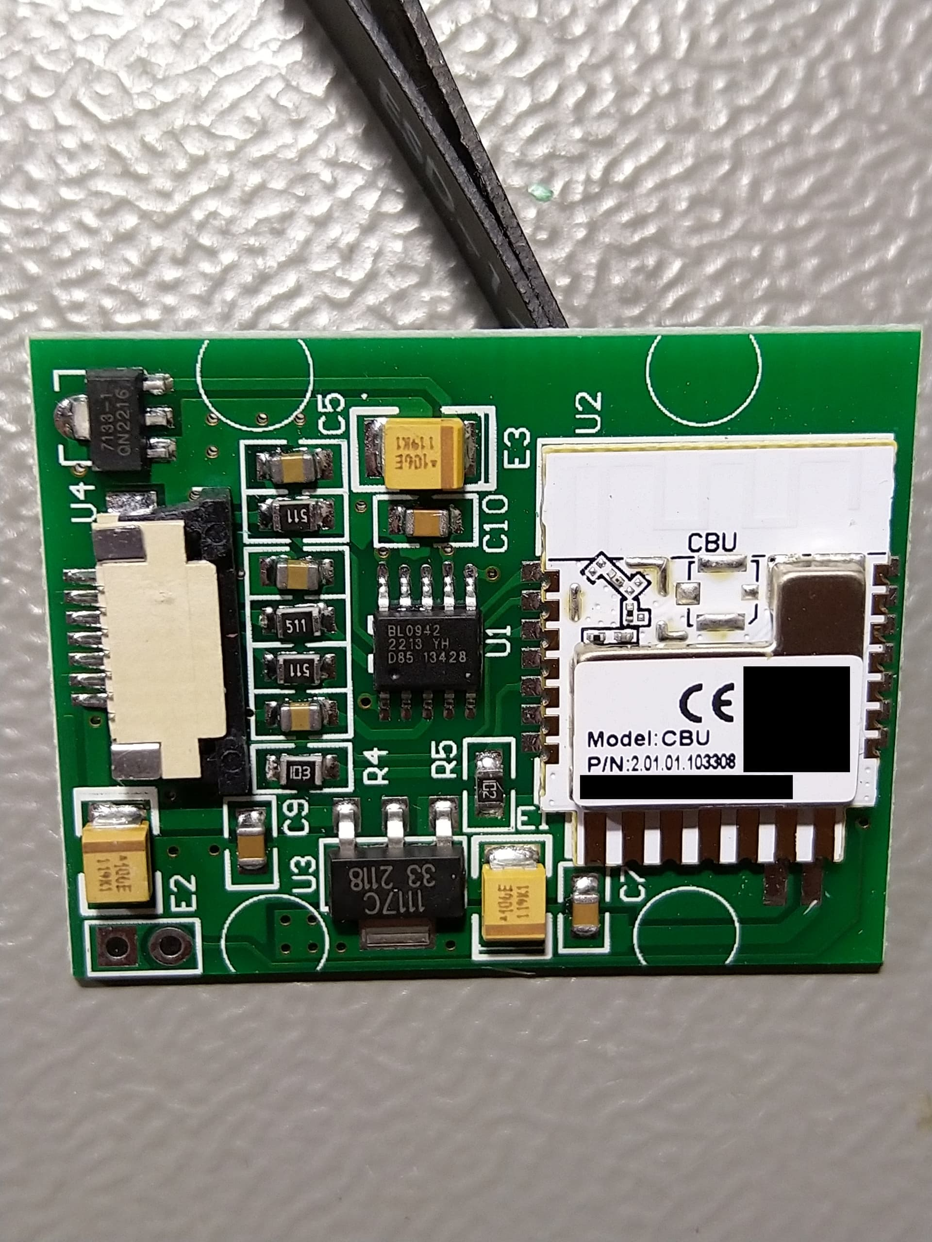

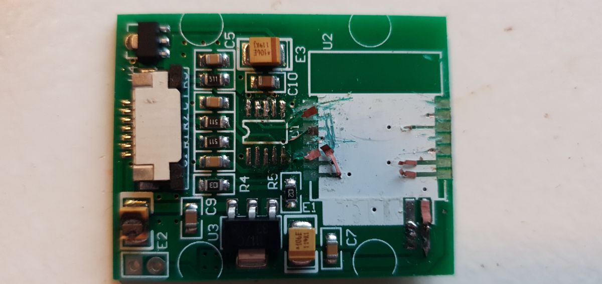

    That moment when I see it...
    Can you tell me what is under that green sticker here?
    because, according to the link you posted, there is a already-mentioned BL0942 underneath...
  • #44 20356813
    deanfourie
    Posts: 45
    Is it possible to flash one back to stock Tuya for testing?
  • #45 20356830
    Posts: 14754
    Rate: 12876
    If I am correct, then it's not needed.
    But yes, you can reflash, if you have a backup.
    Just do "startDriver BL0942" in short startup command and reboot. BL0942 in UART mode is supported.
    You can also check to confirm, are BL0942 RX and TX pins connected to RXD1 and TXD1 of WiFi module?
  • #46 20356873
    deanfourie
    Posts: 45
    By WiFi module, you mean the BKN CBU right?
    Added after 9 [minutes]:
    Damn! That is a BL0942 chip! Not sure how I missed that.
  • #47 20356885
    Posts: 14754
    Rate: 12876
    This explains a lot of things.
    Now, we need to check is that BL0942 connected in UART mode?
    Does BL0942 RX and TX connects to BKN CBU TXD1 RXD1?
    Second option: enter "startDriver BL0942" in short startup command, reboot and see what you get. Also check logs.
    How good are your soldering skills?

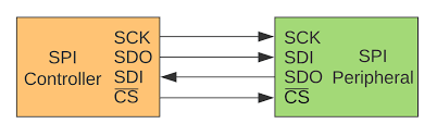

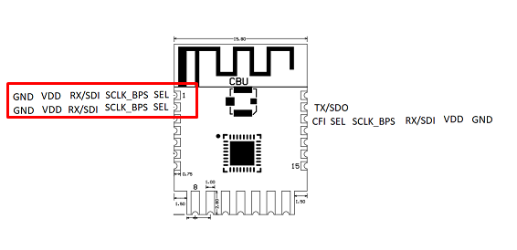

  • Need to verify whether BL0942 uses UART or SPI
    #49 20356896
    Posts: 14754
    Rate: 12876

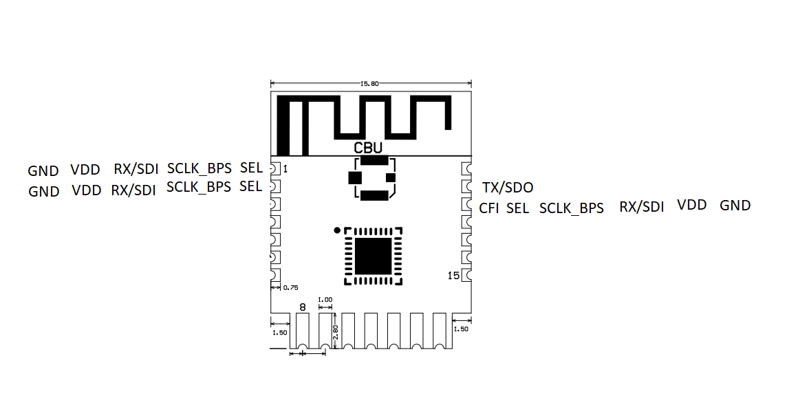

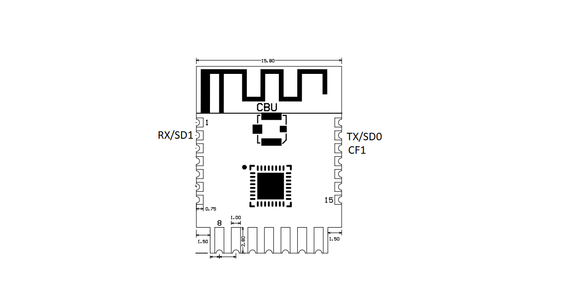

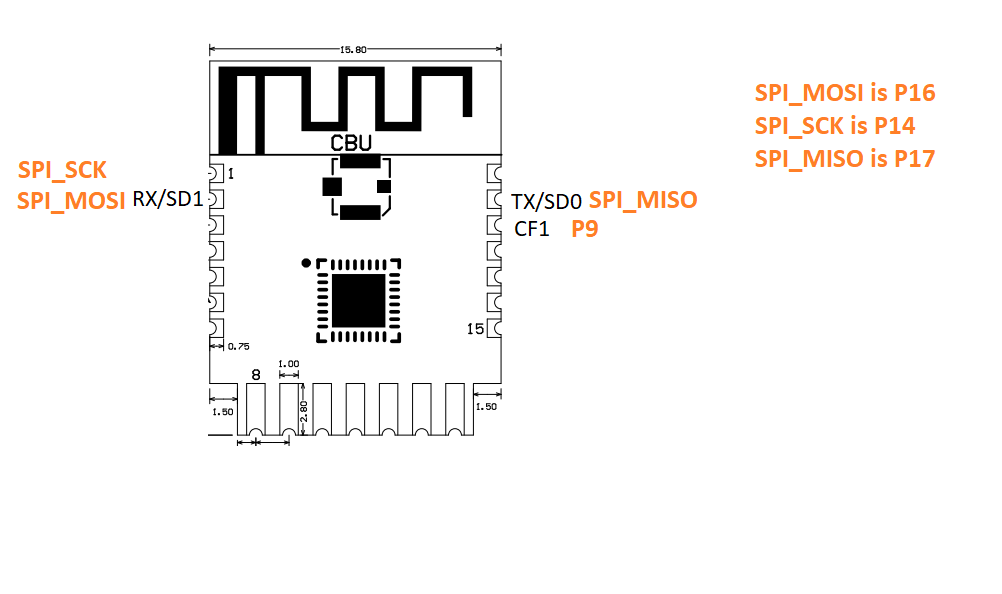

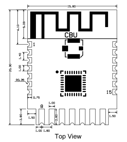

    Here is the CBU documentation:
    https://developer.tuya.com/en/docs/iot/cbu-module-datasheet?id=Ka07pykl5dk4u
    15TX1I/OUART_TX1, which is used for transmitting user data and corresponds to Pin 27 of the IC. For the MCU solution, please refer to CBx Module.
    16RX1I/OUART_RX1, which is used for receiving user data and corresponds to Pin 26 of the IC. For the MCU solution, please refer to CBx Module.

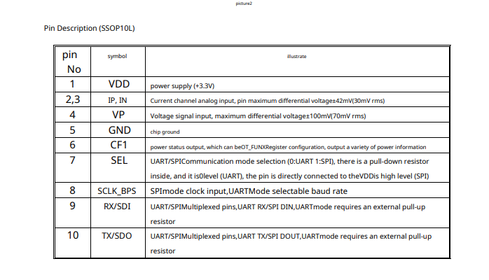

    Here is BL0942:
    We need to know whether BL0942 is connected in UART or in SPI mode.
    Now, there are two potential scenarios...
    Spoiler:
    Scenario 1: if BL0942 is connected in UART mode, then everything is solved, we have a BL0942 driver, which even works with NTP, gathers stats, etc, (thanks @valeklubomir - our important contributor! He did a lot of work for OBK)
    Scenario 2: if BL0942 is in SPI mode, then there are two next options, because SPI mode is not supported yet and I have never seen it before and we already have above 150 devices in templates list and none of them ever had SPI mode, so... if it's SPI, then you can either wait for me to add SPI mode, or just solder jumper wires and cut traces so BL0942 is switched to UART mode and you get it working within 30 minutes (I know how to solder etc and it's really, just 15 minutes job)
  • #50 20356924

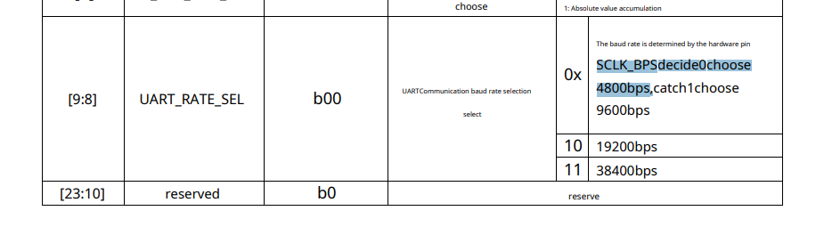

  • BL0942 UART mode wiring and calibration steps
    #51 20356996
    Posts: 14754
    Rate: 12876
    So where are connected the following pins: TX/SDO , RX/SDI , SCLK_BPS, and CF1?
    Here are the pin roles of BL0942:
    Please check the SEL pin. Is it connected to VDD? SEL connected to VDD means SPI. We want UART.
    If your device is using BL0942 in SPI mode, which is a first time ever I encounter this, then easiest way it to put it back in UART mode. Just do the following steps for next device in order to pair it with HA:
    1. First of all, do finally a flash read first (you did it in the past but you overwrote it later? I am not sure, see read and write commands from the first page of this topic)
    2. Then flash OpenBeken (write operation)
    3. Then you have to cut the trace - disconnect SEL from VDD, in order to turn BL0942 into UART mode

  • #52 20357223
    deanfourie
    Posts: 45
    This is the pinout I get using continuity to test.
    Added after 3 [minutes]:
    Honestly, I'm more worried about cutting the traces than soldering.
  • Using P9 as AlwaysLow instead of cutting traces

    Sorry, I am not sure if I understand the notation - are you saying that VDD and GND and RX/SDI and SCLK_BPS connects to the same pin?
    If you don't want to cut the traces, then we are able to use a bit more clever approach.
    For example, from what I am seeing, the SCLK_BPS should be at level 0 for 4800 baud.
    If SCLK_BPS track is connected to, let's say, for example, P9 signal (not pin 9 of CBU, but P9), then you can in our software set P9 role to "AlwaysLow". This will do the same as shorting that signal to ground, but it in a more easy way.
  • #54 20357252
    deanfourie
    Posts: 45
    Yes, they literally all ring out to the same pin?

  • #56 20357313
    deanfourie
    Posts: 45
    Ok here's what I came up with.
    I cannot however find SCLK_BPS.
    Struggled to get the CBU up, lifted a few pads but still have access to the traces
  • SPI pins identified on CBU and UART reroute needed
    #57 20357353
    Posts: 14754
    Rate: 12876
    Very good job. We are progressing quickly. This meter will be up and running with all measurements soon.
    Can you post some detailed photos?
    Isn't SCLK_BPS connected to the SPI_SCK? See your modified picture:
    Here is a list of SPI pins on CBU:
    Pin numberSymbolI/O typeFunction
    1P14I/OCommon GPIO, which can be reused as SPI_SCK (Correspond to Pin 11 of the IC)
    2P16I/OCommon GPIO, which can be reused as SPI_MOSI (Correspond to Pin 12 of the IC)
    20P17I/OCommon GPIO, which can be reused as SPI_MISO (Correspond to Pin 14 of the IC)
    21P15I/OCommon GPIO, which can be reused as SPI_CS (Correspond to Pin 13 of the IC)
    It confirms it's SPI. We will need to think carefully how to reroute it to UART easily. We can reduce the amount of trace-cutting with some trickery. We have "AlwaysLow" and "AlwaysHigh" pin states in our software.
    PS: It's "SDI", as in "serial data input", and "SDO", as in "serial data output". Not "SD1" and not "SD0".
  • #58 20357429
    deanfourie
    Posts: 45
    To be honest it's a bit of a mess. My apologies.
    But, honestly there doesn't look like there was even a trace on PIN 1 of the CBU.
    Ok good to know! Still learning.
  • Need SEL connection traced on board
    #59 20357491
    Posts: 14754
    Rate: 12876
    Thank you for the photo. Judging from it, SCLK indeed is connected where it should be. You can see there was a trace, if you look closely.
    Please zoom in photo to see the traces I highlighted in Gimp.
    Where is SEL connected? It goes to via under the board so I am unable to determine that one myself.
    SCLK_BPS is connected to pin 1 of CBU, so you don't have to cut that trace, you can just control P14 in OpenBeken software, set AlwaysLow or AlwaysHigh pin role.
    Now I need to know where SEL is connected. Maybe you can post a good quality photo of second side of the board and I will trace myself, or just try yourself with multimeter
  • #60 20357554
    deanfourie
    Posts: 45
    Ok, from what I can tell doing a continuity test, SEL is connected to the following pins with RED dots.
    Here's a shot of the bottom of the board.
    Thanks
