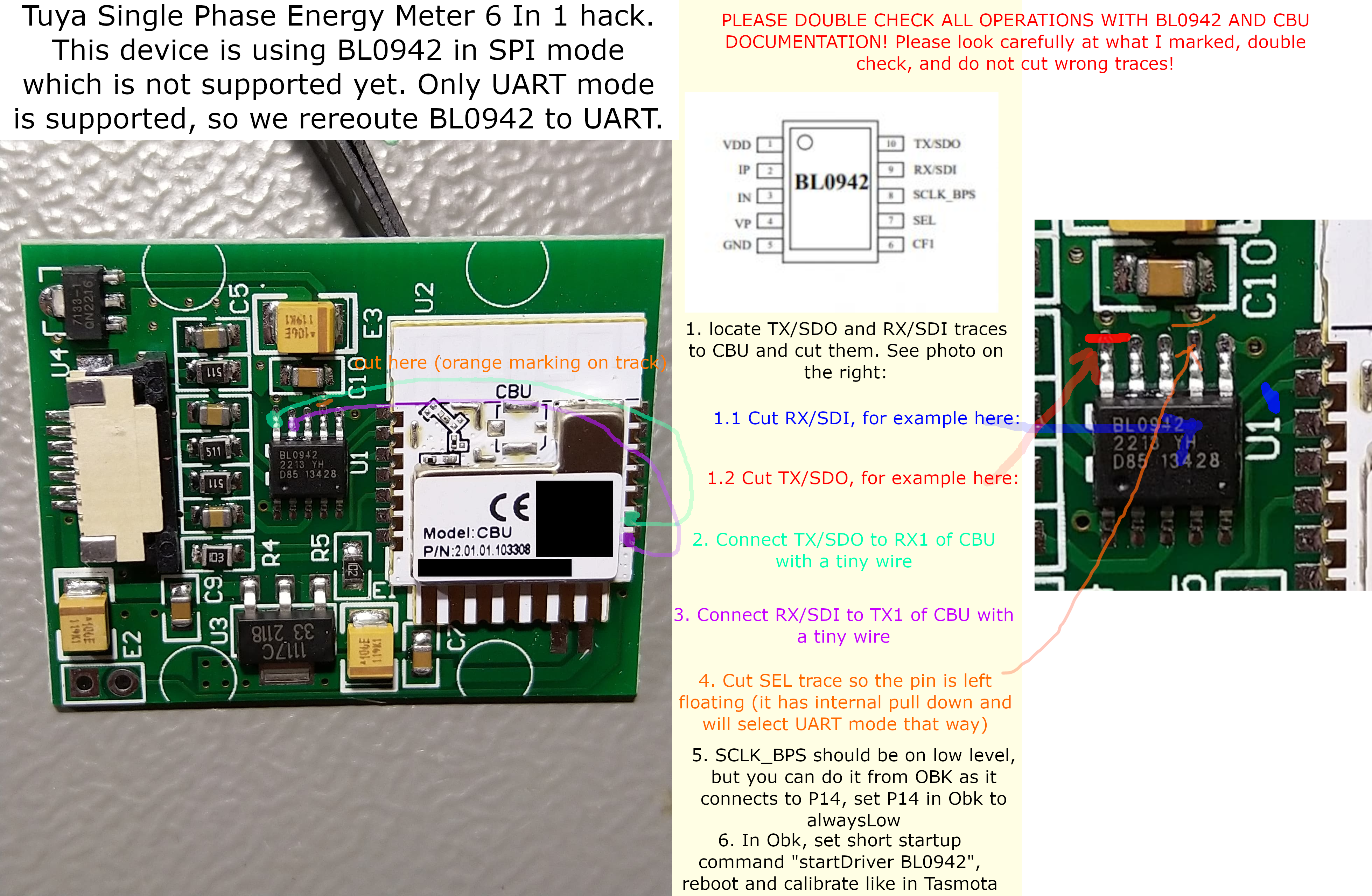

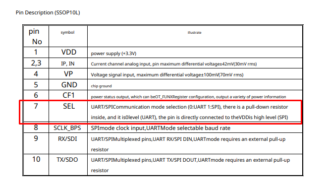

    You have marked both sides of E3, which is impossible under normal circumanstances. You must still have a short on that board.
    Still, judging from the documentation, SEL should be on VDD on your device:
    Tuya Single Phase Energy Meter 6 In 1: CBU Chip Flashing & ESPHome Integration Issues
    While doing the modification, you will have to disconnect SEL from any signals (cut the trace), because there is a pull-down resistor
    inside, and it is0level (UART)
    Ok, I think we have enough information to know what you exactly have to do in order to put next device in UART mode:
    1. disconnect SEL trace (cut the trace before it connects to anything else, so SEL is 'in the air', but the internal pull down resistor sets it to 0 - UART mode)
    2. disconnect TX of BL0942 from old trace (cut it) and connect it to RX1 of CBU
    3. disconnect RX of BL0942 from old trace (cut it) and connect it to TX1 of CBU
    4. Don't do anything about SCLK_BPS, this is for baud rate selection and it connects to P14. You can set P14 to "AlwaysLow" in our software to put logic 0 and SCLK_BPS and choose 4800 bps
    5. Then, go to Options->Short startup command, enter "startDriver BL0942" and reboot. You should get some readings.
    It is hard to say more without having direct access to the device, but these steps might be enough to get it working. You don't need any firmware changes from our side.

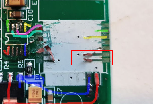

    I will try, but the problem is it's hard to do full guidance remotely. When I have board in front of myself, I can do all the probing very quickly, it's really a 15 minutes business. But remotely.... well, it's hard.
    I have also one more question, before we start the operation.
    Do you know what are those two traces?
    Those traces are supposed to be RX1 and TX1 of CBU module. The same port that we used for programming.
    I am asking because if we're going to reroute BL0942 to that UART port, it would be good to know that UART port is not in use. If it's in use, then we also must think how to solve it.
    Where are those two traces going?

    For now, use that old broken device.
    Show me where those two marked traces are going.
    It is easy to do when you have a board in hand, where do they end up on the other side of the board?
    You can also check with multimeter.
    They certainly lead somewhere...
    I am asking because those are UART signals that will be needed by BL0942. If there is something extra on those signals already, like a button, or a LED, then it must be removed...
    Wait, maybe it's a false alarm, they just go to RX and TX pads, right? Nowhere else?
    Please confirm, if yes, then we're ready to go and I will give you my guide...

    They go nowhere.
    They are not connected to the BL0942 and also do not connect anywhere on the ribbon cable.

    That;s good, ok I will draw you an instruction.
    But again, I emphasize, you must double check my proposed steps with docs (make sure that I didn't confuse pins).
    Ok, drawing, wait..

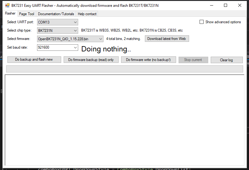

  • BK7231T/N easy GUI flasher with automatic backup and write
    #79 20362181
    Posts: 14754
    Rate: 12876
    I was referring to @TurkeyMan device IP.
    SPI won't be here too quickly, I would need to first find some kind of SPI device in my drawers to get the basic SPI running, and then proceed to BL0942 support.
    And today I will be most likely busy with releasing BK7231T/BK7231N Easy Gui Flasher:
    Spoiler:

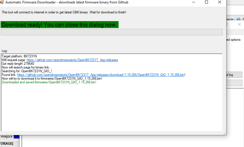

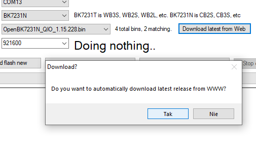

    This tool can run on modern Window machines with no Python installation required, no command line, and with everything user-friendly.
    It can automatically download OBK binary and does all flashing automatically as well, user just have to select N or T version, no command line, no offsets, etc anymore.
    Futhermore, it does automatic read (backup) of original firmware and then OBK firmware write.

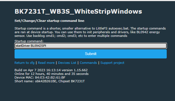

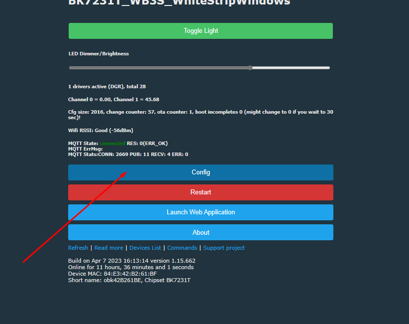

    It seems that the first step is to put startDriver BL0942SPI in the short startup command and reboot. Then check, are you getting anything on GUI?

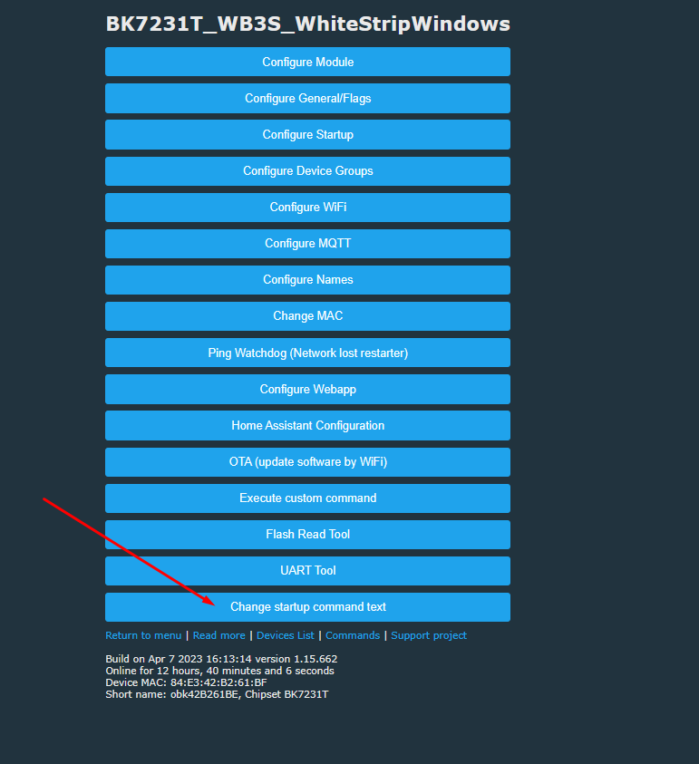

    Ah, sorry, so you haven't got the startDriver BL0942SPI command yet?
    You can enter it here:
    and reboot

What command starts the BL0942 power-meter driver in SPI mode?
Add startDriver BL0942SPI to Short Startup Command and reboot. Readings appear instantly in the UI [Elektroda, p.kaczmarek2, post #20535543]
