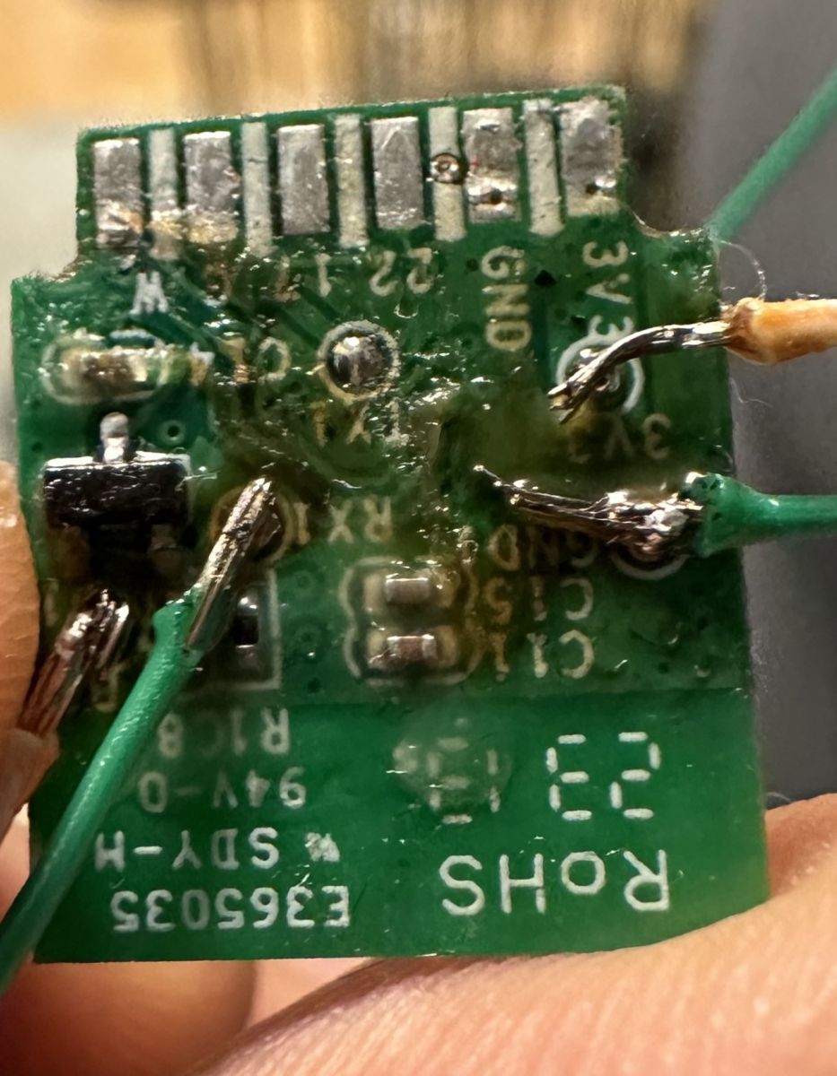

    #36 20731810
    viol_ten0q
    Posts: 14
    Hmmm why not just desolder the whole board? We have tutorial where we've desolder the module of the same shape... not BL602 but physically the same board:
    Oh I did desolder the whole board out... the board was attached to the plug terminals by solder. It didn't help me get access to the pads on the back though by the way it was set up.
    I was able to solder 5 wires (4 in the picture - pls don't judge me on the solder job :) ) to the back side of the module, now I likely need to solder two wires to the bottom of the module for power and ground since the ones on the back will be used to set boot pin to high?
    I also realised that I don't have a USB to TTL adapter so I want to order some from Aliexpress. Do you have a suggestion as to which one should I get?
    Close-up of a circuit board with soldered wires and pin labels.

    #37 20732063
    Posts: 14797
    Rate: 12954
    I am not sure what do you mean - you need to solder 5 wires in total, there is no need to solder VDD and GND twice.
    I am using CH340, the one with voltage levels selection

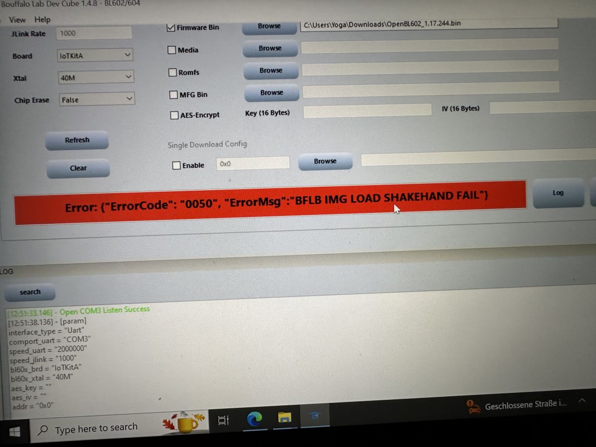

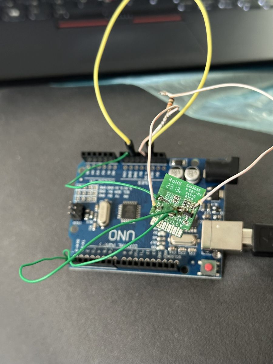

    #44 20732952
    viol_ten0q
    Posts: 14
    Well, there are other options, if you are in hurry. Do you maybe happen to have Arduino or NodeMCU available? That could be used as USB to UART bridge.
    Nice. I was able to use Arduino as the usb-ttl adapter but now getting errors trying to flash the chip using bldevcube
    attaching pictures of connections and log from the utility.
    Screenshot of Bouffalo Lab Dev Cube software showing BFLB IMG LOAD SHAKEHAND FAIL error. Close-up of an Arduino board with wires connected to a small electronic module. Arduino with connected USB-TTL adapter and wires against a keyboard background.
    I have made sure using continuity check that all the wires are attached as they should be.
    • log.txt (6.88 KB) You must be logged in to download this attachment.
  • #45 20733220
    Posts: 14797
    Rate: 12954
    I am not BL602 expert but I get that error when connection is wrong. So...
    - try to swap RX with TX
    - make sure that Boot is pulled high when you connect VDD (if you connect VDD first, and then pull boot high, it won't work)
    - try lower baud rate
    - try to shorten your wires
    - make sure that 3.3V is connect to the chip (if there is no power, it won\'t flash)

    #46 20733239
    viol_ten0q
    Posts: 14
    So, I broke one of the chips when I ripped the boot pad off so that went in the trash. I disassembled another same model ewelink plug and soldered wires again.. this time I was able to do it without having to take the module out.
    - Tried swapping rx and tx as there were suggestions on this forum elsewhere to do so.. didn't work.
    - I have taken off the insulation of the 3v3 wire in the middle and connected it BOOT wire with a 10k resistor in between, so a single wire goes into 3v3 in Arduino. That is correct, yeah?
    - lowered baud rate to 57600 as suggested by some PineCone forum
    - I shortened the wires by a few cms for the soldering on the new chip
    - didn't get you there.. how do I ensure that? If it helps, 3v3 on module is connected to 3v3 on Arduino and the chipset's LED is blinking.
  • #47 20733249
    Posts: 14797
    Rate: 12954
    is the Atmega on Arduino put into RESET state?
  • #48 20733259
    viol_ten0q
    Posts: 14
    Yeah I connected RESET with GND as was mentioned in the guides to turn Arduino to USB-TTL adapter. I guess I will have to wait for the proper TTL converter to give it another shot...

    Posts: 14797
    Rate: 12954
    Hmm... disconnect boot from VDD, then reconnect power. Are you getting anything on UART? You should get a debug log from original BL602 firmware.
