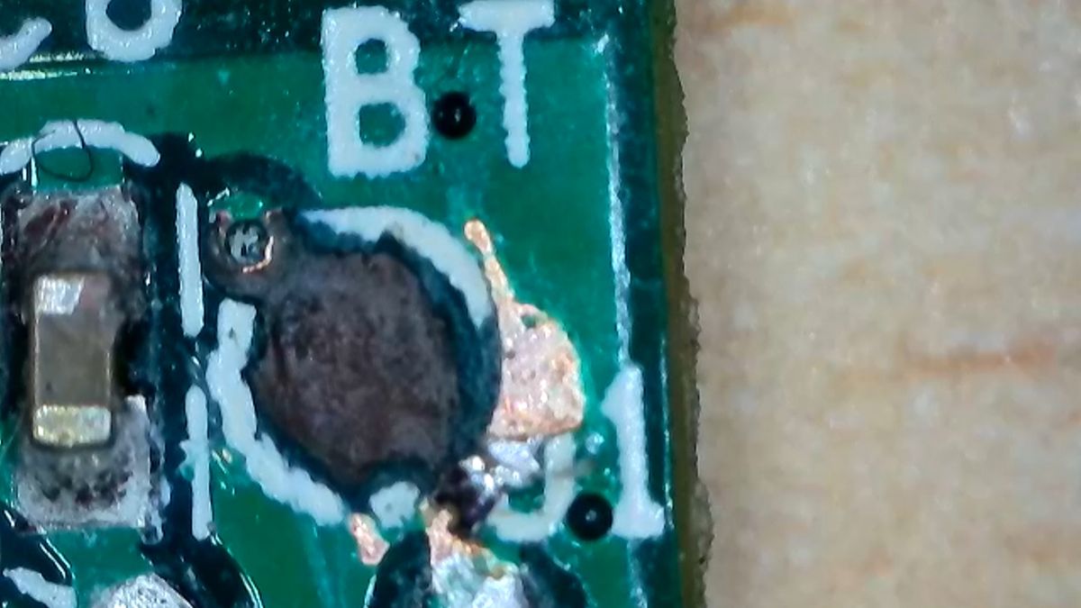

    i have accidentally remove pin. i've scratched pcb but i'm not sure is good

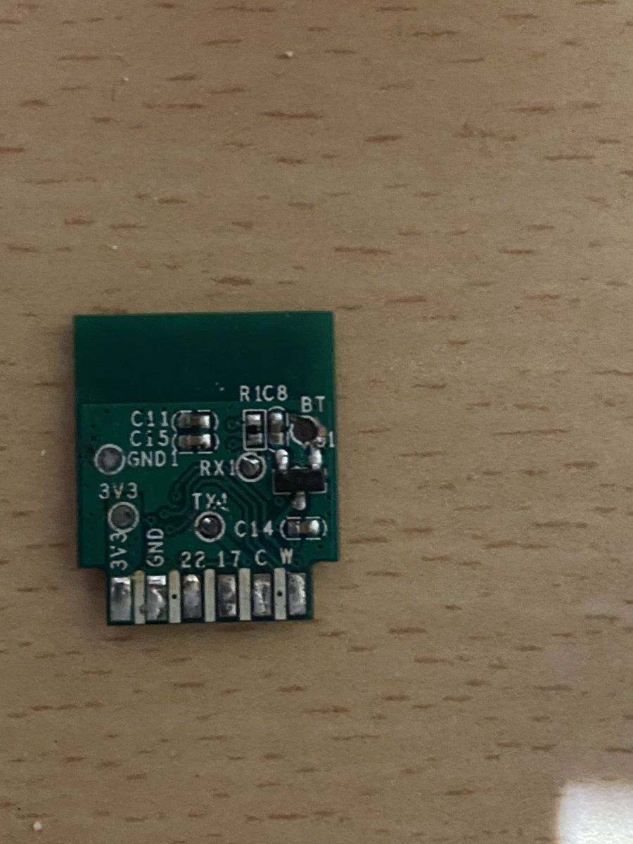

  • #63 20910031
    atomiquepingouin
    Level 4  
    Posts: 10
    yes i have IPA (but i don't like beer /j). Close-up of a small green circuit board with electronic components. Close-up of a circuit board with markings B and T.

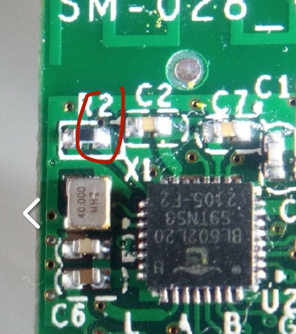

  • #65 20912543
    atomiquepingouin
    Level 4  
    Posts: 10
    I come from France. Do you think I can solder directly on R2? Close-up of a PCB with the R2 component highlighted.
  • #66 20912564
    Posts: 14797
    Rate: 12954
    Hey, so that's the same trace that's BOOT pin? Of course you can. This is a very good solution, I must admit I have assumed that there are no futher solder points when I read your message.

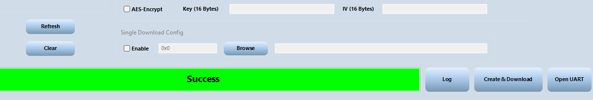

    atomiquepingouin
    Level 4  
    Posts: 10
    thanks for help Software user interface with Success message.

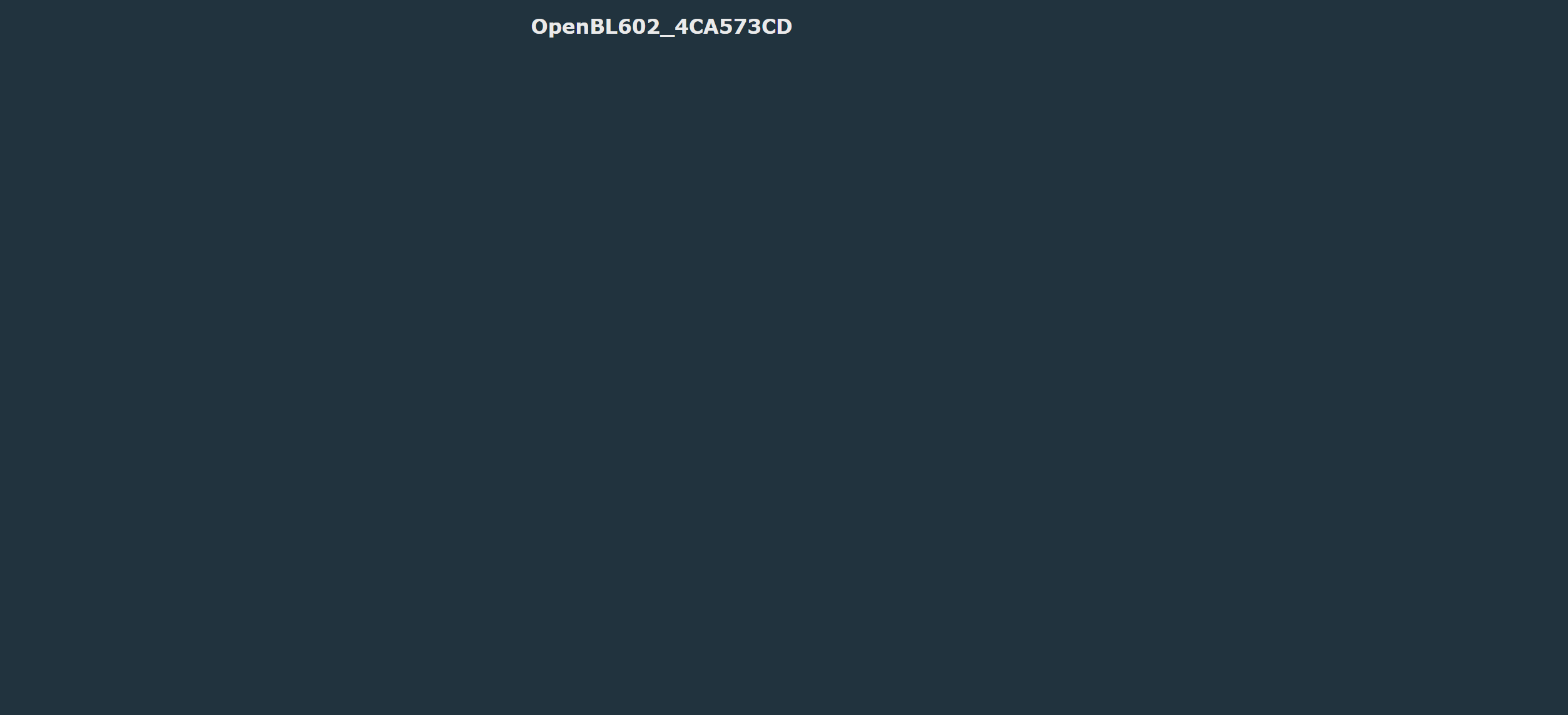

  • #72 20916727
    atomiquepingouin
    Level 4  
    Posts: 10
    yes i use web application Web application interface for configuring the Elicvo WiFi plug with a list of devices and pin settings.

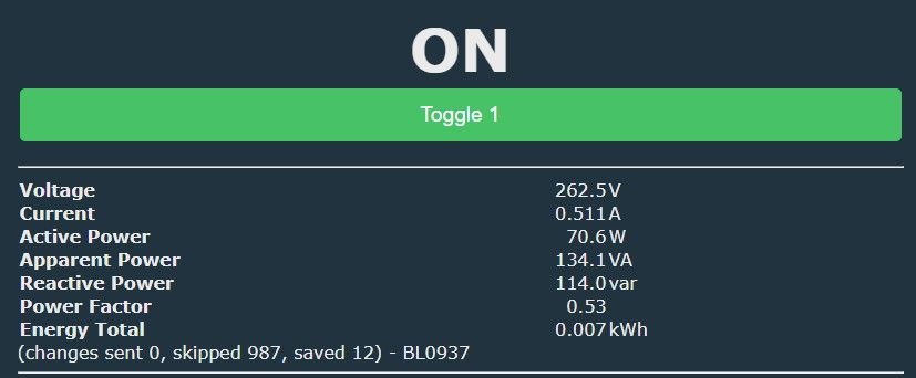

  • #77 20923215
    Mad_Maxs
    Posts: 81
    Currently 1.17.421 version of OpenBL for 602 support BL0937. Thanks everyone, who make it happen :)
    Screenshot of a user interface showing the on state with energy information for device BL0937.
  • #78 20923291
    Posts: 14797
    Rate: 12954

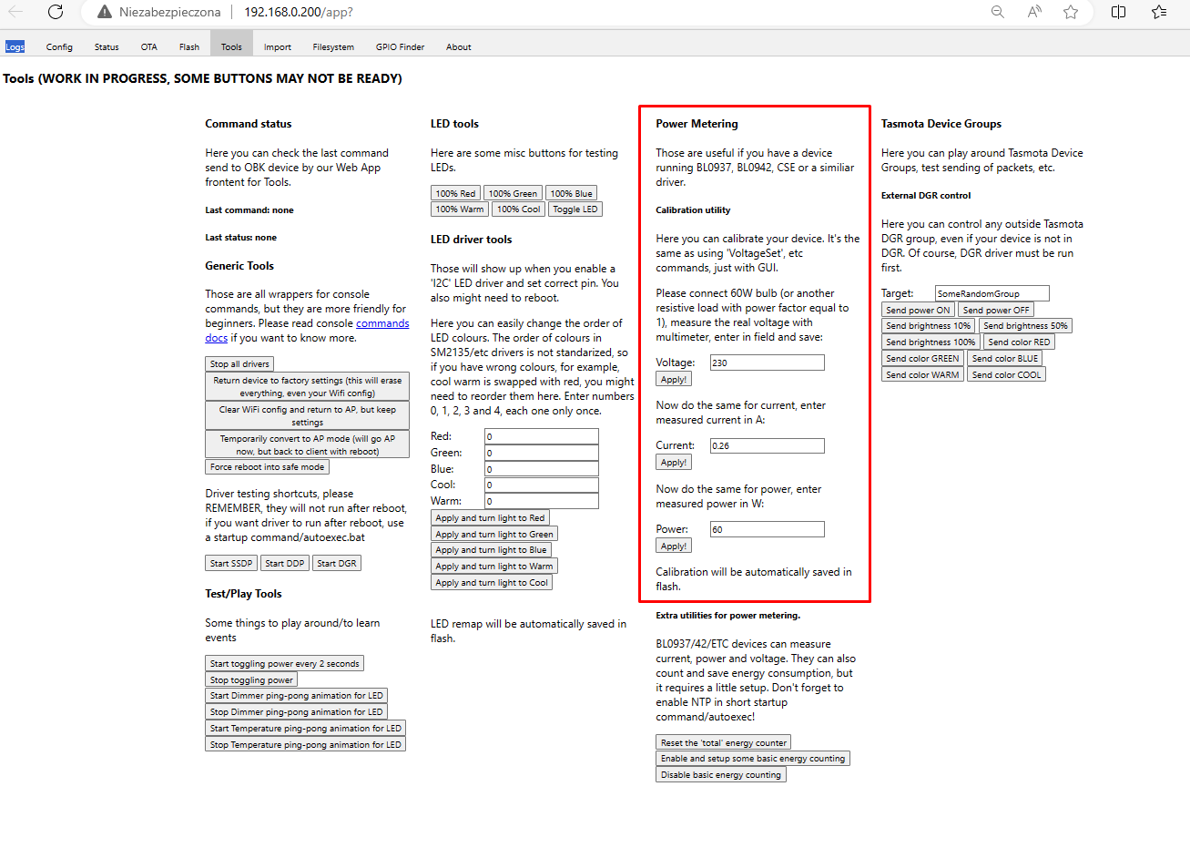

    How accurate is it? I see you have 260V AC, I think you need to calibrate it first.
  • #79 20923500
    hojnikb
    Posts: 45
    pretty inaccurate both in terms of current and voltage. Mine showed 265-270V while being 235V, amps were off by at least 10-15% too.
  • #80 20923577
    Posts: 14797
    Rate: 12954
    Yea, but did you calibrate? This is a necessary step. Calibration is done like in Tasmota, via VoltageSet, etc, commands, but you also have a GUI wrapper for that at Open Web App -> Tools Tab, here:
    Screenshot of a configuration interface for power metering tools with a calibration section.
    So let me ask you again - did you calibrate your devices, guys? @hojnikb @Mad_Maxs
  • Calibration required for accurate BL0937 readings
    #81 20923833
    hojnikb
    Posts: 45
    Yep, absolutly, did a calibration via resistive load (halogen lamp) against a decent power meter. Now it's showing almost bang on.
    Of course i didn't :) that's why it shows 260V. After calibration, looks like measuring is correct
  • #83 20924653
    Posts: 14797
    Rate: 12954
    Calibration is necessary to get useable results. All those devices are calibrated per-piece in factory.

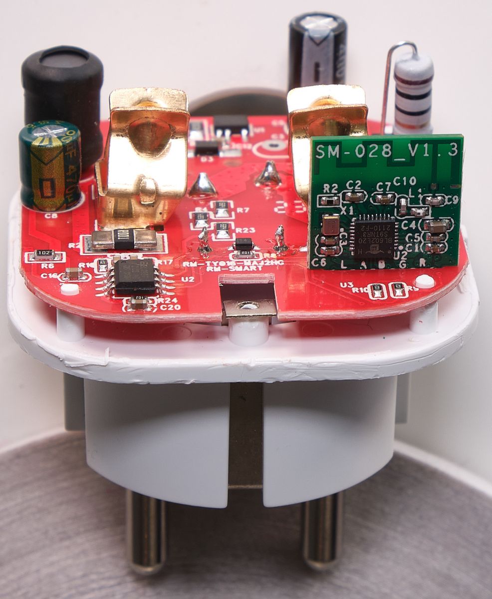

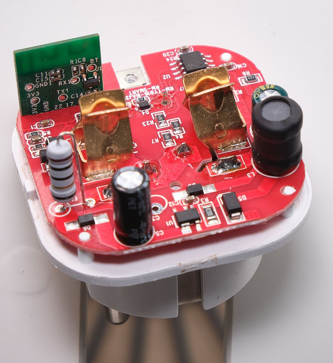

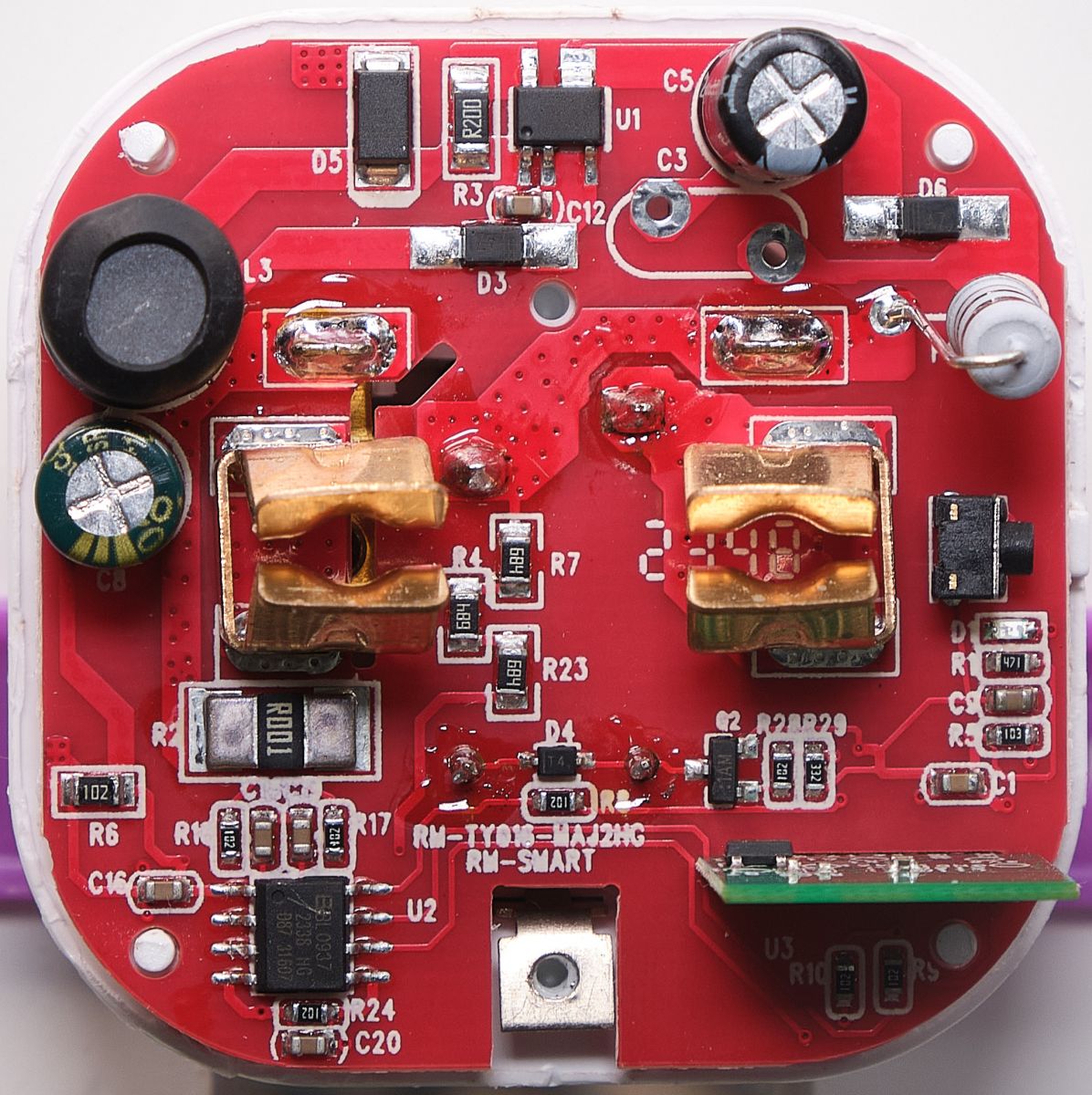

    #85 21016900
    Raufaser
    Posts: 47
    Rate: 16

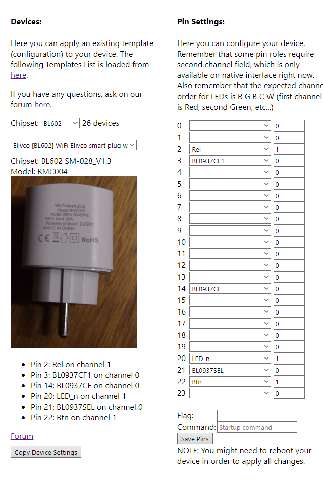

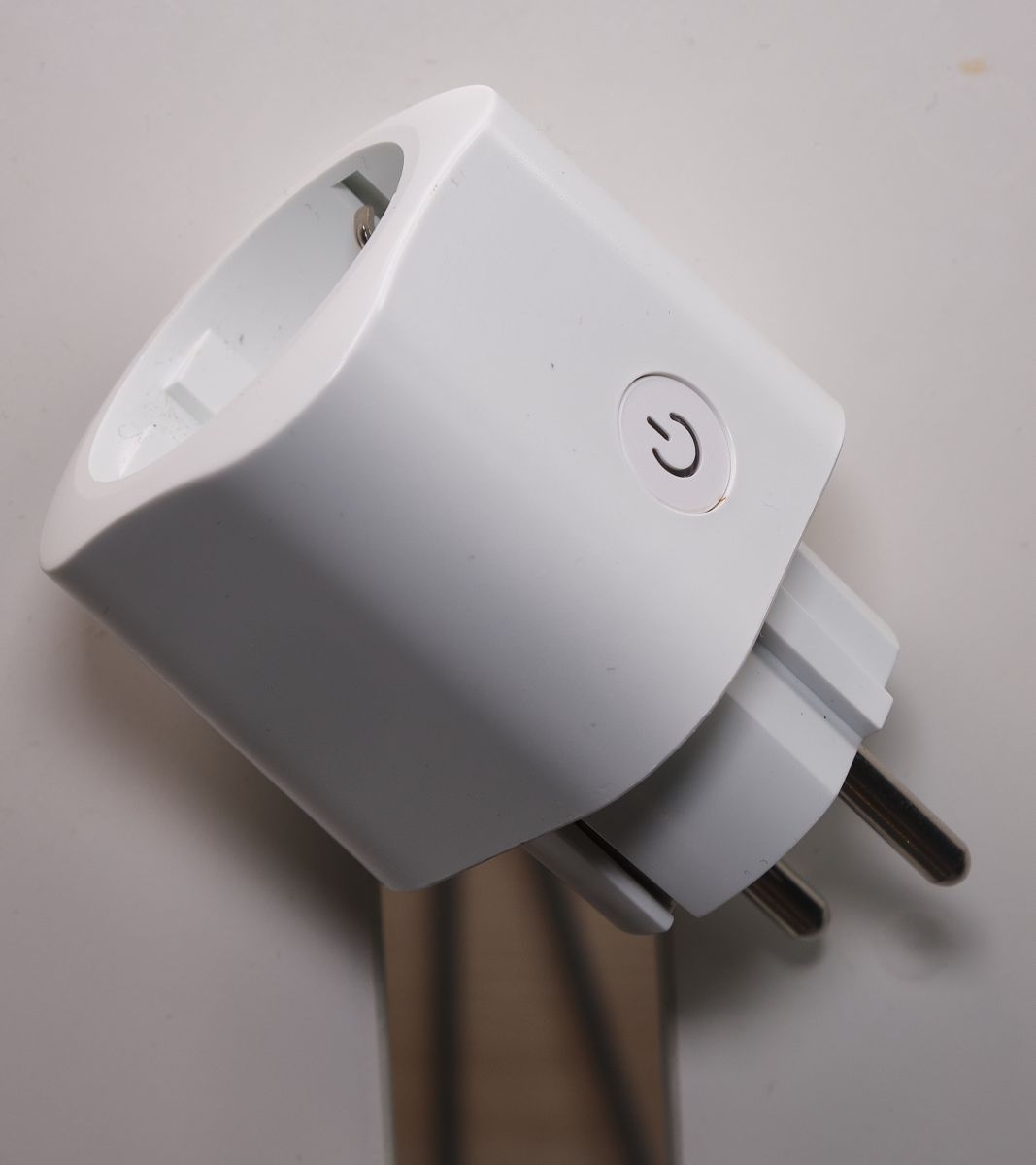

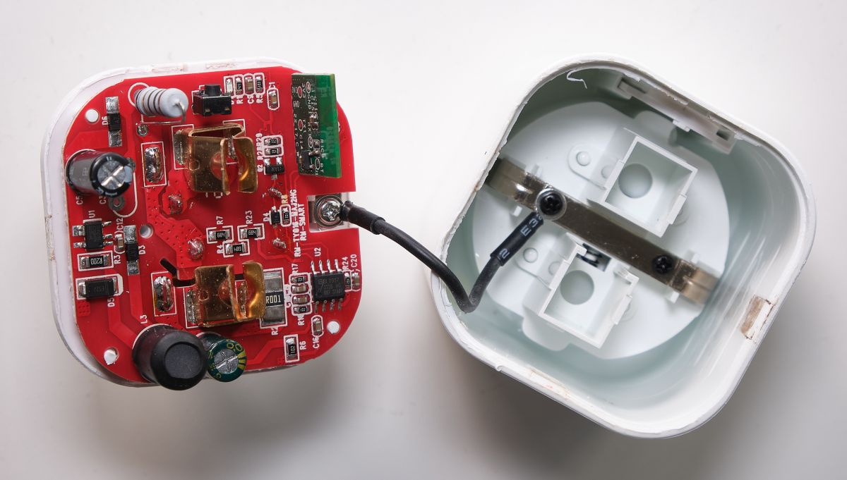

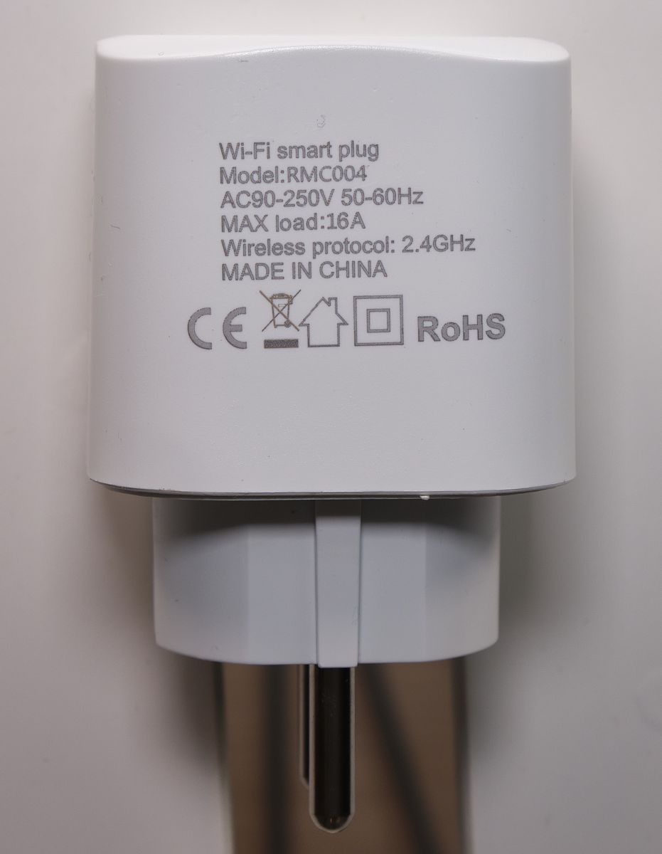

    I got an RMC004 with BL602 from Aliexpress. But it has red main PCB. I guess a different revision. There is for example C3 missing on my board. So I thought why not take a few pictures and document my way to flashing the smart plug:
    Smart plug with power button at an angle. White Wi-Fi smart plug with model RMC004 markings.
    Unscrew the neutral cable from the PCB holder:
    Red PCB with relays and electronic components inside a smart plug housing. Red RMC004 circuit board with electronic components.
    Beautiful views of the communication PCB in its place on the main PCB:
    Close-up of a red circuit board with electronic components and relays. Close-up of a red PCB smart plug labeled SM-028_V1.3 with attached electronic components.

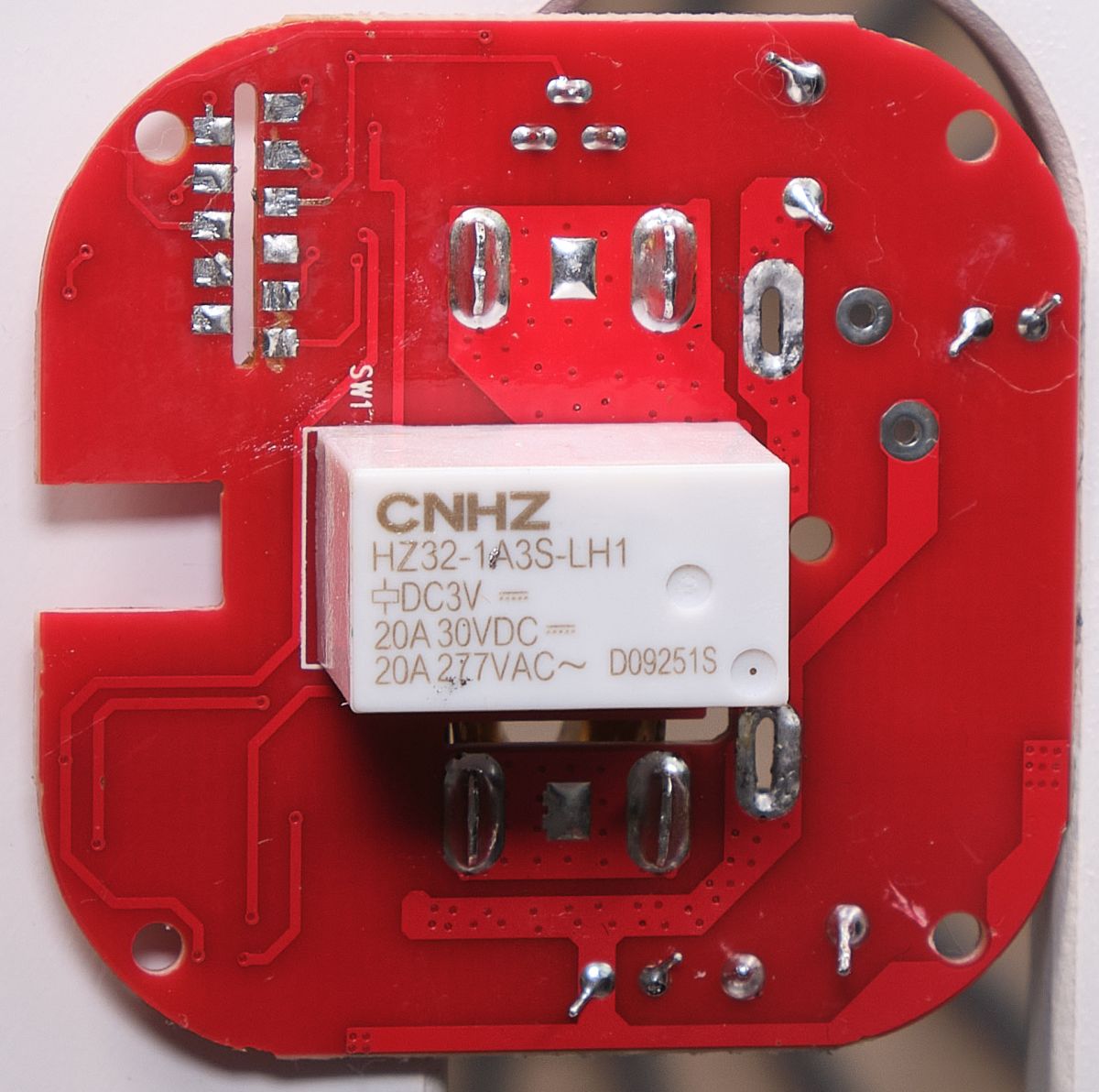

    Desoldering the main PCB from the PCB-Holder/Plug lets you view the relais:
    Red printed circuit board with a component labeled CNHZ HZ32-1A3S-LH1.
    It's always nice to have a 20A relais in a 16A socket :)

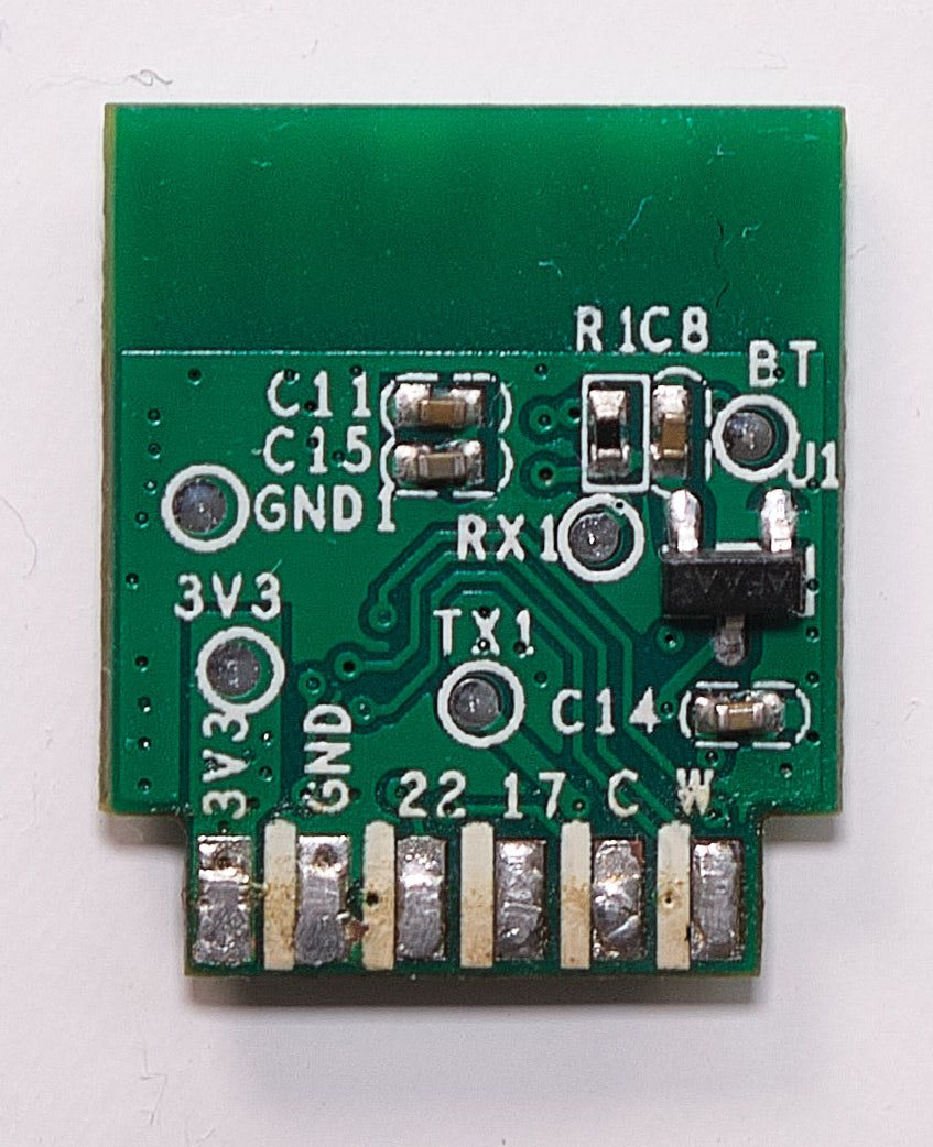

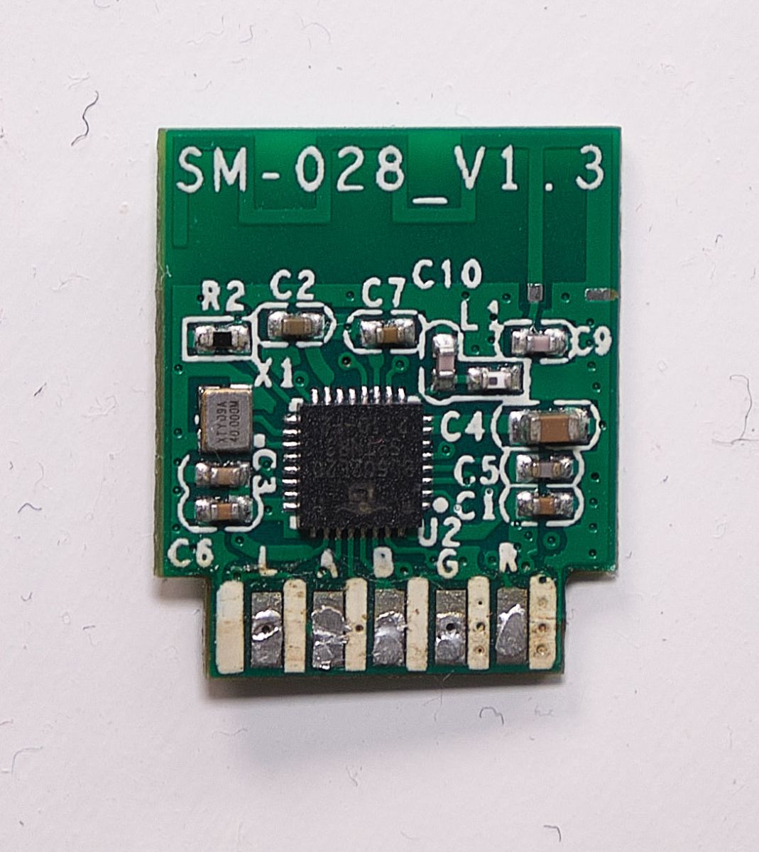

    And here is the BL602 board:
    SM-028 circuit board version 1.3 with electronic components. BL602 PCB with component markings.

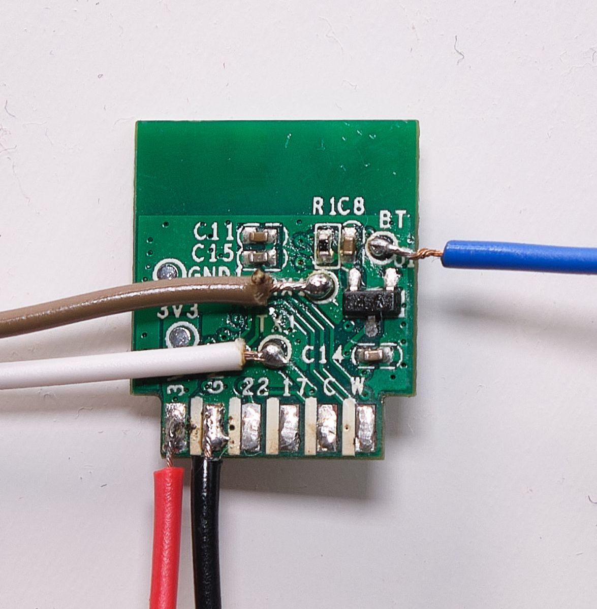

    And this is how i soldered the wires to flash this little guy:
    Close-up of a BL602 PCB with soldered wires.
    The only special thing is the blue wire must be pulled high. In line with 10kOhm to 3,3V
    Before I flashed OpenBeken i dumped the original firmware using this tool.
    BL602_0x10...150000.zip (554.75 kB)You must be logged in to download this attachment.
    Flashing worked like normal. And here is my config:
      "vendor": "Tuya",
      "bDetailed": "0",
      "name": "Wi-Fi smart plug",
      "model": "RMC004",
      "chip": "BL602",
      "board": "SM-028_V1.3",
      "flags": "1024",
      "keywords": [
        "power metering",
        "smart plug",
        "bl0937"
      "pins": {
        "2": "Rel;1",
        "3": "BL0937CF1;0",
        "14": "BL0937CF;0",
        "20": "LED_n;1",
        "21": "BL0937SEL;0",
        "22": "Btn;1"
      "command": "backlog startDriver BL0937; startDriver NTP",
      "image": "https://obrazki.elektroda.pl/8014289700_1711242720.jpg",
      "wiki": "https://www.elektroda.com/rtvforum/viewtopic.php?p=21016900#21016900"
