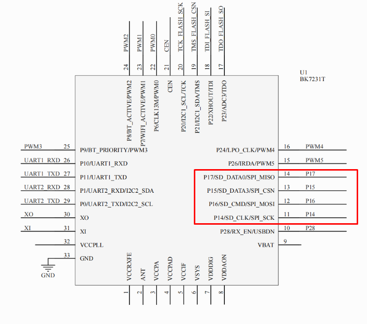

    Good news: Finally I got it to work with SPI!!!
    I still have to do some code clean up and have a look, that it still compiles with the T version, before I can do a pull request.
    Would you add a driver bl0942_spi or would you add an option to the bl0942 driver?

    Well, the beken_os SPI drivers did not work. I think the programmers started with the drivers but didn't finish them. And without haven documentation of the registers I spent a lot of time trying without success. I finally found the armino project. For the N version probably the best would be to port everything to armino or vise versa. But that sound like a lot of work. Thus I ported the armino SPI driver to the current project. I will do pull request, when I cleaned the code a little bit more.
    There is a design flaw with calibration data/functions being repeated in BL0937 and BL0942 drivers and I was planning to fix that soon.
    I haven't looked into the BL0937 driver yet, thus I cant tell if combining them into one file is better or extracting same functionality into a separate file. Maybe you already have plans.
    Is it working over SPI now?
    Yes. I have now the same functionality as the uart driver. Currently it is hacked into uart driver. Thus SPI is working but uart not anymore.

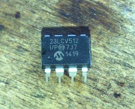

    I am really curious to see how your SPI code works. With SPI interface, we could even attach external memory and use it to, for example, store measurements data or host larger pages on LittleFS.

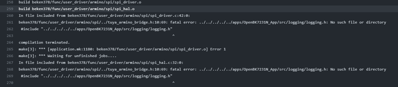

    I have merged your changes, but there seems to be issue with paths. Can you resolve it, even by adding a logging declaration to your source file or with some other simple kind of work around?
    [BK7231N / CBU] PZIOT-E01 DIN rail pass-through energy meter
    We don't have a standarized way of calling OBK functions from within SDK, we usually assume that SDK is not OBK-aware.
    Or should I fix it myself?
    I would totally assume that. When I added the logging and logging include the SPI didn't work and I tried to debug with that. I didn't realize, that I used the OBK logging in the SDK and also forgot to remove it.
    As it is working now we don't need that logging and you already fixed it. Thanks.

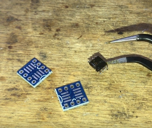

    If I were to try it myself, I would just try to use existing BK SPI driver, the one with "ddev_open" etc...

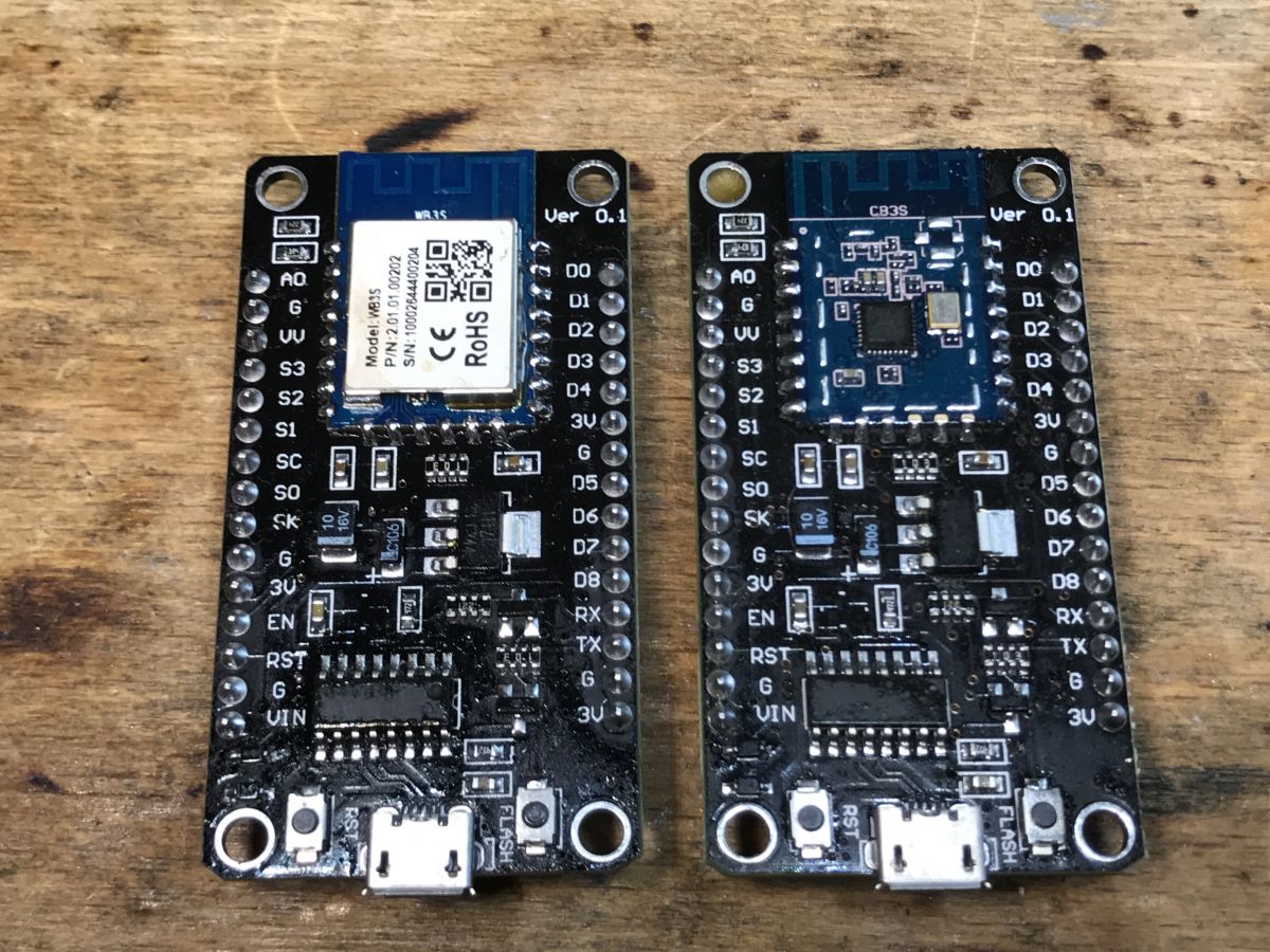

    In a meantime, I have acquired two dev boards - one with WB3S, and one with CB3S:
    I will show more about them in our upcoming Youtube video, remember to keep an eye on our channel. Those will be super helpful, they were built specifically for testing!

    So far I've found this SPI RAM device in my parts bin:
    I've also took my time to get that SPI Flash chip from old Acer notebook:
    However, I seem to have run into a small but a very unfortunate issue. As you can see, P14, P16, P15, and P17 are required for SPI communication:
    P9 - BL0942 - CF1
    P14 - BL0942 - SCLK_BPS
    P16 - BL0942 - RX/SDI
    P17 - BL0942 - TX/SDO
    so I can connect it to, for example, flash memory.
    The problem is, the WB3S and CB3S boards doesn't seem to have those pins routed out!
    https://developer.tuya.com/en/docs/iot/wb3s-module-datasheet?id=K9dx20n6hz5n4
    https://developer.tuya.com/en/docs/iot/cb3s?id=Kai94mec0s076
    It seems I will have to find CBU module in order to at least test the SPI.

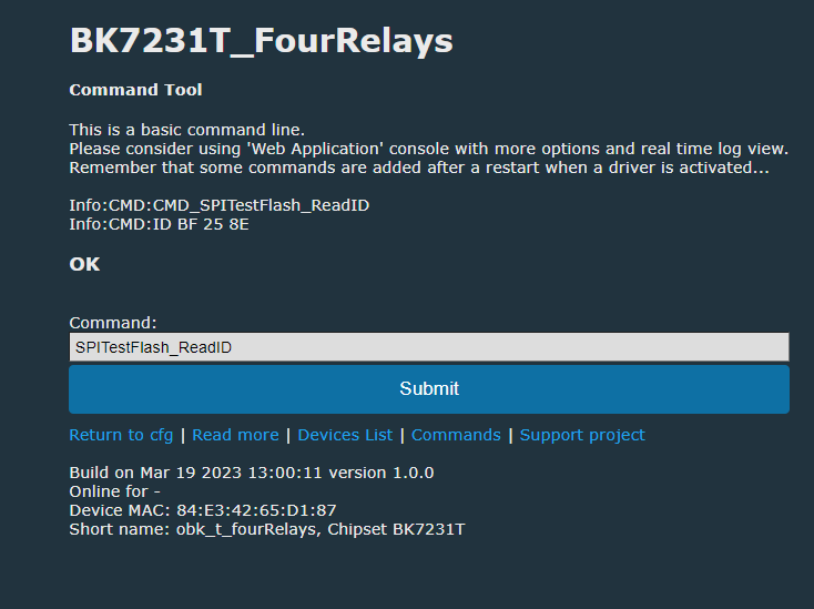

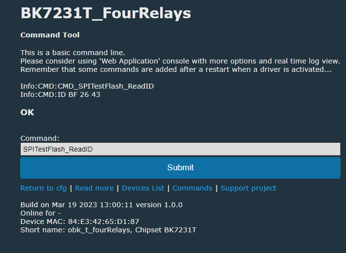

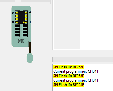

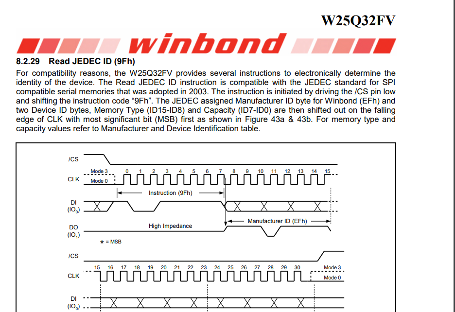

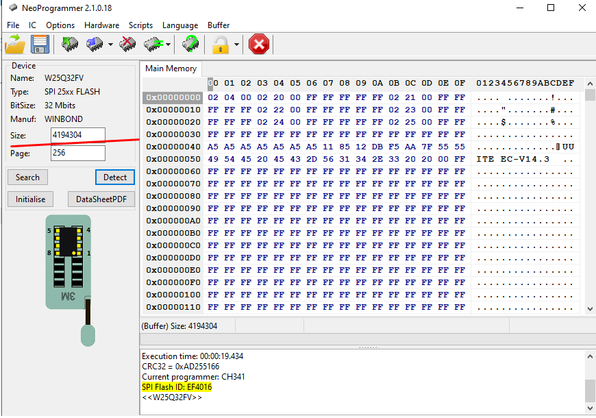

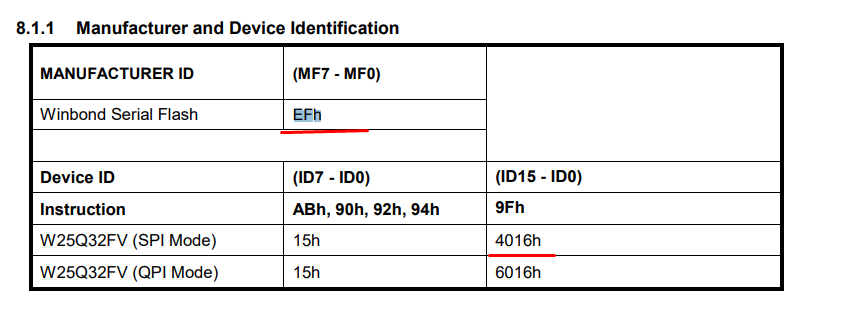

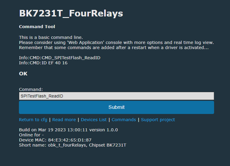

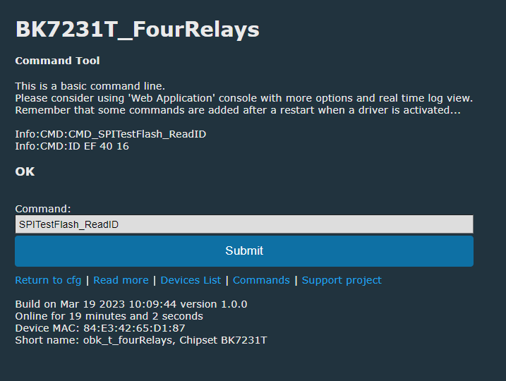

    @Digga, I have looked into software bit-bang SPI. The core protocol is very, very simple. I have basics working on Beken, but there is some kind of instability issue.
    I am testing on 25Q32FV-Winbond
    I have implemented commands: 8.2.29 Read JEDEC ID (9Fh):
    It works almost all the time:
    That one is correct:

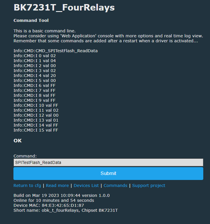

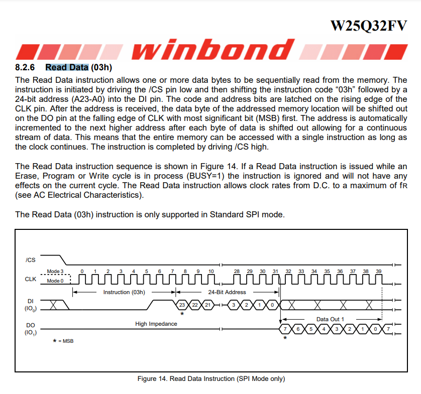

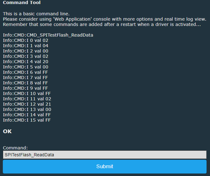

    I also added read command:

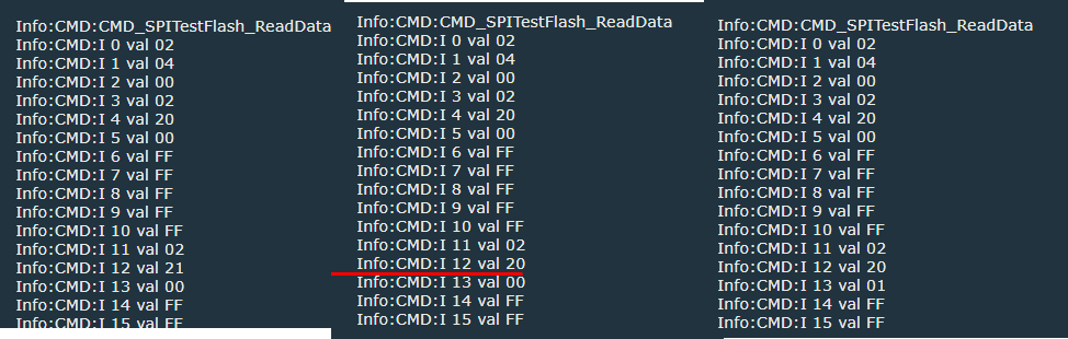

    It mostly works:
    but one in five times, there is a wrong bit or two?
    Screenshot showing the Command Tool displaying SPI test results.
    I will push current version of my code, for the reference.

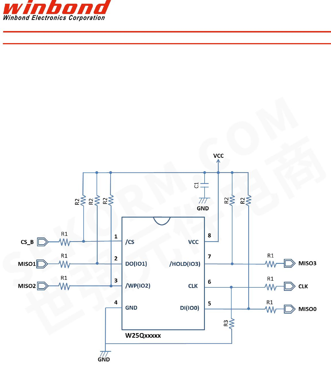

    EDIT: Maybe it's because I made my connection too simplified, here's a recommended schematic from docs:

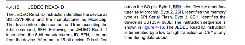

    Test with SST25VF080B:

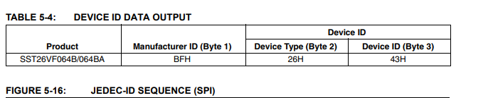

    Test with SST26VF064B:
    interestingly enough, the capacitor on CLK was required for two Microchip memories, not for Winbond, but Winbond was still unreliable without it

    Here's my current test setup, I have also IR receiver and DHT11 because I am going to do a clock project in the following days:
    Strangely enough, my MAX7219 driver seems to be working these days, while I still remember it wasn't working for me when I first tested it and ported my PIC18F code... maybe I had a connection error back then.
    The dev board on the photo is WB3S.
