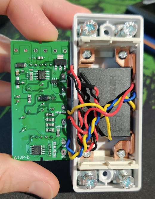

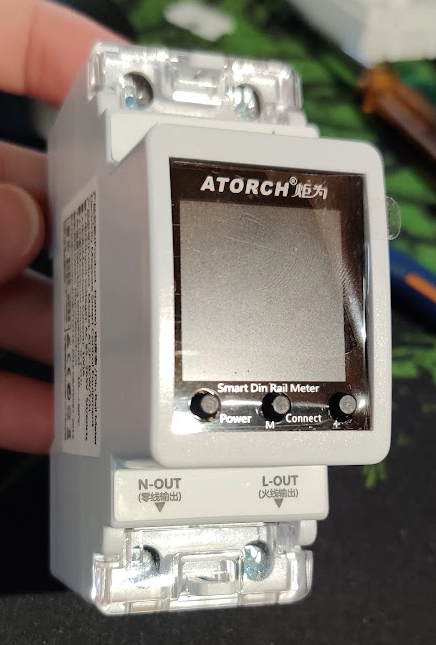

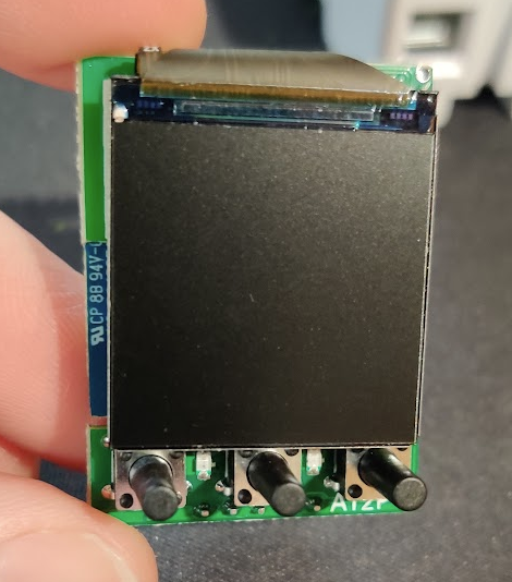

    Teardown of this energy meter from AliExpress.
    [BK7231N / CB3S] HiDANCE AT2P - "HD Color Screen" DIN-rail relay/energy meter [BK7231N / CB3S] HiDANCE AT2P - "HD Color Screen" DIN-rail relay/energy meter
    This looks like a very nice and full featured circuit breaker/energy meter called "HiDANCE".
    The build quality is excellent, and the screen looks very nice, and it has a complete set of features.

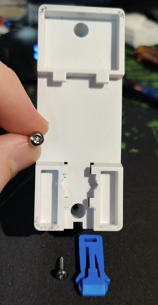

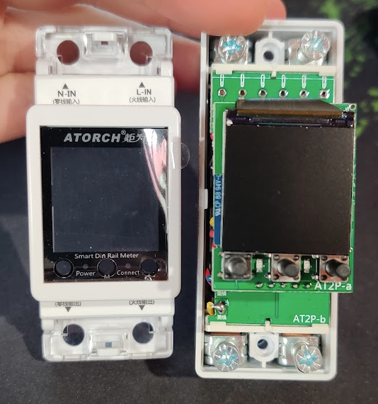

    Opening the device is simple, just 2 screws, except these are torx T10 screws... just for something different!
    I also had to cut the sticker on the side with a blade.

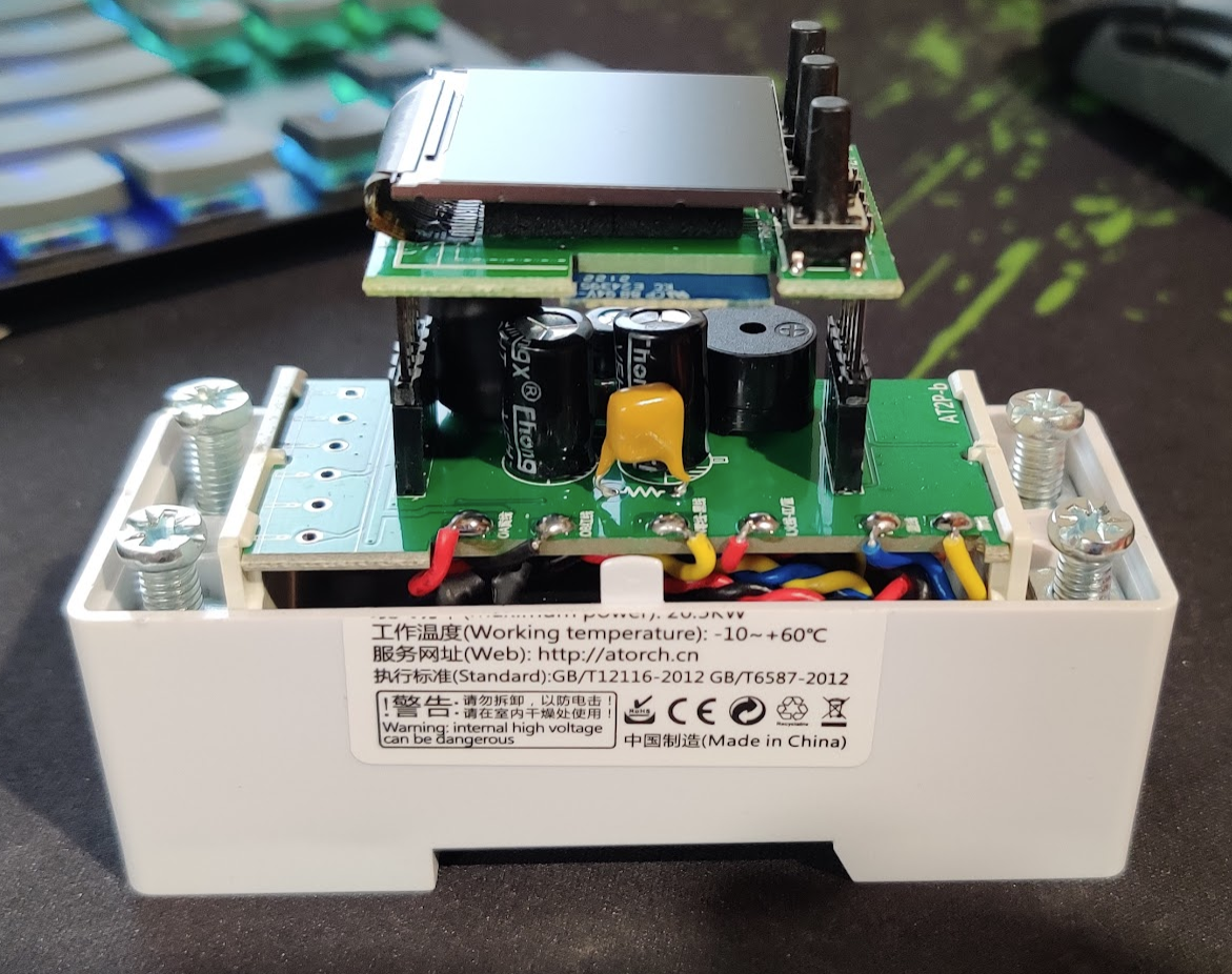

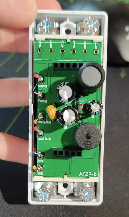

    Construction is very nice. The daughter board is conveniently connected with some pins, power electronics are arranged nicely, and this device even has a little beeper speaker thing to make audible alert noises!

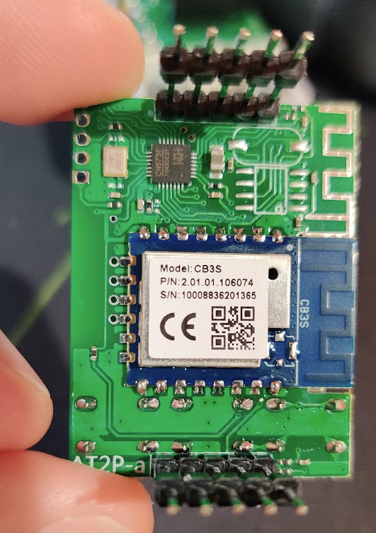

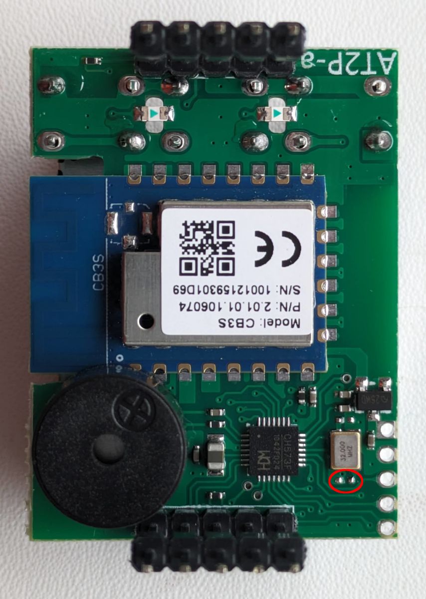

    The logic board is interesting. It seems to be using TuyaMCU, except it's using an extremely small SMD chip in a square package, connecting to the CB3S by UART as usual.
    There appears to be some unpopulated components; a rather large 8-pin chip is missing, and very strangely, there is a second wifi antenna printed on the daughter board beside the main antenna for the wifi module.
    I couldn't see the LCD driver chip, I think it's stuck under the display, but that's kinda glued down with some adhesive foam, and I didn't want to destroy it.
    Now the bad news...
    Trying to flash this device looks very challenging... the TX/RX tracks disappear under the wifi module, and lead directly to the tiny microcontroller. In order to flash this, the TX/RX lines will need to be cut somewhere... but where?
    The microcontroller is MUCH too small to attack with a soldering iron, and removing the wifi module completely is very difficult with a soldering iron; much easier with a hot air station!

    I turned it on to try and capture the MCU comms. As with other power metering devices, they always seem to detect that the mains power is disconnected, and the software just says "OFF" or something to that effect and there is no interesting comms.
    I figured I'd have to capture the comms while on mains power.
    To do this, I broke out TX/RX and connected the RX pin on the wifi module to the RX pin on my USB UART module to snoop comms from the Tuya->wifi... the instant I connected the wire, *POP*, the wifi module is very dead, there is now a short circuit from 3.3V to GND across the wifi module.
    It also destroyed my USB TTL device, and the USB bus in my monitor! >_<
    Thankfully it didn't destroy the USB bus in my PC which the monitor was connected to.
    So, that sucks! I guess there was a huge voltage difference between the UART pins of the 2 devices. I've sniffed several devices this way before, normally works. I'm not sure how the voltages could be so hugely different between the 2 devices?

    With mine I had to remove the wifi board in order to program the first 3 devices I got, with the next batch of 3 I just received I want to see if I can program it while holding the ch573 in reset (on mine there are 3 headers, 1 to the tuyamcu, 1 to the unpopulated 8 pin btle chip, 1 goes to lower 4 pins of wifi but are not programming pins)
    on the tuyamcu header there is spio/spiclk/reset/gnd/3.3v/5v for the ch573 chip with tuyamcu code
    the 8 pin unpopulated ic is for BPOX226 http://zh-jieli.com which is a ble uart/spi chip.
    what's also to note is the ch573 has btle as well as the c3bs module and you find a lot of units without bt support, lol

    For those wondering how to flash this device to OpenBeken, I figured out a way to disable the main MCU, and after that can flash CB3S without a problem.
    I've shorted two pads near crystal with a blob of solder, and this prevents CH573F from booting, and it no longer interferes with CB3S.
    AT2P-E PCB with CB3S module and marked soldering point.

  • CH573F shorted after CB3S replacement
    #24 21541047
    tdochev
    The error while reading the Flash:
    W: Unknown bootloader
    CRC - 0xEDA73627 - please report this on GitHub issues!
    E: An error has occurred
    E: ValueError: Chip CRC value 6255236F does not match calculated CRC value 52EFAA54 (at 0x0)
    E: |-- File "ltchiptoolguiworkbase.py", line 24, in run
    E: |-- File "ltchiptoolguiworkflash.py", line 75, in run_impl
    E: |-- File "ltchiptoolguiworkflash.py", line 189, in _do_read
    E: |-- File "ltchiptoolsocbk72xxflash.py", line 261, in flash_read_raw
    Reading with Ltchiptool 4.11.6, give this error.
    Tuya was not connecting with the other chip (red light for the WiFi was not ON), it was not detected... I don't know. I reset all that is possible from the menu on the device.
    Regarding the new firmware. I have created with ESP Home firmware but no AP is created, no connection to ESP Home, nothing. This is not the first device I am flashing but it is the first CB3S.
    EDIT: Severla days after this post.
    I have recived a new CB3S modul, I programed it without problem this time with the same setup as before. I have replaced the CB3S mobul on the main board. The Atorch device started but on the bood the display have started flickering and turned off. I first desoldered the CB3S and tested it was working fine, and after that I found out that the other chip HDM CH573F is shorted. The power consumption is going up to 150mA (the power limit I have set). So making it work has failed.

• Main MCU: WCH CH573F (8051 core, BLE, 32 kB RAM) [Elektroda, TurkeyMan, post #20365528] • Wi-Fi module: Tuya CB3S, BK7231N, 2 MB flash [Elektroda, TurkeyMan, post #20365528] • Default Tuya UART: 115 200 bps, 8-N-1 [Elektroda, xglooom, post #20907226] • Housing opened by 2× Torx-T10 screws + side sticker cut [Elektroda, TurkeyMan, post #20365528] • Isolated USB-TTL adapter: 3 kV (≈3 750 Vrms) galvanic isolation spec [Waveshare datasheet]
What chips are inside the HiDANCE AT2P/AT2PW energy meter?
The logic board carries a WCH CH573F 32-bit MCU that talks to a Tuya CB3S Wi-Fi module (BK7231N SoC). Pads for an 8-pin BPOX226 BLE chip are unpopulated [Elektroda, TurkeyMan, #20365528; Elektorda, crg1darkspr1te, #20366664].

How do I disable the CH573F so I can program CB3S in-circuit?
Short the two test pads next to the CH573F crystal with a solder blob. The MCU stays in reset, releasing the UART/SPI lines; CB3S then flashes normally [Elektroda, xglooom, post #20907226]
