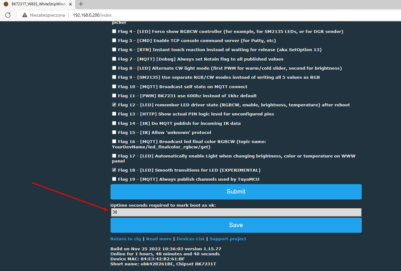

  • Lower safe-mode uptime threshold to 5 seconds
    #61 20429476
    Posts: 14750
    Rate: 12866
    minusync wrote:
    Currently, HA receives a signal about 4-6 times, but then, at least my sensor switches to safety mode and then stops transmitting any data. Such behavior has been repeatedly tested.
    Hey, do you mean that device is booting into safe mode because it had 5 reboots with uptime lower than 30 seconds?
    Then you can just change the uptime required to mark boot as safe there:
    BK7231N/CB3S Tuya generic battery powered temperature and humidity sensor with CHT8305 sensor
    Change to 5 seconds or something...
    Of course, that's assuming I understood you well. Does my hint solves your problem?
  • #62 20433752

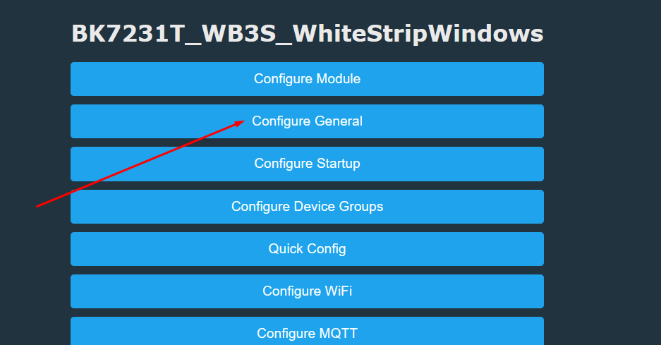

    minusync
    Posts: 57
    The sensor goes to safety mode without any obvious errors.
    Anyway , I will test it with a smaller boot uptime value.
  • #63 20433768
    Posts: 14750
    Rate: 12866
    @minusync it's obvious, you are most likely doing reboot before 30 seconds uptime passes, and device detects it as boot failure.
    Please change "time required to mark boot as ok" to something smaller, 5 seconds are so

  • Shorten boot-ok delay to 5 seconds
    #65 20443873
    minusync
    Posts: 57
    I tested with a smaller number and now the sensor seems to work. For some reason, rounding still doesn't work all the time. Periodically it shows numbers like 21.700000000000003 C.
    I should also ask how is the situation with displaying the battery status? Are there any options to do it?

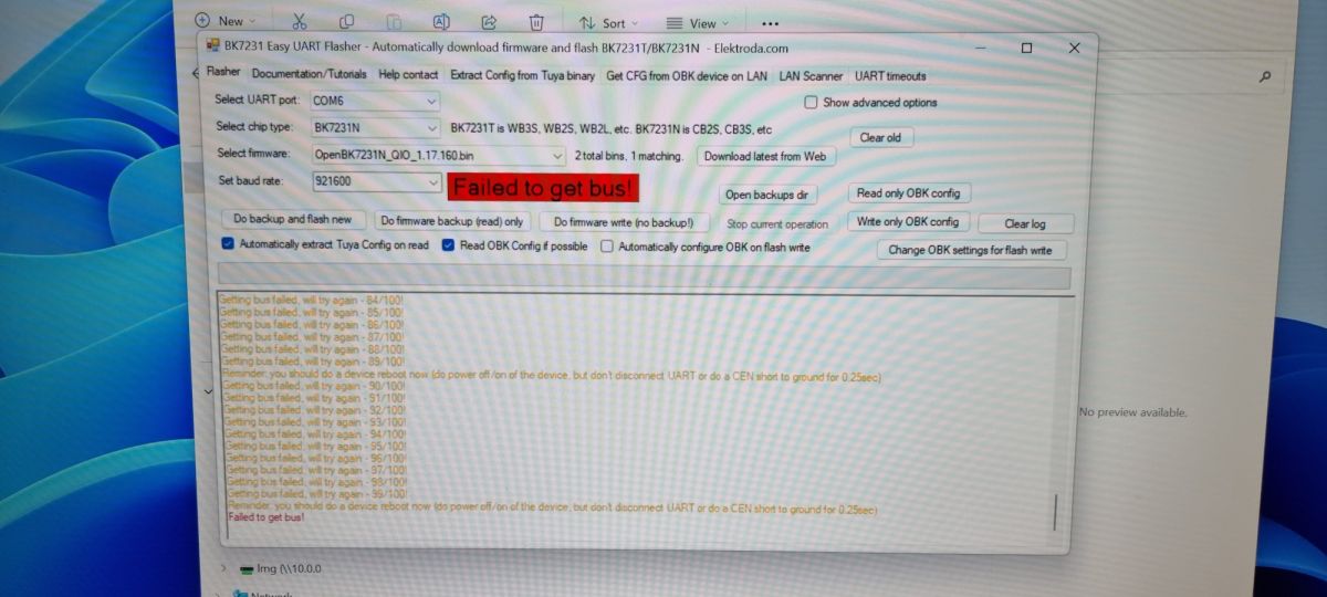

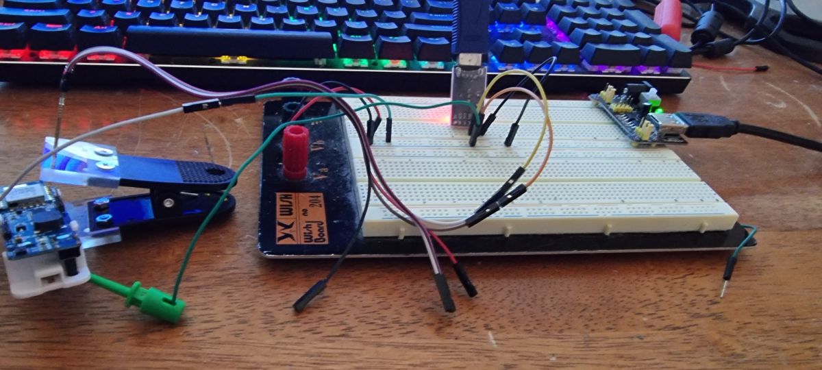

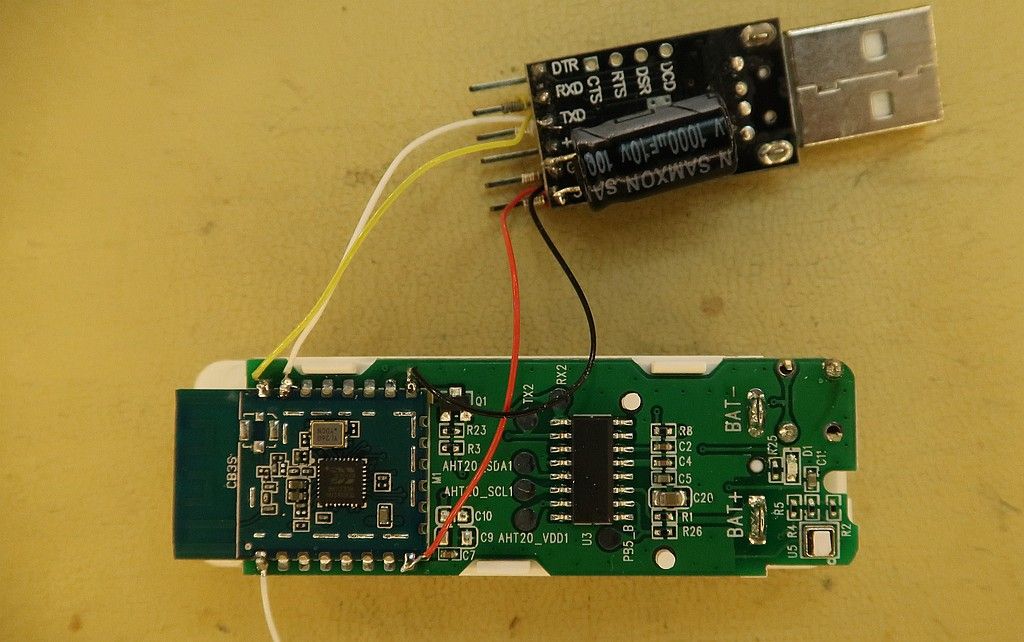

  • Faulty programmer or laptop causing serial port dropouts?
    #67 20473217
    Xinayder
    Posts: 24
    Realized I didn't post an update in some time.
    I got my new temperature and humidity sensor along with my door sensor that I bought from AliExpress (will make a teardown soon enough). However, I have the same issue I had with the previous module. I soldered the wires correctly this time (the temperature sensor has a 6-pin header so I can easily solder the wires there, and they are connected to VCC/GND/TX/RX), but after connecting the wires to my USB programmer, the GUI application on Windows would go crazy on the serial port dropdown, as if I was unplugging/plugging the programmer several times in a second. Disconnecting one of the VCC or GND wires from the module stops this behavior and the serial port shows up, but then I can't communicate to the device.
    Could this be a faulty programmer or the fact that I'm trying to run the GUI flash tool on my laptop?
  • Large capacitors can reset USB-to-TTL adapters
    #68 20475455
    Posts: 14750
    Rate: 12866
    @Kureigu if humidity goes up to 99, there is not much we can do. We don't have increment in our code, it must be what sensor sends. You can recheck now with latest firmware or ask @dheenhasty but it looks like a sensor issue to me.
    @Xinayder , are you using that on Windows? I have never seen such issue, maybe try with another USB to TTL dongle?
    Or wait...
    It could also mean that you have a short somewhere and the current taken by the device is too much for USB port and it resets.
    It could also happen with a large capacitor connected between 5V and GND, that's because such capacitors are taking a large inrush current just after being connected to power, and it overloads USB port briefly.
    I've been fixing that issue in the past by desoldering large electrolytic capacitors from smart device board and only in that case I was able to do power off/on cycle without USB to TTL resetting. I was not using CEN method for flashing back then.
  • Dual-supply serial-USB configuration can cause issues

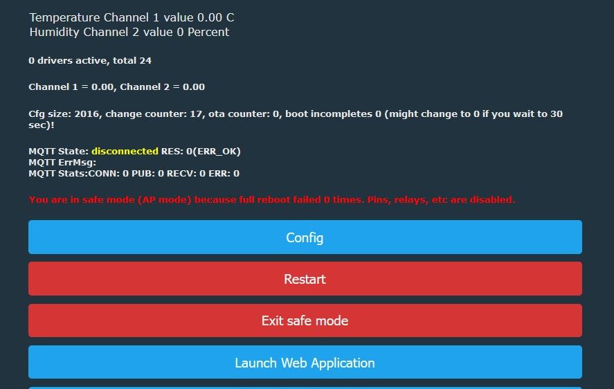

  • Battery discharge appears to break AP mode on CB3S
    #70 20483335
    ionoleinic
    Posts: 48
    Hi everyoane, I was busy for a time, but i am back for working on my project with these devices.Today i took my temp and hum sensor that i flashed about month ago.It worked perfectly until batteries have been discharged completely.Module entered always in AP mode, and changing the batteries didn't help.I decided to conect directly 3.3V to CB3S module, and it works, i could boot up the module.After changing another batteries, there was the same problem, and after a time, AP mode disappeared too.Then i decided to reflash the module.The flashing was succesfull, with the latest bin, but the AP didn't appear ...I desoldered the whole module, reflashed it and try to boot with direct power, but without succes.AP isn't appearing.
    Please help, i dont understand what cause this issue.
    BK7231N/CB3S Tuya generic battery powered temperature and humidity sensor with CHT8305 sensor BK7231N/CB3S Tuya generic battery powered temperature and humidity sensor with CHT8305 sensor
  • #71 20483433
    Posts: 14750
    Rate: 12866
    Please do a full 2MB backup and try "Restore RF" and if it doesn't help then full erase and fresh OBK write.
  • #72 20483467
    ionoleinic
    Posts: 48
    Worked after erase all and flashing new firmware.
    Man, you are awesome.I tried about 3 hrs to solve it, and without succes, but you solved it in 3 sec.
    Thank you very much.
  • Possible USB current limiting on laptop battery power
    #73 20513499
    Xinayder
    Posts: 24
    Or wait...
    Yes, it was both on Windows and Linux. Could it be that I'm using a laptop running on battery and maybe there's some current limiting going on? I could try plugging it in my desktop PC which happens to have a USB 3 port which could, in theory, overcome this issue if this is what's happening.
    In either way I have been busy with IRL stuff and I'm planning on tackling this once again, I just ordered a new 3v3 USB programmer and hopefully I can shine some light on this

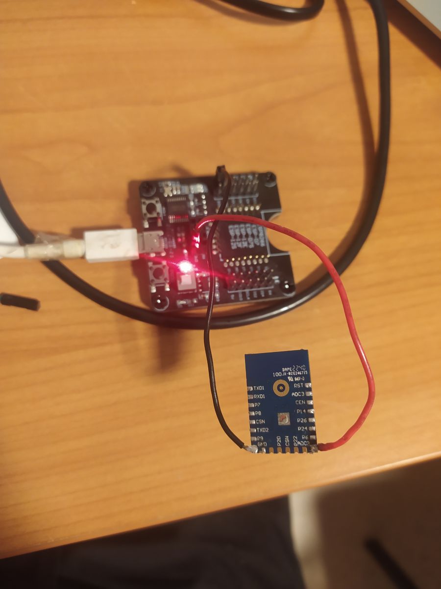

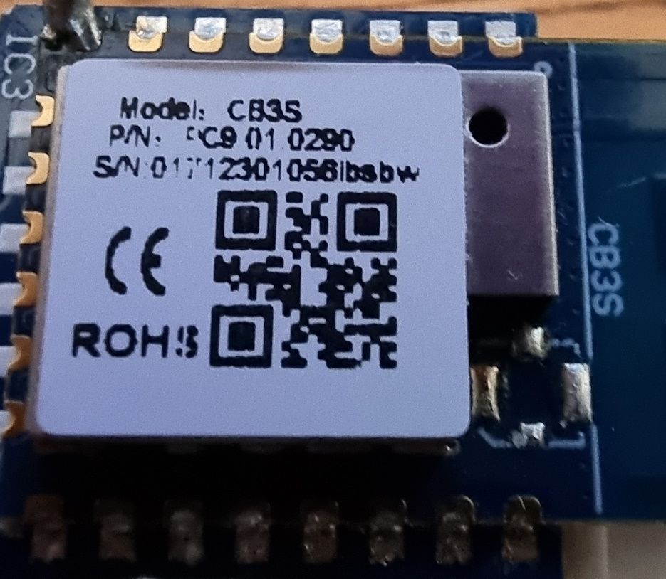

  • Need to power the whole device during BK7231 flashing
    #74 20638523
    haps123
    >>20374205
    I have got exactly the same device, and I am trying to reinstall firmware with OpenBK7231 firmware following elektroda or GitHub openBK7231 wikis but without success. I have got USB/UART connected to TX/RX RX/TX of the device SoC (pin 16 and 15) to RX/TX of UART. Furthermore, I am using the BK7231Flasher apps for this purpose, but I am always getting a Bus error. It does not matter if I am trying to initialize the update via resetting power or grounding CES pin. I connected SoC's VCC to 3.3V PS, but I am not sure that I need to power up also the rest of the device?
    I have tried to upload with and without powering the rest of the device but without success.
    The simple serial terminal shows that the device sends nulls, so some kind of communication exists, but the programmer cannot init the flash upload. Any troubleshooting methodology in this matter highly appreciated.
    haps
  • #75 20638546
    Posts: 14750
    Rate: 12866
    @haps123 this is TuyaMCU ddevice, did you disconnect the MCU(the chip in SOIC or QFN) from the WiFi module?
    You need to connect 3.3V directly to WiFi module 3.3V, otherwise the MCU may disconnect the WiFI module power via transistor.
    Can you post photos of your setup?
    You can also try our python tool: hid_download_py
  • #76 20639734
    haps123
    Hello, @p.kaczmarek2 many thanks for prompt response, much appreciated.
    Yes, I connected the wifi module to 3,3V
    [Can you post photos of your setup?
    As you can see, I am getting some message from the board, but the programmer cannot initiate update of the flash. I have disconnected power, connected CES pin to GND without success.
    BK7231N/CB3S Tuya generic battery powered temperature and humidity sensor with CHT8305 sensor BK7231N/CB3S Tuya generic battery powered temperature and humidity sensor with CHT8305 sensor BK7231N/CB3S Tuya generic battery powered temperature and humidity sensor with CHT8305 sensor
    No, I will try it :)
  • #77 20639761
    Posts: 14750
    Rate: 12866
    You may have problems related to the too long wiring. Stray inductances/capacitances can interfere with flashing. We already had a case on this forum where shortening wires helped to flash CB2S.

  • #86 20642712
    Posts: 14750
    Rate: 12866
    I am not sure, but if it's a "Low Mid High" enumeration, then "LowMidHigh" may be a proper channel type for that.

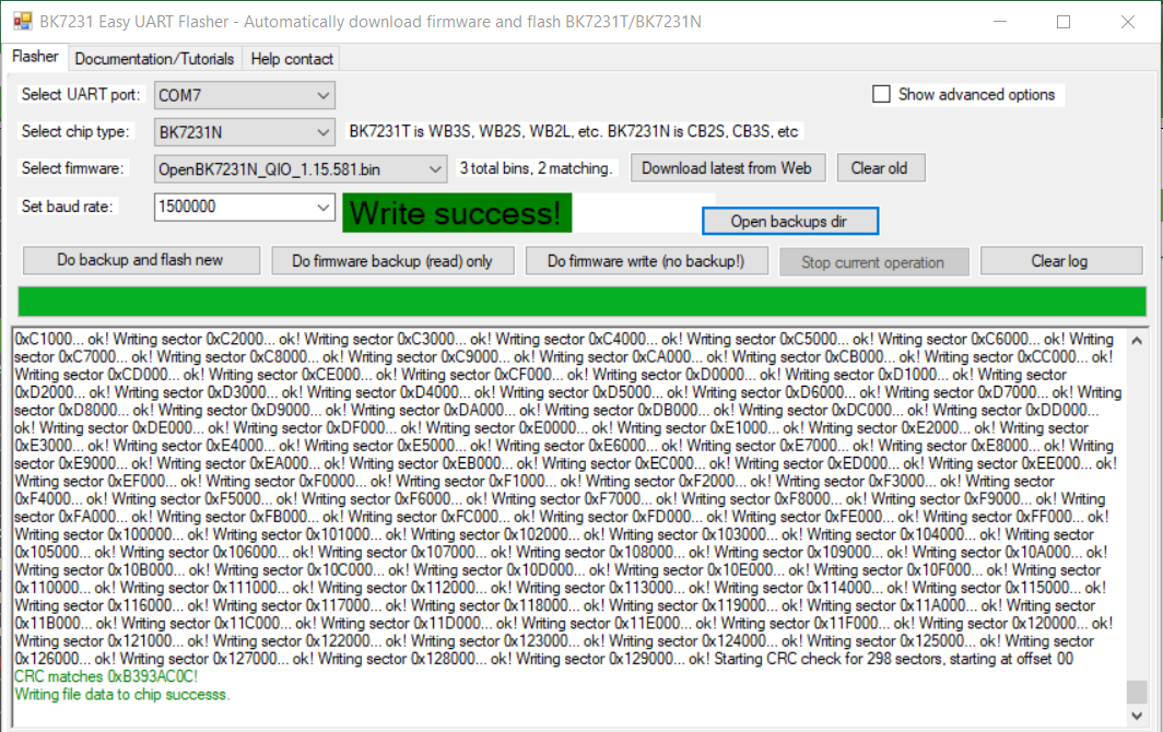

  • Windows tool bypassed CRC flash error
    #89 20677075
    Xinayder
    Posts: 24
    >>20513499
    I finally got my hands on a new programmer and it works!!!
    I managed to read the firmware from my temperature sensor, but trying to flash any of the available firmwares results in a "CRC not equal" error. (I tried both QIO and UG/UA and both T and N) I'm using the hid_download_py tool because I'm on Linux.
    The PCB for mine is CBU and I've attached the firmware read from the memory here.
    When reading the firmware from memory this is what I got in my console:
    CRC should be 664c13c9
    CRC is 4a280325
    anyways, the firmware is attached, I couldn't unpack it because it couldn't find "encrypt" on my PC.
    EDIT: I was able to flash with the Windows tool. Device works, I loaded the config from the generic Tuya temperature and humidity sensor with a SHT30 IC.
    I also attached the config from the windows app.
    • settings.txt (2.29 KB) You must be logged in to download this attachment.
    • aubess.bin (1.1 MB) You must be logged in to download this attachment.
  • #90 20677212
    Posts: 14750
    Rate: 12866
    Hid_download_tool will always give CRC error in current state. I must look into that.
