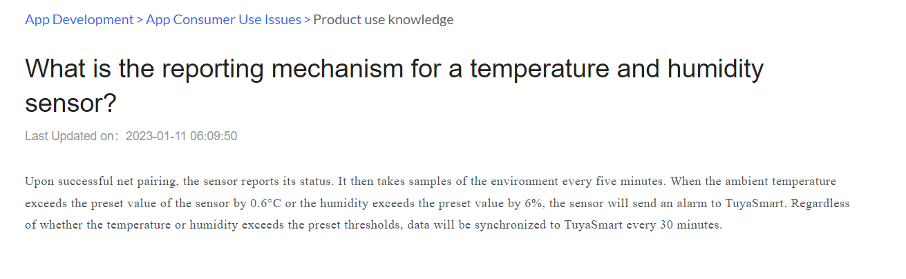

    Can you set a reporting interval in Tuya app?
    Try to detect what is being sent when you set that reporting interval.

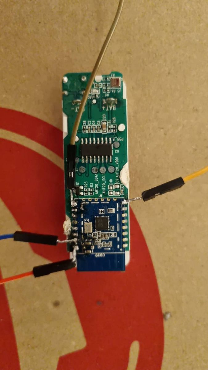

  • Captured Tuya pairing and restart data frames
    #33 20382243
    ionoleinic
    Posts: 48
    I can't set reporting interval.It is by defualt 1 hour...
    I will try to capture when its pairing with tuya App.

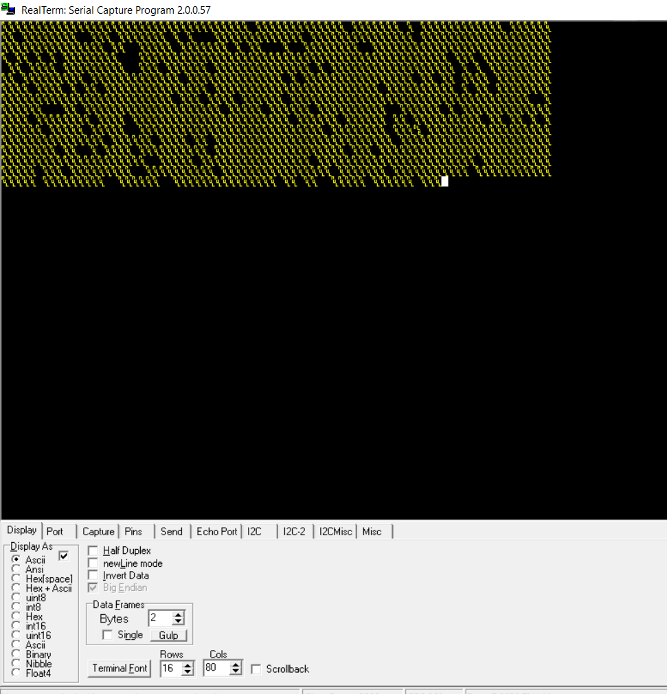

    I got these values:
    On Pairing with Tuya App:
    55 AA 00 02 00 01 02 04 55 AA 00 02 00 01 03 05 55 AA 00 02 00 01 04 06
    55 AA 00 08 00 01 00 08 55 AA 00 08 00 01 00 08 55 AA 00 08 00 01 00 08
    55 AA 00 10 00 02 01 00 12 00 00 00
    On Restart:
    55 AA 00 01 00 00 00 55 AA 00 02 00 01 03 05 55 AA 00 02 00 01 04 06 55
    AA 00 08 00 01 00 08 55 AA 00 08 00 01 00 08 55 AA 00 08 00 01 00 08 55
    On Button Pressed:
    00 01 04 06 55 AA 00 08 00 01 00 08 55 AA 00 08 00 01 00 08 55 AA 00 08
    00 01 00 08 55 AA 00 10 00 02 01 00 12 00
    Current Temp and Hum now is : 28.2 C and 50% (aprox)

    Is that a capture from TXD1 of WiFi module? It seems so. There is no humidity, no temperature data. You can get that data if you capture on RXD1.
    Oh, my fault, i connected Rx to Tx and Tx to Rx, need reverse...

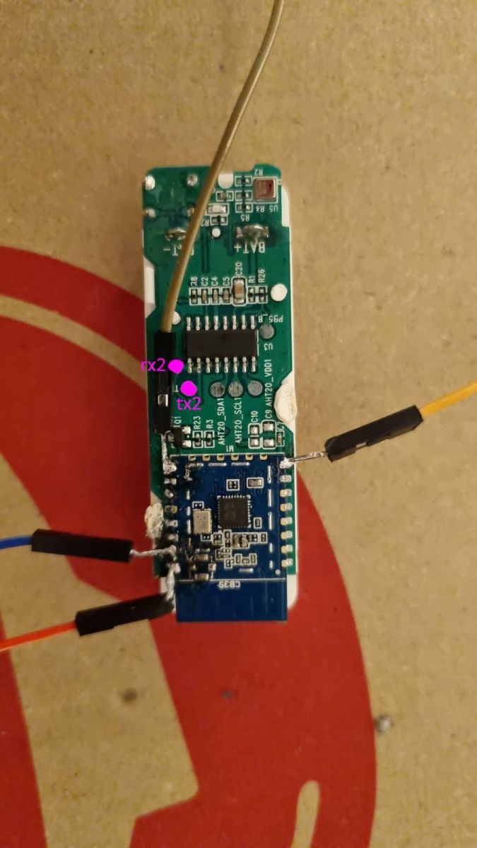

  • Need to sniff both UART directions separately
    #36 20382515
    Posts: 14750
    Rate: 12866

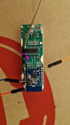

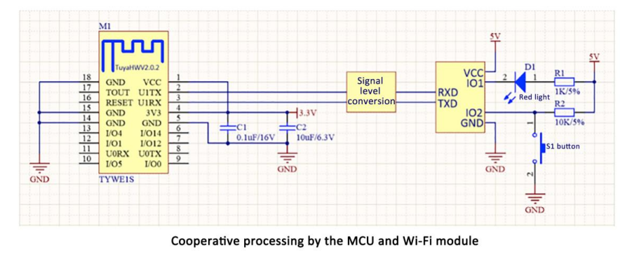

    It's not possible to connect both correctly. You have only one line to receive data on your USB to UART converter, while on the other hand, the IoT device with TuyaMCU has TXD1 (of BK) <-> RX (of TuyaMCU) line and RXD1 (of BK)<-> TX (of TuyaMCU). This is how UART works:
    BK7231N/CB3S Tuya generic battery powered temperature and humidity sensor with CHT8305 sensor
    There are to lines to sniff. You should repeat all tests twice, first sniff what WiFi module receives and then sniff what WiFI module sends.
    Basically, there are two lines of communication while you have only single RX line to receive.

    I think it is deliberately protected in this way, to save power of batteries.A client can make this interval very small and this way discharging is faster.

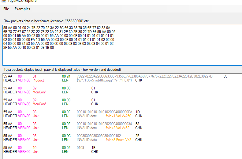

    I have captured again TuyaMCU packets.

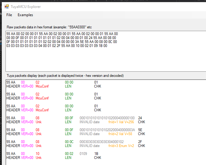

    55 AA 00 02 00 00 01 55 AA 00 02 00 00 01 55 AA 00 02 00 00 01 55 AA 00
    08 00 0F 00 01 01 01 01 01 01 01 02 00 04 00 00 01 00 24 55 AA 00 08 00
    0F 00 01 01 01 01 01 01 02 02 00 04 00 00 00 3A 5E 55 AA 00 08 00 0C 00
    03 03 03 03 03 03 03 04 00 01 02 2F 55 AA 00 10 00 02 01 09 1B 00

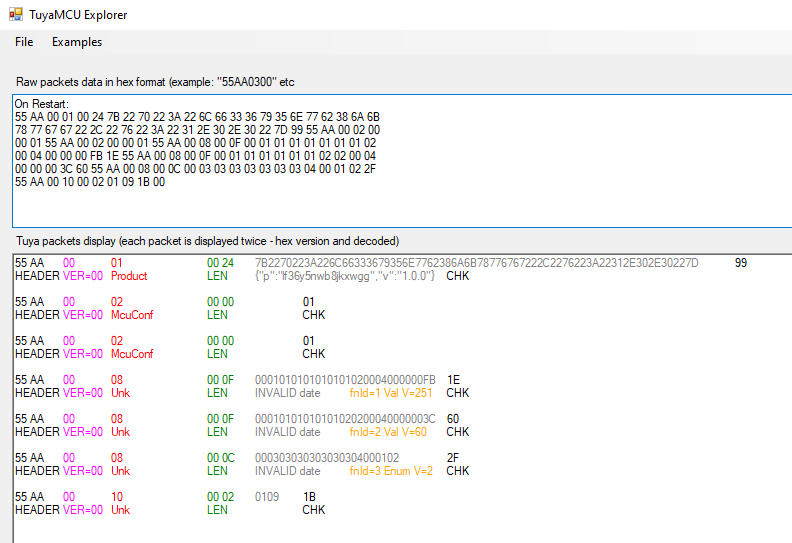

    On Restart:
    55 AA 00 01 00 24 7B 22 70 22 3A 22 6C 66 33 36 79 35 6E 77 62 38 6A 6B
    78 77 67 67 22 2C 22 76 22 3A 22 31 2E 30 2E 30 22 7D 99 55 AA 00 02 00
    00 01 55 AA 00 02 00 00 01 55 AA 00 08 00 0F 00 01 01 01 01 01 01 01 02
    00 04 00 00 00 FB 1E 55 AA 00 08 00 0F 00 01 01 01 01 01 01 02 02 00 04
    00 00 00 3C 60 55 AA 00 08 00 0C 00 03 03 03 03 03 03 03 04 00 01 02 2F
    On Button Pressed:
    6B 78 77 67 67 22 2C 22 76 22 3A 22 31 2E 30 2E 30 22 7D 99 55 AA 00 02
    00 00 01 55 AA 00 02 00 00 01 55 AA 00 08 00 0F 00 01 01 01 01 01 01 01
    02 00 04 00 00 00 FA 1D 55 AA 00 08 00 0F 00 01 01 01 01 01 01 02 02 00
    04 00 00 00 34 58 55 AA 00 08 00 0C 00 03 03 03 03 03 03 03 04 00 01 02

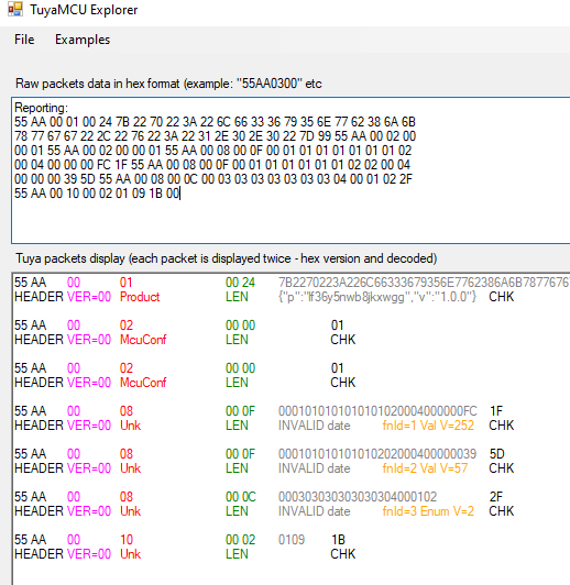

    Reporting:
    00 04 00 00 00 FC 1F 55 AA 00 08 00 0F 00 01 01 01 01 01 01 02 02 00 04
    00 00 00 39 5D 55 AA 00 08 00 0C 00 03 03 03 03 03 03 03 04 00 01 02 2F
    Now i can flash module with OpenBeken?
  • TuyaMCU datapoints identified for temperature, humidity, battery level
    #42 20382906
    Posts: 14750
    Rate: 12866
    ionoleinic wrote:
    On Restart:
    ionoleinic wrote:
    On Button Pressed:
    ionoleinic wrote:
    Reporting:

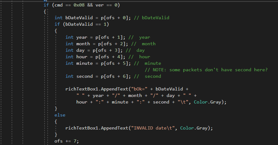

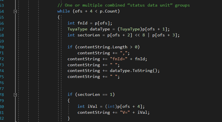

    Id 1 is a temperature but as integer, must be divided by 10.
    Id 2 is humidity
    Id 3 most likely is a battery level.
    The used packet type is 0x08, which consists first a date, which is marked as "invalid date", here is how can it be parsed:
    Then it contains a classic Tuya variables:
    Here's the doc:
    From a quick glance, I can't see anything that sets reporting interval, but I will check later other packet types as well.
    Docs link:
    https://developer.tuya.com/en/docs/iot/tuyacl...niversalserialaccessprotocol?id=K95afs9h4tjjh
    Please do a backup 2MB read, share it if you can and flash.

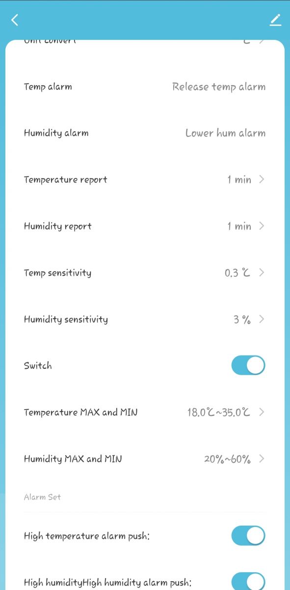

  • MQTT discovery issues and increasing report intervals
    #43 20383655
    minusync
    Posts: 57
    Wait, is it possible to change reporting interval on that device or not?
    I do not have those devices in tuya universe anymore but I remember clearly that in the app there was an option to change reporting interval. The default was 90min or something like that.
    Added after 1 [hours] 53 [minutes]:

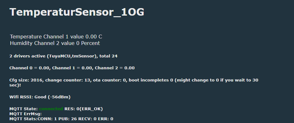

    I will consistently try to summarize the problems encountered with the HA integration.
    Discovering MQTT happens very strangely. The MQTT device HA does not see this sensor and it is not possible to listen to the sensor in the MQTT settings. However, the entities temperature and temperature_2 are displayed on the entities page. It is possible to use the data, but sometimes it is a bit strange, for example, the temp shows 22.400000000000002. HA complains that the device has no ID and therefore cannot be further configured. This is a bit annoying because there is no way to adjust the icon.
    edit: I did add ID manually in yaml, but fact that HA mqtt does not see it as device is confusing. However bcs it does create entities it is generally possible to use the sensor. However, after resetting the device, it starts to send the temperature and moisture data at a few minutes at intervals, this time range will basically double each time and after a few hours the data will be completely suspended. At this point, the device seems to be working but the data is no longer transmitted. Such a pattern is permanent and repeatedly tested. There is also a permanent decimal problem I mentioned above. I use the recommended YAML setup here
    "{{ ((value | float * 0.1 | round(1))) }}"
    but it does not seem to work.

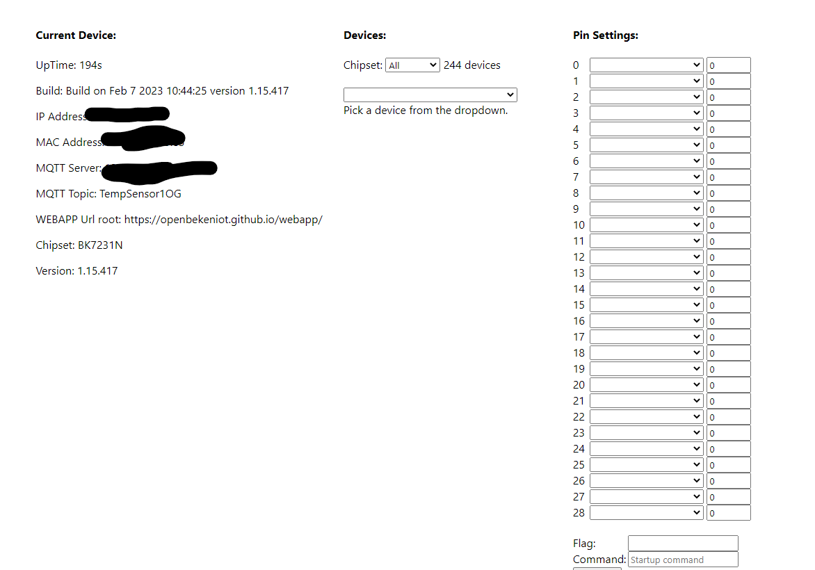

    Succesfully flashed!
    Thanks @p.kaczmarek2 for help.Thanks a lot.
    BK7231N/CB3S Tuya generic battery powered temperature and humidity sensor with CHT8305 sensor BK7231N/CB3S Tuya generic battery powered temperature and humidity sensor with CHT8305 sensor
    Everything works perfectly.
    Autoexec.bat :
    startDriver tuyaMCU
    startDriver tmSensor
    setChannelType 1 Temperature_Div10
    setChannelType 2 Humidity
    Dump :
    [ backup_2mb...mp_hum.bin (2 MB)You must be logged in to download this attachment.
    How to set ChanelType3 to show battery level? Or it isn't implemented yet?

  • AHT20 sensor board uses TuyaMCU and TX2/RX2 vias
    #50 20401521
    Xinayder
    Posts: 24
    I have news from my device after my UART programmer arrived.
    First, the battery powered temp and humidity sensor is just like the OP one except that the PCB is a bit different. The sensor used is a AHT20 and there's a TuyaMCU module as well. I soldered the wires and tried to connect it to my programmer and a weird behavior occurred.
    Whenever I'd power the sensor with the UART programmer (both 3v3 and GND), the DRX and DTX LEDs of the programmer would blink at a low intensity. The programmer stopped being detected by my system. As soon as I removed one of the power wires it was detected again.
    I found out that the TX pin of the CB3S is connected to pin 15 of the TuyaMCU chip, but the RX isn't connected anywhere on the chip. There are 2 vias on the PCB labeled TX2 and RX2 which are connected to the TX1/RX1 pins of the wifi module.
    (yes I know the solder is bad, I was experimenting with my brand new iron that I got from aliexpress). I also wanted to check out the other side of the board but it's either glued or soldered together. But I know that pin 15 goes to something on the other side of the board which goes to the TX/RX vias.
  • TuyaMCU battery sensor needs UART packet capture
    #51 20402035
    Posts: 14750
    Rate: 12866
    This device reminds me of:
    https://www.elektroda.com/rtvforum/topic3914412.html
    Sorry but I don't understand, what stopped being detected? The COM port?
    Or the BK flasher stopped recognizing device? Or what?
    It is virtually impossible, TuyaMCU Battery Powered Devices Serial Protocol (see Tuya site for docs) requires bidirectional communication to work.
    Maybe there is a 100ohm resistor on the way?
    You can watch some videos on our YT channel to see how to improve IoT soldering job:
    I can clearly see Q1 MOSFET which is controlled by TuyaMCU in order to power off and on WiFi module.
    @Xinayder , can you do a UART packet capture first (in hex string mode, both from rx and tx) for further analysis before flashing obk?
    Also do 2MB firmware backup.

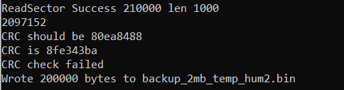

    #52 20403807
    Xinayder
    Posts: 24
    Perhaps, but I haven't located it yet. I'll take a look at it again later.
    I tried, the problem is that (at least on Linux) my UART programmer keeps connecting and disconnecting itself after I power the sensor with the wires from the programmer. TX/DX LEDs on the programmer just start blinking constantly and the module doesn't show up on lsusb. Disconnecting the vcc/gnd wires make it work again.
    For that reason I can't even do a firmware dump because it can't read data from the sensor. I tried plugging the GND to the programmer and powering the sensor with the batteries but no luck either.
    The programmer is a FT232BL.
  • TuyaMCU must be isolated for firmware backup
    #53 20404004
    Posts: 14750
    Rate: 12866
    Doing firmware backup will not work with TuyaMCU on board. You first have to cut the trace or desolder TuyaMCU or desolder WiFi module.
    Doing packets capture should work.
    Please show your wiring connections...
  • Damaged antenna and TXD2 via broke pairing and UART access
    #54 20413614
    Xinayder
    Posts: 24
    Got caught up with work and forgot to reply here.
    I inserted the batteries into the sensor and it can no longer pair, the Tuya app finds the device but can't pair for some reason. I think I may have messed up the solder of the pins when I was trying to solder without flux (which resulted in the crappy solder job), so I'll try redoing the solder and seeing if it works. Otherwise I'm just gonna buy another sensor from AliExpress.
    EDIT: good news, the sensor works, but something damaged the wifi antenna so it's not working properly. I had to put the sensor next to my router to add it to Tuya and it will only update if it's close to it. I also noticed that when I was trying to solder without flux, I accidentally removed one of the vias, specifically the one located at pin 11 (TXD2), which could be the reason why the UART programmer goes crazy.
    I tried to connect the programmer on Windows and I had the same problem. The USB port keeps popping up and disappearing, as if I was unplugging and replugging the programmer several times a second. My guess it's that I completely messed it up with soldering. I'll order a new sensor from AliExpress again and hopefully won't make a mess this time; I'll watch the youtube video to make it properly this time.
  • USB port cycling suggests overcurrent or bad connection
    #55 20415363
    Posts: 14750
    Rate: 12866
    You can fix soldering job, just apply flux now, fix joints, clean PCB with IPA.
    How was the antenna damaged? Maybe you can fix it by doing a short jumper with solder.
    Was TXD11 damaged on wifi module board or on the mother board?
    do you have USB doctor? Maybe something is taking too much current.
  • Removed via may be causing Wi‑Fi issues
    #56 20423300
    Xinayder
    Posts: 24
    The pin 11 via was completely removed from the board (the golden part due to too much heat applied when I had no flux to solder) and I tried putting some solder in it, but it didn't work. I believe this might have caused the wifi issues, as the datasheet states that this pin is used for displaying module internal information.
    Regarding the antenna, how could I try to fix it? If it's by soldering a wire on the antenna trail, the varnish on the PCB covers the whole antenna and I couldn't find a place to solder it.
    Also I should definitely buy isopropyl alcohol before I get into soldering again; I bought a door sensor and the same temperature sensor from a seller on AliExpress, it was supposed to be delivered Friday but due to Lunar New Year I believe it was delayed, so hopefully it will arrive this week.

    #60 20429254
    minusync
    Posts: 57
    crashyourself22 wrote:
    I don´t know which pins i have to configure in OBK and how tzo receive the data from the IC.
    I´m using the same board as @minusync
    Just to get the temperature and humidity, the pin setting is not directly necessary. You need to create a .bat file that runs the necessary drivers, as described somewhere on the first page of this thread and drop it to the filesystem box (in web application). After restarting the sensor, you can see if the drivers work and the temp is read, but note that the sensor will not start transmitting data until the external power from the cb3s pins is removed! If you leave the logs window open, it is also possible to check whether something is being transmitted.
    But the sensor at moment doesn't work anyway. In my experience, it needs some kind of (driver?) setting that defines the time period after which the data is transferred. Currently, HA receives a signal about 4-6 times, but then, at least my sensor switches to safety mode and then stops transmitting any data. Such behavior has been repeatedly tested.
