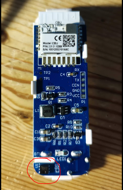

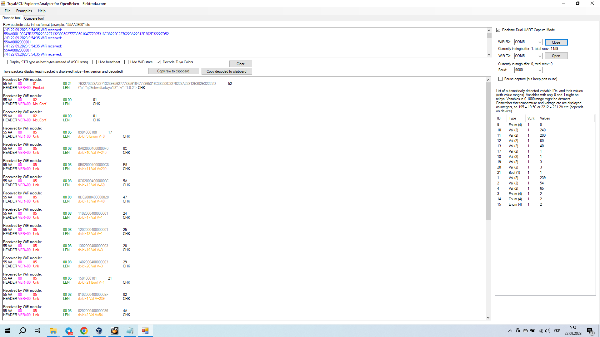

    hello friends, I have several devices with a board as in the first post (with a buzzer) using TuyaMCUAnalyzer-v0.5
    discovered:
    - dpid 1 - temperature
    - dpid 2 - humidity
    - dpid 3 - similar to battery status (high, low)
    - dpid 4 - battery percentage
    - dpid 9 - temperature measurement unit (0 -C, 1 - F)
    - dpid 10 - temperature MAX
    - dpid 11 - temperature MIN
    - dpid 12 - hum MAX
    - dpid 13 - hum MAX
    - dpid 14 - temperature alarm (0 - low, 1 - normal, 2 - high)
    - dpid 15 - humidity alarm (0 - low, 1 - normal, 2 - high)
    - dpid 17 - temperature update time
    - dpid 18 - humidity update time
    - dpid 19 - temperature sensitivity
    - dpid 20 - moisture sensitivity
    - dpid 21 - Switch (buzzer) 1 - activates in case of alarm

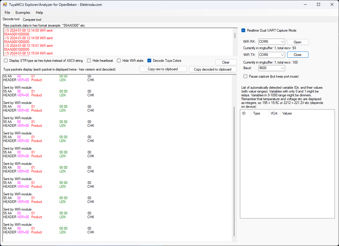

    TuyaMCUAnalyzer interface displaying module data from MQTT.
    Spoiler:

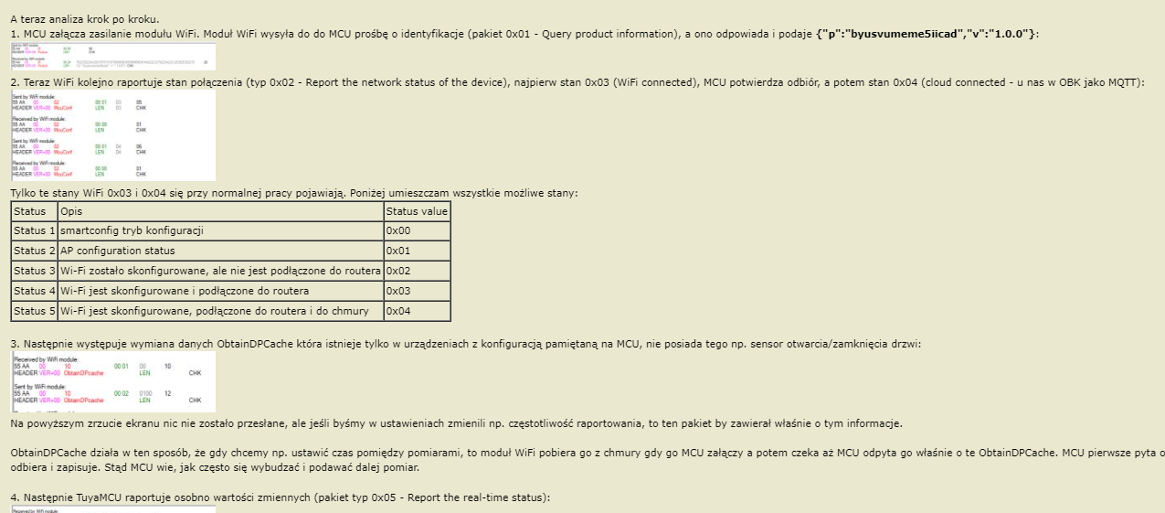

    the battery status is shown only when the power is completely lost and then restored
    With a quick replacement of one of the batteries (the device does not crash) and at the same time it does not show the new status of the battery.
    maybe he does it once a day (will test)
    below is data from WIFITX after applying voltage
    Spoiler:

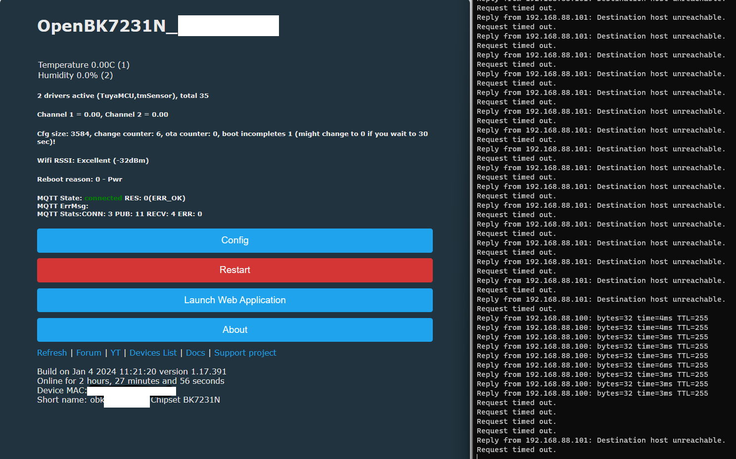

    how to transfer data from the module (which, in turn, takes data from the mqtt topic) to tuyaMCSU about changing the update time?

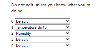

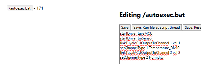

    https://www.elektroda.com/rtvforum/topic3975583.html#20564338
    Spoiler:
    startDriver TuyaMCU
    startDriver tmSensor
    // may be needed, depends on device, some also use 9600
    tuyaMCU_setBaudRate 115200
    // dpID 1 is tempererature div 10
    setChannelType 1 temperature_div10
    linkTuyaMCUOutputToChannel 1 val 1
    // dpID 2 is % humidity
    setChannelType 2 Humidity
    linkTuyaMCUOutputToChannel 2 val 2
    // dpID 3 is battery state - low(0), mid(1) and high(2)
    linkTuyaMCUOutputToChannel 3 enum 3

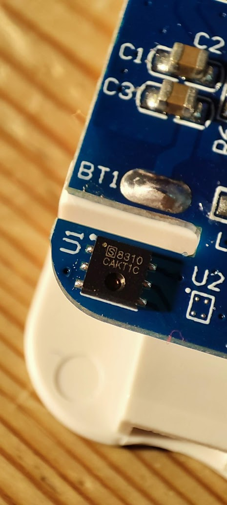

  • CHT8310 sensor compatibility question for OpenBeken
    #94 20850770
    Posts: 5202
    Help: 446

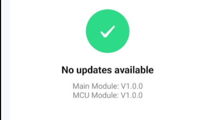

    Rate: 914
    I've just received my first battery generic humidity/temperature iot device and it seems to have a Sensylink CHT8310 instead of the CHT8305.
    https://en.sensylink.com/html/web//product/wsdcgq/cwsdcgq/1663024476742897666.html
    any idea if the drivers in OpenBeken supports this? shall I make a new teardown/discovery post @p.kaczmarek2 ?
    Close-up of a circuit board with a Sensylink SHT8310 sensor.
    Screen message indicating no updates available with version 1.0.0 for both modules.
    The image shows a circuit board of an IoT device with electronic components, including a Sensylink CHT8310 sensor.

    #97 20897781
    Adinfo
    Posts: 26
    I have a thermometer like the one in the first post of this thread (with the UM8005 chip), to program it I had to "disrupt" RX/TX using the button on the thermometer to start programming, because even though I made a copy of the original firmware the first time, I had a problem the second time starting the copy and writing the new firmware - there was an error related to the "baud rate" setting, - after holding the button on the thermometer, the connection was established - a firmware dump was made and the OBK was programmed. The programmer I used was based on the CP2102 system.
    Anyway, I set all the flags as required (if I remember correctly: 2, 7, 10, 19, 35, 37) and autoexec.bat (entries for TuyaMCU and Sensor drivers for temperature and humidity). Unfortunately, when monitoring RX/TX communication, I do not receive any data (MQTT configured and in OBK I see two variables - temperature and humidity). Previously, I uploaded OBK to another thermometer (a slightly different model with the TuyaMCU system without markings - but that concerns another thread) and the problem was the same as in this case - no captured packets with sensor data.
    After powering from the battery, the thermometer wakes up and gives me the status of the WiFI network coverage, but not from the sensors - I get zeros all the time.
    I understand that the package analyzer will not catch anything if OBK is loaded and the thermometer from BK7231N is soldered? (I didn`t check it on the original firmware, only after uploading OBK). In my case, the values in the main OBK panel for both variables are zero - as if OBK did not receive data from TuyaMCU). I am connected as for programming, i.e. RX1, TX1.
    RX (9600):
    //R 2024-01-08 10:42:11 WiFi received:
    55AA0001000000
    Received by WiFi module (I only have these entries - nothing more than what you can see below):
    55 AA 00 01 00 00 00
    HEADER VER=00 Product LEN CHK
    TX:
    //S 2024-01-08 10:42:41 WiFi sent:
    55AA0001000000
    Sent by WiFi module (I only have these entries - nothing more than what you can see below):
    Of course, I will attach the firmware dump when I`m home. Were you able to get readings on this thermometer?
  • MCU must control WiFi power for measurements
    #98 20897798
    Posts: 14750
    Rate: 12866
    The TuyaMCU analyzer is intended for testing communication with the original firmware. If you have already uploaded the OBK, its usefulness decreases slightly, although, for example, if you think that the MCU is sending measurements, but the OBK does not see them, you can check the communication with the analyzer as part of the verification.
    It is possible that you are doing something else wrong, e.g., did you know that in order to obtain measurements, you cannot "artificially" power the WiFi module, the MCU must have control over it? This is because the MCU, after supplying power to the WiFi module, expects that the WiFi module will "speak" first, and the WiFi module "speaks" after its reboot.
    Here you have a detailed study of the door opening sensor: https://www.elektroda.pl/rtvforum/topic3914412.html
    And here is the temperature/humidity sensor: https://www.elektroda.pl/rtvforum/topic3975583.html
    The above topic covers the development of a protocol and you can read there what type of communication to expect. Below is a screenshot:
    Screenshot with analysis of TuyaMCU communication with connection states description.
    Do you ever have:
    1. The MCU turns on the power to the WiFi module. The WiFi module sends an identification request to the MCU (packet 0x01 - Query product information), and it responds with {"p":"byusvumeme5iicad","v":"1.0.0"}:
    Maybe you also have an error in the script, you can show it to be sure.
  • Intermittent zero readings from thermometer MCU
    #99 20898029
    Adinfo
    Posts: 26
    1. TuyaMCU analyzer - that`s what I meant - to suspect whether something is being sent from the MCU to OBK - but I didn`t notice anything that would help determine the lack of data.
    2. I power the thermometer from the pads on the main PCB - where the battery contacts are soldered, but from the programmer, but yesterday I powered it from the batteries alone and there was no difference apart from a slightly lower battery voltage.
    3. The MCU, when it provides power to CB3S WiFi, turns on at startup and turns off after a while, cyclically, both after turning on the thermometer for the first time and in subsequent cycles when the MCU turns on WiFi.
    4. The MCU manages the WiFi power correctly, in the sense that I can see it after powering up and that it transmits the WiFi RSSI status in HA after MQTT (BK7231N gets voltage) - but I do not see this package or others related to "0x01".
    5. The autoexec.bat script I created:
    startDriver tuyaMCU
    setChannelType 1 Temperature_Div10
    Editing autoexec.bat script in a text editor Screenshot showing configuration options for channels in software. Screenshot of OpenBK7231N interface and network command results.
    Screenshot of TuyaMCU Explorer displaying data packets.
    SUPPLEMENT : it just started -> I did some digging and accidentally entered the charts from this thermometer from the night, in the morning there were zero values in the entities for both variables and this misled me, in the main OSR window of the thermometer there were also zero values, so it didn`t occur to me to look there. I just tested it and looked at the logs when I turned on the thermometer and it downloaded the temperature and humidity data, they also appeared in HA, but in certain circumstances these values are lost in the thermometer and are zero, then I need to check if there is a way to leave the last known value. values than 0 and 0.0 because this is misleading. Apart from the situation when the actual temperature is 0 degrees, humidity could be used as a factor that decides whether to download and save the measurement in HA. There`s also the matter of detecting the battery status, but that`s a further topic.
