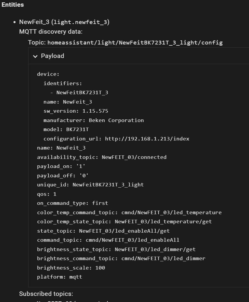

    I was pretty much able to make it work but.....
    ...as you can see in my video, I can toggle the switch in the MQTT server
    and it does change the state of the OpenBeken button, but does not change the actual
    load (light-bulb) connected to the wall-switch.
    On the other hand, if I click on the OpenBeken interface, it does switch the light on/off
    but is not reflecting the state of the MQTT broker sliders...
    Can someone show me a sample yaml script for my application?
    ...any advice?
    Thanks, wd
  • Working OpenBeken TuyaMCU config and HA MQTT YAML
    #32 20485168
    mattj
    Posts: 42
    Rate: 16
    Not sure the issue you're facing, but sharing my working config (across a number of these devices).
    No pins configured...
    /autoexec.bat
    startDriver TuyaMCU
    setChannelType 1 toggle
    setChannelType 2 dimmer
    setChannelType 4 OffDimBright
    tuyaMcu_setDimmerRange 0 1000
    linkTuyaMCUOutputToChannel 3 val 3
    linkTuyaMCUOutputToChannel 101 enum 4
    ^ on bulbs which are unable to dim too low, I increase the lower setDimmerRange value.

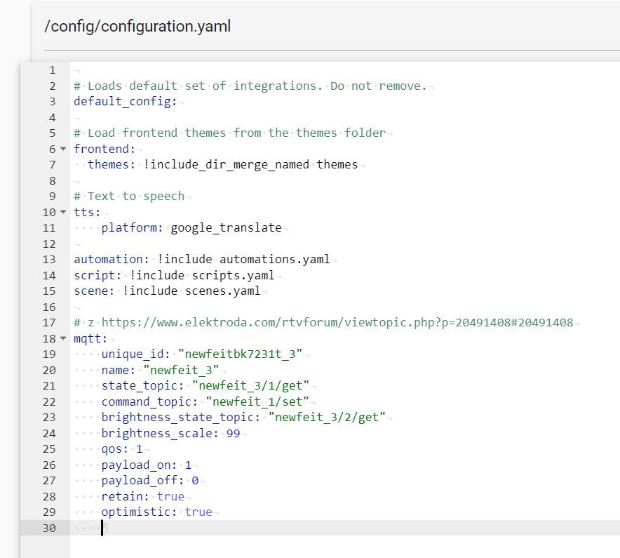

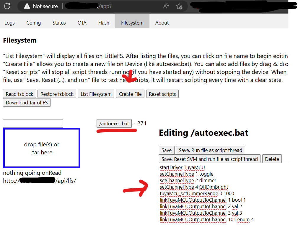

    ...is this the place to write the yaml script? (see the picture)
    BK7231T Feit Smart Wifi Dimmer: TuyaMCU, Programming & 3-Way Mode Tips (Amazon Purchase)
  • #34 20485960
    Posts: 14782
    Rate: 12920
    No, scripts are placed in Launch Web Application -> LittleFS -> create new file (autoexec.bat) and save.

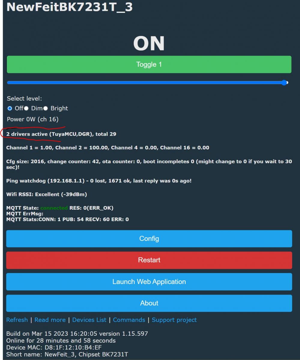

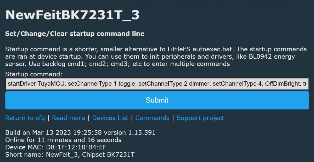

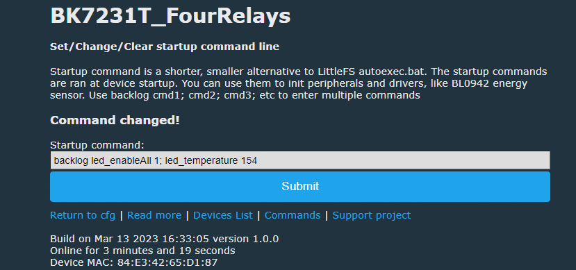

    ...how can I delete these startup commands from this line?
    I think this may be my issue...
  • #38 20487117
    Posts: 14782
    Rate: 12920

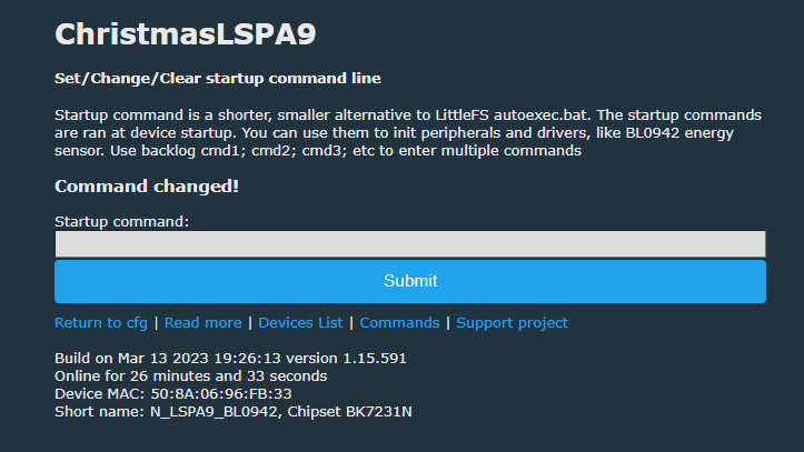

    Is there some kind of problem with removing startup command?
    It seems to work for me with 1.15.591 build:

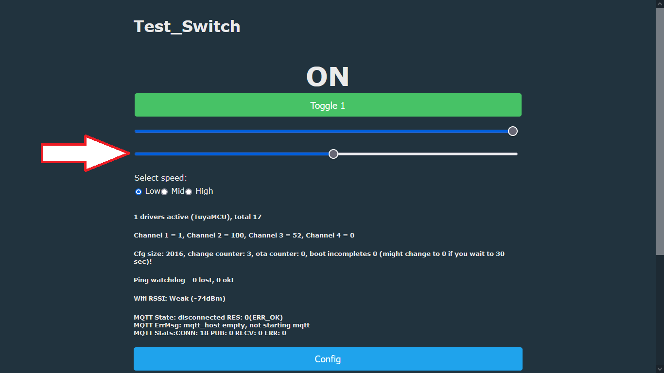

    ...if I select everything in the box and delete it, click "Submit" and the whole string reappears in the dialog box.
    Should it be like that?
    ...I note that there are two drivers running, should it be like that?

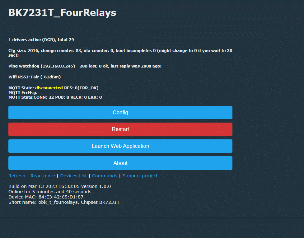

  • Device Groups panel may be causing the TuyaMCU issue
    #40 20491560
    Posts: 14782
    Rate: 12920
    You can ask here, I will try to help.
    You have TuyaMCU enabled and DGR (Device Groups), did you set something in Config->Device Groups panel?
    Screenshot of the BK7231T_FourRelays control panel showing connection status and configuration.
    Why do you have a Power channel? Is it measuring energy? Maybe you need to clear role of one of unused channels, that you have left over from previous experiments?
    User interface displaying information about the BK7231T_FourRelays device
    wesduda wrote:
    ...if I select everting in the box and delete it, click "Submit" and the whole string reappear in the dialog box.
    It must be a bug, you can try entering anything like "sagasgs" random string, but I don't know how do you manage to get that bug.
    User interface with a command input field for BK7231T_FourRelays startup commands.
  • Home Assistant MQTT light config requires mqtt and light sections
    #41 20492692
    mattj
    Posts: 42
    Rate: 16
    >>20491408
    @p.kaczmarek2 is the man for all things OpenBK.
    But in addition to his post above, I noticed your Home Assistant config is missing an item.
    Source docs: https://www.home-assistant.io/integrations/light.mqtt/
    You need to have both “MQTT” AND “Light”… like this:
    # Example configuration.yaml entry
    mqtt:
      light:
        - command_topic: "office/rgb1/light/switch"
    MQTT defines the integration, then you can have components (e.g., light, switch, etc.) within MQTT.

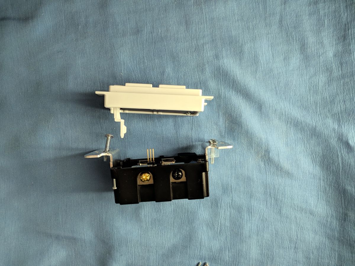

    First, a word of caution: when separating the two halves of the switch, make sure you lift the top halve straight up from the bottom halve because header pins connect the electronic circuit board in the white button halve to the mechanical portion in the black halve, and you don’t want to bend or break them.
    Separate parts of an electrical switch on a blue background.

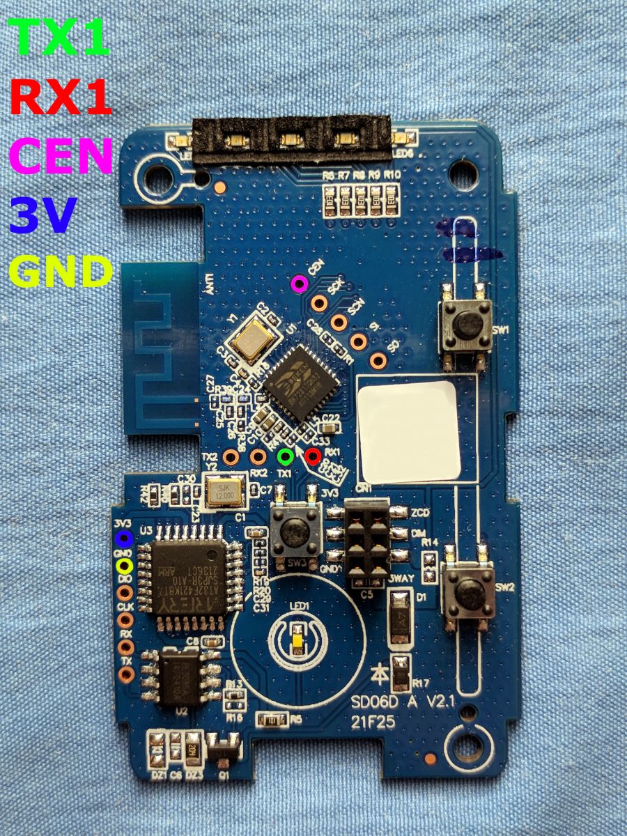

    To flash, I used a CH341A serial programmer with male DuPont cables that I had just pushed into each via hole for the 3V, GND, TX1, RX1 and touched CEN to GND to start the programming. After programming, you can move from using TX1/RX1 to TX2/TX2 if you would like to read the UART output. If you try to flash with a CH341A using its supplied 3.3V output, first check to make sure that it actually outputs 3.3V. Most of the black and yellow versions on the market actually incorrectly output 5V on the 3.3V pin, and 5V might damage the FEIT circuit board. A number of CH341A voltage fix how-tos on the internet to fix it.
    Circuit board with pin labels: TX1, RX1, CEN, 3V, GND.
    When I issued the command “startDriver TuyaMCU”, followed by “tuyaMcu_sendQueryState” on the logs screen of the web app, I get the following response:

    This tells us that the switch has the following IDs: id 1 type 1-bool, id 2 type 2-val, id 3 type 2-val, and id 101 type 4-enum that aren't currently mapped. It also gives us the maximum brightness of 1000 on id 2 and factory minimum brightness of 10 id 3.
    With that information the following is the autoexec.bat file that I generated to utilize all of the functions of the switch along with descriptions of what each command is doing so that others might learn for themselves.
    # Activates the TuyaMCU Driver
    startDriver TuyaMCU
    # Sets channel 1 to be a toggle to turn device ON/OFF
    # Sets channel 2 to be a dimmer to dim the light(s)
    # Sets channel 3 to be a dimmer to set the minimum brightness (This dimmer will allow you to set the minimum brightness level to fix light flicker, premature turning off of light, when using the physical dimmer buttons only)
    setChannelType 3 dimmer
    # Sets channel 4 to a selector to set the LED indicator brightness level on the switch from Off/Dim/Bright
    # Sets the dimmer range from minimum brightness of 10 and max brightness of 1000 (Adjust the minimum brightness level here to fix light flicker, premature turning off of lights, when adjusting brightness from MQTT or in GUI only)
    tuyaMcu_setDimmerRange 10 1000
    # Links dpId 1 with a boolean(1) variable type to channel 1 to toggle device ON/OFF
    linkTuyaMCUOutputToChannel 1 1 1
    # Links dpId 2 with a integer value(2) variable type to channel 2 to dim the light(s)
    linkTuyaMCUOutputToChannel 2 2 2
    # Links dpId 3 with a integer value(2) variable type to channel 3 to set minimum brightness when using physical dimmer buttons on switch
    linkTuyaMCUOutputToChannel 3 2 3
    # Links dpid 101 with a enum(4) variable type to channel 4 to adjust the LED indicator on the switch from Off/Dim/Bright
    linkTuyaMCUOutputToChannel 101 4 4

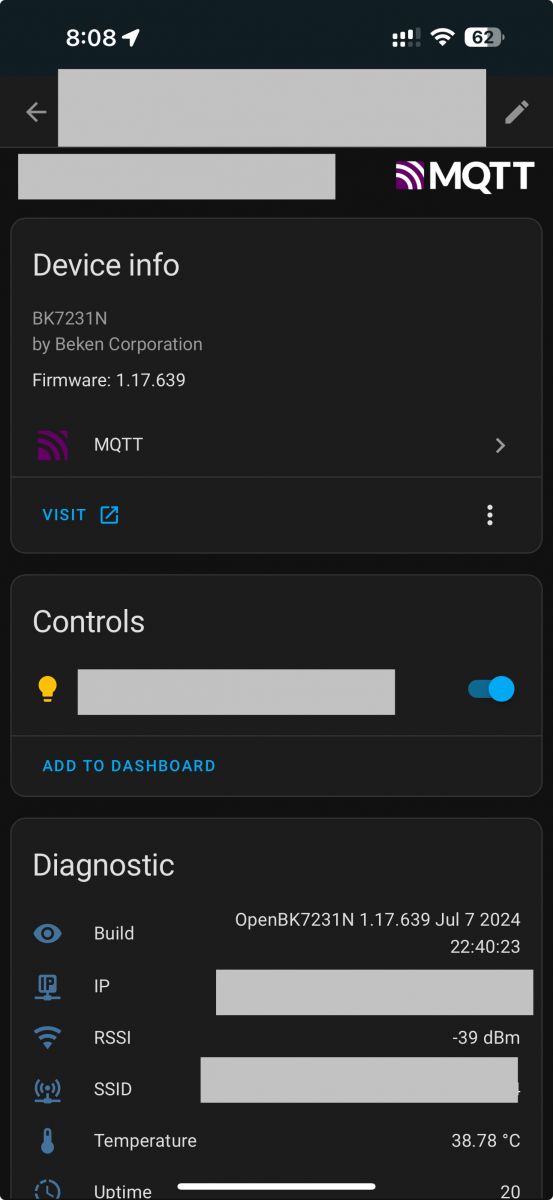

  • MQTT setup leaves four switches diagnostic only
    #52 21149733
    GikOnFlik
    First, let me say thank you very much for all your contributions. So much useful information.
    I have 5 of these switches with bK7231N. Looks like I did something wrong, because out of 5 only 1 shows up in Home Assistant with ability to control light. The other 4 do show up as well, but only have diagnostic info. I’m using MQTT Mosquitto broker, maybe this is my problem and I should just go with hands-on approach and do it in YAML? Home Assistant app interface displaying device information for BK7231N with lighting control. BK7231N device screen with diagnostic information in the Home Assistant app.
  • #53 21150588
    Posts: 14782
    Rate: 12920
    You need to do Home Assistant Discovery after you configure the device.
    [youtube]
    https://www.youtube.com/watch?v=pkcspey25V4
    [/youtube]

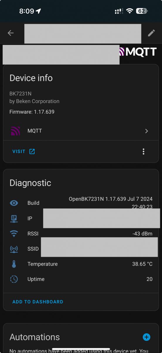

  • BK7231N flashed and installed successfully
    #54 21272408
    hughhallhh56
    Many thanks to all. I have to this point only used TASMOTA and was fortunate that all the globe bulbs and CE Home switches let me install Tasmota OTA. Well I thought I would get some more switches and automate my vacation property. I was at a store called the Big Box Outlet the other day and what would I see but boxes of Feit 3 way switches for the price of $9 CDN for a box of 3. All the items that are returned to Costco usually end up at this store and there were 40 boxes. Couldn't help myself....
    So this was my first attempt at opening a device and replacing the binary. I am just wrapping up for the evening and am so grateful for all the content posted here by everyone. In under 3 hours I managed to open the switch, load the current binary (my Feit had the BK7231N version), and install two of them into my house wiring lab. They are working like a charm. Tomorrow I will move on to getting them into Home Assistant.
    I am going to miss Tasmota.

  • ltchiptool and NRST wiring for flashing Feit switches
    #59 21362064
    olidel001
    Thank you for this thread. It has helped me to switch to OpenBeken with those Feit smart switches. However, it took me a long long time to find the proper recipe. This is what I can say related to the initial setup to flash those switches.
    - I have done the steps below on 3 different Feit switches. I believe from memory that they had the version 1.23 written on the electronic board.
    - To be able to flash the latest OpenBeken firmware, I just soldered a wire on the NRST indicated by the previous post. However, I didn't try to use the CEN connector as described above by GoofySpeed, so this one may also work so you can avoid soldering something. So, I have used only the following connection points: 3V, GND, TX1, RX1, and NRST.
    - For the remaining of the 4 physical connections (3V, GND, TX1, RX1) I just used simple jump wires to connect everything to a UART to USB device. Of course, the NRST wire had to be shortened with ground at the start of the Feit device to be able to flash the switch.
    - To flash I have used the "ltchiptool" tool, that you can find here: Link. However, you need to be aware that this is a python module and so you install it with pip. It is worth noting that I have done this flash process with Ubuntu. All the other tools such as "BK7231 GUI Flash Tool" (Link) or some other python applications did not work. "ltchiptool" was the only tool that worked reliably. By the way, I have tried those other tools under Windows or Linux without any success. Also, "ltchiptool" worked fine with the CLI version of it. I was unable to make it work under Linux with the GUI interface but this is probably due to something that I did not do correctly with the wxpython python module.
    - Finally, to flash the device I have used the following command.
    1- to make a backup of the currently original firmware:
    python3 -m ltchiptool flash read BK7231N firmware.bin
    Note that I didn't try to reinstall this "firmware.bin" firmware, so I don't know if this file is really a good backup.
    2- to flash the device:
    python3 -m ltchiptool flash write OpenBK7231N_QIO_1.17.772.bin
    Note that I'm seeing an error at the end of the flash process but it seems to be without consequences. Also, as long as the flash process was ongoing I had to keep the NRST connection grounded. It takes roughly a minute to have the process completely done and you have a "progress bar" that gives you an idea of how far the process is.
    Basically that's it. Hope this will help somebody.
