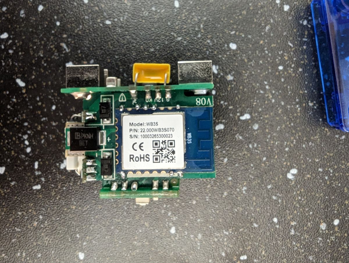

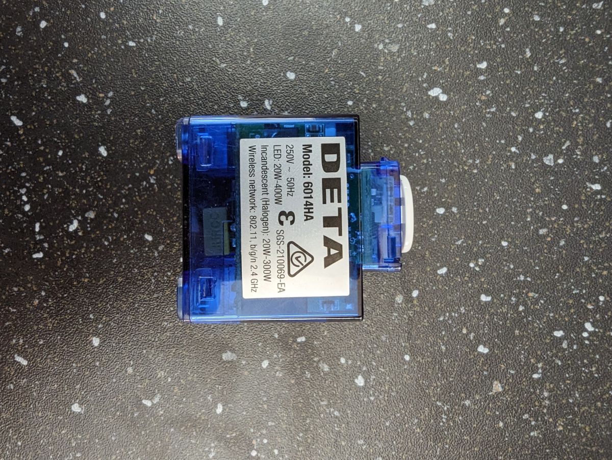

    Here is a device teardown and OpenBeken config for the DETA 6014HA Smart Switch Mechanism available from Bunnings Australia (https://www.bunnings.com.au/deta-smart-switch-mechanism_p0346912) or eBay.com.au
    It is a 250V AC switch, LED: 20W-400W / Incandescent(Halogen): 20W-300W load

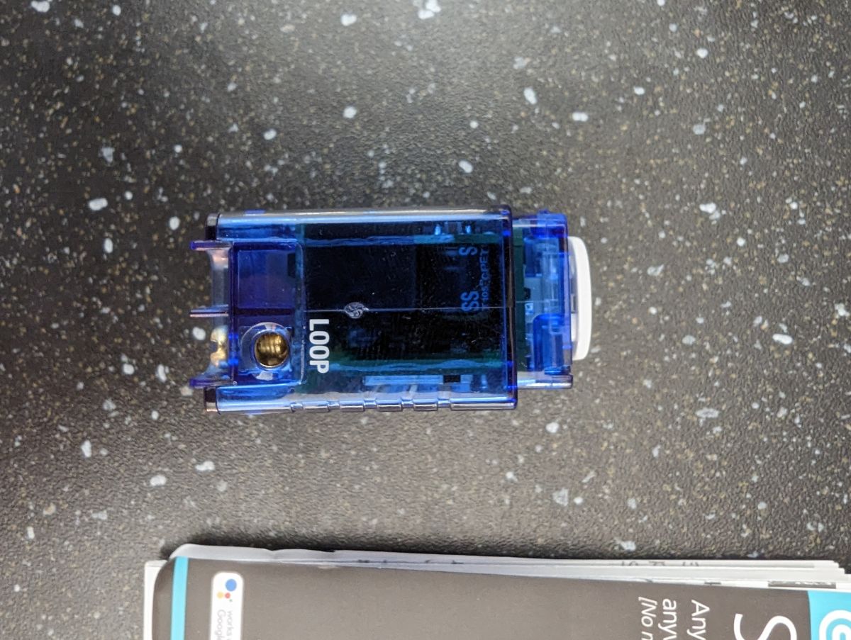

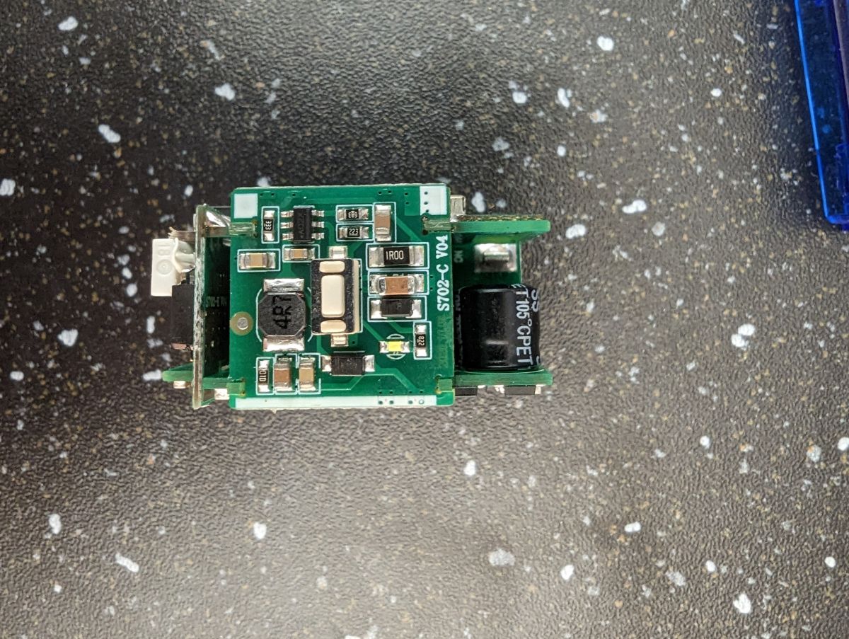

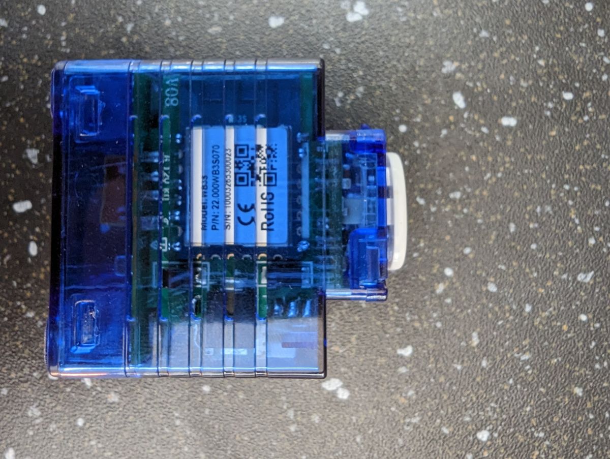

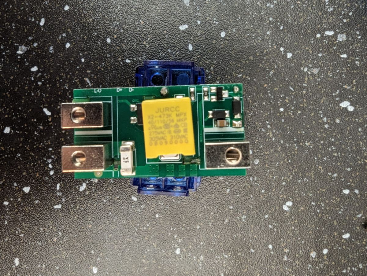

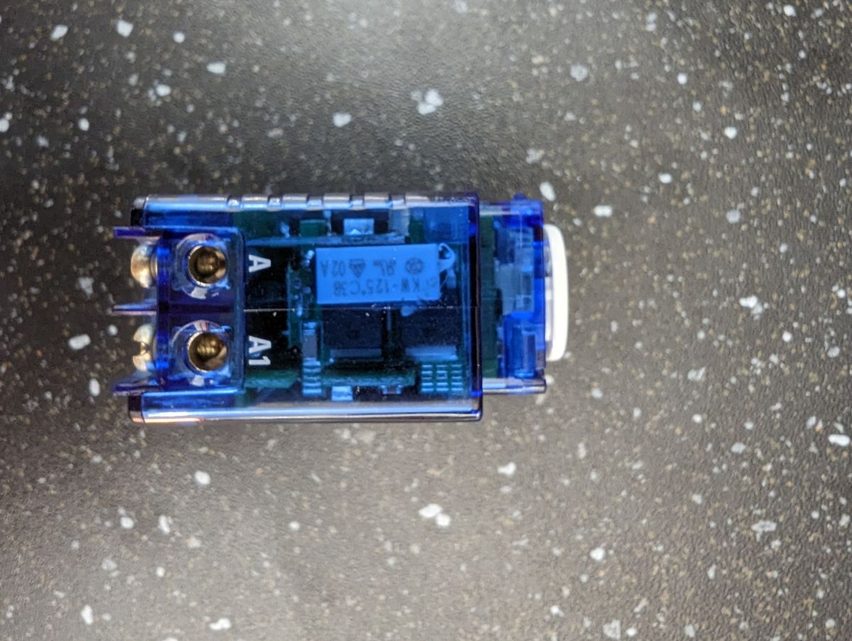

    Access to the chipset is straightforward, remove the 3 terminal post screws and then pry the 4 plastic tabs to remove the terminal cover. Drop the mechanism out.

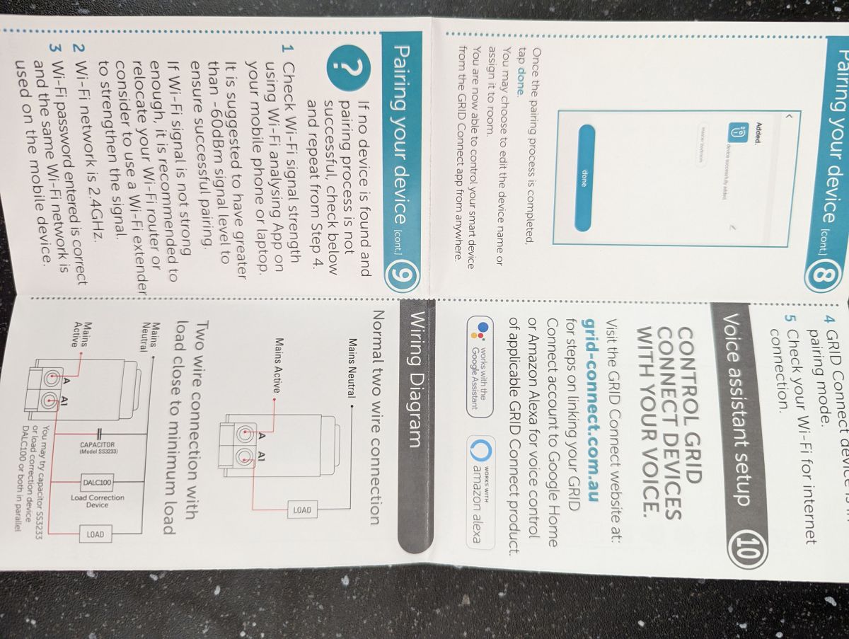

    This switch is a no neutral required, but does need a minimum load (20W). I was able to flash and test with an energy saving globe however it flashes when off (not enough load, DALC100 ordered)
    Cloudcutter profile available - https://github.com/tuya-cloudcutter/tuya-clou...o/blob/master/devices/deta-6014ha-switch.json.

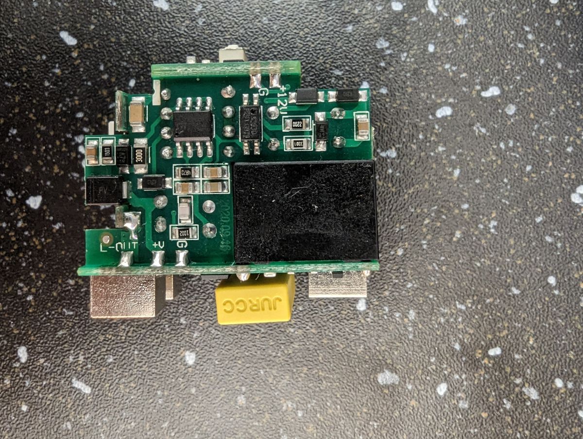

    Packaging and teardown images:
    [WB3S/BK7231T] DETA 6014HA Smart Switch Mechanism from Bunnings Australia [WB3S/BK7231T] DETA 6014HA Smart Switch Mechanism from Bunnings Australia [WB3S/BK7231T] DETA 6014HA Smart Switch Mechanism from Bunnings Australia [WB3S/BK7231T] DETA 6014HA Smart Switch Mechanism from Bunnings Australia [WB3S/BK7231T] DETA 6014HA Smart Switch Mechanism from Bunnings Australia [WB3S/BK7231T] DETA 6014HA Smart Switch Mechanism from Bunnings Australia [WB3S/BK7231T] DETA 6014HA Smart Switch Mechanism from Bunnings Australia [WB3S/BK7231T] DETA 6014HA Smart Switch Mechanism from Bunnings Australia [WB3S/BK7231T] DETA 6014HA Smart Switch Mechanism from Bunnings Australia [WB3S/BK7231T] DETA 6014HA Smart Switch Mechanism from Bunnings Australia [WB3S/BK7231T] DETA 6014HA Smart Switch Mechanism from Bunnings Australia [WB3S/BK7231T] DETA 6014HA Smart Switch Mechanism from Bunnings Australia [WB3S/BK7231T] DETA 6014HA Smart Switch Mechanism from Bunnings Australia
    Pin Configuration
    Pin 26 : Button 1
    Pin 24 : LED
    Pin 14: Relay 1
    Device information
    WB3S chip
    v1.1.0 firmware
    Other Information
    Supports multiple press via autoexec.bat scripting - https://www.elektroda.com/rtvforum/topic3946427.html
    I followed this example
