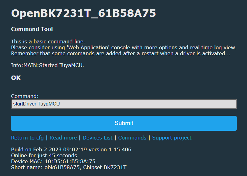

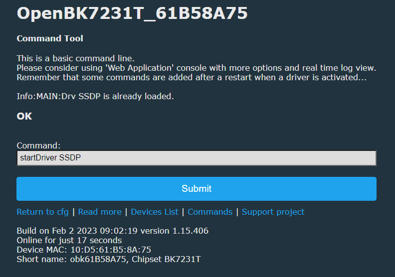

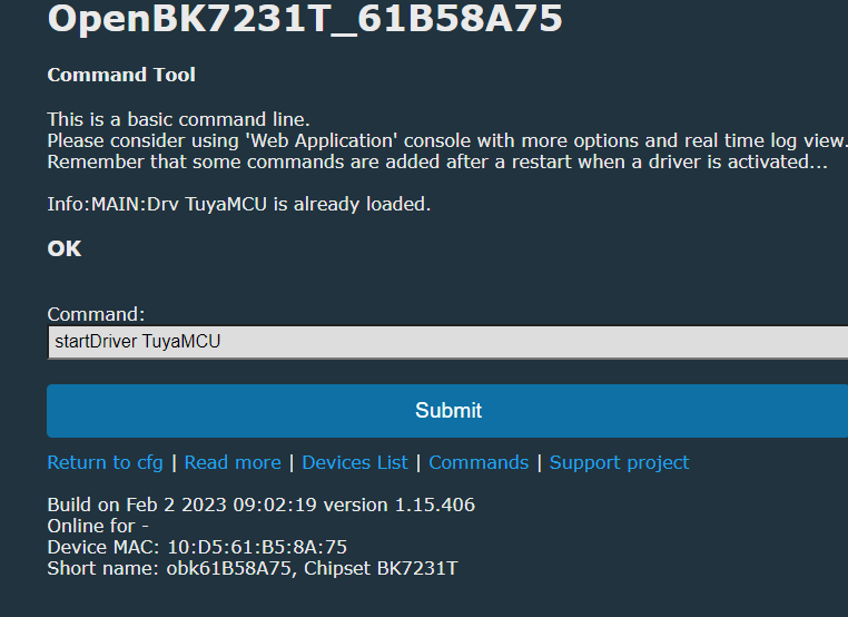

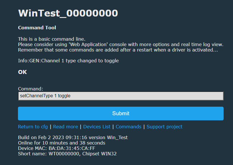

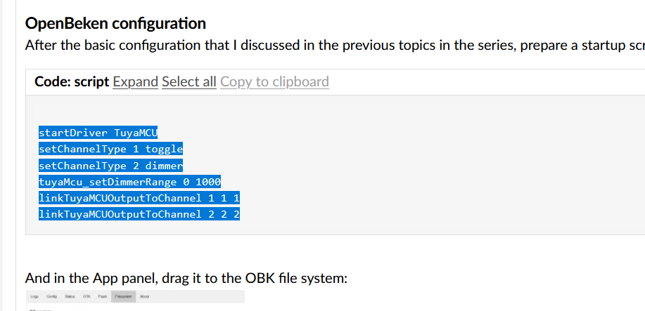

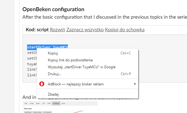

    Very strange... I have checked now and commands seem to be working for me as always in both basic console and in app:
    [BK7231] Melitec 8251-01-1-CM D110 LightZone Ceiling Light: Tuya MCU & OpenBeken Flash
    Not having setChannelType would mean that you might be running into the Safe Mode. Please let your device run for at least 30 seconds and then reboot and check again.

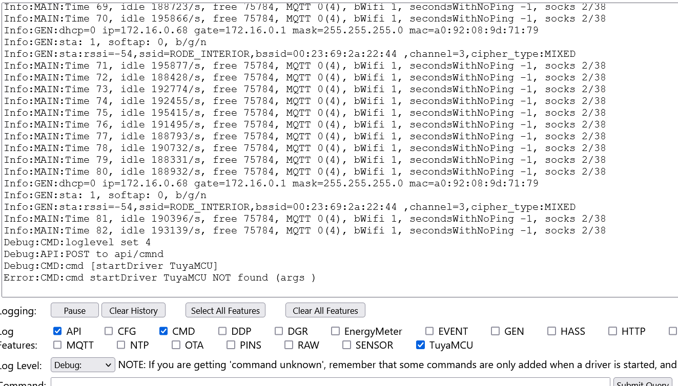

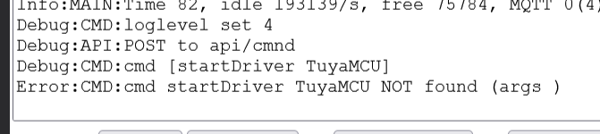

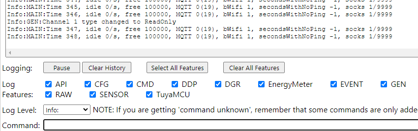

    Even startDriver TuyaMCU doesn't work in the webapp console...
    Prior to this, the device was on for 20 minutes and I did a reboot

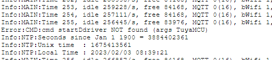

    How are you doing that, which version?
    How are you sending the command? Do you do that with some kind of "hard space" special character between "startDriver" and a driver name?

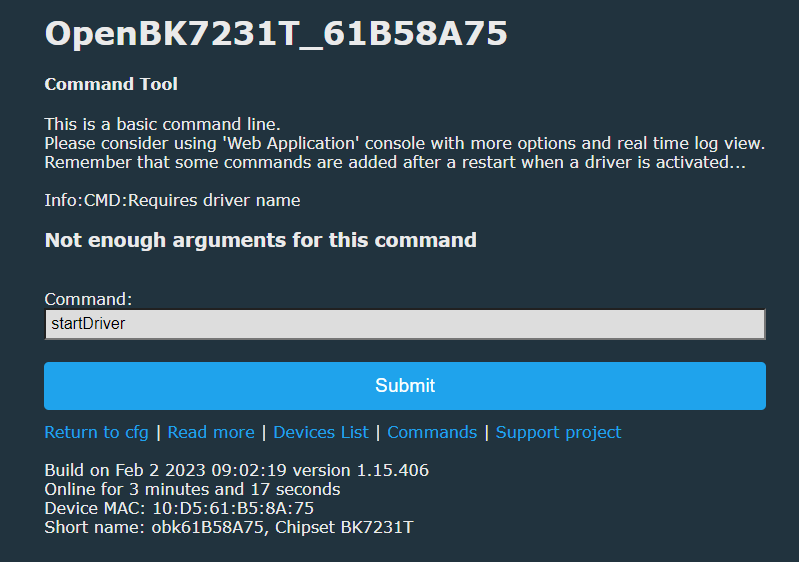

    What "startDriver" without any arguments gives you?
    You know what? See:
    why in my case, when I enter incorrect command, the command is still correctly split into the command and argument, and for you, the command entirely is shown as single token and args are empty?
    It really looks like you have some strange non-standard whitespace encoding.

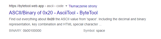

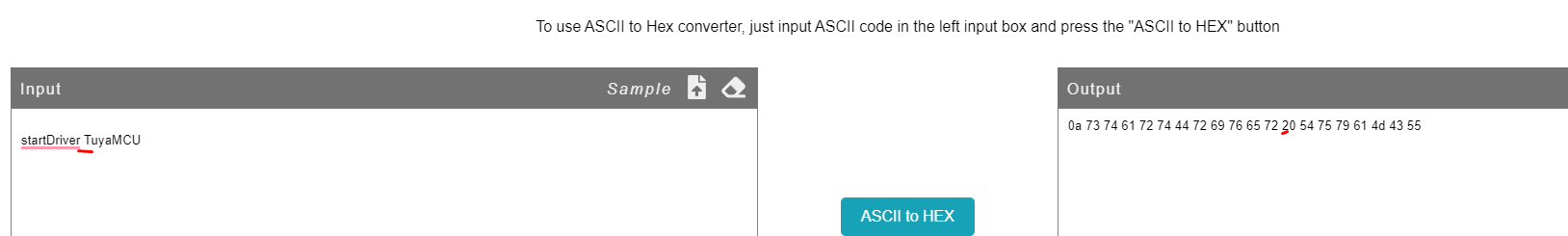

    This explains a lot, but....
    It still works for me after copy/paste:
    Can you help me investigate?
    Use this page:
    https://www.utilities-online.info/ascii-to-hex
    I get 0x20 here, a space, what do you get there?
    or use this:
    http://www.mauvecloud.net/charsets/CharCodeFinder.html
