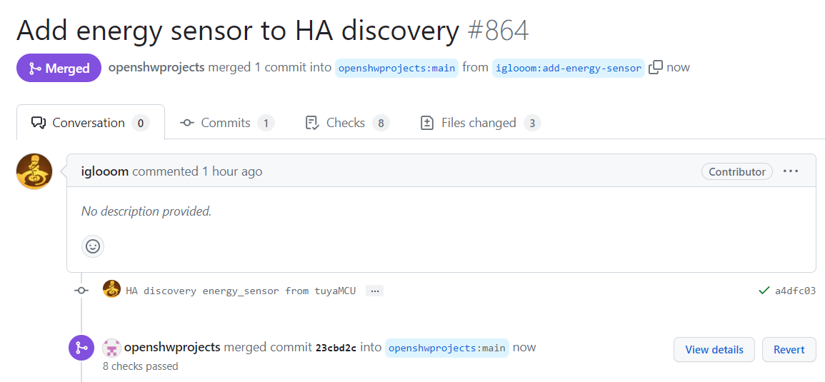

    I've created a PR https://github.com/openshwprojects/OpenBK7231T_App/pull/864 for EnergyTotal_kWh

    #36 20630133
    Posts: 14760
    Rate: 12886
    xglooom wrote:
    IMHO ability to use multiple same channels is good for future-proofing, so setting only the first channel by type I think makes sense anyway.
    The thing is that channel type Current is published via HASS discovery to Home Assistant as just a current, so even if you use it for leakage, Home Assistant Discovery will not work right.
    This is why I think the correct solution is to create channel type LeakageCurrent_div100 or anything.
    xglooom wrote:
    Perfect! Merged into main tree, thanks.

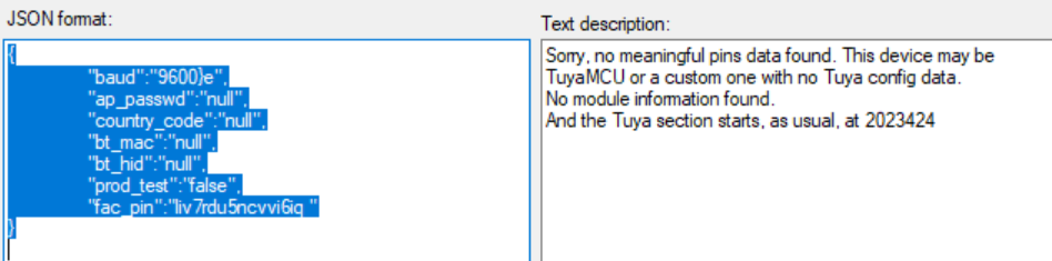

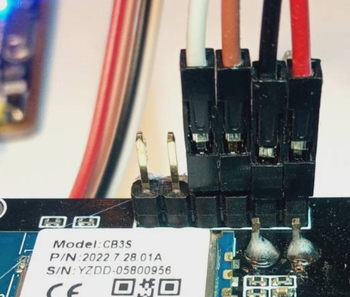

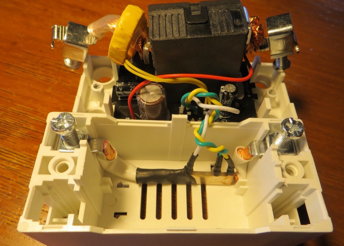

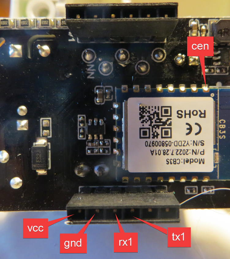

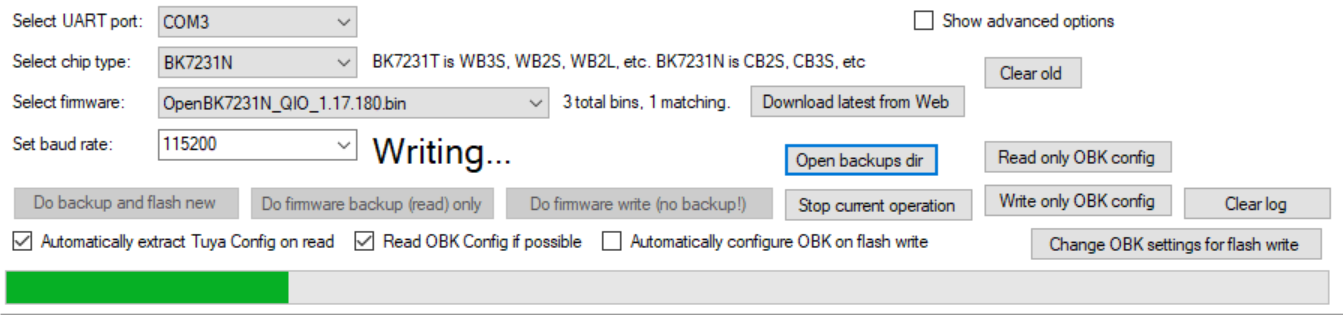

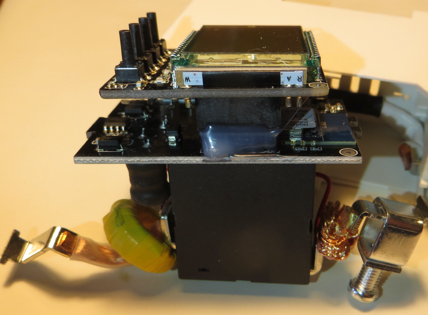

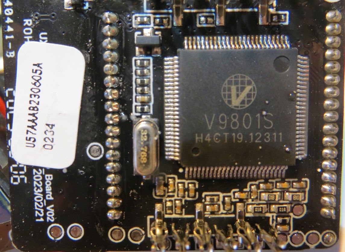

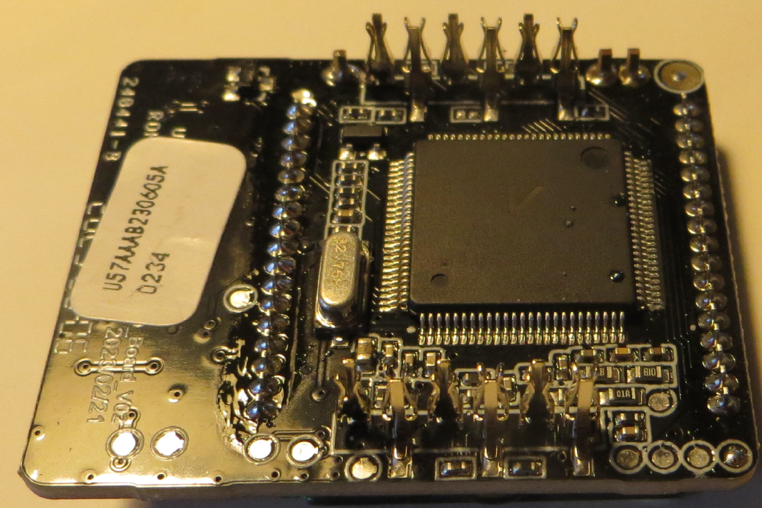

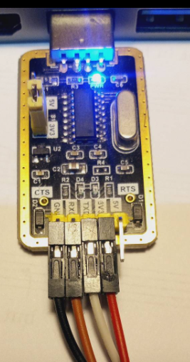

    Just for sharing my experience with the EARU EAMPDW-TY-63
    Flashing was easy with the BK7231 GUI Flash Tool 1.1.1 ( https://github.com/openshwprojects/BK7231GUIFlashTool/releases/tag/v1.1.1 ) , UART is nicely exposed via regular pins. Needed to short CEN to ground to get it going, and change baudrate to 115200.
    EAMPDW-TY63 Alternative Firmware: Access Measurement Data with OpenBeken via TuyaMCU EAMPDW-TY63 Alternative Firmware: Access Measurement Data with OpenBeken via TuyaMCU EAMPDW-TY63 Alternative Firmware: Access Measurement Data with OpenBeken via TuyaMCU
    As expected, no valuable info could be extracted from the backup firmware:
    Looking at the existing teardowns, https://github.com/vedga/eampdw-ty-63/tree/main/doc
    there is a difference in the board.
    This is board_v02 2023/02/21
    Running openbkn 1.17.175 with the suggested autoexec in this thread did the following :
    - toggle works
    - connecting anything to the output would show a very high leak current (25 ++ mA), and multiple times tripped the leak protection
    - voltage is ok, but no power measurement
    - log Warn:EnergyMeter:Consumed 256 unwanted non-header byte in BL0942 buffer
    Here are some images.

    #44 20647046
    Zogdan
    Posts: 25
    Help: 6
    Rate: 13
    I'm not sure how the leak current protection works exactly, it is independent of OpenBKN because the display flashes red, and switches off for 30 seconds, all managed by the V9801S.
    The V9801S SoC (see http://www.jiangsuwanwu.com/index/product?id=316) is actually a very complete power meter solution.
    Datasheet: https://datasheetspdf.com/pdf-file/941764/VangoTechnologies/V9801/1.
    To be followed up...
  • #45 20647222
    Posts: 14760
    Rate: 12886

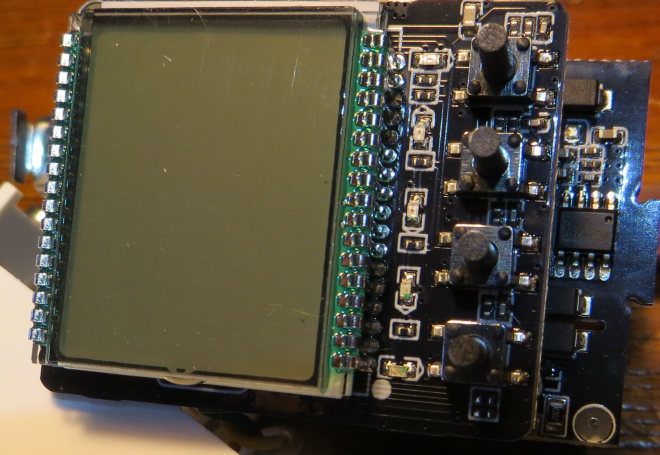

    So you have leakage current displayed on LCD? And the value is high on LCD?
    If so, it's not OBK fault, as the LCD connects directly to MCU, no WiFi module is involved.
  • Leak protection can be disabled in setup mode
    #46 20647226
    Zogdan
    Posts: 25
    Help: 6
    Rate: 13
    The original firmware shows the same behavior tripping immediately leak protection, so it is not openBKN related.
    Good enough that you can switch it off by going into setup mode (long press set, it should flash the digits) and going from 30mA->0mA = OFF
    So far Voltage and Power reading are ok, but current reading is not, nor total energy.

    #59 20972823
    njhuiz
    Posts: 10
    It seems that I've got a newer version of this device. The board with the display has the same date, but maybe the firmware of the V9801S is different. The second line of the sticker says 2155 instead of 0234 in the post above. The device always displays a leaking current of 2mA, so it could be working. I'll order a 22k high voltage resistor to test if it actually measures leakage.
    The IDs over 100 do not work for me. What I found (using tuyaMcu_sendQueryState) is
    ID 18. RAW (55 AA 03 07 00 18 12 00 00 14) with data:
    01 01 00 10
    03 01 01 0E
    04 01 00 AA
    08 00 00 1E
    09 01 00 00
    where bytes 3,4 is the 16 bit value for max Amps, bytes 7,8 are max Voltage and 11,12 min Voltage. I do not have an idea, what the rest of the bytes mean.
    It seems that the raw block is organized in blocks of 4 bytes. The first byte is sort of a channel number, the second byte can be zero or one and the following two bytes are a 16 bit value.
    The max Voltage for example can be set to 256 with
    tuyaMcu_sendState 18 0 03 01 01 00
    Byte two defines, if the condition triggers the relay. A 0 there will only cause the backlight to blink red, if the set condition is violated.
    Likewise ID 17 has 4 raw bytes
    04 01 00 64
    which corresponds the maximal leak current.
    ID 11 is an unknown bool.
    ID 13 is 0 value, which I could not change with send_state.
    IDs 1,6,15,16 are like described above.
    Is there a way to map these raw values?
