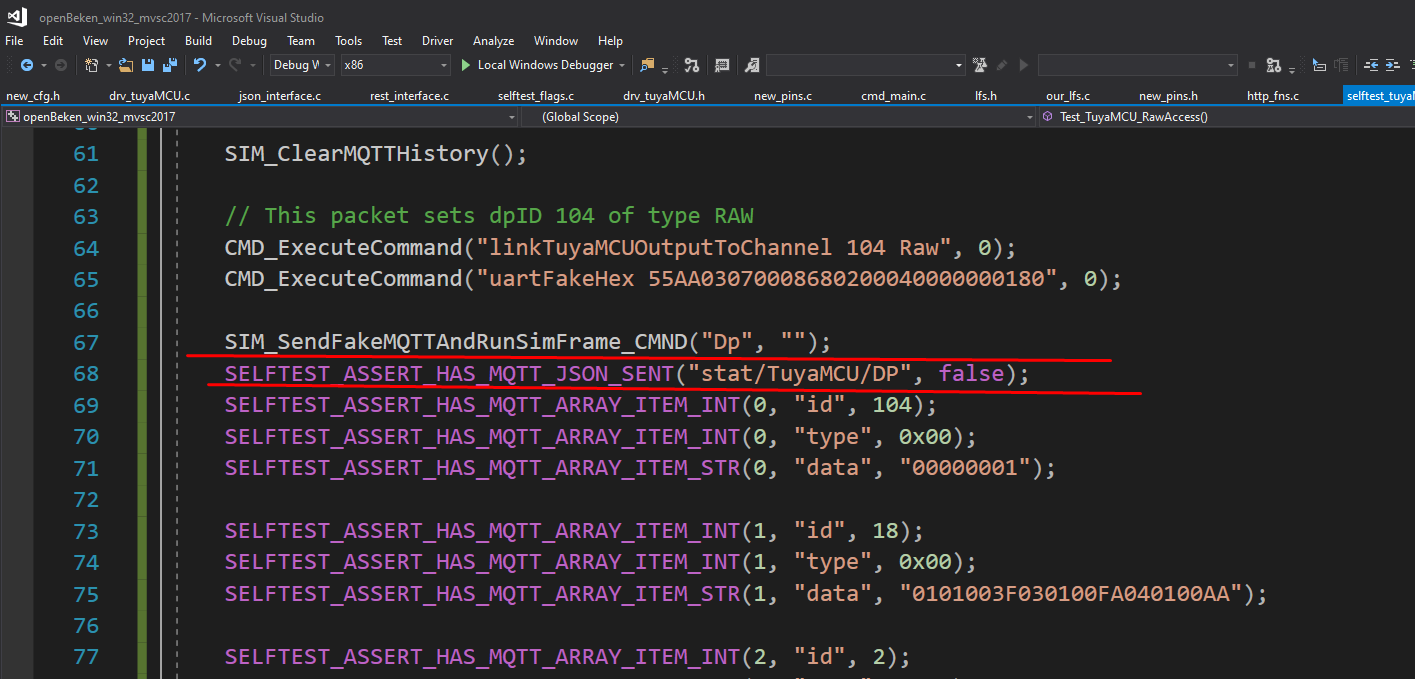

    I am very happy to hear that it works good for you. It indeed took some time to come up with it but I hope it will be a good solution for extending TuyaMCU devices support.
    As for MQTT, you can execute command again and it will publish this JSON under stat topic, see self test:
    Screenshot from Microsoft Visual Studio showing C code related to MQTT.
    Also remember that you can request only single dpID by doing command like:
    This will publish only dpID 23, not the full list.

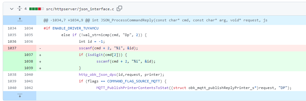

    #63 20925618
    Posts: 14770
    Rate: 12913
    In theory, even the self test on Windows Simulator should be enough to confirm that's working, but practice is always different. For example, here is what I fixed to get it working on BK (and not just on Windows):
    Screenshot showing code differences in the source file json_interface.c in the project.
    Normaly I'd have assumed that all sprintf's should behave in the same way, but somehow, that -1 was getting overwritten on BK even if there was no digits after "DP" string. It's most likely related to our lightweight sprintf replacement...

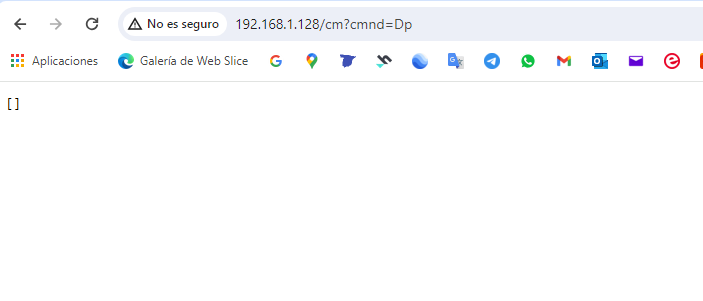

    #64 20929761
    morgan_flint
    Posts: 251
    Rate: 63
    Angel0fDeath wrote:
    I think, if @morgan_flint confirms this version works on the other device too, you can release it.
    I'm trying to reproduce what you did but I'm not very sure of being doing things right...
    First, I followed the instructions here, and then flashed the device OTA with OpenBK7231T_1048_merge_83754a936f15.rbl
    Then, I tried to reproduce what @Angel0fDeath posted here, but got an empty screen:
    Screenshot of browser showing empty result for a URL command.
    What an I doing wrong?
  • #65 20930032
    Posts: 14770
    Rate: 12913

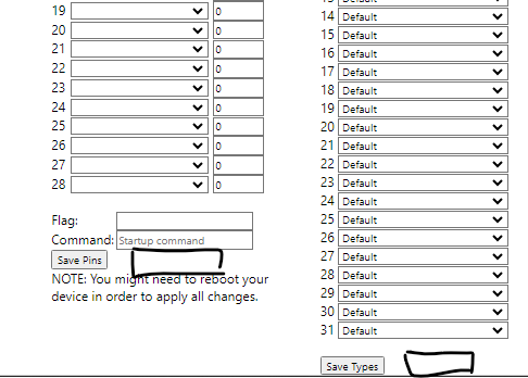

    You must enable a flag for this functionality first.
  • Enable flag 46 and map all dpids via autoexec.bat
    #66 20930067
    Angel0fDeath
    Posts: 118
    Rate: 33
    @morgan_flint Yep. First enable flag 46, save and if necessary reboot. Then try to issue the command
    Also be sure all dpid's are mapped. OTA update will wipe autoexec.bat. It doesnt matter on which channels dpid's will be mapped. Just need to be mapped. It won't work without mapping. Well probably the type of the channel should also be correct :)
    EDIT: I think this is already included in official release 1.17.425, so you can try with this.
    Changes
    increase MQTT_MAX_QUEUE_SIZE to 32 to support 16 relay devices (1683343)
    Tuyamcu raw access (#1048) (55e2a66), closes #1048
    Assets
    I will try it ...
    Just be sure after flashing you enable corresponding flag and map dpid's via autoexec.bat
    EDIT2: Ok. It works by me. Upgrade to official release v. 1.17.425. Install your autoexec.bat. Enable Flag 46. Reboot.
    Then issue command and should work

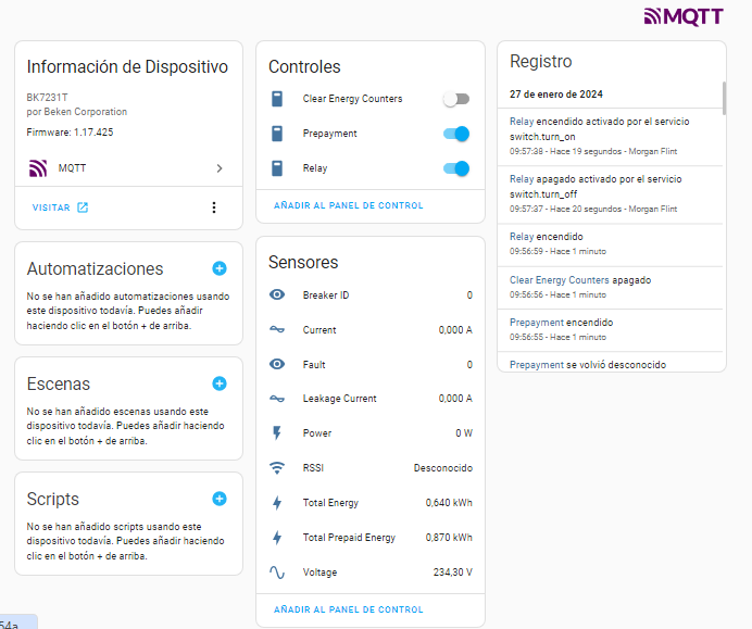

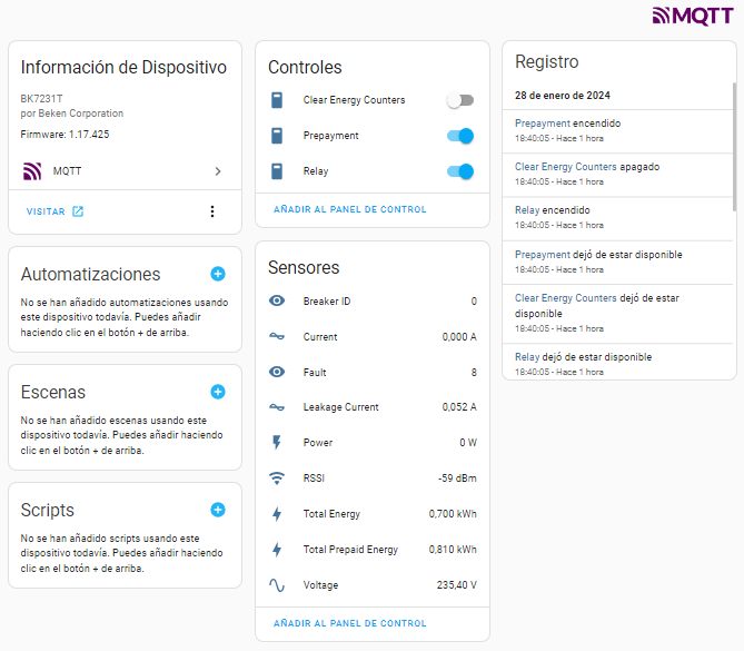

    #67 20931165
    morgan_flint
    Posts: 251
    Rate: 63
    Ok, done on TOMPD-63 WIFI:
    Device view in Home Assistant:
    Screenshot of the OBK application interface displaying device information for BK7231T and switch statuses.
    I'll try on the other device and report here
    (EDIT: added Home Assistant)

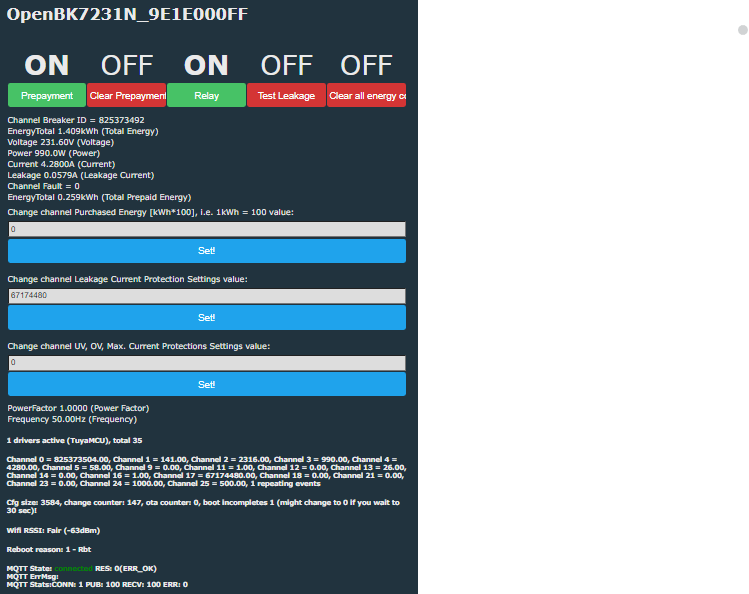

    Added after 2 [hours] 49 [minutes]:
    Tested on the other device (TOMPD 63 - LW). Apparently, it works well also:
    The autoexec.bat, cloned from TOMPD63-WIFI except from the different DpIDs:
    // start TuyaMCU driver
    startDriver TuyaMCU
    tuyaMcu_setBaudRate 9600
    // This one is better than tuyaMcu_defWiFiState 4;  MQTTState 1 = WiFiState 4
    // issuing of tuyaMcu_defWiFiState 4 continues the script,
    // but doesnt report to MQTT since there is still no connection.
    // if you didn't setup MQTT connection then issue tuyaMcu_defWiFiState 4
    // and comment waitFor MQTTState 1
    waitFor MQTTState 1
    // tuyaMcu_defWiFiState 4
    // Breaker Id - Dpid 19 "breaker_id" - channel 0
    linkTuyaMCUOutputToChannel 19 3 0
    setChannelType 0 ReadOnly
    setChannelLabel 0 "Breaker ID"
    // Total energy - Dpid 1 "total_forward_energy" - channel 1
    setChannelType 1 EnergyTotal_kWh_div100
    setChannelLabel 1 "Total Energy"
    // Measurements - Dpid 6 "phase_a" - channel RAW_TAC2121C_VCP -> 2,3,4
    // TAC2121C VoltageCurrentPower Packet
    // This will automatically set voltage, power and current
    linkTuyaMCUOutputToChannel 6 RAW_TAC2121C_VCP
    setChannelType 2 Voltage_div10
    setChannelLabel 2 "Voltage"
    setChannelType 3 Power
    setChannelLabel 3 "Power"
    setChannelType 4 Current_div1000
    setChannelLabel 4 "Current"
    // Leakage current - Dpid 15 "leakage_current" - channel 15
    linkTuyaMCUOutputToChannel 15 val 5
    setChannelType 5 LeakageCurrent_div1000
    setChannelLabel 5 "Leakage Current"
    // Fault - Dpid 9 "fault" - channel 9
    linkTuyaMCUOutputToChannel 9 val 9
    setChannelType 9 ReadOnly
    setChannelLabel 9 "Fault"
    // Prepayment on-off - Dpid 11 "switch_prepayment" - channel 11
    linkTuyaMCUOutputToChannel 11 bool 11
    setChannelType 11 toggle
    setChannelLabel 11 "Prepayment"
    // Clear Prepayment - Dpid 12 "clear_energy" - channel 12
    linkTuyaMCUOutputToChannel 12 bool 12
    setChannelType 12 toggle
    setChannelLabel 12 "Clear Prepayment"
    // Prepaid energy - Dpid 13 "balance_energy" - channel 13
    linkTuyaMCUOutputToChannel 13 val 13
    setChannelType 13 EnergyTotal_kWh_div100
    setChannelLabel 13 "Total Prepaid Energy"
    // Charge Prepayment - Dpid 14 "charge_energy" - channel 14
    setChannelType 14 textfield
    setChannelLabel 14 "Purchased Energy [kWh*100], i.e. 1kWh = 100"
    linkTuyaMCUOutputToChannel 14 val 14
    // Main Relay - Dpid 16 "switch" - Channel 16
    linkTuyaMCUOutputToChannel 16 bool 16
    setChannelType 16 toggle
    setChannelLabel 16 "Relay"
    // Settings 1 - Dpid 17 "alarm_set_1" - channel 17
    linkTuyaMCUOutputToChannel 17 raw 17
    setChannelType 17 textfield
    setChannelLabel 17 "Leakage Current Protection Settings"
    // Settings 2 - Dpid 18 "alarm_set_2" - channel 18
    linkTuyaMCUOutputToChannel 18 raw 18
    setChannelType 18 textfield
    setChannelLabel 18 "UV, OV, Max. Current Protections Settings"
    // Test Leakage - Dpid 21 "leakagecurr_test" - channel 21
    linkTuyaMCUOutputToChannel 21 bool 21
    setChannelType 21 toggle
    setChannelLabel 21 "Test Leakage"
    // Clear all energy - Dpid 101 "clr_all_energy" - channel 23
    linkTuyaMCUOutputToChannel 101 bool 23
    setChannelType 23 toggle
    setChannelLabel 23 "Clear all energy counters"
    // Power factor - Dpid 104 "power_factor" - channel 24
    linkTuyaMCUOutputToChannel 104 val 24
    setChannelType 24 PowerFactor_div1000
    setChannelLabel 24 "Power Factor"
    // Grid frequency - Dpid 105 "supply_frequency" - channel 25
    linkTuyaMCUOutputToChannel 105 val 25
    setChannelType 25 Frequency_div10
    setChannelLabel 25 "Frequency"
    // NOTE: addRepeatingEvent [RepeatTime] [RepeatCount]
    // code below will forever Send query state command every 5 seconds
    addRepeatingEvent 5 -1 tuyaMcu_sendQueryState
    // AngelOfDeath - We don't need it forever, since TuyaMCU sends everything when necessary
    // we need it just first time to obtain initial status. Some dpIDs not reported without asking
    // tuyaMcu_sendQueryState
    (uncommented "addRepeatingEvent 5 -1 tuyaMcu_sendQueryState " because it refreshed data less frequently than the TOMPD63-WIFI)
    And the screenshot of OBKs main page:
    Screenshot of the OpenBK7231N interface homepage showing various settings and readings.

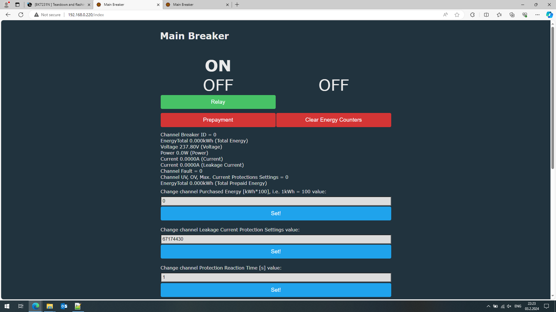

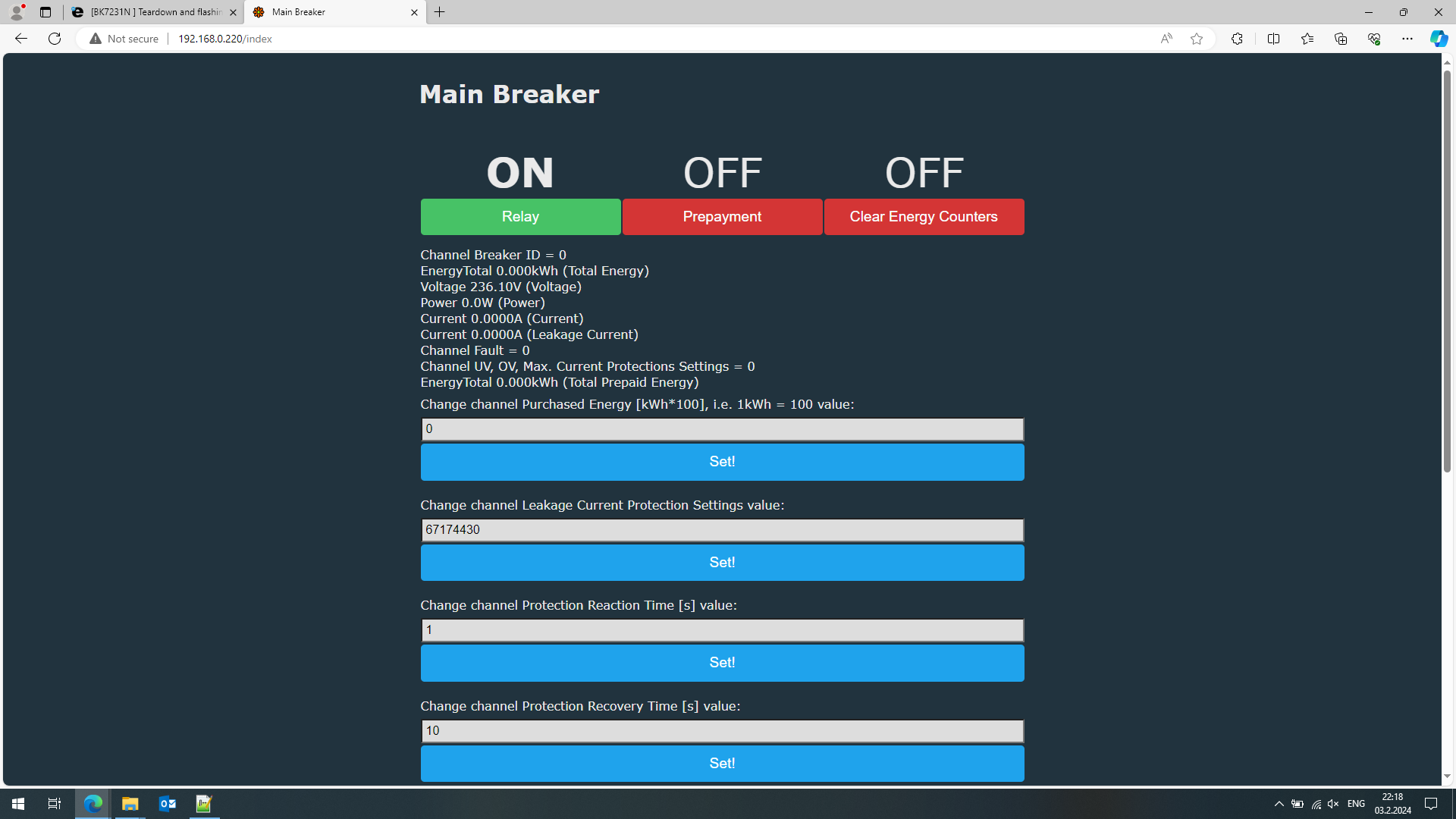

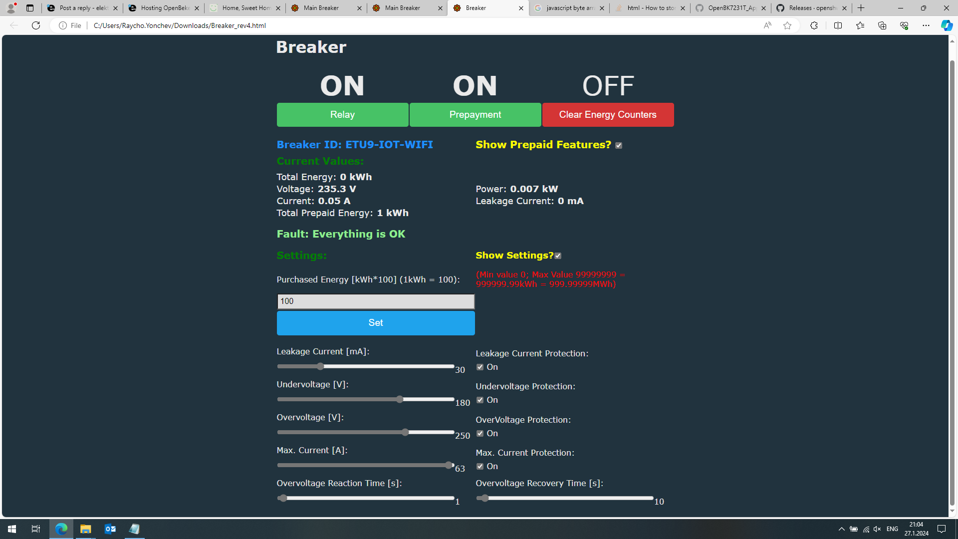

    So now it's time to come up with some kind of better REST page for the device. Can I help somehow more with that?

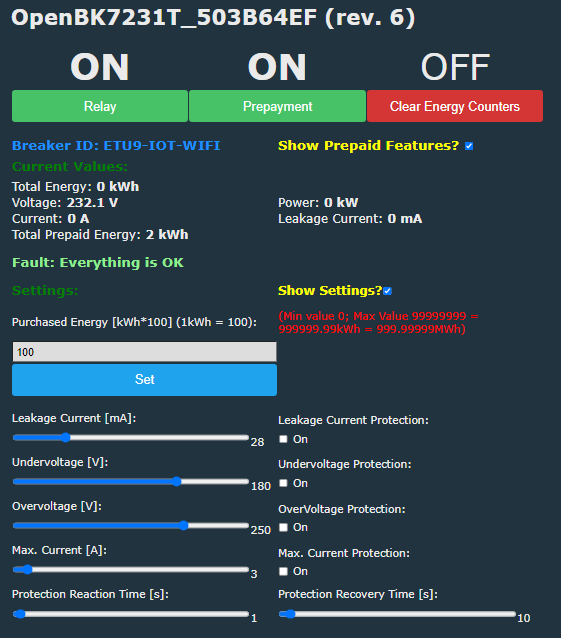

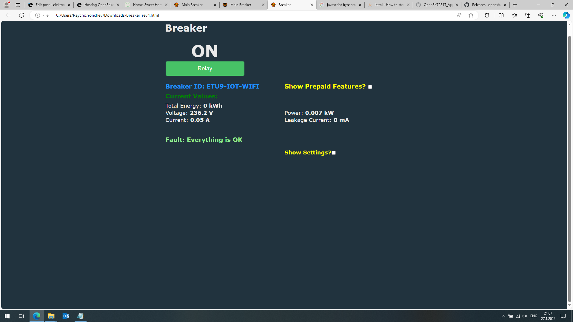

  • REST page update with dpid mapping changes
    #69 20931905
    Angel0fDeath
    Posts: 118
    Rate: 33
    @p.kaczmarek2 @morgan_flint Better REST page - I'm working on that. Already can read all dpID's and set some of them. I would like to make the REST page independent of channels mapping although dpids should be mapped. Currently dpid 17 & 18 set correct.
    Actually all dpids can be set correct, but some of them are set via SetChannel (so still depending on channel mapping). Will rework this tomorrow...
    Attached are current autoexec.bat and Breaker REST (page rev. 4)
    Changes in autoexec.bat
    1. I rearranged again some channels in order to appear more or less as alternative control page. Original page also shows them in order - from 0 to xxx.
    2. DpID18 remapped on channel6 (to be shown before settings which we can set). The channel is RAW and ReadOnly.
    3. Relay remapped on channel10 to be show before other tolgles, as it is already shown on alternative web page
    4. Dpid17 - remains on channel 17 but map definition changed. Channel is VAL instead of RAW. This way it is possible to change (set) Leakage current protection settings from main page also. Well you will need calculator, but now this is possible.
    Breaker alternative control page:
    1. All dpid's are read by new implemented command Dp and correspondingly the values are set in web page
    2. DpID 17&18 - set via raw uart send command.
    3. All other dpids, which can be set are as before - via SetChannel command.
    IMPORTANT: In order html script to work all dpId's should be mapped and the correct type of channel should be given (for instance I changed dpid17 from RAW to VAL). It doesn't matter on which channels dpid's will be mapped (full support will come tomorrow) but for this release please check Channels mapping in html script. In general I suggest to use attached autoexec.bat.
    @morgan_flint Please give some feedback if something doesn't work correct
    @p.kaczmarek2 As I promised when I finish this REST page will submit it as PR to your repository with full comments inside. Currently comments are just for me and to keep filesize lower... Script is already about 23KB....
    EDIT: In general with attached files everything should work. I just would like to make REST page more independent by setting everything by uart send command.
    • Breaker_rev4.zip (5.15 KB) You must be logged in to download this attachment.
    • autoexec_20240127.zip (1.3 KB) You must be logged in to download this attachment.
  • clearIO needed before defining channels; dPID19 appears read-only

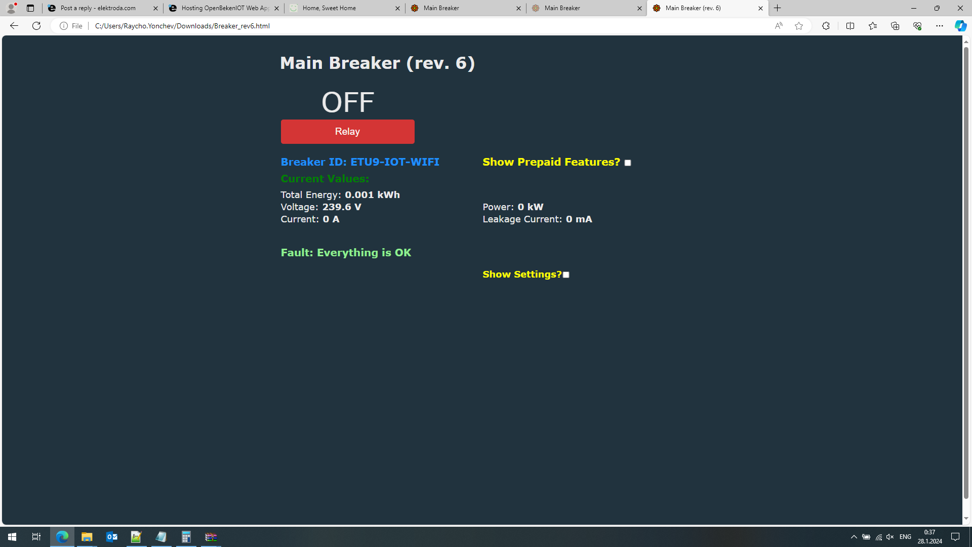

    #70 20931965
    Angel0fDeath
    Posts: 118
    Rate: 33
    [BK7231N ] Teardown and flashing of Tomzn TOMPD-63 WIFI (not to be confounded with TOMPD-63LW)
    Probably is good idea to add clearIO command in the beginning of the script. This will clear all previous definitions. Or set these channels manually to Default in web app -> config
    EDIT: Also just tested - dpID19 - Breaker ID - I was not able to change it via uart raw command, so it seems this is read only on my device. However you can try to set this in the other device you have.
  • #71 20932137
    Posts: 14770
    Rate: 12913
    That's good to hear, please submit a screenshots from this page as well, and maybe a photo of the device. We could make a separate topic in "Teardowns" section for that, so it's not lost on the fourth page of discussion.

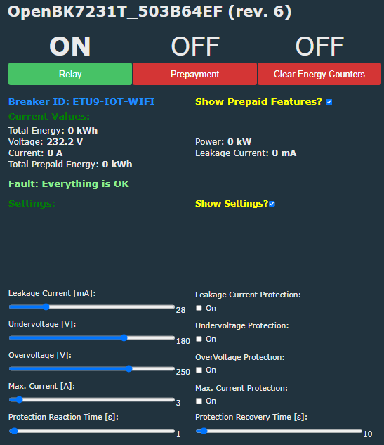

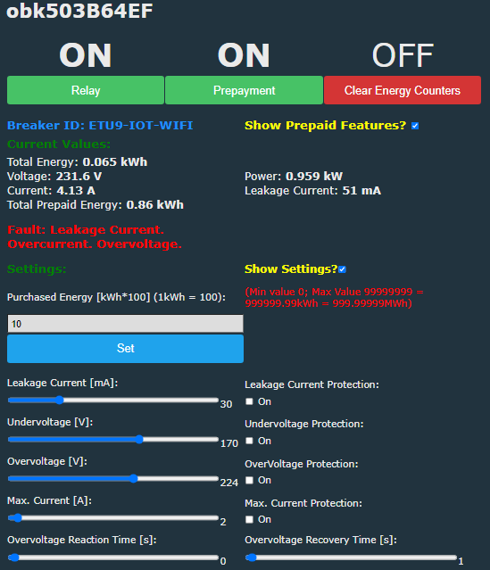

  • REST page should be decoupled from autoexec.bat
    #72 20932186
    Angel0fDeath
    Posts: 118
    Rate: 33
    @p.kaczmarek2 Photo of the device we already have in post No. 1 in this topic. Photo sent by @morgan_flint
    Here is picture of REST screen:
    The above is with all settings ON.
    Usually user don't need settings each time. This is normal load of the page:
    Screenshot of a user interface for a Breaker device.
    But as I said, I would like to make this REST page independent as much as possible from autoexec.bat.

    @morgan_flint Ok. I've got it. In order to process correct the event when tuyaMCU changes from 1 byte report up to 4 bytes report for dpID9 (fault) this dpID should be of type RAW. Then, at least by me everything is processed ok.
    I'm attaching the corresponding autoexec.bat and Breaker.html rev.5
    Nevertheless please check again with your devices and report.
    • Breaker_rev5.zip (5.16 KB) You must be logged in to download this attachment.
    • autoexec.zip (1.3 KB) You must be logged in to download this attachment.

    Nevertheless I already changed this in my REST page, but I can quickly return to previous
    Main breaker screen (rev. 6) showing device status and information.
    Even added version number... but this (rev 6) will be published tomorrow after everything is ok :)
    I've also had that problem (some channels incorrectly set by a previous autoexec, for example), so I created a "resetchannles.bat" with 32 lines like "setChannelType n default". Now I see there was a much more efficient way to do that with just one command... Anyway, it could be a good idea to have a button for that in the web application, for example as in the following picture, to clear all pins or set all channels to default... What do you think?
    Screenshot of a web application form with dropdown lists for channels and a Save Types button.
  • #76 20933390
    Angel0fDeath
    Posts: 118
    Rate: 33
    @morgan_flint Yes it will be better with buttons, but you can always issue clearIO command in logs page or this to be the first command in all your scripts.
    clearIO clears both - pins and channels.
    And yes - you have some homework to do :)
    Tested and works OK, and apparently I can apply all faults in a brief period without problems in detecting them. This is an screenshot with 3 faults simultaneously:
    Screenshot of ETU9-IOT-WIFI device configuration showing settings and current electrical network values.
    I also could check that Overvoltage Recovery Time does not only affect overvoltage, but also the other protections (couldn't check it with undervoltage, but I imagine it's like that)
    For example, if Overvoltage Recovery Time is set to 5 and an overcurrent or over leakage current condition appears, it waits 5 seconds before reconnecting the switch (three tries and then stays off unless the condition disappears first). For overvoltage, as expected, it'll wait 5 seconds before reconnecting once the overvoltage condition disappears. So, for voltage protection, is effectively a "recovery time", but for leakage and overcurrent it is a "retry delay time".
    On the other hand, Overvoltage Reaction Time doesn't seem to affect the leakage current protection (it trips immediately, regardless of this setting), but it also affects overcurrent, as it waits for the settled reaction time before tripping (same as with overvoltage and, presumably, with undervoltage).
    Regarding the Home Assistant integration, it seems to have still some problems when DpID 09 is longer than one byte, as it shows correctly a value of 8 with leakage current but turns to 0 if I apply simultaneously overvoltage and/or overcurrent. Could this be because of the way this DpID is sent with MQTT?
    Screenshot of an energy management system control panel with device information, controls, and sensor data.
    I also did some experiments with the other device. As DpIDs 104 and 105 have another meaning, I commented out the corresponding lines in your autoexec. The Breaker_rev5.html didn't seem to work well, the measurements were not shown and, regarding protections' settings, it seemed to have a random behavior. I'll make some more tests and report after a second look at the autoexec

  • Final html script revision uses mapped dpIDs only
    #84 20954679
    Angel0fDeath
    Posts: 118
    Rate: 33
    @morgan_flint Ok. I think this will be the final revision of html script.
    Now the script is fully independent from channels and depends only on dpID's, however dpID's should be mapped. It doesn't matter on which channel, but should be mapped and data type should be correct.
    I'm attaching also my autoexec.bat file - again some rearrangements, but you can use only channel type. Of course I added ClearIO command and even if you use this file everything should work :)
    The script works with dpID's, however the driver functions which script uses are functioning with mapped channels only.
    After a lot of testing, I found out that actually you can use the same value to set dpID14. If there is no prepaid energy set, this command is executed immediately. If some energy is already set, I don't know why, but execution of this command takes few seconds (actually between 3 and 5 seconds). Clear prepaid energy and set for instance 100 (1 kWh). Then use the same value and wait about 5 sec - you will see it works. Now clear again prepaid energy and use the same value - again it works, but immediately. Really don't know what is going, but this is from the device, since I'm setting everything the same way. Finally, I left it as before (without zeroing the input line as we spoke above).
    Please test and give some feedback.
    If everything is ok - will rework the script for your other device.
    Thank you all for the support.
    • Breaker_autoexec_20240203.tar (10 KB) You must be logged in to download this attachment.
    • Breaker_rev6.zip (5.42 KB) You must be logged in to download this attachment.
  • Prepayment off disables purchased energy channel change
    #85 20954945
    morgan_flint
    Posts: 251
    Rate: 63
    I just tested it; everything seems to work ok.
    I think we've commented on this before: When the prepayment is turned off, the device doesn't respond to the "Change channel Purchased Energy" (original OBK web interface).
    As I can see, this field disappears from the web interface in your script when prepayment is turned off, which makes sense as it wouldn't work in that case:
    User interface of the OpenBK7231T device with various current settings and values. OpenBK web interface displaying energy information and settings.

    @morgan_flint Yep. Correct. All the logic and limitations implemented in the script (or at least I tried). For instance threshold bars - ranges as per specifications. Prepaid energy hidden if not set etc. Please test again everything. I want to be sure everything is ok, not just by me...
    EDIT: If you have suggestions about design (how page looks) - you are welcome, but such changes... I really hate to design pages, so propose your design in such case (in html format of course) :)
    EDIT1: Probably "prepaid energy" fields is better to be moved at the end of the web page. This can be done easily without you to submit anything :) See attached file. This way there will be no gap, if prepaid is OFF
    • Breaker_rev6.1.zip (5.42 KB) You must be logged in to download this attachment.
  • #87 20955378

    @morgan_flint There is no command to ask for just 1 dpID state. Moreover it seems channels are published only if there is a change.
    However you can force channel publishing via MQTT with:
    addRepeatingEvent 5 -1 backlog publishChannel 6; publishChannel 9; etc.
    From your pc or application you can ask for Dp6 only with IP/cm?cmnd=Dp6
    html script uses also the same command, but for all dpID's - IP/cm?cmnd=Dp. html script updates each 1 sec. -> setInterval(getDPIDs,1000)
    EDIT: Although html script updates each 1 sec, it receives current state of the dpID's (just checked). The script doesn't force dpID update, although I can implement this feature (@pkaczmarek2 posted the command below, but I know it), but after that it will be difficult to decide when exactly to start reading updated values, since we never know when TuyaMCU finished with the updates. Sometimes is immediately, sometimes takes few seconds... I also really cannot imagine which application, you are speaking for, can require such refresh rates you are asking for... Is it really necessary to know the state of dpID 6 each second or half second? And if you know this value what actions you will perform? The device is designed to perform all necessary actions and the output information is just... well information, or at least this is my understanding. In general the device will take the necessary actions, if set accordingly, before you even receive the information, regardless updates which you can request even each second or even half second. The script (html) updates each second to be relevant - nobody wants to set the relay and to receive feedback after 5 seconds (for instance)...
    Probably if you share your idea, why you need such high refreshments we can think something...
    And if you really need such quick update you can probably consider buying some professional devices... But speaking about professional devices - the only difference probably will be the price and reaction time of the protections. Well reliability also. You will always receive the info with delay... it is always 'post factum' - after event occurs
    The conclusion is: You are not controlling the device. Device informs you what happened. You can only adjust device's settings in order to achieve the best performance from the device. Everything else is just monitoring of the values or device data and logs are helping in issues resolving, if any

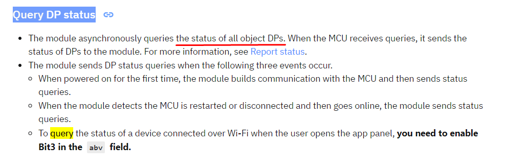

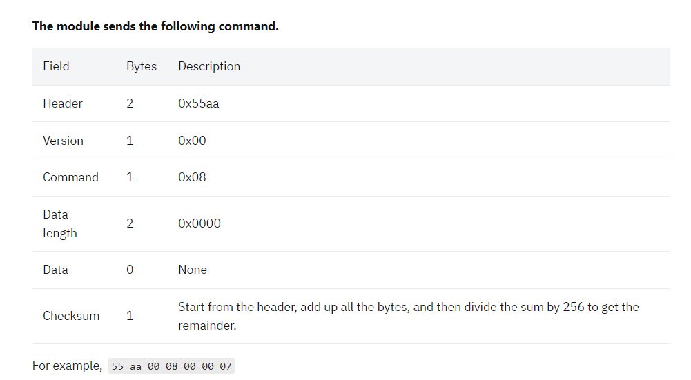

    OpenBeken command tuyaMcu_sendQueryState uses Query DP status Tuya packet which is defined in the following way:
    Screenshot of documentation about Tuya DP status query. Table showing the structure of a command sent by the module.
    It queries update of all dpIDs, it is not possible to query a single dp.
    It's just a simple packet without argument:
    55 aa 00 08 00 00 07
    So, as far as I know, it's not possible to request single DP update. That's a shame, they could very well just allow sending 0x08 command with a single payload byte as argument (dpID) and report only that, but as far as I know, there is nothing like that in Tuya specs

How can I read raw TuyaMCU data as hex over HTTP or MQTT using the OBK Dp and DPxx commands?
Enable the raw DpID feature, map the DpIDs, then query them with Dp or DPxx. Dp returns a JSON array of all mapped DpIDs, including id, type, and data, while DP23 returns one DpID only. Over HTTP, users called IP/cm?cmnd=Dp; over MQTT, the same command published JSON to the stat topic. Raw fields appear as hex strings, and string DpIDs like 19 appear as decoded text. This solved the long-standing visibility problem for DpIDs 17, 18, and 19. [#20925335]

How do I host the alternative TOMPD-63-WIFI HTML control page on LittleFS when the file is too large, and what can I trim or reconfigure to make it fit?
Trim the HTML and autoexec.bat, or increase usable LittleFS space. Users made the page fit standard LittleFS by removing comments, blank lines, and indentation, reducing the HTML to 20,316 bytes and autoexec.bat to 1,733 bytes. Another option is to reconfigure LittleFS size and block settings, then restore files after OTA if needed. A newer WebApp also added an “Upload file” button, which helped Linux and Android users upload the trimmed files without drag-and-drop issues. [#21310442]
