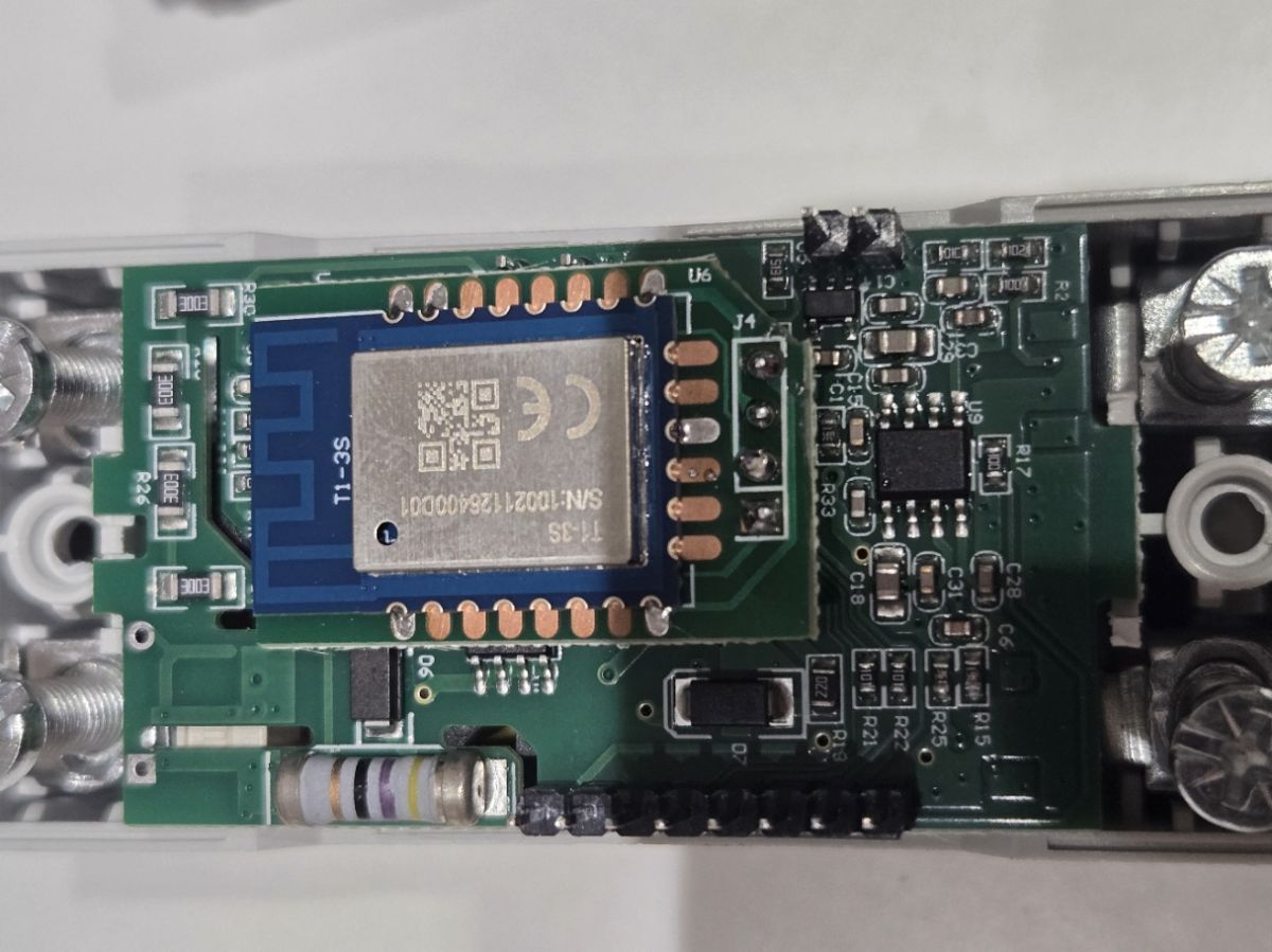

    just in case attached is also a backup of the orig fw and a pdf of the "manual" from my device
    @p.kaczmarek2
    xury wrote:
    How can you upload Openbeken without soldering? If you have dump flash from one, can you use it for others? I'm asking because in the case of, for example, Sonoff, you need to have the original backup.
    To program other devices without soldering, you need a full dump of flash memory (2MB) from a device from the same series and with the same build version. Then it's handed over to the Cutter team to add support, but that's what I can do now - just do a full 2MB read and post the dump.
    could u send the attached backup orig fw to the cloudcutter team?
    • earu-eampdw-ty63-manual.pdf (1.24 MB) You must be logged in to download this attachment.
    • earu-eampdw-ty63-orig-backup.bin (2 MB) You must be logged in to download this attachment.
  • Leakage current transformer appears mispositioned on one pole
    #77 21613612
    morgan_flint
    Posts: 251
    Rate: 63
    Zogdan wrote:
    Just a small warning on quality:
    I bought a few more of these devices, and they all have the same problem with measuring leak current.
    The RCD function (Residual Current Device) of the EAMPDW-TY63 is unusable and you should not rely on that as a protection device, since it consistently reads too high values, tripping the set protection. If readings are so much all over the place you might wonder if it is reading anything useful, so I just switch it off...
    For completeness or those searching : the printed sticker says EARU EAMPDW-TY-63
    Hello @Zogdan and rest of topic followers.
    I understand the quoted post is old, but just in case you didn't solve the problem and/or others are having the same.

    Hi everyone. I've bought a few EARU EAMPDW-TY-63 devices, and it seems like there's a new revision with T1-3S module instead.
    T1-3S Wi-Fi module mounted on a PCB of a power control device
    Everything else remains the same. I've managed to successfully flash OBK for BK7238(T1). Attaching the backup of the original firmware to the post.

    So,
    1) dp 15 (leakage current enable and value) are "write-only". They're always being read as 0, however writing to the dp has immediate effect.
    2) there's some setting in the device which isn't present in the manual. Screen says "E-C" and possible values are 0-99. Channel 102 sets this value and channel 104 is true if the value is not zero. Couldn't manage to find out what does it do.
    3) dp 105 acts strangely - it sets a countdown timer and toggles the relay when timer reaches value 2. So if I set 10s, it begins to decrement, toggles the relay and remains 2.
    4) dp 103 is temperature
    5) dp 107 sets power on delay time
    6) dp 134 defines default power-on state (off, on or last active state)
    7) 106, 109, 110, 111 behavior is unknown
    What's more, it seems like this device has less Flash memory and it's impossible to upload the custom html page shared previously in this topic. Thus I've removed all the prepaid functionality (as I won't use it anyway), removed all the visibility toggling logic and used html minifier before uploading. Attaching non-minified version of the page as well.
    If someone could suggest what other dp's are doing that would be great.
    On a side note, during the debug I've encountered an issue when the device was not responding on the network several times. I couldn't ping it and it did not load any webpages. The only cure was power reset. I'm wondering, how common is this? Has someone else encountered similar issue?
    I'm asking as I'm planning to use it for some power automations for my off-grid power station and after installation it would be quite hard to reset the power in case of freezing like this.
