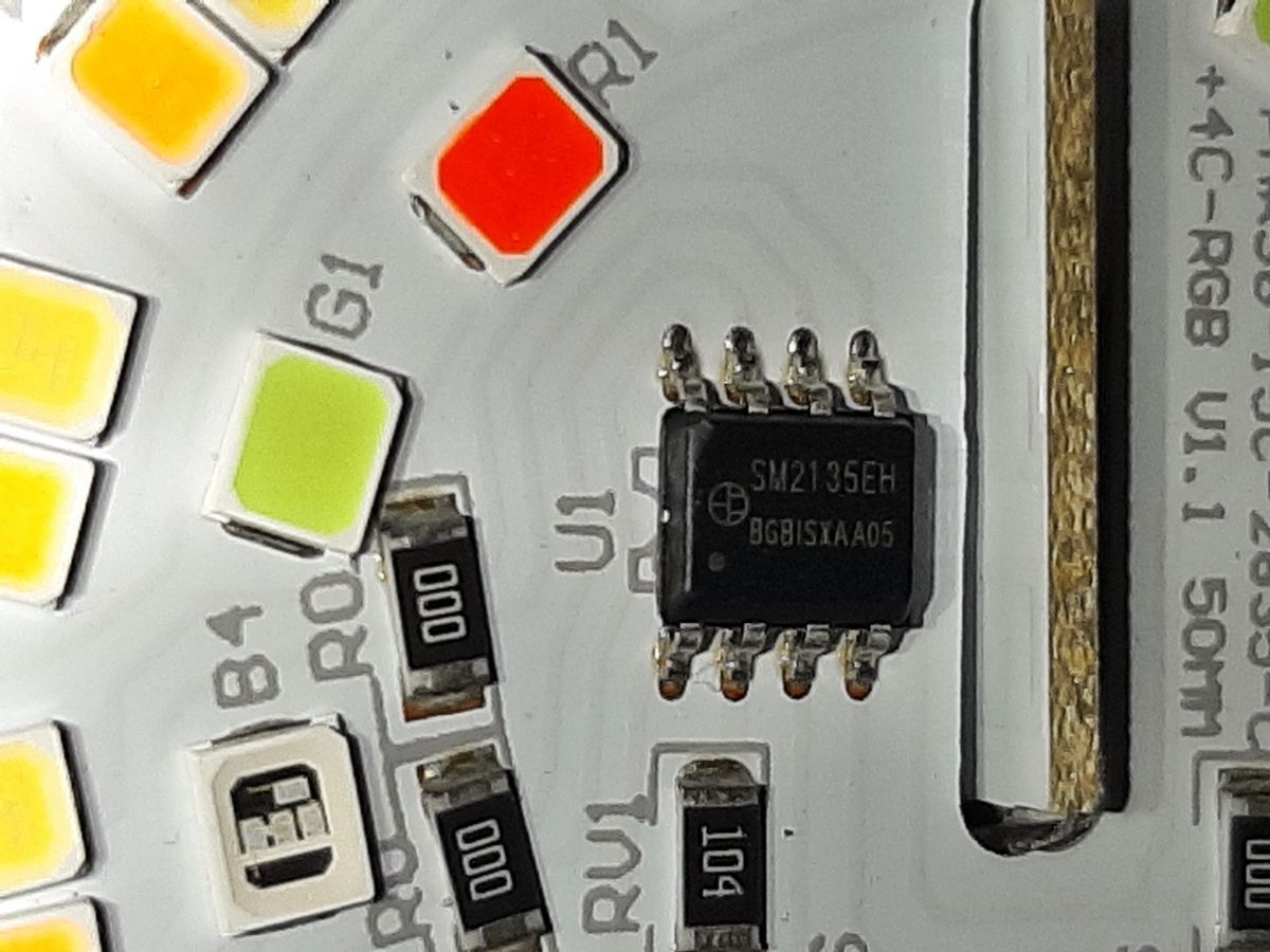

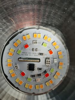

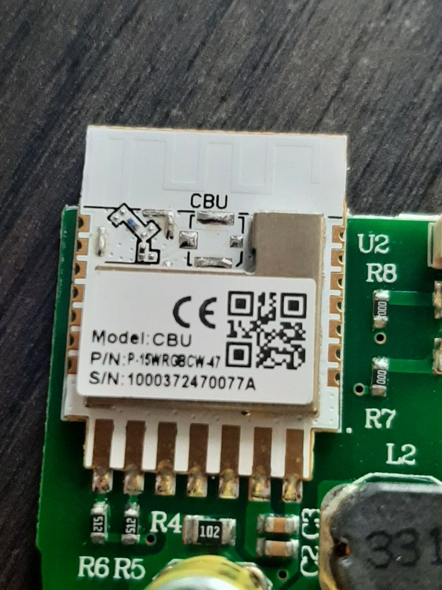

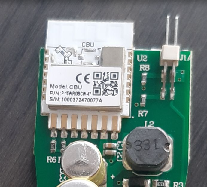

    Hello, what is the marking of U1 chip? It looks like modified I2C LED controller, with those SDA/SCL markings on the board...
    There is no sense in setting PWMs, as it can be clearly seen that the LED boards is getting 4 signals, one is power, one is ground, so it would leave space only for 2 PWMs and it's RGBCW, so it has just not enough pins.
    It must by SM2135 or similiar.
  • SM2135EH identified, pin mapping still unresolved

    I uploaded a picture of the U1. It's a SM2135EH - BGBISYAA05. Also looking at the LED's they appear to be SM2835's. Not sure if that makes any difference. I have tried setting the SM2135DAT and CLK to the pins 7 and 8 also pin 24 and 26 as they are the pins the other Mirabella devices have been using. No luck as of yet. I'm sure it's just a pin allocation issue as the other devices had a different firmware chip and it's a matter of just trying all combinations until I get it. I'll just keep trying until I find the magical pin combo for now unless you have a better idea.

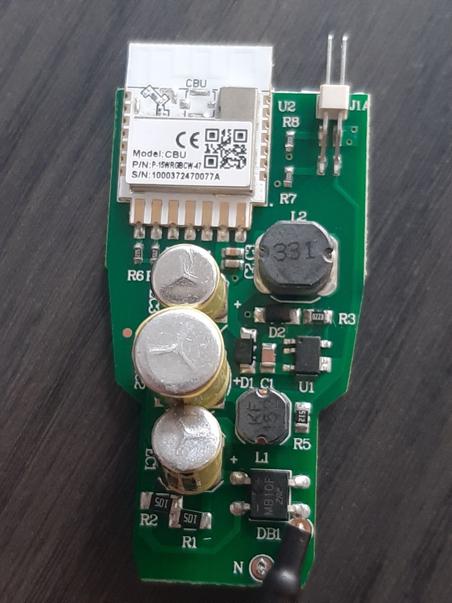

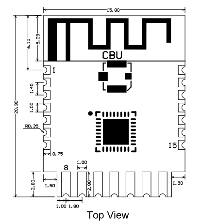

    Please do not try at random. When you look at this photo:
    Mirabella Genio Wi-Fi Dimmable 15W ES Par38 LED Bulb - Teardown
    you can easily see which pins to access and test with multimeter. Just use continuity test mode and check which CBU pins are used for I2C communication.
    Here is CBU pinout:

    but on the photo, I can see that only pins 8-14 are soldered, so those are the candidates:
    8P8I/OSupport hardware PWM (Correspond to Pin 24 of the IC)
    9P7I/OSupport hardware PWM (Correspond to Pin 23 of the IC)
    10P6I/OSupport hardware PWM (Correspond to Pin 22 of the IC)
    11P26I/OSupport hardware PWM (Correspond to Pin 15 of the IC)
    12P24I/OSupport hardware PWM (Correspond to Pin 16 of the IC)

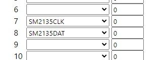

    Not really trying at random. Been sticking with these pins below as they are the only ones that I can see would be correct.
    I unfortunately do not own a multimeter so can't test it that way. Will have to go buy one and see what I can find. I'm kind of perplexed as there is another Mirabella device that uses pins 24 and 26 with the same SM2135 chip and it works fine. Maybe there has been some slight changes, but I would think it should still run on those pins regardless. Anyway, off to buy a multimeter and will report my findings.
    Finally worked it out. Has the CLK and DAT settings around the other way to the other Mirabella devices.
    Light working as expected. RGB colours at this stage are wrong.
