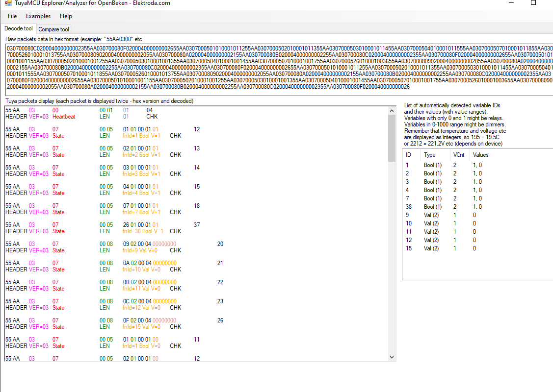

    i did some logging for tuyaanalyzer
    inkc switching from all-button, each single button, timers and countdowns. most switched from "Smart Life " app
    [CB2S/BK7231N] TuyaMCU AOFO Smart Power Strip C733: Configuring & Modifying with OpenBK7231N
    55AA0307000503010001001355AA030700080B020004000000002255AA0307000501010001001155AA0307000809020004000000002055AA0307000504010001001455AA030700080C020004000000002355AA0307000502010001001255AA030700080A020004000000002155AA0307000507010001001755AA030700080F020004000000002655AA0307000503010001011455AA030700080B020004000000002255AA0307000501010001011255AA0307000809020004000000002055AA0307000504010001011555AA030700080C020004000000002355AA0307000507010001011855AA030700080F020004000000002655AA0307000501010001001155AA0307000809020004000000002055AA0307000501010001011255AA0307000809020004000000002055AA03000001010455AA0307000502010001011355AA030700080A020004000000002155AA0307000503010001001355AA030700080B020004000000002255AA0307000503010001001355AA030700080B020004000000002255AA0307000504010001001455AA030700080C020004000000002355AA031C00001E55AA0307000507010001001755AA030700080F020004000000002655AA0307000507010001011855AA030700080F020004000000002655AA03000001010455AA03000001010455AA03000001010455AA030700080B0200040000012C4F55AA030700080B0200040000012B4E55AA030700080B0200040000012A4D55AA030700080B020004000001294C55AA030700080B020004000001284B55AA030700080B020004000001274A55AA030700080B020004000001264955AA030700080B020004000001254855AA03000001010455AA030700080B020004000001244755AA030700080B020004000001234655AA030700080B020004000001224555AA030700080B020004000001214455AA030700080B020004000001204355AA030700080B0200040000011F4255AA030700080B0200040000011E4155AA031C00001E55AA030700080B0200040000011E4155AA031C00001E55AA030700080B0200040000011D4055AA030700080B0200040000011C3F55AA030700080B0200040000011B3E55AA030700080B0200040000011A3D55AA030700080B020004000001193C55AA030700080B020004000001183B55AA0307000507010001001755AA030700080F020004000000002655AA030700080B020004000001173A55AA0307000507010001011855AA030700080F020004000000002655AA03000001010455AA030700080B020004000001163955AA0307000504010001011555AA030700080C020004000000002355AA030700080B020004000001153855AA0307000504010001001455AA030700080C020004000000002355AA030700080B020004000001143755AA0307000503010001011455AA030700080B020004000000002255AA0307000503010001001355AA030700080B020004000000002255AA0307000502010001001255AA030700080A020004000000002155AA0307000502010001011355AA030700080A020004000000002155AA0307000501010001001155AA0307000809020004000000002055AA0307000501010001011255AA0307000809020004000000002055AA0307000503010001001355AA030700080B020004000000002255AA0307000504010001001455AA030700080C020004000000002355AA0307000502010001001255AA030700080A020004000000002155AA0307000503010001001355AA030700080B020004000000002255AA0307000501010001001155AA0307000809020004000000002055AA0307000507010001001755AA030700080F020004000000002655AA0307000501010001011255AA0307000809020004000000002055AA0307000502010001011355AA030700080A020004000000002155AA0307000507010001011855AA030700080F020004000000002655AA03000001010455AA03000001010455AA03000001010455AA031C00001E55AA03000001010455AA03000001010455AA03000001010455AA03000001010455AA031C00001E55AA030700080A02000400000E103F55AA030700080A02000400000E0F3E55AA030700080A02000400000E0E3D55AA03000001010455AA030700080A02000400000E0D3C55AA030700080A02000400000E0C3B55AA030700080A02000400000E0B3A55AA030700080A02000400000E0A3955AA030700080A02000400000E093855AA030700080A02000400000E083755AA030700080A02000400000E073655AA030700080A02000400000E063555AA030700080A02000400000E053455AA030700080A02000400000E043355AA030700080A02000400000E033255AA030700080A02000400000E023155AA030700080A02000400000E013055AA030700080A02000400000E002F55AA030700080A02000400000DFF2D55AA03000001010455AA030700080A02000400000DFE2C55AA030700080A02000400000DFD2B55AA030700080A02000400000DFC2A55AA030700080A02000400000DFB2955AA030700080A02000400000DFA2855AA030700080A02000400000DF92755AA030700080A02000400000DF82655AA030700080A02000400000DF72555AA030700080A02000400000DF62455AA030700080A02000400000DF52355AA030700080A02000400000DF42255AA030700080A02000400000DF32155AA030700080A02000400000DF22055AA030700080A02000400000DF11F55AA030700080A02000400000DF01E55AA03000001010455AA030700080A02000400000DEF1D55AA030700080A02000400000DEE1C55AA030700080A02000400000DED1B55AA030700080A02000400000DEC1A55AA030700080A02000400000DEB1955AA030700080A02000400000DEA1855AA030700080A02000400000DE91755AA030700080A02000400000DE81655AA030700080A02000400000DE71555AA030700080A02000400000DE61455AA030700080A02000400000DE51355AA030700080A02000400000DE41255AA030700080A02000400000DE31155AA030700080A02000400000DE21055AA030700080A02000400000DE10F55AA030700080A02000400000DE00E55AA03000001010455AA030700080A02000400000DDF0D55AA030700080A02000400000DDE0C55AA030700080A02000400000DDD0B55AA030700080A02000400000DDC0A55AA030700080A02000400000DDB0955AA030700080A02000400000DDA0855AA031C00001E55AA030700080A02000400000DD90755AA030700080A02000400000DD80655AA030700080A02000400000DD70555AA030700080A02000400000DD60455AA030700080A02000400000DD50355AA030700080A02000400000DD30155AA030700080A02000400000DD20055AA03000001010455AA030700080A02000400000DD1FF55AA030700080A02000400000DD0FE55AA030700080A02000400000DCFFD55AA030700080A02000400000DCEFC55AA030700080A02000400000DCDFB55AA030700080A02000400000DCCFA55AA030700080A02000400000DCBF955AA030700080A02000400000DCAF855AA030700080A02000400000DC9F755AA030700080A02000400000DC8F655AA030700080A02000400000DC7F555AA030700080A02000400000DC6F455AA030700080A02000400000DC5F355AA030700080A02000400000DC4F255AA030700080A02000400000DC3F155AA03000001010455AA030700080A02000400000DC2F055AA030700080A02000400000DC1EF55AA030700080A02000400000DC0EE55AA030700080A02000400000DBFED55AA030700080A02000400000DBEEC55AA030700080A02000400000DBDEB55AA030700080A02000400000DBCEA55AA030700080A02000400000DBBE955AA030700080A02000400000DBAE855AA030700080A02000400000DB9E755AA030700080A02000400000DB8E655AA030700080A02000400000DB7E555AA030700080A02000400000DB6E455AA030700080A02000400000DB5E355AA030700080A02000400000DB4E255AA03000001010455AA030700080A02000400000DB3E155AA030700080A02000400000DB2E055AA030700080A02000400000DB1DF55AA030700080A02000400000DB0DE55AA030700080A02000400000DAFDD55AA030700080A02000400000DAEDC55AA030700080A02000400000DADDB55AA030700080A02000400000DACDA55AA030700080A02000400000DABD955AA030700080A02000400000DAAD855AA031C00001E55AA0307000503010001001355AA030700080B020004000000002255AA0307000501010001001155AA0307000809020004000000002055AA0307000504010001001455AA030700080C020004000000002355AA0307000502010001001255AA030700080A020004000000002155AA0307000507010001001755AA030700080F020004000000002655AA0307000503010001011455AA030700080B020004000000002255AA0307000504010001011555AA030700080C020004000000002355AA0307000507010001011855AA030700080F020004000000002655AA0307000503010001001355AA030700080B020004000000002255AA0307000501010001001155AA0307000809020004000000002055AA0307000504010001001455AA030700080C020004000000002355AA0307000502010001001255AA030700080A020004000000002155AA0307000507010001001755AA030700080F020004000000002655AA03000001010455AA03000001010455AA0307000503010001001355AA030700080B020004000000002255AA0307000501010001011255AA0307000809020004000000002055AA03000001010455AA0307000501010001001155AA0307000809020004000000002055AA031C00001E55AA03000001010455AA03000001010455AA03000001010455AA03000001010455AA031C00001E55AA03000001010455AA03000001010455AA030700080A02000400000C416E55AA030700080A02000400000C406D55AA030700080A02000400000C3F6C55AA030700080A02000400000C3E6B55AA030700080A02000400000C3D6A55AA03000001010455AA030700080A02000400000C3C6955AA030700080A02000400000C3B6855AA030700080A02000400000C3A6755AA030700080A02000400000C396655AA030700080A02000400000C386555AA030700080A02000400000C376455AA0307000501010001001155AA0307000809020004000000002055AA0307000504010001001455AA030700080C020004000000002355AA0307000502010001001255AA030700080A020004000000002155AA031C00001E55AA0307000503010001001355AA030700080B020004000000002255AA0307000502010001001255AA030700080A020004000000002155AA0307000507010001001755AA030700080F020004000000002655AA0307000503010001011455AA030700080B020004000000002255AA0307000501010001011255AA0307000809020004000000002055AA0307000502010001011355AA030700080A020004000000002155AA0307000504010001011555AA030700080C020004000000002355AA0307000507010001011855AA030700080F020004000000002655AA03000001010455AA0307000503010001001355AA030700080B020004000000002255AA0307000502010001001255AA030700080A020004000000002155AA0307000507010001001755AA030700080F020004000000002655AA0307000504010001001455AA030700080C020004000000002355AA0307000501010001001155AA0307000809020004000000002055AA0307000503010001011455AA030700080B020004000000002255AA0307000501010001011255AA0307000809020004000000002055AA0307000504010001011555AA030700080C020004000000002355AA0307000507010001011855AA030700080F020004000000002655AA0307000503010001001355AA030700080B020004000000002255AA0307000504010001001455AA030700080C020004000000002355AA0307000507010001001755AA030700080F020004000000002655AA0307000502010001011355AA030700080A020004000000002155AA0307000503010001011455AA030700080B020004000000002255AA0307000504010001011555AA030700080C020004000000002355AA03000001010455AA0307000507010001011855AA030700080F020004000000002655AA0307000507010001001755AA030700080F020004000000002655AA0307000507010001011855AA030700080F020004000000002655AA03000001010455AA03000001010455AA031C00001E55AA0307000501010001001155AA0307000809020004000000002055AA0307000501010001011255AA0307000809020004000000002055AA03000001010455AA0307000501010001001155AA0307000809020004000000002055AA0307000501010001011255AA0307000809020004000000002055AA0307000503010001001355AA030700080B020004000000002255AA0307000504010001001455AA030700080C020004000000002355AA0307000502010001001255AA030700080A020004000000002155AA0307000503010001001355AA030700080B020004000000002255AA0307000501010001001155AA0307000809020004000000002055AA0307000504010001001455AA030700080C020004000000002355AA0307000502010001001255AA030700080A020004000000002155AA0307000507010001001755AA030700080F020004000000002655AA0307000503010001011455AA030700080B020004000000002255AA0307000504010001011555AA030700080C020004000000002355AA0307000507010001011855AA030700080F020004000000002655AA0307000502010001011355AA030700080A020004000000002155AA0307000501010001011255AA0307000809020004000000002055AA03000001010455AA03000001010455AA03000001010455AA031C00001E55AA031C00001E55AA0307000501010001001155AA0307000809020004000000002055AA03000001010455AA03000001010455AA03000001010455AA03000001010455AA031C00001E55AA03000001010455AA03000001010455AA03000001010455AA03000001010455AA031C00001E55AA03000001010455AA03000001010455AA03000001010455AA03000001010455AA031C00001E
    and this is only switching from hardware buttos
    55AA0307000501010001011255AA0307000502010001011355AA0307000503010001011455AA0307000504010001011555AA0307000507010001011855AA0307000526010001013755AA0307000809020004000000002055AA030700080A020004000000002155AA030700080B020004000000002255AA030700080C020004000000002355AA030700080F020004000000002655AA0307000501010001001155AA0307000502010001001255AA0307000503010001001355AA0307000504010001001455AA0307000507010001001755AA0307000526010001003655AA0307000809020004000000002055AA030700080A020004000000002155AA030700080B020004000000002255AA030700080C020004000000002355AA030700080F020004000000002655AA0307000501010001011255AA0307000809020004000000002055AA0307000501010001001155AA0307000809020004000000002055AA0307000501010001011255AA0307000809020004000000002055AA0307000501010001001155AA0307000809020004000000002055AA0307000502010001011355AA030700080A020004000000002155AA0307000502010001001255AA030700080A020004000000002155AA0307000502010001011355AA030700080A020004000000002155AA03000001010455AA0307000502010001001255AA030700080A020004000000002155AA0307000503010001011455AA030700080B020004000000002255AA0307000503010001001355AA030700080B020004000000002255AA0307000503010001011455AA030700080B020004000000002255AA0307000503010001001355AA030700080B020004000000002255AA0307000503010001011455AA030700080B020004000000002255AA0307000503010001001355AA030700080B020004000000002255AA0307000504010001011555AA030700080C020004000000002355AA0307000504010001001455AA030700080C020004000000002355AA0307000504010001011555AA030700080C020004000000002355AA0307000504010001001455AA030700080C0200040000000023
    and reboot two times
    55AA0300000101040000000000000000000000000000000000000000000000000000000000000000000000000000000055AA031C00001E55AA03000001000355AA0301002A7B2270223A226A66627165746B727339673161377469222C2276223A22312E302E30222C226D223A307D0155AA030200000455AA030300000555AA03000001010455AA0307000501010001001155AA0307000502010001001255AA0307000503010001001355AA0307000504010001001455AA0307000507010001001755AA0307000526010001003655AA0307000809020004000000002055AA030700080A020004000000002155AA030700080B020004000000002255AA030700080C020004000000002355AA030700080F020004000000002655AA03030000050000000000000000000000000000000000000000000000000000000000000000000000000055AA031C00001E55AA03000001000355AA0301002A7B2270223A226A66627165746B727339673161377469222C2276223A22312E302E30222C226D223A307D0155AA030200000455AA030300000555AA03000001010455AA0307000501010001011255AA0307000502010001011355AA0307000503010001011455AA0307000504010001011555AA0307000507010001011855AA0307000526010001013755AA0307000809020004000000002055AA030700080A020004000000002155AA030700080B020004000000002255AA030700080C020004000000002355AA030700080F020004000000002655AA0307000501010001011255AA0307000502010001011355AA0307000503010001011455AA0307000504010001011555AA0307000507010001011855AA0307000526010001013755AA0307000809020004000000002055AA030700080A020004000000002155AA030700080B020004000000002255AA030700080C020004000000002355AA030700080F020004000000002655AA030300000555AA030000010104
    logs zipped and original firmware

    Hello, would you be able to do log of just toggle all operation?
    I am curious if Smart Life does it by sending separate sets for each relay, or by sending a single dpID.
    I remember we've spoken before that this "single dpID toggle all" is just for display so I am curious how Smart Life does it.

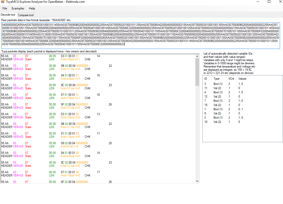

    Both of the files are captured on RX of WiFi module, so that's what WiFi module receives from MCU?
    If yes, can you show what WiFi module sends to MCU on toggle from app?
    I have checked this file: aofo_c733_switching_albutton_from_app.txt
    And this file:
    aofo_c733_switching_albutton_hardware.txt
    I must admit there are many, many dpIDs. This must be a very complicated device.

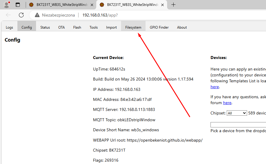

    I have no "LittleFS" tab in the web application, so instead I went to configuration and wrote the script of the second post in a tab that allows me to write script executed at startup, but it didn't work.
