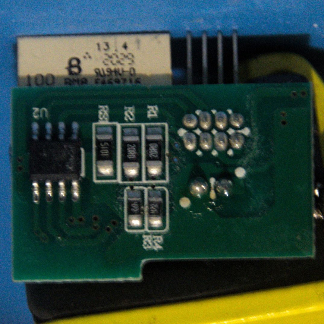

    Teardown
    [BK7231T] Connect 10W Smart RGB Bulb
    The bulb has two product IDs: LSH-B22RGB10W and CSH-B22RGB10W. Laser Co seems to sell this bulb under its own brand and the Connect SmartHome brand it owns.
    Multiple revisions of this bulb exist (ESP8266 chip, WB2L chip) but the manufacturer doesn't change the product ID. This means you need to open your bulb to find out what's actually inside. Because of this I don't recommend buying this bulb.
    [BK7231T] Connect 10W Smart RGB Bulb [BK7231T] Connect 10W Smart RGB Bulb [BK7231T] Connect 10W Smart RGB Bulb [BK7231T] Connect 10W Smart RGB Bulb [BK7231T] Connect 10W Smart RGB Bulb
    I didn't photograph the power circuit as it's just a 220v capacitive drop circuit that outputs 12v and passes through 220v to VIN.

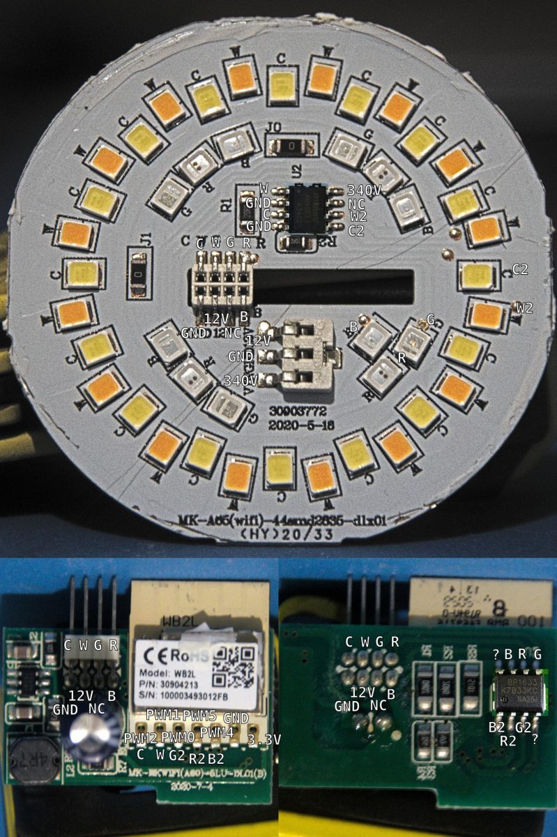

    Here's a labelled collage of all the pins (click to zoom!):

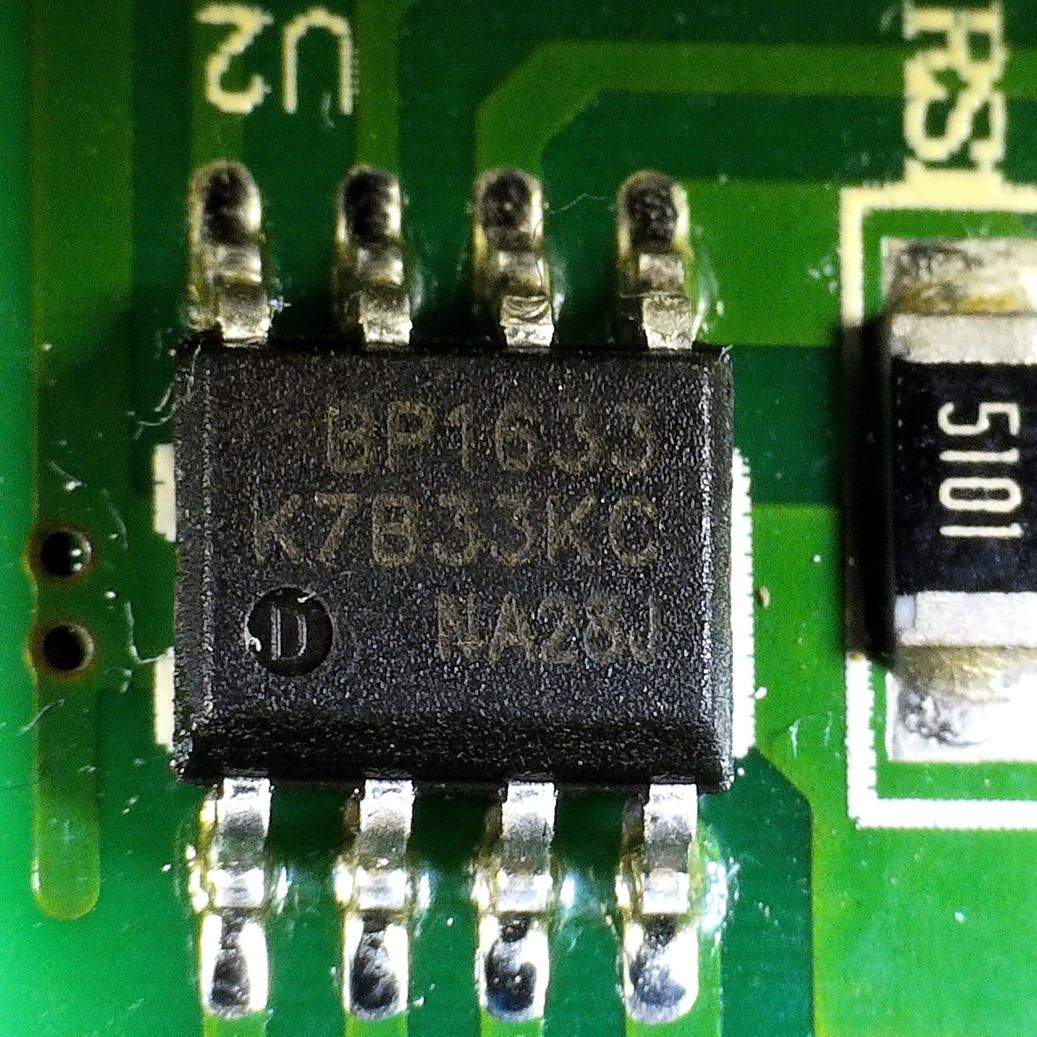

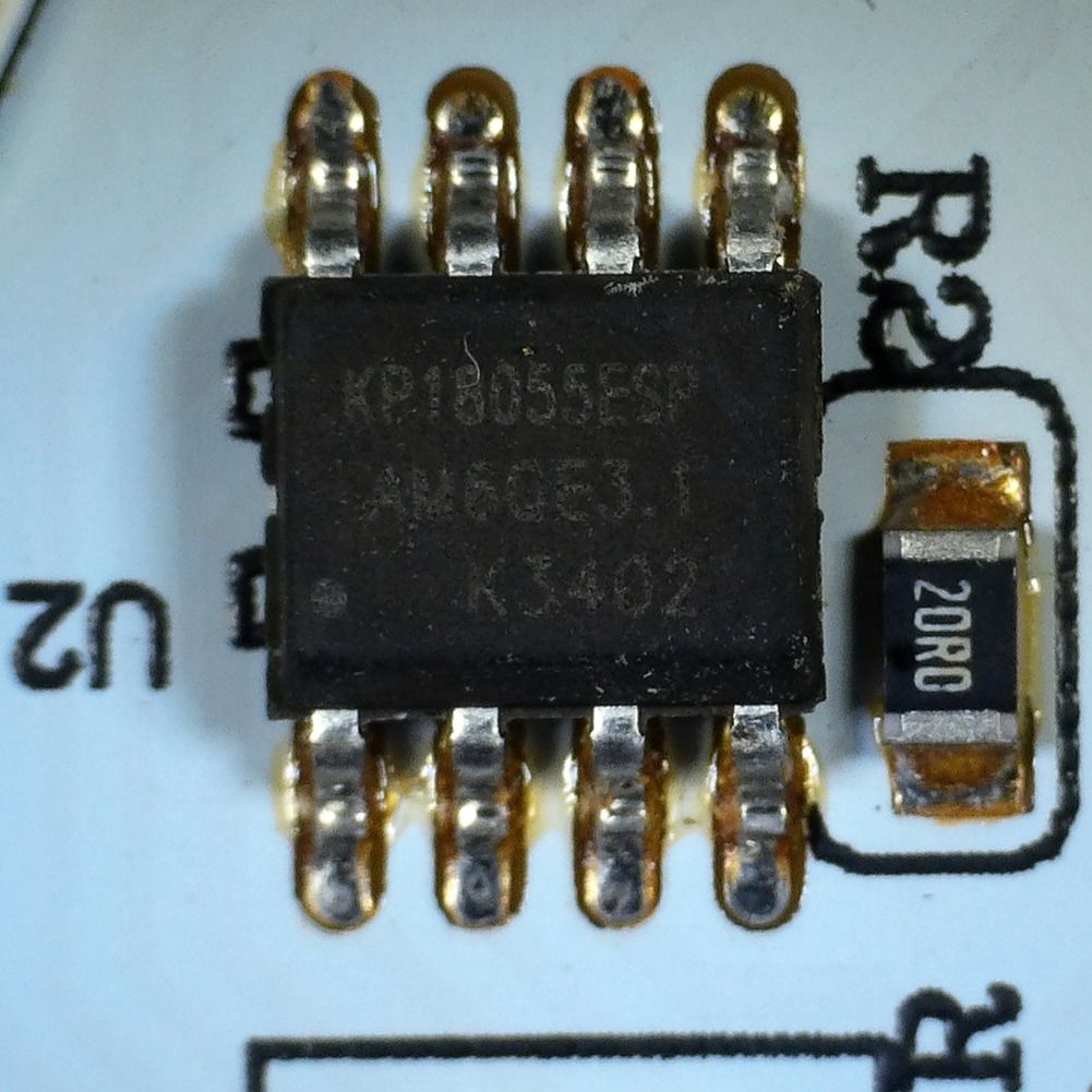

    The operation is fairly simple: The WB2L sends PWM signals to two LED drivers. One is a KP18055ESP and the other is a BP1633. The mapping goes like this:
    PinLED
    PWM4Blue
    PWM5Green
    PWM0Red
    PWM1Warm white
    PWM2Cold white
