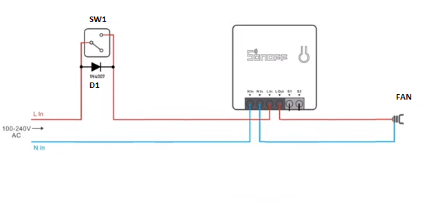

    @spin55 what's your opinion on using this hack with ceiling fan? could it be used?
    I think the channel mention that it depends on the fan itself if it can be powered by half wave dc.
    I have these ones at home, one with a knob speed controller and another using remote

    All the assembly would be valid, except that it would be necessary to "play" with these three components. How many watts does it consume?

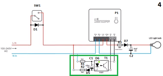

    According to the specs sheet, these are the estimates
    Motor W : Low 14.1 – 19.9
    High 67.5 – 82.5
  • #35 20536220

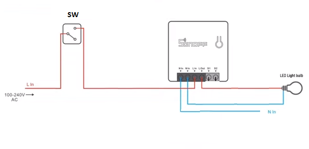

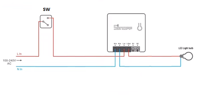

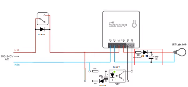

    Do you know that you can control it remotely with SW Closed and this configuration?:
    Modifying Tuya Mini for No-Neutral Installation: Experiences with Diode Polarity Reversal? Modifying Tuya Mini for No-Neutral Installation: Experiences with Diode Polarity Reversal?
  • #36 20536279
    ferbulous
    Posts: 419
    Help: 8
    Rate: 56
    This would require neutral behind the switch, correct? And you'd need to lock the switch in always on position
    #37 20536339
    spin55
    Posts: 209
    Help: 17
    Rate: 42
    This is correct, but the neutral wire is already in the ceiling.
    This is how I have ceiling lights in my house.
  • Neutral already present in ceiling wiring

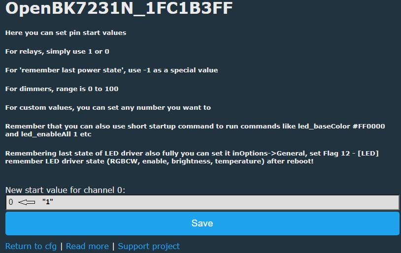

    I see, so this is another alternative just that it turns off openbk if the switch is toggled off.
    And that startup command turns on the relay once it boots up, and remote control is back.

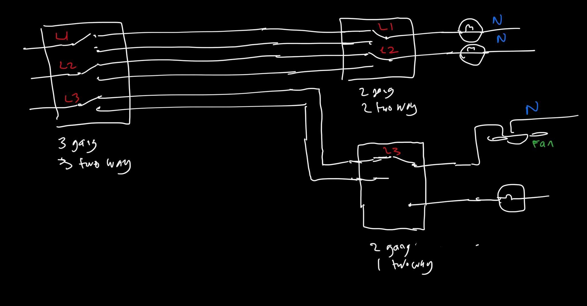

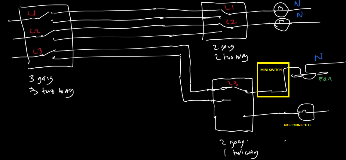

    I have a 2 way switch that controls a ceiling fan which I'm still figuring out if it's safe to use the hack
  • Clarifying two-way switch use for fan control
    Two ways for what? One for light and one for fan?. Doesn't control light and fan with remote control? If so, you only need one way.
    Regards
  • #40 20536534
    ferbulous
    Posts: 419
    Help: 8
    Rate: 56
    Separate lights and fan, just that each have 2 way wiring

  • #42 20536689
    ferbulous
    Posts: 419
    Help: 8
    Rate: 56
    spin55 wrote:
    Same assembly as before but you would need a mini switch for each line.
    yes, that's what I plan to do with all the lights

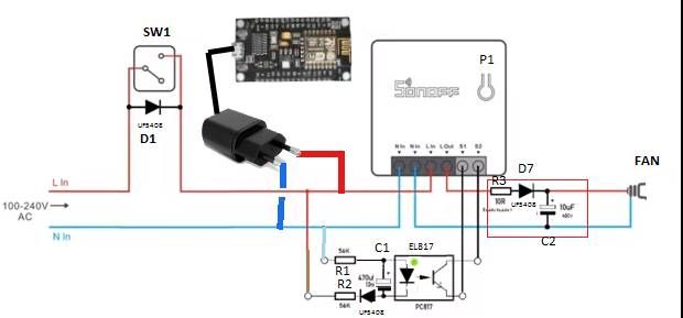

    I'm just not sure if it's safe to use the hack for the ceiling fan, I mean would it affect the fan motor or something since it's using half wave dc
  • Proposed fan-safe rectifier assembly for the hack
    #43 20536819
    spin55
    Posts: 209
    Help: 17
    Rate: 42

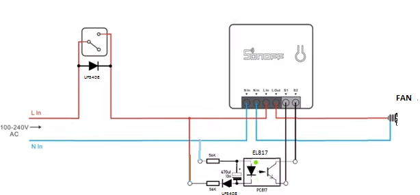

    With this assembly you should not have a problem with the fan:
    Forget about this assembly, because as you say, it works with pulsating direct current and needs alternating current to work. And you can't suppress the diode because it would blow up the electrolytic capacitor. Thanks for making me see. what a mistake.
    Don't even try it because the impedance of the motor winding is too small in DC, it may damage the fan!!!
    Added after 2 [hours] 36 [minutes]:
    I think this assembly might work with the fan:
  • #44 20537878
    spin55
    Posts: 209
    Help: 17
    Rate: 42
    I did tests with a hand dryer because I don't have a fan and I can confirm that this setup only works when the wall switch is closed. AC devices do not work with a single half cycle.
    https://www.elektroda.com/rtvforum/topic3971605.html#20537876
    Regards
  • Half-wave DC only works with DC loads

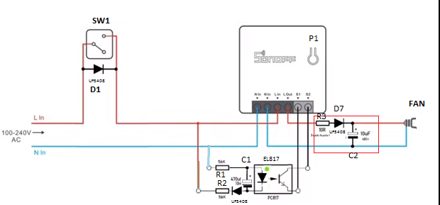

    Thanks for the detailed explanation on how it works with dc or ac
    From your test, the hand dryer (ac) didn’t turn on when the relay is toggled on with half wave dc (switch in open position).
    So if my fan is using dc motor, then technically half wave dc could still power the motor as normal with no issues?
    Also, since you’ve excluded the fusible resistor in the diagram with fan, is it advisable to do that since the youtube channel did mention fusible resisor is needed for safety reason
  • Half-wave DC fan supply with diode and capacitor sizing

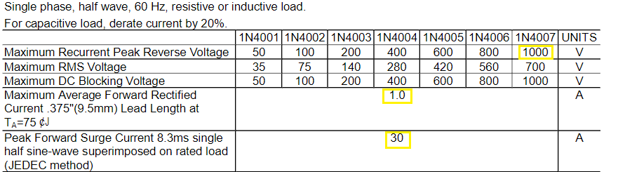

    In my opinion, I would only have to choose the diodes D1 and D7 based on the consumption in amps of the load.
    The rest would be the same as the devices that have power supplies that are connected to AC but internally work with DC. That's why I think that the DC fan could work by "playing" with the diodes and the value of C2, increasing it if the ripple is excessive.
    These are the characteristics that you have to pay attention to when choosing the diodes:
    It's right, all assemblies should have a protection fuse for safety reason!!.
    Resistor R3 is there to protect D7 when you plug the entire assembly into the mains AC for the first time. At that instant the capacitor is discharged and there is a significant current peak that must not exceed the maximum supported by D7. It also protects if there is an excessive consumption of C2 or fan due to failure. During the negative half-wave, D7 acts as a switch and prevents C2 from being destroyed which begins to discharge through the fan by supplying it with the current it needs. This is repeated every 10 milliseconds (for a mains frequency of 50Hz) and the set of C2 and fan impedance have to make C2 hold as much charge as possible.
    NOTE: Before trying the assembly 4 with DC fan I would make sure what type of internal power supply it has.
    NOTE2: Please, if someone is not sure what it does, don't try it. This can be dangerous for people if they don't understand what they are doing and why.
    Regards
    Hi, how do I check for the internal power supply? Any specific ones I need to look out for
    Since i'm already using IN4007 diodes, would that be sufficient?

    spin55
    Posts: 209
    Help: 17
    Rate: 42
    Yes, to check how many watts you can handle with that value of C2 with the test of accumulating light bulbs.

    With this assembly:
    1.- SW1 Closed. Relay On via web. It should work.
    2.- SW1 Opened. Relay On via web. If there is movement it is Fan DC.
    Do the same for the other fan if you want to compare.
  • Suggested test setup for comparing fan movement detection
    #51 20543240
    ferbulous
    Posts: 419
    Help: 8
    Rate: 56
    spin55 wrote:
    Yes
    Awesome, I have some diy mmwave sensors that could really benefit from this, just have it hidden away in the ceiling under the light fixtures
    spin55 wrote:
    With this assembly:
    Thanks for the instructions, i'm gonna start small with the stand fan first
    Wouldn't want the wife to get angry if the ceiling fan stops working
  • Diode polarity test for Aubess mini switches
    #52 20745181
    franfj
    Posts: 7
    This is a great idea. I've successfully used it on Aubess mini switches.
    The easy way to start is with just a diode in series in the Line In, noting the polarity which powers on the mini-switch, and build the rest of the circuit according to that polarity.
    I wonder if it's better to always put the 400V capacitor near the bulb, or avoid it if the light does not blink? Not having the capacitor allows to put it in small spaces.
  • Capacitor only needed to prevent half-cycle flicker
    Logically, if the bulb does not blink without a capacitor, you don't need to put it in.
    The reason for putting the capacitor is so that the bulb does not flicker during the negative half cycle of the mains wave. The diode acts as a switch that only conducts during the positive half cycles and recharges the capacitor. During the negative half cycle, the diode does not conduct and the capacitor keeps the light bulb on during the 10 milliseconds that the wave lasts (for a 50Hz network).
    It could remove the capacitor if the mains frequency increases. In this case, you could also remove the diode and the protection resistor. The light bulb would turn off during the negative half cycle, but we would not perceive it due to the persistence of images on the retina.
    Circuit diagram with LED bulb and capacitor connections.
    Greetings
  • 10R fusible resistor sizing for lamp load
    #54 20772394
    franfj
    Posts: 7
    Sounds logical.
    Any recommendations for the 10R fusible resistor? I tried with one of 1/2W and worked for about a month, but it got fused. Maybe it was a bad quality resistor, or maybe it was not well calculated.
    The theory is that this resistor gets a lot of power for a short time during the power on because of charging the capacitor, but since all the power for the LED lamp passes through it, it must also be able to dissipate the corresponding current.
    In my calculations, 1/4W for 10R should be enough for up to 30W lamp, 1/2W for up to 50W lamp, am I right?
  • Resistor power calculation for no-neutral LED load
    #55 20772829
    spin55
    Posts: 209
    Help: 17
    Rate: 42
    The 50W of the LED lamp refers to a given alternating current supply and a cosine of phi, so P=V.I.cos phi.
    There you could calculate the effective current intensity consumed by the lamp, which would be I=P/(V.cos phi). For a mains voltage of 230V/50Hz and a cosine of phi=1, the current would be 0.227A.
    Therefore, the power dissipated in the resistor would be P=I(squared).R, which would result in 0.515W. But the electrical voltage allows a variation margin of +-10%, therefore you must always allow for excess. In this theoretical case I would try a resistor of 1W or the nearest standard value.
    But you will see in the videos that here we are not applying an alternating current and therefore the voltage and current calculations differ.
    https://www.youtube.com/watch?v=sekdEc5wU6k
    https://www.youtube.com/watch?v=J8lNkVzukSM
    Greetings
