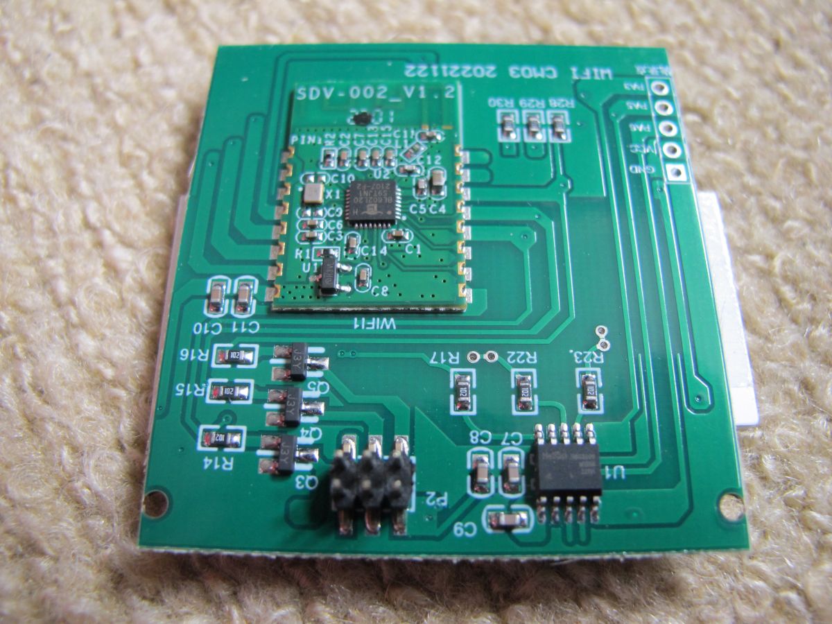

    Yes, I edited my previous message and added a photo of the packaging. Devices are simply called "wall switch" and have SKUs 696124744016 and 696439453921. Unfortunately, now I’m not sure which SKU is from which version. Also, I was hoping to use the templates suggested by @gyenchev in this post: https://www.elektroda.com/rtvforum/topic3970659.html#20535955. I'll try to check them out soon and report back.
    @p.kaczmarek2 , so i have tested the @gyenchev configurations on my devices and they work. I prepared code for my devices, but in essence they are similar. Anyway i'm attaching codes for 2-gang and 3-gang wall switches.

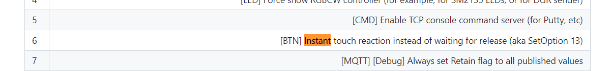

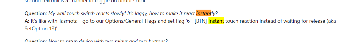

  • Questioning whether the 1.5 s relay delay is software-related
    #34 20888344
    SuperXL
    Hi everyone!
    I also became the proud owner of these switches.
    I would like to express my deep gratitude to the people who, with their posts above, helped me reflash these switches and wean them off the external cloud.
    I replaced all the switches in my apartment.
    One thing I didn't like about these switches is the long response time when pressing the sensor, it takes about 1...1.5 seconds to turn the light on or off. This happens on all my switches.
    As I understand from the circuit diagram (compiled from the images above), the sensor (chip) gives a command to the Wi-Fi module, and the module controls the transistors that are connected to the relay on the main board.
    Please tell me, does this happen to all owners (long response time)?
    I'm guessing it's a software delay.
    I wonder if it is possible to reduce this delay?
  • #35 20888403
    Posts: 14767
    Rate: 12906
  • #36 20888453
    SuperXL
    Great!
    This helped me. I set the flag number 6 and the sensor became instant!
    Thank you for your help!

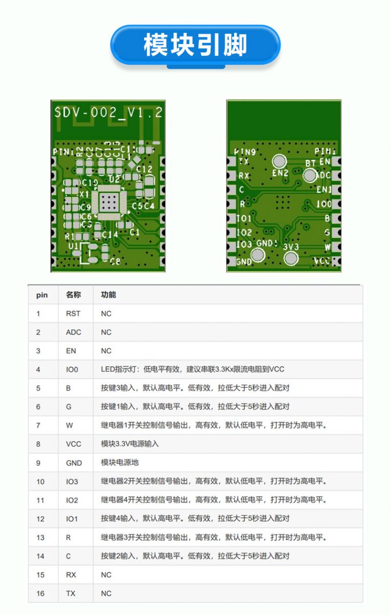

    #37 21125557
    Posts: 5216
    Help: 448
    Rate: 917

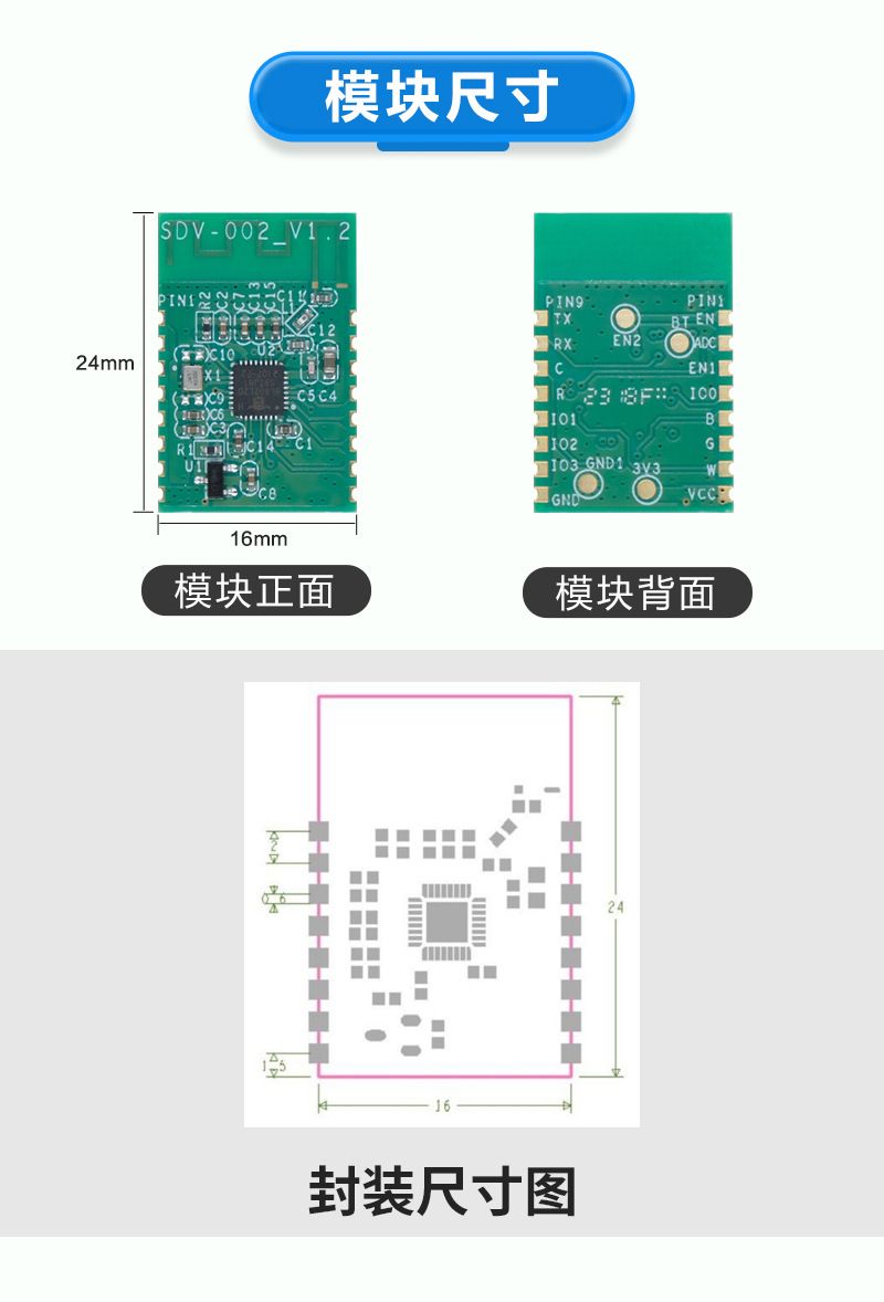

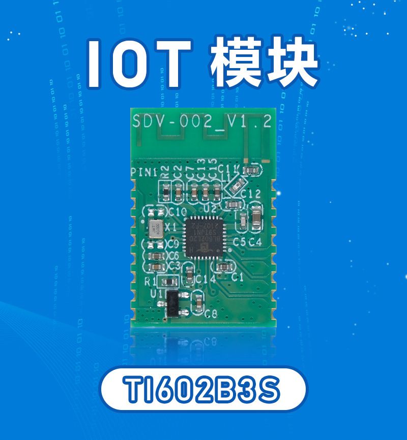

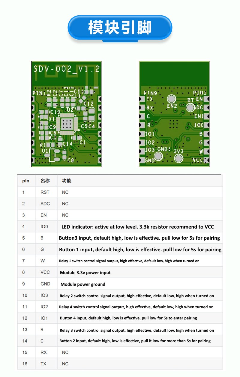

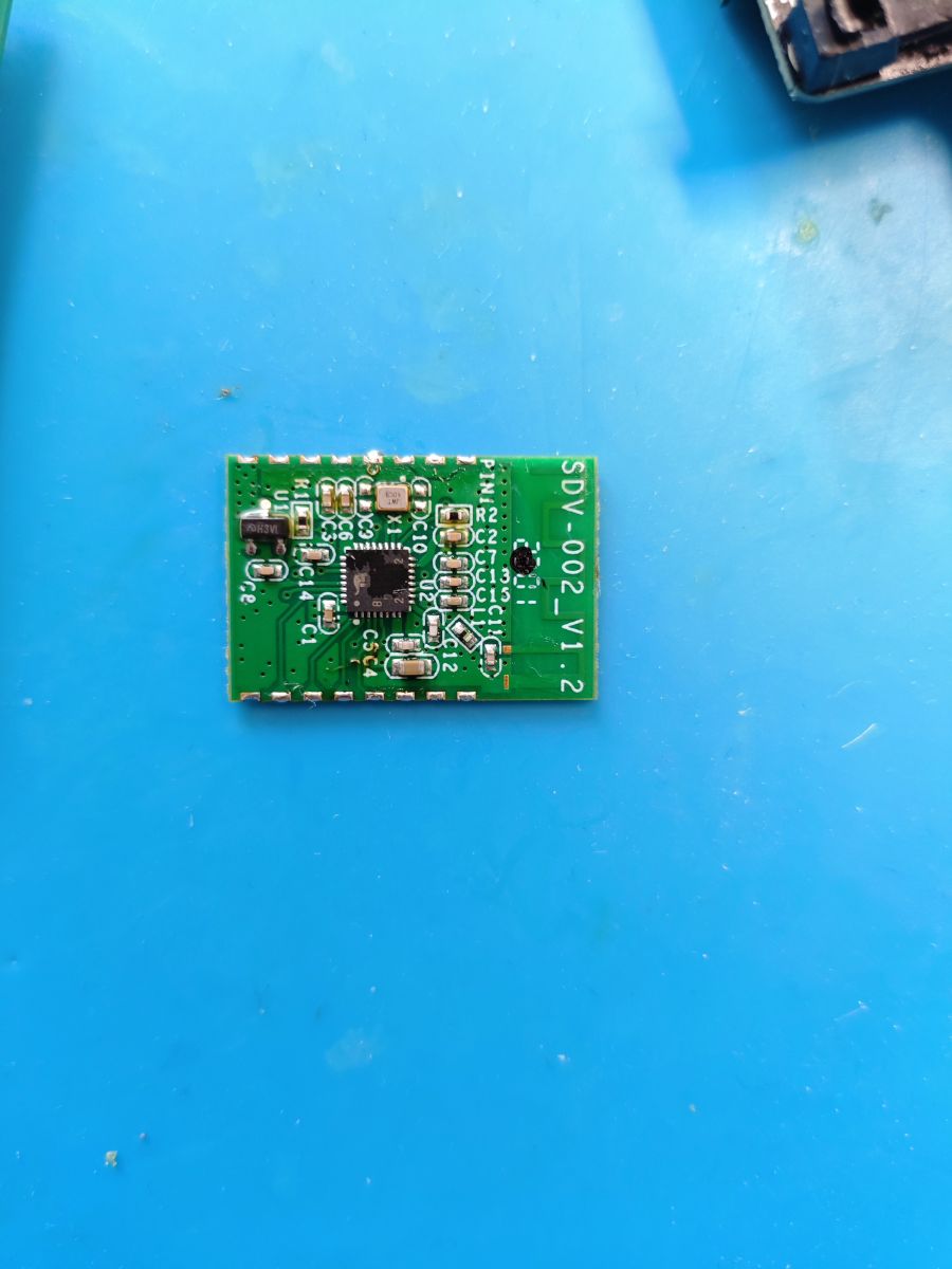

    The SDV-002_V1.2 (TI602B3S) module is made by Trolink. Datasheet attached.
    Table showing pin assignments and functions for the SDV-002_V1.2 module produced by Trolink. The image shows the SDV-002_V1.2 module from Trolink, along with a table explaining the functions of its pins. SDV-002_V1.2 module with pin diagram and pinout table. SDV-002_V1.2 module on a blue background labeled TI602B3S. Image of the SDV-002_V1.2 (TI602B3S) module by Trolink, front and back views, with a component layout diagram.
    • TI602B3S Datasheet.pdf (964.12 KB) You must be logged in to download this attachment.

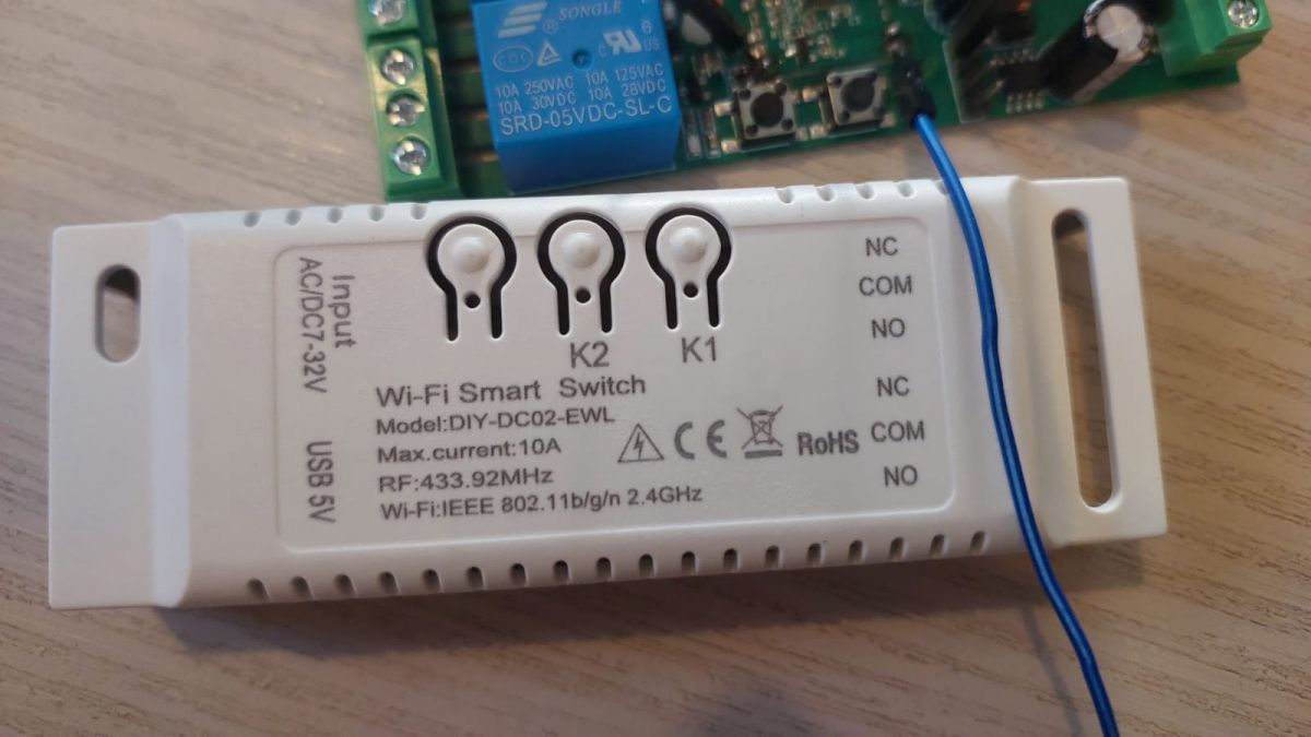

    I recently bought the ST-DC2 which is a 2 channel relay switch but this one came with the BL602 chip. I now see how I can flash this device thanks to this post.
    I would like to put ESPHome on it and link it to my Home Assistant. Has anyone tried this and is it possible?
    Thanks again

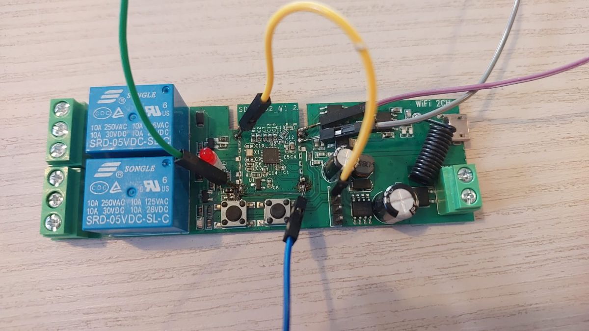

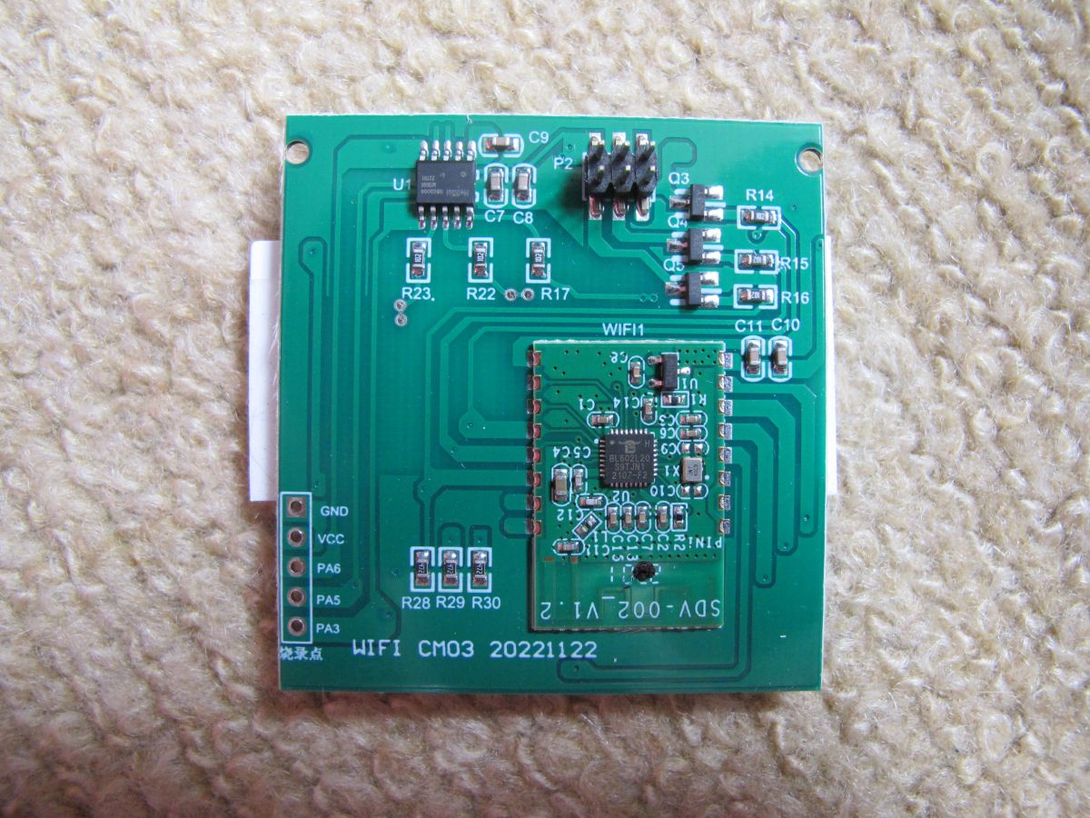

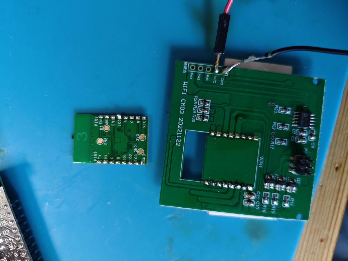

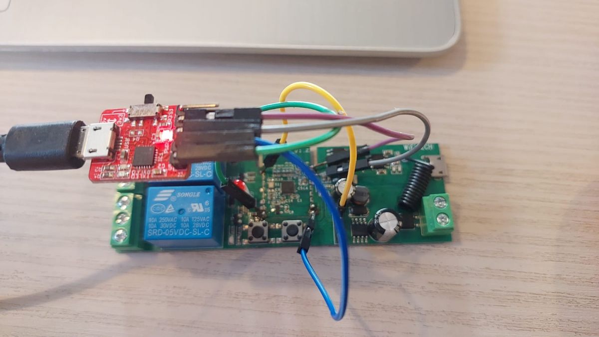

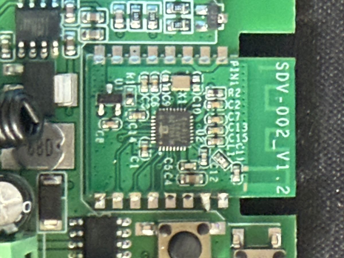

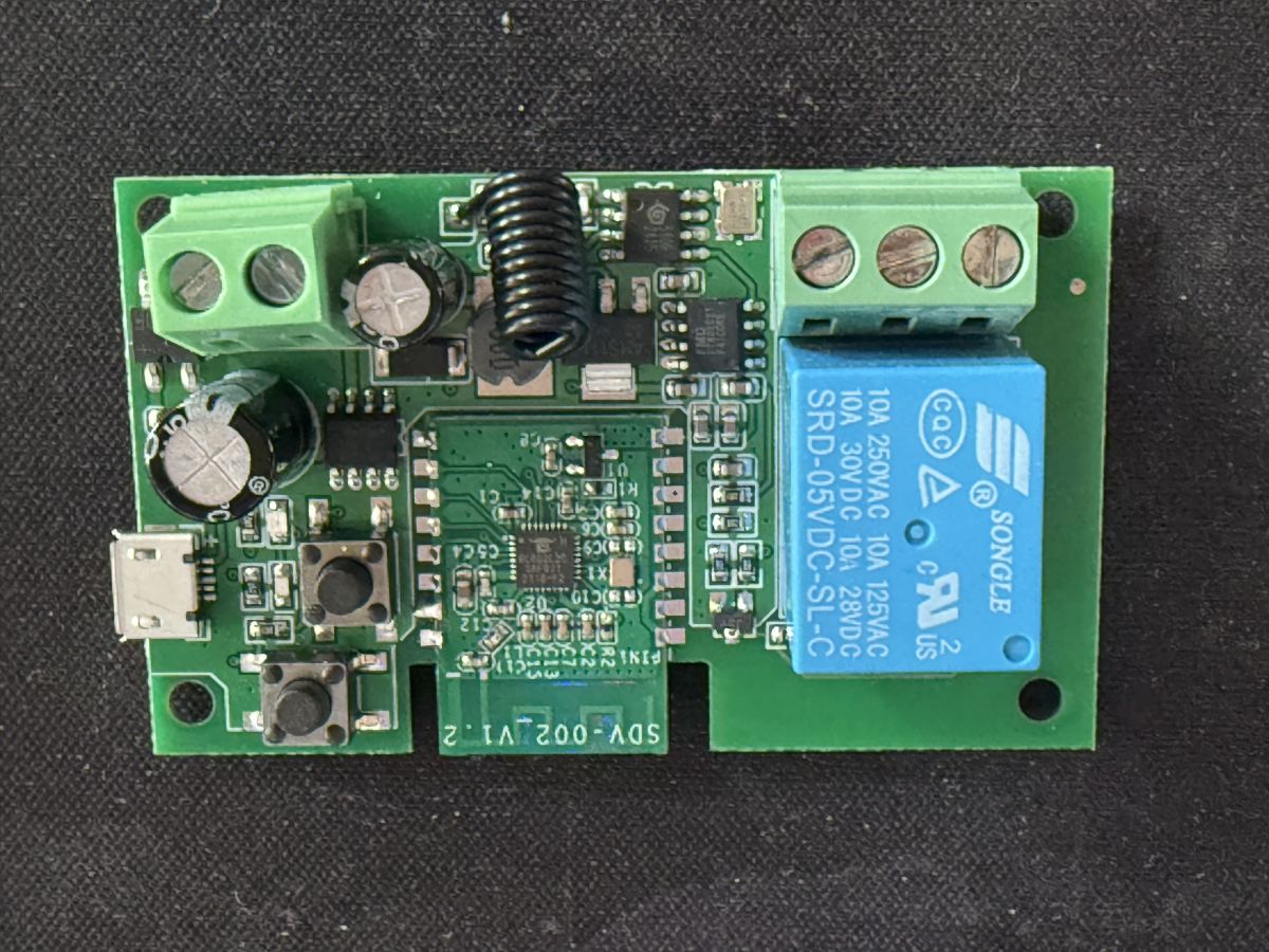

    #41 21202155
    muzzthegreat

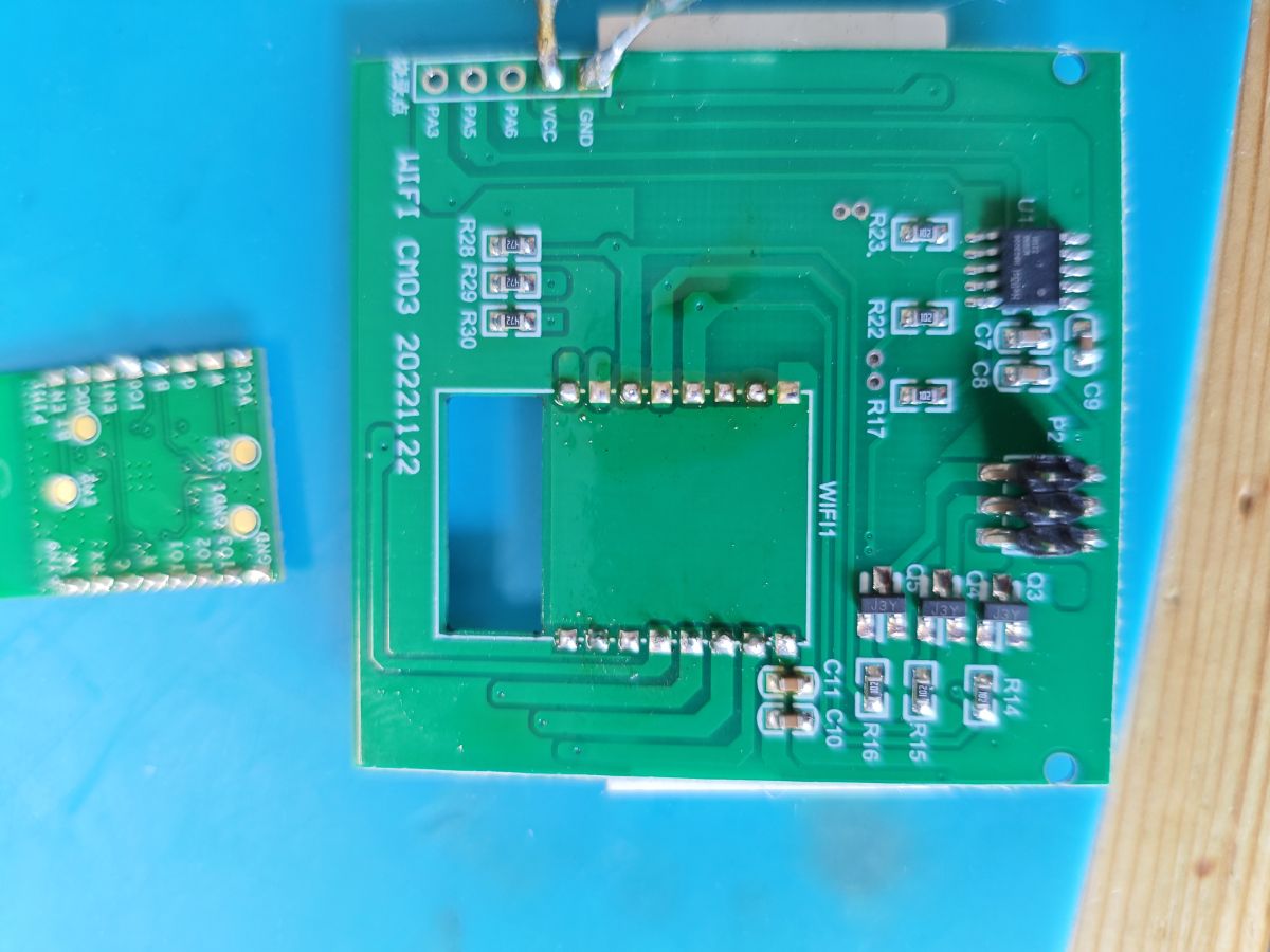

    Thanks for this great post. I have a BL602 chip on the SDV-002 which is a 2 channel LV switch and I have been following these instructions but the Flash keeps saying Error:{ErrorCode: 0050, ErrorMsg: BFLB IMG LOAD SHAKEHAND FAIL}.
    I have checked the RX and TX and even changed them around to check, but still nothing.
    I have connected the EN pin to 3.3V and when I start up I am getting a single flash on and off of the Red LED which I assume means boot mode, If I disconnect this, it has multiple flashes while trying to connect to eWelink.
    This USB to UART device doesn't pick up in the simple flasher, but it does in the newer version of the BLDevCube. I'm not sure if this is the reason, but I do use this device for flashing with ESPhome.
    Any help will be appreciated.
    Electronic circuit with USB to UART module and dual-channel switch. Green PCB with a BL602 chip on SDV-002 module, featuring two blue relays, a red LED, and various wires connected to pins. Close-up of a Wi-Fi Smart Switch DIY-DC02-EWL with visible labels and connectors.

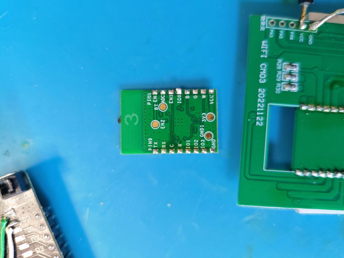

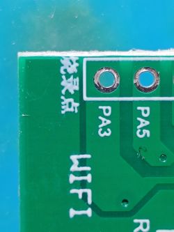

  • BOOT pin pull-up needed for BL602 UART mode
    #42 21202165

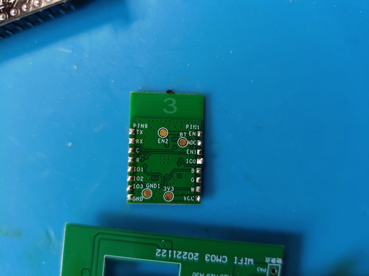

    Posts: 5216
    Help: 448
    Rate: 917

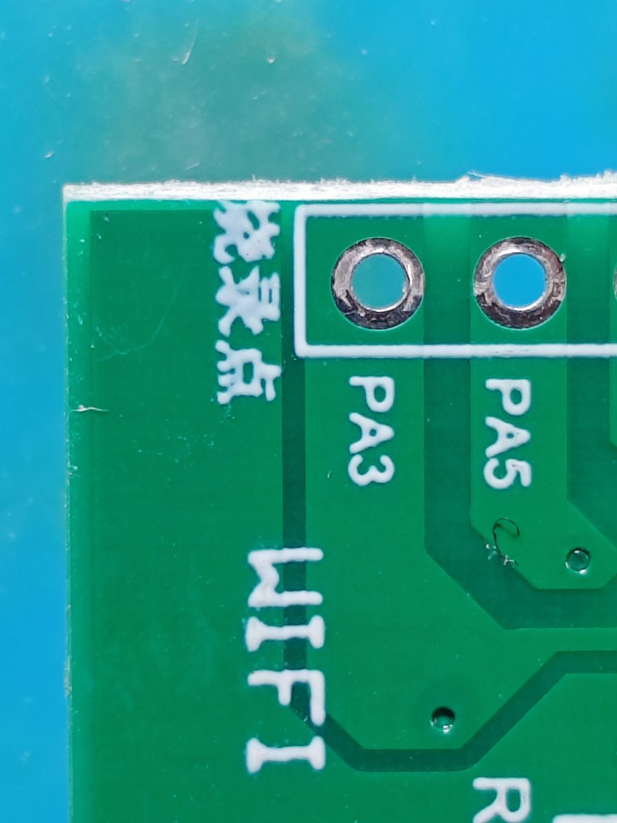

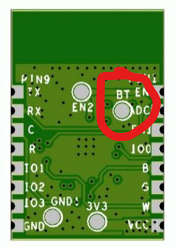

    Hi. You need to pull the BOOT (BT/GPIO8) pin high with a 10K resistor on BL602 to get into UART download mode. This is demonstrated here https://www.youtube.com/watch?v=bs0ylC6xRs0
    The SDV-002_V1.2 module has this pad on the underside
    The image shows the underside of a module with pin labels and a red circle highlighting the BT_EN pad on the circuit board.
    so you may have to unsolder module if that doesn't trace anywhere else on the main PCB
    https://www.elektroda.com/rtvforum/topic3889041.html
  • #43 21202593
    Posts: 14767
    Rate: 12906
    I don't think this tiny USB to UART converter can provide enough current for BL602 to work correctly.,.

    muzzthegreat
    patentjyp wrote:
    Here, BT_EN is connected to pin 14 (CHIP_EN) of BL602 (tested with multimeter). Therefore, this BT_EN pin is indeed BOOT.
    The previous post by patentjyp states that the BT_EN pin is the BOOT pin, so I did pull this pin high (albeit not through a 10k resistor, would this matter?).
    I am really hoping I don't need to unsolder the board to get to the BT pad. Can anyone confirm this?
    Thanks
  • #45 21206206
    Posts: 5216
    Help: 448
    Rate: 917
    I do not have an SDV-002_V1.2 to check.
    But the BT and the EN are different labels, one for each pad, not BT_EN for one pad.
  • Boot handshake failure suggests wrong boot mode
    #46 21214288
    muzzthegreat
    I've tried a few different setups trying to boot the SDV-002_V1.2 and I keep getting the same error message in the log
    [22:15:08.999] - shake hand fail
    [22:15:09.121] - Load helper bin time cost(ms): 2958.368408203125
    [22:15:09.121] - {"ErrorCode": "0003","ErrorMsg":"BFLB LOAD HELP BIN FAIL"}
    [22:15:09.121] - Burn Retry
    [22:15:09.121] - 0
    [22:15:09.122] - Burn return with retry fail
    Does this mean that I am not getting it into boot mode?
    The last resort is for me to take the SDV-002_V1.2 off the rest of the board to get to the BT pad at the back, but I have tried to connect directly to the BL602 GPIO8 which I believe is the Boot pin, but still no luck. Any other suggestions that I might try?
    Thanks for the help
  • #47 21214312
    Posts: 5216
    Help: 448
    Rate: 917
    I'm not sure what else to suggest. Getting to the BT pin or pad is a must to get it into UART download mode.
    Which pin have you connected to? Do you have any clear detailed pics?
  • Flash via R2 pull-up and ESP32-C2 replacement
    #48 21214352
    insmod
    Posts: 1432
    Help: 168
    Rate: 455
    Before I replaced this module, I successfully flashed it by soldering a wire to R2 and connecting it to 3.3v.
    This method is shown in https://www.elektroda.com/rtvforum/topic3970659.html#20533595.
    If you have the ability to remove the module, why not replace it with an ESP?
    (if you truly decide on ESP, then you will have to pull up the strapping pin (IO0 on ESP-12) through a resistor. I used an esp32-c2 module and 1K resistor)
  • #49 21214457
    muzzthegreat
    >>21214352
    This was exactly what I did, I connected R2 to 3.3V through a resistor.
    The light on the board flashes differently so I believe that something is happening, but it keeps telling me "shake hand fail".
    Could it be that my usb converter is not working or is it definitely not getting into boot mode?
  • #50 21214638
    Posts: 14767
    Rate: 12906
    You can try lower baud rates, swapping RX and TX, or different USB to UART converter

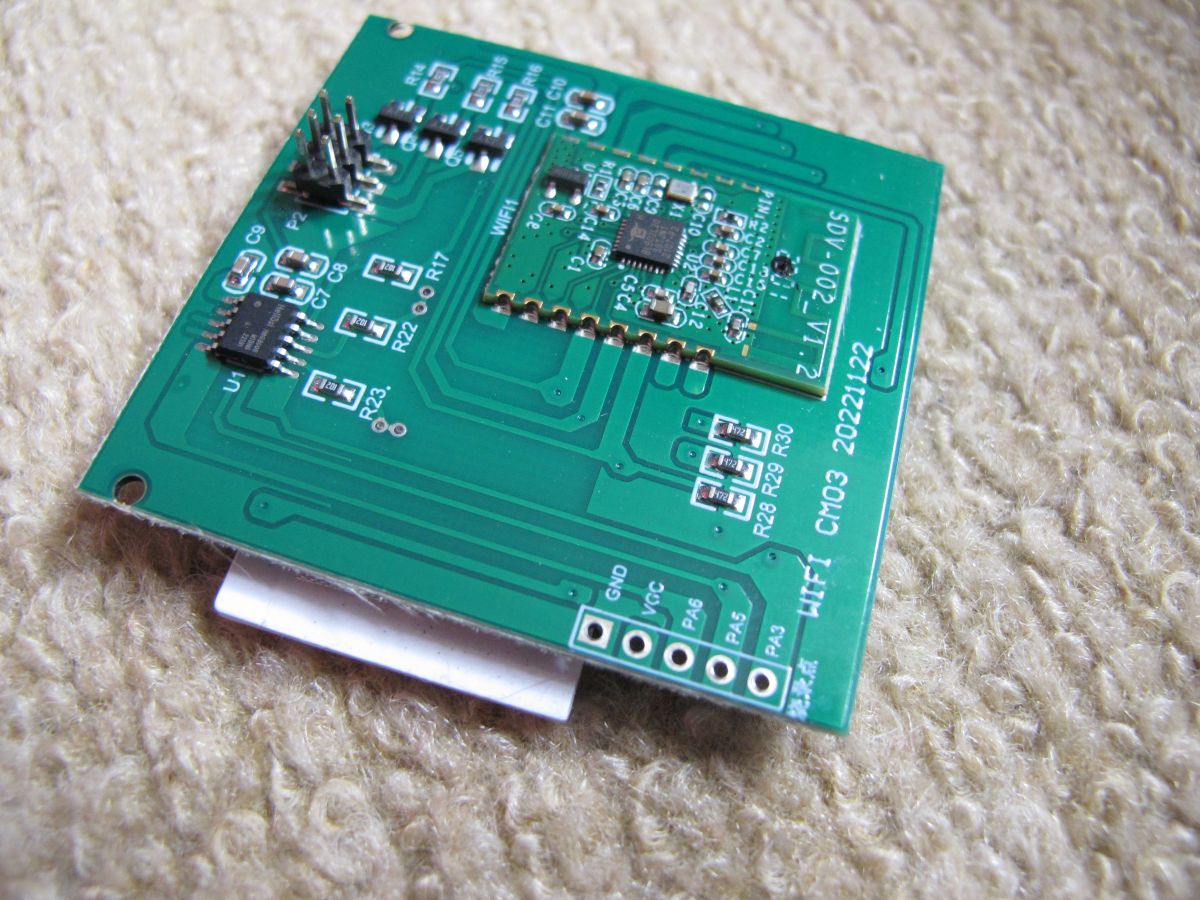

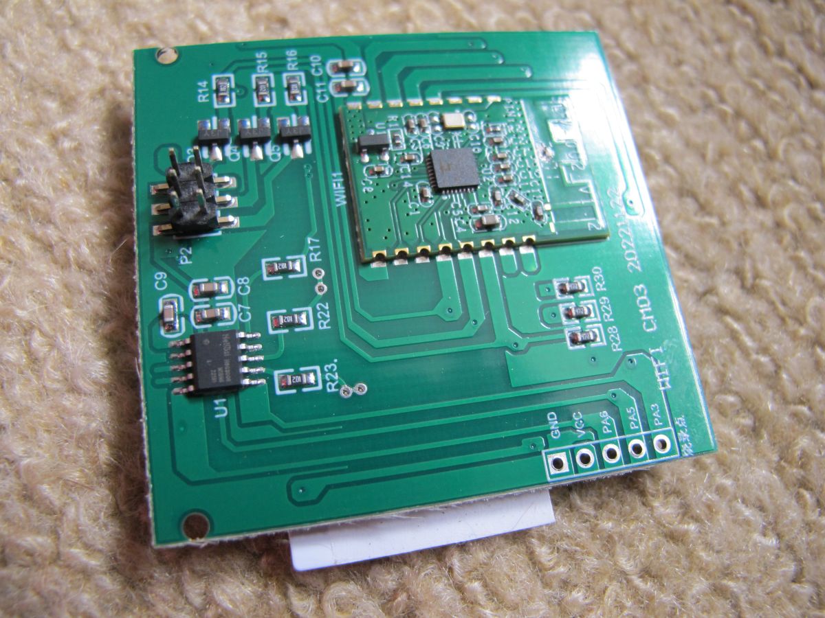

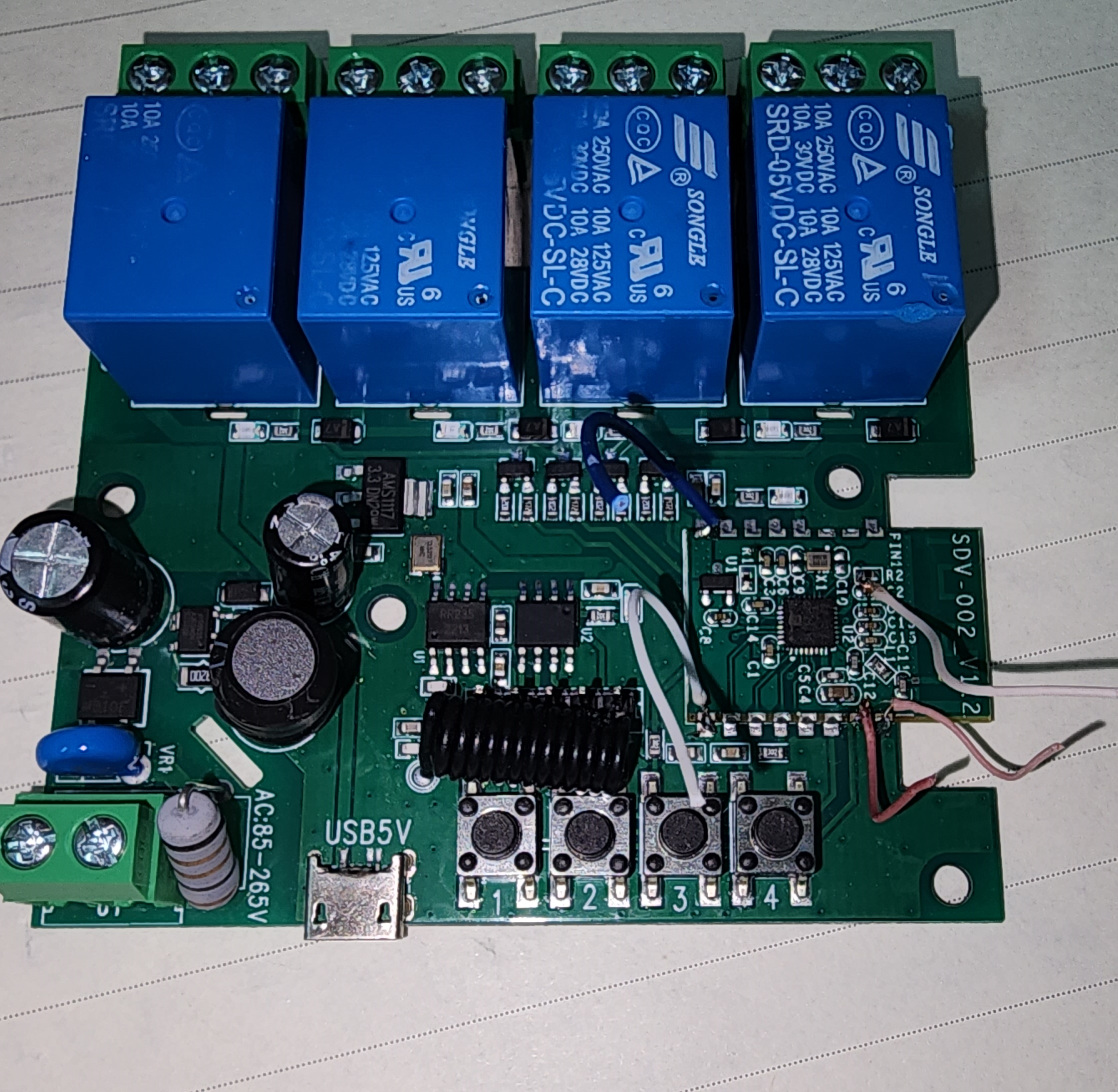

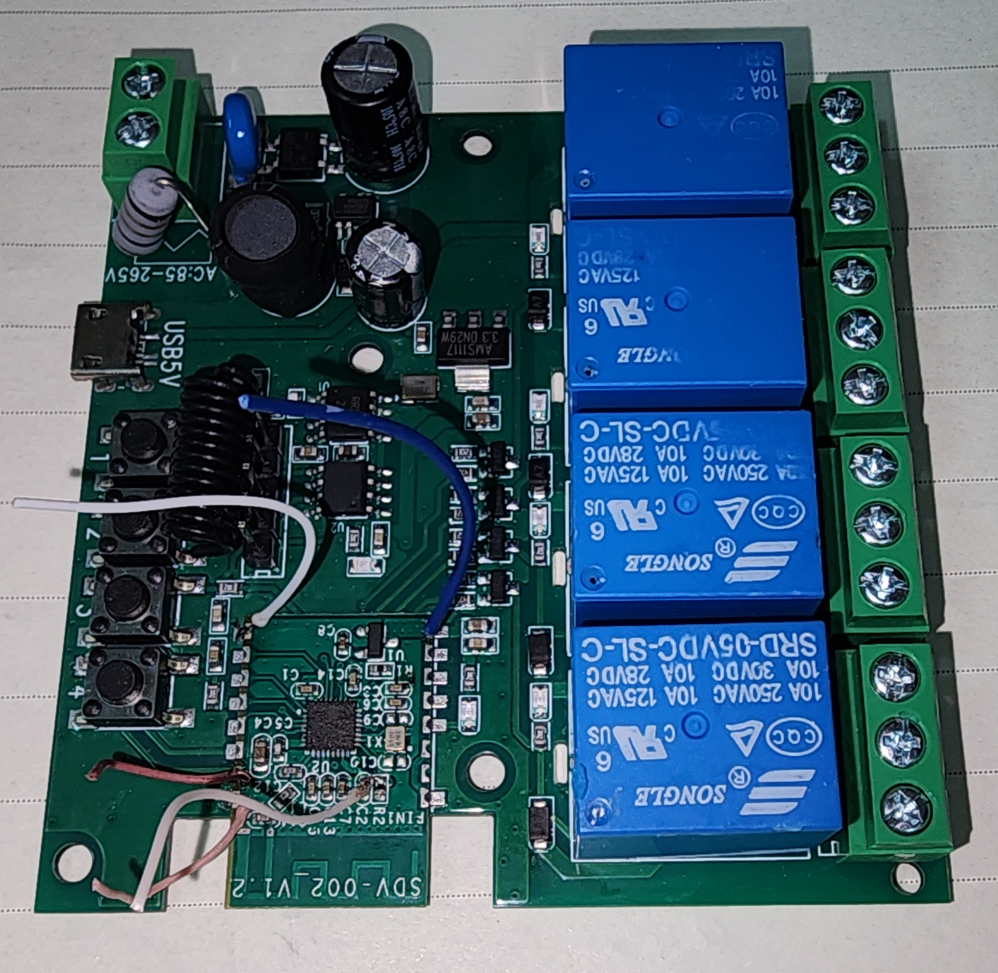

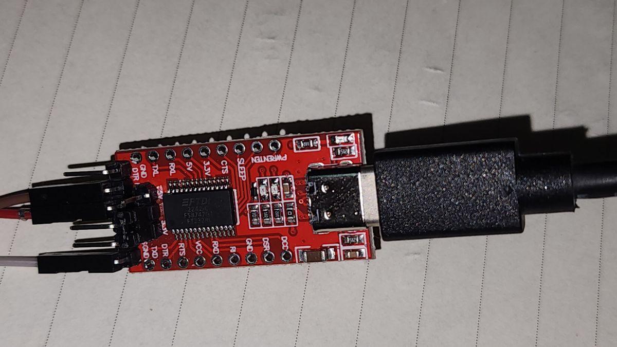

    BL602 4-gang switch flashed with OPNBKN pin map

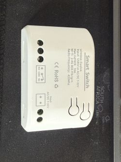

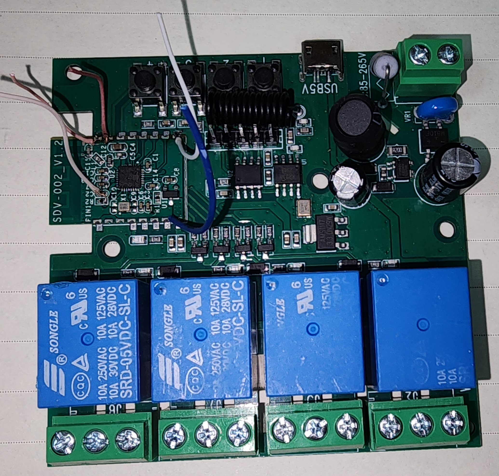

    #52 21452814
    dullu
    HI,
    I am posting this to help if someone has the same 4-ch and wants to flash it.
    I received a 4-Gang switch from Aliexpress.
    opened it and found BL602L20 Module SDV-002_V1.2 (it can be configured via Ewelink app)
    This has 4 relays, 4 buttons, WIFI 433MHz
    Blue box with the text Smart Switch on top.
    Smart home device packaging showing features like remote control and schedules.
    Product label with barcode and information about a smart module.
    With the help of this forum thread, I successfully flashed the latest version of OPNBKN on it.
    Circuit board with blue relays and various electronic components.
    Close-up of an electronic PCB with four blue relays.
    Electronic circuit board with blue relays and various components.
    I tried to use an already available template for 4-ch but its pin assignment was different than this board.
    So, I used GPIO finder and assigned each 4 nos. of relays and buttons to their correct pins.
    By the way, I used FTDI usb to TTL adaptor. which was working nicely up to 1000000 baud (even works with 2000000 baud with short wire lengths.)
    FTDI USB to UART adapter on white paper.

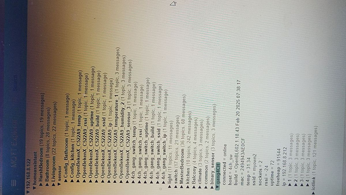

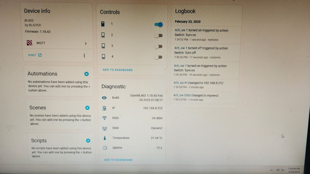

    configured MQTT etc. and finally it showed up as a device in Home-assistant.
    Screen of the MQTT Explorer application with topics and messages.
    and in home assistant it showed up instantly.....
    Display of BL602 device interface with control panel, diagnostics, and logs.
    My config is as below....
    Spoiler:
    "vendor": "Tuya",
    "bDetailed": "0",
    "model": "enter short model name here",
    "chip": "BL602",
    "board": "TODO",
    "flags": "134218820",
    "keywords": [
    "TODO",
    "TODO",
    "TODO"
    "pins": {
    "0": "Rel;4",
    "1": "Btn;4",
    "2": "Rel;1",
    "3": "Rel;3",
    "14": "Btn;1",
    "20": "Btn;3",
    "21": "Btn;2",
    "22": "Rel;2"
    "command": "",
    Original device image backup before OPNBK flashing is attached here.
    4gang_BL60...0_baud.zip (588.35 kB)You must be logged in to download this attachment.

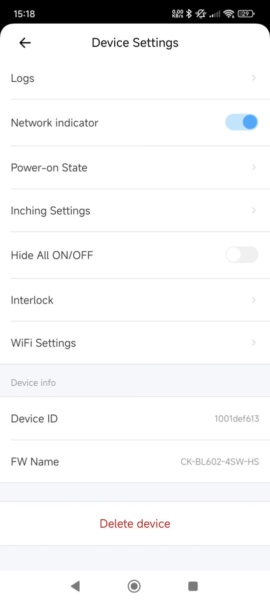

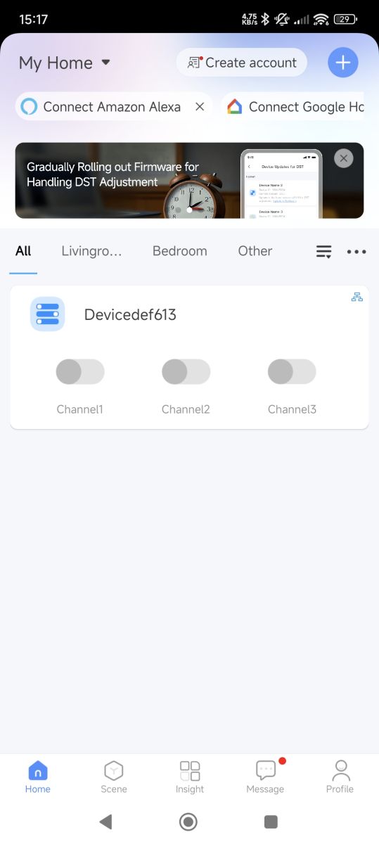

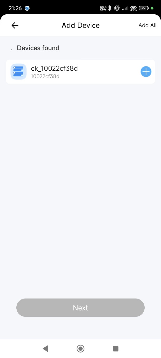

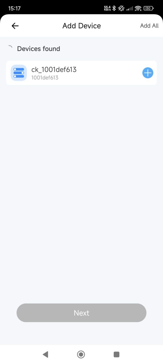

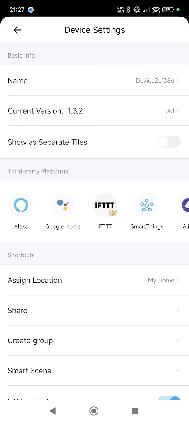

    Backup flashed and eWeLink pairing confirmed

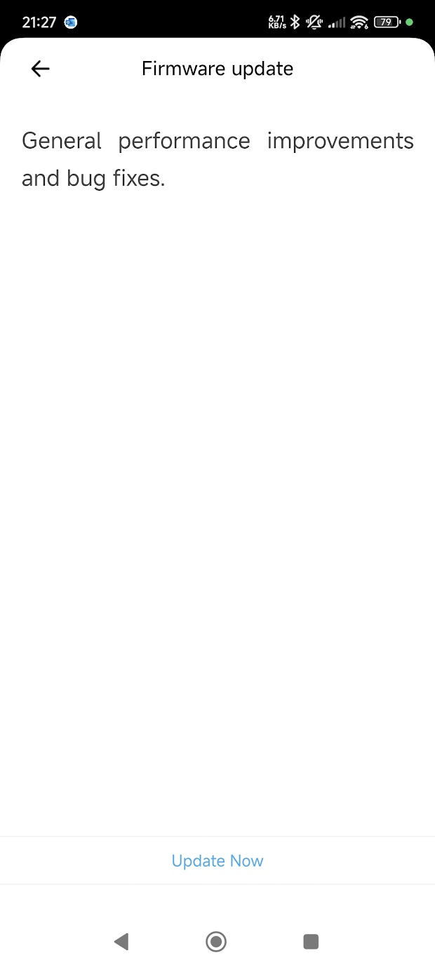

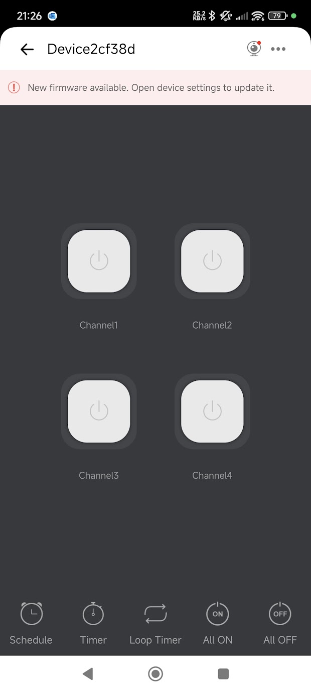

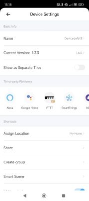

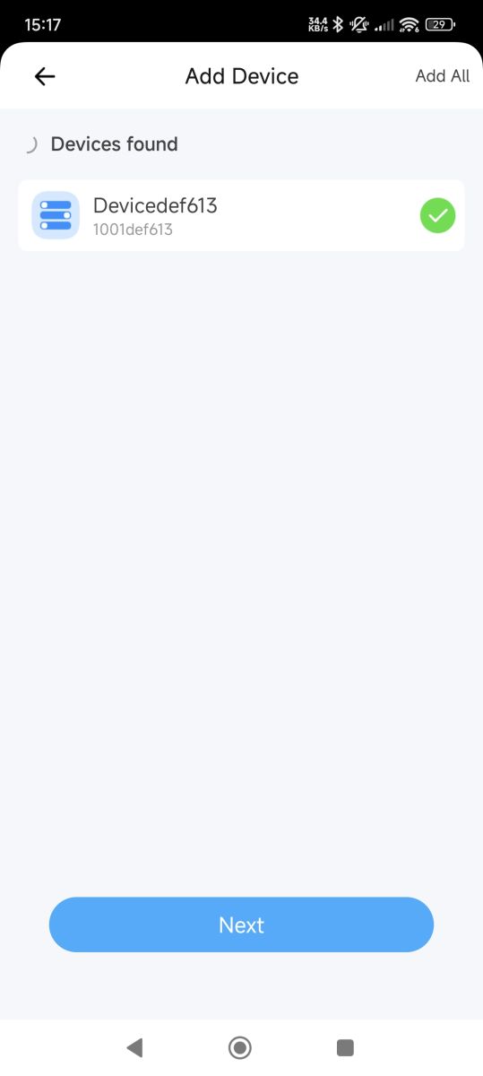

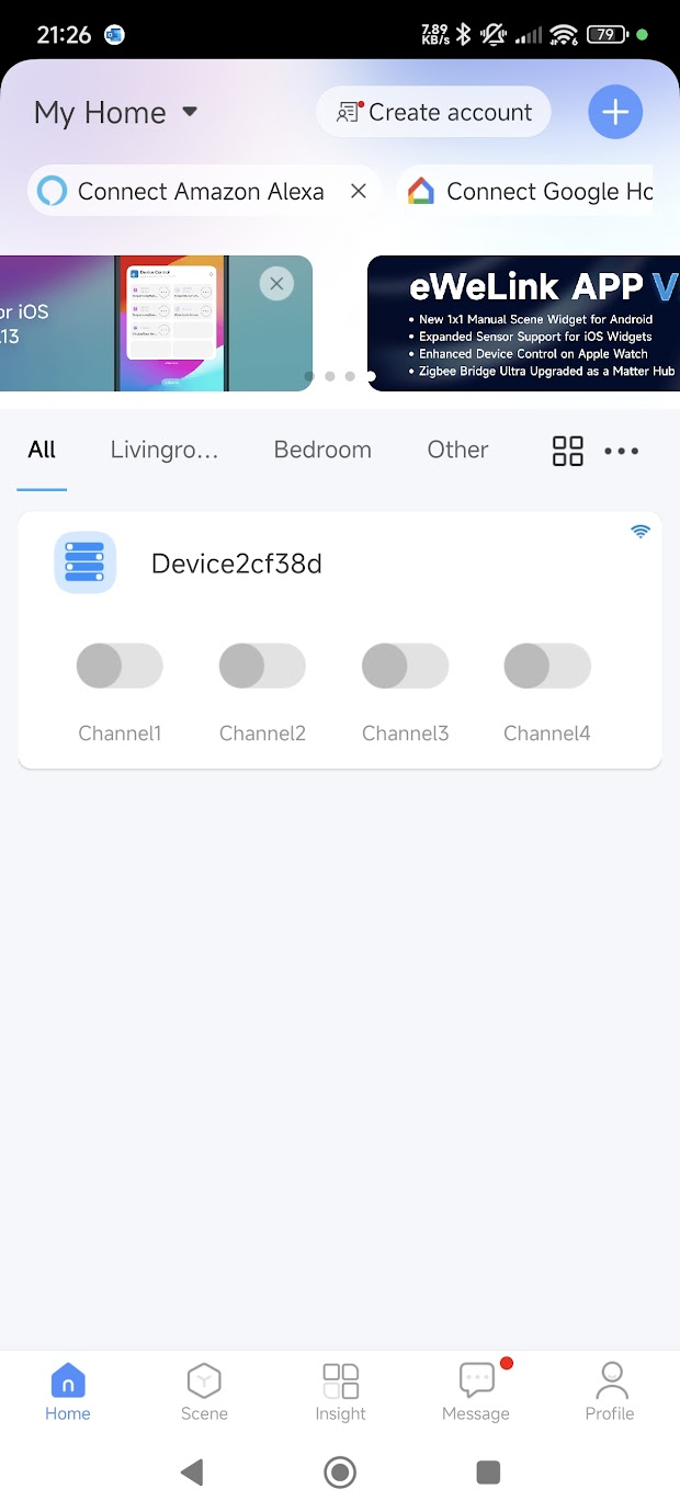

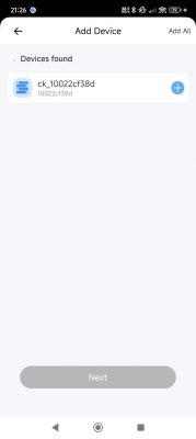

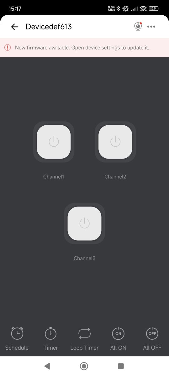

    #53 21454829
    Posts: 5216
    Help: 448
    Rate: 917
    >>21452814
    https://github.com/OpenBekenIOT/webapp/pull/185
    Added after 6 [minutes]:
    >>21452814
    no wifi LED?
    boot log
    Added after 23 [minutes]:

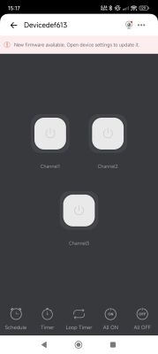

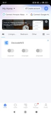

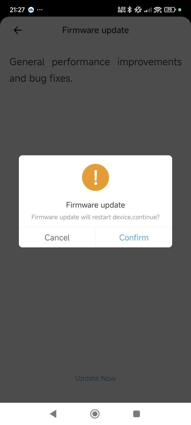

    I flashed your backup and was able to pair it in eWeLink app.
    It also offers a firmware update from 1.3.2 to 1.4.1. After update the boot log is more verbose
    App screen for adding a device, showing a found device named ck_10022cf38d.
    Screenshot showing a home device management app interface. Screenshot of a remote device control app with four channel buttons. Device settings with version 1.3.2 and integrations with Alexa, Google Home, IFTTT, SmartThings, and AliGenie platforms. Firmware update screen with performance improvements and bug fixes. Firmware update screen with a message about performance improvements and device restart.
    both versions will be here in a pairing state https://github.com/openshwprojects/FlashDumps/tree/main/IoT/BL602
    eWeLink_4Ch_Relay_PCB_(FWSW-HSBL602-SWITCH-BL602L)_(CK-BL602-4SW-HS)_xxx.bin
  • ESP-12S pinout appears compatible with SDV-002_V1.2
    #54 21483420
    feldsam
    Hello guy, I am looking to buy two of these single relay modules to control my garage door and gate: https://www.aliexpress.com/item/1005006140417293.html, they have 7-32V AC/DC input, which is great for this application. Standard VCC on openers is 24V AC. When I am looking on this SDV-002_V1.2 module, it is very similar to ESP-12S. When I am checking pinout from post #37 and comparing to ESP-12S pinout, then there is a match! I am going to order these modules along with ESP-12S and I think it is possible to just replace the control module by ESP one and load ESPHome onto it. Does anybody try this?
  • #55 21483654
    insmod
    Posts: 1432
    Help: 168
    Rate: 455
    >>21483420
    I don't know if ESP-12S internal 10K pull-up on GPIO0 is enough to start the module. You may have to add 1K resistor like i did in #48.

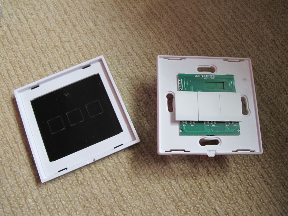

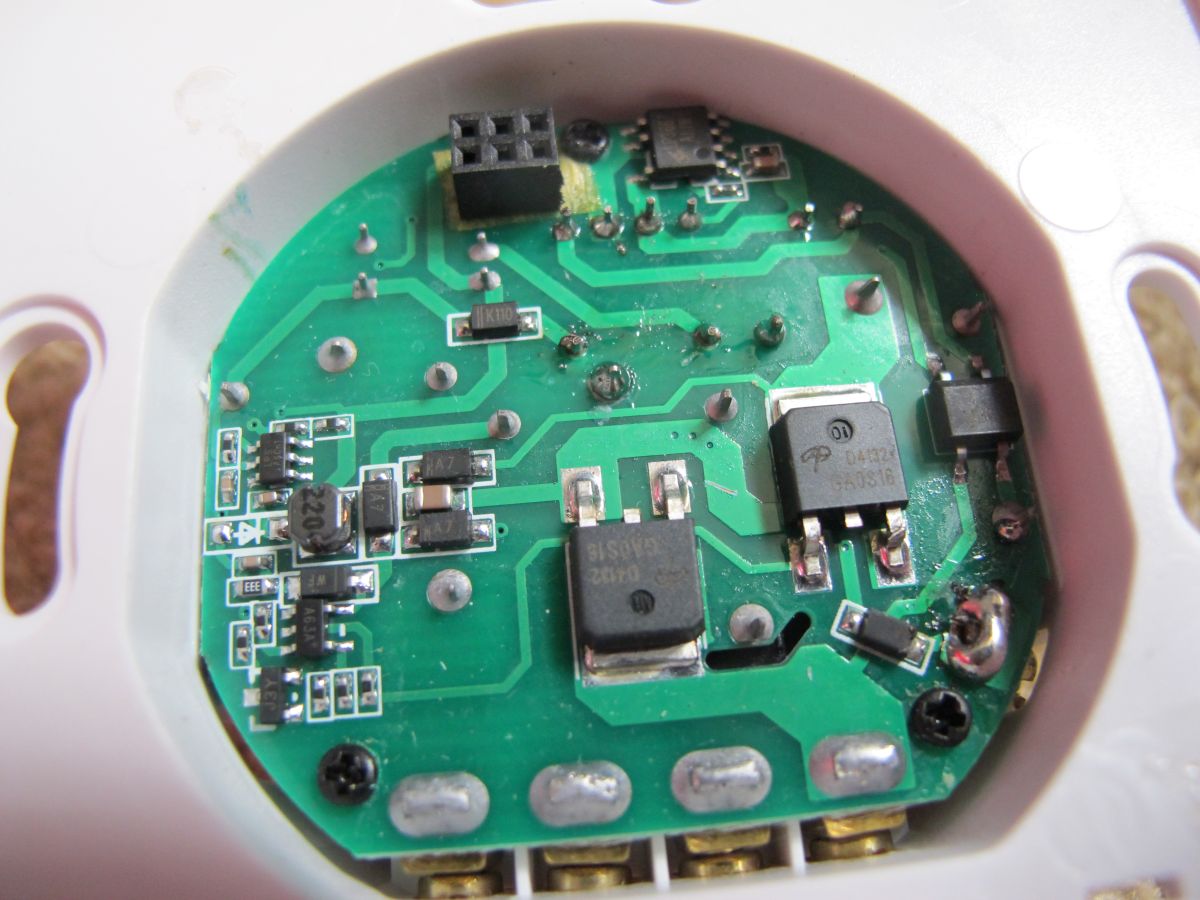

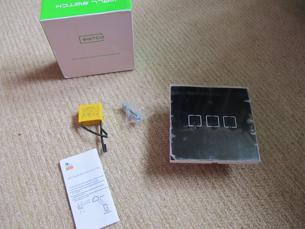

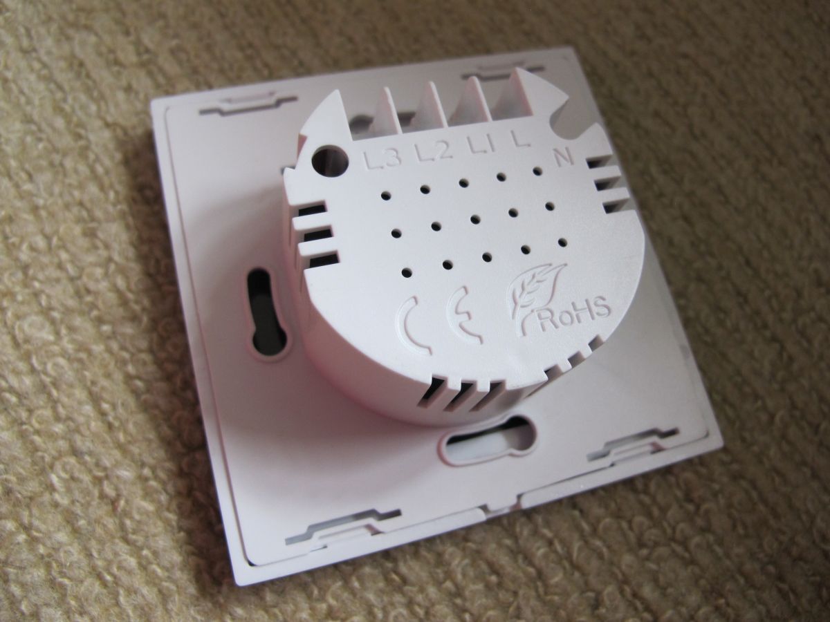

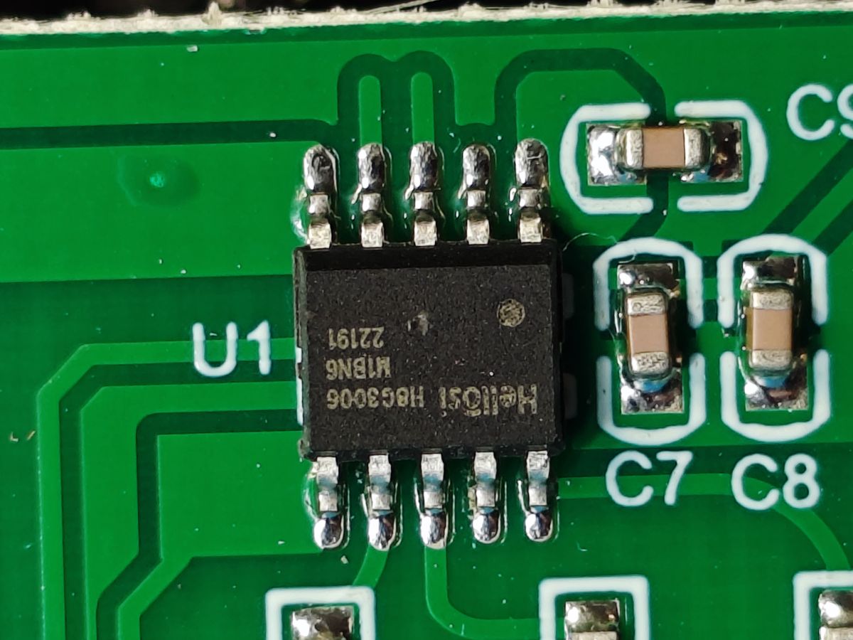

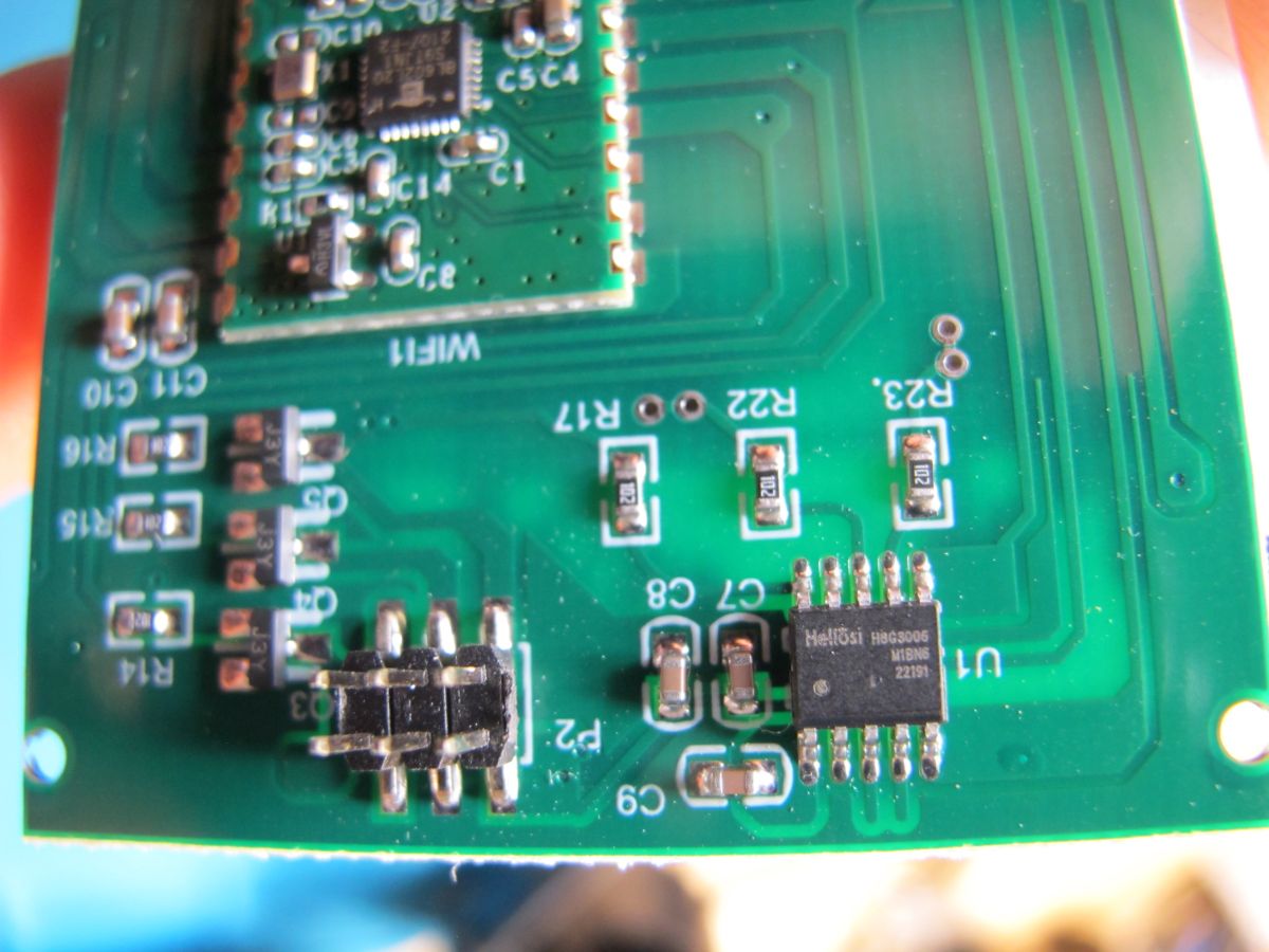

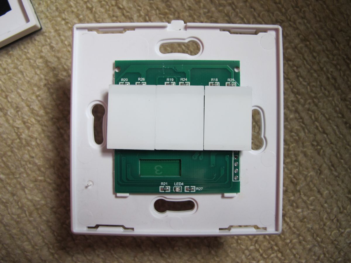

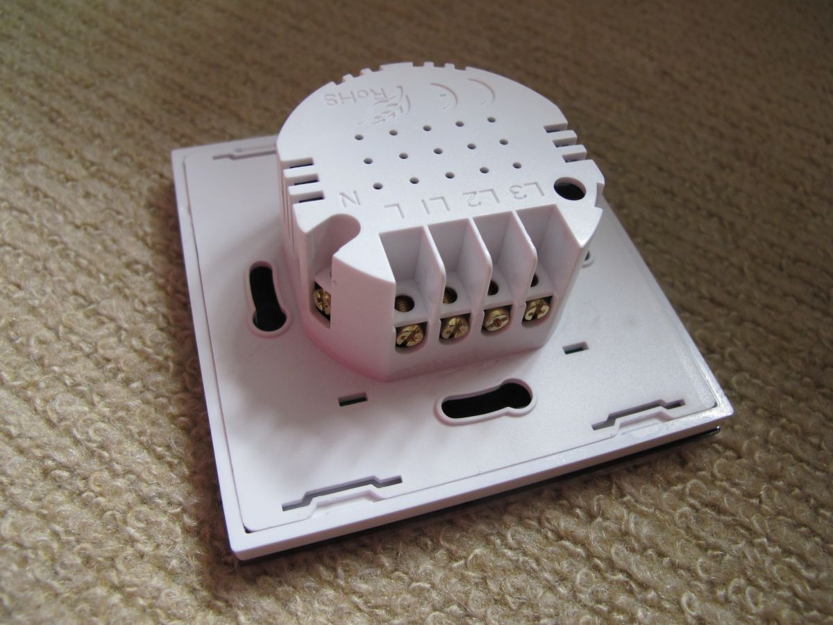

    Back to the original device type posted - I have a related 3-gang touch light switch device from "Axus" https://fr.aliexpress.com/item/1005006625784259.html
    AXUS black WiFi touch light switch with three buttons, shown on a product page with Bluetooth, eWeLink, and Wi-Fi logos.
    Here's a dump of some more stuff, even though it's pretty well covered in the first posts anyway
    White box with green SWITCH label and the slogan Show Future Technology and Embrace Smart Life. Product box labeled SWITCH and FUTURE TECHNOLOGY on the side, placed on a carpet. White product box with a large information sticker and barcode, labeled AXUS WiFi Smart Switch. Touch wall switch kit: three-button panel, yellow module, screws, manual, and box. A yellow CHAMPION X2 MPX 3.3µF capacitor with two black wires and two metal screws in a plastic bag on a beige carpet. Back of a white Axus three-touch light switch with markings L1, L2, L3, and N. Printed circuit board of the SDV-002 V1.2 electronic module on a blue background. Green PCB module with labeled pins including PIN9, TX, RX, IO1, IO2, IO3, GND, 3V3, PIN13, BTN, ADC, EN1, EN2, IO0, and GND. PCB with a removed WiFi module, visible solder pads and pin rows, on a blue work surface. Small green PCB module with labeled pins and mounting holes, resting on a blue surface next to a larger printed circuit board. Two printed circuit boards: one larger with a socket for a module, and a smaller one partly out of frame. Close-up of two printed circuit boards – a small electronic module on the left, and a larger board with a socket and connected wire on the right. A section of a green PCB showing the labels “WIFI”, “PA3”, “PA5”, Chinese characters, and two mounting holes. Close-up of a Hellosi H8G3006 chip on a green PCB, with visible U1 marking and nearby SMD capacitors. Electronic module with Hellosi H8G3006 M1BN6 chip and pin header on a green PCB. Close-up of an electronic device's PCB with visible integrated circuits and a pin header. Close-up of a green PCB with a Wi-Fi module and SMD electronic components, lying on a carpet. Close-up of a green PCB with electronic components and pin headers, lying on a light carpet. PCB board with a Wi-Fi module and electronic components on a green substrate. Wi-Fi module PCB with BL602 chip and various connectors and electronic components. Close-up of a printed circuit board with electronic components inside a case, visible IC chips and connectors. Open case of a touch light switch showing the circuit board with electronic components inside. Top view of an open Axus 3-gang touch light switch, showing its PCB and three large touch buttons. Disassembled Axus touch light switch with three touch zones, showing front panel and PCB. Yellow CHAMPION X2 MPX 3.3µF film capacitor on carpet background, with voltage ratings and certification marks. Rear view of a white Axus touch light switch with terminals labeled L, N, 1, 2, 3.
    I couldn't find any datasheets for or even company information regarding the Hellosi H8G300H M1BN6 touch chip.
    original fw boot log
    eWeLink pairing and firmware update
    Screenshot from a device adding app – one device found named ck_1001def613. Mobile app screen showing a found device named Devicedef613 with a green checkmark and a Next button at the bottom. Screenshot of a smart home control app showing a device named Devicedef613 with three switchable channels. A device control app screen showing three channel buttons and a notification about a new firmware update. Device settings screen in a mobile app showing device name, firmware versions, and integrations with Alexa, Google Home, IFTTT, and SmartThings. Screenshot of a smart device settings screen showing options like network indicator, power-on state, WiFi settings, and device information.
    ota update comes from http://52.57.99.135:8088/ota/rom/6B0Tvxb25CAj...67afd99d8c4597e9f9ea30e7afb90afb4b6eddc05aeba
    updated fw boot log
    fw dump https://github.com/openshwprojects/FlashDumps/commit/47ae54944b881af3f317f87401c638b939e4def8

What power supply should I use when flashing BL602 modules, and why can cheap PL2303 USB-to-UART adapters cause boot or Wi-Fi failures?
Use a stable external 3.3 V supply or regulator, not the weak 3.3 V pin from cheap USB-to-UART adapters. One PL2303 board exposed only a 4 mA 3.3 V LDO, which cannot power a Wi-Fi module. The failure looked like successful flashing followed by no access point or repeated resets. A power bank or external regulator fixed the issue in the thread. [#20815848]

How can I reduce the 1–1.5 second touch response delay on OpenBeken BL602 touch wall switches?
Enable OpenBeken flag 6, the “instant touch reaction” flag. One user reported a 1–1.5 second delay on all touch switches after flashing. After setting flag number 6, the sensor response became instant. This is a software configuration fix, not a relay or touch-chip hardware modification. It applies when button events are delayed but GPIO mapping already works. [#20888453]
