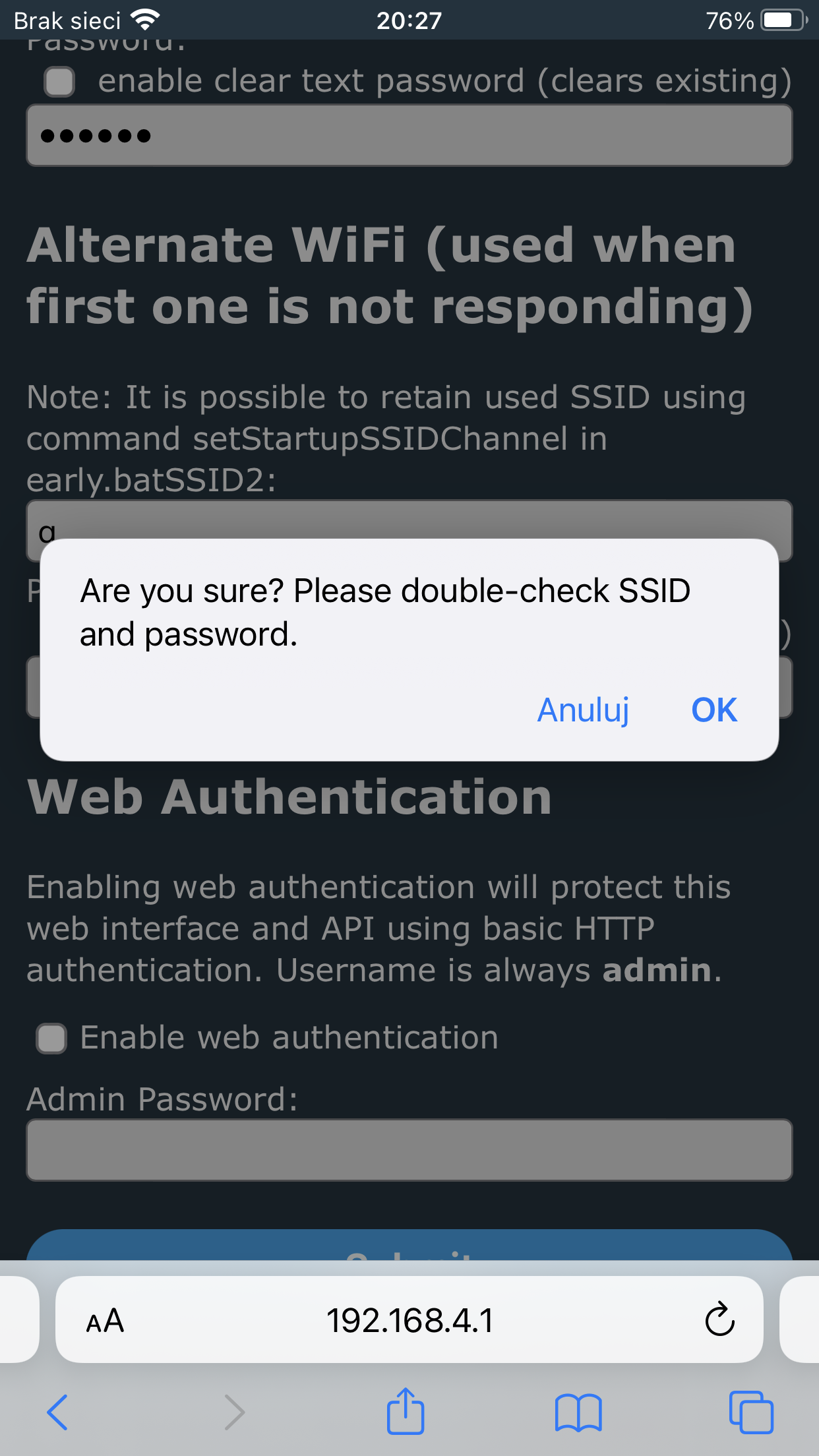

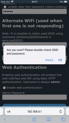

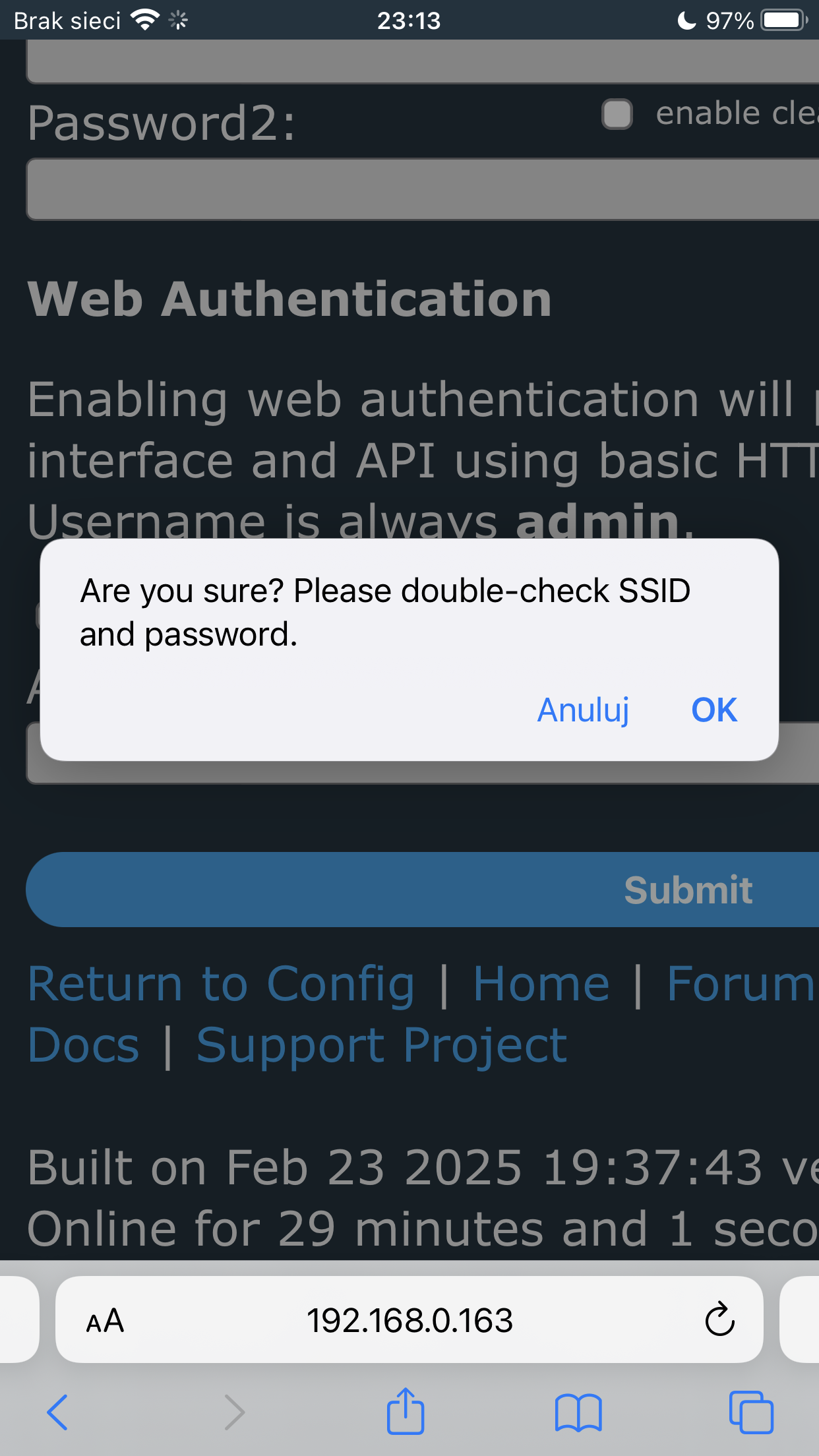

    Yes that is what appeared to be happening, in the browser window that appears on connect. It seems OK now it is connected to the network and I go there directly with Safari
  • #62 21589630
    Posts: 14767
    Rate: 12907
    It seems to work on my iPhone. Can you provide more details which browser do you have?
    Info on BL602 Module SDV-002_V1.2 from Aliexpress 3-Gang Switch, Pin Compatibility & GPIOs
  • #63 21590483
    ausalex
    >>21589630
    Safari on iOS 18.6 works now it is on my network but never worked when it was acting as a hotspot.
  • #64 21590654
    Posts: 14767
    Rate: 12907
    Hm.. let me recheck... in AP mode
    iOS 15.8.3, it seems... still working

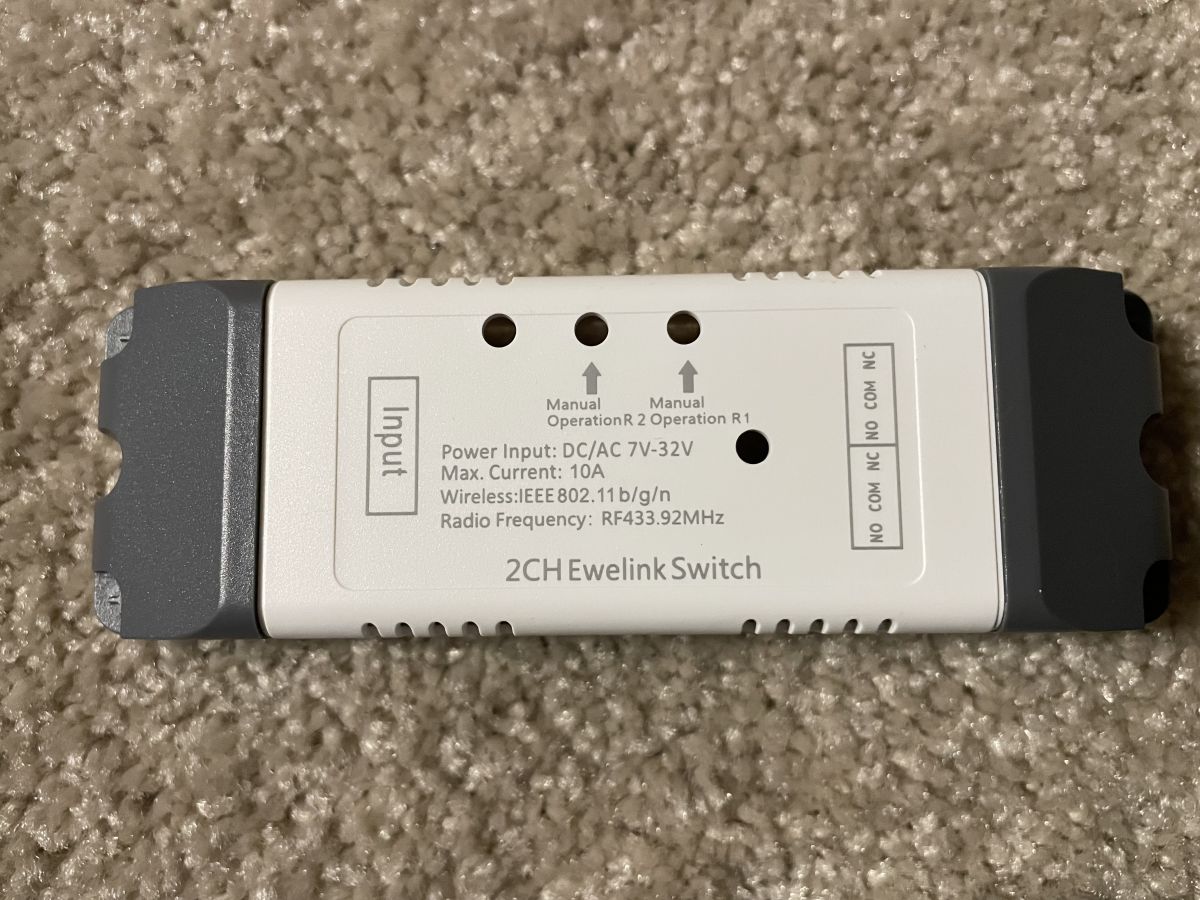

  • Flashed BL602 SDV-002_V1.2 relay module successfully
    #65 21629997
    bashioo

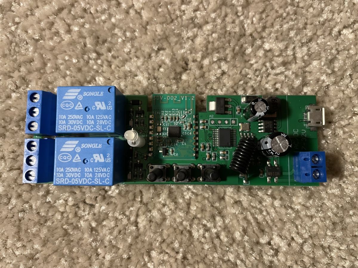

    Thanks to this forum and this post specifically, I was able to flash yet another incarnation of a very similar relay from AliExpress.
    2 Channels eWeLink WiFi Smart Switch Module 7-32V
    AliExpress link: https://www.aliexpress.com/item/1005009212238503.html
    WiFi relay module SDV-002_V1.2 with two blue relays and various electronic components
    2CH eWeLink WiFi switch module placed on grey carpeted floor
    Smart switch box eWeLink 7–32V with WiFi, CE, and Alexa/Google Assistant logos
    Receiver module label with manufacturer details and CE, UKCA, RoHS markings
    WiFi relay module under magnifying glass, with soldered wires and a lit red LED

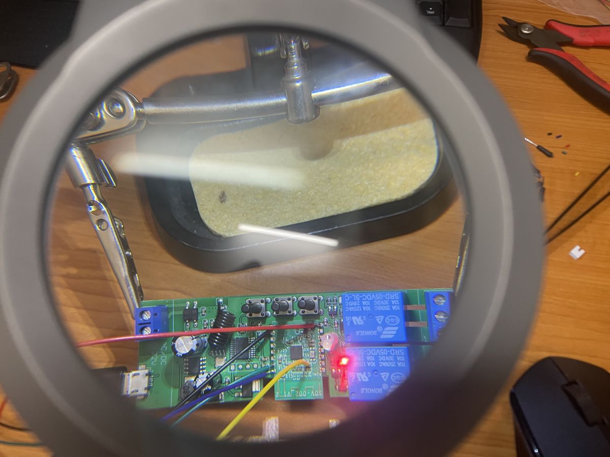

    Exactly the same BL602 Module SDV-002_V1.2.
    Flashed as per instructions from this post - powered the board separately via USB, and only connected Ground, TX and RX from FTDI adapter. Connected Reset to VCC via 10k resistor.
    Config:
      "vendor": "Tuya",
      "bDetailed": "0",
      "chip": "BL602",
      "board": "TODO",
      "flags": "1088",
      "keywords": [
        "TODO",
        "TODO",
        "TODO"
      "pins": {
        "0": "Rel;0",
        "1": "Rel;1",
        "12": "Btn;0",
        "22": "Btn;1"
      "command": "",
    Could not find WiFi LED though.

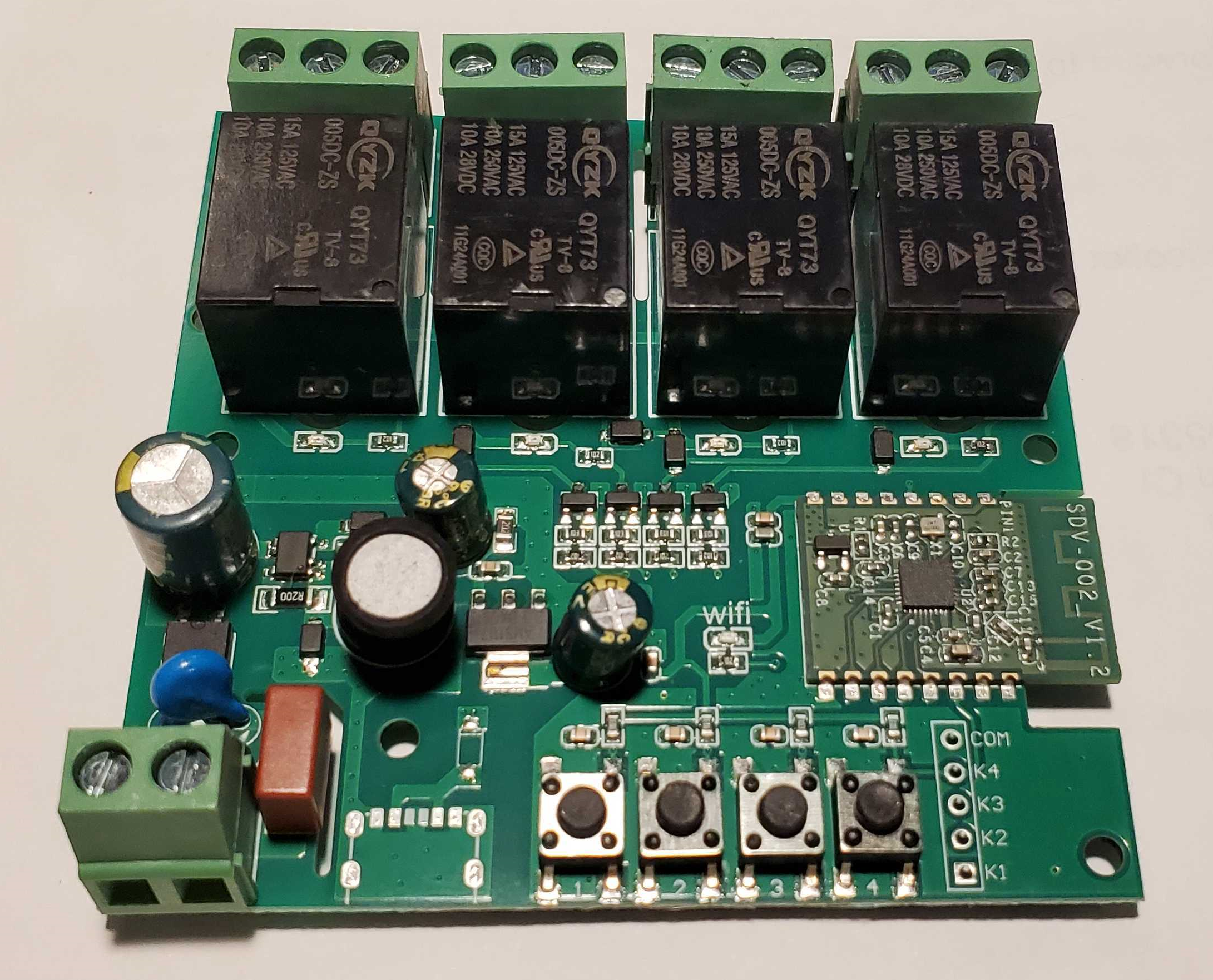

  • Questions about boot mode wiring and pin mapping
    #67 21702698
    mseelye
    >>21452814
    @dullu
    Hello, I have a very similar unit to the one you were able to flash.
    Relay board with Wi-Fi module and four push buttons on a green PCB
    Some QQs:
    Were you able to get it into boot mode using that R2 wire just going to Pin1/EN? Or did you find some other way to get to BT?
    Also I'm assuming in your images `Blue` is VCC, across from it `White` is GND, on the same side as GND is RX and TX (Red-ish and Tan-ish). And the other (white-ish) wire looks to be soldered to R2. Is that correct?
    Also, is TX actually connected to anything? I can't seem to trace it, (I have a SDV-002_V1.2 as well)
    Thank you!
