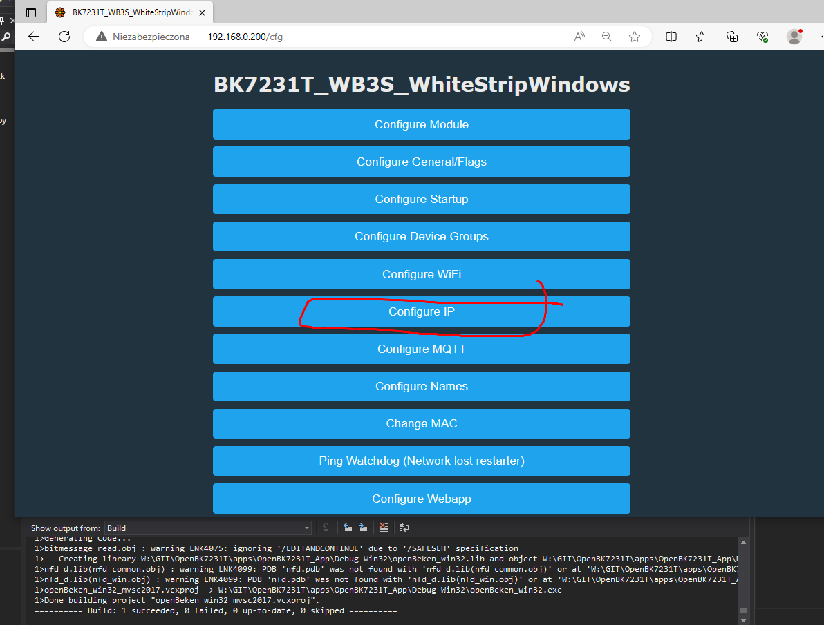

    I wanted to ask.. I am having trouble getting the IP address of the device.. Each time I connect to an access point, I don't have the privilege to access the router webpage.. I am planning to set a static IP address on the device during OpenAP mode.. And then set the main WiFi SSID and password by using the previously set IP address..
    Is that possible?

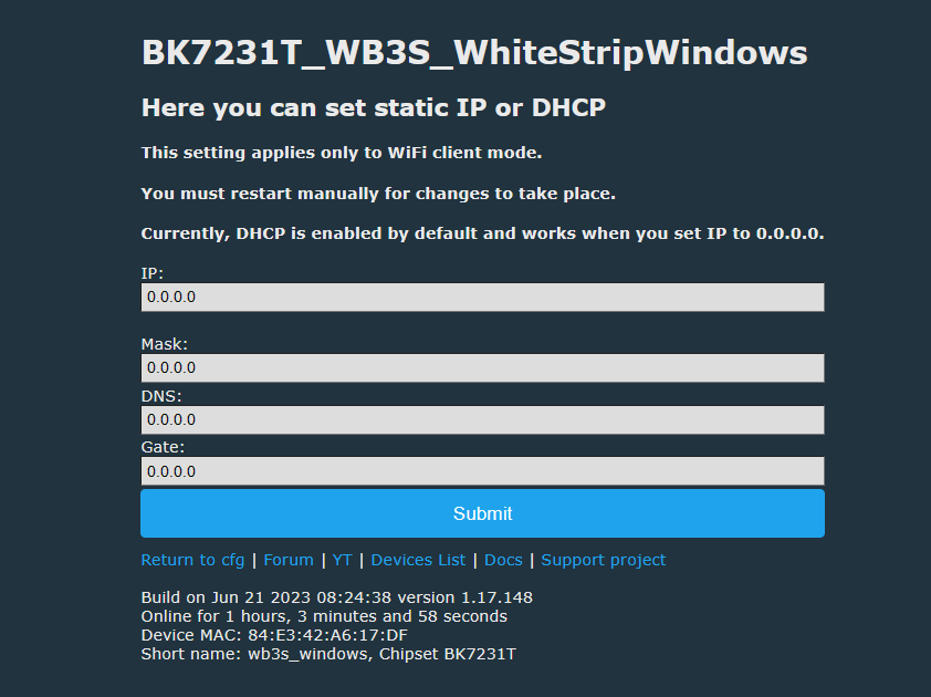

  • #33 20629101
    Posts: 14756
    Rate: 12883
    Hello, you can easily set the static address for OpenBeken device. You can do this in AP mode. Make sure the IP address you are using is unique. I am attaching a config page screenshot below:

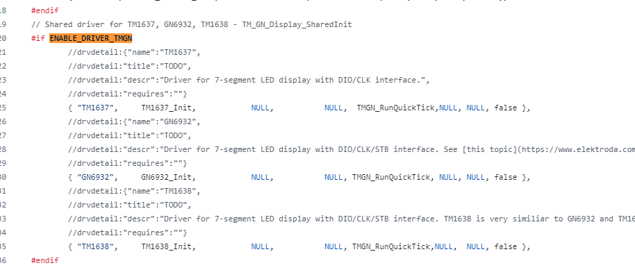

  • GN6932 driver missing from build
    #34 20979685
    Posts: 5214
    Help: 448
    Rate: 916

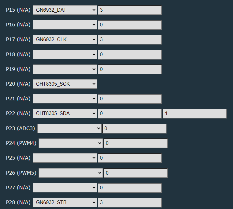

    I assume everyone else's config is still working?
    Mine doesn't seem to like starting the GN6932 driver. I've tried CLK/DAT/STB on different channels and the same.
    Screenshot of pin configuration settings for driver GN6932.
    Info:MAIN:Driver GN6932 is not known in this build.
    Info:MAIN:Available drivers:

  • Enable TMGN driver in obk_config.h
    #35 20979746
    Posts: 14756
    Rate: 12883
    The answer is here OpenBeken online building system - compiling firmware for all platforms (BK7231, BL602, W800, etc)
    The GN6932 is so rarely used that's disabled in latest builds. You need to enable it. Alternatively, I can make a build for you in Pull Requests.
    See:
    Code snippet showing driver configuration for TM1637, GN6932, TM1638 with a highlighted line for activation
    You need to add
    #define ENABLE_DRIVER_TMGN 1
    in obk_config.h
  • #36 20979755
    Posts: 5214
    Help: 448
    Rate: 916
    Ah. That explains it! Maybe it's time I had a go at my own fork and building. I'll try your guide, thanks
    Unless you think it should go back into live...

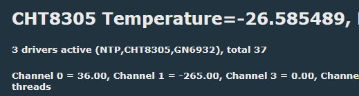

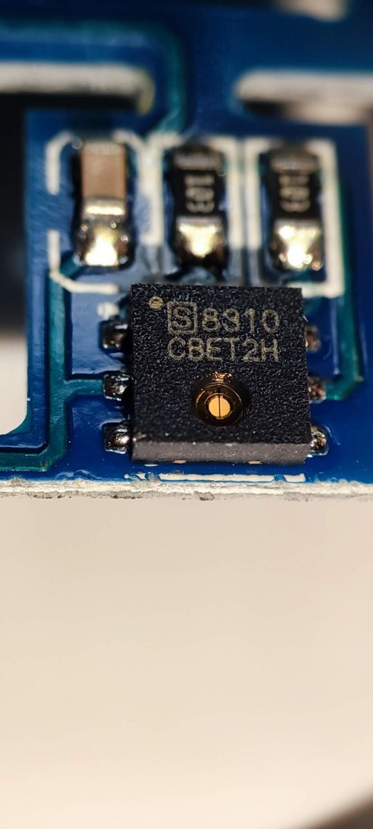

    CHT8310 driver needs older version and channel swap
    #37 20980349
    Posts: 5214
    Help: 448
    Rate: 916
    Just for testing I went back to 1.17.295 and the driver of course works now. Because the newer units have a CHT8310 temp/hum sensor (mine does anyway), as opposed to the CHT8305, the driver for the CHT is the old version before CHT8310 support was added. As such, the readings are incorrect. No matter. Just testing.
    I also had to set the CHT_SDA channels as 1:0 way round or the display would show the temp in the humidity line and humidity in the temp line. The temp though is showing the div10 figure in LED and -265 in GUI.
    Screenshot showing temperature readings from the CHT8305 sensor with a value of -26.585489 and three active drivers: NTP, CHT8305, GN6932. Digital display showing time, temperature, and humidity.

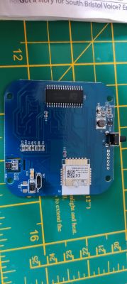

    Some random pics for the library
    Close-up of an electronic component on a blue printed circuit board with the markings B8310 CBET2H. GN6932 integrated circuit on a circuit board.
    Electronic circuit board with a series of LEDs marked with a QC label
    A blue circuit board with various electronic components.
    Message indicating no updates available for the device.
    Image of an LED WIFI T&H Sensor display showing temperature and humidity.

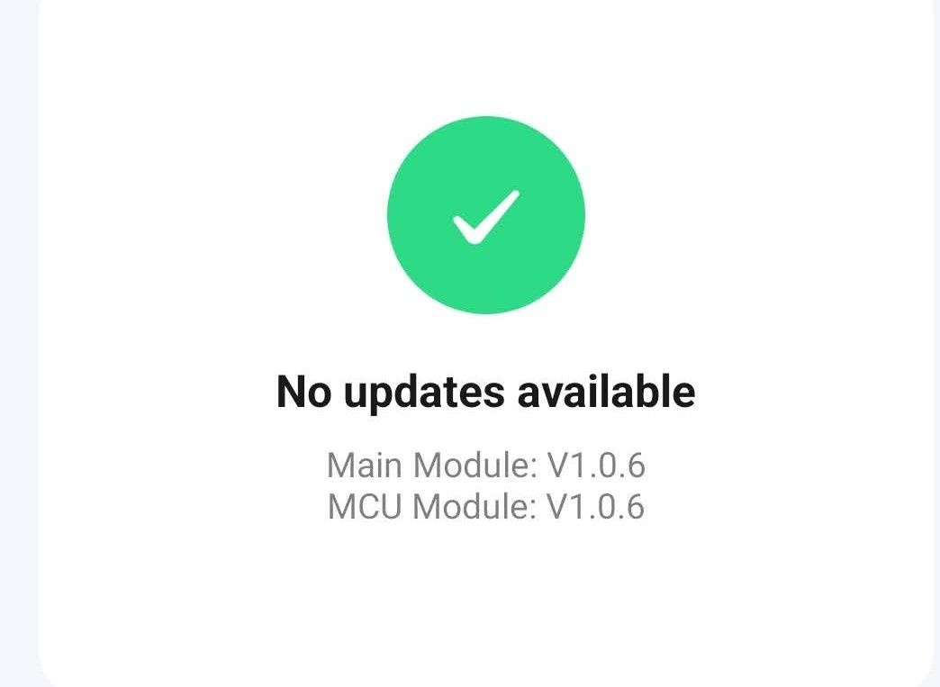

    1.0.6 is not in the known patched firmware list, so could be cloudcutter compatible, if not already in there.

    Growing flash size usage causes the "LittleFS is being removed by OTA" issue which pops up periodically on Github. That's why rarely used drivers are disabled.
    That's the old version without temperature/humidity probe driver. Can you check if it's working with new build with LED display driver enabled?

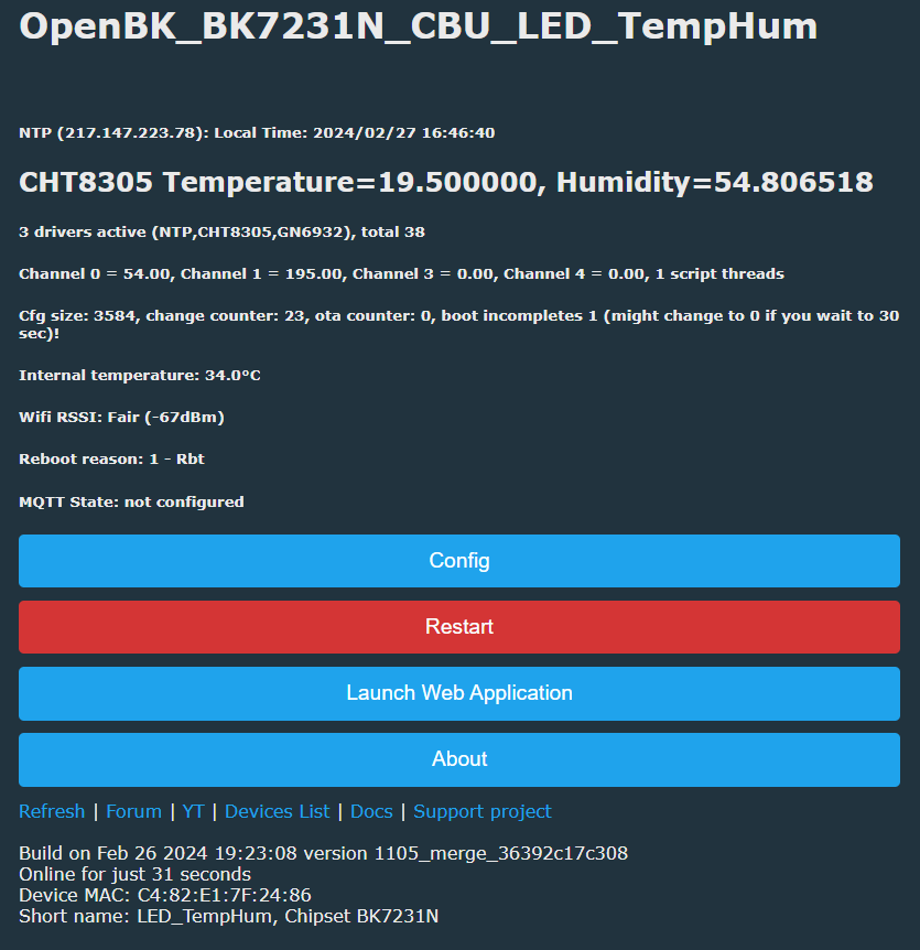

  • #41 20981282
    Posts: 5214
    Help: 448
    Rate: 916

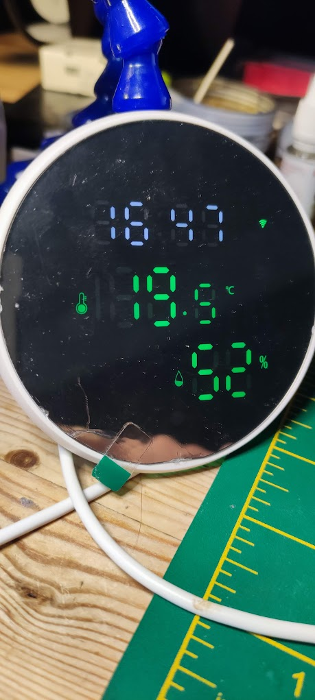

    oh. I see I see. and yay

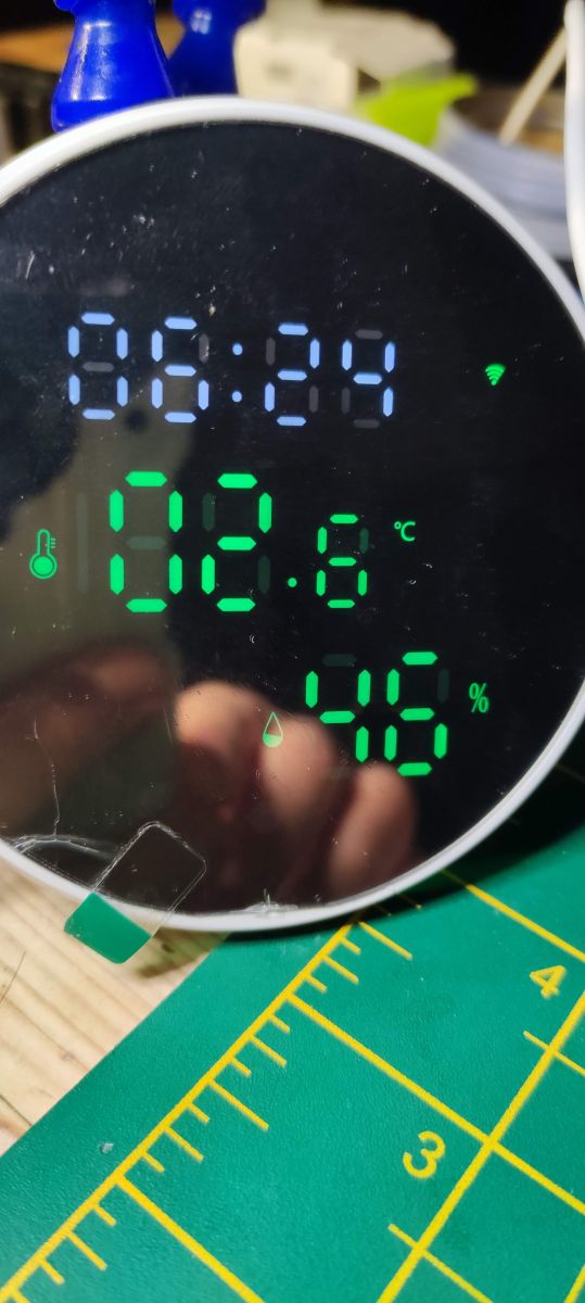

    User interface screen of the OpenBK application showing temperature and humidity data along with other technical details.
    Digital thermometer with a display showing the current time, temperature, and humidity.
    so cool
  • #42 20981879
    Posts: 14756
    Rate: 12883
    I am glad to see it's working, good job.

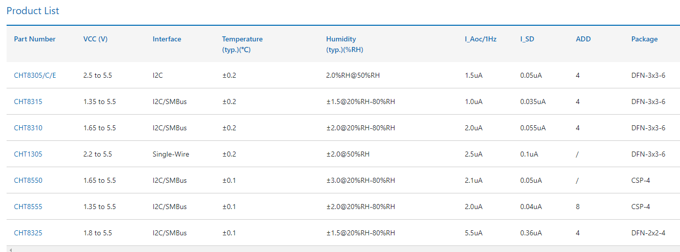

    So, to sum up, the newer models come with CHT8310 instead of CHT8305? I wonder what are the differences between those two CHT sensors.
  • CHT8310 replaces CHT8305 with minor differences
    #43 20981912
    Posts: 5214
    Help: 448
    Rate: 916
    yes. otherwise they seem identical.
    who knows what the deciding factors were in changing to CHT8310 though. chip shortage? discontinuation? :shrug:
    differences in Sensylink summary:
    Product list with technical specifications of sensors.
    about which chatgpt says
    Interface: Both the CHT8305 and CHT8310 use I2C and SMBus interfaces.
    Temperature Accuracy: Both have the same typical temperature accuracy of ±0.2°C.
    Humidity Accuracy:
    The CHT8305 has a humidity accuracy of ±2.0%RH at 50%RH.
    The CHT8310 has a wider humidity accuracy range of ±2.0%RH at 20%RH to 80%RH.
    Current Consumption at 1Hz (I_AOC/1Hz):
    The CHT8305 consumes 1.5µA.
    The CHT8310 consumes 2.0µA.
    Shutdown Current (I_SD):
    The CHT8305 has a shutdown current of 0.05µA.
    The CHT8310 has a slightly higher shutdown current of 0.055µA.
    Analog-Digital Converter Resolution (ADD): Both have an ADC resolution of 4.
    Package: Both use the same package type, DFN-3x3-6.

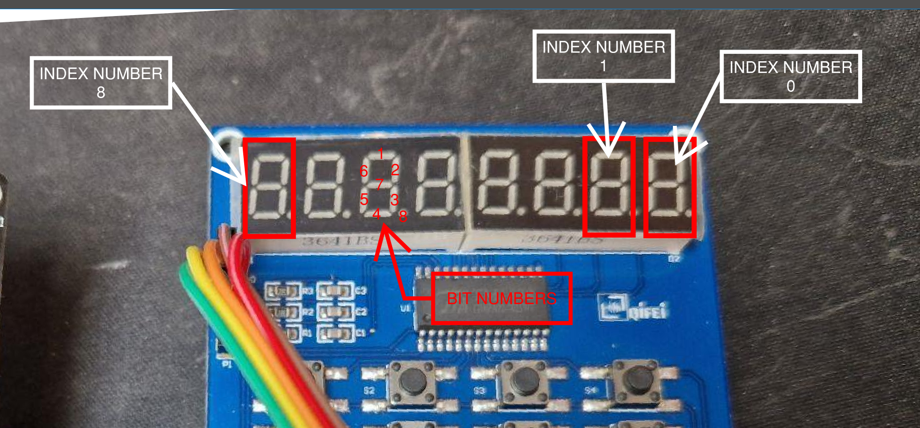

    @DeDaMrAz thank you. But I would like to clarify what to write in the setbit command.
    Why 9 1 1 what do these numbers mean? Where to look and read?
  • TMGN_SetBit syntax for 7-segment displays
    #49 21205196
    DeDaMrAz
    Posts: 620
    Help: 34
    Rate: 130
    @yuretskor

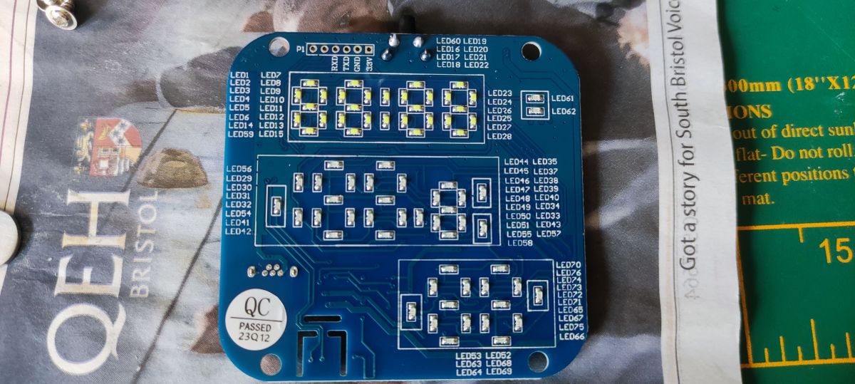

    In general those drivers can support multiple 7-segment display (some of them even keyboard matrixes) so it the particular example:
    TMGN_SetBit 9 1 1
    9 is index number for the display. remember multiple displays so 0-15 (I think, check the datasheet about the actual number it supports), next 1 is bit number of that display (all of them have 7 segments + a dot, so you are choosing what to control from 0-7) and last 1 is the actual value of that bit, so is that segment on or off = 1 or 0.
    Here is a picture for visual reference that I took some time ago while TMGN driver was created. Picture may not be 100% accurate but it'll do for reference (order may be reversed or segments starting from 0-7 etc.) It is from a TM1638 LED driver but you should get a good idea overall.
    Four 7-segment LED displays on a blue circuit board, with index and bit number labels.
    Also check the projects GitHub docs section and search for TMGN in there - https://github.com/openshwprojects/OpenBK7231T_App/blob/main/docs/commands.md
    Hope it helps.

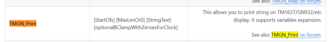

  • #53 21210107
    yuretskor
    Posts: 52
    please explain for the dumb that in the TMGN_Print command 7 2 means 7 and 2 if possible with an example. thanks
  • #54 21210176
    Posts: 14756
    Rate: 12883
    Fragment of documentation showing the syntax and description of the TMGN_Print function.
    TMGN_Print [StartOffset] [MaxLenOr0] [Text]
    So, if you want to display on the, let's say, position 3, you do: TMGN_Print 3 0 XY
    If you want to display at start position (first digit), you do: TMGN_Print 0 0 XYZW
    Etc etc

  • CHT8305 wiring found in the device: SDA uses CBU pin 4/P22, SCL uses CBU pin 3/P20, and the alert pin was not connected. [#20535581]
  • GN6932 wiring found in the device: DIN uses CBU pin 21/P15, CLK uses CBU pin 20/P17, and STB uses CBU pin 17/P28. [#20535534]
  • GN6932 supports an 8-segment × 16-bit display mode, 8 brightness duty-cycle levels, an RC oscillator at 450 kHz ±5%, and an SOP32 package. [#20535551]
  • A working display command sequence used LSB-first bytes: 40, then C0 ..., then 8F; decoding it MSB-first made the packet look wrong. [#20536000]
  • Build 701 added working CHT_Calibrate; the example CHT_Calibrate -2 10 applies −2 °C temperature and +10 %RH humidity offsets. [#20539841]
How do I configure the CHT8305 sensor pins on a Tuya CBU BK7321N/BK7231N USB thermostat in OpenBeken?
Configure CHT8305 as I2C on CBU P22 and P20. Set CHT pin 1, SDA, to CBU pin 4/P22. Set CHT pin 6, SCL, to CBU pin 3/P20. The alert pin was reported as not connected. The thread confirmed the CHT sensor worked after this wiring map. [#20535581]

How do I start and test the GN6932 display driver in OpenBeken using TMGN commands?
Start the GN6932 driver, then send a TMGN test or print command. Use this 3-step check:
  1. Run startDriver GN6932.
  2. Run GN6932_TestAddressIncreaseMode to light random segments.
  3. Run TMGN_Brightness 7 and TMGN_Print 0 0 123456 to test output. Build 680 already showed changing patterns with the test command. [#20536357]
Why does OpenBeken say “Driver GN6932 is not known in this build” and how do I enable it?
OpenBeken says this when the build excludes the rarely used GN6932/TMGN driver. Newer builds disabled it to reduce flash usage and avoid LittleFS OTA problems. Enable it by compiling with #define ENABLE_DRIVER_TMGN 1 in obk_config.h. A custom build or pull-request build can also include it. [#20979746]
How can I create an autoexec.bat script to show temperature, humidity, and time on the GN6932 LED display?
Create autoexec.bat with GN6932, NTP, brightness, static bits, and a loop. The working example starts GN6932, starts NTP, sets timezone +2:00, prints minutes at offset 7, hours at offset 5, temperature at offset 2, and humidity at offset 0. It also blinks the clock colon by toggling bits 10:0 and 10:1 every 1 second. [#20537716]
What do the numbers mean in the OpenBeken command TMGN_Print 7 2 $minute 1?
7 is the start offset, and 2 is the maximum length. TMGN_Print uses the format TMGN_Print [StartOffset] [MaxLenOr0] [Text]. So TMGN_Print 7 2 $minute 1 prints the two-digit minute value starting at display position 7, with zero padding enabled by the final 1. [#21210176]
How does TMGN_SetBit work for controlling individual LED display segments on TM1637, TM1638, or GN6932 displays?
TMGN_SetBit 9 1 1 means display index 9, bit 1, value on. The first number selects a display byte or digit index, usually within 0–15. The second number selects one of 8 bits, matching 7 segments plus dot. The third number sets that segment off or on, using 0 or 1. [#21205196]
How do I calibrate CHT8305 temperature and humidity readings in OpenBeken with CHT_Calibrate?
Use CHT_Calibrate [temperature offset] [humidity offset] after starting the sensor driver. Build 701 confirmed CHT_Calibrate -2 10 worked. That example subtracts 2 °C from temperature and adds 10 %RH to humidity. Earlier SHT_Calibrate and SHT3X_Calibrate commands failed on CHT8305 because they targeted other drivers. [#20539841]
CHT8305 vs CHT8310: what are the differences and which sensor is used in newer versions of this USB thermostat?
Original units used CHT8305, while newer tested units used CHT8310. The newer board otherwise looked identical in the thread. An older OpenBeken build with GN6932 support lacked newer CHT8310 support, so readings became incorrect. The reported GUI value reached −265 while the LED showed a divided-by-10 temperature figure. [#20980349]
How can I set a static IP address for an OpenBeken device while it is still in AP mode?
Set the static IP from the OpenBeken configuration page while the device runs in AP mode. Choose an address that is unique on your target network. This solves the case where you can join Wi-Fi but cannot access the router page to discover the DHCP address. [#20629101]

Why might a GN6932 display show humidity and temperature in the wrong positions, and how can channel mapping or TMGN_Map fix it?
The display can show values in wrong positions when channel order or digit mapping does not match the physical grid. One user had to set CHT SDA channels as 1:0 because temperature appeared on the humidity line. For TM1637 mapping issues, the maintainer advised using TMGN_Map instead of TMGN_SetBit. [#20980349]
