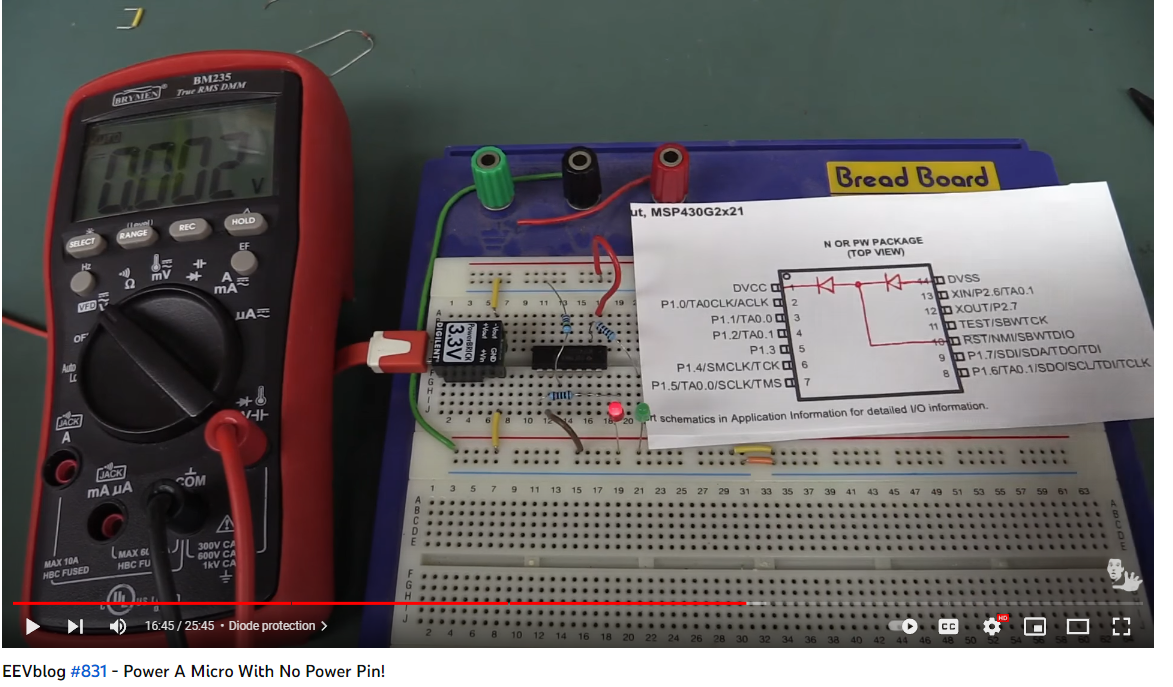

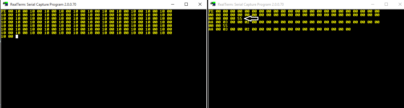

    This is not what I expected. It turns out that I communicate with the TuyaMCU chip without the need to power the board.
    The connections are:
    Tx --> Tx
    Rx --> Rx
    GND --> GND
    CEN --> GND
    Motion sensor with BK7231N and TuyaMCU battery powered devices protocol
  • Invalid TuyaMCU reply packet identified
    #92 20524399
    Posts: 14811
    Rate: 12977
    It is actually normal. This is because MCU GPIO has clamping diodes to VDD and GND and the voltage drop on diode gives still enough voltage left to power MCU.
    See:
    Source: https://www.youtube.com/watch?v=2yFh7Vv0Paw&ab_channel=EEVblog

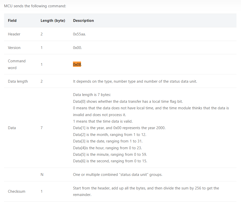

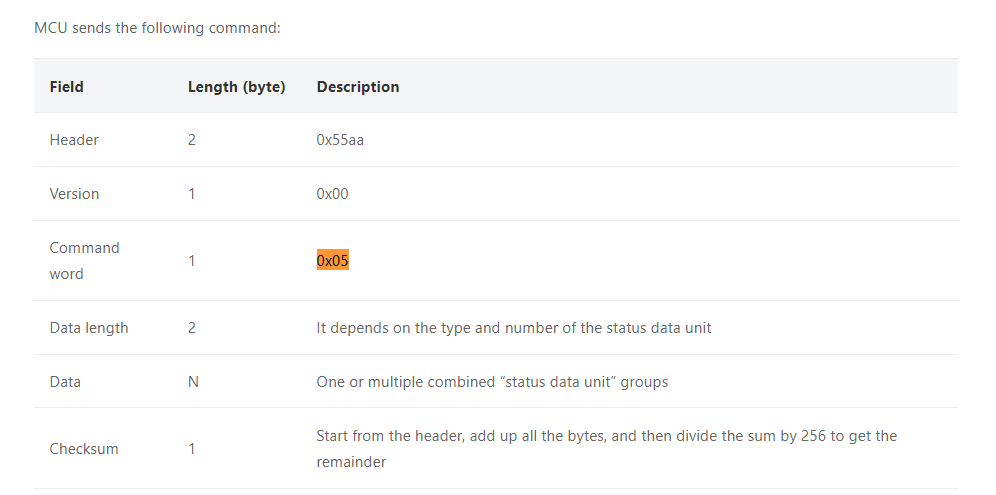

    As far as I know, there are two ways that sensors can report data.
    - they can report it with timestamp:
    - or they can report without time:
    Source: https://developer.tuya.com/en/docs/iot/tuyacl...niversalserialaccessprotocol?id=K95afs9h4tjjh
    So you are most likely correct that we have invalid reply for that packet. Let me fix it and we will try again.

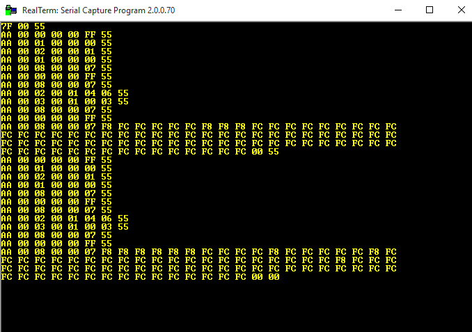

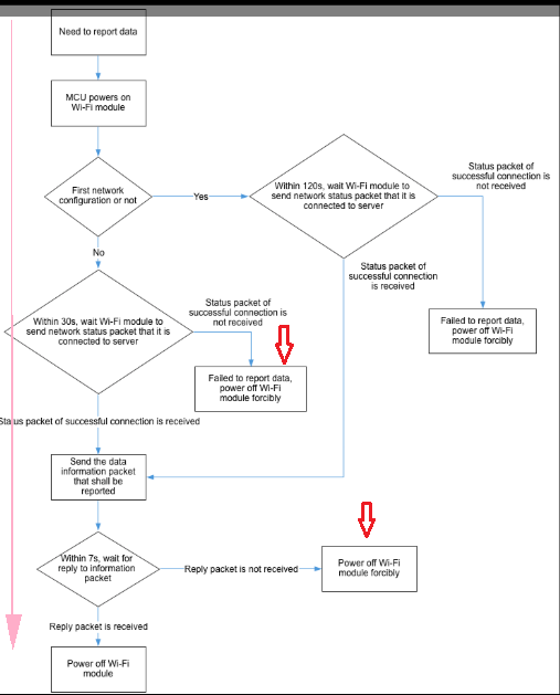

    I think it may be possible that our system sends wrong 55 AA 00 08 00 00 07 packets which confuse TuyaMCU, because they should be send only in non-battery powered devices.
    spin55 wrote:
    Tx:
    55 AA 00 00 00 00 FF
    55 AA 00 01 00 00 00
    55 AA 00 02 00 00 01
    55 AA 00 02 00 01 04 06
    55 AA 00 03 00 01 00 03
    Rx:
    55 AA 00 00 00 01 00 00
    55 AA 00 01 00 24 7B 22 70 22 3A 22 6C 79 64 77 6F 62 77 79 71 78 69 79 6F
    62 39 68 22 2C 22 76 22 3A 22 31 2E 30 2E 35 22 7D 62
    55 AA 00 05 00 05 01 04 00 01 01 10
    55 AA 00 05 00 08 04 02 00 04 00 00 00 64 7A

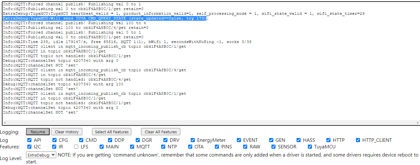

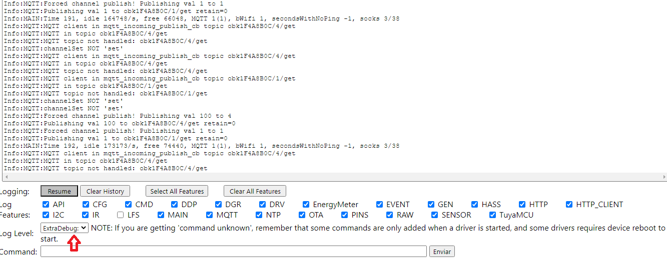

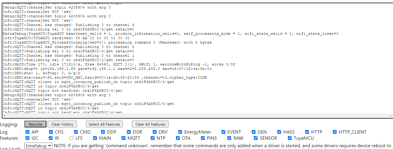

    If you enable extra debug log, what do you get in UART log?
    Do you get:
    Will send TUYA_CMD_QUERY_STATE (state_updated==false, try %i)

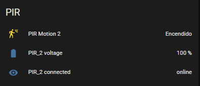

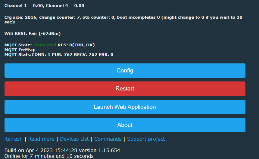

  • #95 20524597
    spin55
    Posts: 209
    Help: 17
    Rate: 42
    Are you referring to this?
    Added after 22 [minutes]:
    This confirms that the communication with HA is correct, but because I force it to go into AP mode to start and maintain the connection:
  • #96 20524774
    Posts: 14811
    Rate: 12977

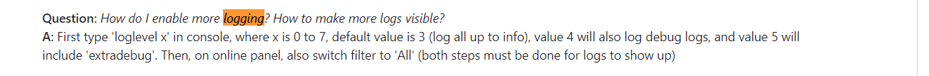

    Yes, this, but also use console command to set log level.

  • Tx channel no longer receives command 08
    #103 20525004
    spin55
    Posts: 209
    Help: 17
    Rate: 42
    Still the same. The Tx channel has changed and no longer receives command 08. And the message from before does not appear in the Log.
    Tx:
    Rx:
    Log:
    Added after 8 [minutes]:
  • #104 20525180
    Posts: 14811
    Rate: 12977
    spin55 wrote:
    Rx:
    Please post logs as text... but I retyped and it looks like it's still rebooting quickly? After 10 or so seconds? So WiFi doesn't have time to connect well?
    I see it sends dpIDs:
  • Device is rebooting before Wi-Fi can connect

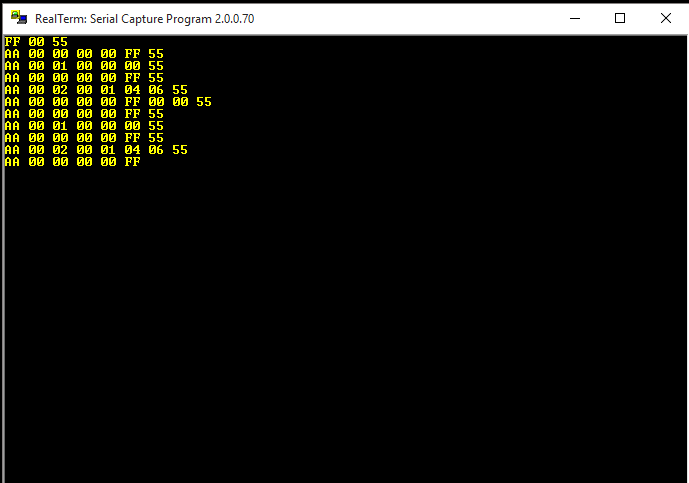

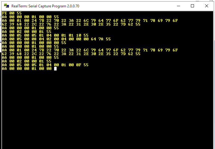

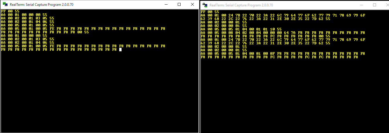

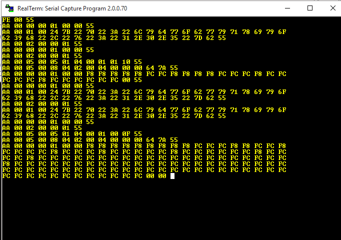

    #106 20533304
    spin55
    Posts: 209
    Help: 17
    Rate: 42
    Today I received another pir motion. I have paired it with Smart Life App.
    Simultaneous capture of both Tx and Rx channels with RealTerm:
    Canal Tx:
    55 AA 00 01 00 00 00 (Query product information)
    55 AA 00 02 00 01 03 05 (Report the network status) (Wi-Fi has been configured, and connected to the router)
    55 AA 00 02 00 01 04 06 (Report the network status) (Wi-Fi has been connected to the router and the cloud)
    55 AA 00 05 00 01 00 05 (Ack)
    Canal Rx:
    62 39 68 22 2C 22 76 22 3A 22 31 2E 30 2E 35 22 7D 62 (Ack)
    55 AA 00 02 00 00 01 (Ack)
    55 AA 00 05 00 05 01 04 00 01 01 10 (Report the real-time status) (sensor status)
    55 AA 00 05 00 08 04 02 00 04 00 00 00 64 7A (Report the real-time status) (battery status)

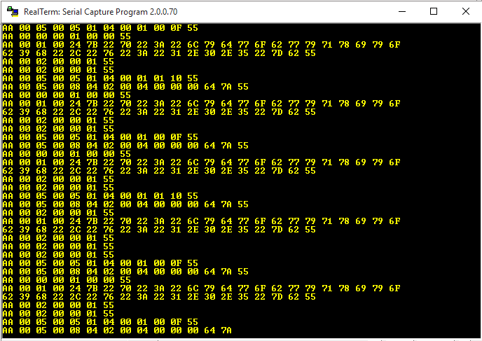

    When it detects motion, the only thing that changes is:
    55 AA 00 05 00 05 01 04 00 01 00 0F
    There is a reset time of approximately 2 minutes. During this interval it does not detect movement.
    At the moment I don't flash it in case some test needs to be done.
    Regards
    NEO4_T..txt (5.65 kB)You must be logged in to download this attachment. NEO4_R..txt (5.88 kB)You must be logged in to download this attachment.

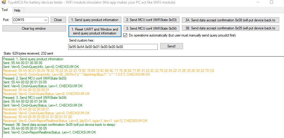

  • TuyaMCU pairing and confirmation packet differences

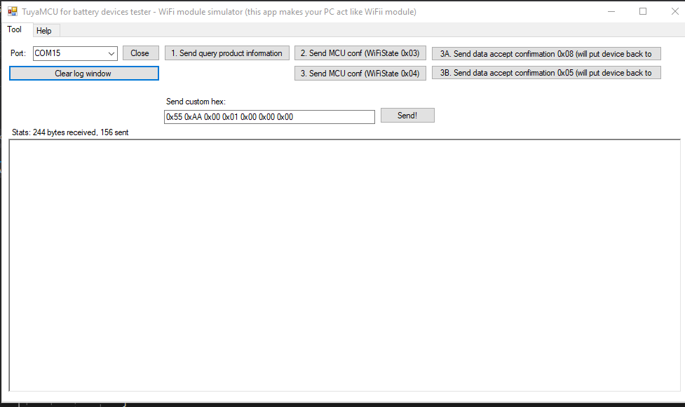

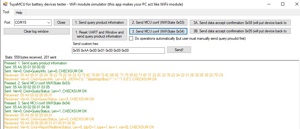

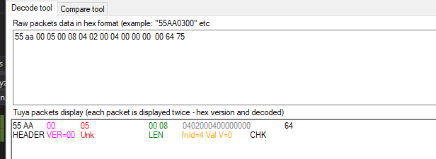

    #113 20535974
    Posts: 14811
    Rate: 12977

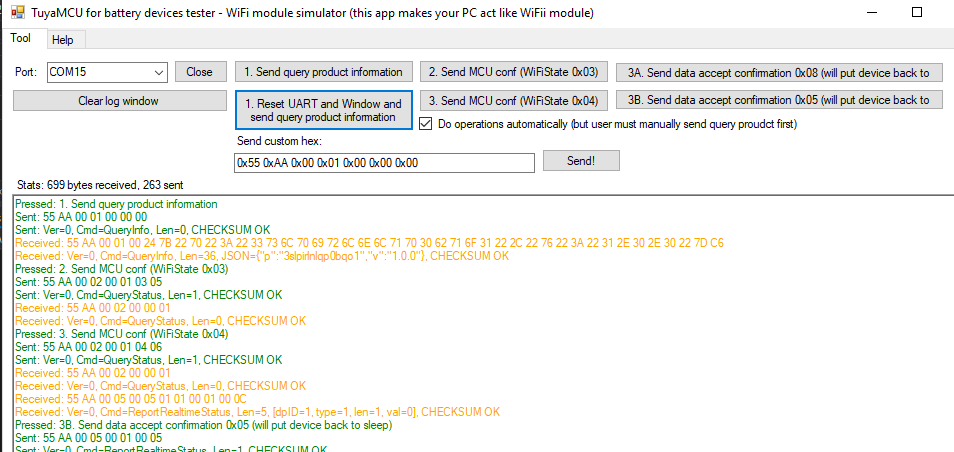

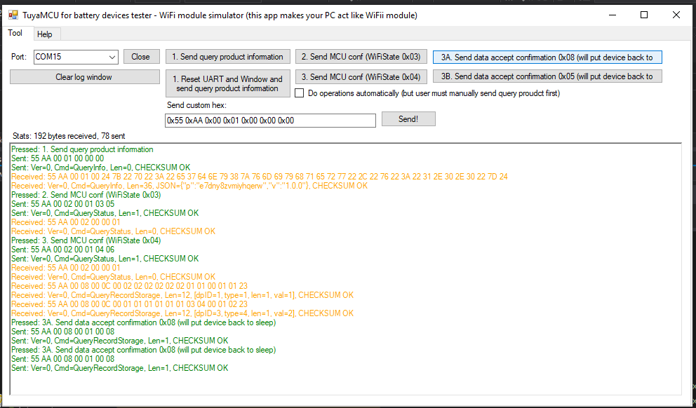

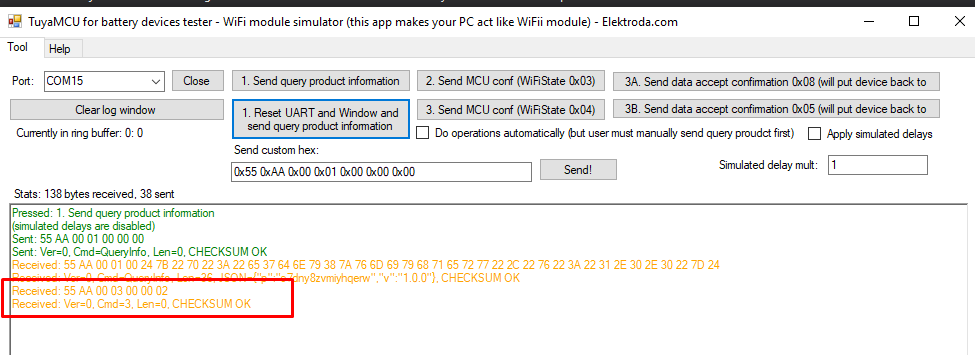

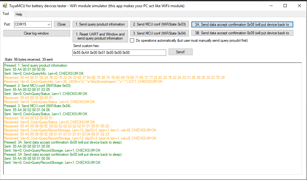

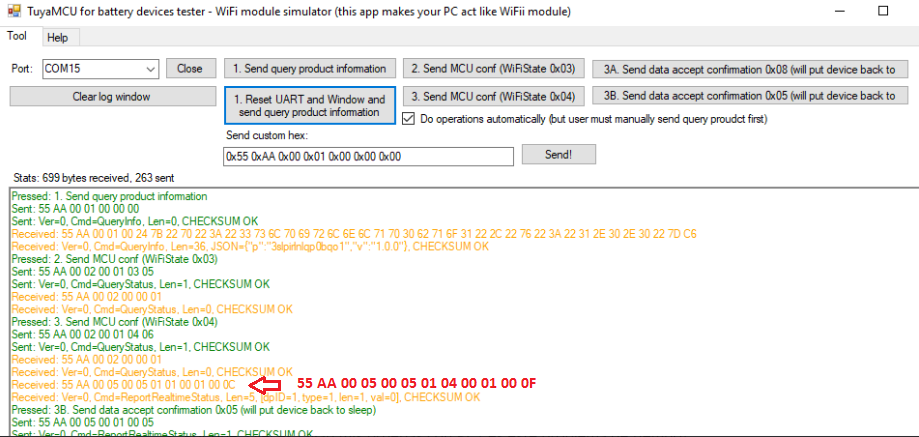

    So to sum it up, we have following conclusions:
    1. OBK was sending extra data from vanilla TuyaMCU driver, which is now disabled
    2. OBK was always sending the same confirmation type, but for 0x08 we have to respond with 0x08 confirmation and for 0x05 with 0x05
    3. your device first report "connected to router" and then separately "connected to cloud", while OBK immediately reported "connected to cloud"
    I will add this to my tool and then we can check:
    Code: C#
    Here's how GUI looks:
    I am testing on my devices, but I still to seem have problem with one device. Maybe MCU thinks it's not paired. Can you give a packets dump what happens when you press a pair button?
    Or maybe I am too slow with clicking....
    Here's a successful transaction (I simulated closing of door sensor):
    Here, just a moment later, I simulated opening:
    The door sensor used for testing:
    Here is the second sensor used for testing. Let's simulate closing the door:
    It behaves strangely. It done Received: Ver=0, Cmd=ReportRealtimeStatus, Len=5, [dpID=1, type=1, len=1, val=0], CHECKSUM OK and powered off without waiting for me to reply.
    But... if I use the automatic mode.... i got it right?
    another try:
    So the open questions are:
    - if the door sensor is already paired and we press the button, how does the button tells WiFI module that we want to re-pair it?
    - do we really need to first report wifi state 0x03 and then 0x04, or just only we can report 0x04 and it's all?
    - why sometimes my tests with PC fail? is this timing issue?
    I need few hours more.
    Added after 31 [minutes]:
    WAIT, sorry, it seems I solved one more issue! More information soon
    Added after 48 [minutes]:
    It seems to work now in a stable way. I am attaching my PC tester program. OBK update is still TODO.
    • BatteryPoweredTuyaMCUDemo20230412.zip (22.71 KB) You must be logged in to download this attachment.
  • AP mode triggers command 03 and may require re-pairing
    I just connected pir motion and see this in Realterm. Simultaneous captures of Tx and Rx channels (Tx->Left Rx->Right):
    The command 03 that I point to with the arrow appears when I switch it to AP mode following these instructions:

  • Long press sends 0x03 enter pairing mode command
    #115 20536251
    Posts: 14811
    Rate: 12977
    you are very helpful, thank you, let me check.
    spin55 wrote:
    How to reset?
    (1) Press the reset button for 6 seconds till the indicator flash rapidly. The device turns to Smart Wi-Fi mode.
    (2) Press the reset button again for 6 seconds till the indicator flash slowly. The device turns to AP mode.
    I only checked short press for button. Let me check long press now. Short press was only waking up device, no pairing.
    Added after 1 [hours] 17 [minutes]:
    I can confirm that I get 0x03 command on long press:
    so this:
    Received: 55 AA 00 03 00 00 02
    means "enter pairing mode"

  • Measured 15-second Wi-Fi timeout before TuyaMCU sleep
    #119 20542916
    spin55
    Posts: 209
    Help: 17
    Rate: 42
    According to the diagram, TuyaMCU keeps the wifi module ON for a minimum of 30 seconds under any circumstances. But I have verified that it does not keep it active for more than 15 seconds. Measuring with a multimeter on the CEN pin of BK7321N and placing a led diode for visual verification.
    This time is extended up to 37 seconds if the Wi-Fi module notifies that it is connected to the router and cloud.
    Any firmware to try?
    Regards
  • Version 00 and 03 Tuya protocol differ significantly
    #120 20545046
    spin55
    Posts: 209
    Help: 17
    Rate: 42
    Firmware version OpenBK7231N_QIO_1.15.631.bin does not work well. I'm back to 592. And from what I've seen there are very significant differences between versions 03 and 00 of the Tuya protocol.
    Command format in version 03:
    WiFi module: 55 AA 00 .......
    MCU: 55 AA 03 ......
    Command format in version 00:
    MCU: 55 AA 00 ......
    What we see in the captures:
    WiFi module --> Tx
    55 AA 00 00 00 00 FF -> Valid but unnecessary because module Sleeping
    55 AA 00 01 00 00 00 -> Ok
    55 AA 00 02 00 00 01 -> Version 03
    55 AA 00 01 00 00 00 -> Redundant. No need to send it again
    55 AA 00 08 00 00 07 -> Version 03
    55 AA 00 02 00 01 04 06 -> Ok
    55 AA 00 03 00 01 00 03 -> Version 03
    It seems that you have started from the commands of version 03 and have adapted them by setting the version to 00 and correcting the checksum, but this does not seem correct because the protocols are different. The same command number does not always do the same in both versions, nor are they sent and received in the same way.
    For example, the 08 command of version 03 has a format similar to that of version 00 but in version 03 it is sent by the WiFi module and is asynchronous (it does not need an immediate response), and in version 00 it is sent by the MCU and the reply of the WiFi module is different: 55 AA 00 08 00 01 00 08.
    Another example, in version 03 the 03 command sent by the module is:
    Report network status: 55 aa 00 03 00 01 04 07
    MCU reply: 55 aa 03 03 00 00 05
    But in version 00 it is:
    Report network status: 55 aa 00 02 00 01 04 06
    MCU reply: 55 aa 00 02 00 00 01
    If Report network status - MCU reply: 55 aa 03 03 00 00 05 passes it to version 00, it would be: 55 aa 00 03 00 00 02, which is Reset Wi-Fi - MCU send in version 00.
    It is a different command. And there are more commands that are also different.
