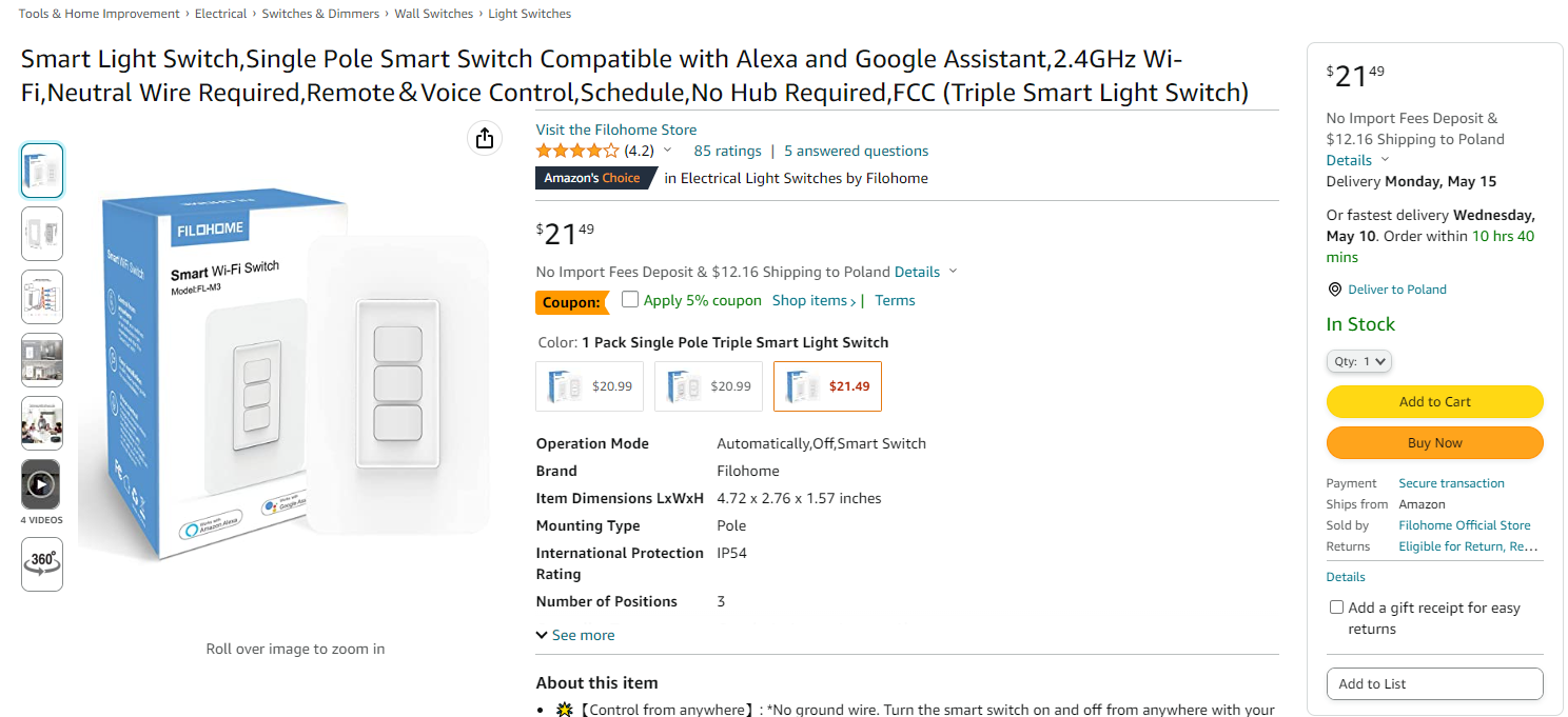

    Filohome FL-M3 is a 3 gang light switch based on Tuya CB3S module with BK7231N chip. It can be easily freed from the cloud and paired with Home Assistant by changing firmware to OpenBeken. This device has no TuyaMCU, so you can also script advanced button events on that and use double click, etc, to fire custom scripts. Here are some device details and device template.
    Device information was submitted by our Github user. Thank you for sharing!
    Filohome can be bought on Amazon or on other places around the web:
    [BK7231N/CB3S] Filohome FL-M3 3 gang Smart Switch template/flashing guide
    It comes in 1-gang, 2-gang and 3-gang versions.

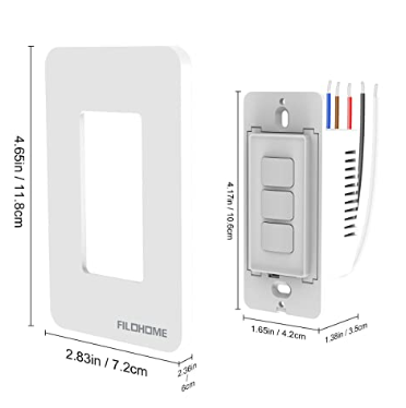

    Here are the dimensions:

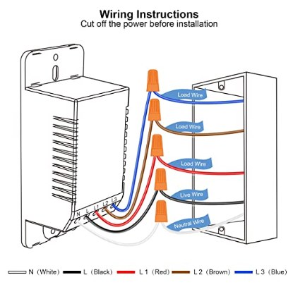

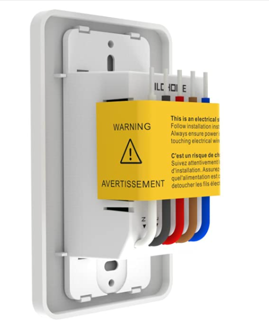

    Wiring instruction:

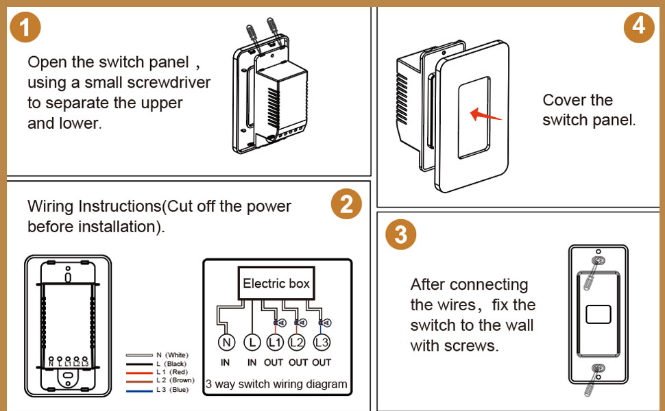

    Manual:
