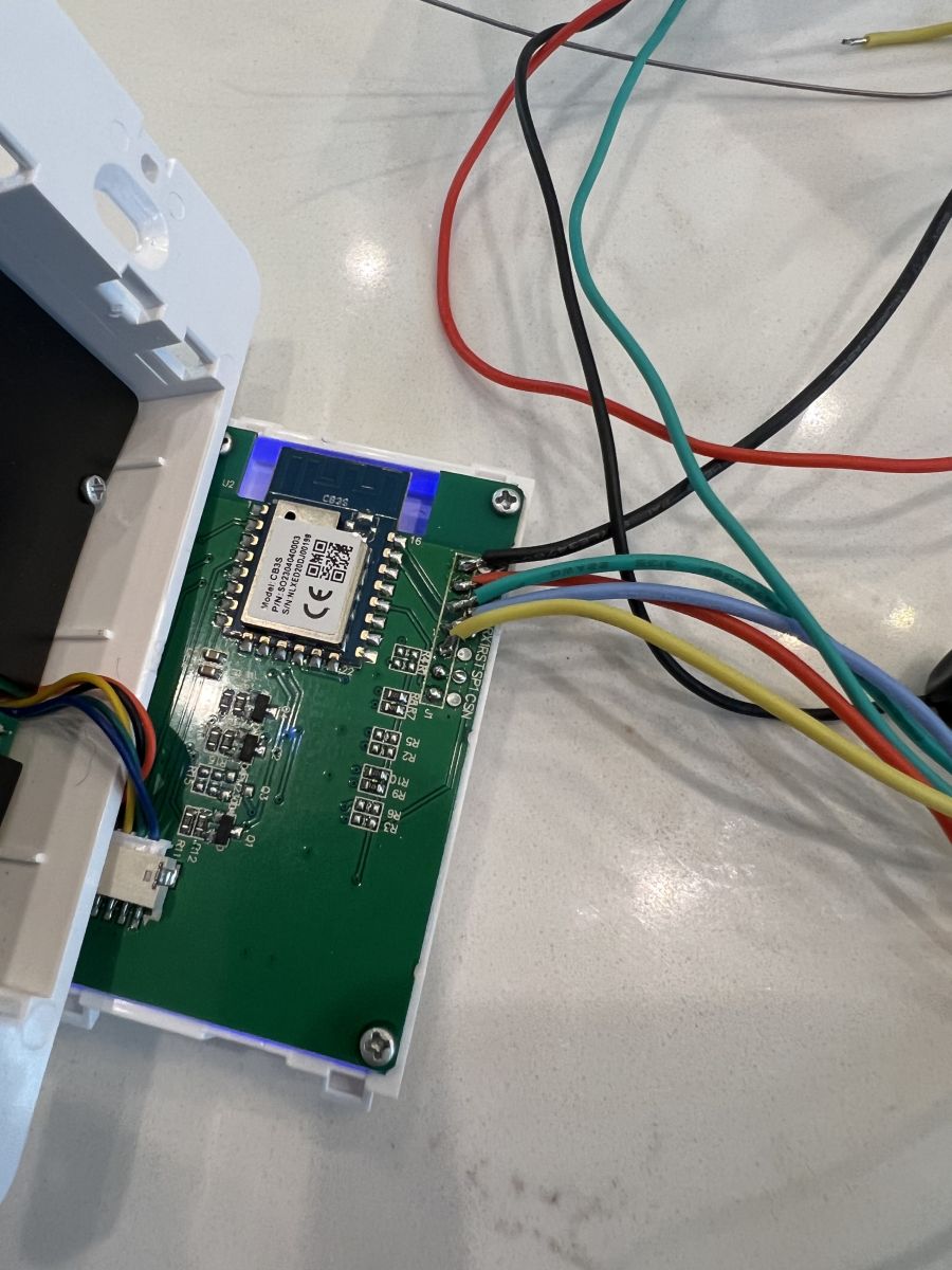

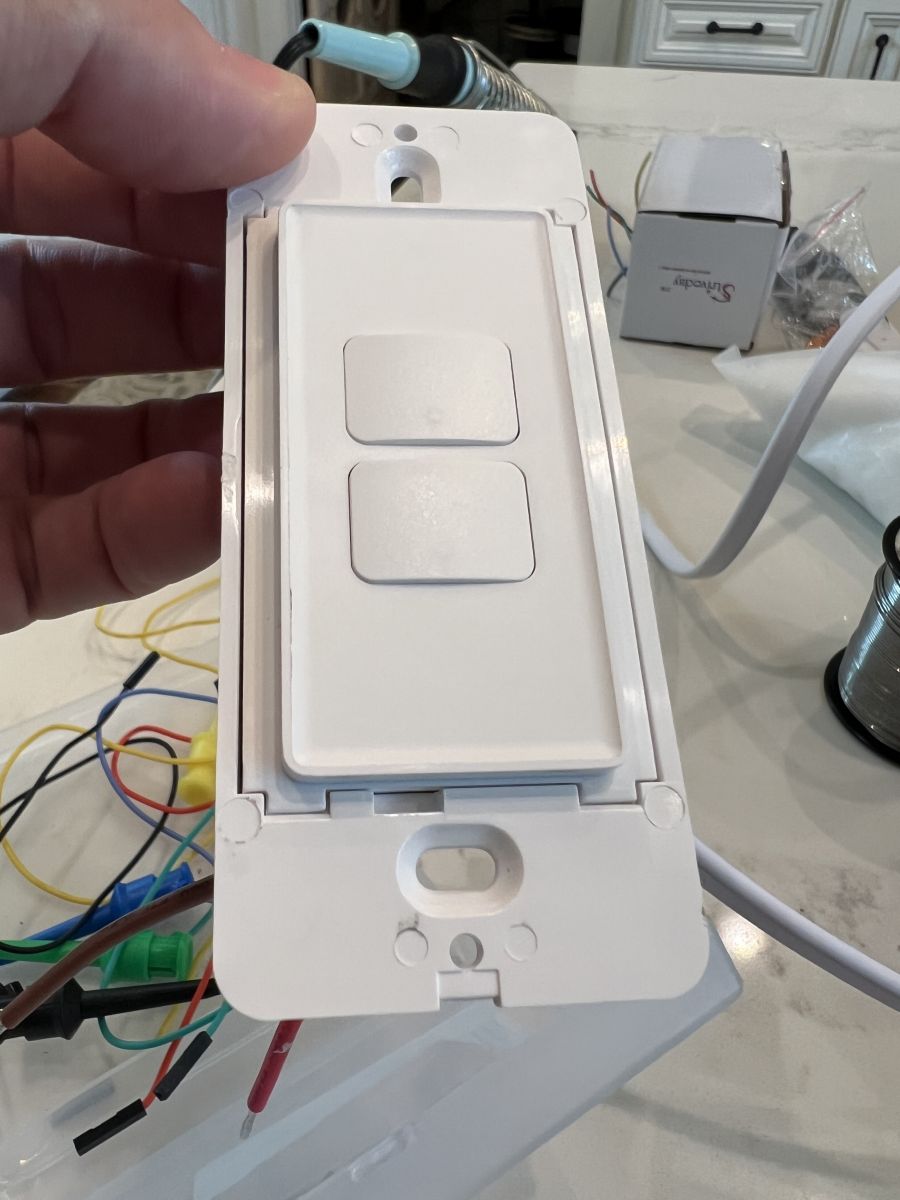

    Doing a 2 switch version as the three switch has different setup.

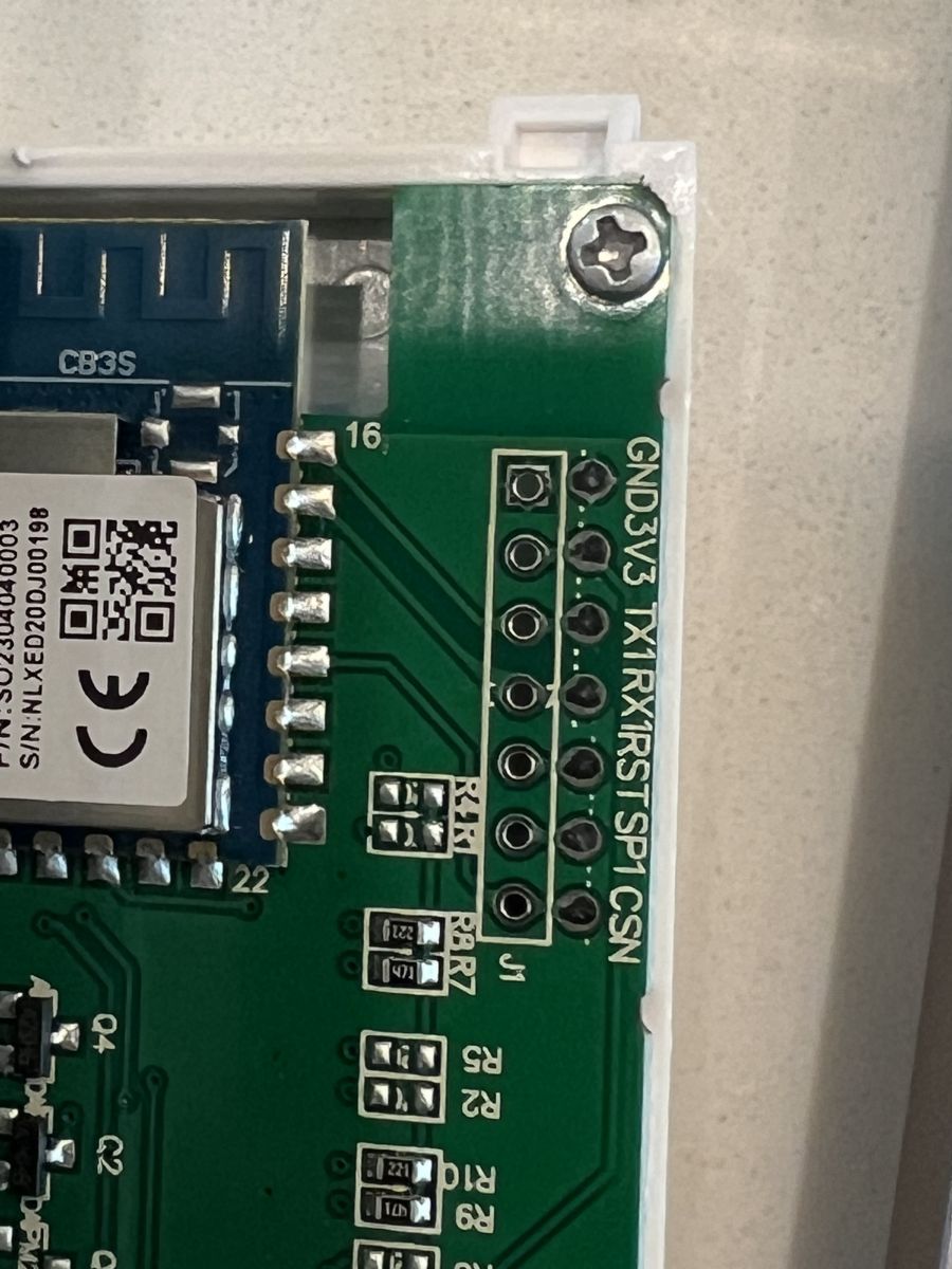

    Pry open the face with a small screwdriver or small knife edge. Pins for debugging are on the right edge of the board.
    Module Model CB3S
    Wire it up and get to flashing

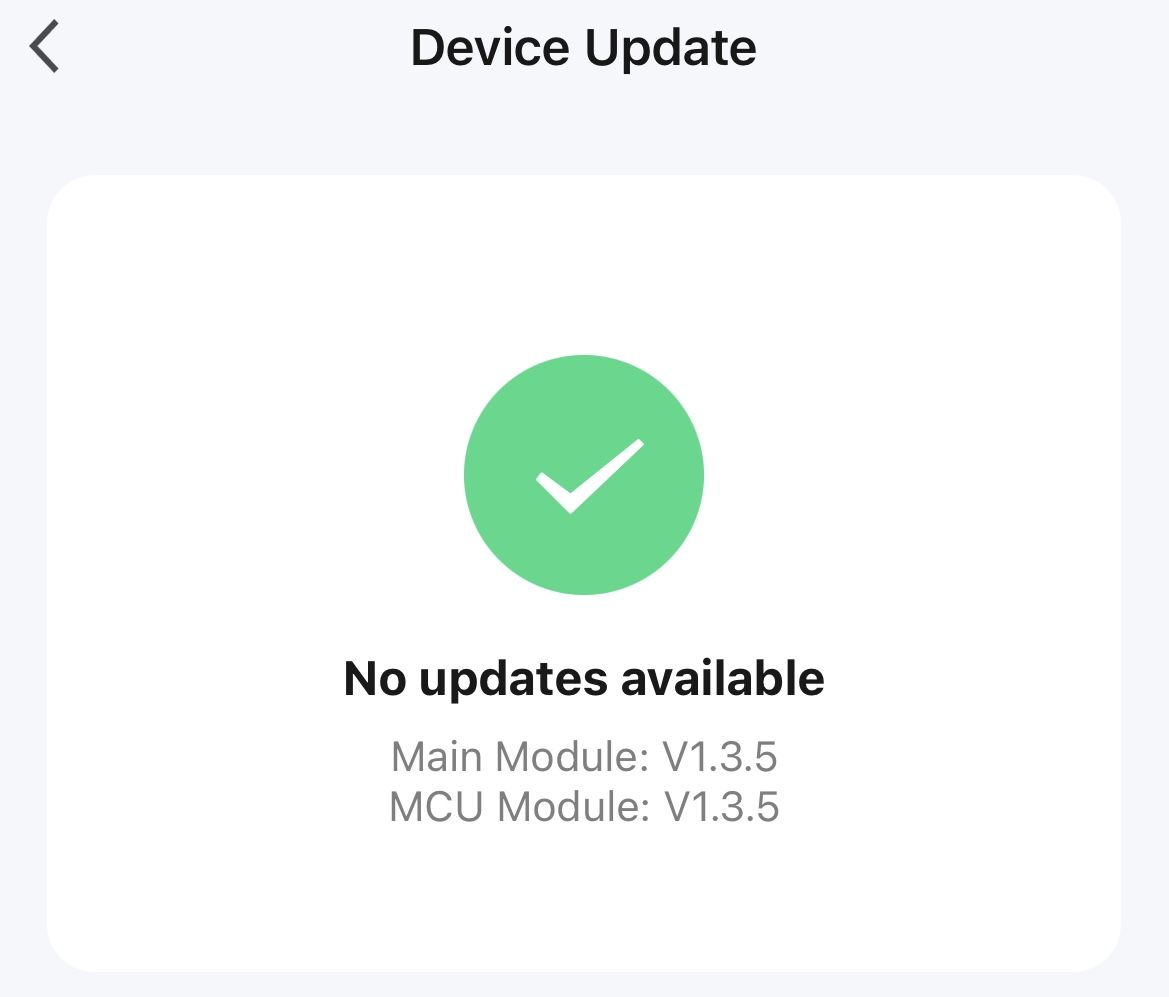

    I am having trouble writing openbk OTA and through serial.
    OTA using cloud cutter I get an exploit didn’t work error. Tuya shows the module on firmware version 1.3.5

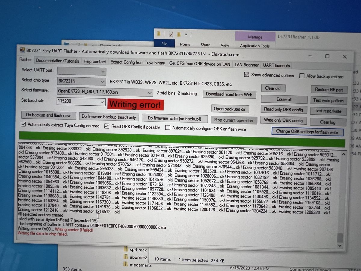

    Serial I get a write error [CB3S/BK7231N] Filohome Smart WiFi FL-M2: Two-Switch Version, template, configuration [CB3S/BK7231N] Filohome Smart WiFi FL-M2: Two-Switch Version, template, configuration
    Added after 6 [minutes]:
    Just realized looking at my screenshot I have the wrong firmware selected for write. If you use the UART it should work.
