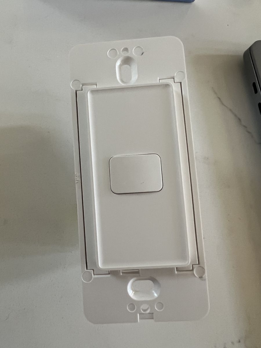

    Insert small tool into the slot on the face and pry it open.

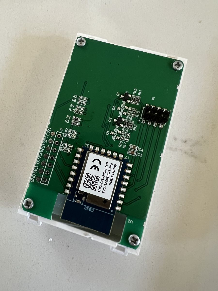

    *Note there is a pin header on this model compared to jumper cable on the others.
    Pin header on the side of the board
    Disassembling and Configuring Filohome FL-M1 Smart Wifi Switch: Differences from FL-M2, FL-M3

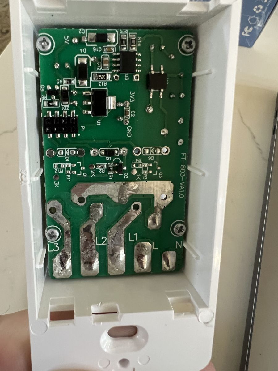

    This single switch has the same base board as the other units with provisions for L2 and L3.

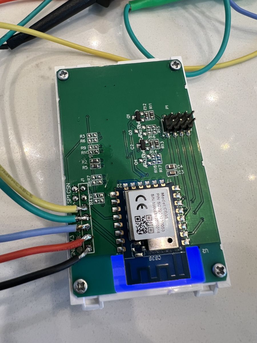

    Wire it up and get to flashing
    - Button (channel 1) on P24
    - LED (channel 1) on P10
    - WiFi LED on P6
    - Relay (channel 1) on P9
    Device seems to be using CB3S module, which is using BK7231N.

    Very nice device, at least that one has two LEDs decoupled from the relay, which makes it more configurable than some other devices where the LED is on the same GPIO as the relay.
