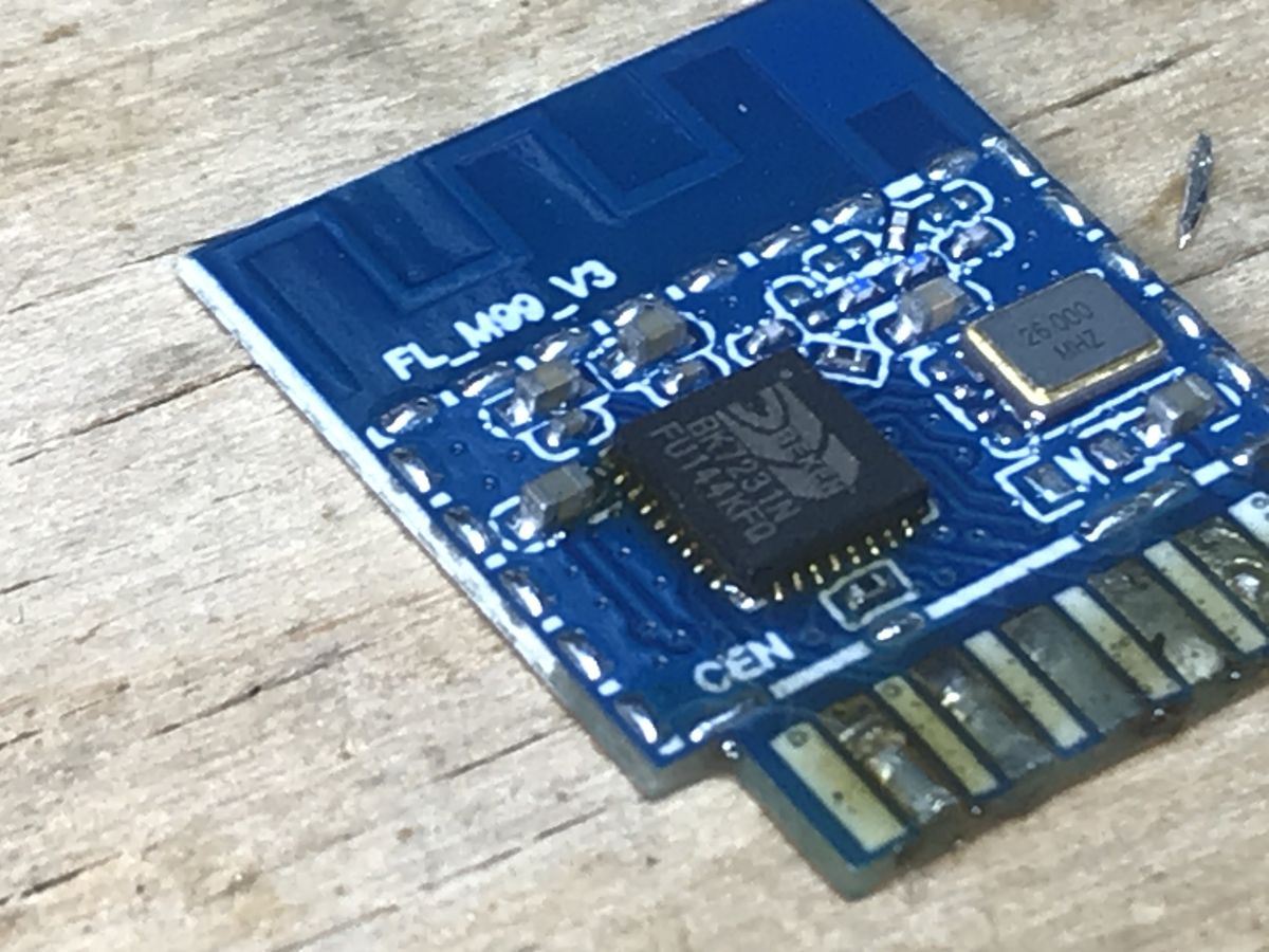

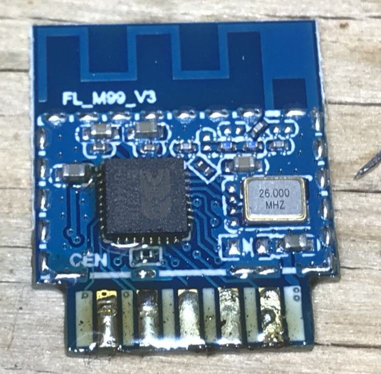

  • FL_M99_V3 module with a microcontroller on a blue PCB marked with 26.000 MHz.

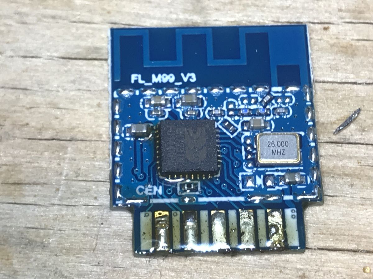

    Some of new Tuya IoT devices are based on FL_M99_V1/FL_M99_V2/FL_M99_V3 modules, which are using BK7231N/BL2028N WiFi 2.4GHz + Bluetooth microcontroller. They can be flashed with OpenBeken, which will provide basic Tasmota compatibility and Home Assistant features. Here's a basic FL_M99 pinout and flashing guide.
    There have been already multiple reports of similiar modules on our forum, including:
    - mini smart switch - Belon BL2028N
    - Aubess 2gang Mini Smart Switch BK7231N /CB2S
    I have also received recently a WiFi smart switch based on FL_M99_V1, here is this module photo:
    FL_M99_V3 IoT module on a wooden background Close-up of FL_M99_V3 module with BK7231N microcontroller. FL_M99_V1 electronic module with visible pins on a white casing.

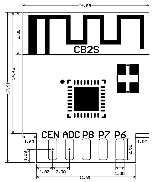

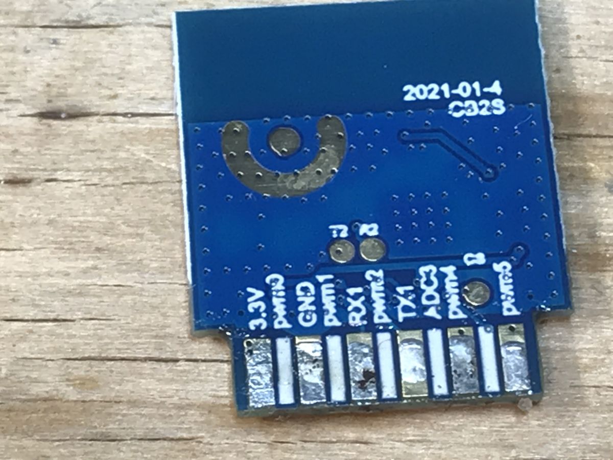

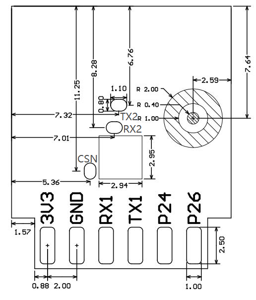

    Module pinout seems to match CB2S:
    Technical drawing of the CB2S module with pin labels and dimensions.
    Diagram of the FL_M99 module pin layout.
    Pin numberSymbolI/O typeFunction
    13V3PPower supply 3V3
    2P6I/OSupport hardware PWM and correspond to P6 of the IC
    3GNDPPower supply reference ground
    4P7I/OSupport hardware PWM and correspond to P7 of the IC
    5RX1I/OUART_RX1, which is used for receiving user data and corresponds to P10 of the IC. Do not pull it up. By default, the MCU serial port should be in low-level or high-impedance state.
    6P8I/OSupport hardware PWM and correspond to P8 of the IC
    7TX1I/OUART_TX1, which is used for transmitting user data and corresponds to P11 of the IC. Do not pull it up. By default, the MCU serial port should be in low-level or high-impedance state.
    8ADCI/OADC, which corresponds to P23 of the IC
    9P24I/OSupport hardware PWM and correspond to P24 of the IC
    10CENI/OReset pin
    11P26I/OSupport hardware PWM and correspond to P26 of the IC
    Test pointRX2I/OUART_RX2, which corresponds to P1 of the IC. This pin is not allowed to use.
    Test pointTX2I/OUART_TX2, which is used for outputting logs and corresponds to P0 of the IC
    Test pointCSNI/OMode selection pin. If it is connected to the ground before being powered on, enter the firmware test mode. If it is not connected or connected to VCC before being powered on, enter the firmware application mode. It corresponds to P21 of the IC.
    Availability of 5 PWM outputs makes this module suitable for RGBCW lighting, extra ADC pin can be also used for light sensor.

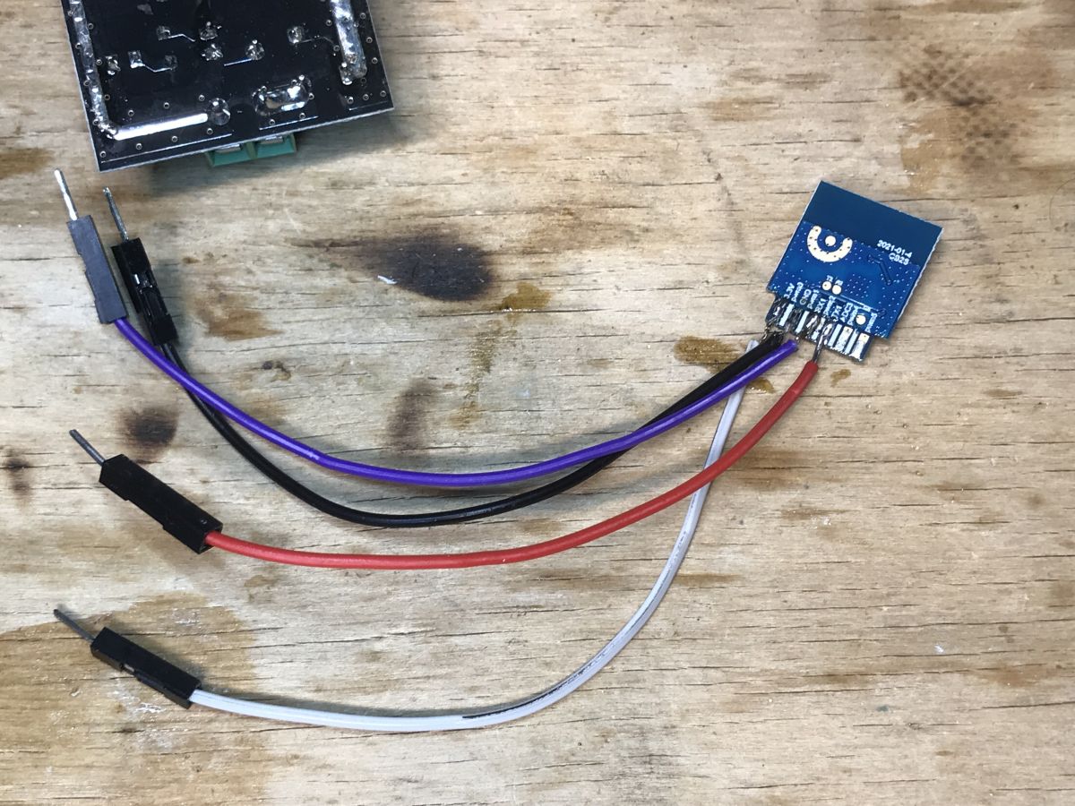

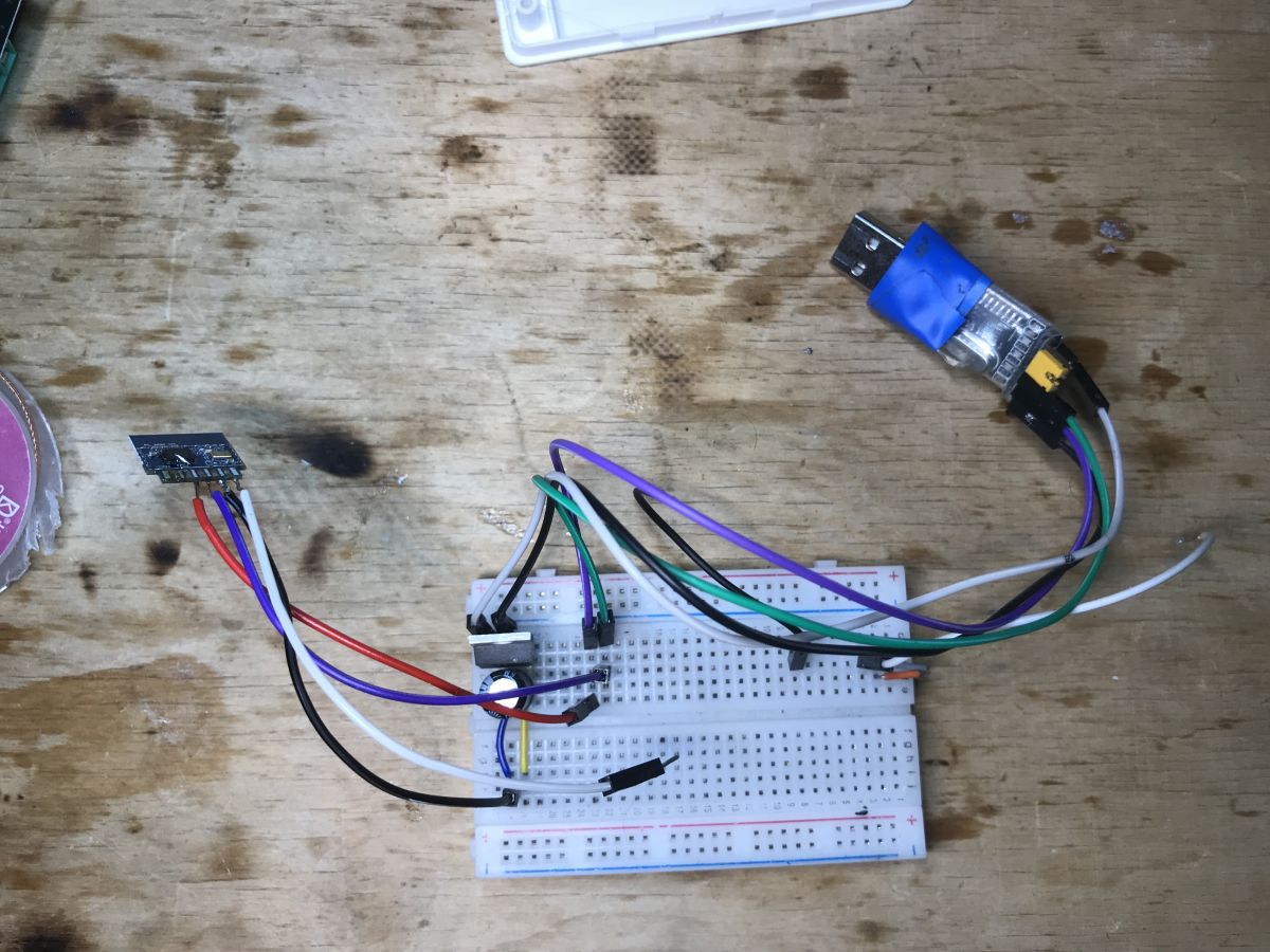

    How to flash FL_M99_V1/FL_M99_V2/FL_M99_V3?
    Flash it like CB2S, either in circuit, or desolder it from the board.
    You can use our BK7231 flasher for that:
    You can watch our old (hid_download_py) and new (BK7231tool flasher) guides:
    I am usually just desoldering the module, here is my setup:
    FL_M99 module connected to a breadboard with wires and a USB adapter. Orange FL_M99 module with attached wires on a wooden surface.
    I do not solder CEN, I just do power on/off cycle by disconnecting and reconnecting 3.3V wire.
