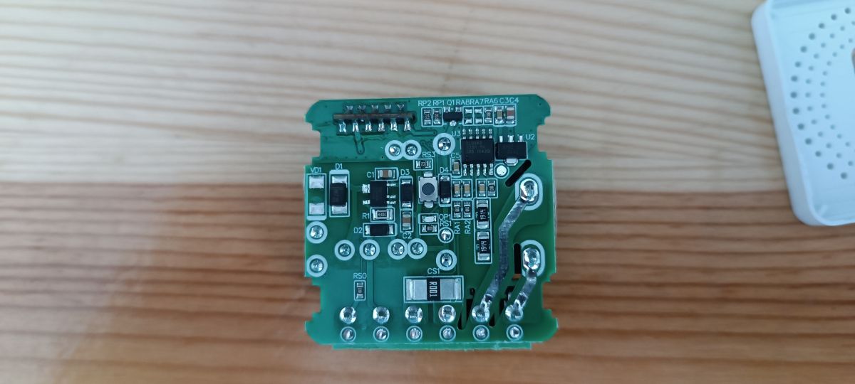

    I would say it's the same as erlipan2001 posted.
    I can provide the original firmware. But I'm really new to this topic and not an electrician guy. So I need more assistance. I don't have a USB/UART Adapter. But I have a raspberry. Is that enough to extract the firmware?
    Or is there anyone related to Germany? That I can send some device per parcel? :)

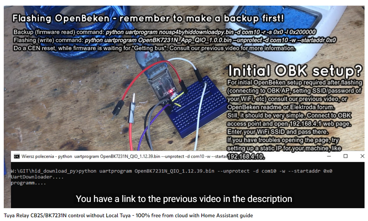

    Doing firmware backup is the same as reading.
    Just use this tool (bkWriter 1.60 is obsolete):
    use "Read firmware backup" button
  • #35 20590165

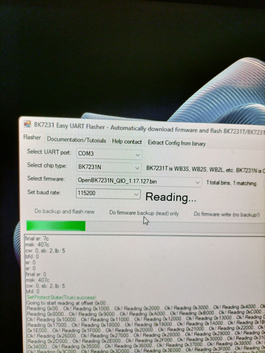

    ttp1106
    Posts: 9
    Just use this tool

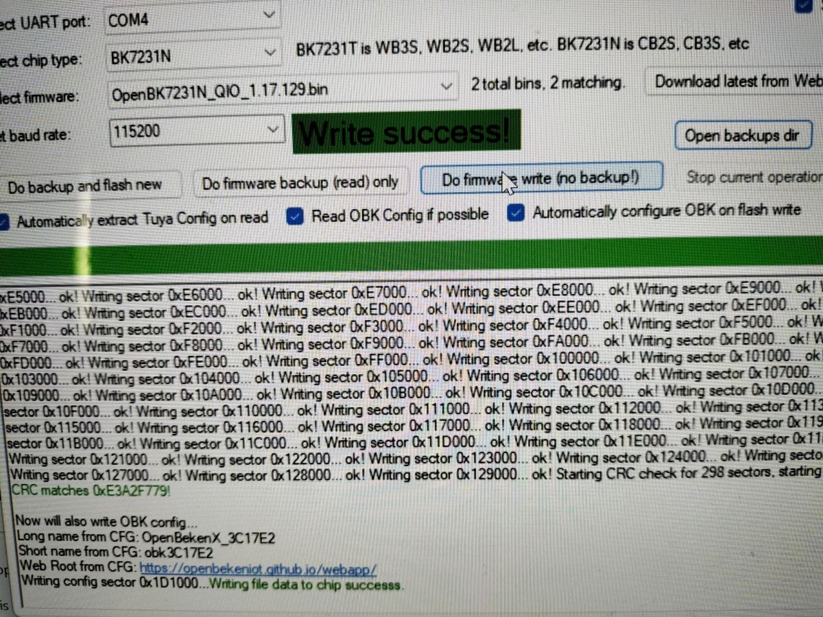

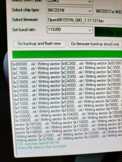

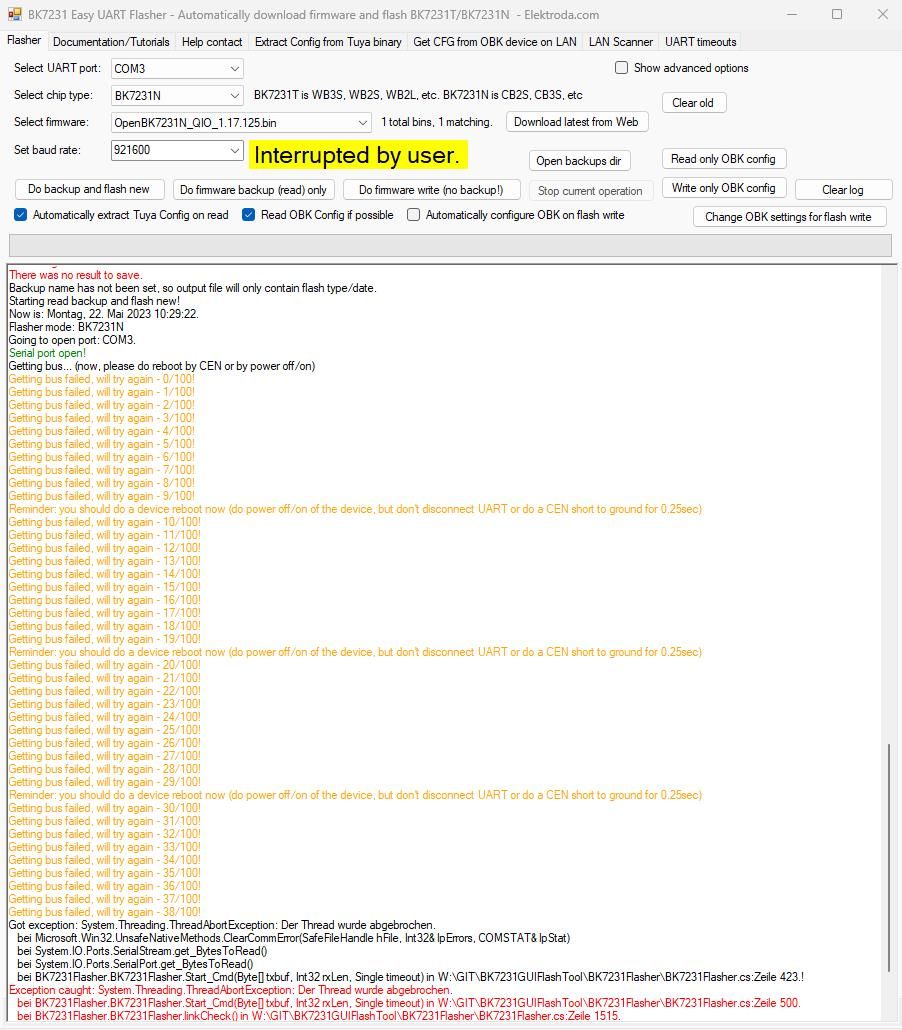

    Something went wrong in my case. It [BK7231N/CB2S] Comparison of multiple smart switch modules, differences on PCB, patched firmware
    It's always switching to COM3, even if I select COM5 (which is the UART Adapter) in this case. Very strange. Before the .exe File was removed by Microsoft Defender. Oh my... Still I got failed.
  • #36 20590544
    Posts: 14771
    Rate: 12914
    How does it switch to COM3? When?
    If you select COM5, there is no code to switch back to COM3, unless... unless COM5 gots reset/removed temporarily from USB devices due to Windows/power/driver issues.
  • #37 20591048

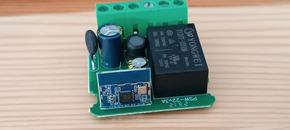

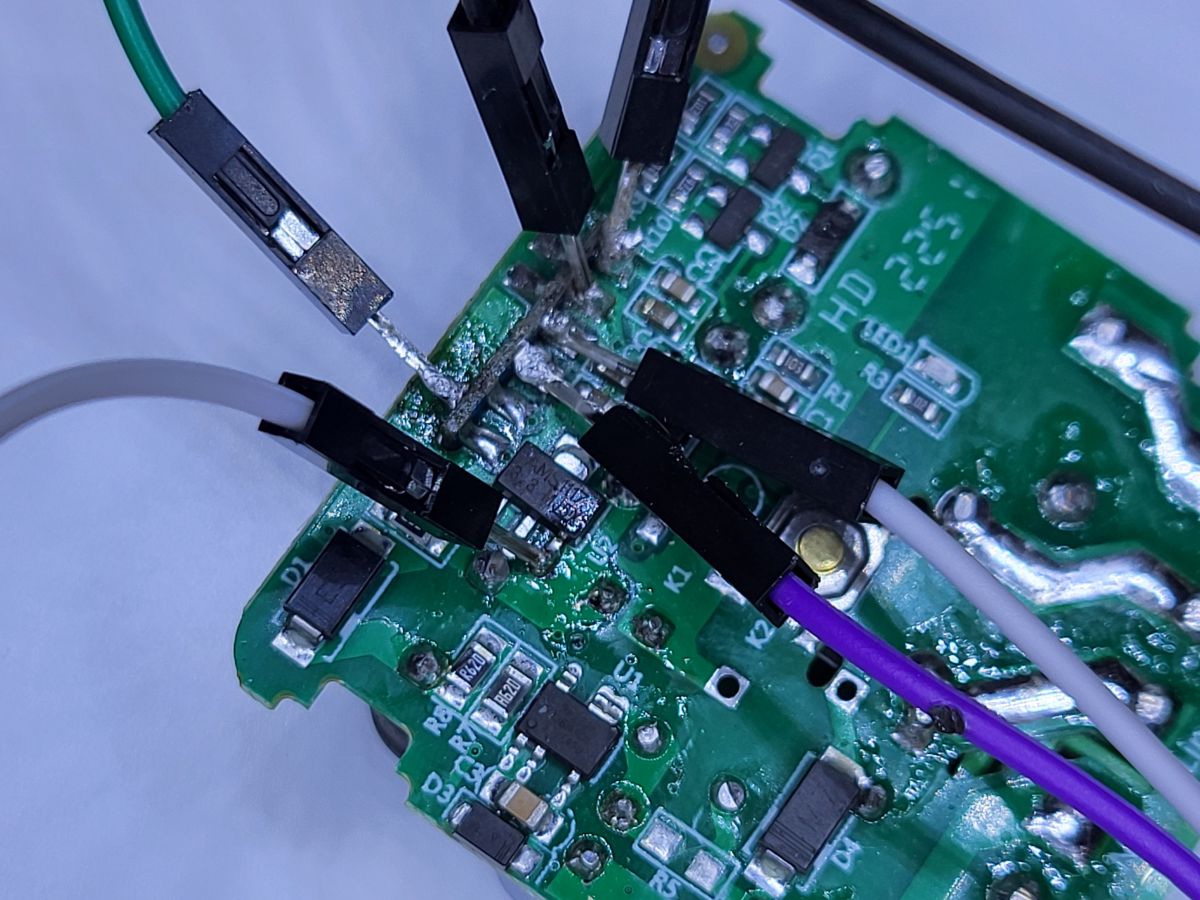

    I just got in a couple Aubees branded FS-03W blind controllers (https://www.aliexpress.com/item/1005004608903981.html) which also have this CB2S labeled module with a BL2028N on them. Also couldn’t read the flash for the life of me. I’ll try your suggestions as well and let you know the results.

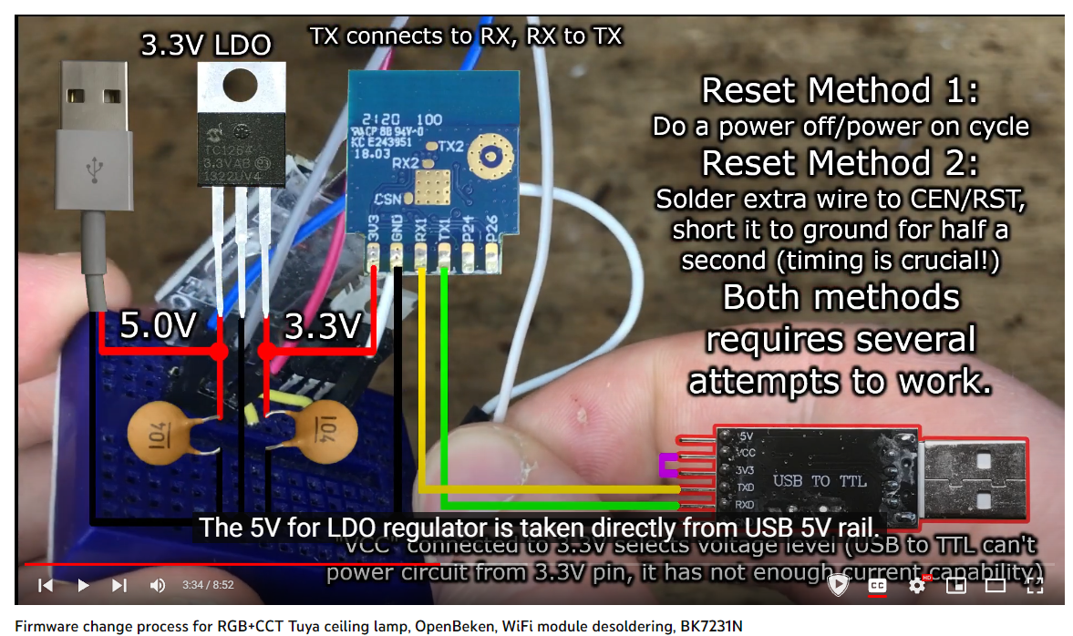

    Try bkWriter 1.60 for reading (but don't use it to restore the flash, it's buggy) or hid_download_py (requires python):
    https://youtu.be/PKkiqDNFIx8?list=PLzbXEc2ebpH0CZDbczAXT94BuSGrd_GoM&t=296

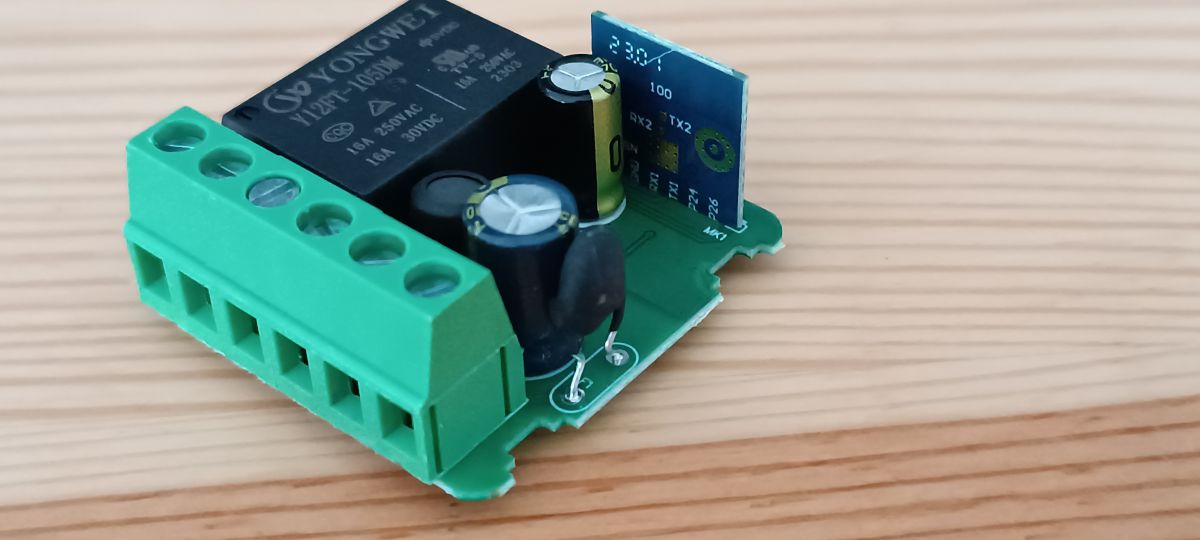

    No luck with 1.6 either. Could the fact there is caps on TX and RX be interfering? [BK7231N/CB2S] Comparison of multiple smart switch modules, differences on PCB, patched firmware
  • #40 20592136
    Posts: 14771
    Rate: 12914
    Are you flashing it in circuit or outside circuit (desoldered module)?
  • #41 20592158
    Nanganator
    Posts: 14
    Destroyed 1 CB2S trying to remove it from the board pictured above. Tore the solder pad off the TX… So for the second one was trying to read the flash with it installed in the device still.

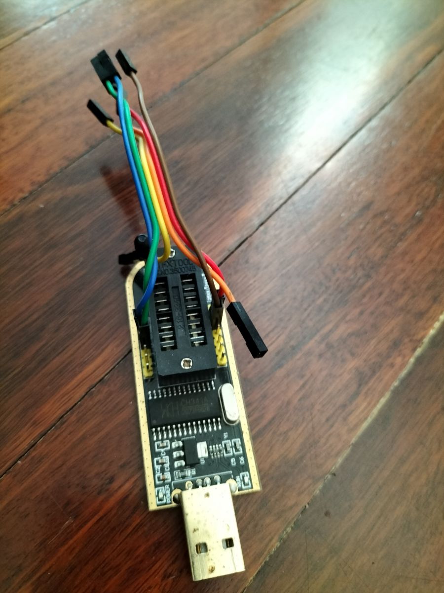

    #42 20592326
    prologue71
    Posts: 6
    Hi everyone
    I just came across this on my recent purchase of the mini switch.
    I have the First model of erlipan2001 description:
    Patched firmware 1.3.10 (Tuya-Cloudcutter won't work)
    obviously Tuya-cloudcutter did not work.
    I just need some clarification. How do I flash the device I have a ch341A EEPROM programmer. I downloaded the latest BK7231tool where do I grab the firmware to flash and why I need to backup the 1.3.10 firmware?
    Thank you in advance

    While flashing a CB2S Qiachip Smart Switch, we indeed had a capacitor on RX pin, and had to remove it:
    Video above is using hid_download_py, BK7231GUIFlashTool wasn't released back then
    @prologue71 we are now using the new GUI solution here, it should work in most cases:
    we do not recommend command line program because it's easy to confuse offsets and brick device.
    Here are binaries:
    https://github.com/openshwprojects/OpenBK7231T_App/releases
    You need USB to UART converter, not the EEPROM programmer.
    https://www.youtube.com/playlist?list=PLzbXEc2ebpH0CZDbczAXT94BuSGrd_GoM
  • #44 20592376
    prologue71
    Posts: 6

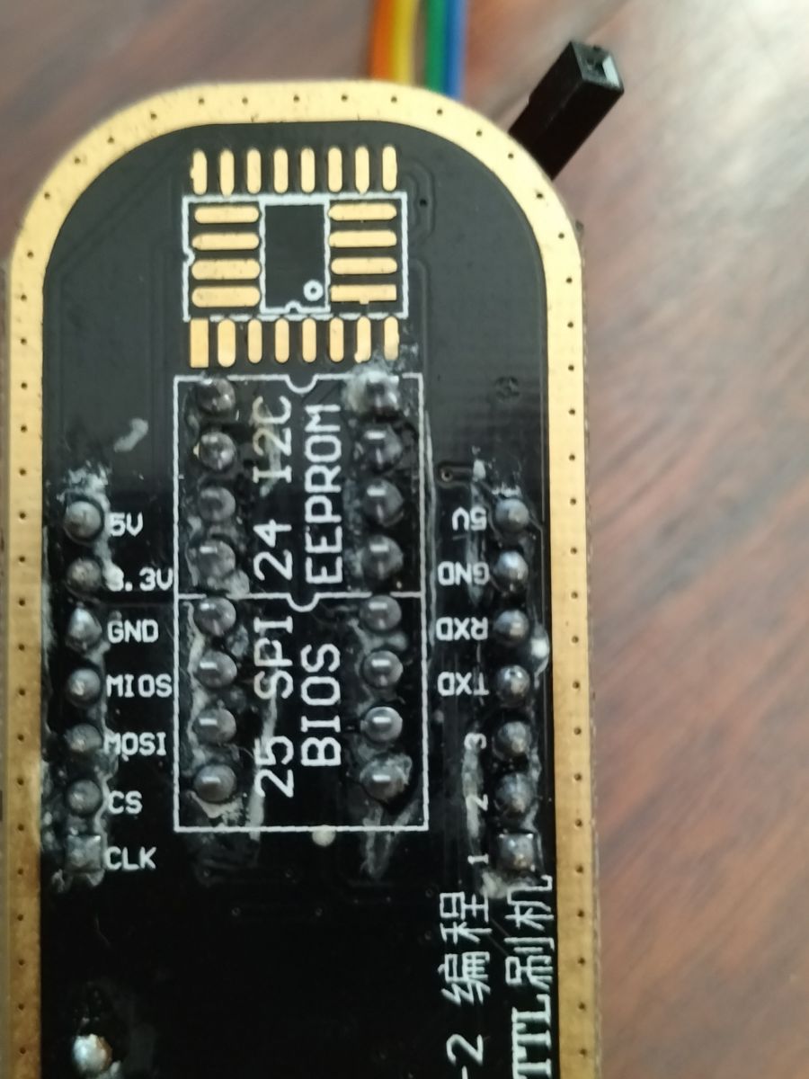

    Thank you for the quick reply. I mean this USB programmer. I occasionally fix firmware with this. So the software should do the whole process of backup and finding the firmware to flash ?
    [BK7231N/CB2S] Comparison of multiple smart switch modules, differences on PCB, patched firmware [BK7231N/CB2S] Comparison of multiple smart switch modules, differences on PCB, patched firmware
  • #45 20592449
    Posts: 14771
    Rate: 12914
    It seems to have RX and TX pins, so you can give it a try. Just follow our tutorials. You need RX, TX, GND and 3.3V to flash BK7231 modules.

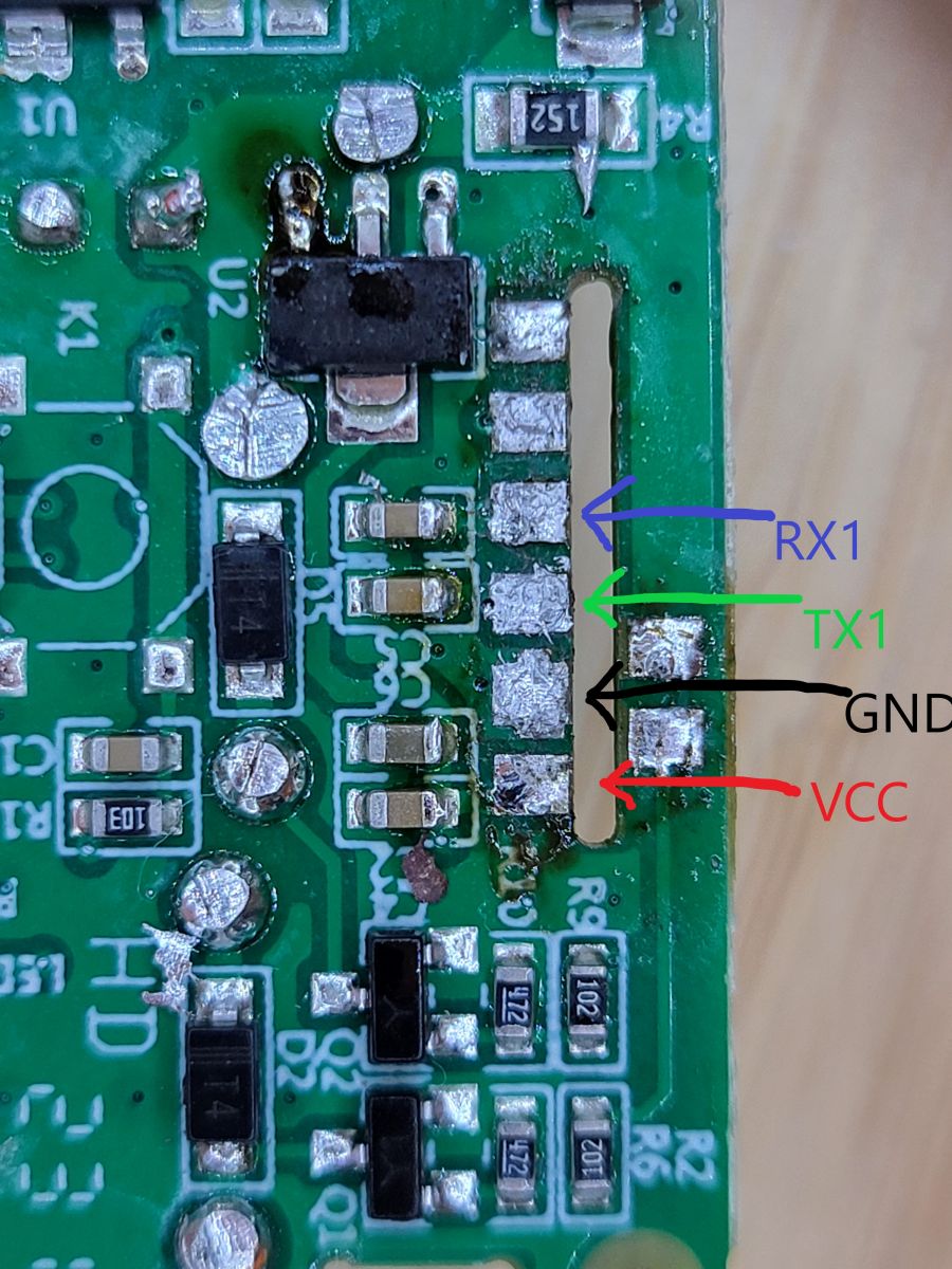

  • Rx/tx tied to ground must be wick-cleared
    #46 20592454
    erlipan2001
    Posts: 29

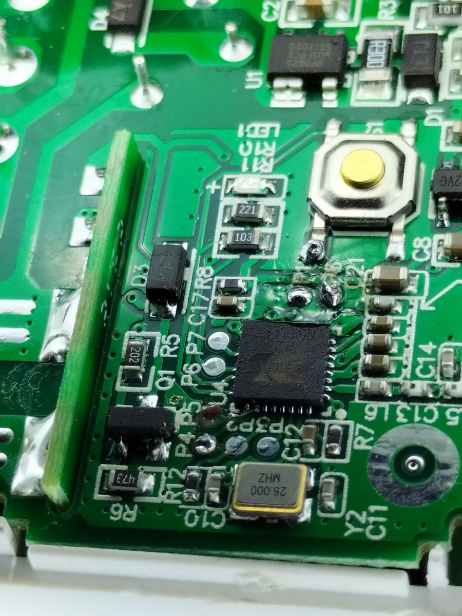

    >>20592158
    @Nanganator please use a bit of flux to remove all the oxide that's forming. It will make your soldering job way easier. Also why 6 wires? You only need rx, tx, 3v3, gnd.
    Also I found out that if rx or tx is connected to the main pcb, 2 out of 2 variant I had both were connected to ground making flashing fail. You need to take a copper wick (Nearly always included in a starter kit) and wick the solder joint away.

    Posts: 14771
    Rate: 12914

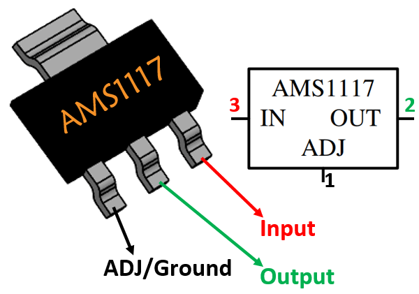

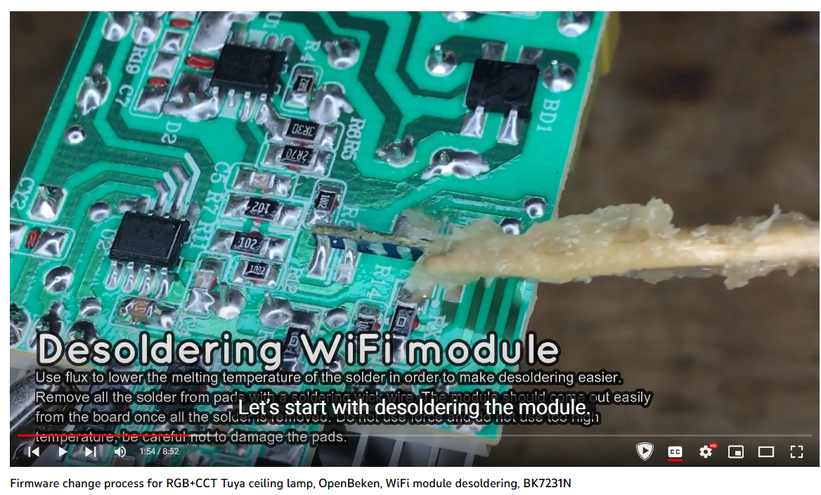

    I guess he tried to solder first into 3.3V directly, and then to the input of AMS1117-3.3V so he can feed 5V:
    but in general, flux is a must, we have tons of desoldering footage, just please watch it, for example here:

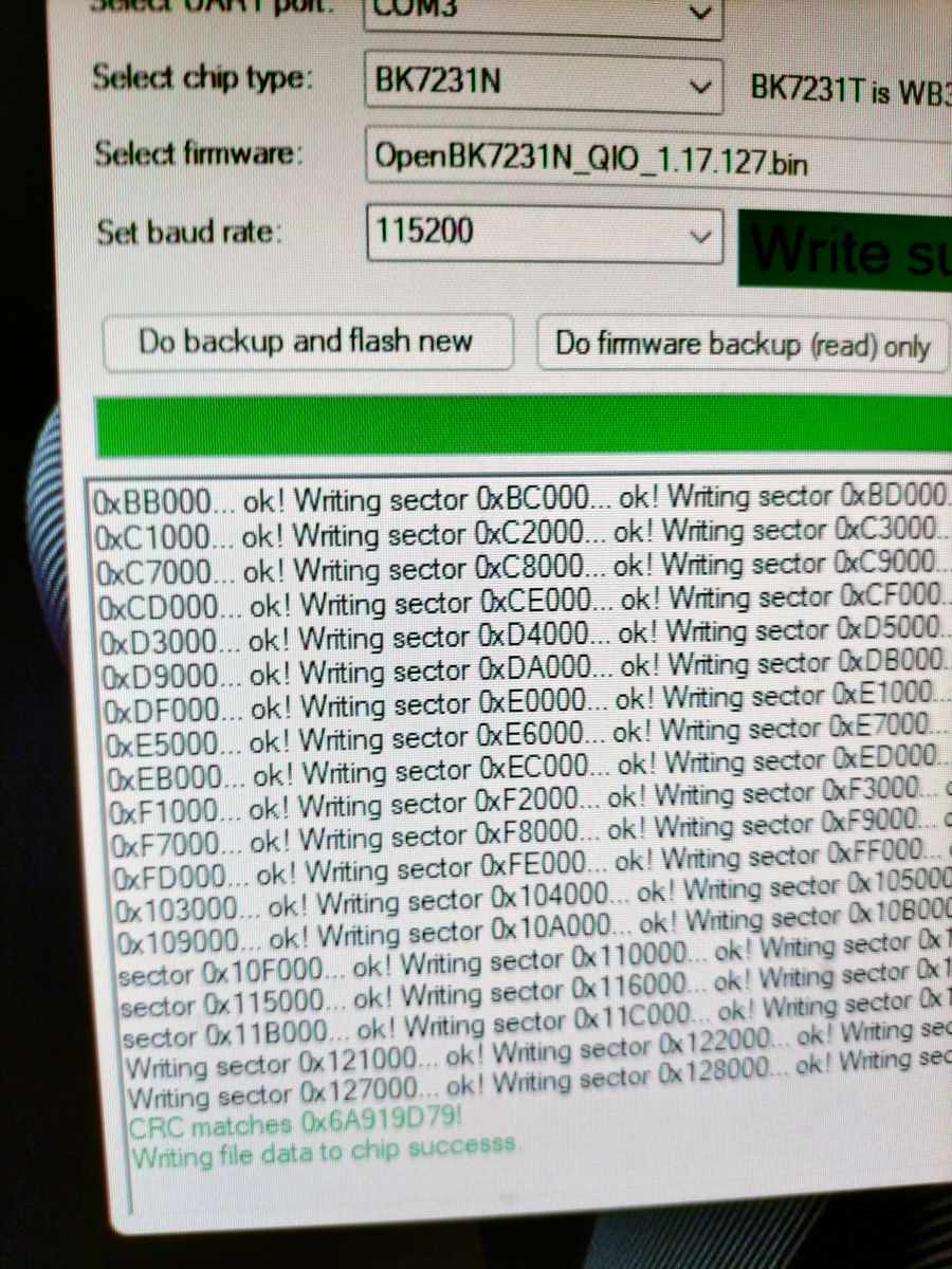

    [BK7231N/CB2S] Comparison of multiple smart switch modules, differences on PCB, patched firmware ok. Thank you guys all done with the flashing. I will attach some photos. It was actually really easy, even easier than tasmotizer.
    Now a small detail. How do I log in to the switch?
    I already desoldered and did not check it with Termite. [BK7231N/CB2S] Comparison of multiple smart switch modules, differences on PCB, patched firmware
  • #49 20592527
    Posts: 14771
    Rate: 12914
    What is Termite? Do you have 2MB flash backup? Does the configuration AP shows up?
    With latest flasher, you could even configure the device in-place, just enter wifi pass/ssid in the BK7231Flash Tool and it will be flashed as well ("Configure OBK" or something like that button)

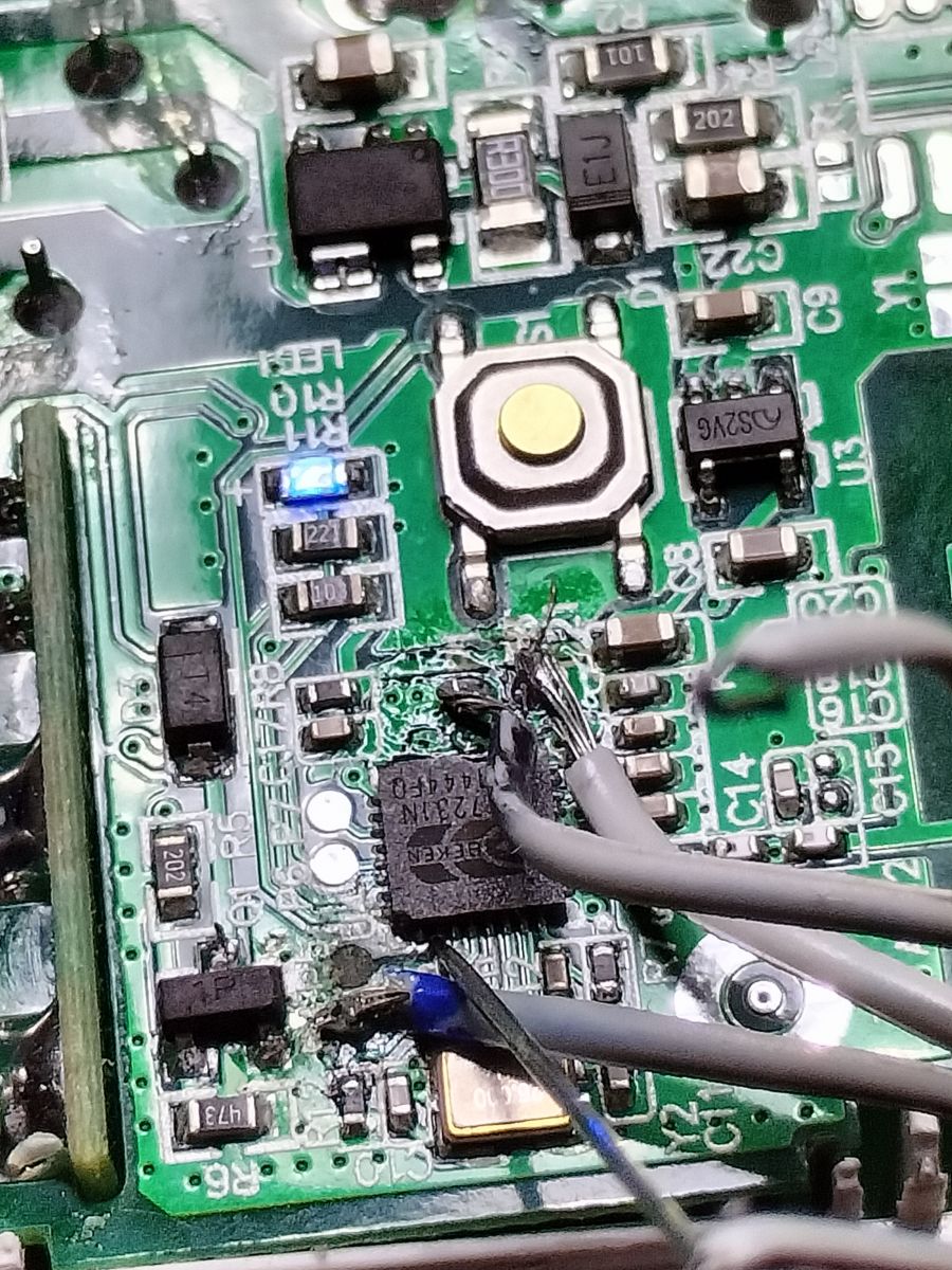

    I slightly desoldered P5 pad as you can see from photo [BK7231N/CB2S] Comparison of multiple smart switch modules, differences on PCB, patched firmware
    Added after 7 [minutes]:
    thank you p.Kazmarek2. A really fast forum here
    After flashing tasmota device i was using Termite software a cli for reprogramming the device.
    Now i need some help here! How do i can get in the device ota? Is there a predefined address? the 192.168.4.1 tasmota does not work
    Thank you

    I am back on the flashing. As the track from pin5 is gone, I used a needle to get the tx directly from the MCU.
    As per photo.
    Used the latest version to reflash. How do I recover the wifi parameters? [BK7231N/CB2S] Comparison of multiple smart switch modules, differences on PCB, patched firmware

Which RX, TX, 3.3V, GND, and CEN pins should I use when wiring a CB2S or CBU BK7231N module for flashing?
Use RX, TX, GND, and 3.3V on the module, and reset with CEN or power cycling. The thread repeatedly states that RX and TX must cross between adapter and module. CEN can be pulled to GND to reboot into flashing flow. If CEN does not work, disconnect 3.3V, briefly discharge the module VDD to GND, then reconnect 3.3V. Do not short the power-supply 3.3V directly to GND. [#20600974]

BK7231GUIFlashTool vs hid_download_py vs bkWriter 1.60 — which tool is best for reading and flashing BK7231N devices?
BK7231GUIFlashTool is the preferred tool for BK7231N flashing and normal backups. Use hid_download_py when the GUI fails or when following the documented Python workflow. Use bkWriter 1.60 only as a read fallback, and do not restore with it because it was called buggy. The developer also stated that bkWriter 1.60 is not recommended for BK7231N and likely will not work. [#20594479]
Can I use an ESP8266 NodeMCU, Arduino, Raspberry Pi, CH341A, or CP210x adapter as a USB-to-UART programmer for BK7231N flashing?
Use a real 3.3V USB-to-UART adapter when possible. An ESP8266 NodeMCU worked when the ESP chip was disabled by grounding ENABLE. CP210x adapters were discussed for normal UART use. A CH341A-style device can work only if it exposes RX, TX, GND, and 3.3V UART pins. Arduino bridges caused failed flashing until replaced with USB TTL-UART. Raspberry Pi GPIO may work, but one user avoided risking it. [#20589284]
