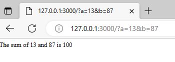

    Now you need to somehow send data to it , method one - browser, open the URL:
    http://127.0.0.1:3000/?a=13&b=87
    Works:

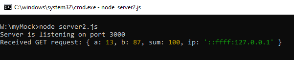

    In the server log we also see that something is going on:
