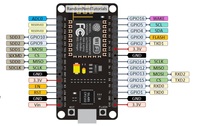

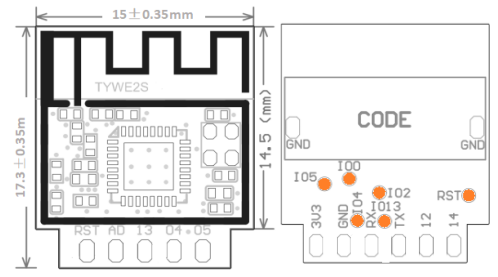

  • WB2S and TYWE2S pin mapping to NodeMCU GPIOs
    #3 20597290
    spin55
    Posts: 209
    Help: 17
    Rate: 42
