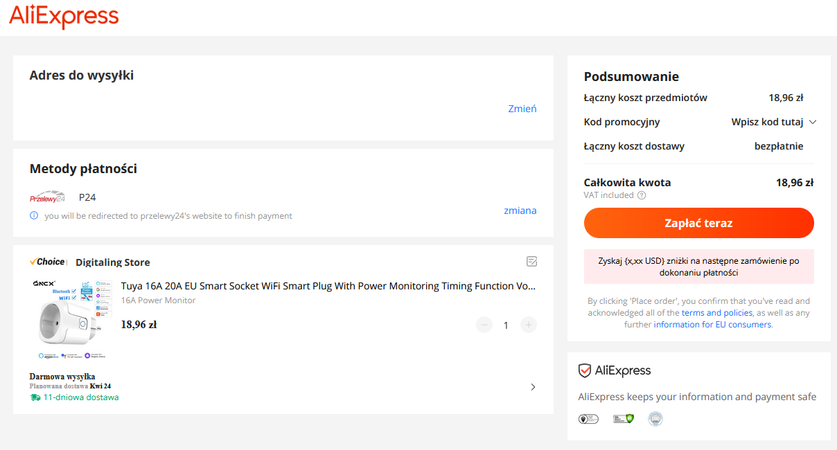

    I found a great deal on smart sockets with current measurement and 20A relay for $2.99 with free shipping in 11 days:
    US$2.99 82%OFF | Tuya 16A 20A EU Smart Socket WiFi Smart Plug With Power Monitoring Timing Function Voice Control Alexa Google Assistant

    I ordered 1 pc. and it turned out that this is also the limit for one account.

    It didn't work for me on any of the accounts (mine or family members), I had to try it on a clean browser. It's weird. After all, I recently ordered a smart socket from aliexpress 2 years ago.
    Bought for PLN 20, thank you for the link, it will be useful for making another video for the Elektrody channel:

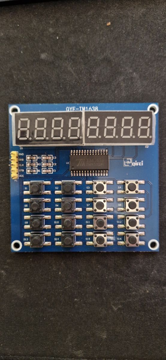

  • Upcoming OBK support for TM1638, BMP280 and SSD1306
    #1208 20550963
    DeDaMrAz
    Posts: 620
    Help: 34
    Rate: 130

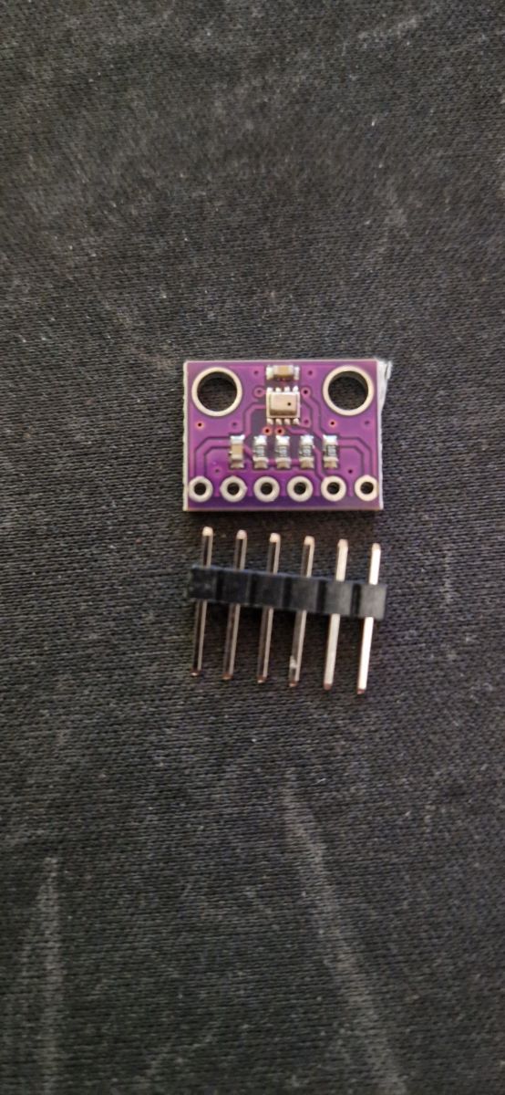

    I found this project by accident and got hooked up fast :) Got to talk to the admin and we figured I can contribute the the community. We already did one project (GN6932 driver) almost from scratch, details in this post - https://www.elektroda.com/rtvforum/topic3971252.html
    I will continue to support this project by sharing as much information as possible here and on GitHub.
    Here are some of the upcoming devices that will be implemented and worked on so OBK will be more powerful and documented in the best way possible.
    TM1638 - 7 segmend display driver
    some of the devices for future support
    And some other toys to play with, like new modules, BMP280 pressure sensor, SSD1306 OLED LCD....

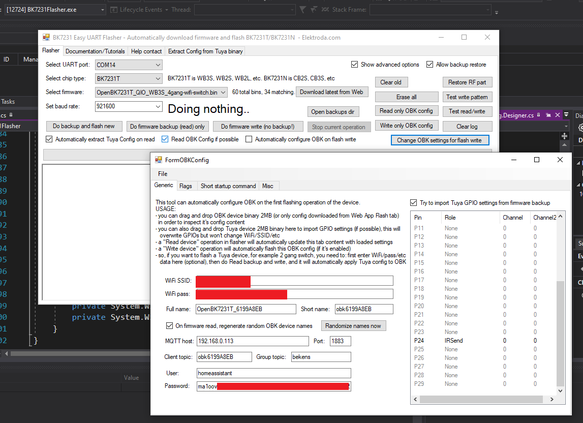

  • BK7231GUIFlashTool to extract Tuya config and edit OBK config
    #1210 20573740
    Posts: 14728
    Rate: 12814

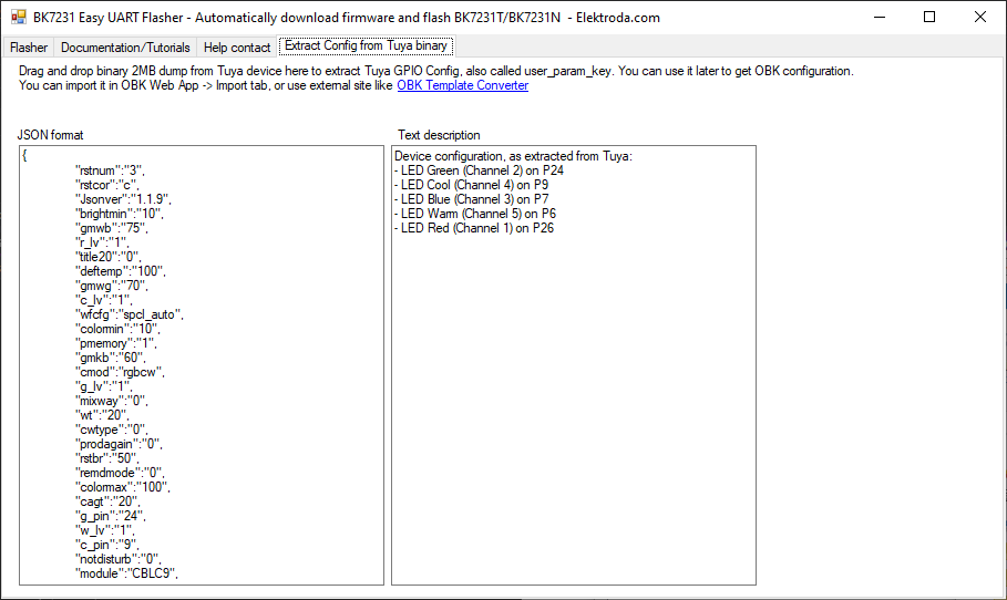

    Important update.
    BK7231GUIFlashTool, this project:
    will soon get update that allows:
    - to extract Tuya config from tuya device binary (so it means you get ready gpio config)
    - to modify obk config via flash tool
    Here's a short preview:

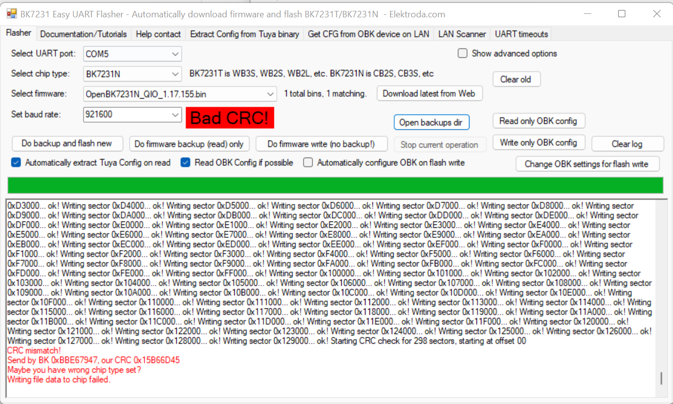

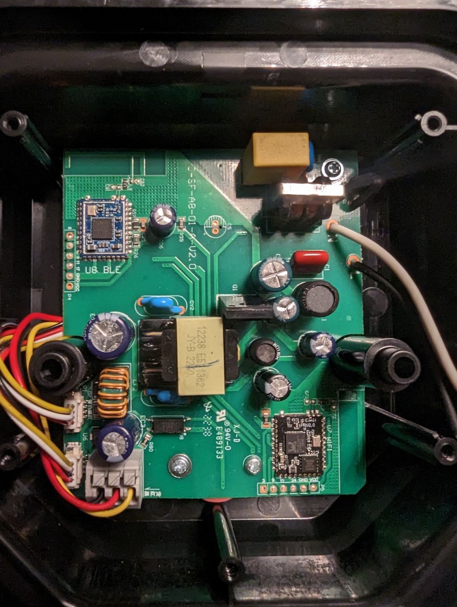

    One of my wall switch (N device) stopped responding after latest ota
    I removed the pcb and use serial method to flash it but I keep getting crc error
    Anyway to fix this?

    Are you 100% sure it's N chip? Not a T with "CB2S" or something like that marking?
    Can you also check with hid_download_py?
  • #1214 20633667

    My bet is that the memory is corrupted in the chip.
    Try to read the entire memory and see if there are any errors.
    Yes, it's a cbu (N chip)
    hid_downlaod_py also gave crc error
    Could be, I've already replaced it with another spare cbu chip to get the switch working again.
    will post the firmware bin later

    CRC error in hid_download_py for N can be ignored currently, I think. It will be updated soon yet to do a correct CRC calculation.

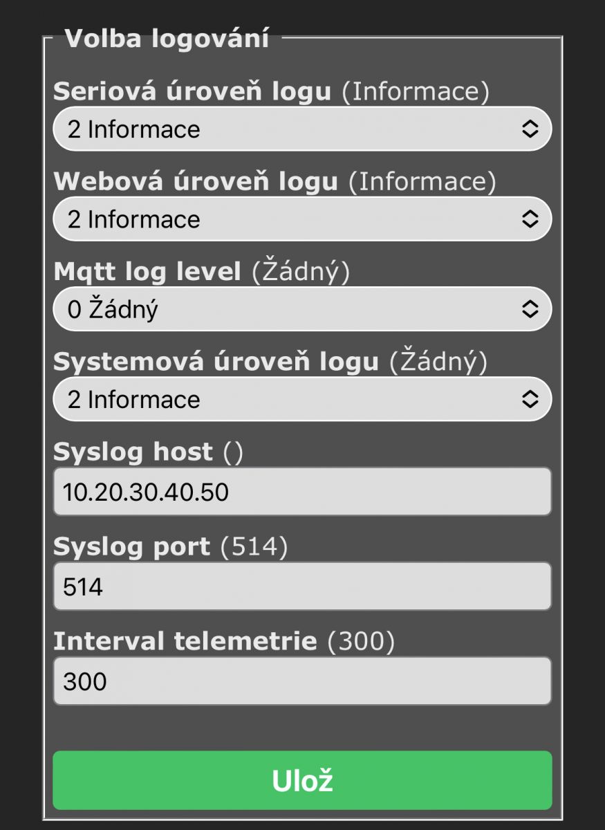

    jakubhrusovsky01
    Hello, is it possible add syslog on UDP to new firmware update ? Like Tasmota have, i want it for Loxone state read. Thanks

    Sure, I can print the log to UDP for you. Can you provide any more details how it should work, which port, etc? UDP is not really reliable and may lose packets. Can you point me towards that "Loxone syslog" documentation?

    Screenshot of logging settings in the Tasmota interface.
    In Tasmota i have this settings and it works perfectly for my integration with Loxone, i use virtual read and it reads state of relay and give it to Loxone.
