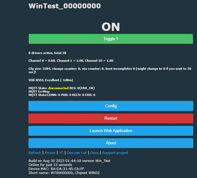

    In order to pair buttons with outlets, please go to "Config" page and use channel values to pair them with relays.
    Screenshot of a web interface showing the status of a WinTest device with the Toggle 1 button activated.

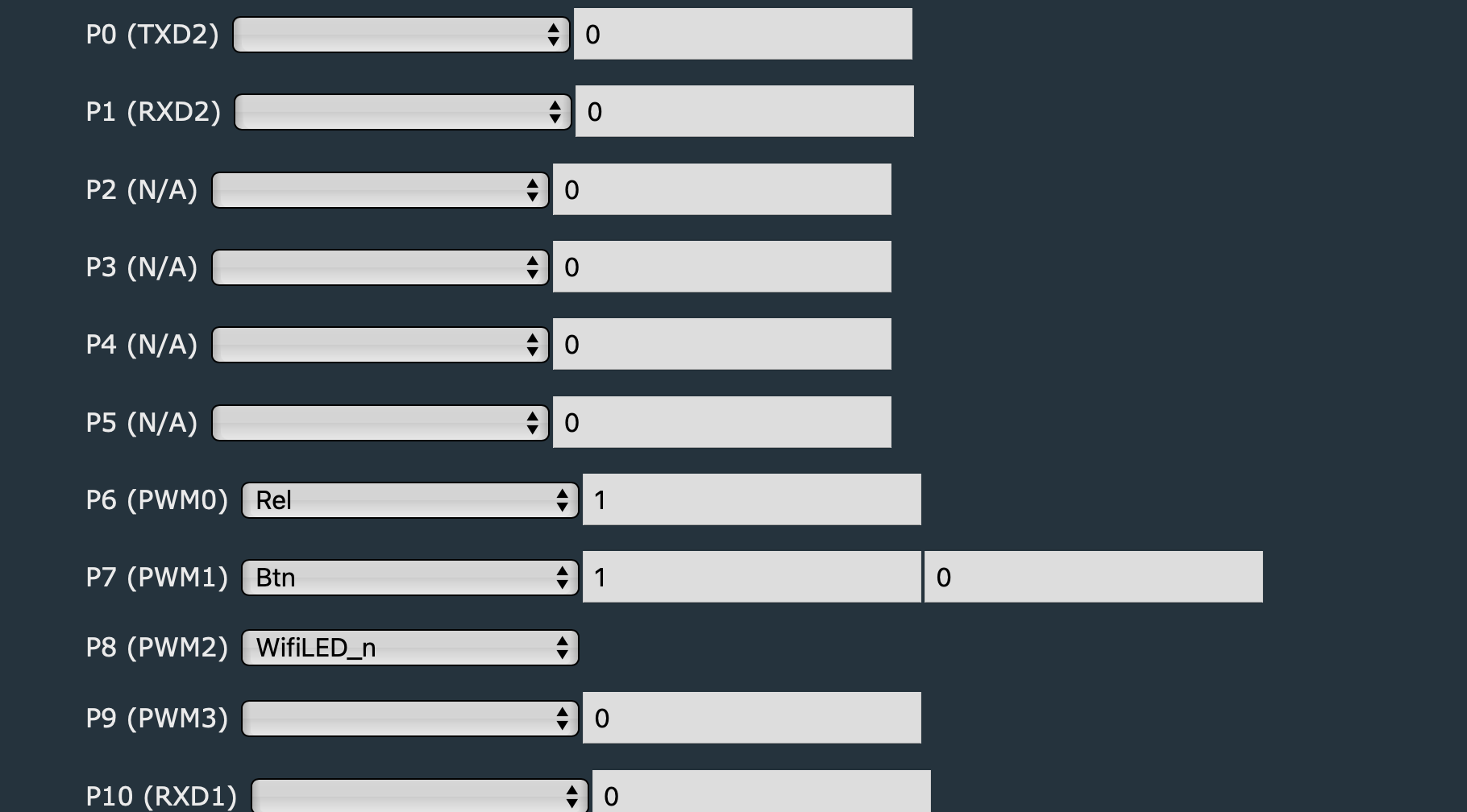

    So, for first relay, set, let's say, channel 1, and for first button, also channel 1, and then, for second relay, set channel 2, and for button 2, set channel 2.
  • #5 20714652
    pastel_uplands0z
    Posts: 12
    Yes I've paired relays and buttons. Still doesn't work. Really weird!
    User interface with a dropdown list and values for various ports and functions.

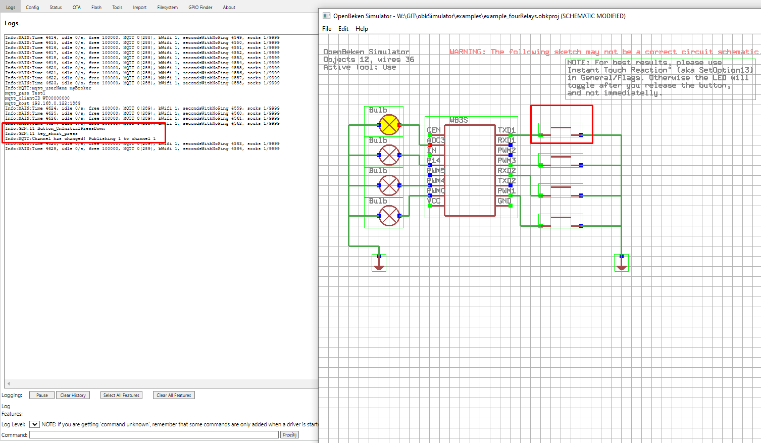

    Okay, so go to Web App and open the tab with log.
    Then, press one of the buttons you've configured.
    Do you get a button press event message like that:
    Screenshot of OpenBeken simulator and event log.
    Namely:
    Info:GEN:11 Button_OnInitialPressDown
    Info:GEN:11 key_short_press
    Info:MQTT:Channel has changed! Publishing 1 to channel 1

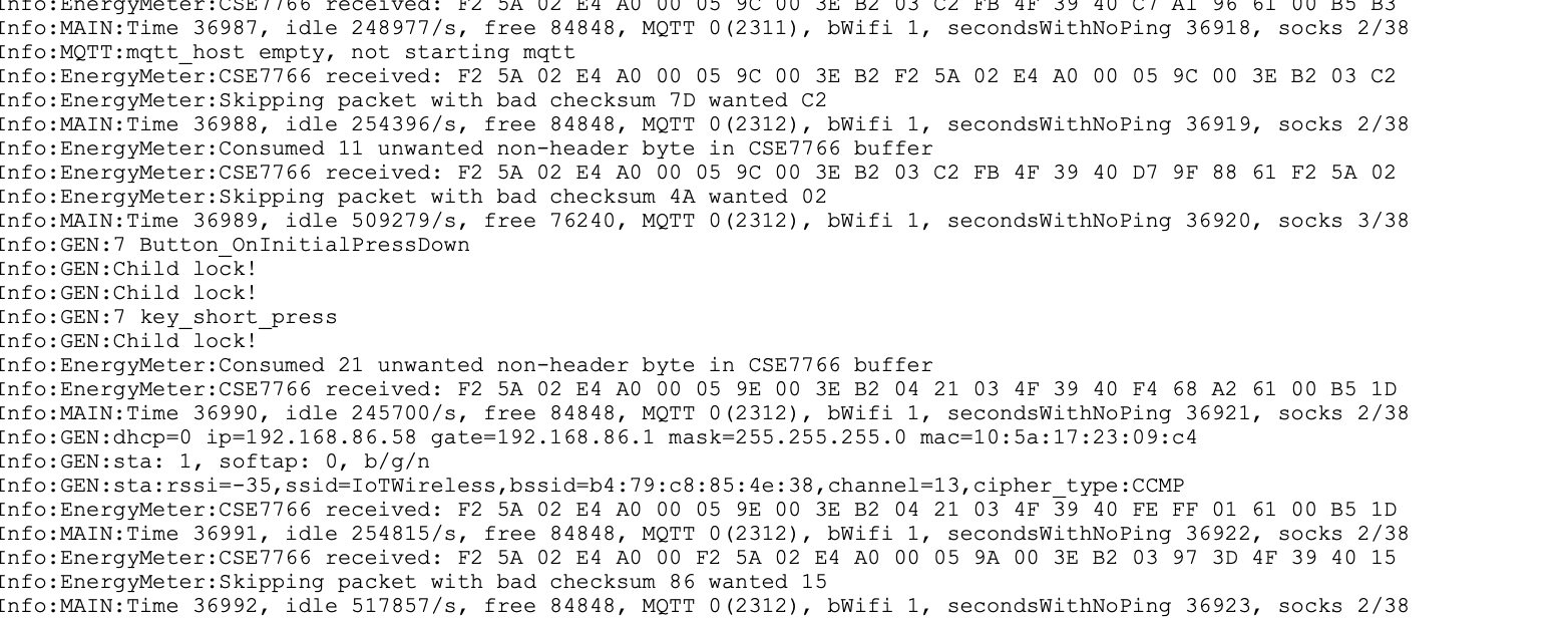

  • #7 20715537
    pastel_uplands0z
    Posts: 12
    Yes, the button trigger showed up in the log file. Deta 6294HA Outdoor Double Outlets: Successfully Flashed with OpenBeken Tuya-CloudCutter

    @pastel_uplands0z , you have enabled child lock flag... it blocks all the buttons.
    Please disable child lock flag.
  • #9 20715729
    pastel_uplands0z
    Posts: 12
    Thank you! That was the issue. Now all the buttons are working!

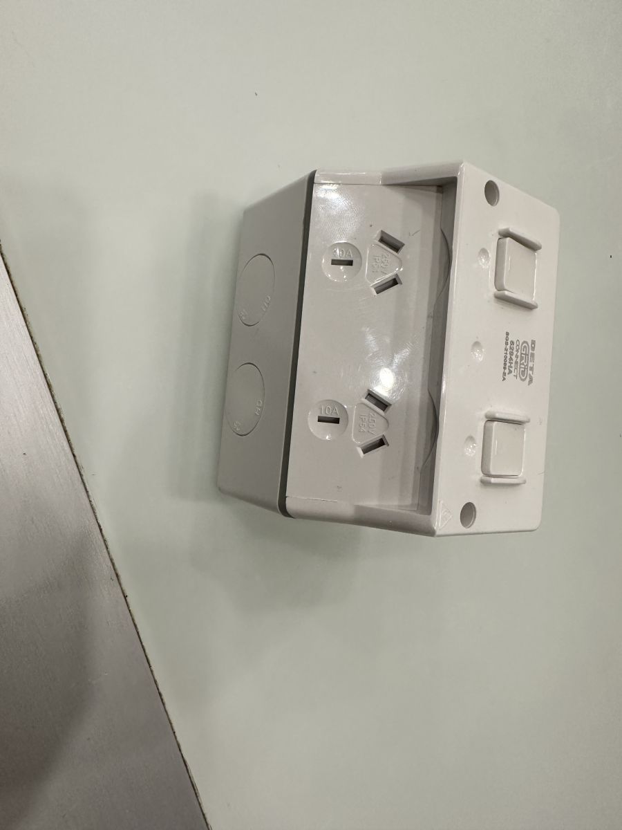

    Ok, now that everything is working, can you post a tested JSON template for your 6294HA and maybe also some real device photos, or screenshots from the seller page, so I can add it to the devices list?
    OpenBeken JSON template for DETA 6294HA outlets

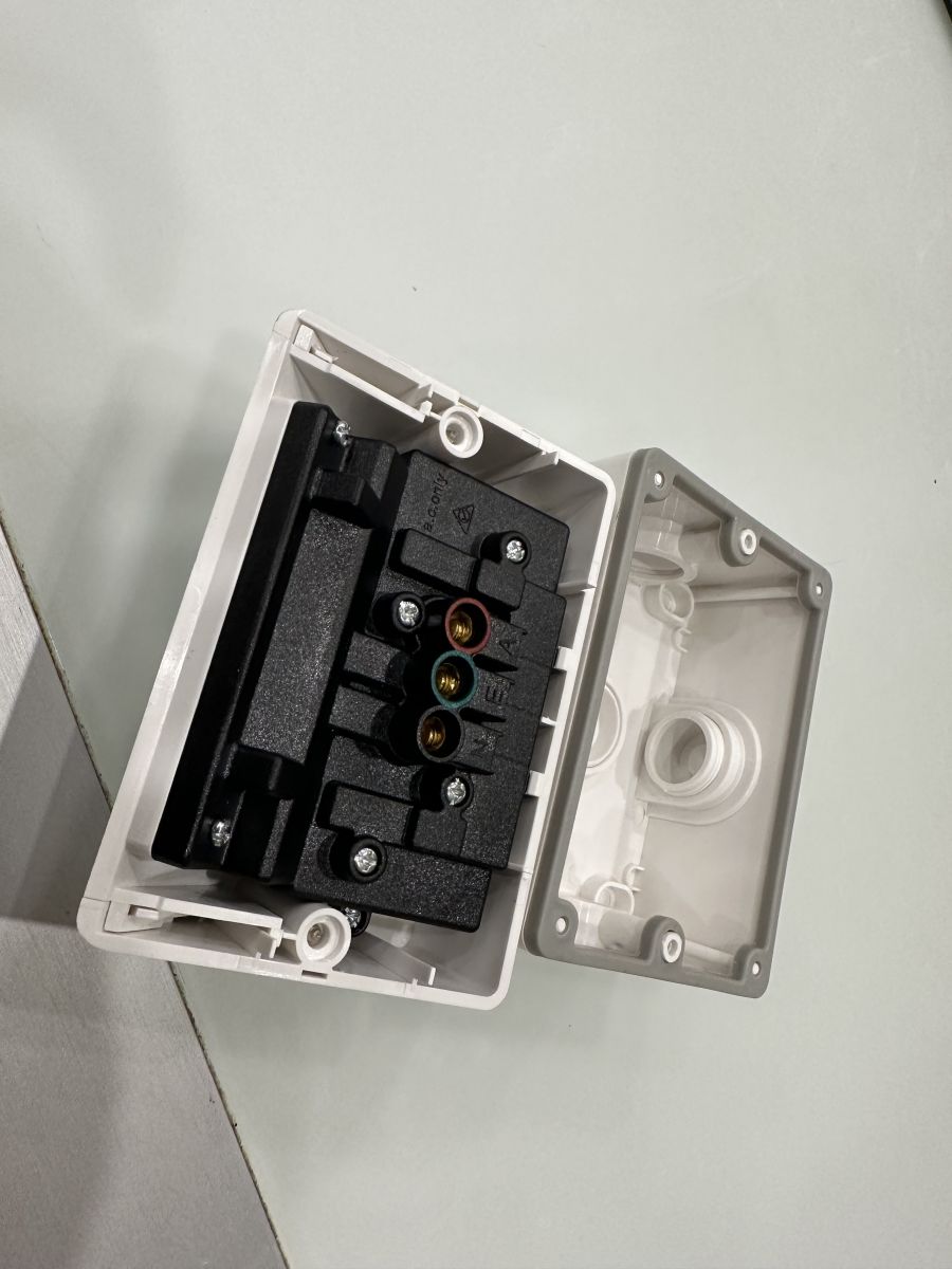

    Couple of photos:
    DETA Grid Connect Smart outdoor double socket in a white casing. View of an open DETA Grid Connect Smart Outdoor Double Powerpoint showing internal components.
