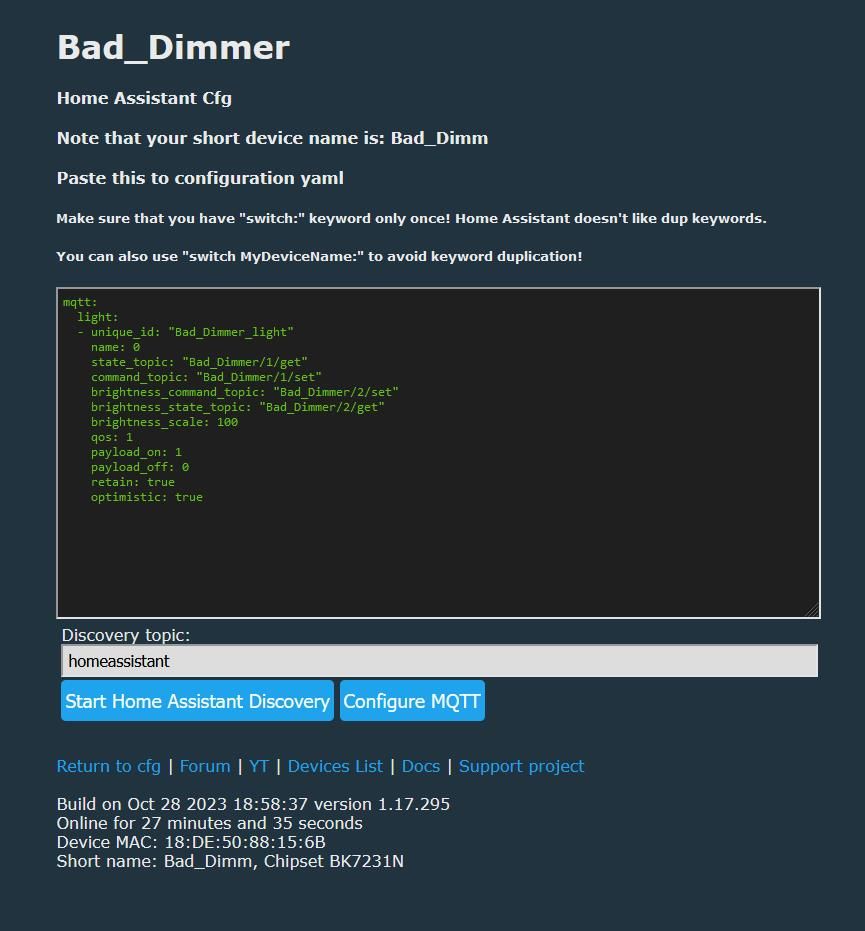

    >>20799162
    I try this
    Screenshot of Bad_Dimmer configuration in Home Assistant.
    but no luck. There is still just a switch in HA. :/

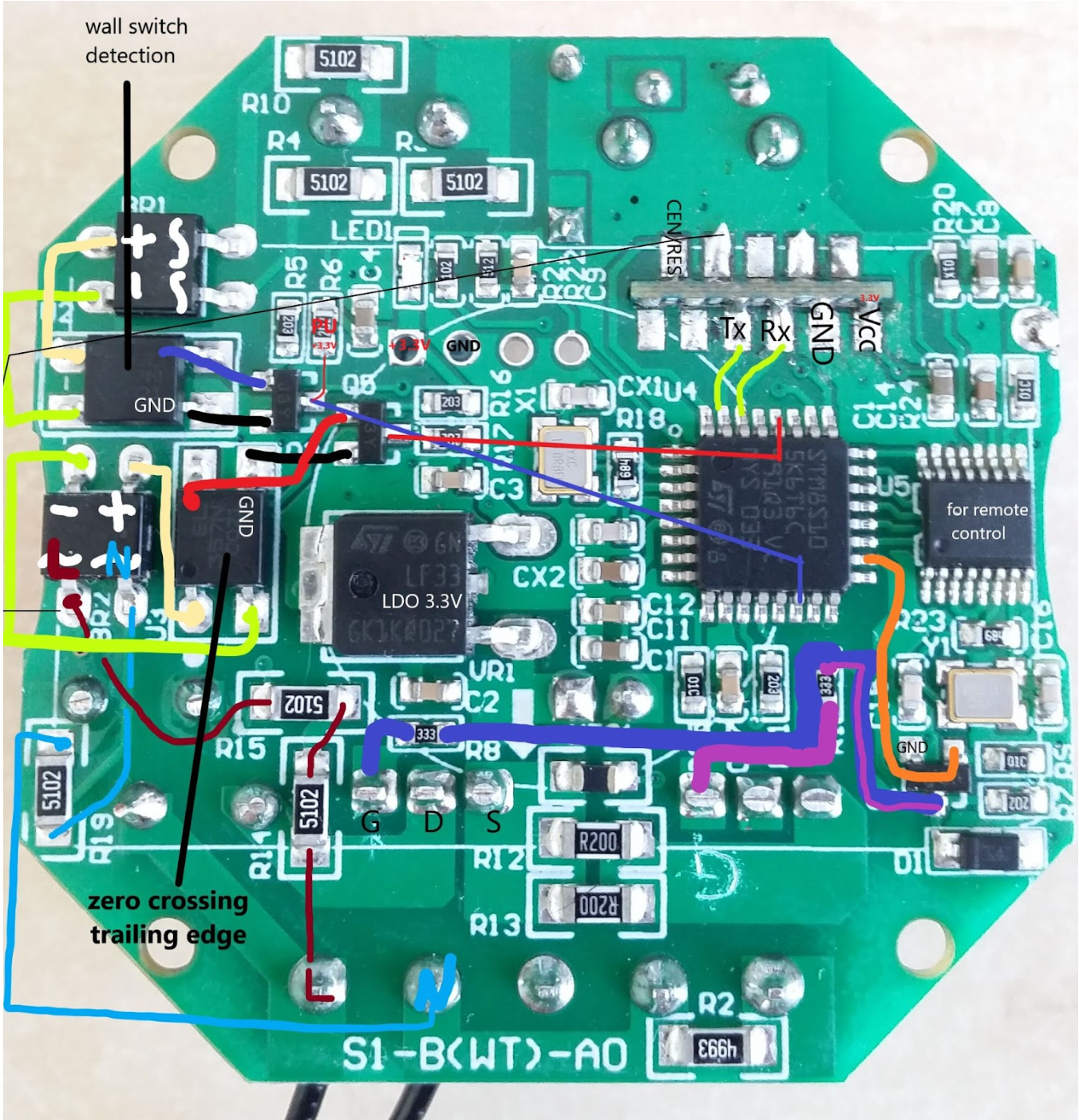

    jtauscher87
    Posts: 13
    PCB with annotated traces and test points, including Tx/Rx, GND, Vcc, 3.3V and L/N.
    In case this is helpful to anyone.
