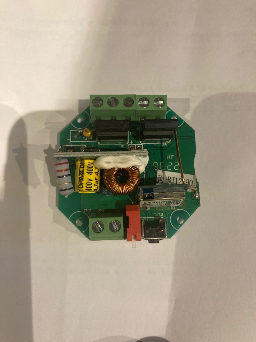

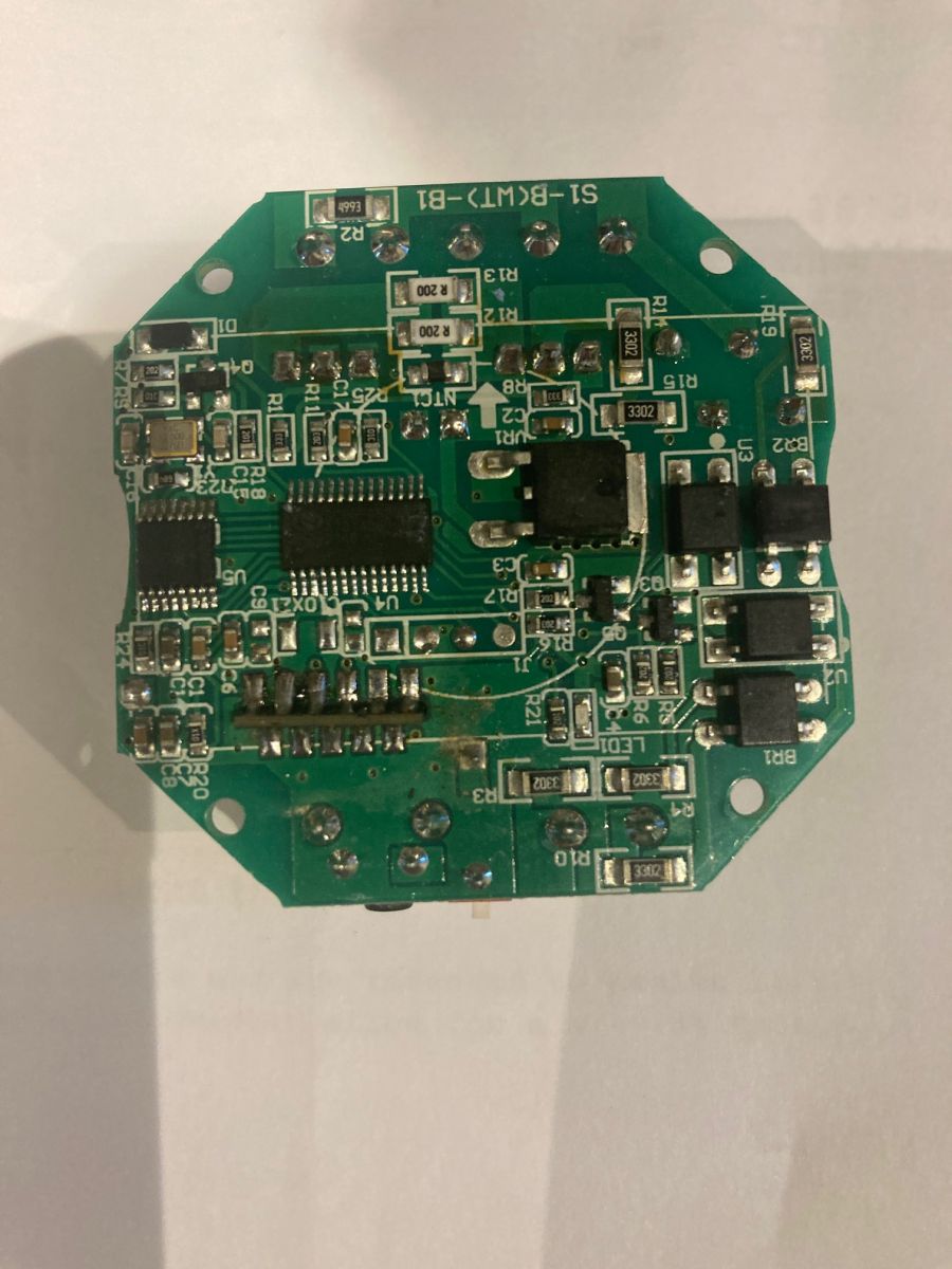

    Configuration Issues with Tuya S1-B-WT Triac Dimmer after OBK Firmware Flashing Hello,
    I have a Tuya generic S1-B-WT triac dimmer which I have successfully flashed with the latest OBK firmware.
    I can navigate to the device IP address and can launch the web application. There is a cloudcutter profile available but when I paste it into the import section of the app, it doesn't seem to generate any useful script. I've been through the 3-step import process and restarted the device, but nothing happens. Here is the JSON code:
    I'm completely new to this sort of stuff and have no idea how to configure it manually or how to interpret this code.
    Can anyone help?

  • #3 20652186
    andyc1
    Posts: 14
    I've attached the requested TuyaConfig file for you and I've also taken a couple of photos of the inside of the device so that you can see the components if that might be of any help to you.

    The binary you have attached confirms the data from CC profile:
    Please try following autoexec.bat:
    startDriver TuyaMCU
    tuyaMcu_defWiFiState 4
    tuyaMcu_setBaudRate 115200
    Reboot, then open Web App log, and try pressing the button, changing brightness, etc, etc, and copy the web app log here so we can see which dpIDs are received by OBK.
    EDIT: You could also try to guess dpIDs, maybe they still have dpID 1 for switch and 2 for dimmer, if that's the case, then try:
    startDriver TuyaMCU
    // not sure about those ids:
    setChannelType 1 toggle
    setChannelType 2 dimmer
    tuyaMcu_setDimmerRange 0 1000
    linkTuyaMCUOutputToChannel 1 1 1
    linkTuyaMCUOutputToChannel 2 2 2
  • Heartbeat logs show Tuya MCU communication only

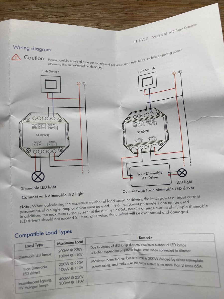

  • #6 20654184
    Posts: 14770
    Rate: 12913
    Did you toggle the dimmer by using a physical switch? There is no toggling in log.
    Toggling the dimmer on the web page will not help.
    You need to attach a physical switch to the device like in the Tuya manual and use it to adjust the dimmer mode. Then copy the log here.

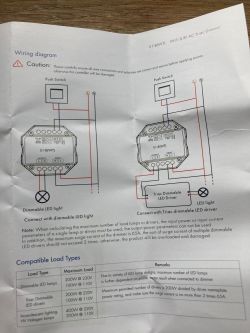

  • #7 20654204
    andyc1
    Posts: 14
    Do you mean wire in a standard dimmer switch as in this wiring diagram?
    If not, please explain.
    What should I look for in the log to check I've done it correctly?
  • Need dpIds for brightness and toggle
    #8 20654210
    Posts: 14770
    Rate: 12913
    Yes, wire it as on manual.

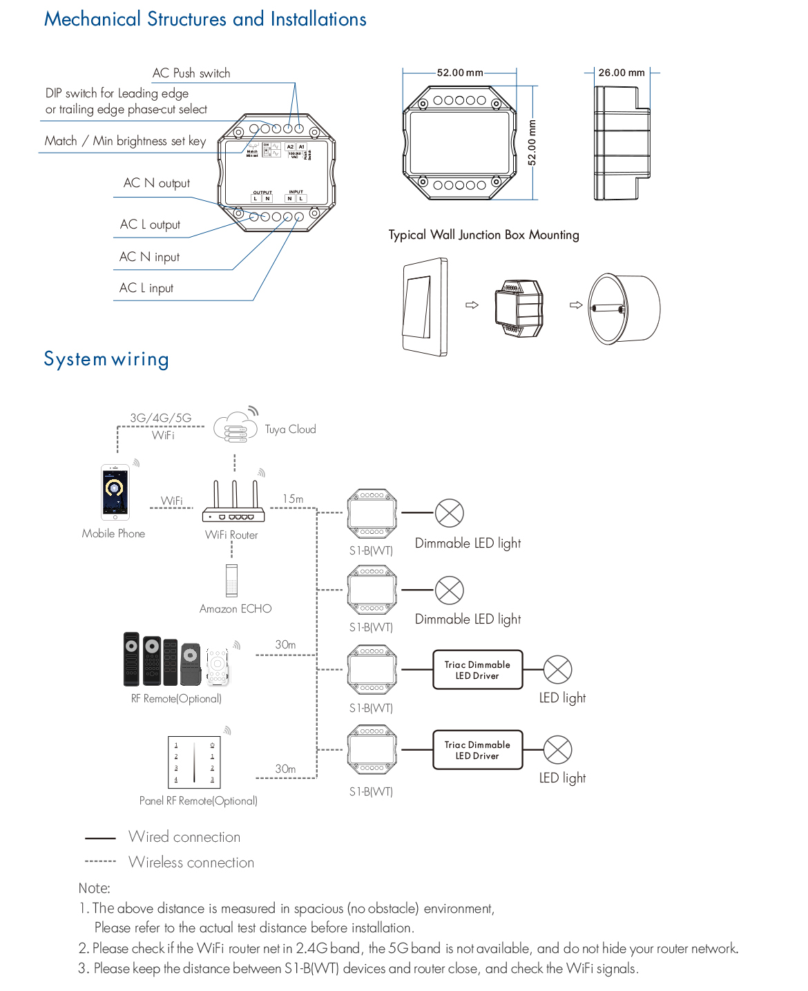

    Thank you, that's a very informative find. Futhermore I can see that documentation on the Skydance's site is very detailed, that's nice. Let me post here some screenshots:

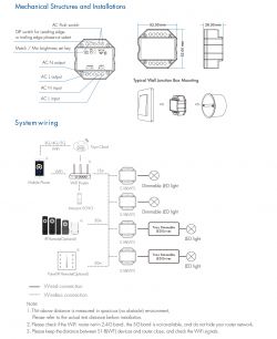

    Image of a WiFi-RF dimmer with text on a webpage.
    Image of LED dimmer specifications and features. System wiring diagram with installation and mechanical structure description. Infographic showing features and applications of the Skydance AC TRIAC dimmer with Wi-Fi, RF, and push-button control.
    They even offer a leading edge or trailing edge dimming selection? Nice.

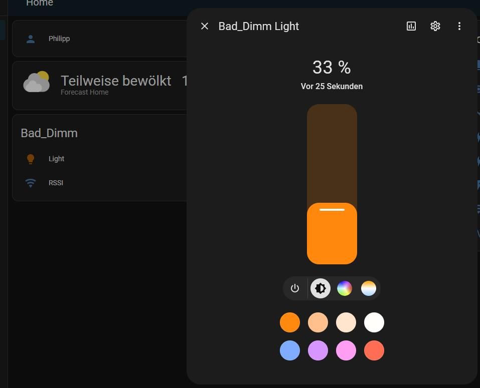

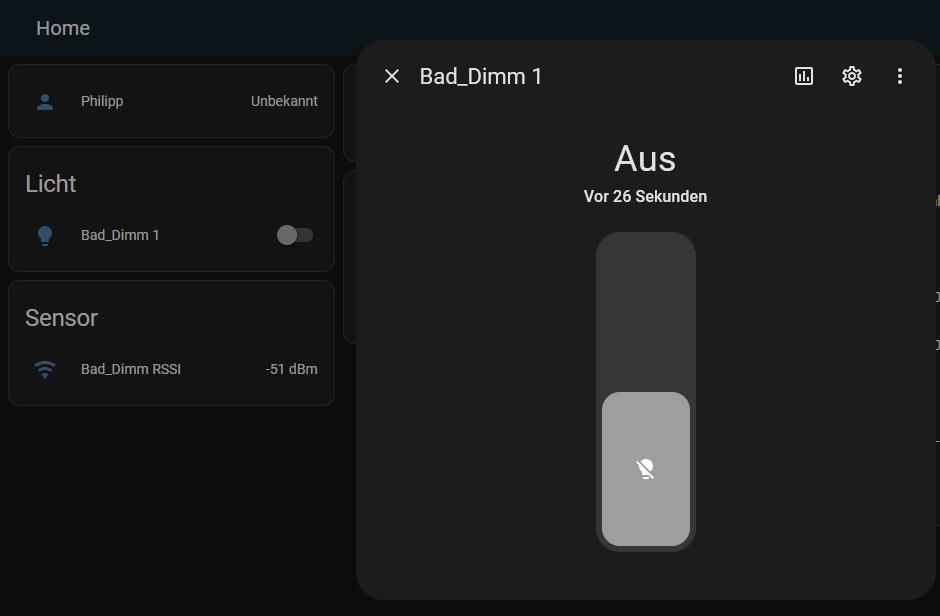

    Thanks for your fast reply. In the Home Assistant, the dimmer only reports as a switch and not as a dimmer, and the signal strength is displayed as an extra sensor and not on the device.
    Home Assistant interface with Bad_Dimm 1 device
    My autoexec.bat:
    startDriver TuyaMCU
    startDriver SSDP
    PowerSave 1
    linkTuyaMCUOutputToChannel 20 1 1
    linkTuyaMCUOutputToChannel 22 2 2
    If I write the following in autoexec.bat, I can dim the brightness, and the signal strength is not displayed as an extra sensor (but of course, it shows the full RGBCCT panel, I only need a dimmer slider):
    startDriver TuyaMCU
    startDriver SSDP
    PowerSave 1
    tuyaMcu_setupLED 24 0
    Lighting control interface with brightness slider set to 33%.
    How can I add the device manually through configuration.yaml?
  • #28 20799162
    Posts: 14770
    Rate: 12913
    The first script should work with HASS Discovery as well too, I need to check that.
    You can check this topic for manual dimmer YAML guide:
    https://www.elektroda.com/rtvforum/topic3898502.html

How do I use a physical wall switch to generate TuyaMCU state packets and confirm the correct dpIDs for an S1-B-WT dimmer?
Wire the wall switch as shown in the device manual, then operate the dimmer physically while the OBK web log is open. Do not rely on the web page slider for this test. The successful capture showed command 7 (State) packets, then dpId 20 as a boolean and dpId 22 as a value of 1000. Those packets gave the exact mapping needed for linkTuyaMCUOutputToChannel. Without the physical switch, the user only saw heartbeat traffic. [#20654276]

How should I set up Home Assistant discovery so an OpenBeken Tuya dimmer appears as a dimmer entity instead of only a switch?
Use channel-based dimmer mapping, not only tuyaMcu_setupLED 24 0, and keep Home Assistant discovery enabled. The thread showed that a script with setChannelType 1 toggle, setChannelType 2 dimmer, and linkTuyaMCUOutputToChannel 20 1 1 plus 22 2 2 should be the right discovery path. However, one user still saw only a switch in Home Assistant, so the maintainer said the first script should work and needed checking. In short, discovery expects a real dimmer channel, not just relay-only exposure. [#20799162]
What can I put in Home Assistant configuration.yaml to manually add an OpenBeken TuyaMCU dimmer if auto discovery creates the wrong entity type?
Use a manual dimmer definition in configuration.yaml instead of waiting for discovery to classify it correctly. The maintainer explicitly pointed the user to a manual dimmer YAML guide after discovery exposed the S1-B-WT only as a switch. If your script already uses setChannelType 2 dimmer and tuyaMcu_setDimmerRange 0 1000, but Home Assistant still shows only a switch, manual YAML is the fallback path mentioned in the thread. [#20799162]
