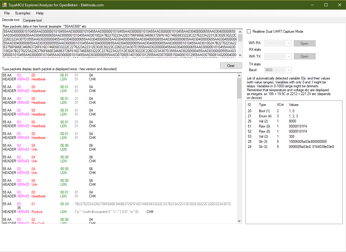

    Well, we can either guess, or if you have a backup - do you? You can flash the backup, then test device with Tuya app so we can do packets capture and write down how do they control colors, and then try to send the same packets from OBK.
    Maybe we could try without original 2MB flash if we manage to find some information how to send data to your device.
    I've tried searching but I only found devices that seem to have simple RGB/CCT control like that one:
    https://templates.blakadder.com/polux_313911.html
    Screenshot showing TuyaMCU configuration with function descriptions and settings.
    We could try searching Tasmota code, maybe they support it:
    https://github.com/arendst/Tasmota/blob/0ac5d...ta/tasmota_xdrv_driver/xdrv_16_tuyamcu_v1.ino
    but it doesn't look like it?
    https://tasmota.github.io/docs/TuyaMCU/#tuyasend-command
    So most likely restoring the Tuya firmware for further analysis is the way to go. If you don't have a backup, we could ask our dedicated Serbian tester and contributor, @DeDaMrAz to consider ordering this device and doing some captures. I also could do that myself, but I am not sure if you're willing to wait few weeks for me to have a free slot on my table. I am currently making a series of video tutorials for OBK and also I am focusing on code issues related to current features. Here's a sneak peak of what I am working on:

    Original Firmware backup - unfortunately, no, I don't have a backup of the original firmware.
    Tasmota - I have no idea if any of these work.

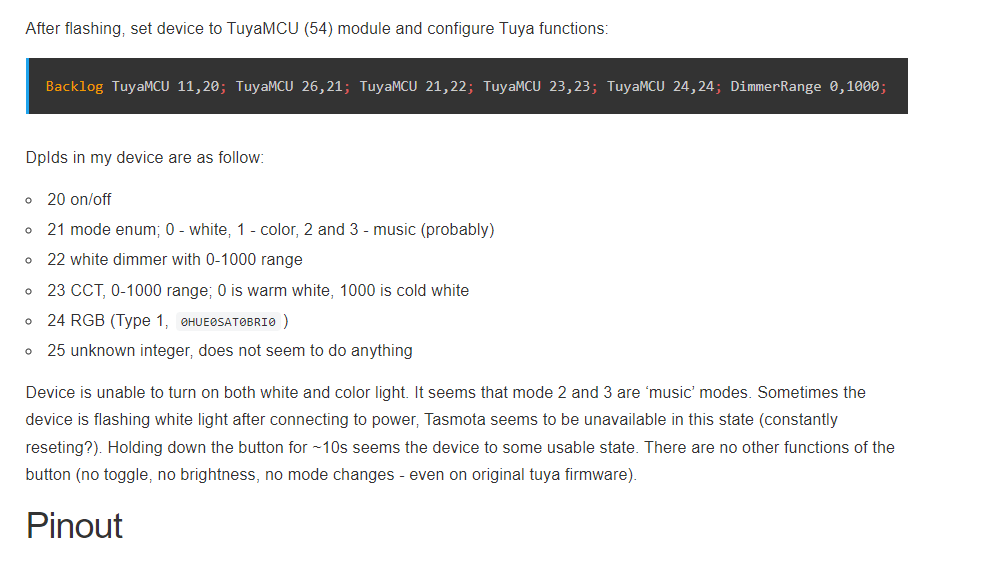

    Looking through the forums, this is the closest I can find to my device:
    [url=]https://www.elektroda.com/rtvforum/topic3982779.html[/url]
    I have tried a few commands from that thread with some success and others without:
    1. This one didn't work
    setChannelType 21 toggle
    linkTuyaMCUOutputToChannel 21 1 21
    2. This worked - it changed the color on the LEDs (from a multicolor pattern that I selected with the IR remote) to blue.
    tuyaMcu_sendState 25 3 ff0000646464ff
    3. From that thread, all the
    tuyaMCU_sendColor *******
    seem to work, but some of them produced different colors on the LEDs. This actually might be a device problem as even when I use the IR remote, some colors are not right - red = purple, blue = yellow, green = green, yellow = light blue.
    4. From the same thread -
    tuyaMCU_setupLED 24 0
    it does add the Dimmer/Brightness, RGB Color, and Temperature Slider on the front www page of the device. The Temperature Slider does not work at all.
    However, if I try to use them, they don't operate as they should. If I use the RGB color to pick a color, the device goes blank. Only with the IR remote can I get it to display colors again.
    If I use the Dimmer/Brightness - it does dim the LEDs, but it never increases the intensity back.
    If I use the Temperature Slider, it turns off the LEDs. And they never come back. I have to cut the power to the device and do some sort of a reset from the IR remote to get it back.
    In regards to individual addressable LEDs - yes, it does look like the LEDs can display different colors.
    If @DeDaMrAz or you would consider looking at this device, that would be great.
    Looking forward to your new YouTube videos :)

    MnM1 wrote:
    2. This worked - it changed the color on the leds (from a multicolor pattern that I selected with the IR remote) to blue.
    It may be just a fluke. You can try with that command and multiple dpIDs:
    tuyaMCU_sendColor dpID red01 green01 blue01 tuyaRGB
    tuyaMCU_sendColor 25 1 0 0 1
    tuyaMCU_sendColor 25 0 1 0 1
    RGB values are in 0-1 range, so "1 0 0" is red, "0 1 0" is green, etc.
    Try those commands and let us know whether they give consistent results or do they give, for example, always blue...
    I think that it is very possible that someone somewhere in the web has documented this TuyaMCU format already and we just need to find it. Otherwise... it would mean that we are the first ones investigating that kind of device.
    Added after 51 [seconds]:
    Btw what if you use: tuyaMcu_sendQueryState command?

    I tried the suggested commands - both of them just dimmed the LEDs.
    tuyaMcu_sendQueryState:
    Debug:CMD:cmd [tuyaMcu_sendQueryState]
    Info:CMD:[WebApp Cmd 'tuyaMcu_sendQueryState' Result] OK
    Info:TuyaMCU:TUYAMCU received: 55 AA 03 07 00 05 14 01 00 01 01 25
    Info:TuyaMCU:TuyaMCU_ProcessIncoming[ver=3]: processing command 7 (State) with 12 bytes
    Info:TuyaMCU:TuyaMCU_ParseStateMessage: processing dpId 20, dataType 1-DP_TYPE_BOOL and 1 data bytes
    Info:TuyaMCU:TuyaMCU_ParseStateMessage: raw data 1 byte:
    Info:TuyaMCU:TUYAMCU received: 55 AA 03 07 00 05 15 04 00 01 01 29
    Info:TuyaMCU:TuyaMCU_ParseStateMessage: processing dpId 21, dataType 4-DP_TYPE_ENUM and 1 data bytes
    Debug:TuyaMCU:TuyaMCU_ApplyMapping: id 21 with value 1 is not mapped
    Info:TuyaMCU:TUYAMCU received: 55 AA 03 07 00 08 1A 02 00 04 00 00 1F 40 90
    Info:TuyaMCU:TuyaMCU_ProcessIncoming[ver=3]: processing command 7 (State) with 15 bytes
    Info:TuyaMCU:TuyaMCU_ParseStateMessage: processing dpId 26, dataType 2-DP_TYPE_VALUE and 4 data bytes
    Info:TuyaMCU:TuyaMCU_ParseStateMessage: raw data 4 int: 8000
    Debug:TuyaMCU:TuyaMCU_ApplyMapping: id 26 with value 8000 is not mapped
    Info:TuyaMCU:TUYAMCU received: 55 AA 03 07 00 09 33 00 00 05 00 00 01 01 00 4C
    Info:TuyaMCU:TuyaMCU_ProcessIncoming[ver=3]: processing command 7 (State) with 16 bytes
    Info:TuyaMCU:TuyaMCU_ParseStateMessage: processing dpId 51, dataType 0-DP_TYPE_RAW and 5 data bytes
    Info:TuyaMCU:TUYAMCU received: 55 AA 03 07 00 09 34 00 00 05 00 00 01 01 00 4D
    Info:TuyaMCU:TuyaMCU_ParseStateMessage: processing dpId 52, dataType 0-DP_TYPE_RAW and 5 data bytes
    Info:TuyaMCU:TUYAMCU received: 55 AA 03 07 00 08 35 02 00 04 00 00 01 2C 79
    Info:TuyaMCU:TuyaMCU_ParseStateMessage: processing dpId 53, dataType 2-DP_TYPE_VALUE and 4 data bytes
    Info:TuyaMCU:TuyaMCU_ParseStateMessage: raw data 4 int: 300
    Debug:TuyaMCU:TuyaMCU_ApplyMapping: id 53 with value 300 is not mapped

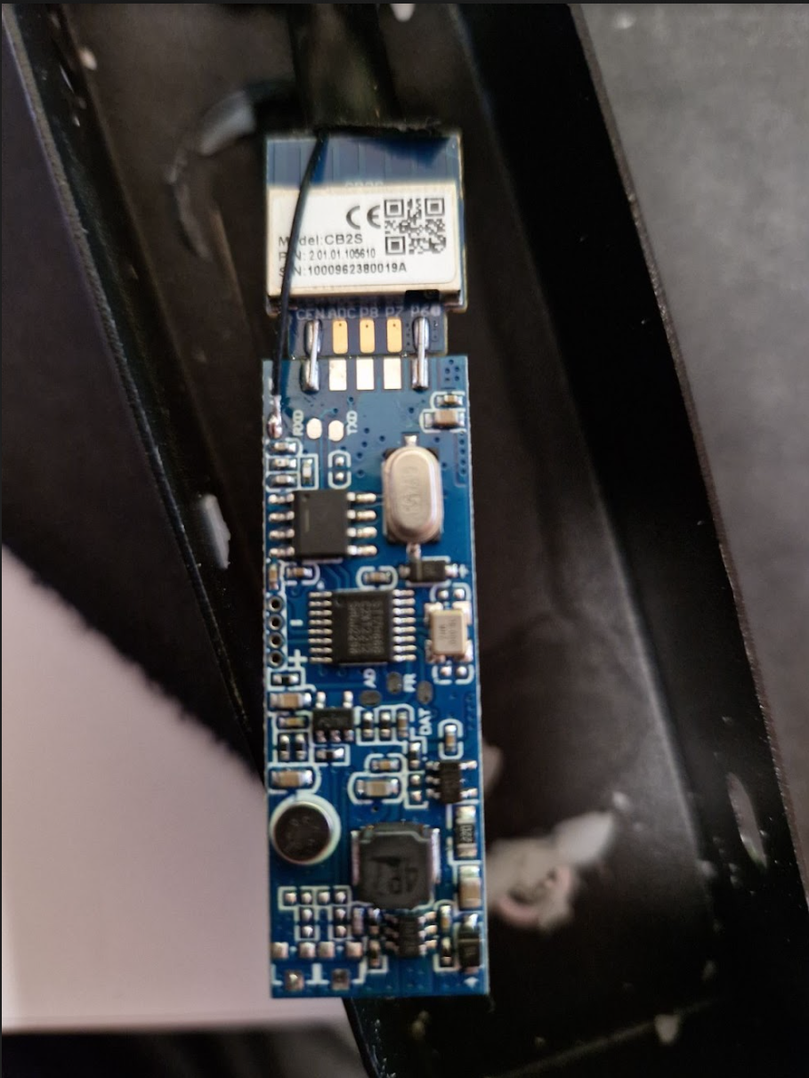

    Device arrived, interesting construction but we can probably work on it.
    It has a TuyaMCU, a microphone(???) and the LED driver is blank - no markings on it so it will be interesting to figure out how to deal with it. Stand by and we will update this post once we get to it.

    Prepare your scope and let's look at the waveforms. This will tell us whether they are WS2812b-compatible or something else.
    You can also later try swapping LED strip with WS2812B....
    Also, your one is CB2S? So BK7231N? So SM16703P driver will work without porting, or at least I hope so.

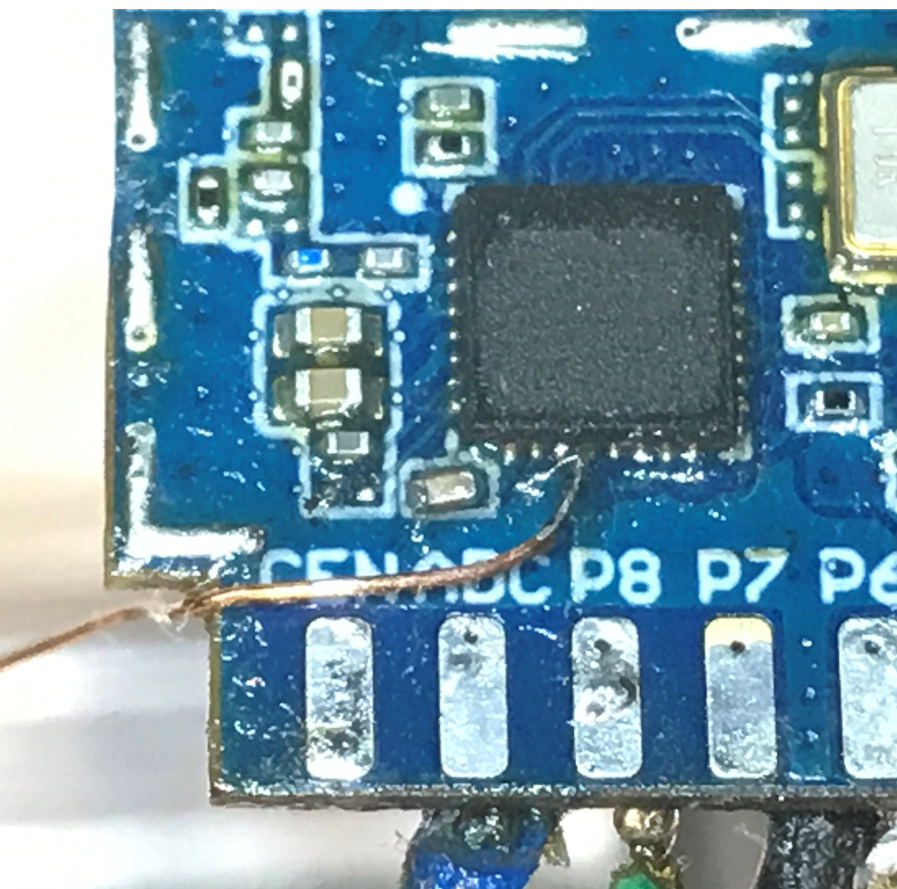

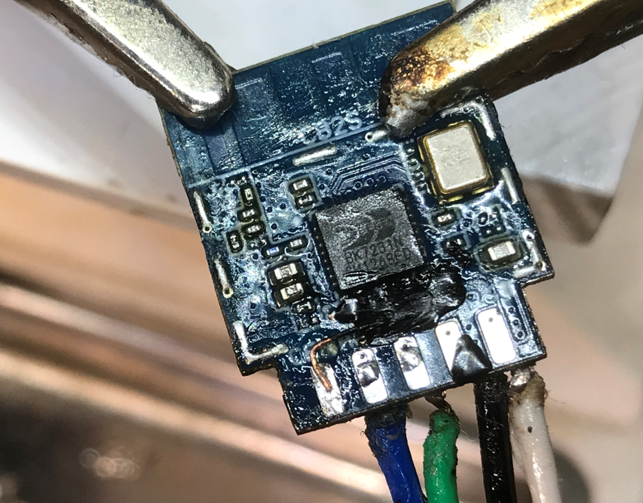

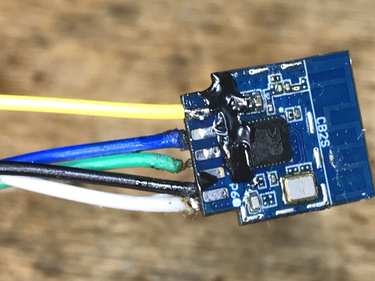

    I am also slowly building up time and equipment to test the "direct" (without TuyaMCU) SM16703P and possibly WS2812B driver, but it's very hard. It has turned out that hardware SPI, required for such driver, is using P16 which is not available on CB3S and CB2S, so I had to solder directly to QFN pin and route out wire myself:
    Close-up of an electronic circuit with soldered wires. Close-up of an electronic module with a thin wire soldered to a pin.
    It is soldered now, soon I will test it with WS2812B and maybe attempt to port driver to BK7231T as well.

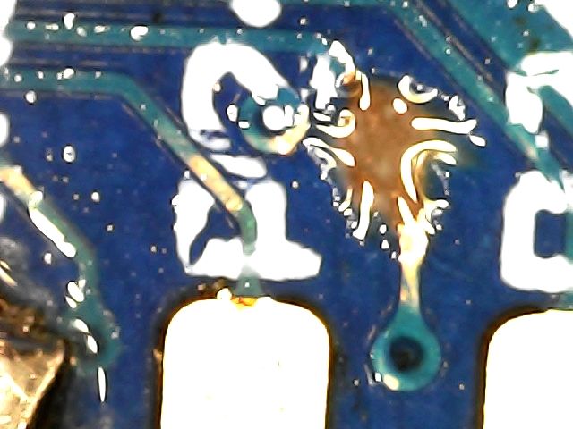

  • P16 rerouted to CEN pad for direct LED control
    #47 20711886
    Posts: 14792
    Rate: 12937
    I have basically first disconnected the trace to CEN pad:
    The image shows a damaged printed circuit board with visible traces, mounting holes, and signs of modification. Close-up of circuit traces on a printed circuit board.
    Then I routed P16 to CEN pad, which is now P16:
    Close-up of a blue PCB with several connected colored wires and CB2S marking.
    I know this is not directly related to the device from this topic (TuyaMCU one), but maybe we could also just skip TuyaMCU there and wire a jumper directly to addressable LEDs... there are many options

    Some small progress in this regard - backing up of original firmware is done.
    • readResult_BK7231N_QIO_led_strip_light_2023-28-8-20-10-21.bin (2 MB) You must be logged in to download this attachment.

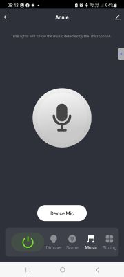

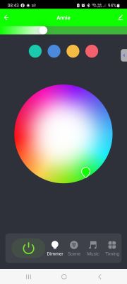

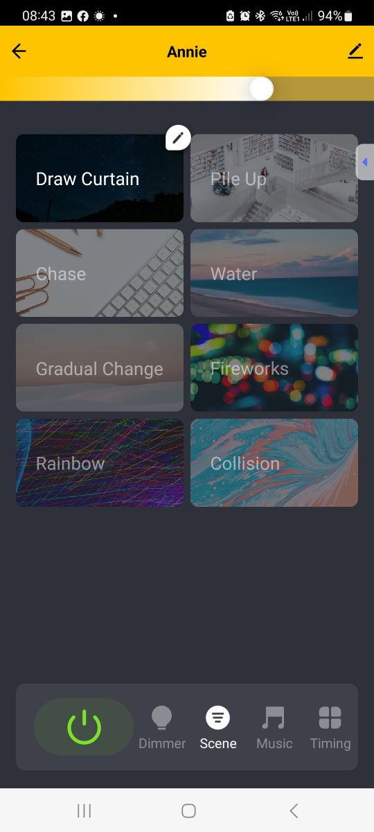

  • Tuya dpIDs and JSON capability dump
    #50 20713960
    MnM1
    Posts: 175
    Rate: 13
    @DeDaMrAz here the dpIDs:
    Dreamlight scene mode(51)
    ON/OFF(20)
    Dreamlight built-in music sync(52)
    Mode(21)
    Strip light pixel number set(53)
    Color(24)
    Scene(25)
    Timer(26)
    Music sync of microphone(42)
    Music(27)
    Adjust(28)
    I also got a JSON file with more information from Tuya IoT - not sure if it helps but here it is in any case:

    @MnM1
    For some reason I am unable to pair my device to TuyaAPP (or SmartLife app) I asked about the dpID's but saw a bit latter that you already posted that.
    How did you device behave on the first power up? Before you linked it to the APP? Did it fast blink red color?
  • #52 20713963
    MnM1
    Posts: 175
    Rate: 13
    Yes, I think I had that issue too initially.
    I asked the vendor for instructions back then, and they sent me a file (see below).
    Basically, the easiest way was to LONG Press the Music Button on the remote - that put it in pairing mode right away.
    • TUYA说明书.pdf (1.02 MB) You must be logged in to download this attachment.
  • #53 20713965
    Posts: 14792
    Rate: 12937
    What features are exactly available in Tuya App for this device? I am curious how much real control over color we have... hopefully @DeDaMrAz will manage to check
  • Music button long-press enters pairing mode
    #54 20713968
    DeDaMrAz
    Posts: 621
    Help: 34
    Rate: 130
    MnM1 wrote:
    Yes I think I had that issue too initially.
    I asked vendor for instructions back then and they sent me a file (see below).
    Basically the easiest way was to LONG Press the Music Button on the remote - that put it in pairing mode right away.
    FFS never in a million years would I guess to hold down the music button... tried holding PWR button, light button....
    Thanks for this tip!
    We can finally do some tests now :)

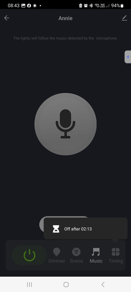

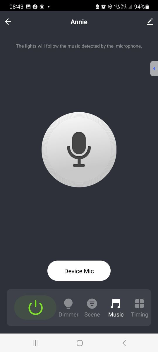

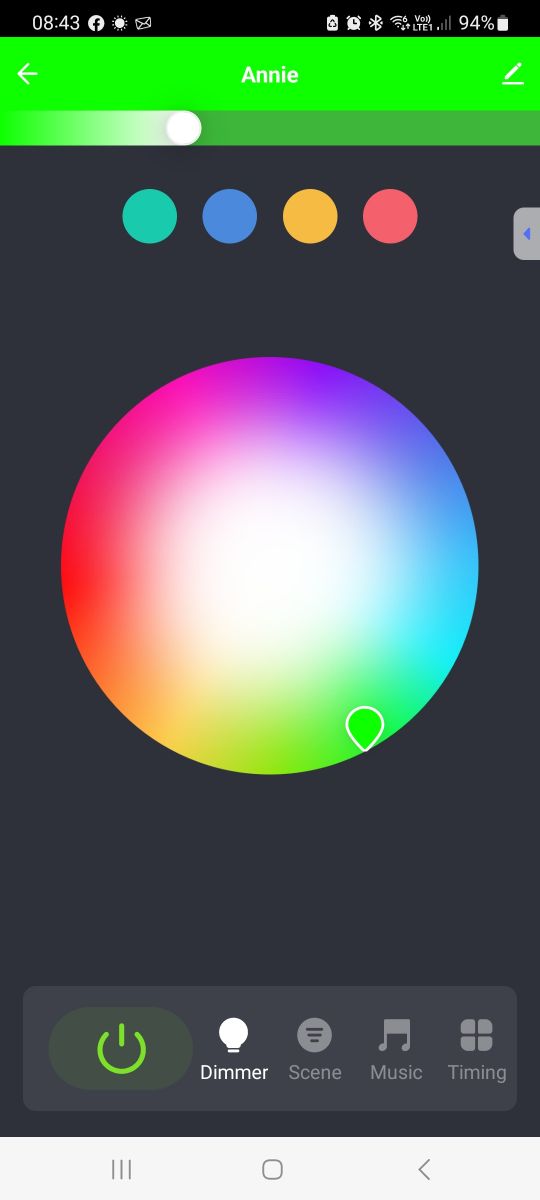

    Once you get into the Tuya app this is what is there:
    Tuya app screen with color and brightness selection. Tuya app interface with lighting scene selection. Tuya app interface with music-synchronized lighting feature. Tuya app interface with a microphone icon.
  • #56 20713971

    So there is only a predefined set of animations?
    With a direct connection to SM16703, we could do much more.
  • #58 20713974
    MnM1
    Posts: 175
    Rate: 13
    In the 2nd picture I posted, I think there are 8 "scenes" - assuming that is what you meant?
  • #59 20713976
    Posts: 14792
    Rate: 12937
    Yes, this is most likely what I mean.
    With a direct connection to SM16703, we could have created our own scenes, fully customizable. With a TuyaMCU in a way, we have to use the scenes that Tuya created.
    We will try both approaches.
  • #60 20713978
    MnM1
    Posts: 175
    Rate: 13
    I see what you mean.
