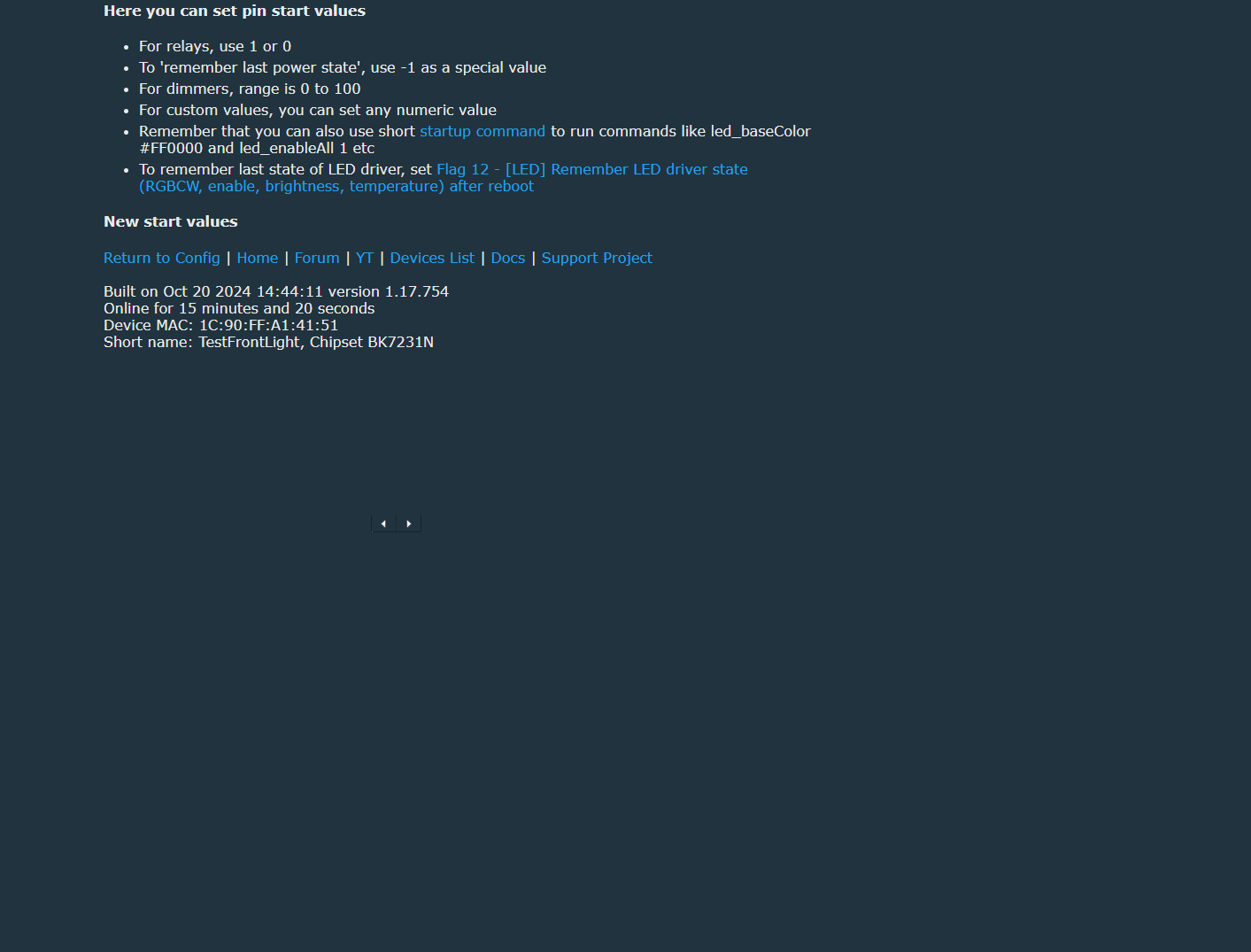

    Added after 2 [hours] 31 [minutes]:
    @p.kaczmarek2 - maybe a firmware bug? No fields displayed under configure startup.
    Screenshot of settings with information on initial pin values.

    This topis seems very long, but isn't it a TuyaMCU device? Startup values on the screenshot are only for Relay channels in non-TuyaMCU setting.

    >>21272313 Yes correct but they are missing. Would like to change the setting I have done a while ago but I cant anymore.

    What is your current pin config? Are you saying that you had non-TuyaMCU relays on your TUyaMCU device?
    You can always use: SetStartValue

    OK the first issue I was trying to sort with configure startup is for the light to be in the OFF position when the device reboots or the power is cycled on it.
    A few times I found the lights on during the day after there was a power cut to the house.
    I did try SetStartValue 0 0 or -1 but it doesn't work. I also have Flag 12 enable and the same result.
    It seems to remember the light color - if I pick blue and I give it a reboot it will turn on on blue.
    Second is not what I posted originally anymore. - either the OBK firmware since my post sorted it or HA updates did it.
    The light does turn on from HA.
    The enabled flags for me are:
    12, 27, 37, 43
    I have enabled 1, 2, 10 and 20 too, but it still turns on after a reboot.

    Ok, I found the source of the issue, we will have to work on it a bit, please be patient.
    EDIT: Quick and dirty way around it for now is to send the OFF command after the reboot, replace the header of your autoexec with this:
    startDriver TuyaMCU
    startDriver httpButtons
    tuyaMcu_defWiFiState 4
    tuyaMcu_setBaudRate 115200
    tuyaMcu_sendQueryState
    tuyaMCU_setupLED 24 1
    delay_s 1
    tuyaMcu_sendState 20 1 0
    Light will turn on for a second on reboot and go back to off state, upon MQTT connection it will update the state in HA (set flag 10 if not set for that)
