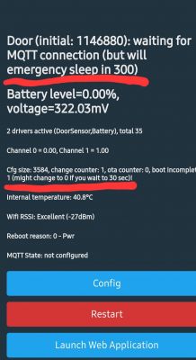

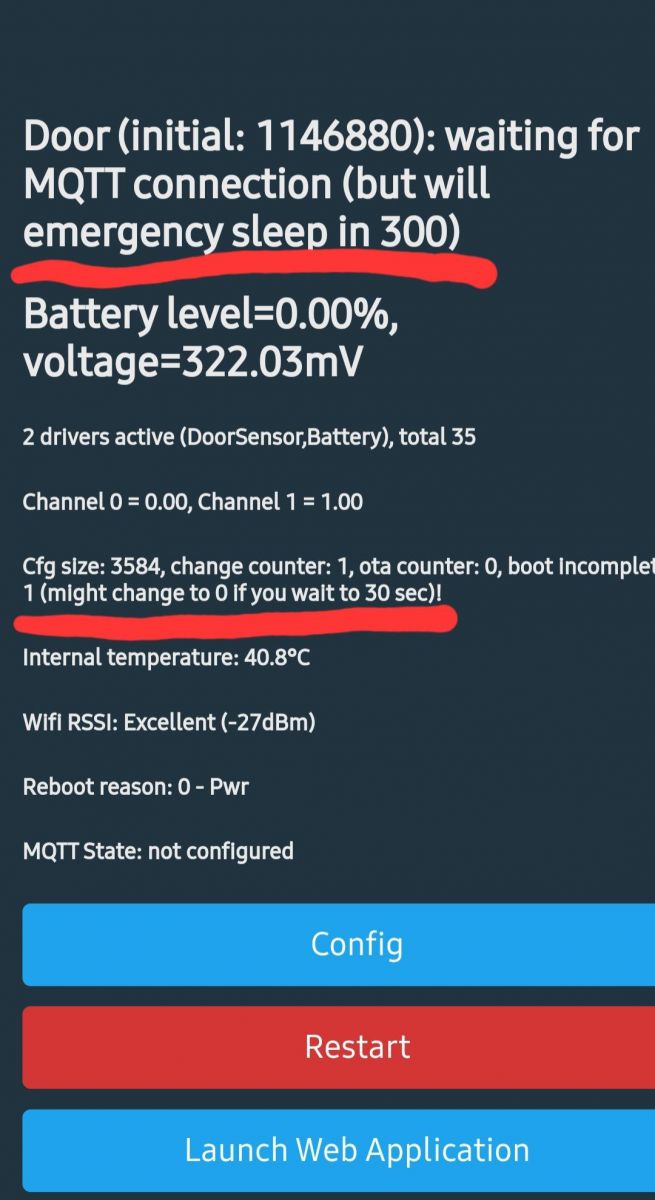

    Hi! I just installed firmware on two of these devices following this guide, but what do these two warnings mean and how can I solve them?
    Error message screen with warnings about low battery level and unconfigured MQTT.
  • #32 21073140
    Posts: 14611
    Help: 654
    Rate: 12622
    First message means that MQTT is missing so sensor is not able to report data to your Home Assistant. It is currently waiting for MQTT to become online but it will emergency sleep soon to save the battery.
    Second message can be ignored, it's normal.

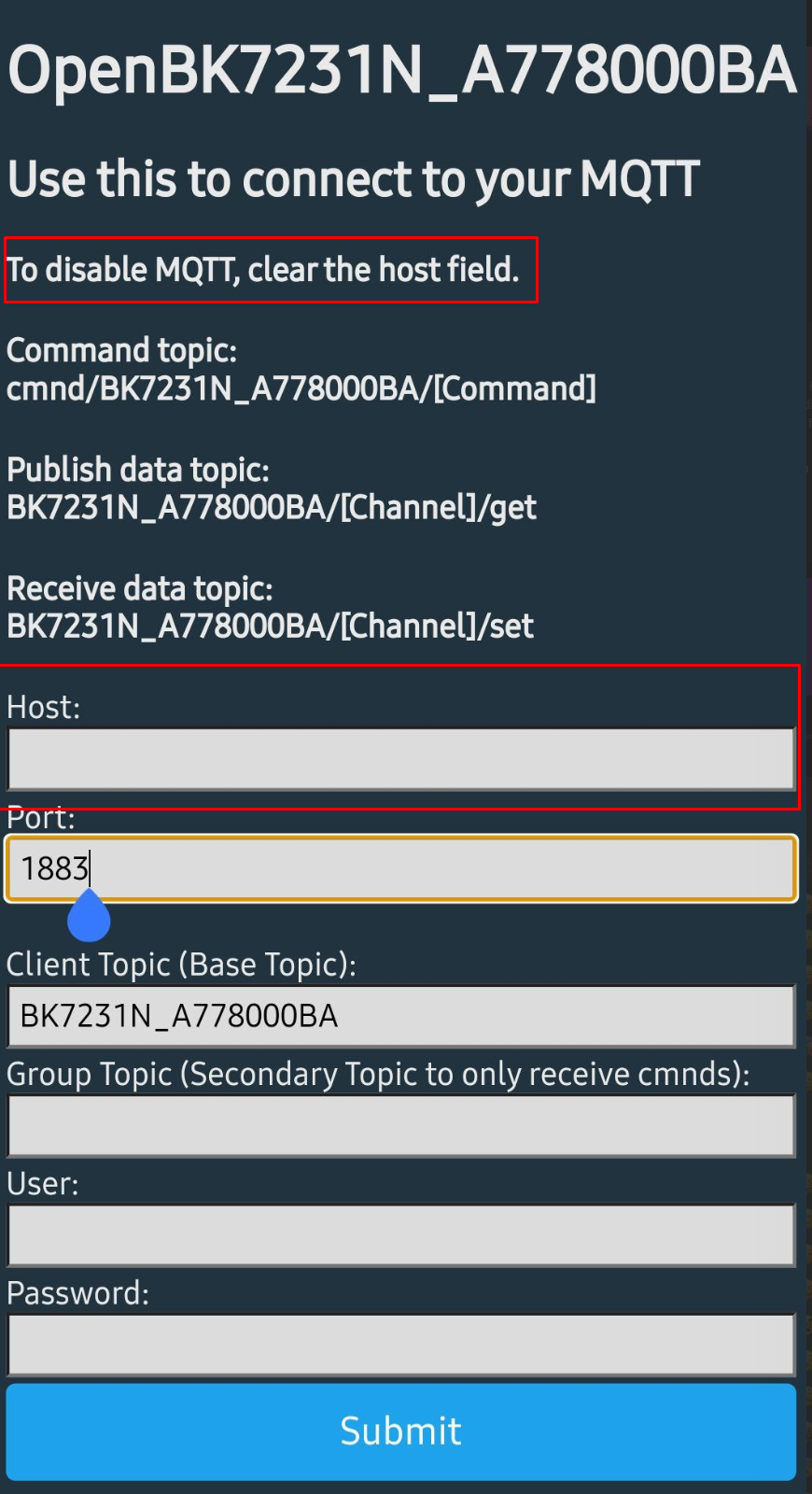

    pincopallino1010
    Posts: 22
    Thank you! How can I disable the first warning (as I will not be using MQTT and home assistant)?
    MQTT settings interface with an empty host field and highlighted warning.
    In the settings I cleared the host field but apparently it's still on :(
  • #34 21077843
    Posts: 14611
    Help: 654
    Rate: 12622
    It's not a warning, it's just instruction. You have already disabled MQTT.

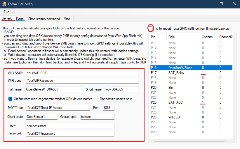

    pincopallino1010
    Posts: 22
    OK so there is no risk of it going off since there is that countdown...
    In any case, I should have already followed all the steps, is there by any chance some configuration to be applied to limit the power consumption?
    Or am I good to go with these configurations?
    User interface of the FormOBKConfig application with WiFi and MQTT settings.
    Flags 10, 11, 35 and 37 + startup command: "backlog dstime 30"
  • #36 21080933
    Posts: 14611
    Help: 654
    Rate: 12622
    You can enter:
    PowerSave 1
    in either short startup command (use backlog for multiple commands) or in autoexec.bat

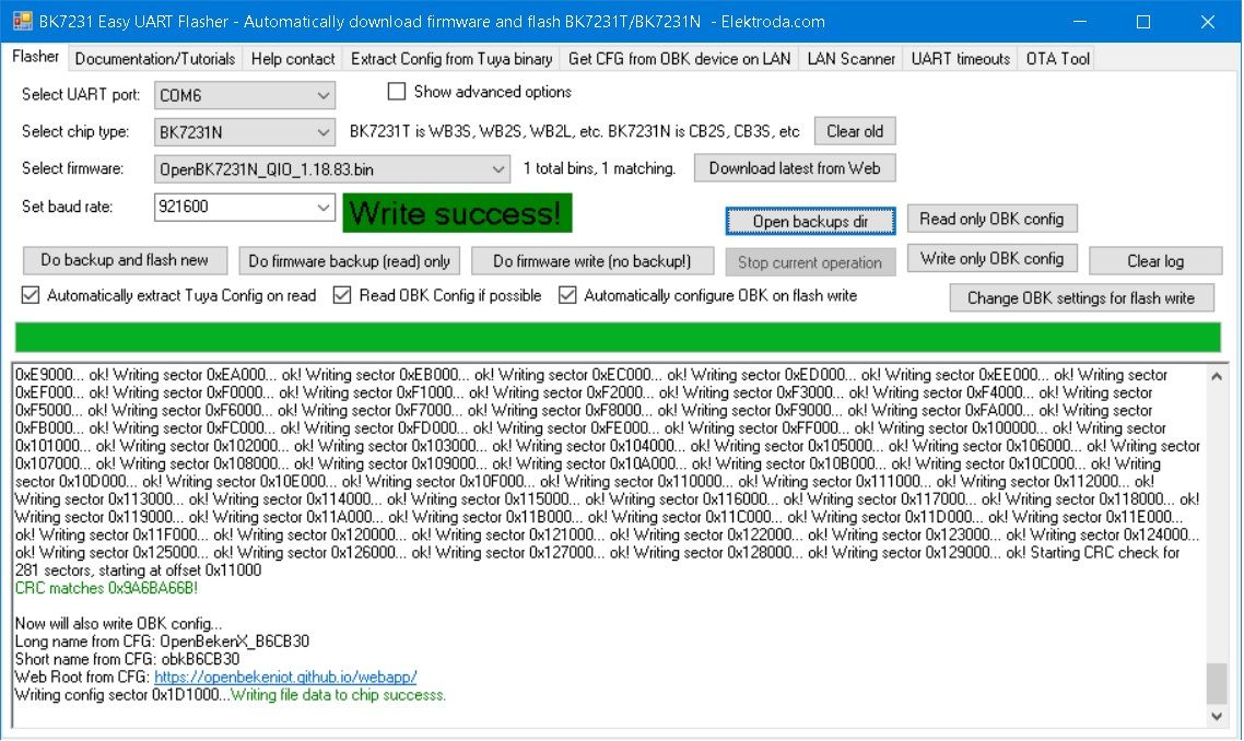

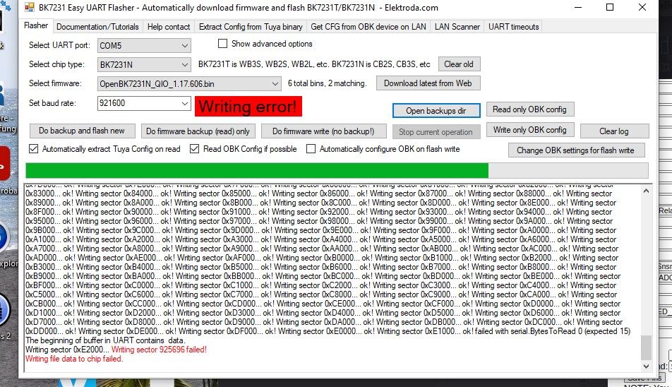

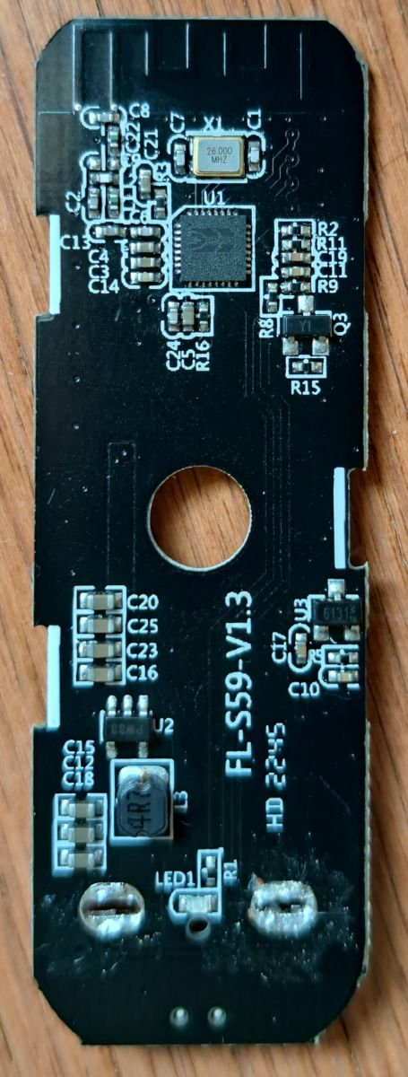

    Help: 654
    Rate: 12622
    Well, by "emergency" I mean it will sleep without reporting via MQTT because there is no MQTT connection. The sleep itself is the same in both cases, no matter whether it's an emergency or not. So, it will still wake up on door event after emergency sleep and it will try to report state via MQTT again...

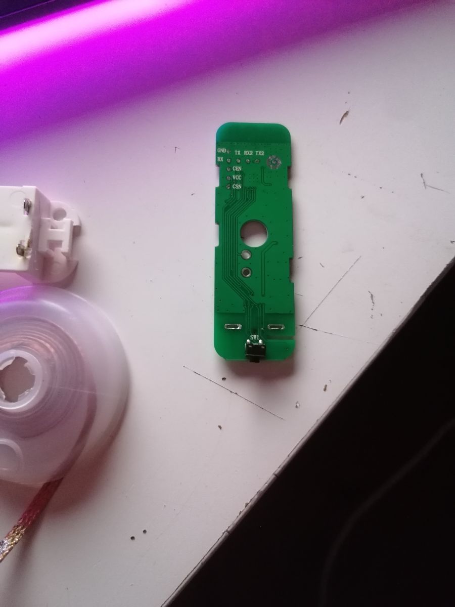

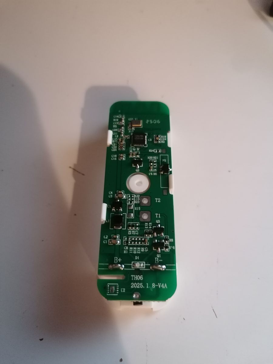

    Handlers addChangeHandler Channel1 == 0
    SendGet http://192.168.1.10:9876/?imsi=0
    Will it still send the open/close event even if he is sleeping?
    I have a web server listening on that port that receives events from the sensor and handles them via a python script (in my case it sends messages via telegram bot)

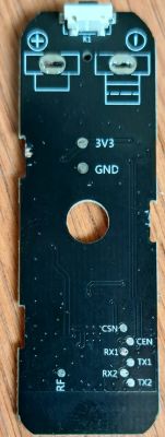

    I have a door sensor like the board in post #18, but a CBU, not a CPU-NL. Trying to write the new firmware after a while I get always a writing error at sector 0xE2000. I tried several baud rates, but it is always the same. Has anyone an idea what is going wrong? Reading the old firmware was ok, but I got no OBK data. Screenshot of BK7231 Easy UART Flasher program with firmware writing error.
  • #43 21274307
    Posts: 5052
    Help: 438
    Rate: 893
    What does your cabling look like and how are you powering the device?

    >>21274326 I found the solution now, there was a hint in another thread. The problem was the USB-Serial converter. I changed it and it was working.
    Hinzugefügt nach 2 [Stunden] 11 [Minuten]:
    >>21274970
    After the door sensor is working, i found a small problem. On the board is a step up converter from battery voltage to 3.3V. This device is not enabled while the system is active. On the original software this is working. How can i fix it?
    Hinzugefügt nach 2 [Stunden] 34 [Minuten]:
    Chip Enable of the step up converter is connected to Pin22 (Hardware Pin 10), high active.

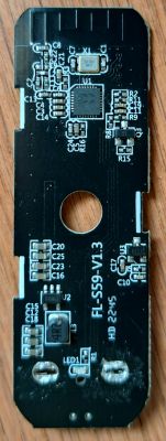

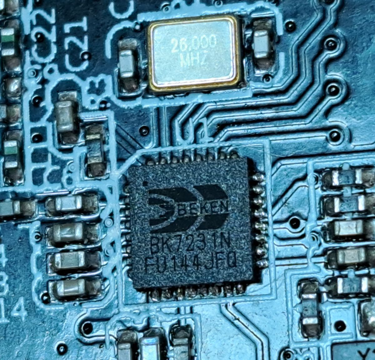

    I have very similar Door Sensor, also bought it on AliExpress, and also it was described as "AUBESS Door Sensor"
    WiFi door/window sensor by Aubess, consisting of two white components.
    It is also BK7231N FU144JFQ version but the board is FL-S59-V1.3 HD 2245
    I was lucky that the cloudcutter method worked for it so I was able to flash it with OpenBeken without even opening it. The problem was that the settings for pins didn't work so I was playing with different options found for similar sensors... and at some point unfortunately my sensor stopped booting.
    I may have bricked it but I decided to try flashing it again. Because it is not booting anymore this time I have to do it the hard way by connecting all the pins etc. as described in this topic.
    The flash was successful but unfortunately the device is still not booting (the LED never blinks on it, not visible on WiFi, no access point).
    Does anyone have any idea how can I make it boot again? Or maybe it is really bricked for good and nothing can really be done at this point?
    Here's the device's board pictures:
    Close-up of a Bekcen BK7231N chip and 26 MHz quartz oscillator on a printed circuit board.
    A printed circuit board with electronic components, visible processor, capacitors, and resistors.
    Printed circuit board with connector, labeled terminals and tracks, top view.
    Here's the flashing result screenshot:
    BK7231 Easy UART Flasher window with Write success! message on a green background.
    And the full flash log attached.
    • flash_log.txt (18.54 KB) You must be logged in to download this attachment.
  • #47 21520642
    Posts: 14611
    Help: 654
    Rate: 12622
    Maybe you have a starting script that turns on deep sleep on start? But that would still give some log output on TX2...
    Or what do you mean by "not booting", are you checking TX2 output?
    Anyway... Make a full 2MB backup of current device state (just in case), and then try to flash full 2MB dump from , well, any device (with same chip), you can get dumps here: https://github.com/openshwprojects/FlashDumps
    Then check if it boots, later overwrite it with fresh OBK firmware.
