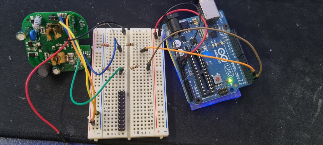

    Posts: 20
    Issue was resolved by throw away crappy Arduino UNO, i flashed BL602 with ESP-01 flasher tool.
    Now i have working BL602 on my own network but i don't know what next. I tried to apply webconfig as stated on

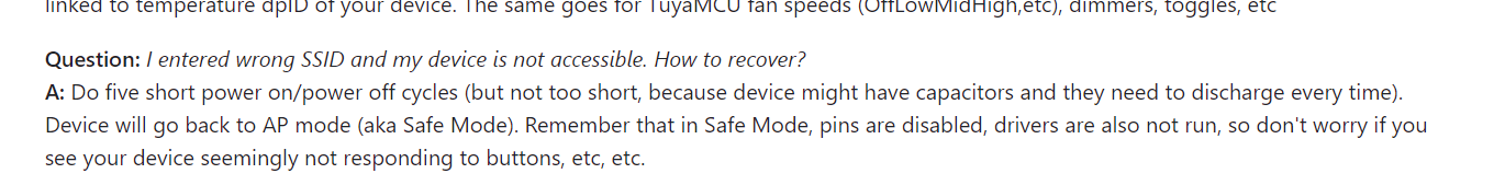

    I made a mistake in typing in the seid of my wifi.
    What can i do to get Connecticut to my bl602?
    Best regards
  • #334 20643555
    Posts: 14770
    Rate: 12913
    @Maniac2002 you can power off/on device 5 times to enter safe mode, see FAQ:
    https://github.com/openshwprojects/OpenBK7231T_App/blob/main/docs/faq.md
    Tasmota replacement for BL602, programming, pairing with Home Assistant, now with OTA working!
    @pdrobek templates can be applied in the Web App, or you can just set pin roles manually in Config

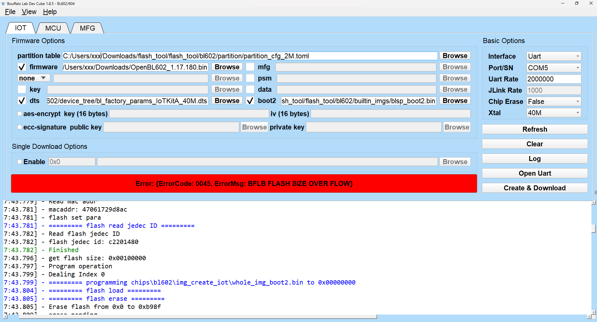

  • BL602 flashing fails with flash size overflow
    #341 20653505
    shopuk
    Hello and welcome,
    I bought an LED strip with a BL602 controller, I read the entire thread in this section, but unfortunately I am not able to properly program this system. The program version 1.4.8, included in the thread as verified, crashes with an error, while version 1.8.5 ends the programming process with the error "program chips\bl602\device_tree\ro_params.dtb file to 0x001F8000, but it overflow with flash size 0x00100000". Log file bl602.txt (20.17 kB)You must be logged in to download this attachment. attached and a screenshot with settings. Could someone tell me what I`m doing wrong?

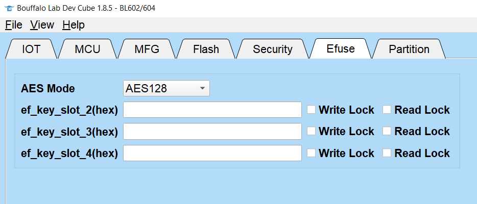

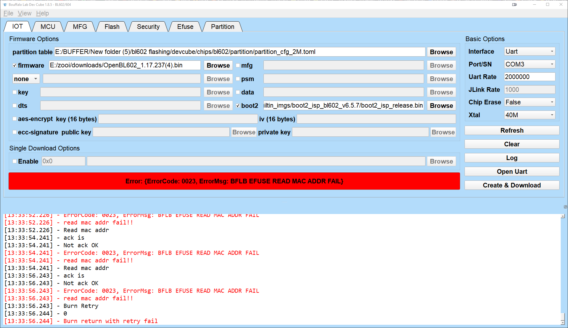

  • BLDevCube 1.8.5 and BL602 SDK download links
    #344 20658015
    Posts: 14770
    Rate: 12913
    Hello @shopuk . I see you are using BlDevCube 1.8.5. I haven`t used this version, although others have reported that they managed to upload a batch using it.
    Search this topic for information on how they did it or try using the version I had.
    Here you have a copy of the BL602 SDK from BlDevCube that I used:
    https://github.com/openshwprojects/OpenBL602/tree/master/tools/flash_tool
    You can download them here:
    Right click on Code and "Download Zip".
  • #345 20658033
    shopuk
    Hello and welcome,
    Unfortunately, in the version you provided, the following error occurs during flashing:
    [21:40:09.488] - {"ErrorCode": "0003","ErrorMsg":"BFLB LOAD HELP BIN FAIL"}
    Regards
    Added after 3 [minutes]:
    @p.kaczmarek2
    Sorry, there was an error in the previous post: [21:43:49.944] - {"ErrorCode": "003D","ErrorMsg":"BFLB FLASH MATCH TYPE FAIL"}
    Regards

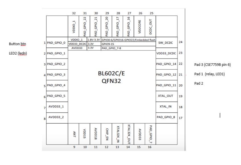

    fcopurico
    Posts: 6
    I remember that I was adding some UART features but ultimately I wasn't been able to check them, as I don't have that Sonoff BL602 device at hand. So, someone would have to test them. It shouldn't be that hard, especially now that we have working OTA for BL602.
    @p.kaczmarek2 , @jbrande, @davidcpurdy @bxwen19
    I was give as a gift a package of 4 S40. Since then I been reading this thread with attention.
    I do not know an easy way to break apart the plastic housing-case. If any one have a good idea please help. I guess tomorrow i will hand saw from the side to get to internal boards unless I see any Ideas.
    I am offering myself to serve as a tester. Never work with BL602 nor any other RISC-V, but had experience with other micros; ARM, MIPSEL. Motorolla, etc.
    From what I have read, we need to test communication between cse7759b/CSE7766 and BL602
    From page 6 bxwen19 posted
    Pinout diagram of the BL602C/E QFN32 chip with labeled pins and connections to external components (button, LED, Pad 1, Pad 2, Pad 3).
    Close-up of S40 WiFi module circuit board showing labeled pins GND, 21, 22, and 5V, visible traces, and board markings.
    Middle pin is connected to pi 20 (GPIO11)
    button->GPIO0
    LED2-> GPIO1
    relay = LED1 ->GPIO11
    So from bxwen19 it seems "S40 WiFi module" have pin out using GND, 21, 20, 22 & 5V!! I guess I will have to check once I open the case.
    Asuming it is in fact serial data, It will be nice to check if we can see the signal from "cse7759b" and the determine boud rate and log data before we program BL602. I know working it hot can be dangerous but it may be the step is required.
    @p.kaczmarek2
    Witch pins are RX1 and TX1 on BL602? I guess once I crack the plastic case I will be able to check.
    But from https://lupyuen.github.io/articles/flash#uart
    UART Port at /dev/ttyS0, on [ GPIO 7/ Pin 16 ] (rx) and [ GPIO 16 / Pin 27 ](tx)
    UART Port at /dev/ttyS1, on [ GPIO 3 / Pin 4] (rx)and [ GPIO 4 / PIN 5 ] (tx)[
    Then why bxwen19 reference them as [ 21, 20, 22 ] ???
    I see from image bxwen19 wrote "GPIO 14 / Pin 22" goes to "Pad 3 ( CSE7759B Pin 6 ). HAHAHA this may mean CSE7759B may not use UART!!! Or in the other hand from https://lupyuen.github.io/articles/uart#initialise-uart-port
    it may seem that Pins for UART can be manually programed !!
    Please confirm or advise.

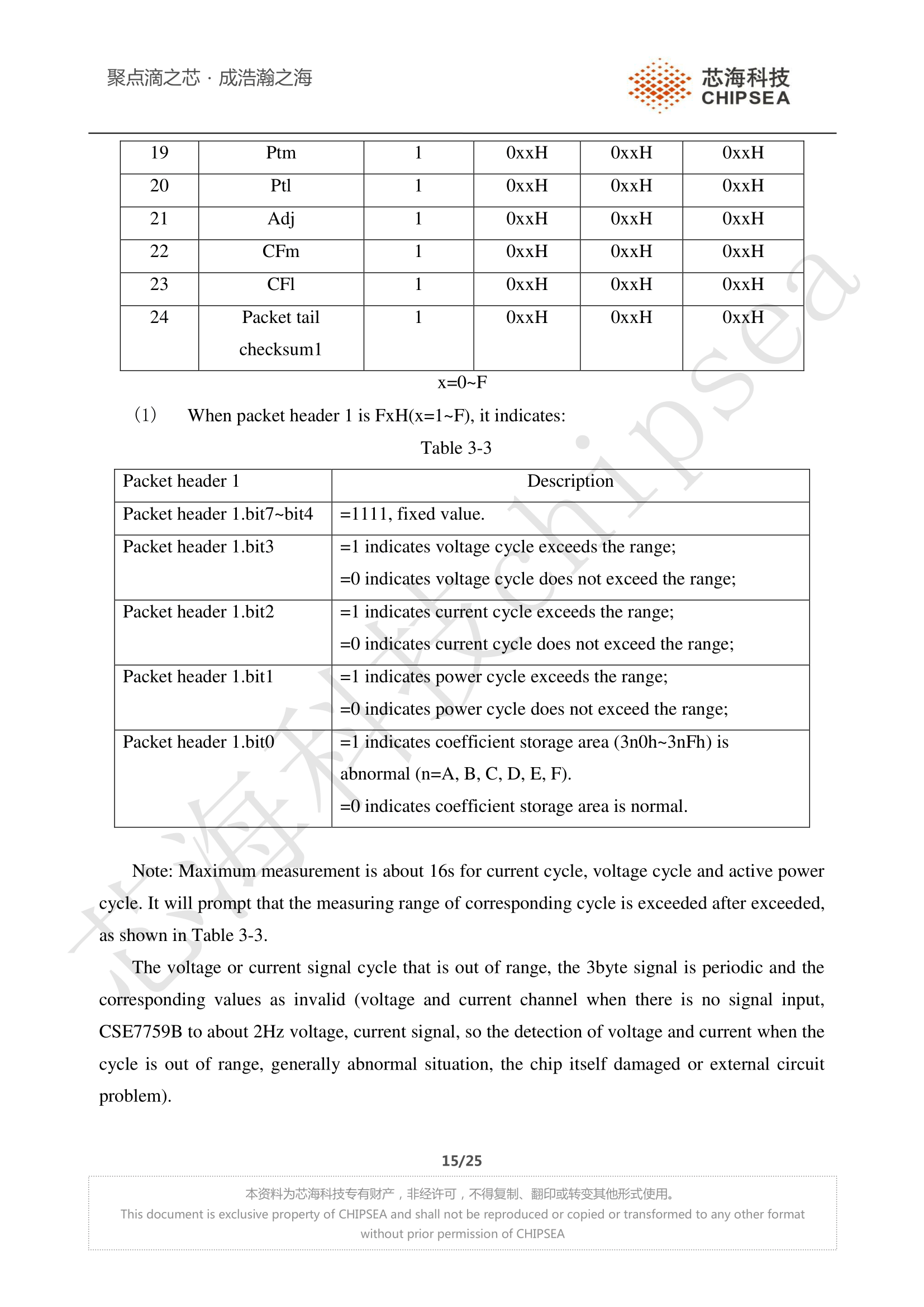

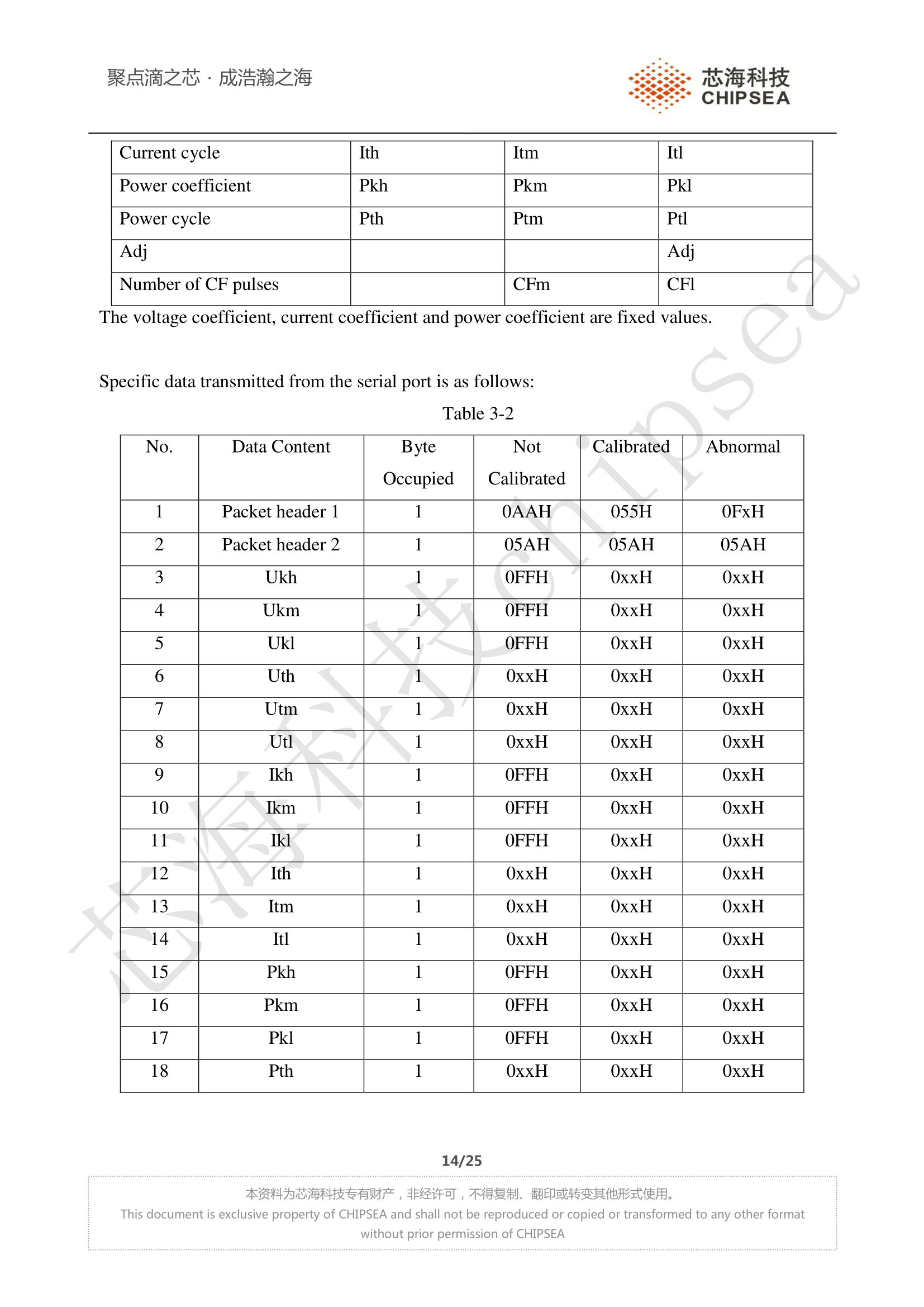

    CSE7759B is a calibration-free electric energy measuring chip.
    At present, this serial port only supports baud rate of 4800bp
    Serial port Protocol is at page 13 of CSE7759B.PDF 3.4 Serial Port Protocol In general a 24 byte per stream

    #348 20682798
    fcopurico
    Posts: 6
    I guess people in vacations. Hope to see some one else soon. Could not do much today. I hand saw it open. Corroborated the Right side of the table. Did not wanted to remove WifiBoard. Hopefully I will be able to install new firmware and detect pin-out on the left side.
    BL602.pins I did corroborated this side
    as per
    bxwen19
    I need to check
    it myself
    				GND		<==> WifiBoard.PAD1 <==> 	GND
    BL602.pin22			(RX1) 		<==> WifiBoard.PAD2 <==> 	R17 <- CSE7759B.pin6(TI)
    BL602.pin20			(TX1)		<==> WifiBoard.PAD3 <==>	Seems not connected
    BL602.pin21 			R21->LED1	<==> WifiBoard.PAD4 <==> 	R1 -> Q1 -> K1 Relay
    				5V 		<==> WifiBoard.PAD5 <==> 	5V
    				R22->LED2
    Note: as per specs UART CSE7759B.pin6(TI) is 5V.  But It only pass thru R17 ( 1Kohm ) to be received as
               3.3V TTL by BL602 !!!

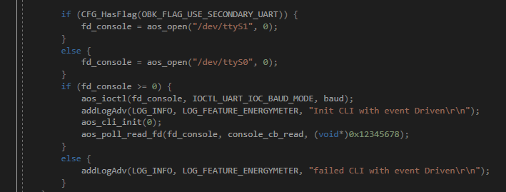

  • Use OBK_FLAG_USE_SECONDARY_UART for CSE7766 on BL602
    #349 20682807

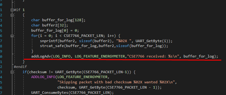

    Posts: 14770
    Rate: 12913
    Hello, as far as I remember, the UART pins on BL602 are configurable. For CSE7766, the alternate UART is used.
    You need to set the flag for alternate UART: OBK_FLAG_USE_SECONDARY_UART, which is 26, see here:
    https://github.com/openshwprojects/OpenBK7231T_App/blob/main/docs/flags.md
    Then reboot, and try:
    startDriver CSE7766
    Then check if anything is received:
    A code snippet in an editor showing a highlighted line logging CSE7766 data reception.
    This will print UART data, no matter if checksum is correct or not.
    The UART selection seemed to be done at compile time in DTS files:
    https://www.elektroda.com/rtvforum/topic3889041-240.html#20366504
    but I didn't have a device to check is it working. There are two UARTs available:
    - "/dev/ttyS0"
    - "/dev/ttyS1"
    In code, I can only select between them:
    C code snippet with a condition checking a flag and selecting UART port /dev/ttyS1 or /dev/ttyS0.
    It would be easier for me if I had that device at hand.
    CSE7759B seems similar to CSE7766, packet is also 24 bytes long, header seem to match:
    Table describing the bits of packet header 1 and a list of packet data fields from a CHIPSEA technical document. UART data format table from CHIPSEA showing packet headers, byte counts, and calibration statuses.
    If you want, you could try to power the device from safe, isolated, 5V (inject 5V before LDO, not directly to WiFi module!!!) and try to capture packets with UART.
    Or you could use isolators like ADuM1201 to get capture with mains connected in a safe manner.

    Now regards RX1 receiving CSE7759B output. I hook to RX1 at boudrate 4800 and clearly see the CSE7759B output signal.

    This UART data capture is useful. I can later try to manually plug it into our CSE driver and see if it works.

    #353 20723265
    godofal
    Hi, I'm stuck with a bl602 powered smartplug. The exact module on this device is this one. The issue is that whilst trying to write i get an error regarding the mac adress:
    Screenshot of Bouffalo Lab Dev Cube software showing an error message related to MAC address.
    I'm using a newer version of devcube, a newer release of the firmware, and an arduino uno and a few resistors to drop 5v to 3.3v. I have to reset the chip by shorting chip_EN to gnd before I can flash, but after that it seems to communicate well except for the mac address part.
    The image shows a smart plug connected to a breadboard and an Arduino Uno.
    the devcube logs:
    Spoiler:

    The error does not seem to appear in google or if I search this forum. I've little to no experience flashing chips like this so I would presume a simple mistake on my part, but I'm incapable of figuring out what it might be. Any help would be appreciated.

    Hello. In efuse tab, is it possible to skip writing the MAC efuse and just update the firmware bin?
  • #355 20723275
    godofal
    Efuse tab in Bouffalo Lab Dev Cube 1.8.5 with AES settings.
    This is the efuse tab, i'm not sure what this means.
  • #356 20738023
    godofal
    Followup on the above: my ch340 based programmer finally arrived and it flashed just fine now, 0 errors. Just like the earlier poster.
    If it is possible to do this with an uno, I don't know how. I'm gonna go ahead and say it's not worth the effort figuring it out, and echo everyone else in recommending a ch340 programmer.
