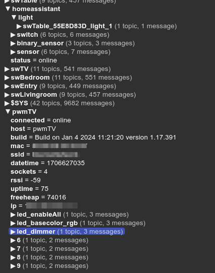

    Hi there!
    I'm having some issues with OBK autodiscovery related to HomeAssistant.
    I suppose I'm doing something wrong... or do not actually understand how things (should) work in OBK so after quite some trial and errors I decided to start bothering here...
    Hopefully it's just my wrong doing (not understanding) and not something else...
    What am I trying to accomplish:
    - define "functionalities" in OBK web config (define pins, pwms, buttons...)
    - issue HA Autodiscovery from OBK to get the device/entities shown/configured in HomeAssistant
    Some basic options seems to work OK (declaring pin as Button + declaring pin as Relay for the same button produces a "switch" in HA; declaring a pin as "dInput" also produces a "binary sensor" in HA...) so this is "ok", I suppose.
    The issues start with PWM lights/dimmers.
    I have a 4-channel dimmer where I would like to use each channel as a simple Dimmer - just "brightness" for four different lights.
    So, configured pins 6,7,8,9 as PWM and set the relevant pins "channelType" to "Dimmer" through webApp
    But... after autodiscovery I get a single "light" device in HA with the RGB, color... properties instead of 4 simple "dimmers".
    I thought the problem could be that OBK is by default taking consecutive "channels" as RGB elements and so "publishes" just one light... so I configured the pins as 6,7,8,9 as PWM1, PWM10, PWM20, PWM30 hoping to get 4 separate "lights" and... it half-worked!

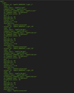

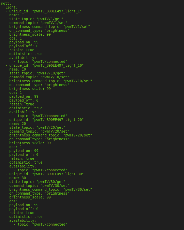

    In the OBK HA Config the configuration is nicely shown BUT the autodiscovery in HA has NO LIGHTS whatsoever?!
    Screenshot of MQTT configuration for four lights in HomeAssistant.
    Screenshot of MQTT configuration for a home device with four channels.
    Also... the channels in MQTT are "just something" (6,7,8,9) instead of 1,10,20,30 as they should be. Also, the "led_dimmer" etc is just ONE instead of for each channel (as I understand).
    How can I configure the OBK device to autodiscover 4 (simple) dimmers in HA?
    I know I could copy-paste the suggested HA config in config.yaml but that is ugly and requires constant edits/corrections on two places (device+config file)
    The generated HA config (or manual changes) IS NOT sent to HA by "start HA autodiscovery", right? It's there just for "copy to clipboard", right?
    This is simply not supported, as I have never seen any such device in my life, and I already did a hundreds of teardowns:
    I can look into adding it, but as I said, the idea is that HASS discovery is for simple devices, and for custom functionalities you can do Yaml by hand.
    The code currently takes first PWM channel and assumes the consequent channels are for the next colors.
    I may look into it and add that possibility if you think that may be useful.
    You are correct, generated HA config is a legacy thing and it's not in the synchronization with Discovery. We may totally hide it in the future or move it to the Web App.

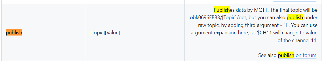

    Is there any way of using "variables" (other than channels) in PUBLISH/SUBSCRIBE commands in OBK scripts/handlers like for example, to use "short name", "full name", "mqtt base topic"? This way the script could be the same and would automatically use the correct names/topics for MQTT commands. (after making event handlers/scripts for btn presses or dimmer handling etc)
    If you use a publish command, it will automatically publish under given devices short MQTT name:
    Screenshot of a table with instructions for publishing data using MQTT.
    Ah, yes... I missed that part... that it by default uses the "right" base topic... that helps... BUT...
    is it possible to use variables in the MQTT config "Client topic (base topic)"?
    I mean, to set it to be "$ShortName" (or similar) to always track the changes of device config?
    Again - to not have to check/modify the "same" thing at different places.
    Any yes, to use this "baseTopic" in other places like publish custom autodiscovery? (because you have to publish discovery data under homeassistant/<type>/<name - baseTopic>/config and having to change this everywhere when you rename the device is not "nice")
