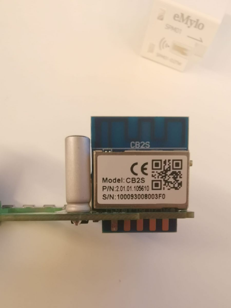

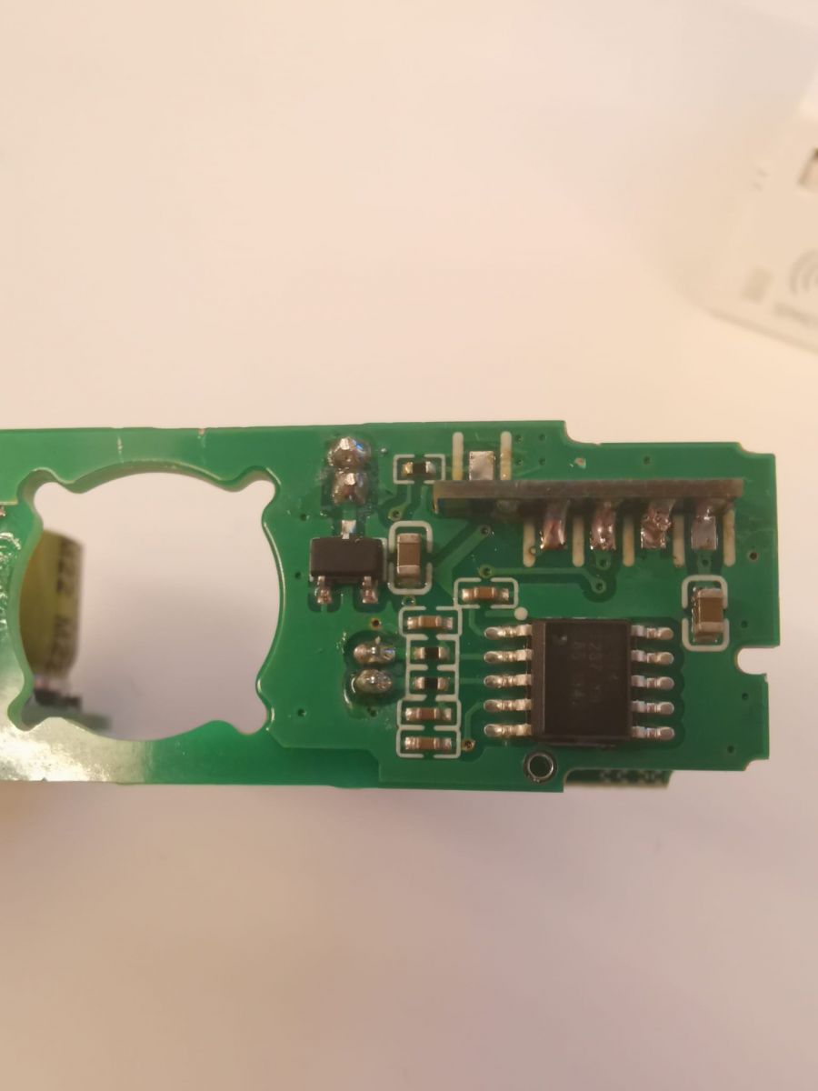

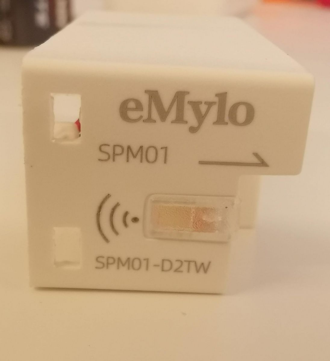

    Hi,
    I ran across a new device I could not find any template for.
    It is called eMylo SPM01-02TW and can be bought on Amazon: https://www.amazon.de/dp/B0CG3BF8XG
    Close-up of a circuit board with a button labeled SPM0103V2. Close-up of a circuit board with electronic components. CB2S module with visible model and serial numbers. eMylo SPM01 device with visible button and LED.

    It is equipped with a CB2S and a BL0942.

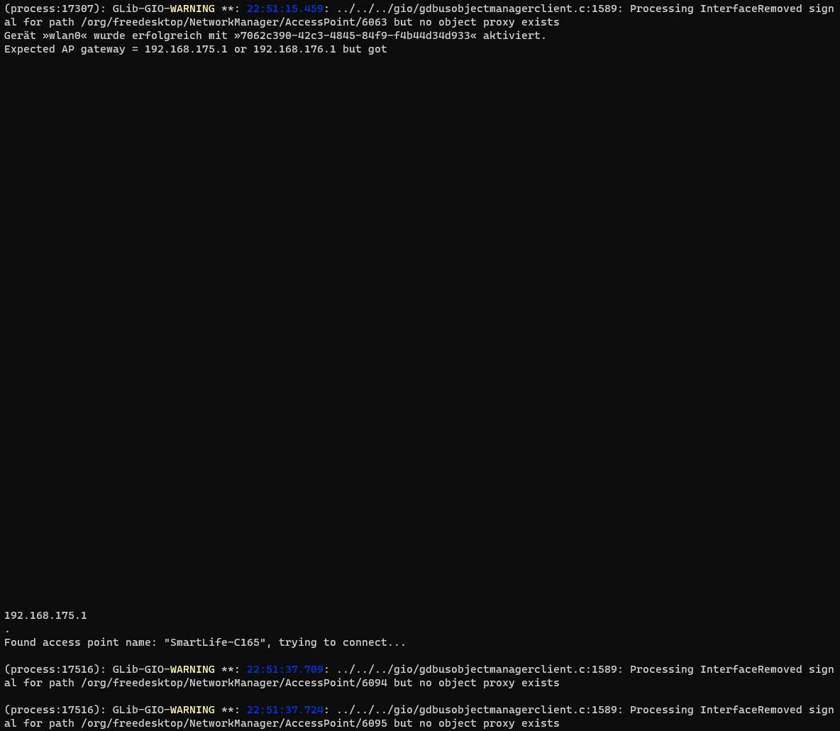

    Flashing was extremely challenging for a novice, since there was no template and tuya-cloudcutter only allows flashing for specific templates (https://github.com/tuya-cloudcutter/tuya-cloudcutter/blob/main/INSTRUCTIONS.md#flashing-custom-firmware). You cannot just flash a firmware file without selecting a template...
    I had to try dozens of templates to finally start flashing. Then I ran across the error:
    "Expected AP gateway = 192.168.175.1 or 192.168.176.1 but got
    192.168.175.1
    The error stayed and added an extra free line every time, resulting in blank screens I had to scroll to read the error.
    Screenshot of error messages during an attempt to connect to Wi-Fi access point.
    However, I was finally successful flashing OpenBK with the tuya-generic-pj-mgw1103-power-meter-with-ct and the parameter -r:
    "sudo ./tuya-cloudcutter.sh -p tuya-generic-pj-mgw1103-power-meter-with-ct -f OpenBK7231N_UG_1.17.268.bin -r"

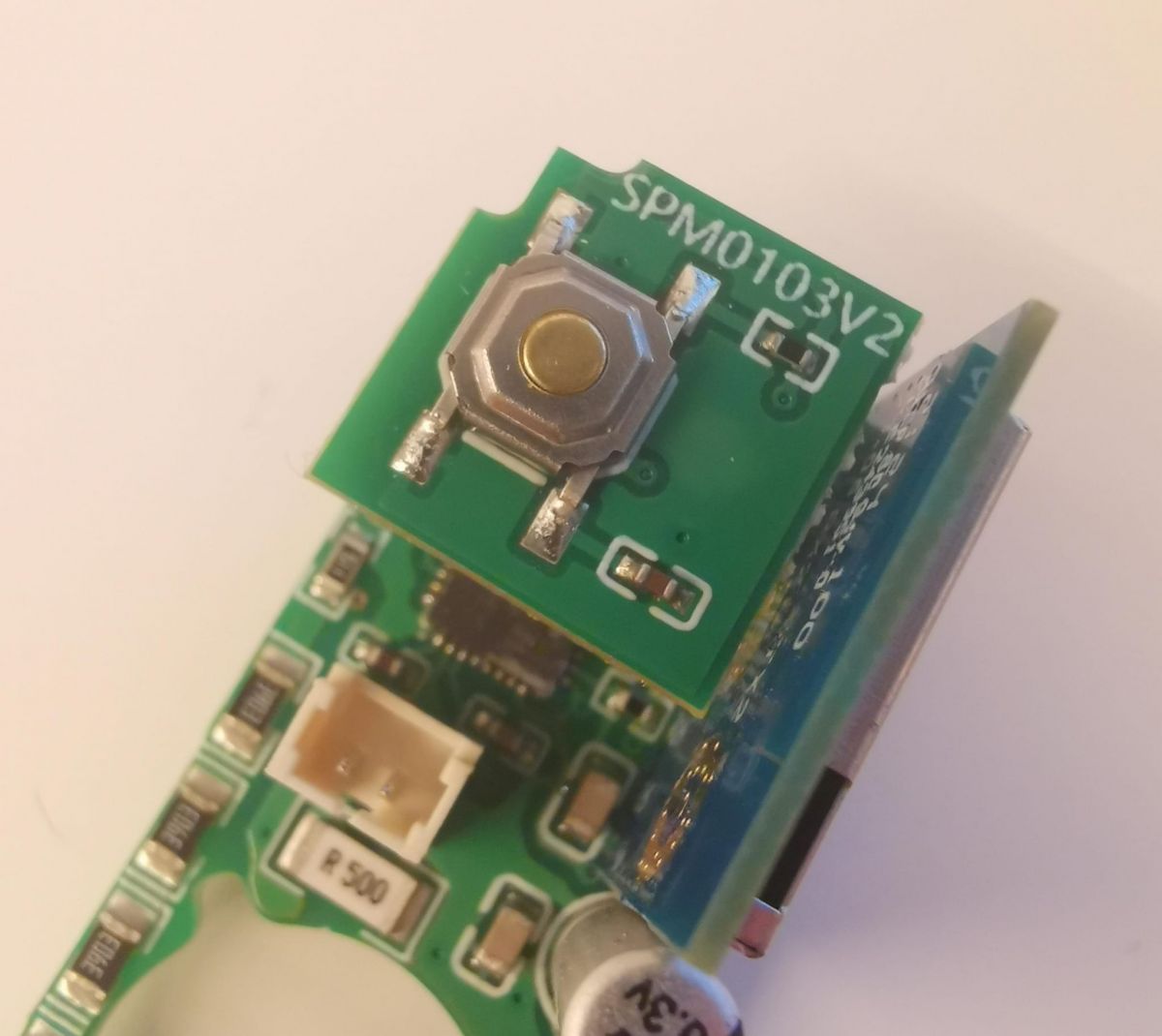

    The device has a button, a LED, and a BL0942, and this is where my knowledge ends. I cannot select the BL0942 in the GPIO drop-down menus since it is not listed. And I don't know what is on what GPIO.
    Can someone help me find out more? I will be happy to share.

    Hello, BL0942 is always using the default UART1 port so there is no need to select GPIOs for that.
    For other pins, like a relay, you can use GPIO doctor if template config extraction fails.
