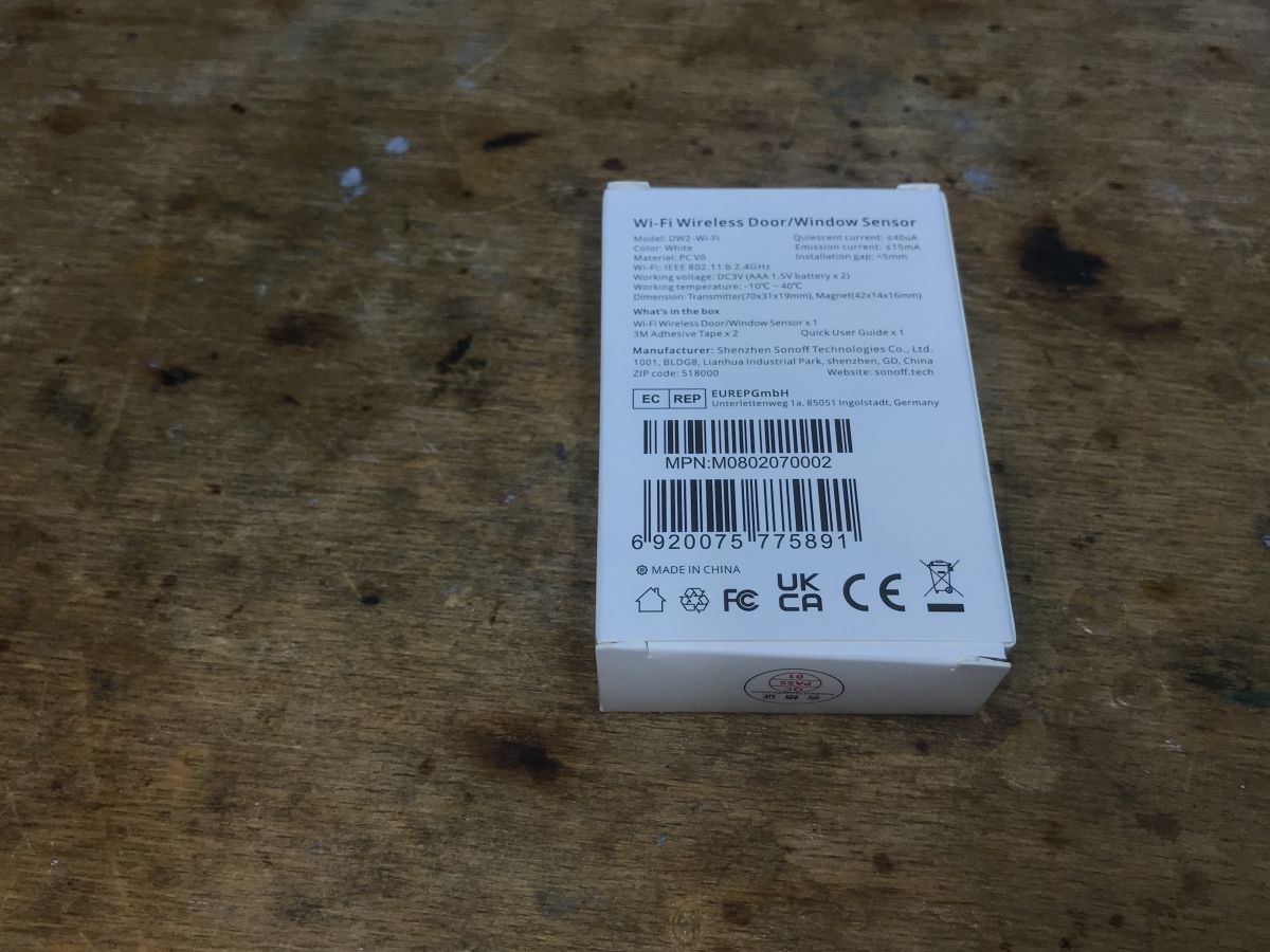

    Recently, a reader sent a rather unusual Sonoff door opening sensor. This sensor is built on a WiFi microcontroller, which we have not yet discussed on the forum. Here I will present its interior, backup it's Flash memory via SPI and consider the potential of changing the firmware of this gadget.
    Purchasing the sensor
    The sensor turned out to be very cheap, less than 30PLN. That's odd. Equally strange is the fact that the RF433 keyword is inserted in the title of the bids, even though radio communication this gadget does not have, there is only WiFi:
    Sonoff DW2 door sensor with WiFi and packaging on product page
    In the description, the seller explains that the earlier version, DW1, relied on RF433MHz, while the one in the offer uses WiFi:
    Sonoff DW2 WiFi door opening sensor mounted on a door.

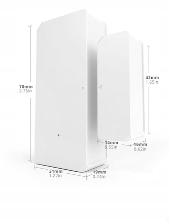

    Dimensions:
    White door opening sensor with dimensions in millimeters and inches.

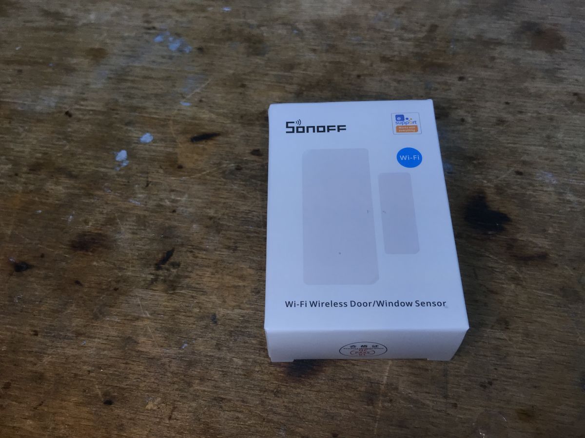

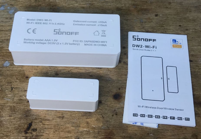

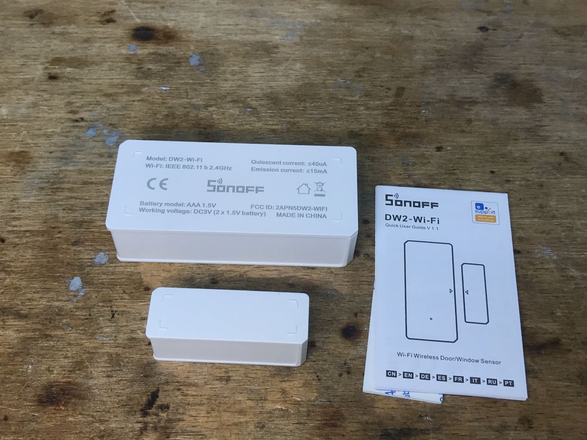

    Here's what I got:
    Box with Sonoff DW2 Wi-Fi door/window sensor. Sonoff DW2-Wi-Fi sensor packaging on a wooden surface.
    Contents:
    Sonoff DW2-Wi-Fi sensor set with user guide on a wooden table.
    Case information:
    - Quiescent current: <=40uA
    - Emission current: <=15mA
    - Model: DW2-Wi-Fi
    - FCC ID: 2APN5DW2-WIFI
    The sensor can be paired with the eWeLink app, then it works flawlessly, but this I already described in the case of the first reviewed door sensor:

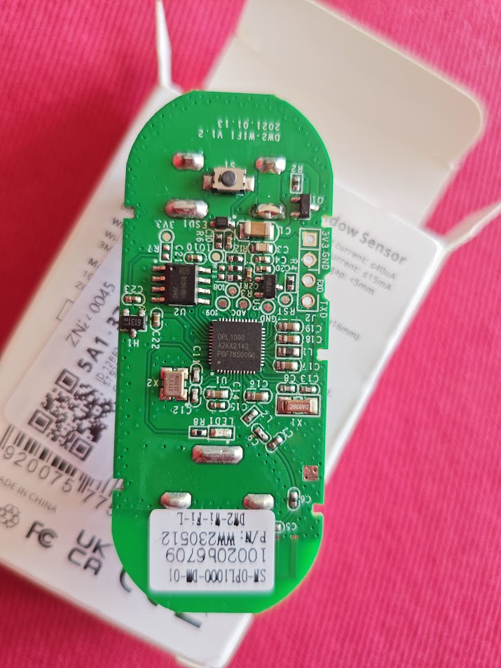

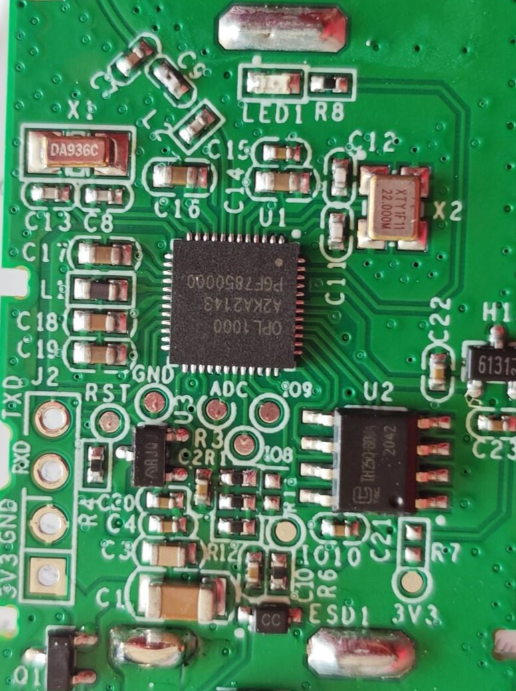

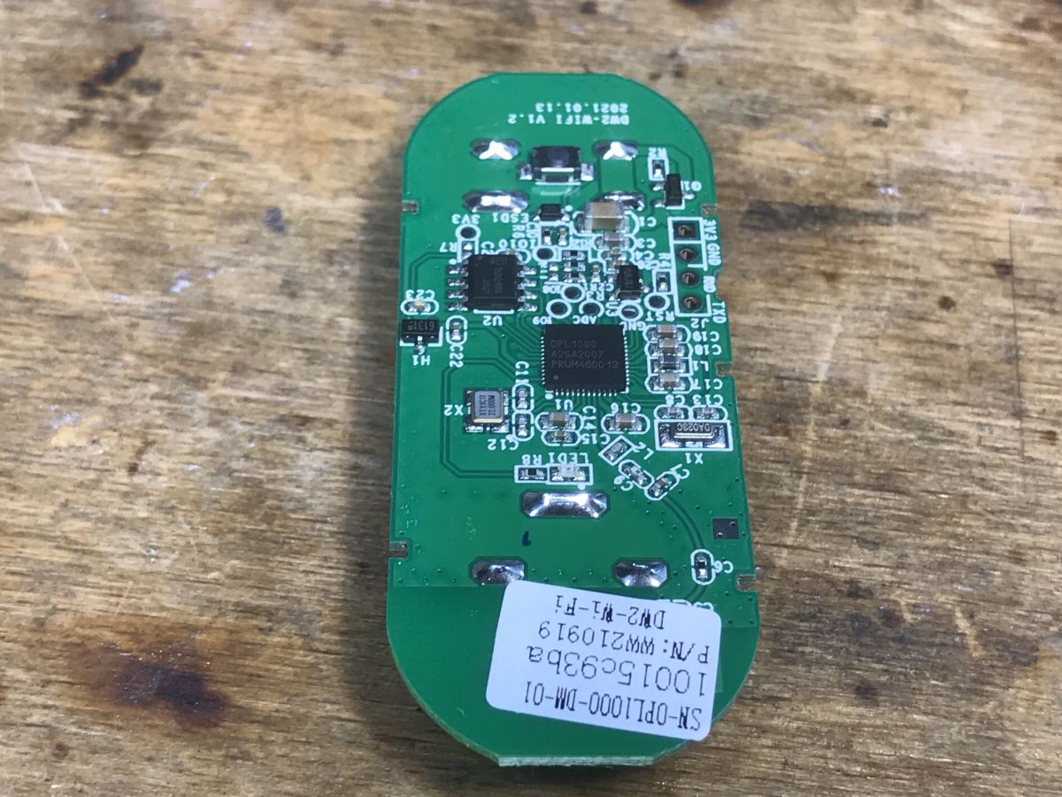

    Inside of the sensor

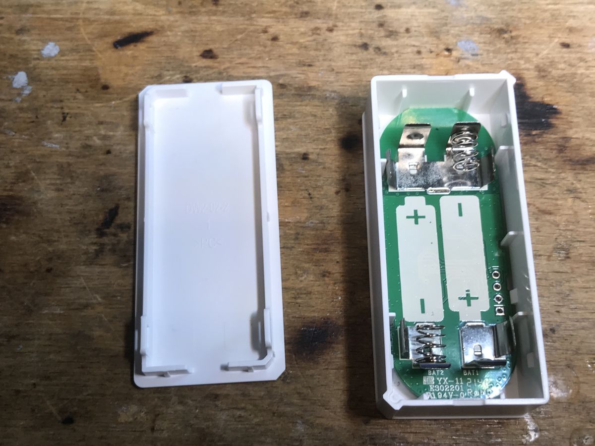

    You have to pull off the battery cover first:
    Interior of an opened Sonoff door sensor showing the PCB and battery compartment.

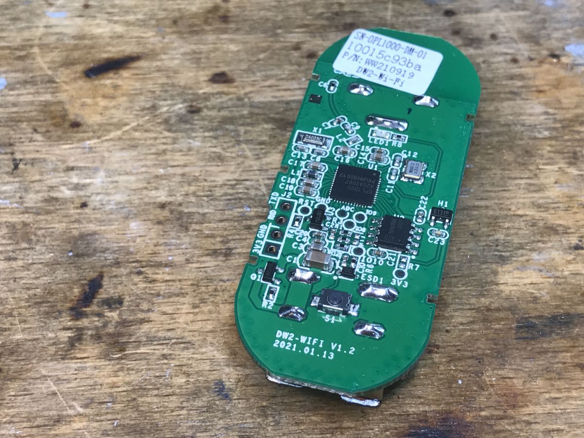

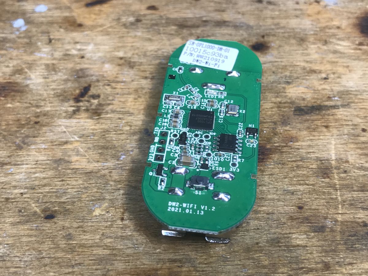

    PCB is held on by two hooks. Just undermine these hooks, then you can remove the board:
    Sonoff DW2-WiFi door sensor PCB on a wooden background Close-up of the PCB of the Sonoff DW2-WiFi door sensor on a wooden background.

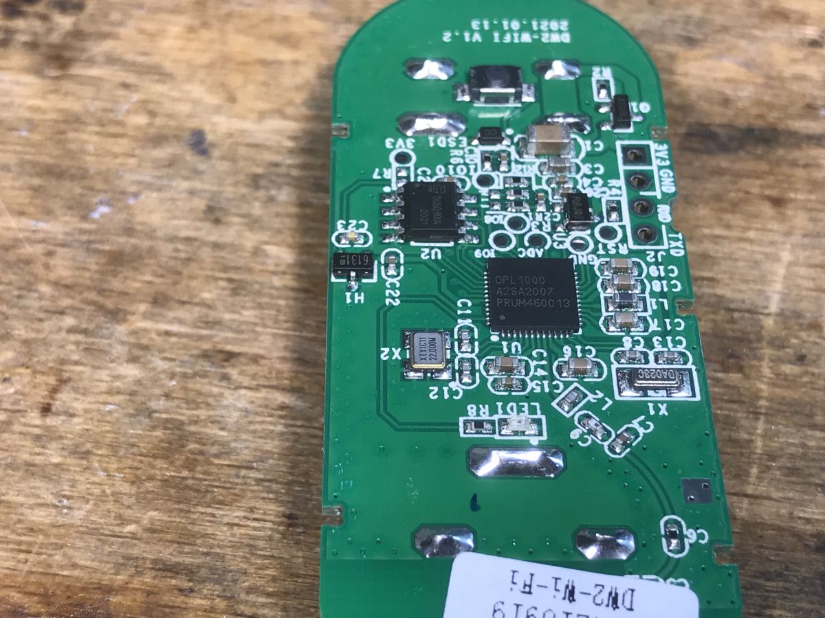

    PCB designation:
    DW2-WiFi V1.2
    2021.01.13

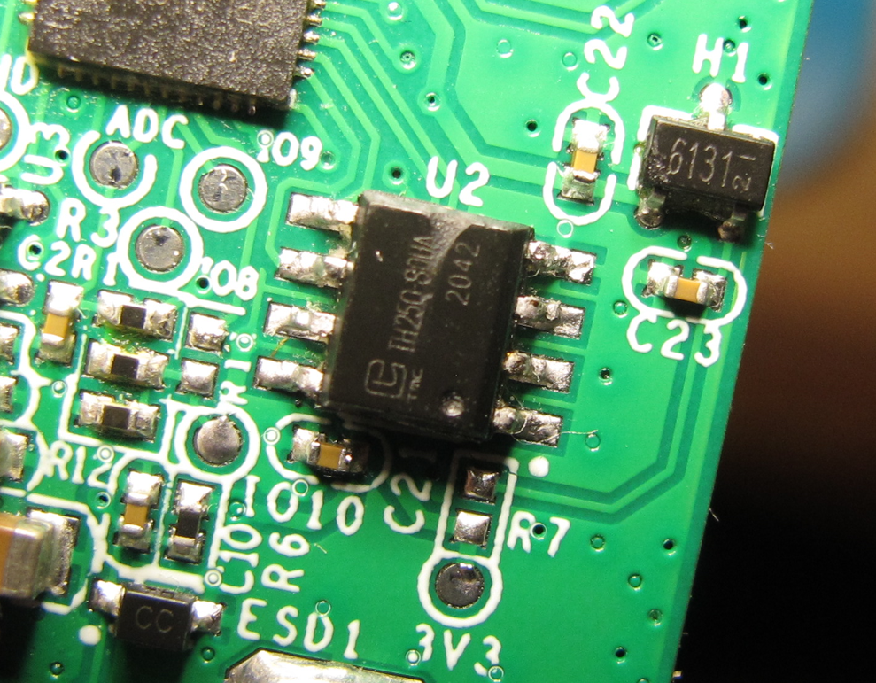

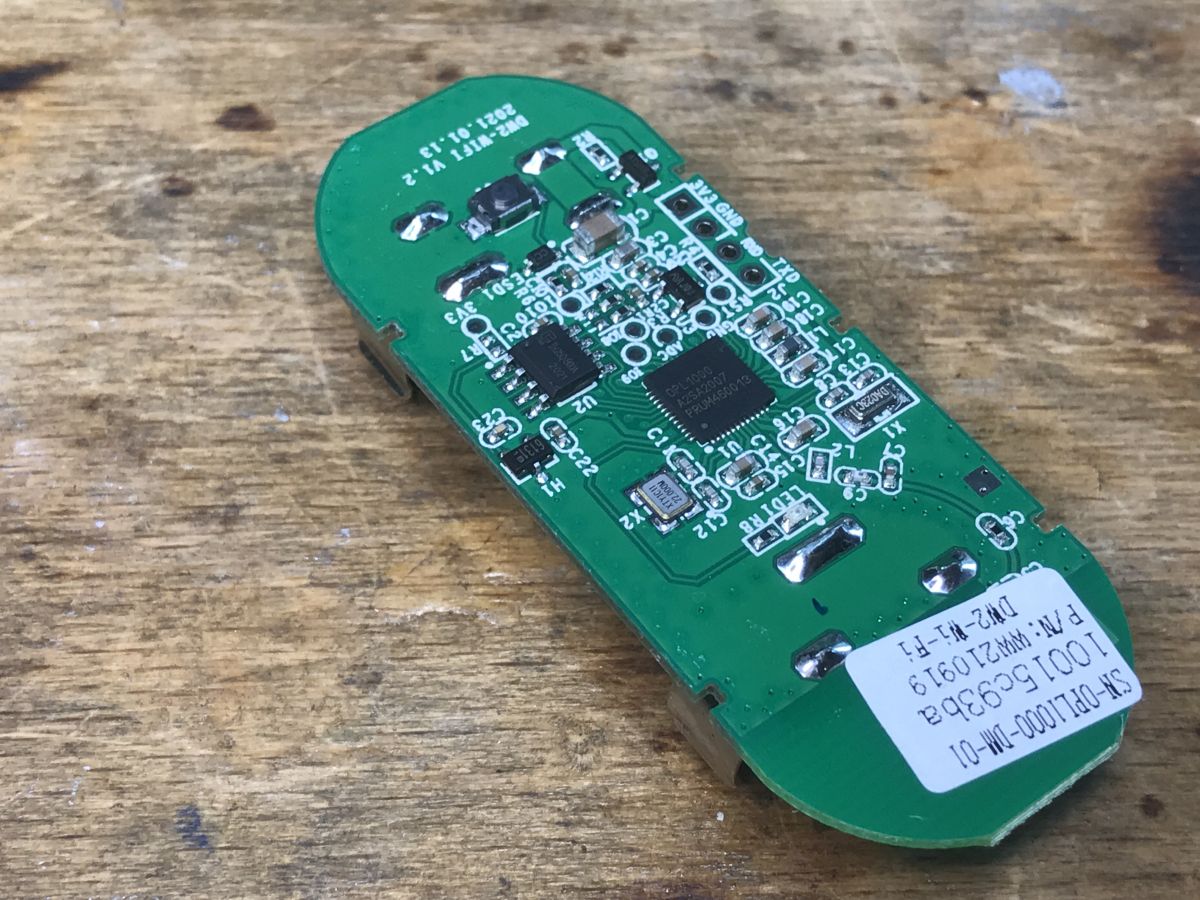

    You can see the WiFi module separately, and the Flash memory chip separately:
    Interior of the Sonoff DW2-WiFi door sensor with visible PCB and components.

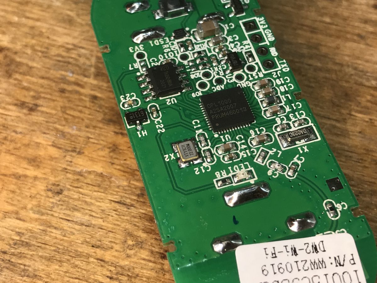

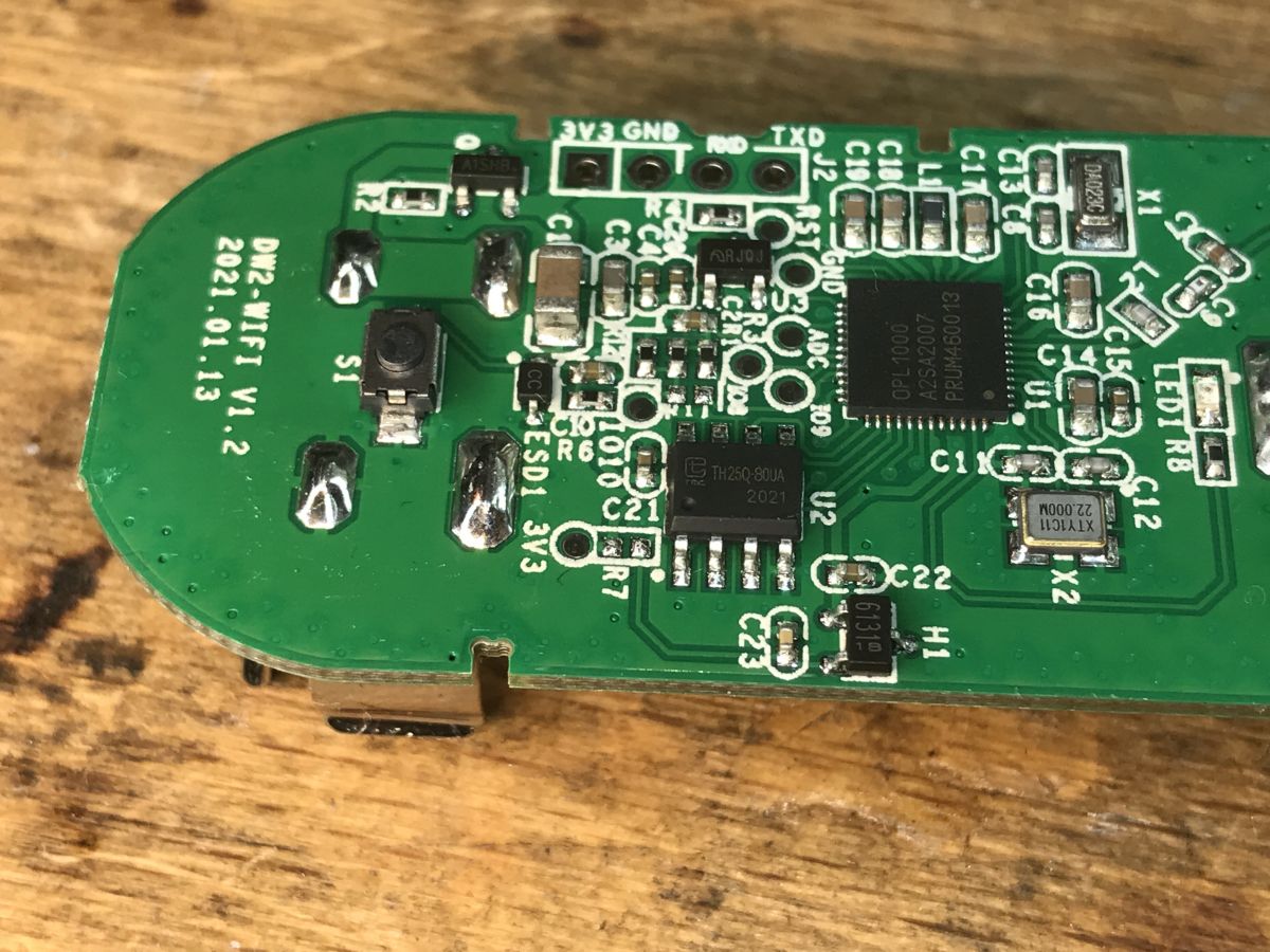

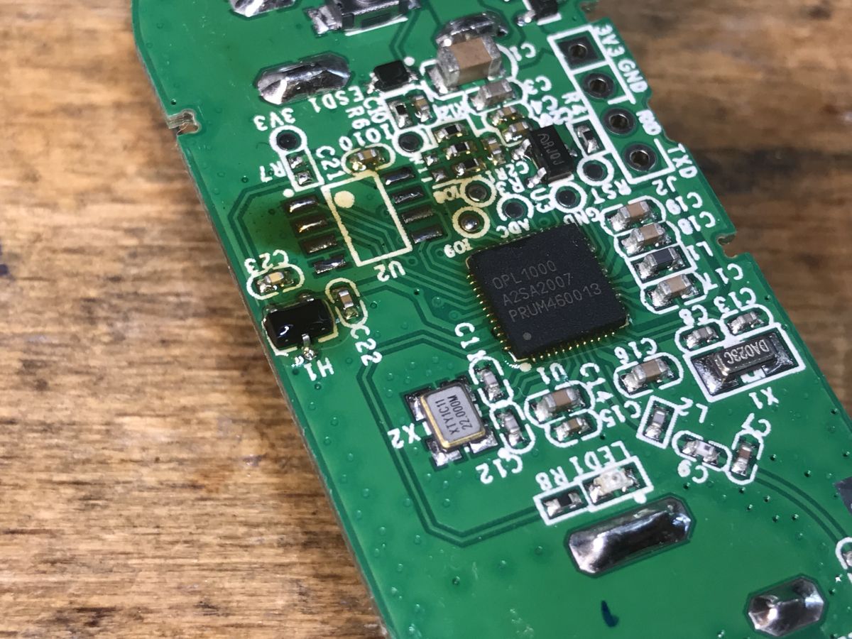

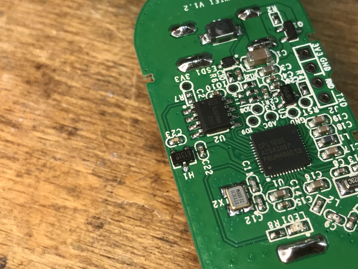

    H1 is the Hall sensor, Q1 is the transistor.
    Close-up of the Sonoff door sensor circuit board with visible electronic components.
    The Hall sensor is designated as 6131.
    The SPI bone is TH25Q80UA.

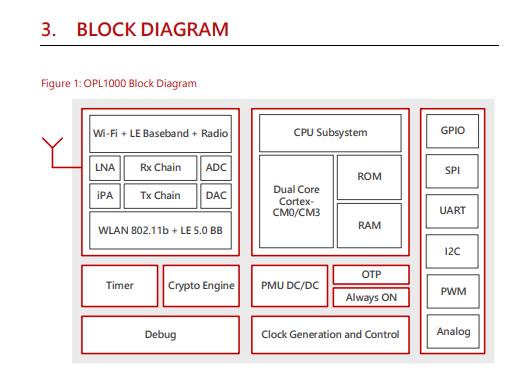

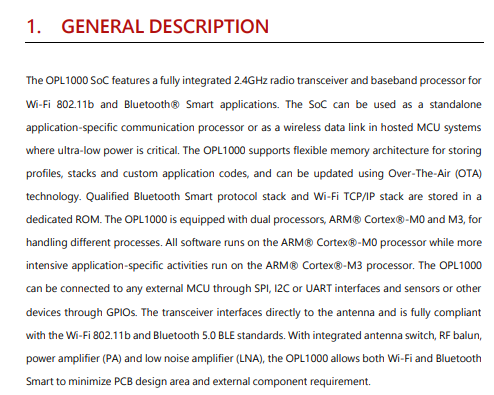

    The microcontroller is OPL1000 - manufactured by Opulink. It offers connectivity via WiFi and Bluetooth.
    A fragment of the OPL1000 microcontroller documentation describing its functions.
    Block diagram of the OPL1000 microcontroller.
    There is no open source software for IoT devices for this microcontroller yet. Documentation, however, is available:
    https://github.com/Opulinks-Tech/OPL1000-HDK/tree/master
    A few more photos:
    Interior of Sonoff DW2-Wi-Fi sensor with OPL1000 microcontroller. Close-up of a PCB from the Sonoff DW2-WiFi door sensor. Interior of DW2-WiFi sensor with OPL1000 microcontroller Close-up of the PCB of a Sonoff door sensor with visible electronic components. Close-up of Sonoff DW2-WiFi sensor PCB. .

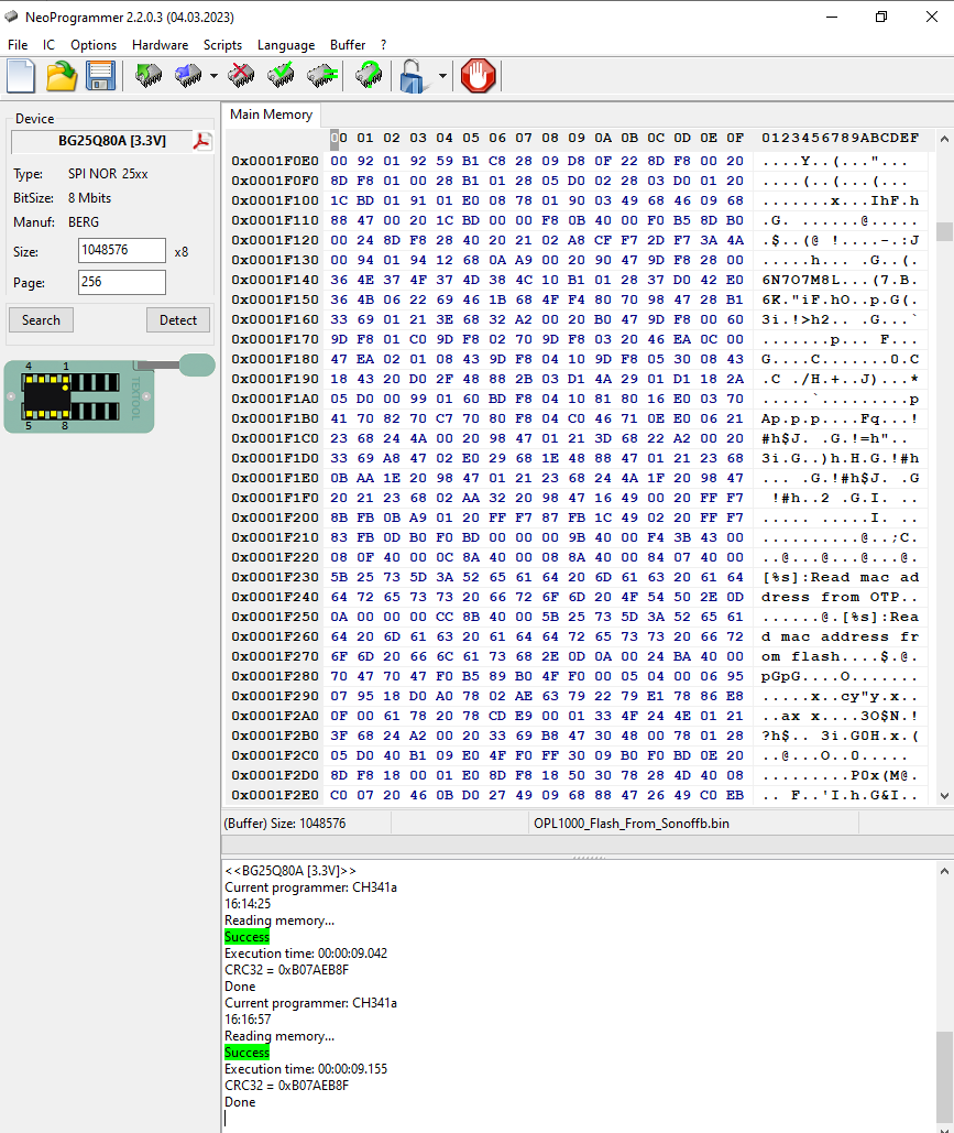

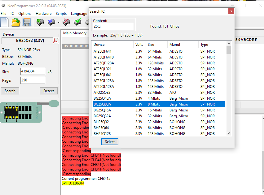

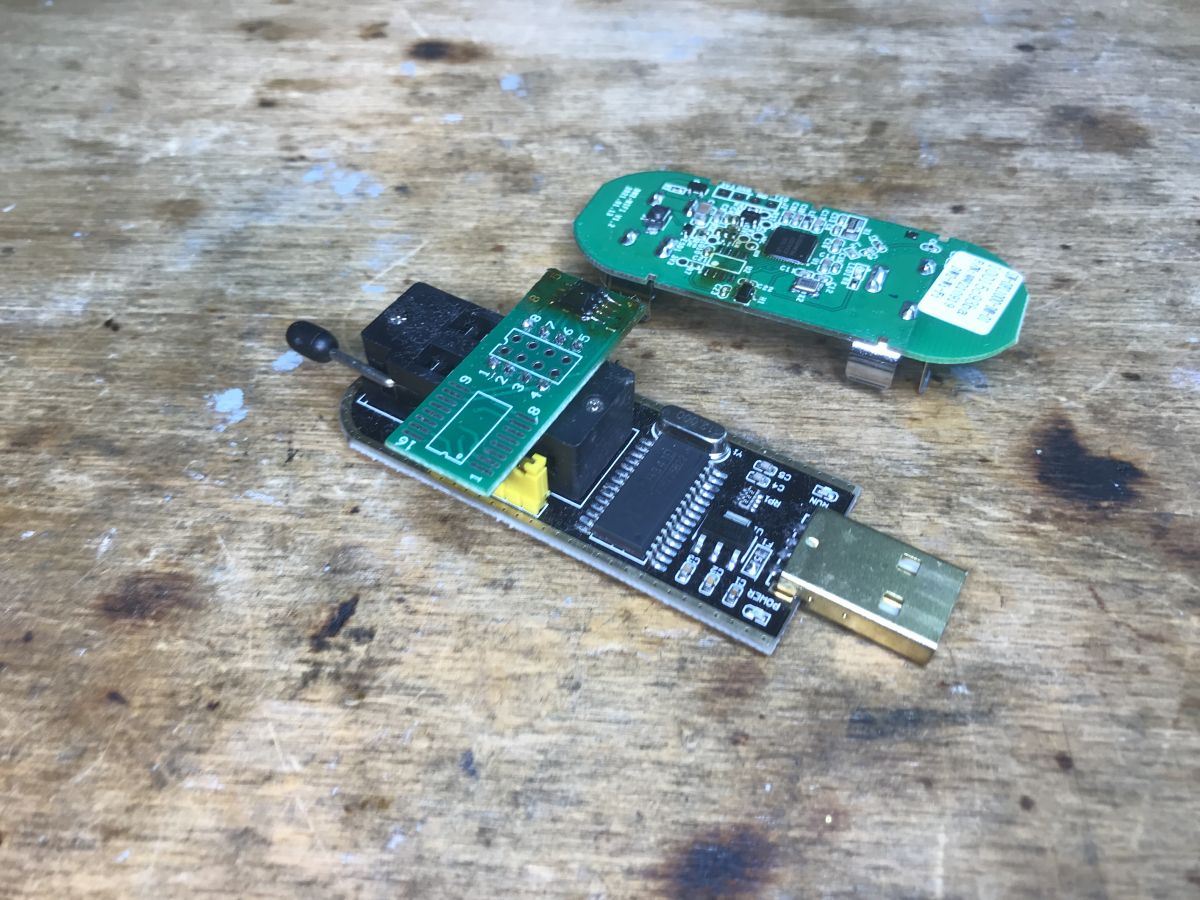

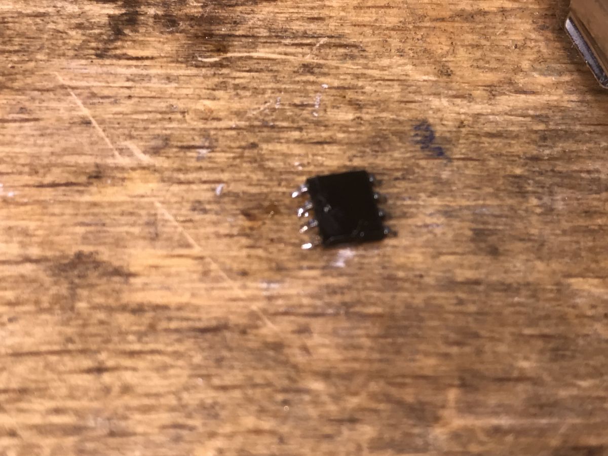

    Dumping the Flash [/size]
    For a start, I decided to dump flash memory, So I started by desoldering the Flash chip (I don't trust the clip method):
    Close-up of a circuit board with an OPL1000 microcontroller. Small integrated circuit on a wooden table.

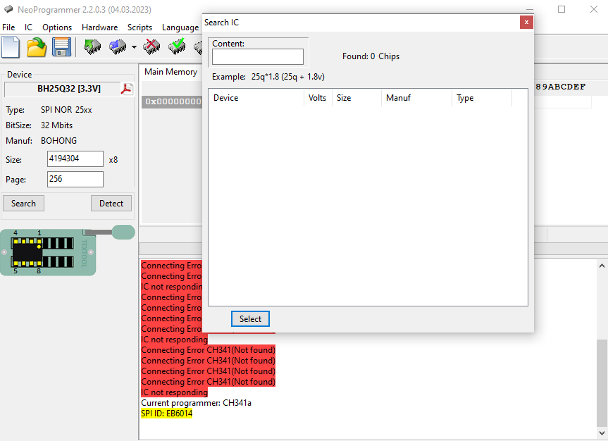

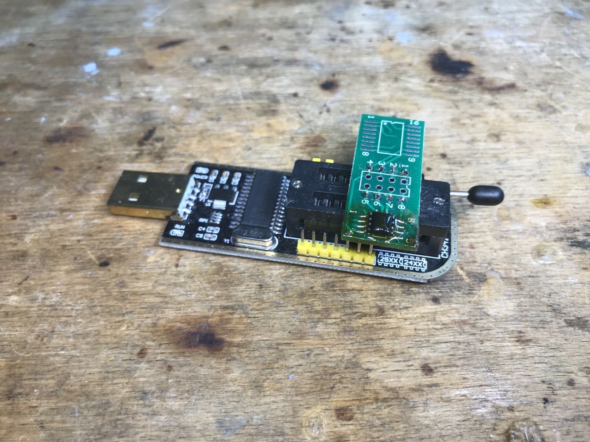

    Then I loaded its content with a CH341 programmer:
    Sonoff DW2-WiFi sensor PCB and USB programmer on a wooden surface. USB Flash programmer with connected adapter board.
    Programmer tool (NeoProgrammer 2.2.0.3) recognized the chip (SPI ID: EB6014):
    Screenshot of NeoProgrammer software during Flash memory detection. Screenshot of NeoProgrammer 2.2.0.3 showing a list of SPI memory chips.

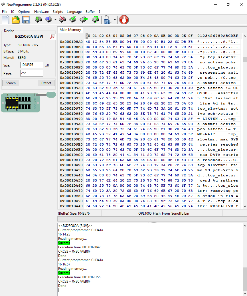

    I was able to read the data, and I even found some SDK-related character strings inside:
    Screenshot of NeoProgrammer displaying memory data read from a Flash chip. Screenshot of NeoProgrammer displaying flash memory readout.
    I posted a copy of the firmware here:
    https://github.com/openshwprojects/FlashDumps/commit/a4d13b2bee408249def6e3797748db6a45ddaee7

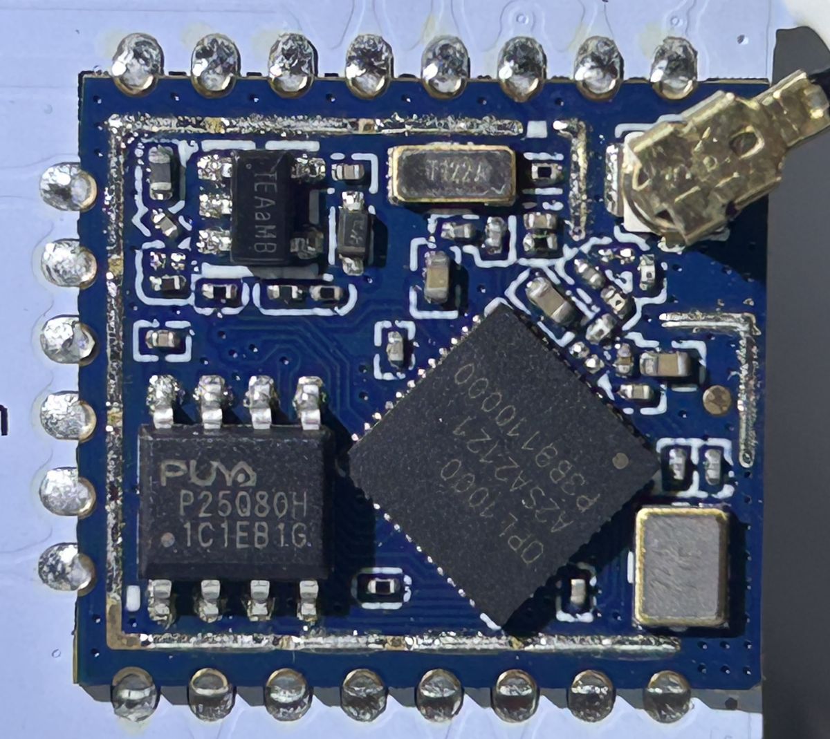

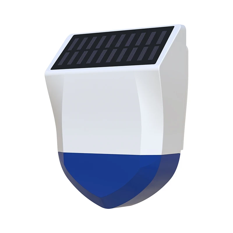

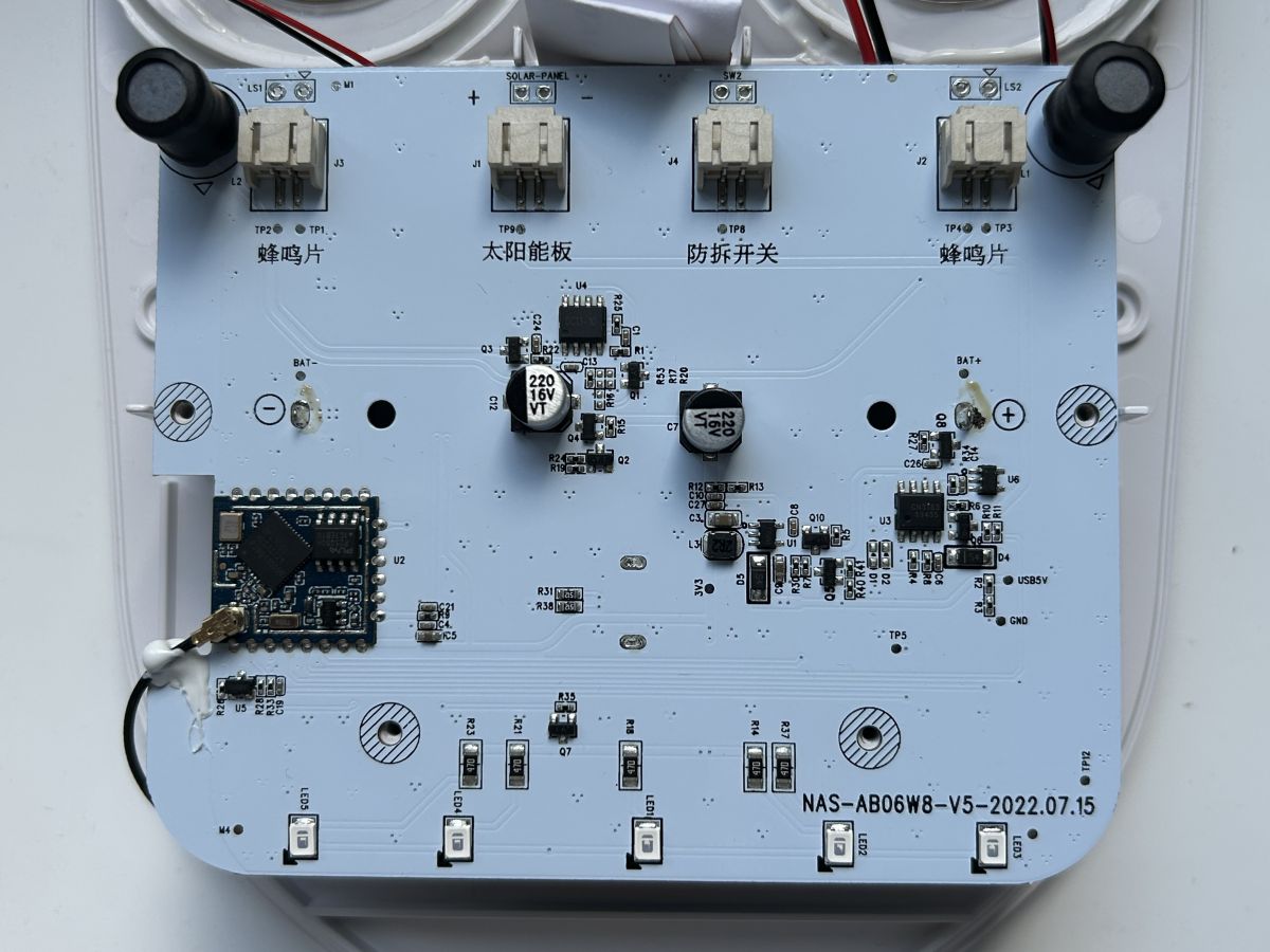

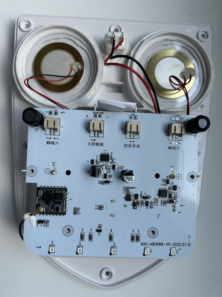

    I found this device, based on OPL1000, that might be a good candidate to prepare a firmware for it (of course a port OpenBeken) to cut it off from the cloud:
    Tuya Outdoor 95dB Siren with solar and USB power supply (cost 20/30 euro)
    [OPL1000] Sonoff DW2 door/window opening sensor - teardown, firmware [OPL1000] Sonoff DW2 door/window opening sensor - teardown, firmware[OPL1000] Sonoff DW2 door/window opening sensor - teardown, firmware [OPL1000] Sonoff DW2 door/window opening sensor - teardown, firmware
    AliExpress Link
    Feature and Specifications:
    Power: 5V/1A Type-C USB;
    Battery type: 18650 rechargeable batter
    Wireless protocol: WIFI
    Wireless range: 45m
    Standby current: 2.5mA
    Alarm ringtone: 3
    Maximum alarm sound: 1m-100dB
    Waterproof rate: IPX5
    Main body size: 200x150x66mm
    Solar panel size: 132x62mm
    Here are some pictures of the inside and the main board
    Interior of a solar-powered siren with visible circuit board and speakers.
    Image of the interior motherboard of a solar-powered siren, featuring an OPL1000 chip on a white board.
    and of the OPL1000 module
    OPL1000 module with PUYA P25Q80H memory on a blue PCB
    with the OPL1000 A2SA2121 chip and the PUYA P25Q80H SOIC-8 NOR Flash memory

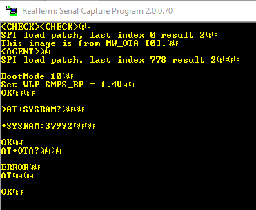

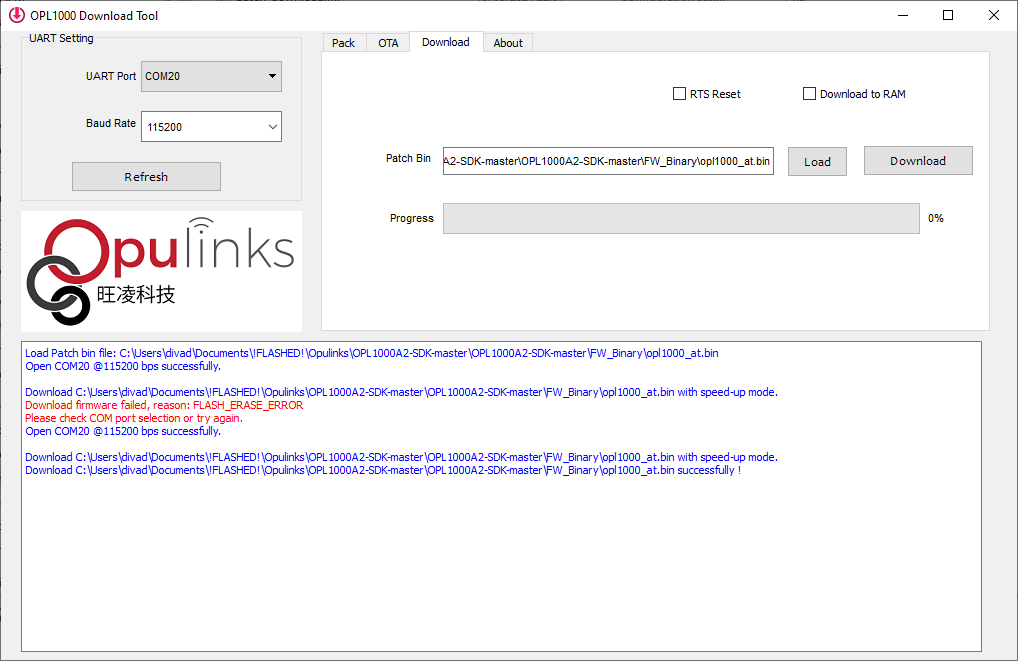

    Added after 4 [hours] 36 [minutes]:

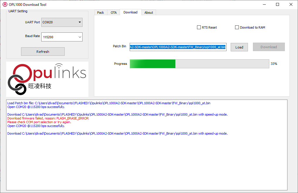

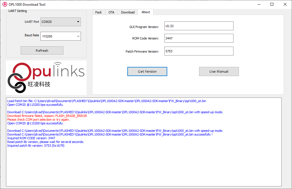

    I've ordered a CH341a but will probably try bit-banging with FTDI before it arrives. I'd forgotten about this vid https://www.youtube.com/watch?v=z9uLPo9QAY8
    Sadly the Opulinks UART download tool doesn't seem to have a flash read function.

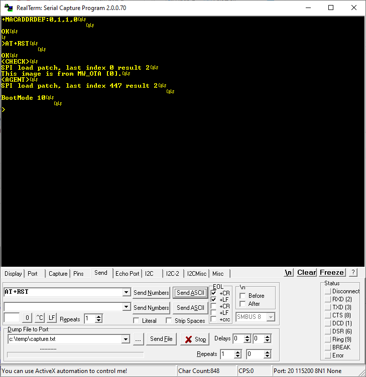

    Posts: 5021
    Help: 438
    Rate: 891
    DW2 boot output from GPIO8. Pad is available on PCB.
    Close-up of a circuit board with a visible OPL1000 chip.
    and at boot GPIO0 outputs this
  • #19 21187912
    Posts: 5021
    Help: 438
    Rate: 891

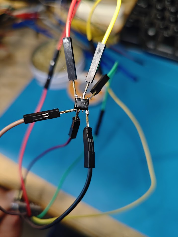

    and now after desoldering the TSINGTENG Microsystem TH25Q-80UA 8mbit/1mb flash chip here is a bit-banged dump
    Close-up of a USB connector with wires connected to an electronic board.
    Close-up of a desoldered TSINGTENG Microsystem TH25Q-80UA chip with attached wires.

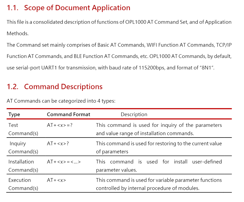

    Rate: 891
    • A2_opl1000_at_strings.txt (24.44 KB) You must be logged in to download this attachment.
  • #23 21188100
    Posts: 14576
    Help: 654
    Rate: 12602

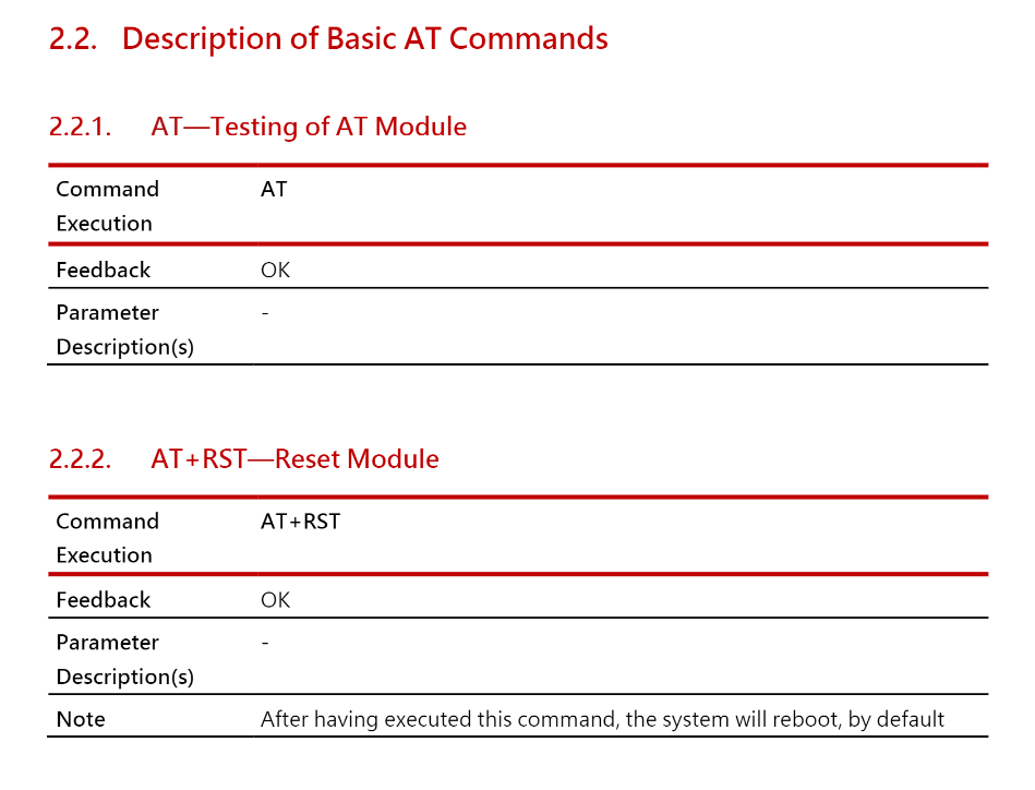

    Try to execute few:
    Instructions for OPL1000 AT Command Set, outlining the scope and command formats.
    Table of basic AT command descriptions.

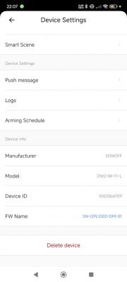

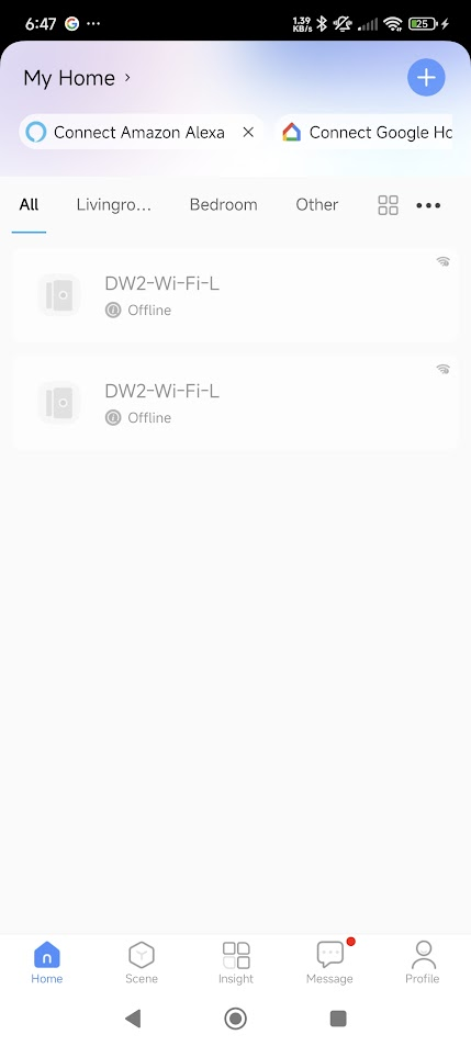

    will solder flash back. assuming I don't kill it, I'll try AT commands next.
    Added after 59 [minutes]:

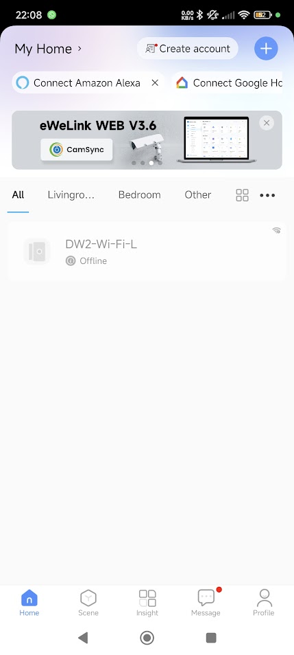

    success
    Close-up of a green circuit board with a soldered integrated circuit.
    and it pairs
    App screen showing DW2-Wi-Fi-L device offline. Screenshot of SONOFF device settings on a smartphone showing options for Smart Scene, push message, logs, and arming schedule.

    Posts: 5021
    Help: 438
    Rate: 891
    hmm. no luck so far getting any AT response. trying welcome +++ sends too.
    not helped by the fact that this device doesn't seem to be able to talk to the coolkit.cc servers, it just loops this in the log and device remains offline in the eWelink app even though pairing was successful.
    there doesn't appear to be an AP mode
    anyway. wouldn't building something from the SDK be more meaningful? Apart from cutting off from the cloud with OTA, like Magic Home BL602, what else could be achieved or gained from AT command response? OTA still needs a working firmware from SDK...

    I've fiddled a bit more and flashed opl1000_at.bin using the latest OPL1000 Download Tool I can find - 3.9.3.7012
    Flash start is the same as Beken - reconnect power when flash tool is waiting on COM port.
    Screenshot of the OPL1000 Download Tool showing UART settings and download progress.
    Screenshot of OPL1000 download tool showing UART settings and flash process.
    Screenshot of OPL1000 Download Tool with settings and a log.
    and then some AT commands including AT+RST to show boot log (from flashing/AT UART GPIO0, not GPIO8)
    Screenshot of RealTerm program with extended boot log. Screenshot of RealTerm program showing AT+SYSRAM command and response 24760.
    Added after 8 [hours] 37 [minutes]:
    I've flashed back my TH25Q-80UA dump and the one from https://github.com/openshwprojects/FlashDumps/commit/a4d13b2bee408249def6e3797748db6a45ddaee7 and they both boot and are pairable in the eWelink app.
    Screen view of the eWelink app showing two offline devices.
    both output this on GPIO0 (APS_DBG_UART_TX)

    The opl1000_ali_sensor_003_020_2436_2004.bin binary gives this on GPIO0 at boot
    and accepts AT commands
    Screenshot from RealTerm showing a log of communication with a device via a serial port.

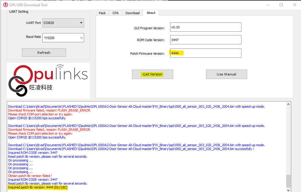

    Added after 6 [minutes]:
    the "Get Version" button queries the OPL for patch firmware version value. This is the return from opl1000_ali_sensor_003_020_2436_2004.bin
    Screenshot of OPL1000 download tool displaying firmware version information.

    Great progress, so it's possible to flash the Flash chip dumps directly via UART?
    Btw, did you check the original dump for open ports?
    Ok, so the next step is to compile something... can we compile our own opl1000_ali_sensor_003_020_2436_2004 or similiar?
  • #29 21190525
    Posts: 5021
    Help: 438
    Rate: 891
    yes. both dumps and the OPL AT and Ali door sensor binaries flash and boot
    started to but the connection was too unstable. can do again with smaller ranges
    this is the bit im most scared about as im not yet sure how to approach it. I have MYSYS2 installed from something ages ago and I have a mental note you demonstrated something somewhere, maybe it was the XR809 original build. I'm a little bit not excited given how rare it is. but it would be a good learning exercise.
  • #30 21190566
    Posts: 14576
    Help: 654
    Rate: 12602
    Ok so which SDK would you like to try together? Which repository has binaries that you confirmed are working?
