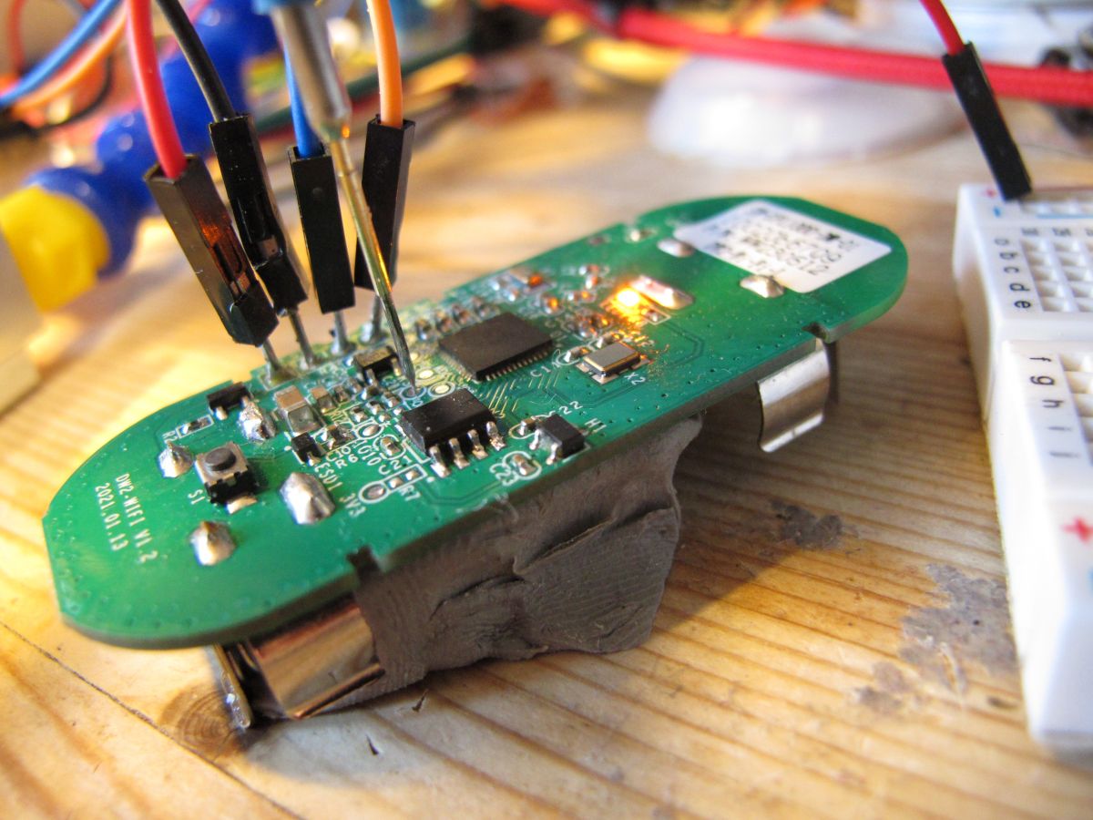

[OPL1000] Sonoff DW2 door/window opening sensor - teardown, firmware
p.kaczmarek2 11076 83
  • Sonoff DW2-WiFi door/window sensor uses an OPL1000 WiFi/Bluetooth microcontroller instead of RF433MHz, unlike the older DW1.
  • Inside the DW2-WiFi V1.2 board, a 6131 Hall sensor, Q1 transistor, and TH25Q80UA SPI flash sit alongside the separate WiFi module.
  • The flash was desoldered and read with a CH341 programmer; NeoProgrammer 2.2.0.3 recognized the chip with SPI ID EB6014.
  • Firmware strings suggested SDK traces, and the dumped firmware was published with links to OPL1000 SDK documentation and source.
  • The sensor pairs with eWeLink and works, but cloud cutoff is still difficult, and OpenBeken porting is only a possibility so far.

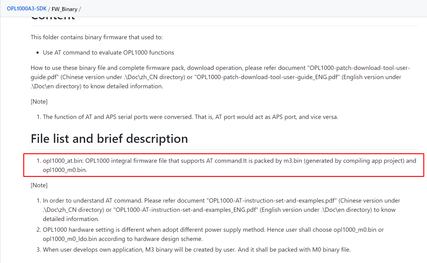

    I've flashed the opl1000_at.bin from https://github.com/Opulinks-Tech/OPL1000A2-SDK/tree/master/FW_Binary
    The Ali door sensor binary is outside of that SDK path but does reference A2 https://github.com/Opulinks-Tech/OPL1000A2-Door-Sensor-Ali-Cloud
    I'm not sure if A3 SDK is a revision of the same SDK as well as a version of the OPL1000 chip, so we should use updated A3 SDK or if each SDK is specifically for each chip type only. I note our chips have A2 printed on them.
    Added after 3 [minutes]:
    these are identical however
    https://github.com/Opulinks-Tech/OPL1000A3-SDK/blob/main/FW_Binary/opl1000_at.bin
    https://github.com/Opulinks-Tech/OPL1000A2-SDK/blob/master/FW_Binary/opl1000_at.bin
    each SDK readme does make a point of saying "OPL1000A3-SDK is Opulinks official software development kit for OPL1000 A3 chip" which reads like each SDK is specific to each chip revision

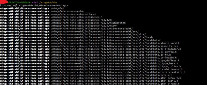

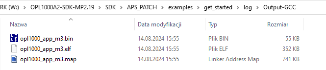

    use GNU arm GCC tool. "Makefile" is provided for each individual example under SDK\APS_PATCH\examples folder. User can use Make tool to compile and link own application. How to install GCC development environment under Windows system please refer chapter4 of "OPL1000-SDK-Development-guide.pdf" document.
    but maybe it would be easier to:
    use Keil uVision 5 on Windows system. "opl1000_app_m3.uvprojx" project file is provided for each individual example under SDK\APS_PATCH\examples folder. User can open it by KeilC and add own function freely.

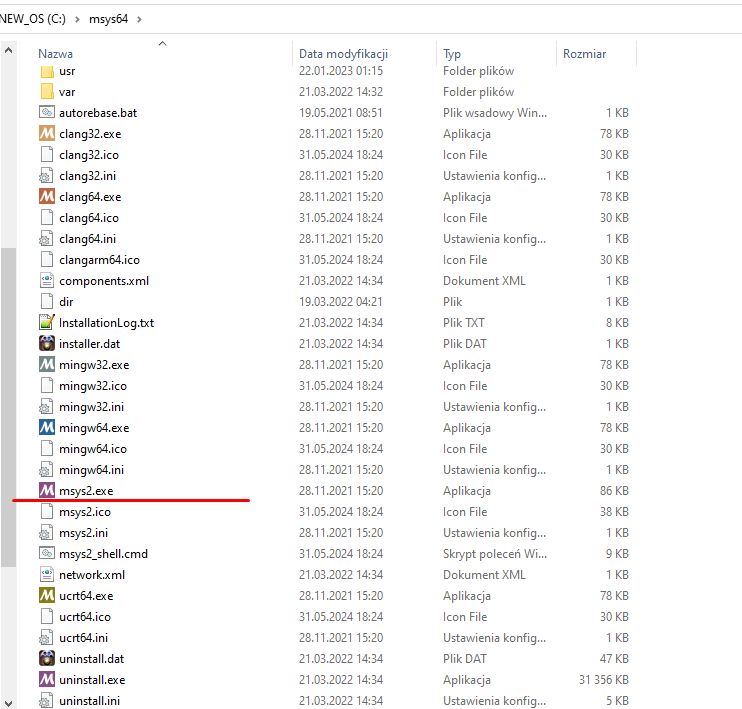

    I tried first way.
    Screenshot displaying the contents of the msys64 folder on the C drive, with the file msys2.exe highlighted.

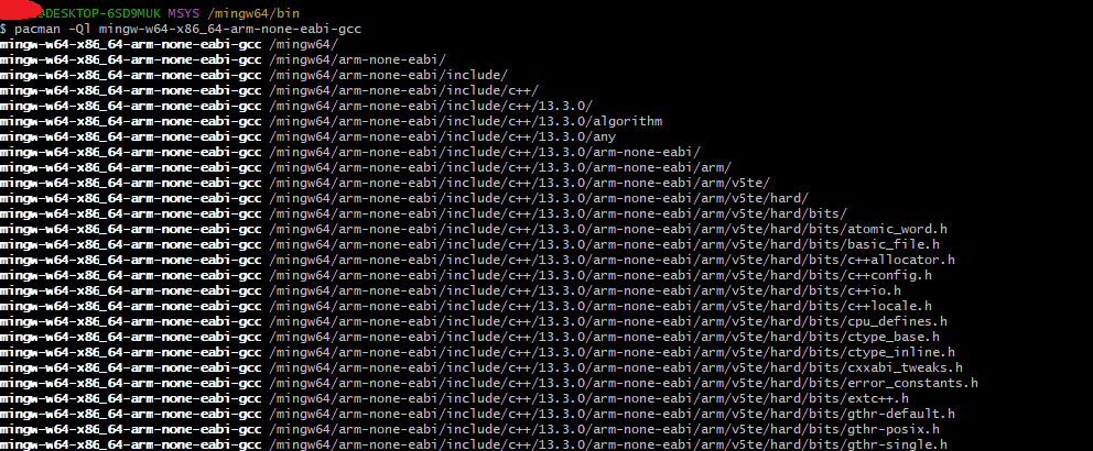

    In msys64 do, first update:
    pacman -Syu
    then toolchain:
    pacman -S mingw-w64-x86_64-arm-none-eabi-gcc
    then you should have:
    Screenshot of an MSYS2 terminal showing mingw package installation.
    Add to path:
    export PATH=$PATH:/mingw64/bin
    Then try in path:
    Compilation error with message fatal error: no input files.

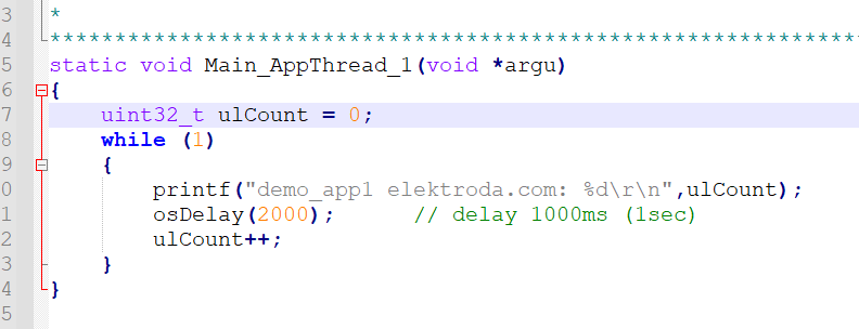

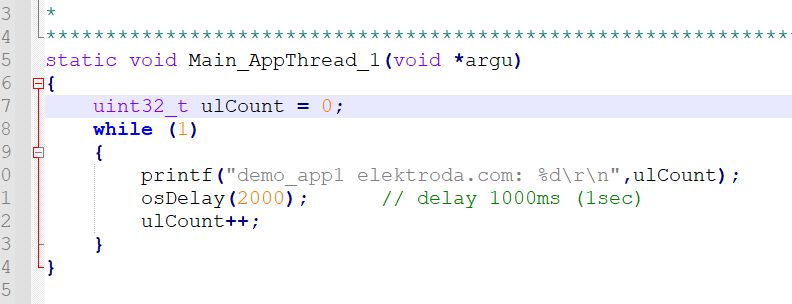

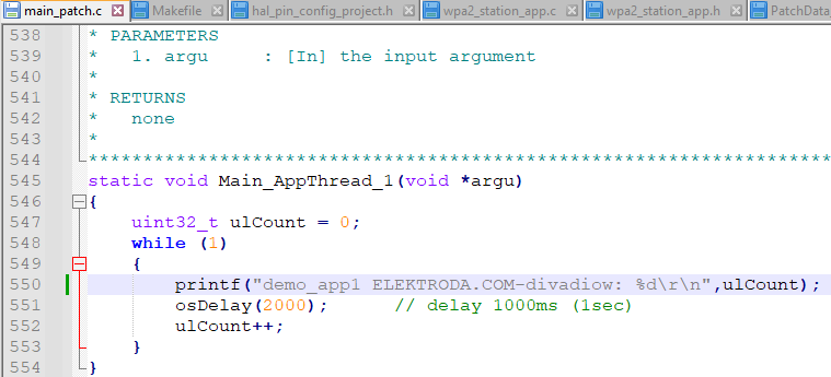

    I added log:
    Snippet of C code with a while loop.
    Now I will try to compile:
    Screenshot of a warning message during compilation in the terminal.
    This has been created:
    Screenshot showing a list of files in a compilation output folder.

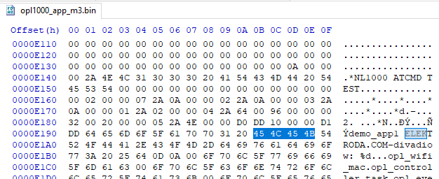

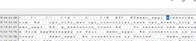

    It has elektroda in bin:
    A fragment of a binary file with ASCII text code.
    @divadiow can you try to retrace my steps and also get those binaries and then try flashing them?
    Added after 9 [minutes]:
    interesting:
    Screenshot of the OPL1000A3 SDK documentation regarding binary files.
    source: https://github.com/Opulinks-Tech/OPL1000A3-SDK/tree/main/FW_Binary
    Added after 4 [minutes]:
    https://github.com/Opulinks-Tech/OPL1000A3-SDK/tree/main/FW_Pack

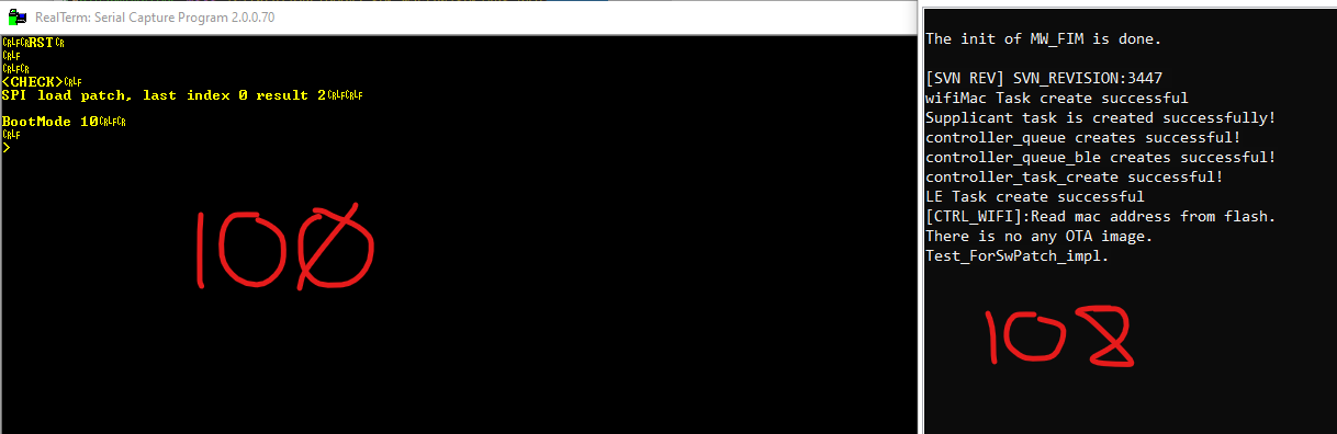

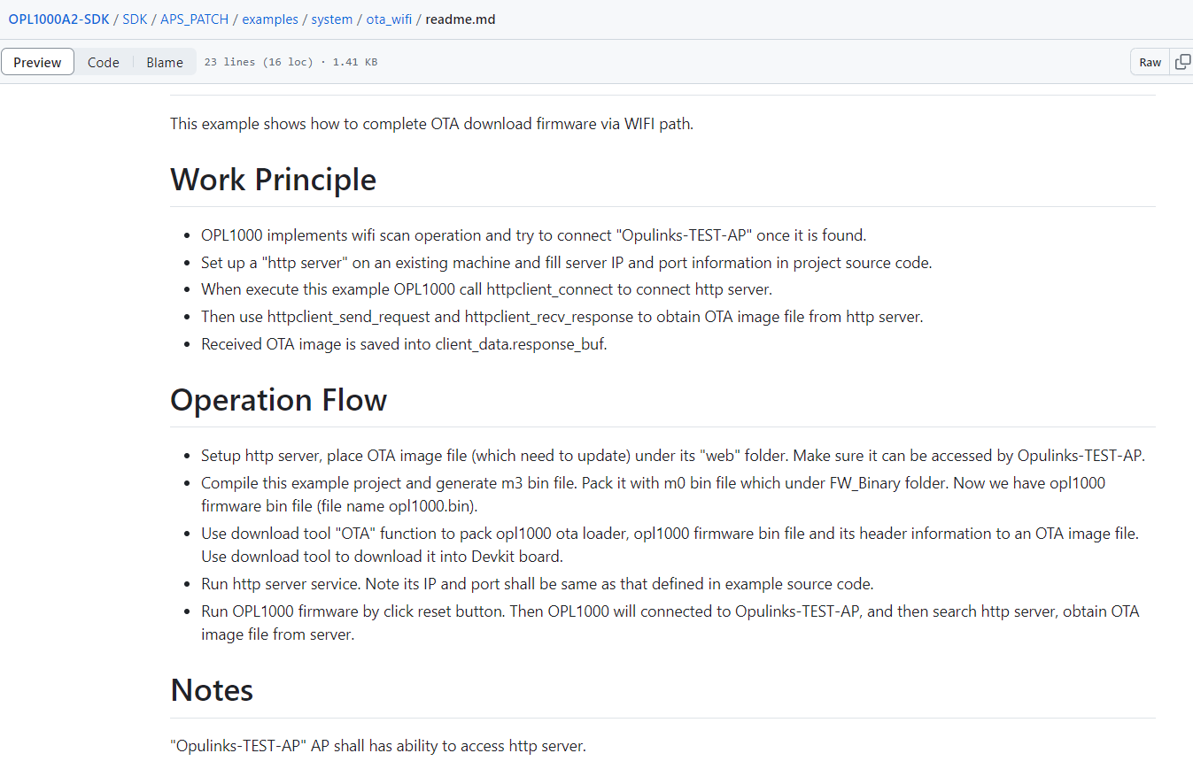

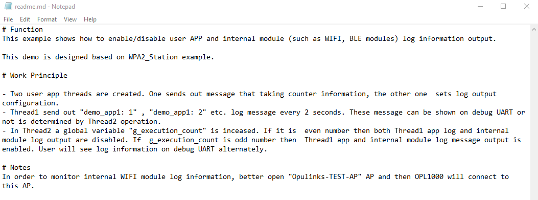

    well. I should be expecting to see "demo_app1: 1" , "demo_app1: 2" I believe:
    Screenshot of a readme.md file showing a description of the function and working principles of a demo application for APP and WIFI modules.
    Screenshot showing a code snippet with encoded message and text Opulinks-TEST-AP.
    I've an AP of Opulinks-TEST-AP / 1234abcd but nothing is joining. Tried 3 APs on different hardware - all 2.4Ghz

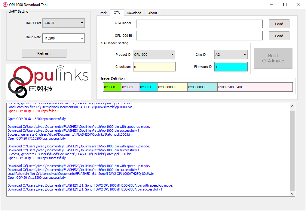

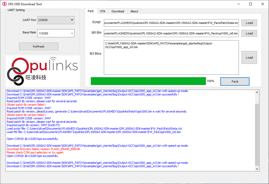

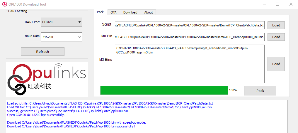

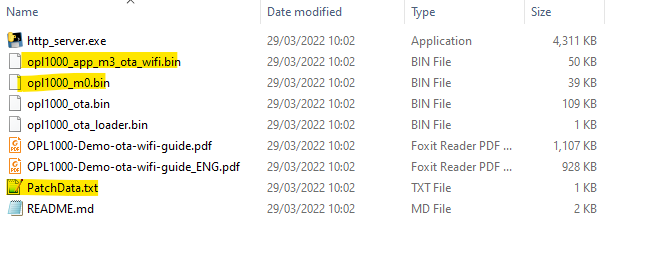

    I have packed the m3 with the m0 and used patchdata,txt as the script. boots still but no change
    Screenshot of OPL1000 Download Tool with loaded binary files and operation logs.
    Added after 24 [minutes]:
    also did A2 hello world and A3 log bins. hmmm
    Added after 8 [minutes]:
    divadiow wrote:
    A2 hello world
    https://blog.csdn.net/qq_24258593/article/details/112751210
    Added after 22 [minutes]:

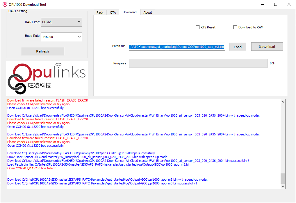

    ah, but if I use the script and m0 files as seen in that blog in the pack with my m3
    Screenshot of OPL1000 Download Tool with UART configuration and loaded files.
    then the app loads

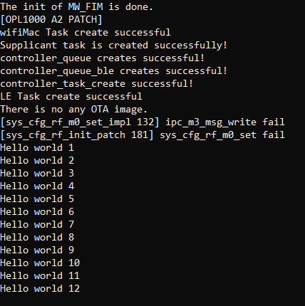

    Screenshot showing a software startup log with messages of successful task creations and errors related to the initialization of various functions.
    Added after 12 [minutes]:
    log doesn't seem to want to connect to any of the APs but does run

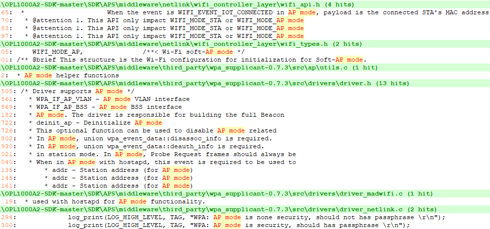

    i've been playing with wpa_station and these are curious
    [sys_cfg_rf_m0_set_impl 132] ipc_m3_msg_write fail
    [sys_cfg_rf_init_patch 181] sys_cfg_rf_m0_set fail
    I'm wondering about what the 128 or 256kb flash built into the OPL1000 contains, or did contain, from factory. Are some of the addresses in PatchData.txt used not correct? where is the RF data held? What effect does having the 8mbit flash in addition to the on-board memory have on PatchData.txt? Do the demos assume only the on-board flash is present?
    There's vey little online about this chip as we know.

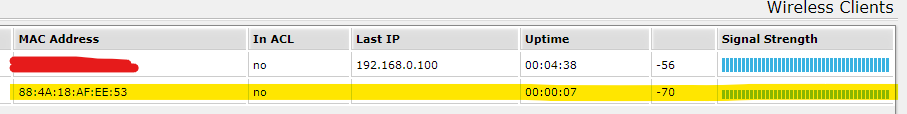

    packed and flashed this demo
    Screenshot of a folder showing various files including binary and PDF documents.
    and it can list all the APs around me
    and connect to my test AP
    Screenshot showing a wireless clients table with MAC addresses, last IP, uptime, and signal strength.
    not sure of what this means though for the content of a patchdata file for a firmware that'll not fit on the OPL onboard memory

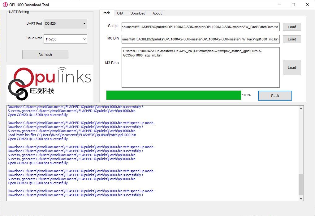

    ha. OK. went back to original m0 and patchdata and tried OPL1000A2-SDK-master\SDK\APS_PATCH\examples\wifi\wpa2_station_gpio
    so packing looks like
    Screenshot of OPL1000 Download Tool showing UART settings and packing process.
    and after flash
    and the device is connected to router
    Table with MAC addresses, ACL status, last IP, uptime, and signal strength.

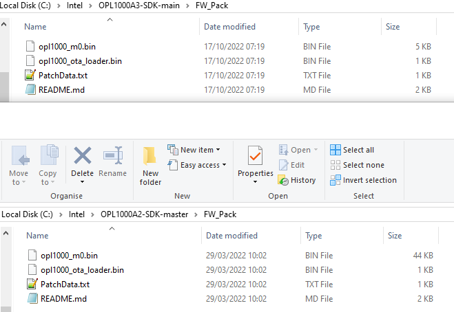

    OPL1000A3-SDK-main\FW_Pack\PatchData.txt
    OPL1000A3-SDK-main\FW_Pack\opl1000_m0.bin
    OPL1000A3-SDK-main\SDK\APS_PATCH\examples\wifi\wpa2_station_gpio\Output-GCC\opl1000_app_m3.bin (10kb after build?)
    = no boot
    Added after 6 [minutes]:
    The A2 and A3 Patchdata.txt content and the m0 files differ quite a bit
    Screenshot of two folders with SDK files for OPL1000A3 and OPL1000A2.

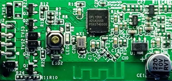

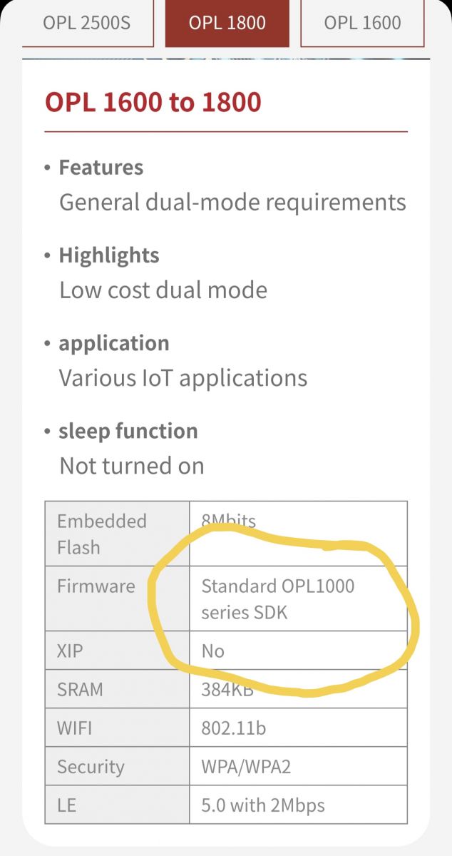

    well exactly. my question back to them is about A1 vs A2. Maybe the silkscreen is OPL1000 series, but actually it's an OPL1200 and then it makes sense we should use the A2 SDK.
    I have not tried any A1 SDK builds.
    Added after 16 [minutes]:
    Oh. Series indeed.
    Specification table for OPL 1600 to 1800 series.
  • #51 21192924
    Posts: 14575
    Help: 654
    Rate: 12602

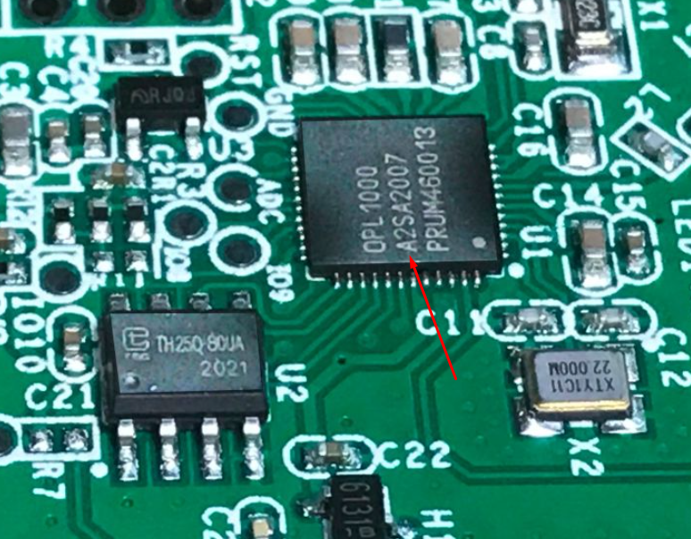

    Well, both our photos shows "A2", when you look closely...
    Close-up of a circuit board featuring a chip labeled A2SA2007.
    So I guess that's solved?
    Sadly I don't have my one already (I was flashing a batch of devices for a friend and no he is using it with original cloud) so I may need to get another one soon.
    Anyway, so in A2 SDK everything works so far?
    Yes. Indeed
    Yes. Seems to be fine so far

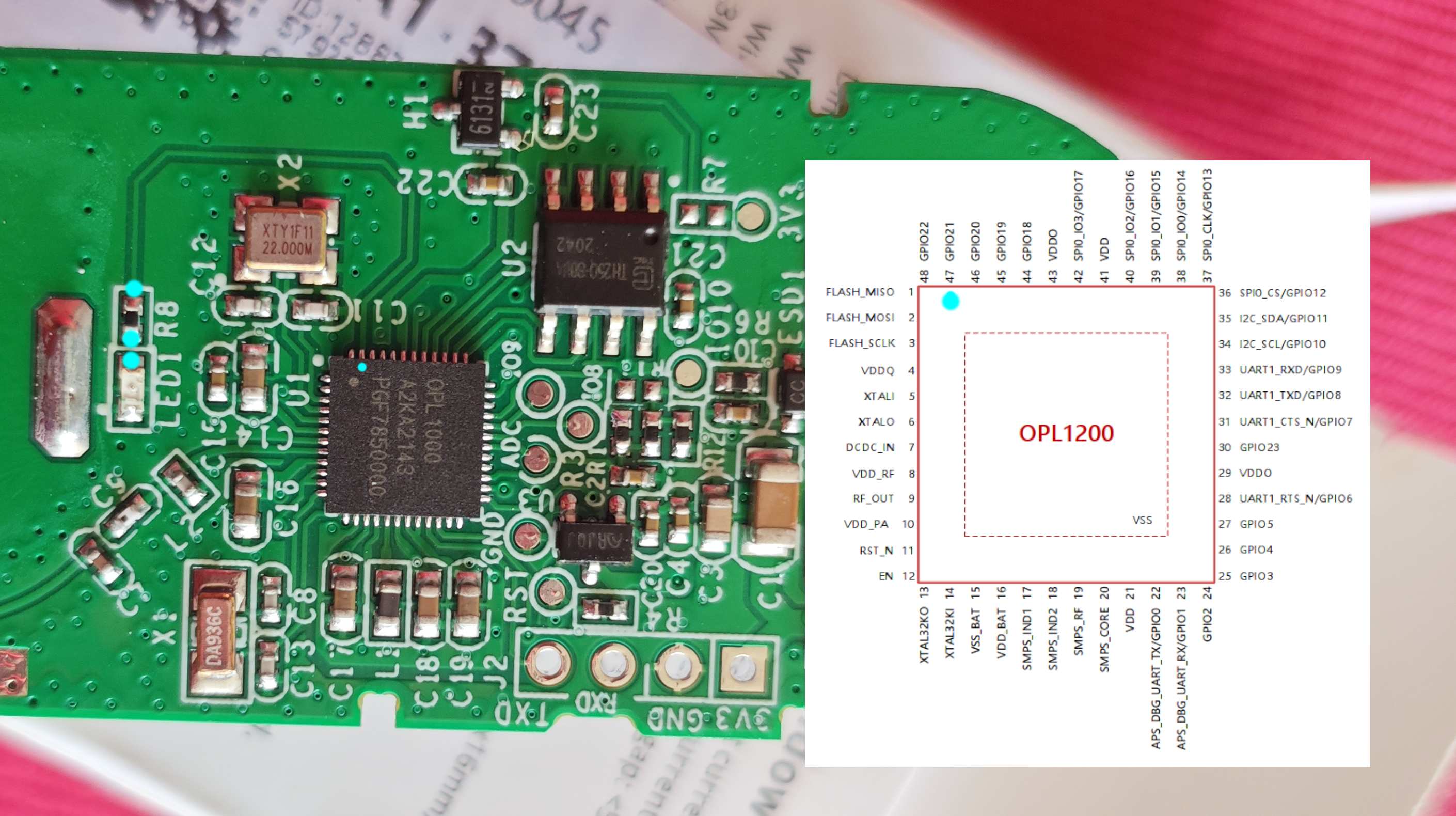

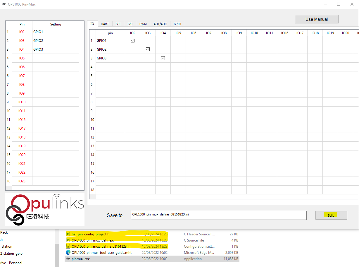

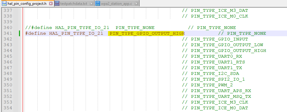

    ah. the function of the correct GPIO needed changing in hal_pin_config_project.h to PIN_TYPE_GPIO_OUTPUT_HIGH from PIN_TYPE_ICE_M3_CLK
    Screenshot showing code from the hal_pin_config_project.h file with a highlighted line defining GPIO21 as high output.
    then only the GPIO# in wpa2_station_app.c needs changing.
    It's clear from the traces and datasheet the LED is connected to GPIO21

    and now LED lights when wifi is connected
    Close-up of a circuit board with several wires connected to terminals, with an LED lit nearby.
    hal_pin_config_project.h content is a product of the PinMux tool where the function of each GPIO can be set.
    the highlighted files are created on PinMux build
    View of the OPL1000 Pin-Mux program with highlighted files.

    Great! So what next?
    PWM?
    OTA?
    PWM:
    https://github.com/search?q=repo%3AOpulinks-Tech%2FOPL1000A2-SDK%20PWM&type=code

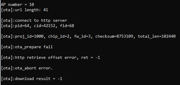

    ota:
    https://github.com/Opulinks-Tech/OPL1000A2-SD...mples/system/ota_wifi/http_ota_example.c#L398
    If we can get ota_wifi demo working, we could try adding OBK to that.

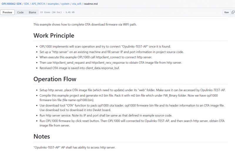

    Screenshot of OPL1000A2-SDK documentation on downloading OTA firmware via WiFi.
    Just how to get OTA file...
  • #56 21193453

    yes. the OTA demo is on my radar :)
    I was going to OTA Hello World to WPA2_GPIO or something. There's an OTA pack tab in the flash tool.
    Screenshot of OPL1000 Download Tool displaying OTA settings.

    We will also need to think about the futher OTA usage. Can the OTA file be created from commandline? Our automatic Github builds will require that....
    I will do the coding, once we have everything confirmed to work, but I don't know much about the build process on Github itself. Maybe we can just reuse the path of one of the other platforms.
  • #58 21193536
    Posts: 5021
    Help: 438
    Rate: 891
    not found any mention of a command line option yet. the builder exe does not accept anything cli - it just launches gui.
    pausing at this point for tonight
    Screenshot of error messages related to OTA download.
    http server is serving opl1000_ota.bin file download for any other device on subnet but not the DW2 yet.
    Added after 7 [hours] 49 [minutes]:
    back to our original understanding!

    Oh and look https://templates.blakadder.com/unsupported/sonoff_L3.html
    Circuit board with visible OPL1200 chip.
    If OPL1200 then it's labelled as such.

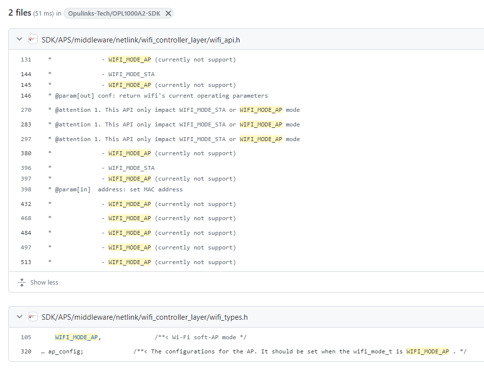

    I am no further forward with a working OTA demo.
    Also a little worrying is the distinct lack of a soft-AP demo or any real mention of soft-AP mode in the documentation.
    Added after 5 [minutes]:
    some mentions
    Screenshot of C code related to AP mode API.
  • #60 21194822
    Posts: 14575
    Help: 654
    Rate: 12602
    Strange:
    Screenshot of code from the SDK repository Opulinks-Tech/OPL1000A2-SDK showing fragments related to Wi-Fi configuration.
    Did this device support AP mode pairing for the app?
    But those comments seem to be related to separate functions, not to AP mode itself..
    Here is some STA init code:
    https://github.com/Opulinks-Tech/OPL1000A2-SD...amples/protocols/tcp_client/tcp_client.c#L235
    Maybe we can change:
    - wifi_config.sta_config to wifi_config.ap_config
    - WIFI_MODE_STA to WIFI_MODE_AP
    Added after 41 [seconds]:
    Then it should create AP. The AP initialization itself is NOT listed as unsupported, so it should work.
