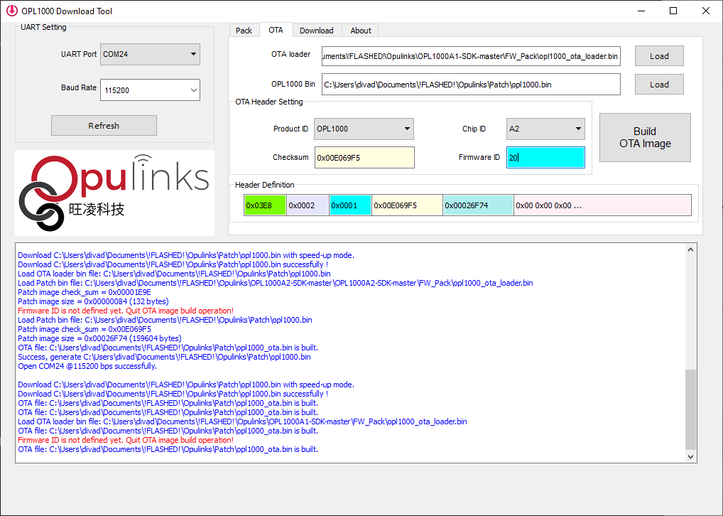

    #65 21194948
    Posts: 5220
    Help: 449
    Rate: 918
    I made some changes to the mw_ota.c file but nothing extra was printed to log. I saw "ota_abort error" in https://github.com/Opulinks-Tech/OPL1000A2-SDK/blob/49805f417c8d1fda258c146d2c8c7a8961fa57fc/SDK/APS_PATCH/examples/system/ota_wifi/http_ota_example.c#L364
    GPT gave me the attached revised for both. This is the boot log output now.
    I think it's something to do with
    project_id = 1000
    chip_id = 2
    firmware_id = 1
    img_size = 160180
    img_sum = 14753094
    eg setting firmware ID to 20 here
    OPL1000 Download Tool user interface with OTA configurations.
    gives a 20 value in the log

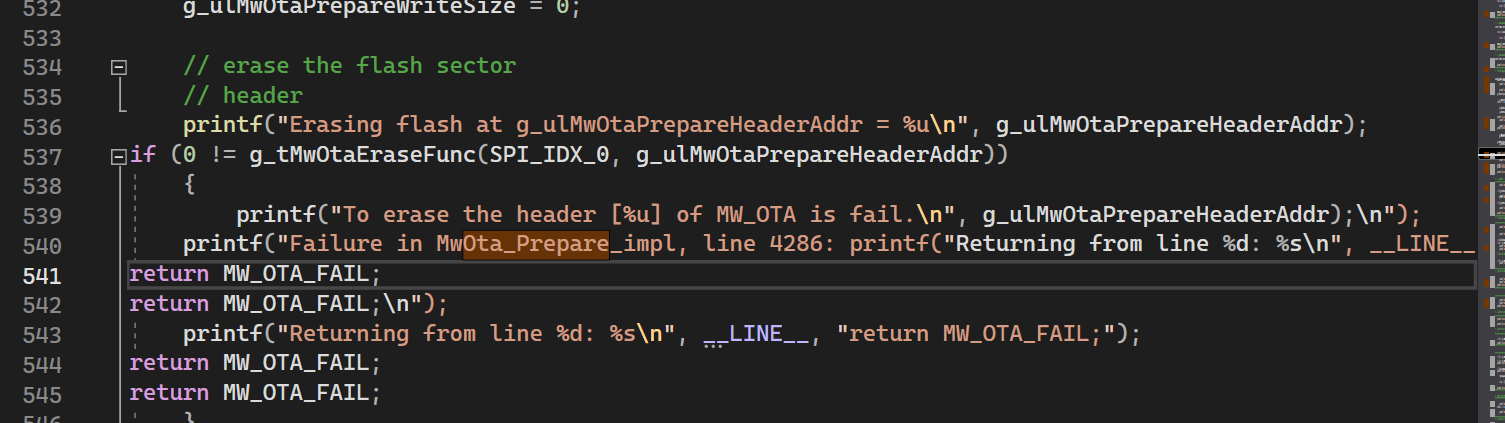

    #66 21194994
    Posts: 14770
    Rate: 12912
    mw_ota.c you attached won't build, something has copied printfs twice there:
    Source code snippet in C with duplicated return statements.
    Here is the function with better printfs:
    Code: C / C++
    Also, make sure to make a full rebuild, so the changes are included.
    It is possible this file somehow is not getting build.
    Or just make a syntax error in it and check if it detects it.
  • DW2 OTA fails at ota_prepare stage

  • Correct OTA image packing with Opulinks tool v2.0.0
    #69 21196691
    Posts: 5220
    Help: 449
    Rate: 918

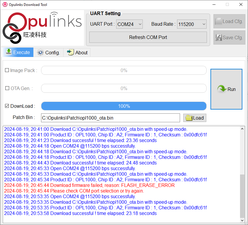

    OK. So it helps if you use a version of the Opulinks Download Tool that packs the firmware correctly.
    v2.0.0.
    Using the same opl1000_m0, PatchData.txt as before and the ota_wifi firmware opl1000_app_m3.bin we create the opl1000.bin as normal
    Opulinks Download Tool window displaying settings and file paths.
    then we add the opl1000_ota_loader.bin because
    - from OPL1000-Demo-ota-wifi-guide_ENG.pdf
    Burn opl1000_ota.bin to OPL1000
    Screenshot of the Opulinks Download Tool showing UART settings and download process logs, with a FLASH_ERASE_ERROR displayed.
    on reboot this in the output indicates the OTA loader is present
    -from OPL1000-Demo-ota-wifi-guide_ENG.pdf
    and if you've set the AP SSID and password correctly in http_ota_example.h and the http server and port in http_ota_example.c and opl1000_ota.bin is available on the your HTTP server
    Code snippet defining server IP, port, and URL for OTA download.
    then it will begin to download the OTA file and flash it. This is the complete process from first boot of ota_wifi demo fw, OTA file download and flash and finally boot of wifi_station_gpio where it connects to my wifi and the LED on the DW2 lights. (Note the wifi_station_gpio firmware on the HTTP server is the same opl1000_ota.bin created by the ota pack process in tool).
    note how the new firmware boots with this in log
    I did try to OTA the full 1024kb factory backup but of course it failed. it stops at around 167kb. Unknowns are how big each image area is, if these demos are even aware of the 1mb flash, how big could Openbeken OTA fw be?
    Added after 37 [minutes]:
    and if you serve up ota_wifi firmware so it OTA updates every reboot, then it alternates between MW_OTA [0] and MW_OTA [1]

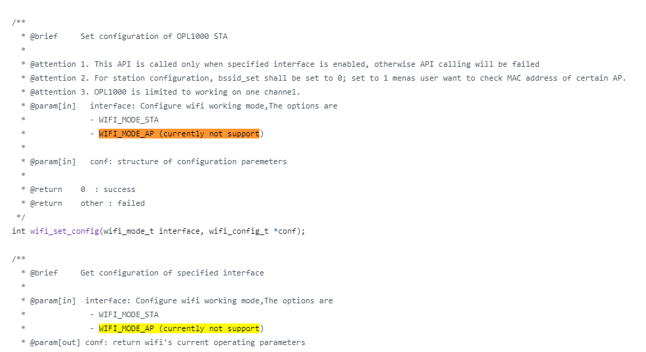

  • AP support appears possible in OPL1000 SDK
    #72 21204577

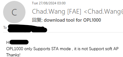

    Posts: 5220
    Help: 449
    Rate: 918
    Now I see you've got OTA working, is that correct
    Yes
    what about creating AP?
    I started playing with other devices and haven't done anything OPL1000 since, but will see if I can get AP going
    Added after 5 [hours] 37 [minutes]:
    hmm
    https://github.com/Opulinks-Tech/OPL1000A2-SD...ware/netlink/wifi_controller_layer/wifi_api.h
    Screenshot of API documentation for OPL1000 regarding Wi-Fi configuration.
    Added after 4 [minutes]:
    but then there is this https://github.com/Opulinks-Tech/OPL1000A2-SD...tlink/wifi_controller_layer/wifi_types.h#L105
    Added after 9 [hours] 6 [minutes]:
    Screenshot of an email about the OPL1000 device, indicating it supports only STA mode, not soft AP.
  • #73 21205361
    Posts: 14770
    Rate: 12912
    Strange, I was sure barely some time ago that it just does not support config change, but still can run AP.
    If no AP, then how it pairs? Now seriously. Is it even possible? It would kinda require device to know the SSID upfront and phone would have to use AP mode so OPL is STA...

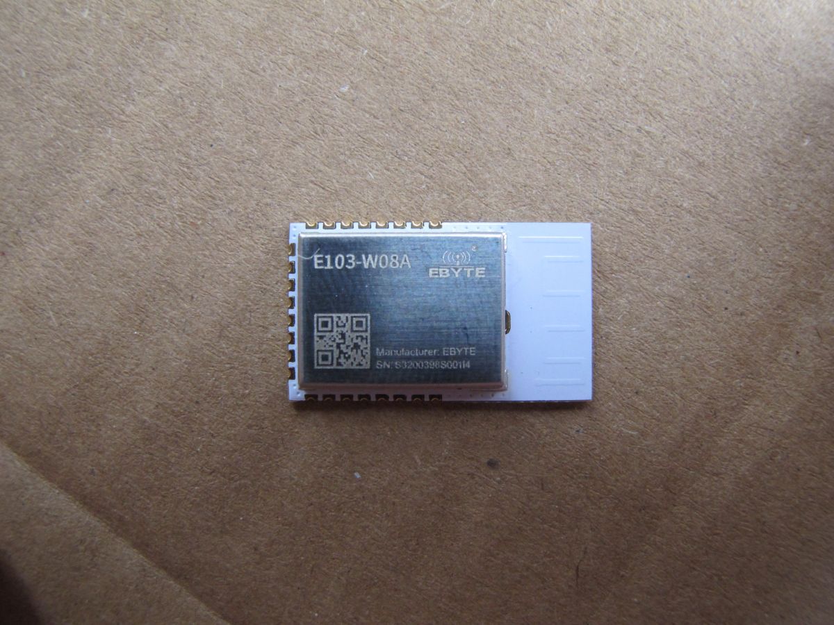

  • #80 21386430
    Posts: 14770
    Rate: 12912

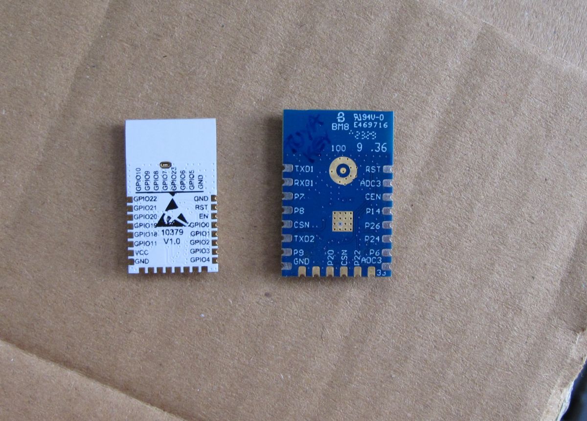

    That's not good, it will not fit to NodeMCU.
    Maybe it will fit to ESP boards? ESP32 modules have also smaller pitch pins?

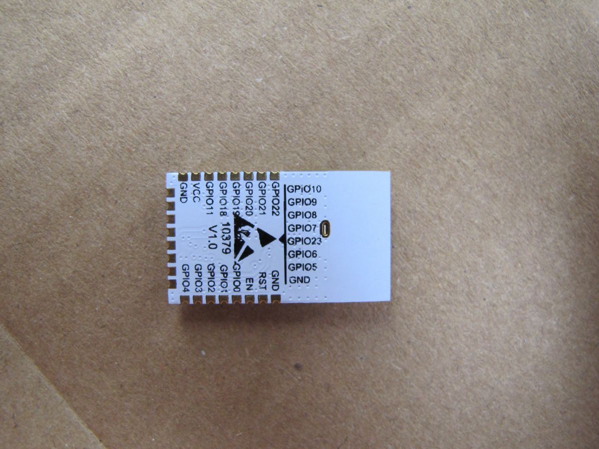

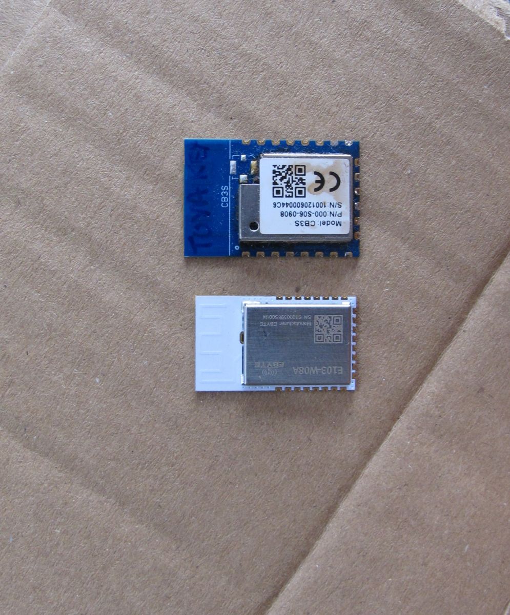

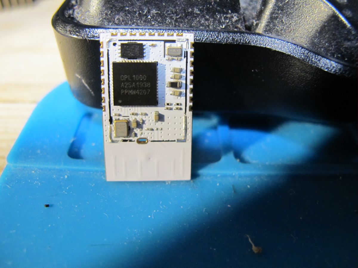

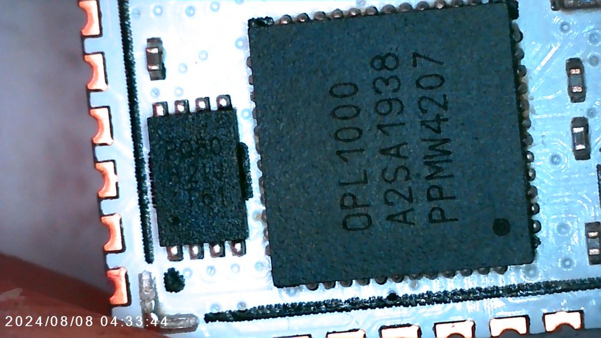

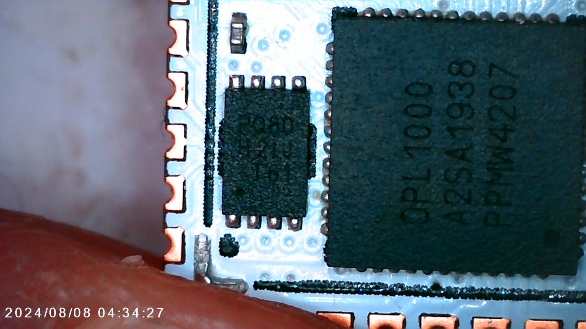

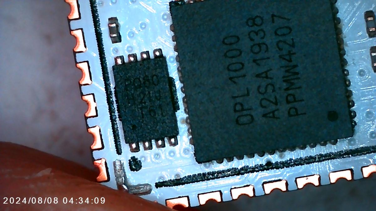

  • E103-W08A identified with GPIO3 TX boot log
    #82 21405013
    Posts: 5220
    Help: 449
    Rate: 918
    E103-W08A defrocked
    Close-up of a circuit board with two chips, one marked PQ80 92U T61 and the other OPL 1000 A2SA1938 PPMN 4207. Close-up of an electronic circuit with two visible chips on a circuit board. Close-up of a circuit board with two black integrated circuits.
    Electronic module with visible conductive elements
    looks like
    Added after 3 [hours] 17 [minutes]:
    ah, is this the same USON package @DeDaMrAz has just encountered here: https://www.elektroda.com/rtvforum/topic4093142-150.html#21403323 how did you connect to it @DeDaMrAz ?
    Added after 6 [minutes]:
    maybe not. this has legs
    GPIO3 TX 115200 boot
    -11 Carriage return wrapping was not entered
  • #83 21407092

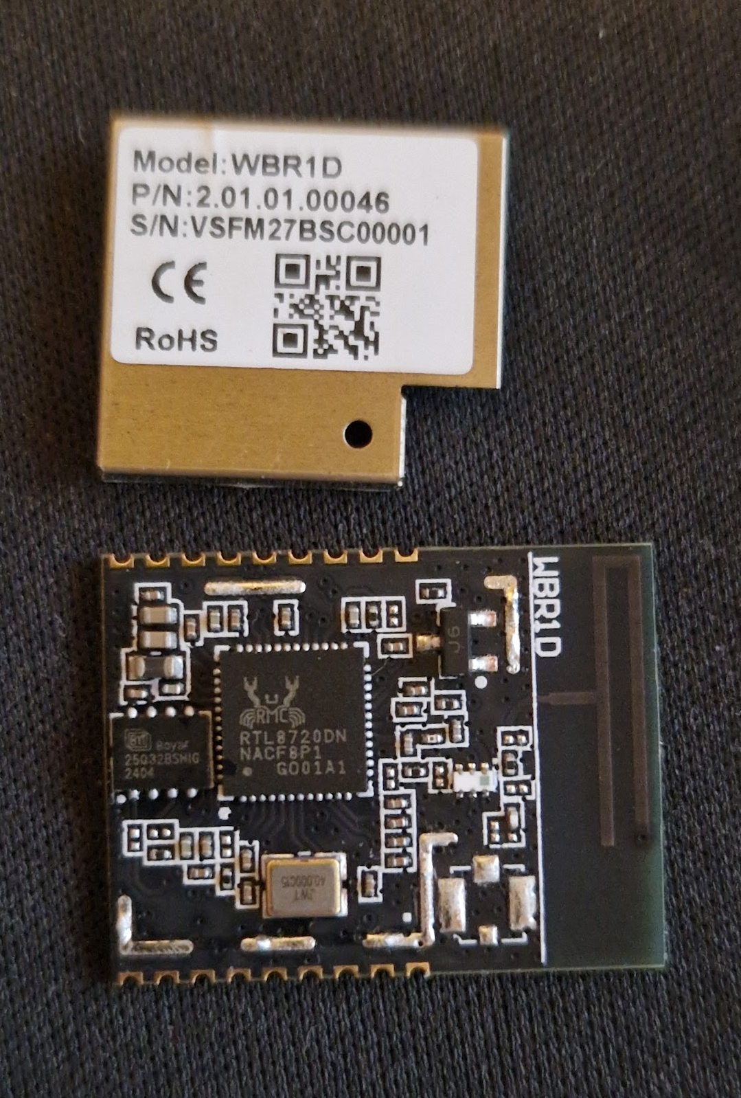

    Posts: 14770
    Rate: 12912
    I haven't seen that small flash memory used on such module yet, all ESP modules I saw had a larger flash footprint.

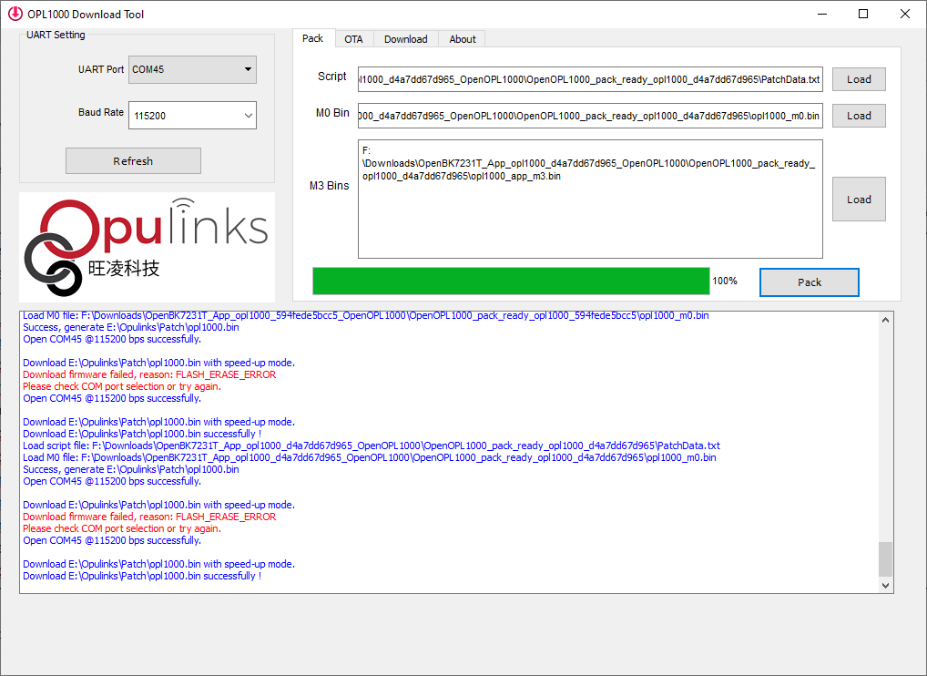

    just vibing an OPL1000 mess. It's building something. Not got a working OBK http yet though. Only just got it to connect to wifi.
    List of builds with green check icons and entries starting with “Build (Open…)” in a UI
    https://github.com/divadiow/OpenBK7231T_App/tree/refs/heads/opl1000
    Before Wi-Fi/lwIP: ~2680 bytes free
    After lwIP net_start: ~728 bytes free
    M3 gets only this play with I think - 0x00440000 - 0x004164A0 = 0x29B60 = 170,848 bytes
    no AP mode of course. fixed to connect to test/1234abcd
    Screenshot of OPL1000 Download Tool showing UART settings and firmware download log
    more for fun than a serious attempt I think

    I thought about porting it, but when i've seen that there's no xip, i quickly abandoned the idea.
    Because unlike RTL8711AM, there's no embedded sdram.
    Still, you can use additional 16kb ram
    https://github.com/divadiow/OpenOPL1000/tree/main/Demo/Expand_M3_RAM
    And there's no freertos source in sdk, so you can't add it directly to heap.
    But, perhaps there's hope for it
    https://github.com/divadiow/OpenOPL1000/blob/...K/APS/FreeRtos/Source/include/portable.h#L189

  • Case label and seller data in the thread identify the unit as DW2-Wi-Fi, with quiescent current <=40 uA and emission current <=15 mA. [#20767159]
  • The teardown identifies three core parts: an Opulinks OPL1000-family module marked A2, a TH25Q80UA SPI flash, and a 6131 Hall sensor. [#20767159]
  • The original buyer paid less than 30 PLN, which is why the DW2 attracted interest as a low-cost battery Wi-Fi sensor. [#20767159]

What is MW_OTA in the OPL1000 boot log, and what do messages like "This image is from MW_OTA [0]" and "MW_OTA [1]" mean?
MW_OTA is the Opulinks dual-image OTA storage area used to switch between firmware slots. In the thread, the boot log printed "This image is from MW_OTA [0]" before an update and "This image is from MW_OTA [1]" after a successful OTA flash. That shows the new image was written to the alternate slot and then executed after reboot. The same post notes that if you keep serving the OTA demo again, the device alternates between [0] and [1] on successive reboots. "MW_OTA" is firmware storage logic that keeps two bootable images for rollback-style updates. [#21196691]
Why does the OPL1000 ota_wifi demo fail with "ota_prepare fail," and how do I package the firmware correctly for OTA updates?
It fails when the OTA file is built in the wrong format. The breakthrough post showed the fix: first build normal opl1000.bin, then use Opulinks Download Tool v2.0.0 to combine it with opl1000_ota_loader.bin and generate opl1000_ota.bin in the OTA tab. After that, the OTA demo downloaded and flashed a 118,300-byte image successfully. Before that correction, the log stopped at "ota_prepare fail" even though HTTP worked. The full 1,024 KB factory backup still failed as an OTA payload, stopping around 167 KB, so raw flash dumps are not valid OTA images. [#21196691]

What pairing method does the Sonoff DW2 use if it does not seem to support soft-AP mode, and how is BLE involved in WiFi setup?
The DW2 appears to use BLE for provisioning and then joins Wi-Fi as a station, not as a soft-AP. The thread notes that repeated resets never exposed an AP, and later analysis pointed to Opulinks blewifi examples where BLE handles configuration of the device’s Wi-Fi connection. One poster summarized it as BLE being the setup channel while the device is configured to connect to a Wi-Fi AP, not act as one. That explains why pairing can work even when no temporary AP is visible. [#21205368]
