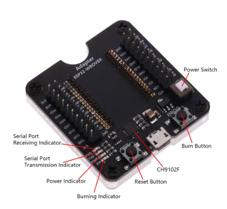

    Hello, today I will briefly show you a useful board that is essentially a USB to UART converter, but is distinguished by the fact that you can place a module with ESP12-compatible pins without soldering.

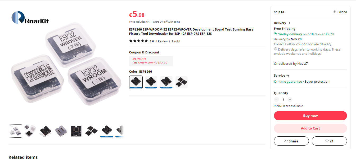

    We found the tile in China under the slogan: ESP8266 ESP-WROOM-32 ESP32-WROVER Development Board Test Burning Base Fixture Tool Downloader for ESP-12F ESP-07S ESP-12S . However, I didn't order it myself, my friend from Serbia, @DeDaMrAz, ordered it and I got the photos from him. I tested it with him remotely.
    Below are screenshots of the offer:
    Set of three development boards in boxes: ESP8266, ESP32 WROOM, and ESP32 WROVER

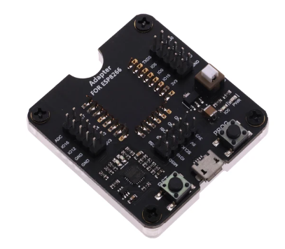

    It may not be the cheapest board, it costs over €6, but what makes it unique is that instead of regular soldering pads, it has springs that allow you to quickly replace the module on board.

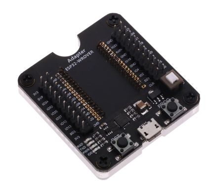

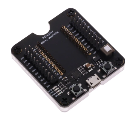

    It is available in three versions: ESP8266, ESP-WROOM-32, SP32-WROVER:
    USB to UART adapter for ESP8266 modules.
    ESP-WROOM-32 adapter with spring connectors and two buttons
    ESP32-WROVER adapter with buttons and micro USB port
    Description from the seller:
    Development board with a slot for an ESP module and various components.
    The board board includes:
    - RESET button
    - GPIO0 button (to enter ESP into programming mode; unnecessary in the case of BK7231)
    - USB to UART converter

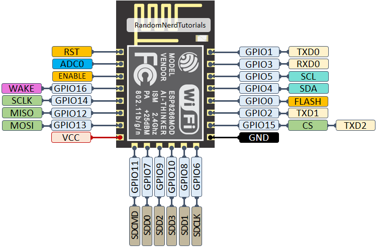

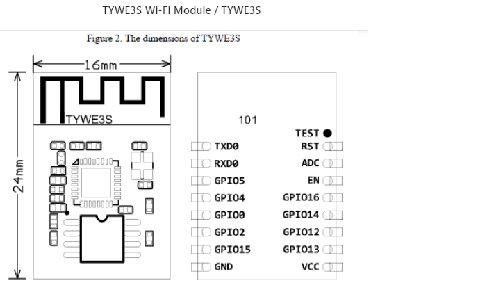

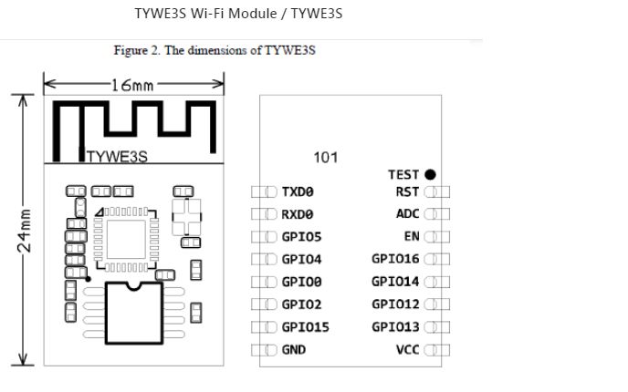

    First of all - ESP8266, just like in the name. That is, all modules like ESP12, TYWE3S, below the pinout:
    Pinout diagram of the ESP8266 module with pin labels.
    Details of the dimensions and pins of the TYWE3S Wi-Fi module.

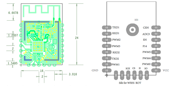

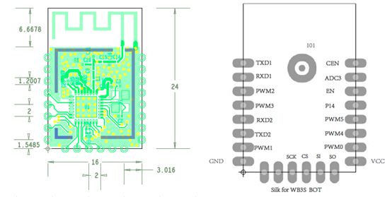

    The most important pins here are power, ground, RESET and UART1 - RX and TX. The WB3S (BK7231T) are compatible with TYWE3S:
    Electrical schematic of a module with pin layout.

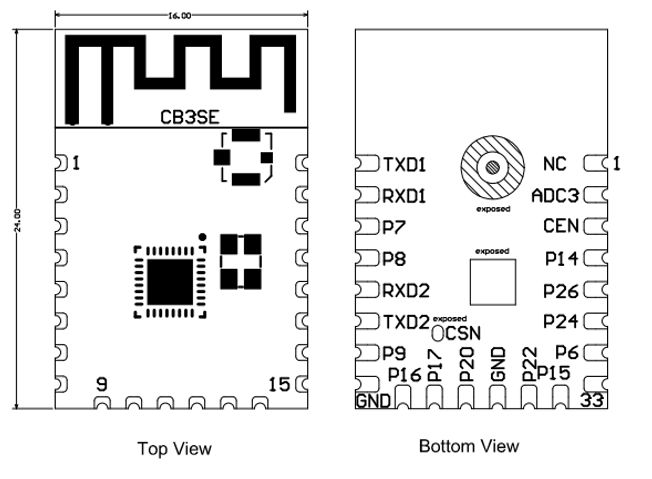

    So WB3S fits too. Inevitably, CB3S and related ones are similar:
    Pin diagram of CB3SE module top and bottom view.
    Over time, I also encountered modules based on other microcontrollers with similar pinouts. There was even something with the W600 or W800 from WinnerMicro, and the ground/power supply and UART positions were the same, so this board would be useful even for them.

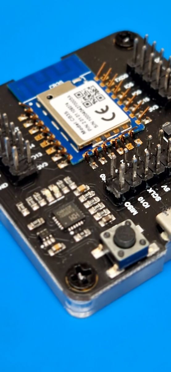

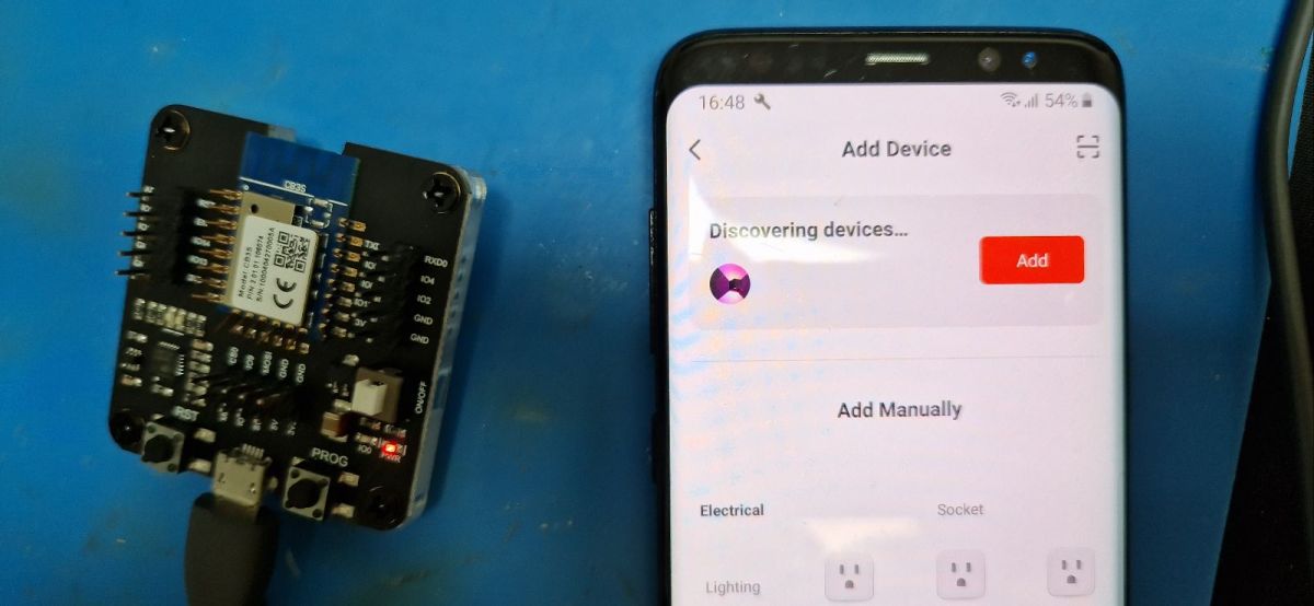

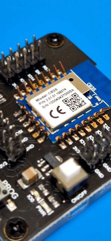

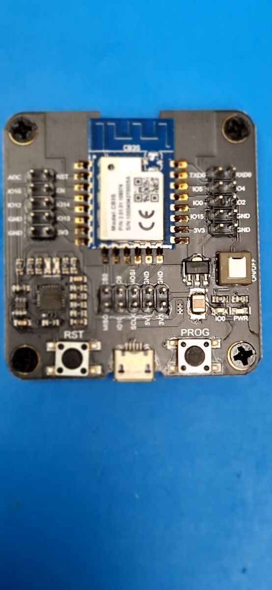

    Here are photos of the board in action - with the CB3S module:
    Development board with an inserted ESP module, connected to a USB cable. USB to UART converter board with CB3S module. Close-up of a development board with a CB3S module. Development board with a CB3S module mounted on springs. USB to UART converter board with CB3S module in a no-solder socket.

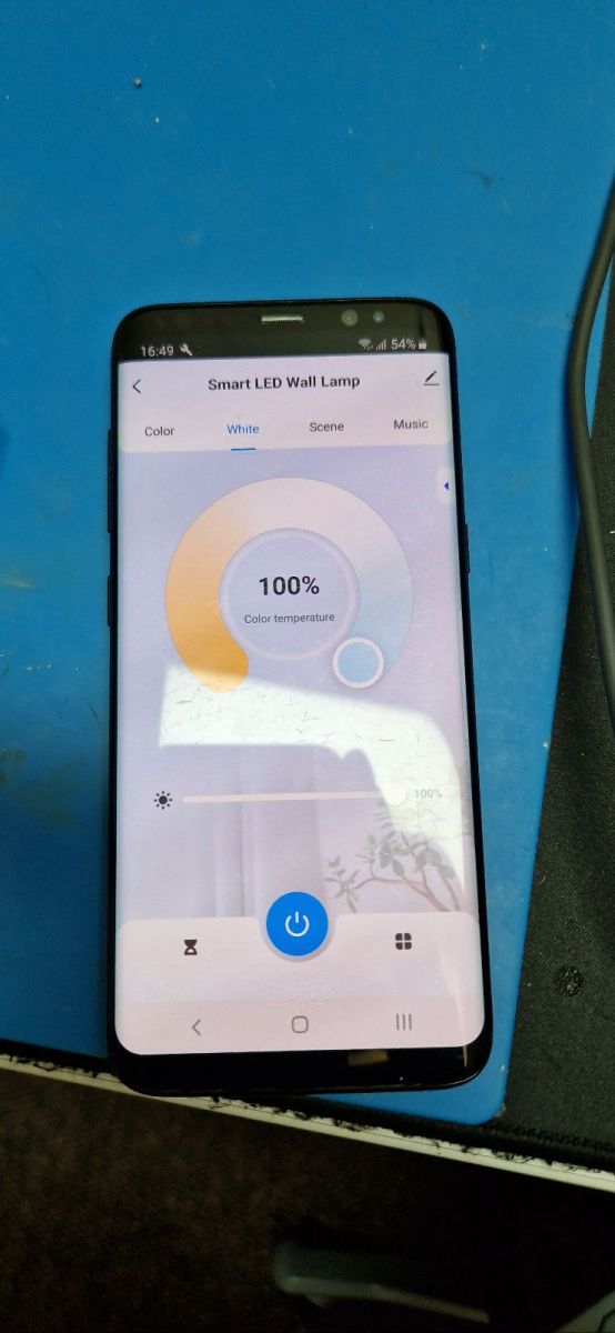

    Together with @DeDaMrAz we checked and it is possible to flash and operate CB3S in this board without any problems. Here is an example of a photo after uploading the CB3S batch of the Tuya lamp whose communication protocol we will be examining:
    Smartphone with LED lamp control app on a blue background. Test board with CB3S module and a phone displaying the device addition screen
    In this situation, the CB3S in the photo is new, and we have uploaded the user's input to it, but that is not important for this topic...
    We uploaded with my flasher:

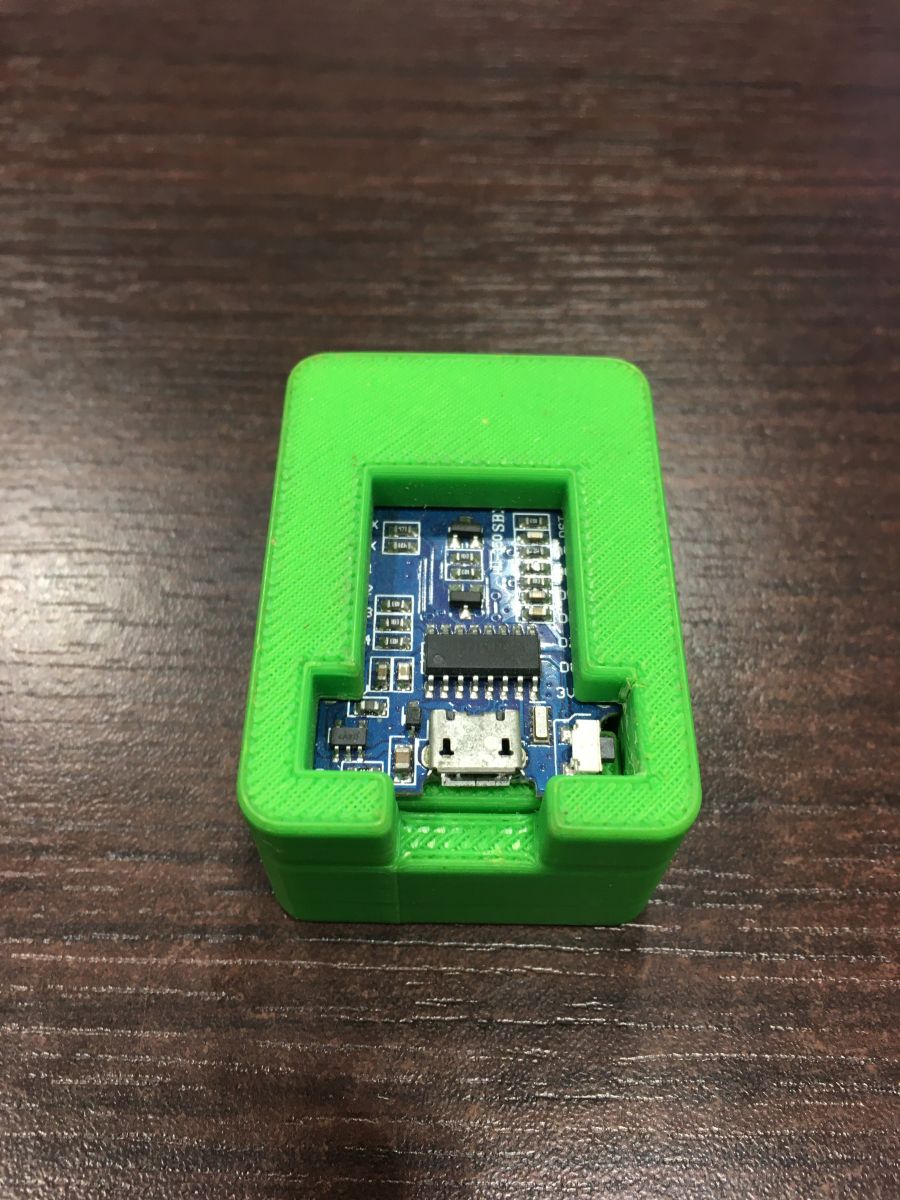

    I've had the board for about 2 years now - it's a great thing, I use it to load various loads onto "bare" ESP8266 12F boards and I still use it to build various structures, you could say that without this board it's like without a hand when playing smart home.
    A few years ago, I don't remember who from me, whether it was from a user of this forum or some FB group, as a gift, I received his own construction of such an adapter for loading loads on the ESP:
    Green, 3D-printed plastic adapter for flashing firmware on ESP8266. Adapter for flashing ESP8266 12F in a green case.
    I used this gift for a long time and it helped me a lot. Handmade using a 3D printer and Wemos D1 mini.
